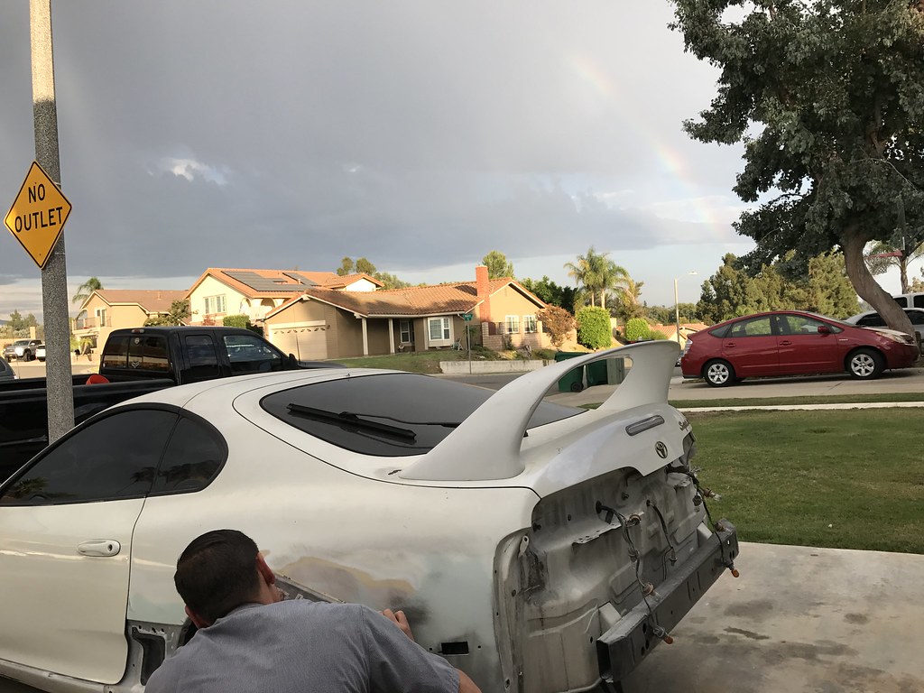

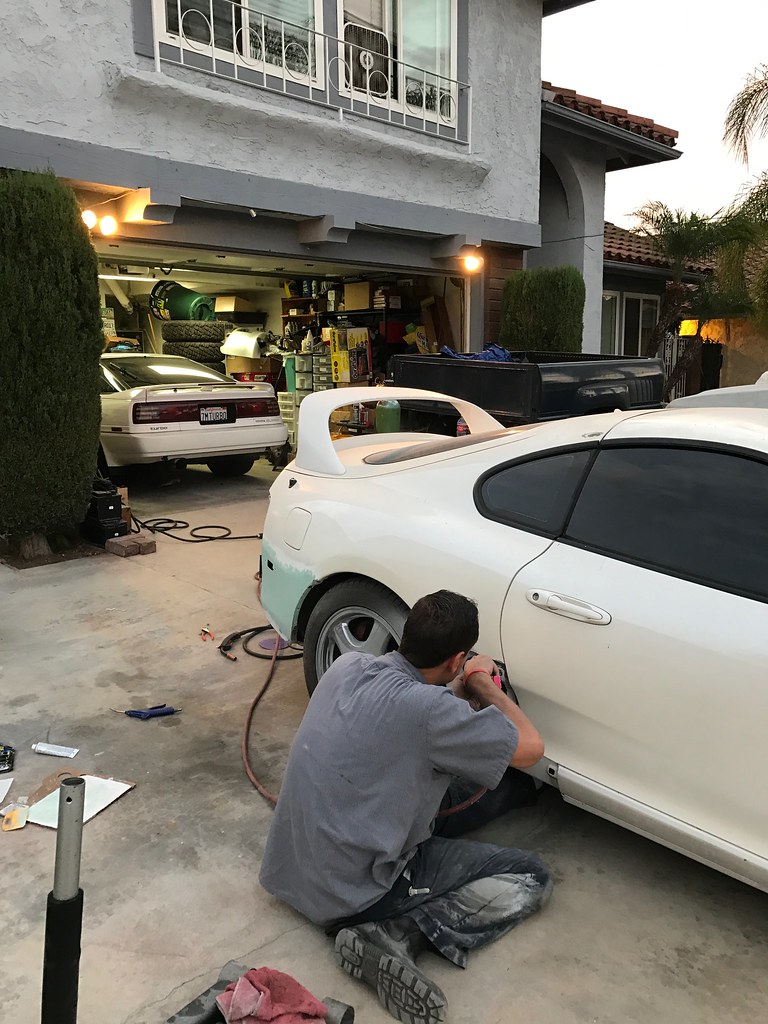

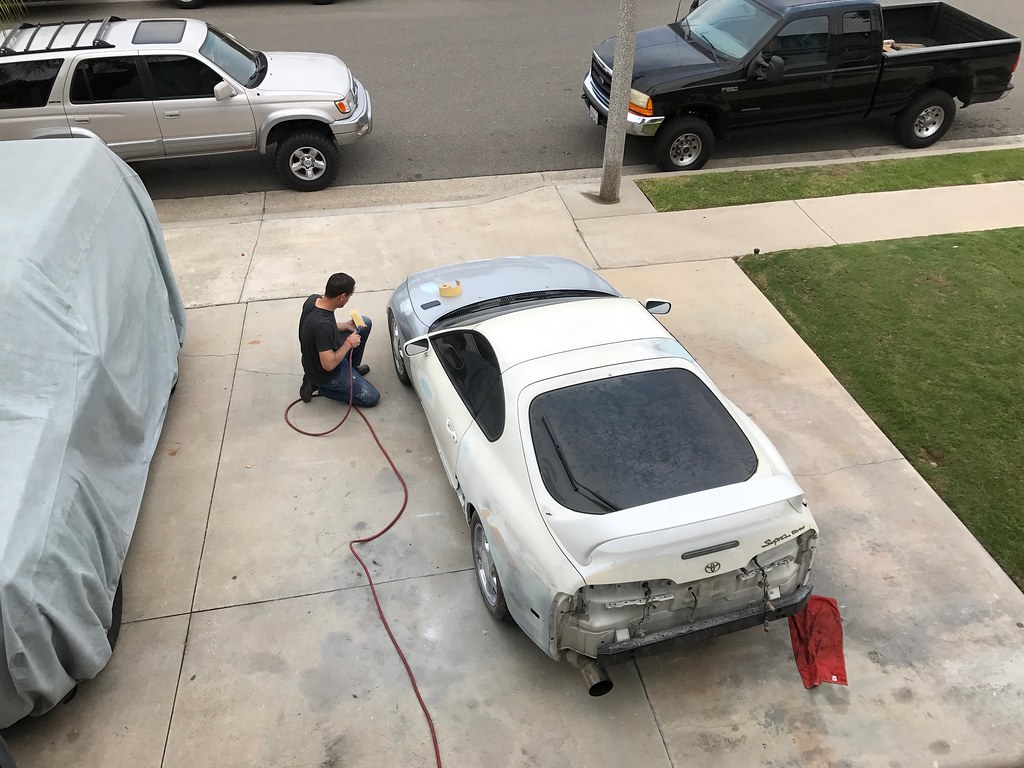

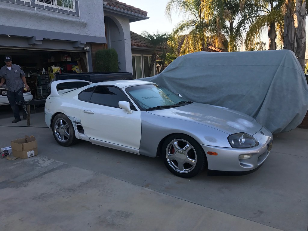

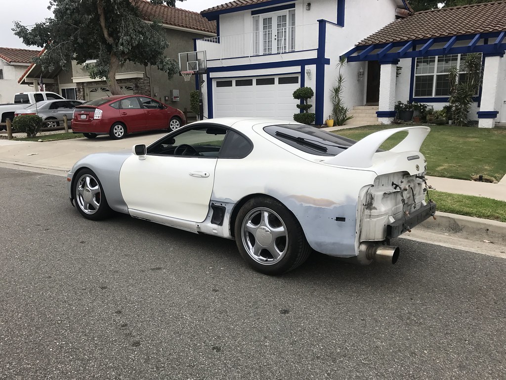

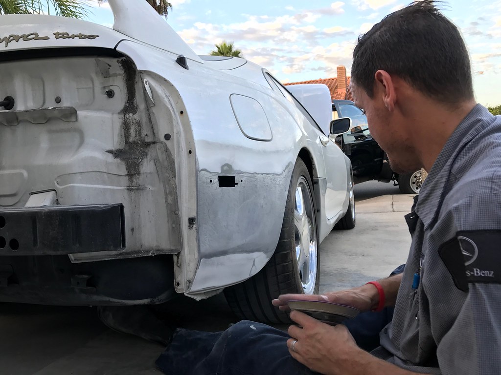

A friend of mine from work, Justin, does bodywork. He did up my 99 4Runner a while back. Top notch work, which is what this car needs.

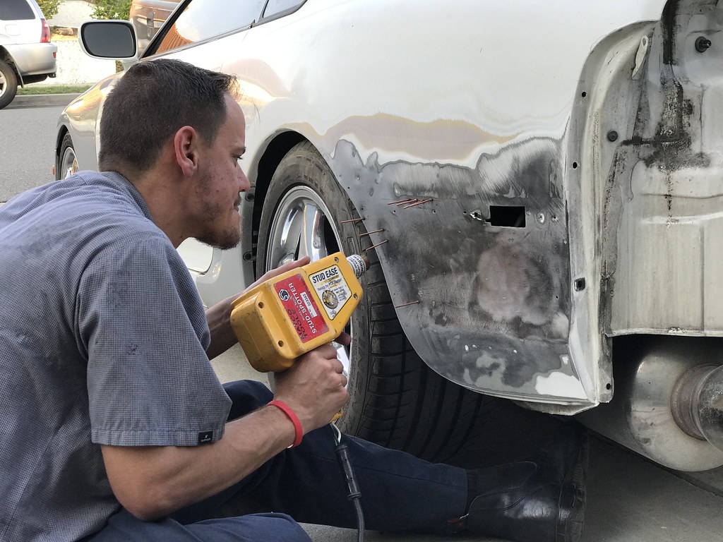

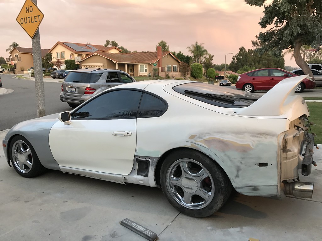

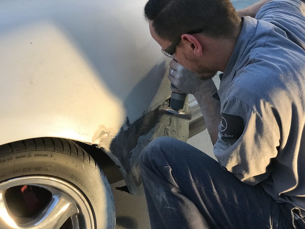

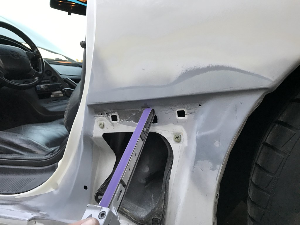

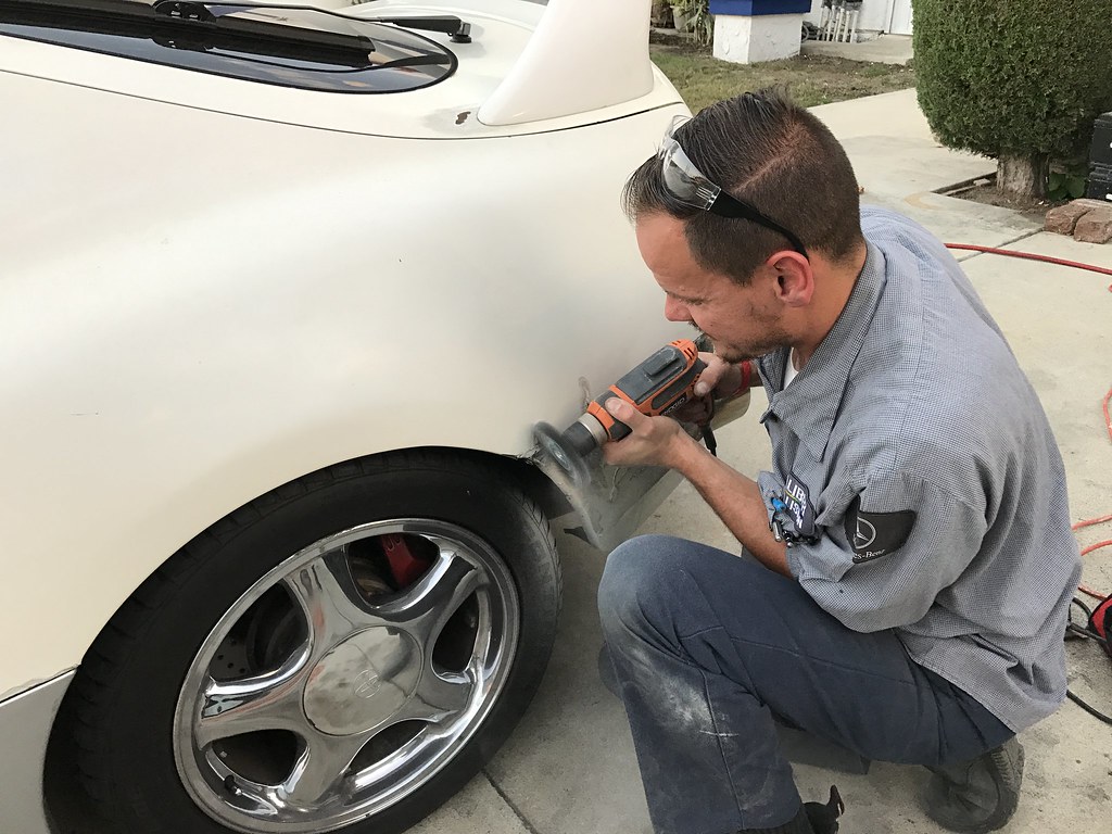

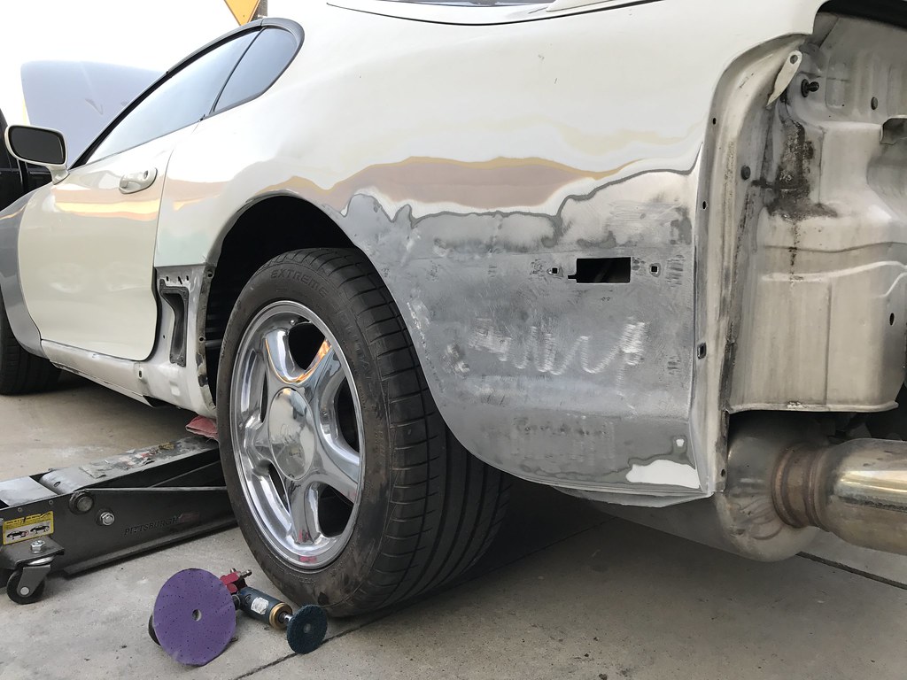

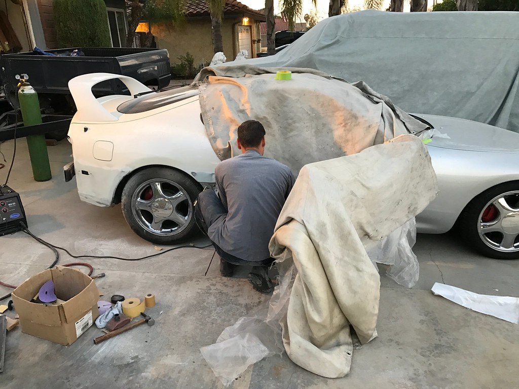

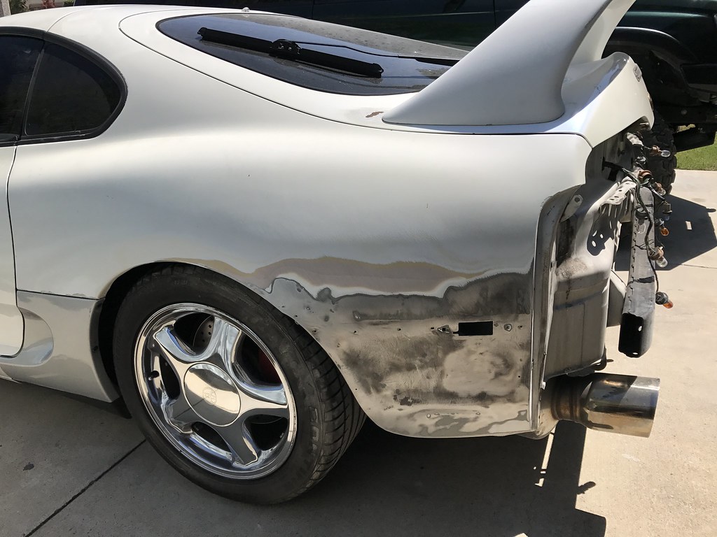

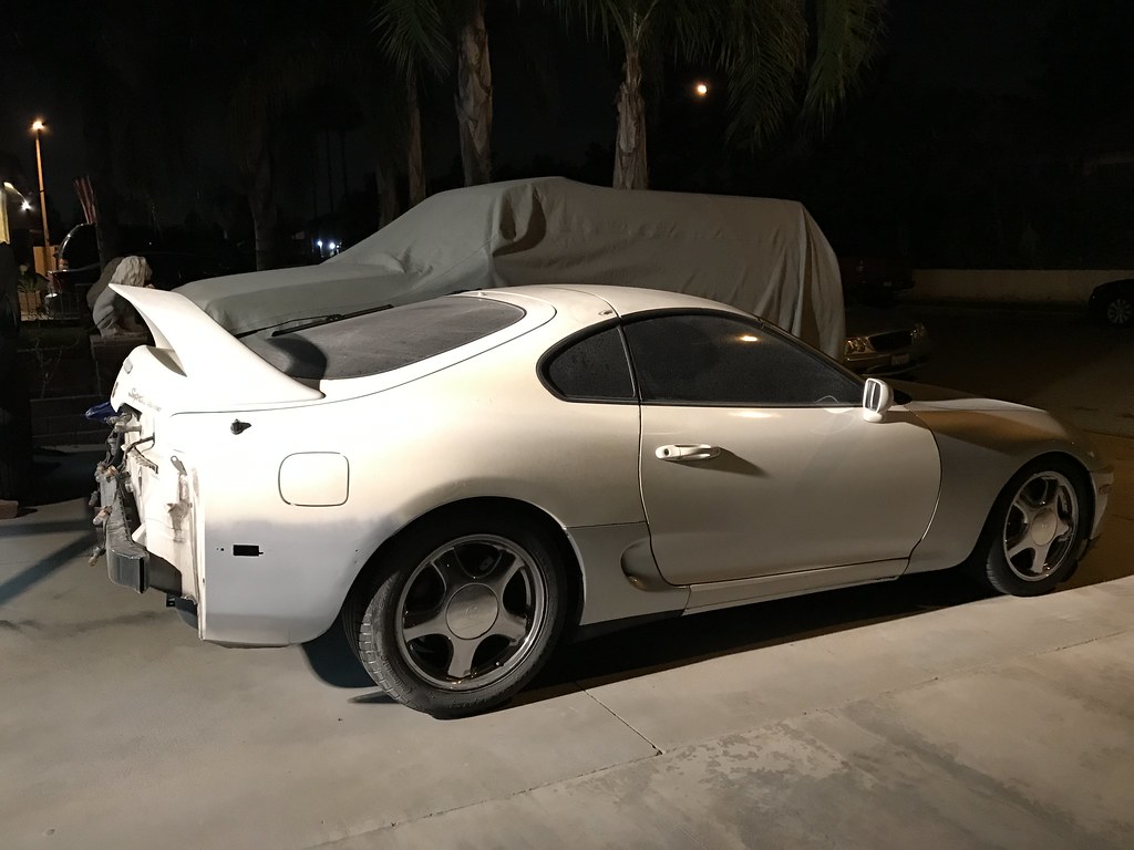

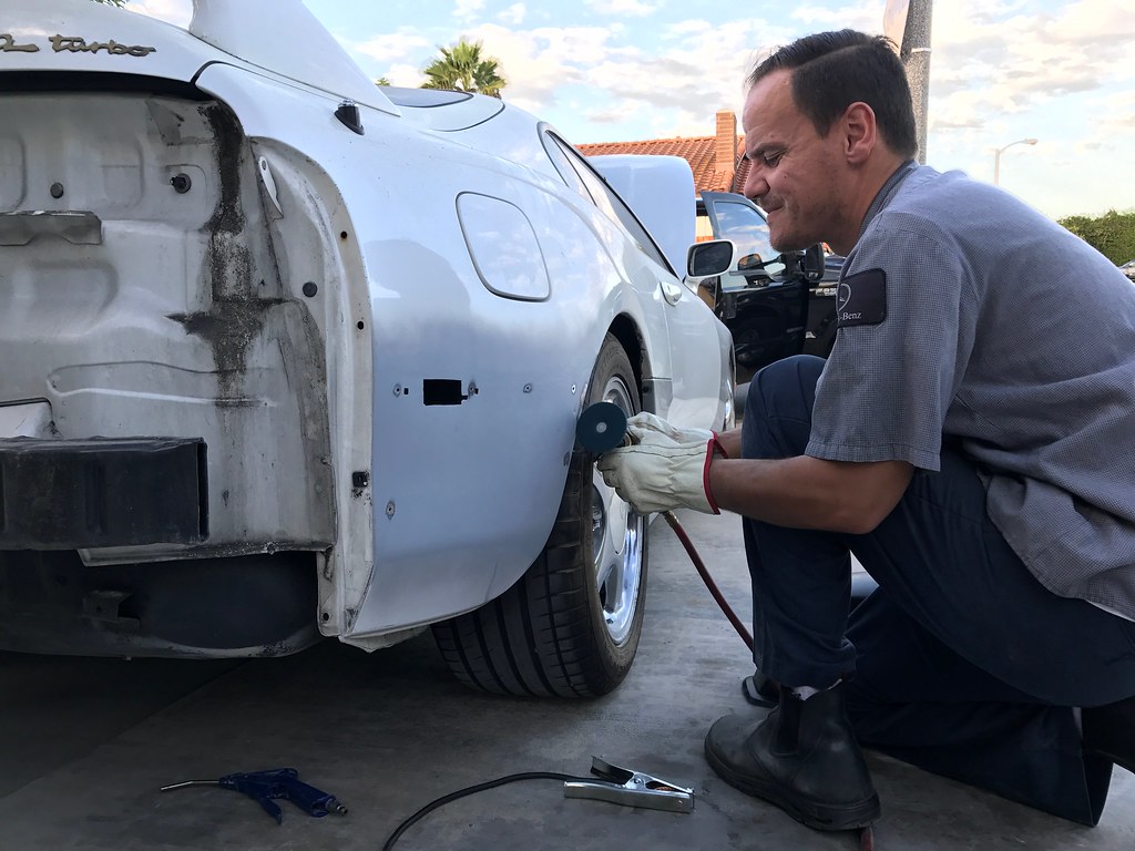

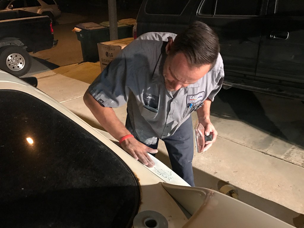

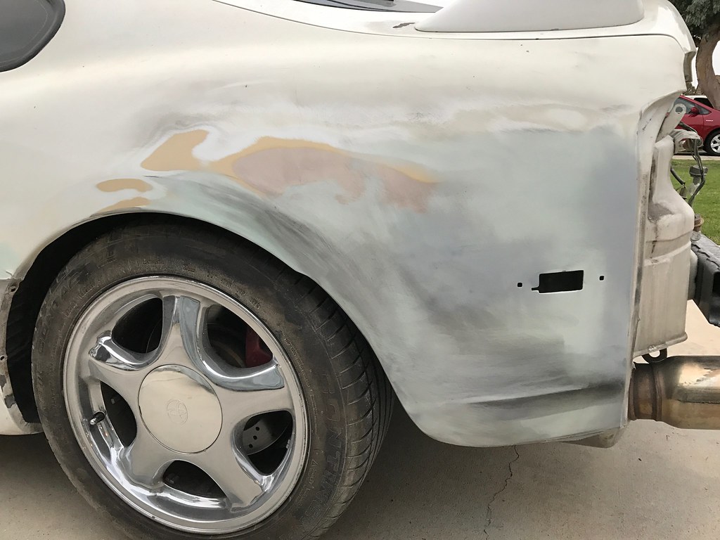

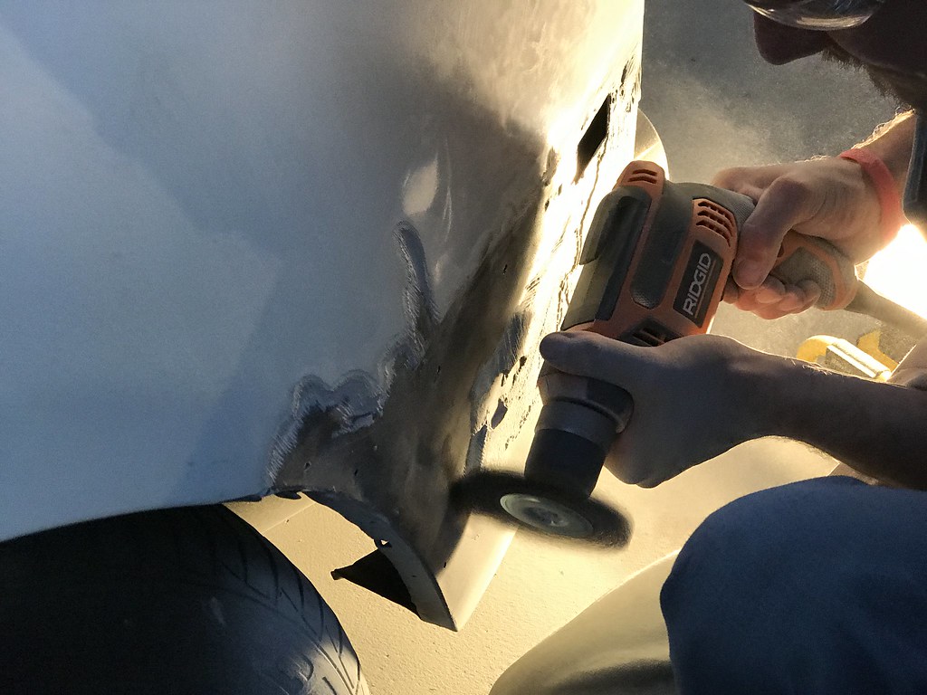

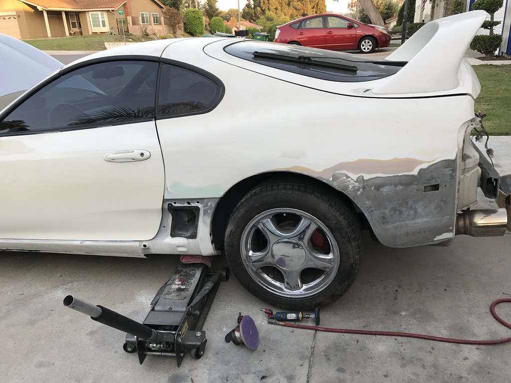

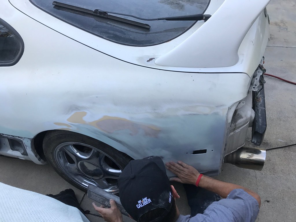

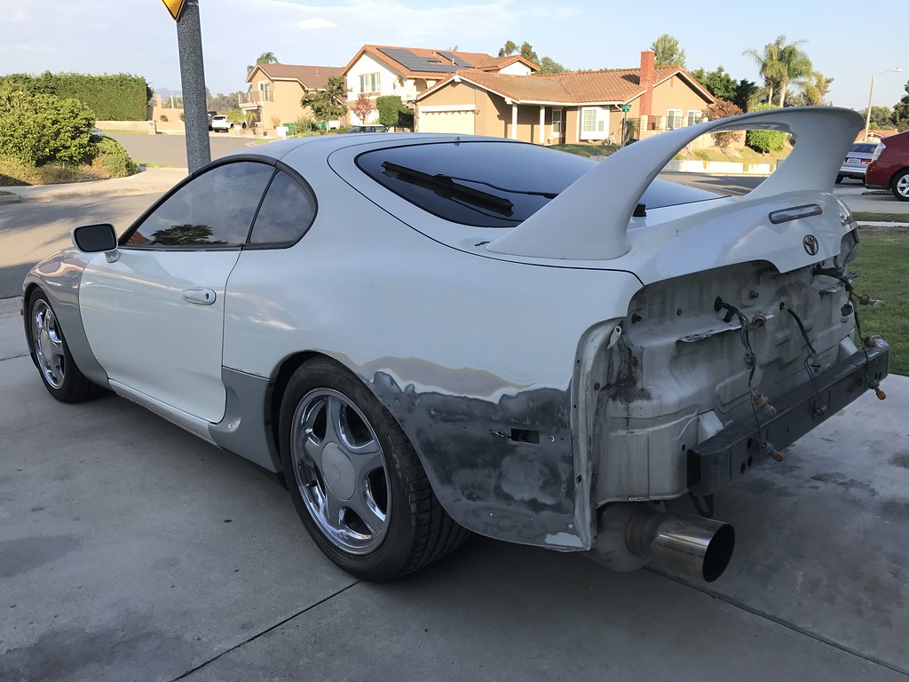

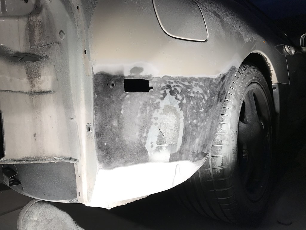

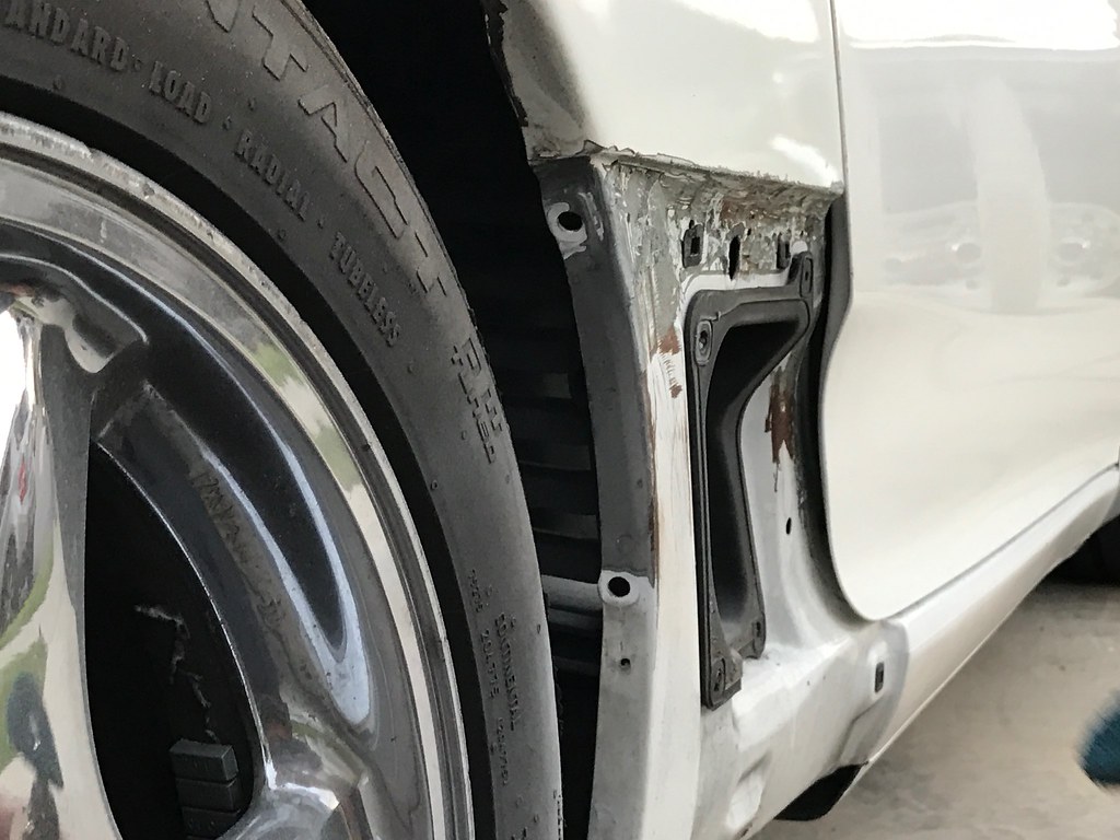

Time to unleash Justin’s skills on this poorly neglected Supra. He starts with the wire wheel, removing the old body filler still stuck to the left rear quarter panel.

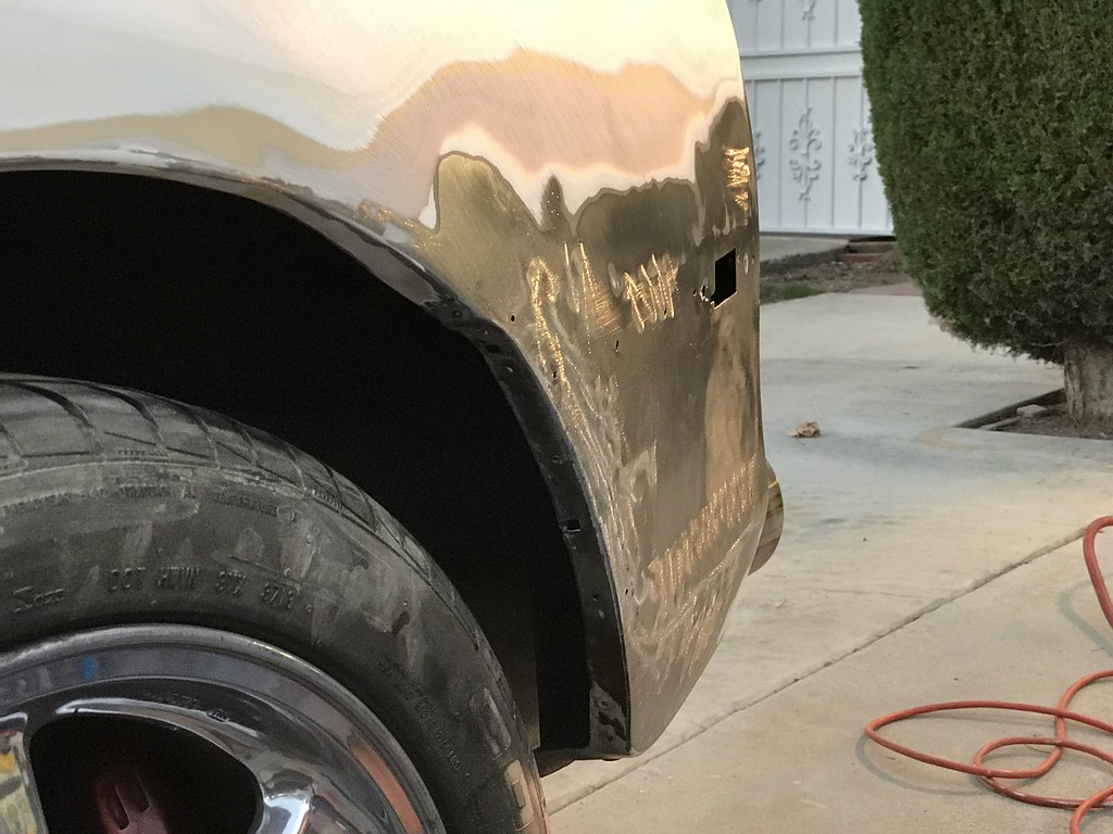

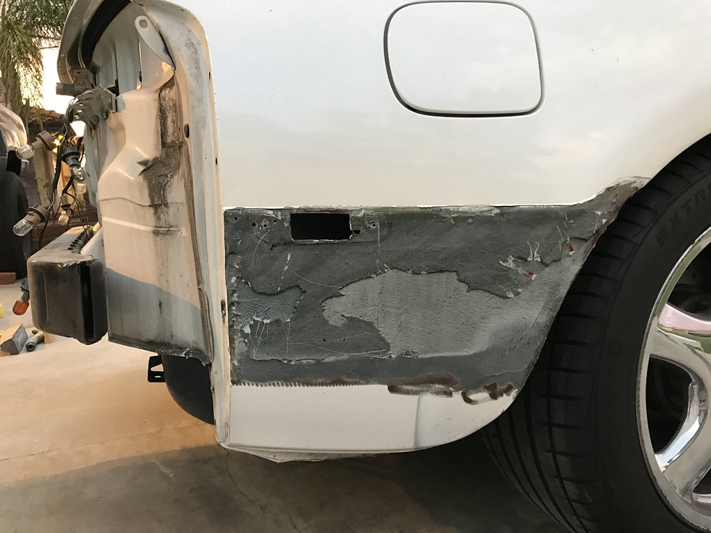

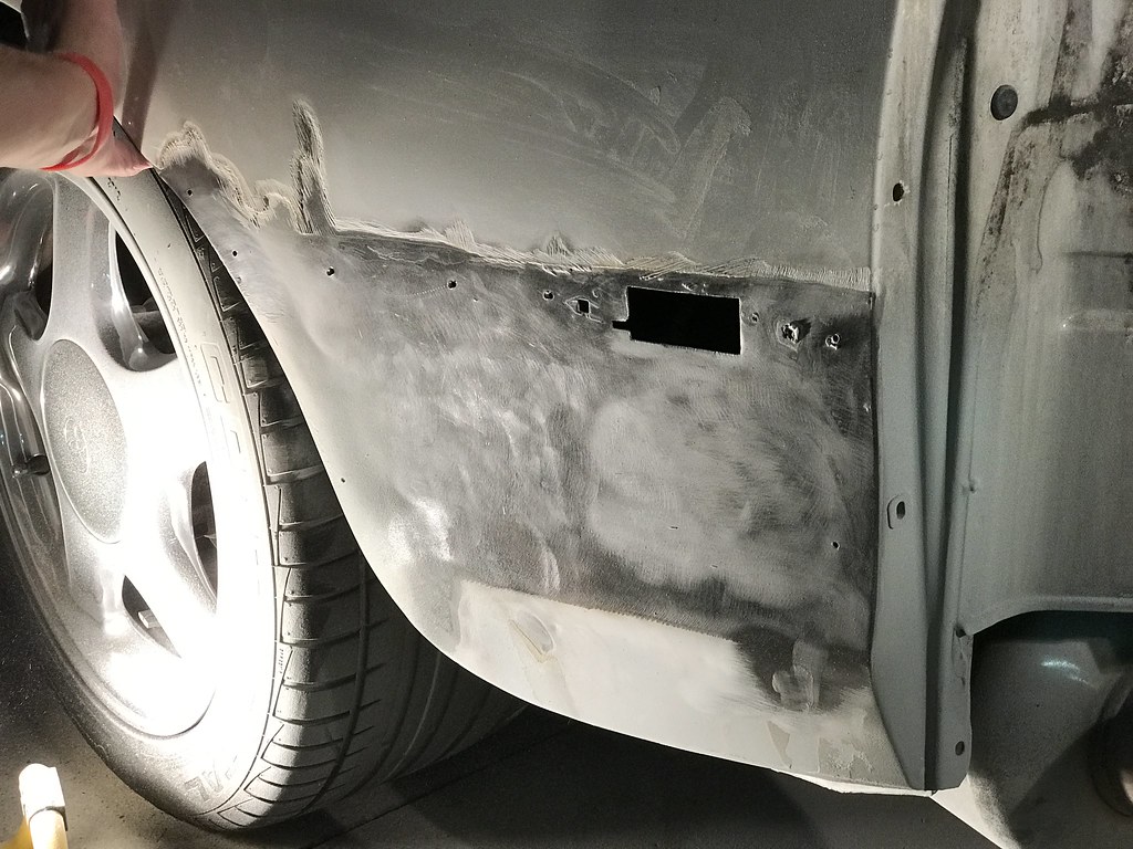

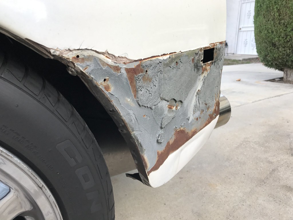

Underneath, we found a relatively intact panel underneath tons of unnecessary filler.

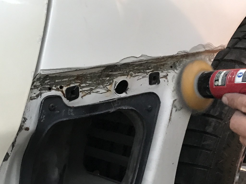

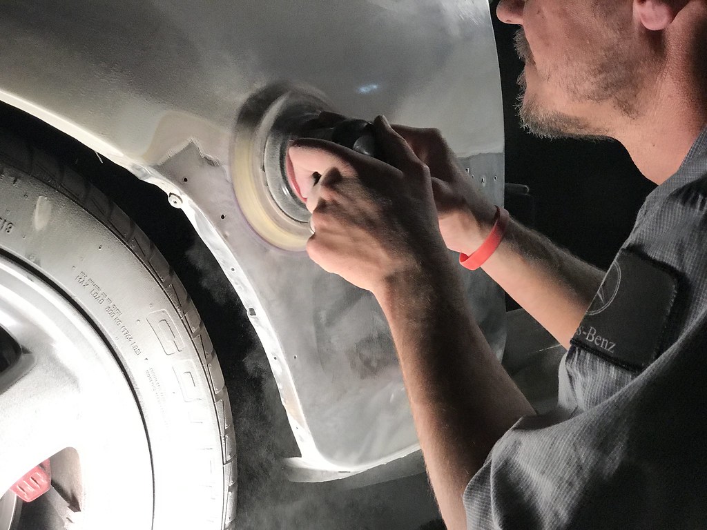

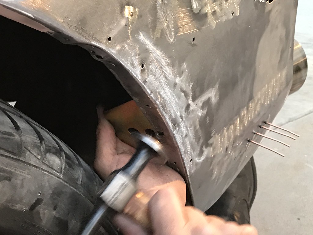

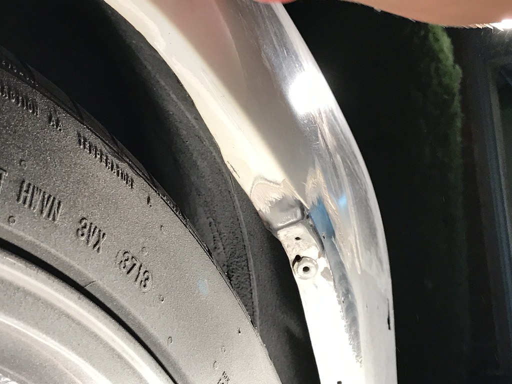

Body filler coming out of the wheelwell.

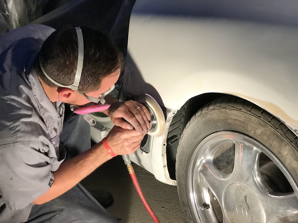

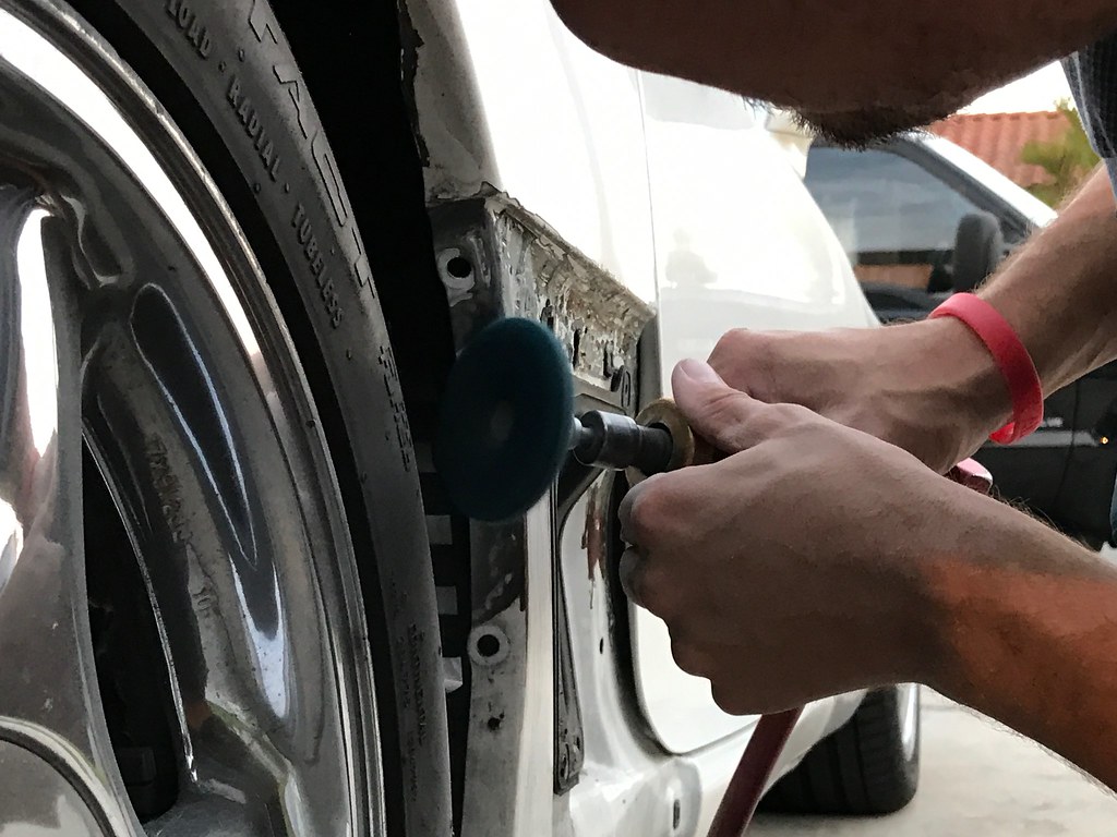

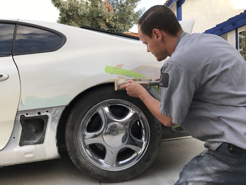

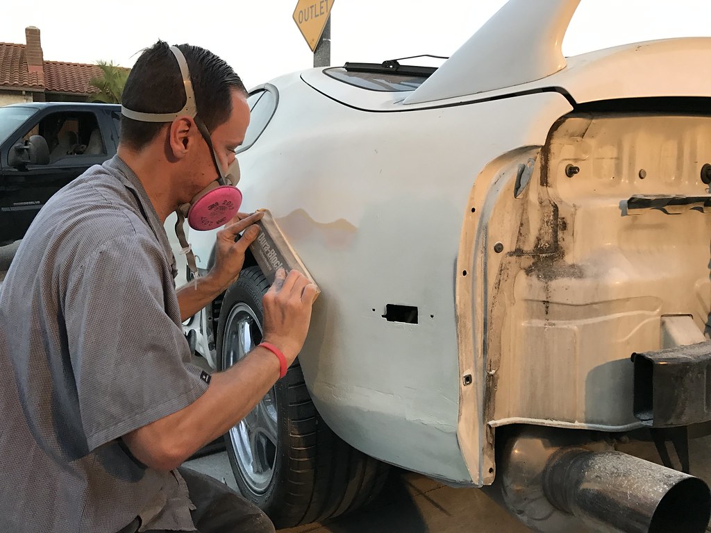

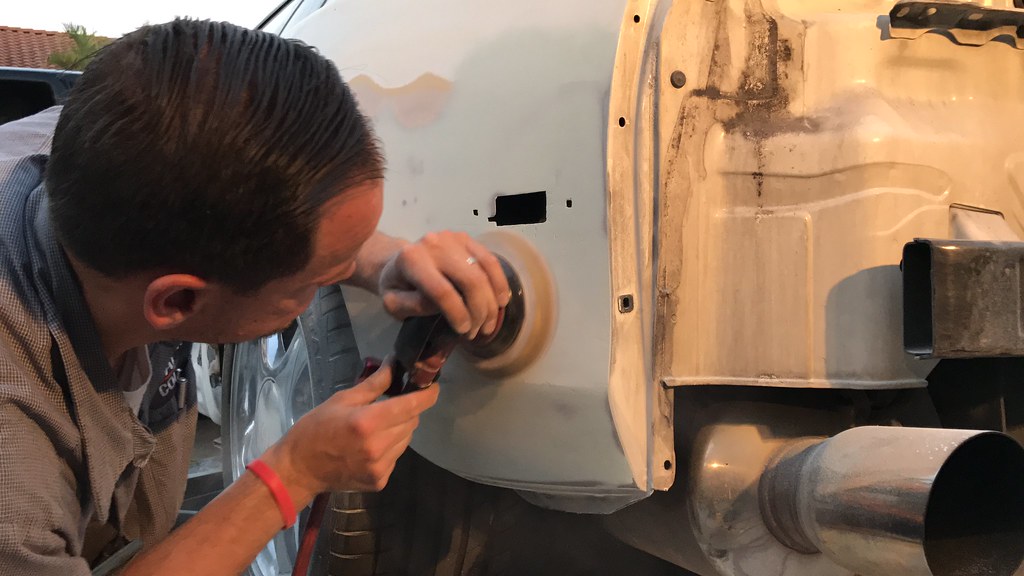

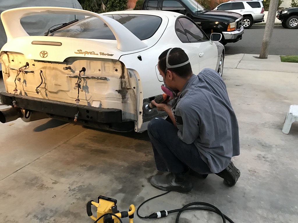

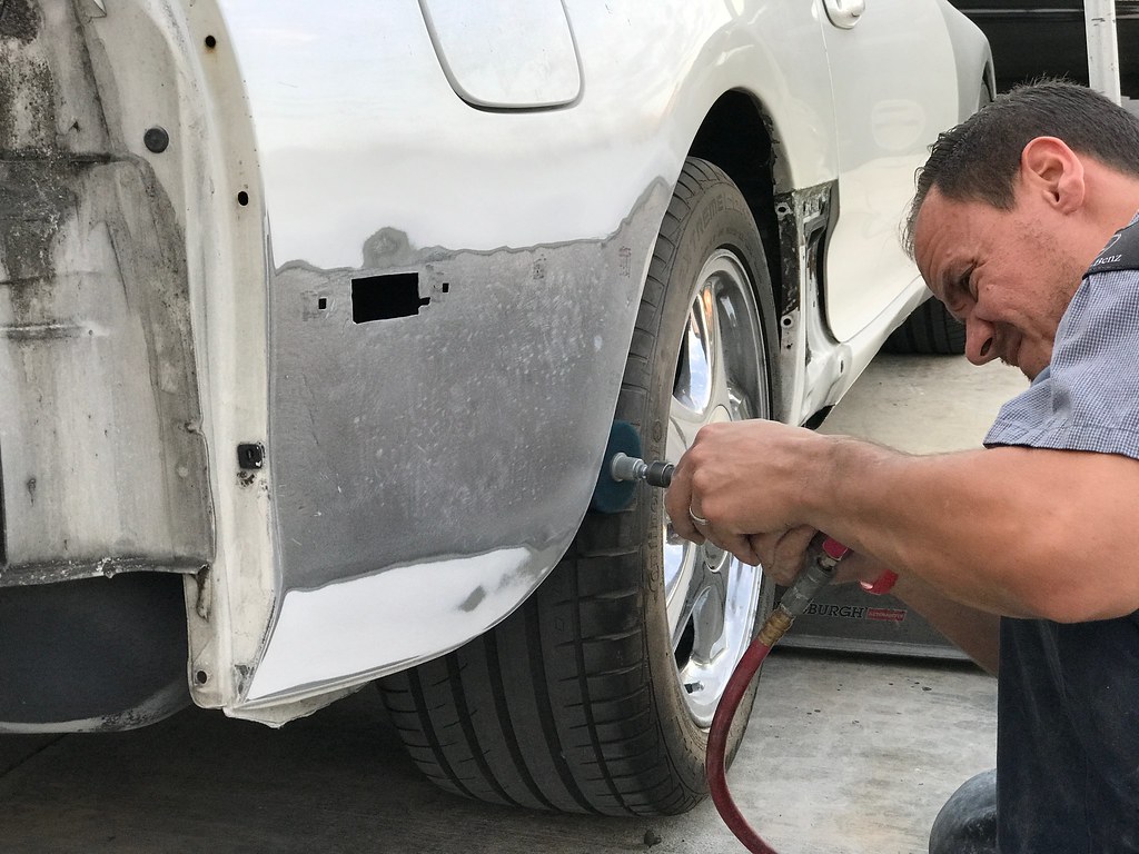

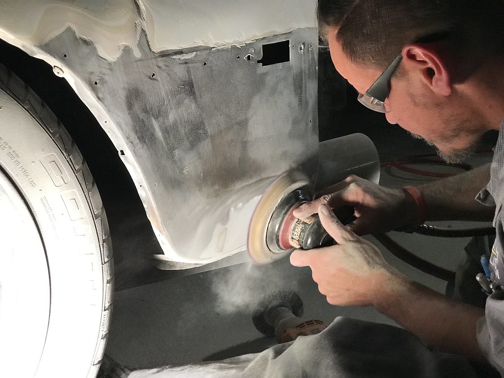

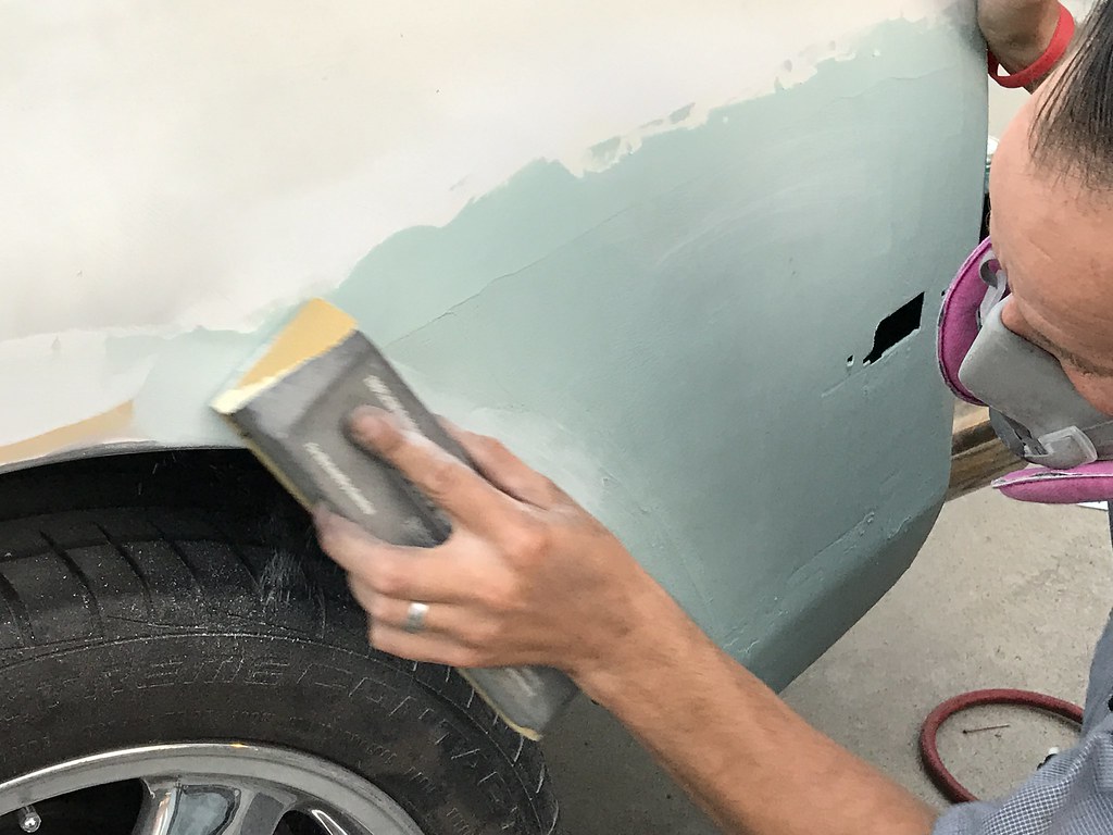

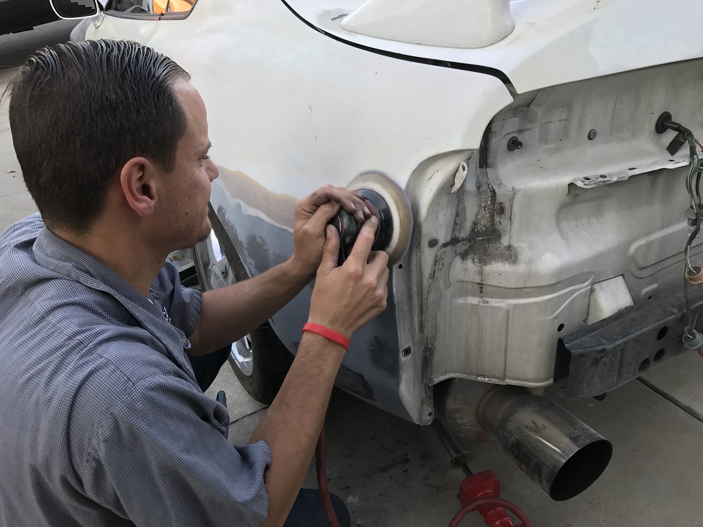

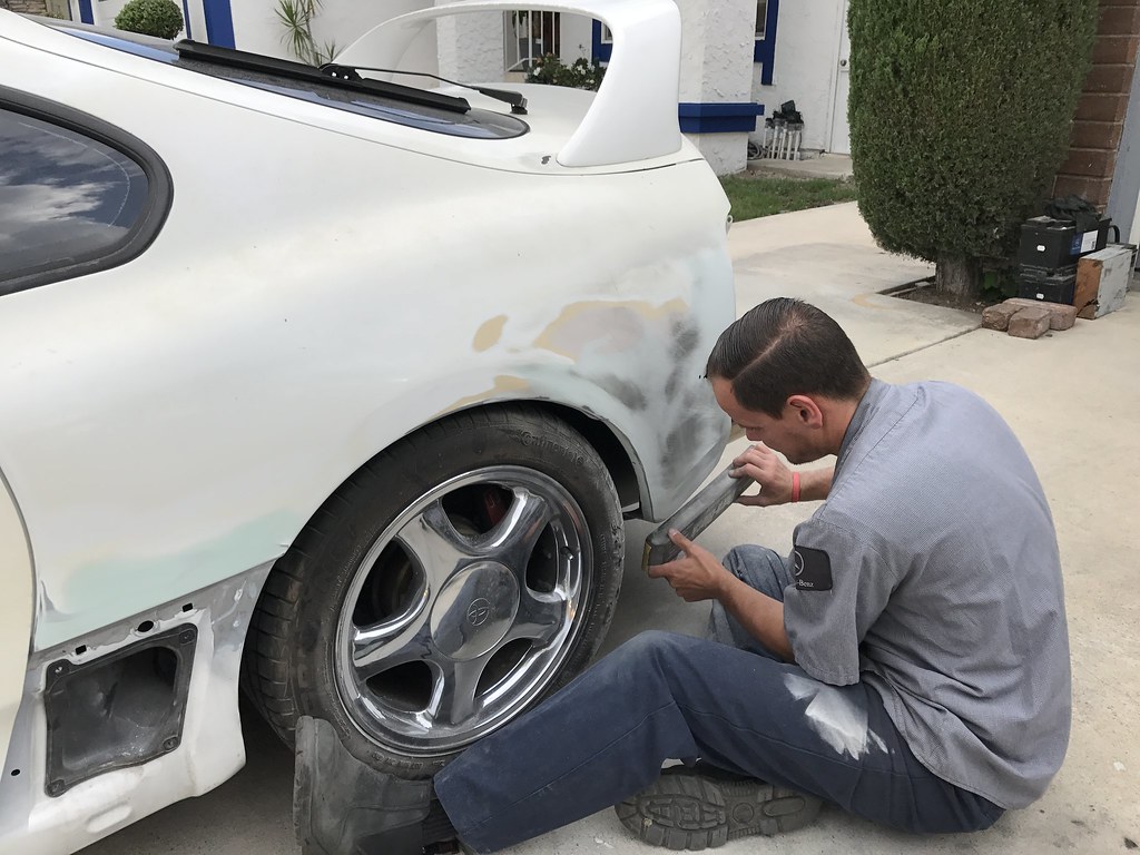

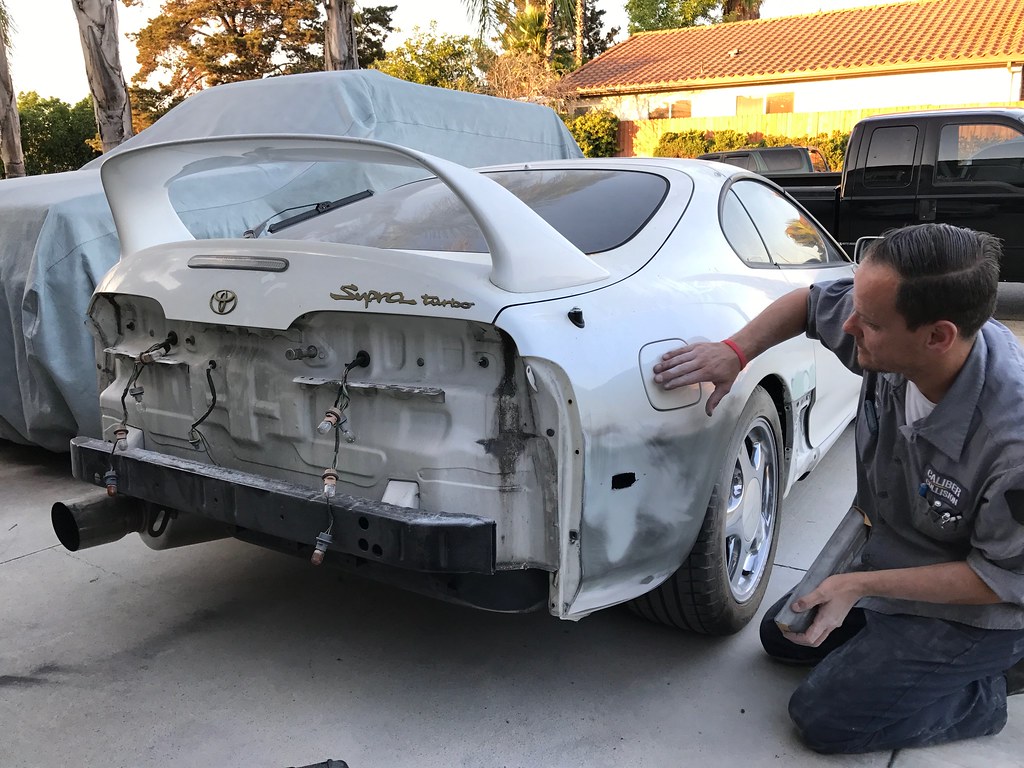

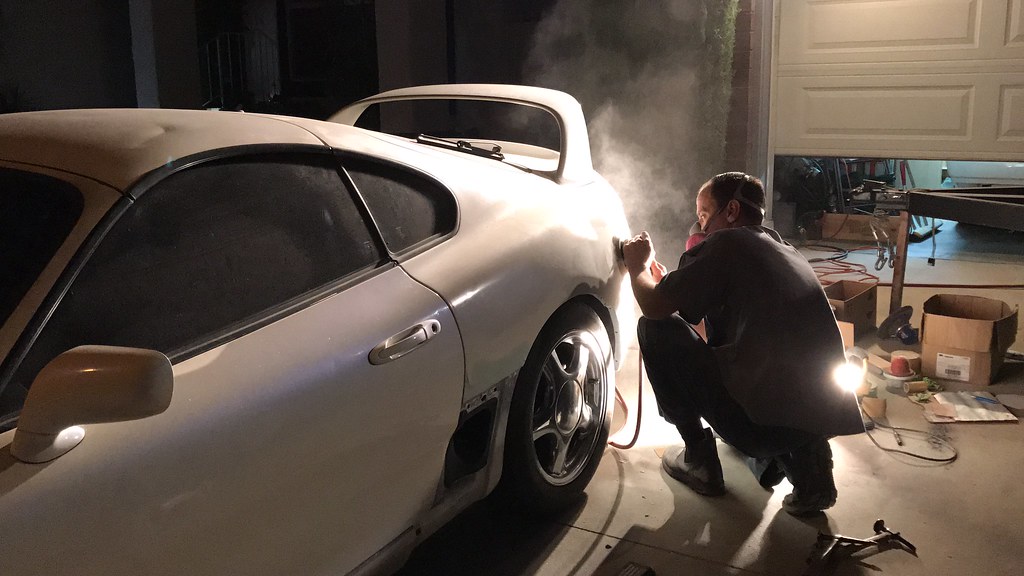

Continuing with an orbital sander.

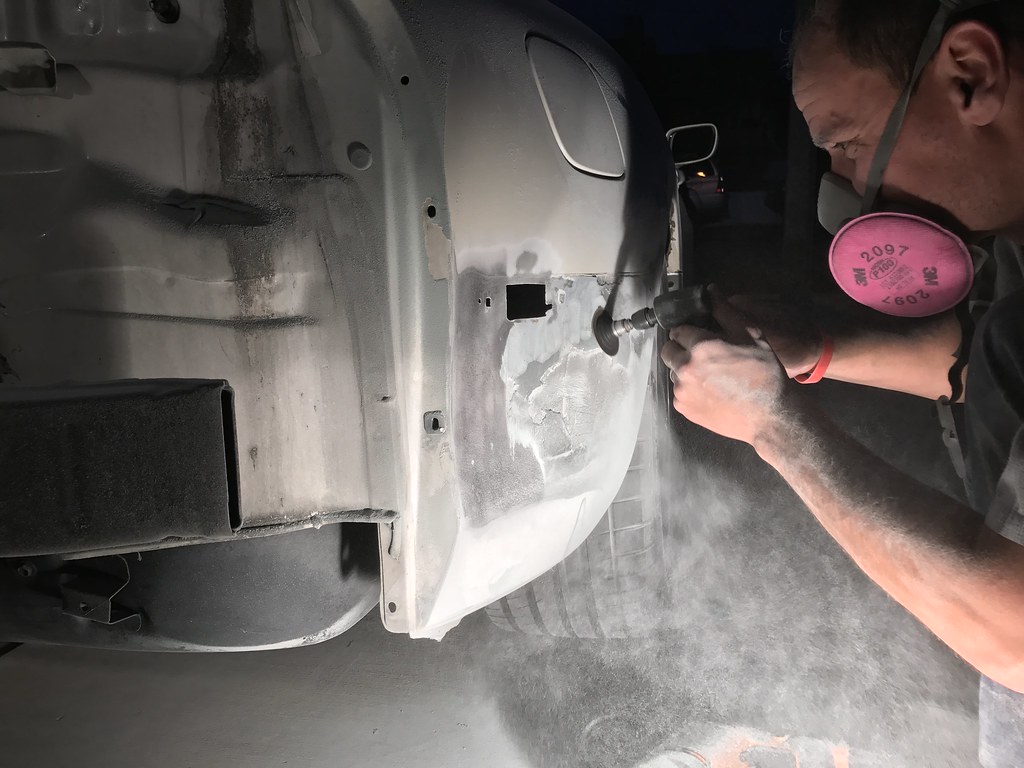

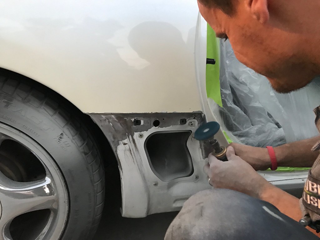

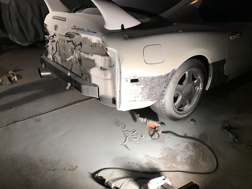

Getting in the wheelwell.

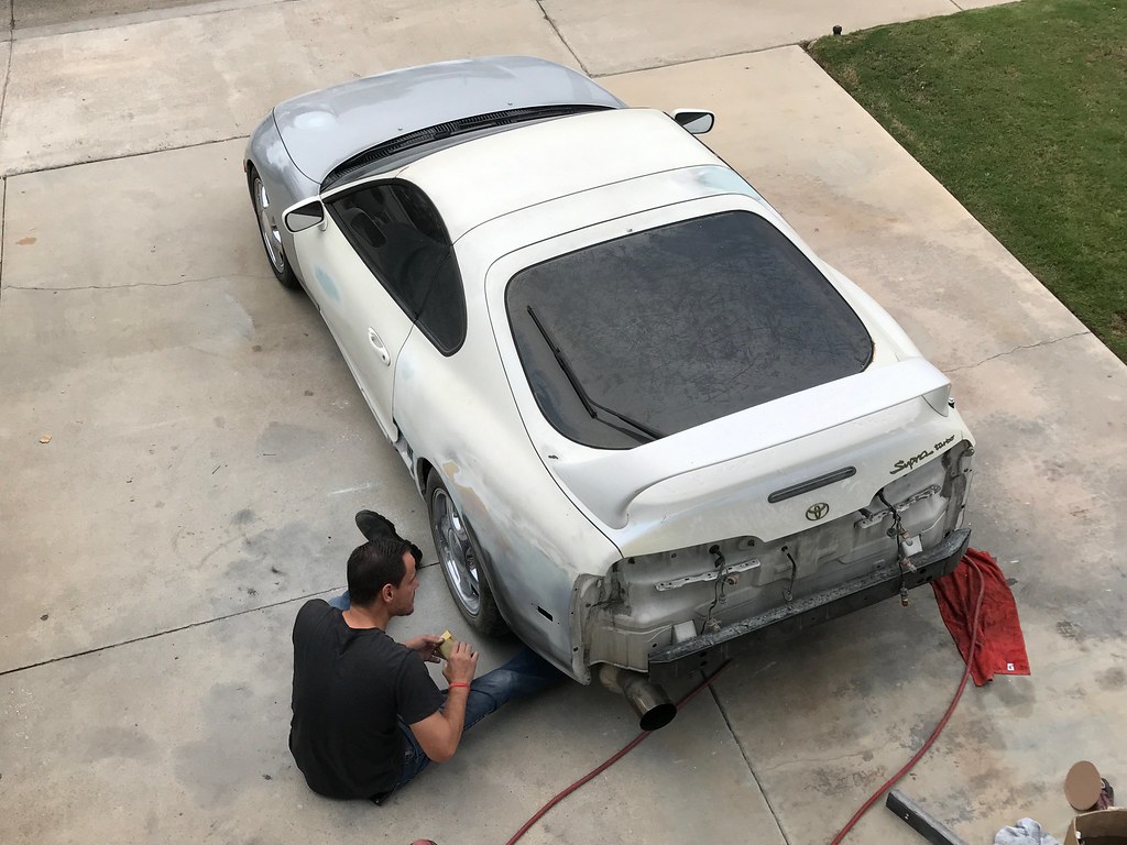

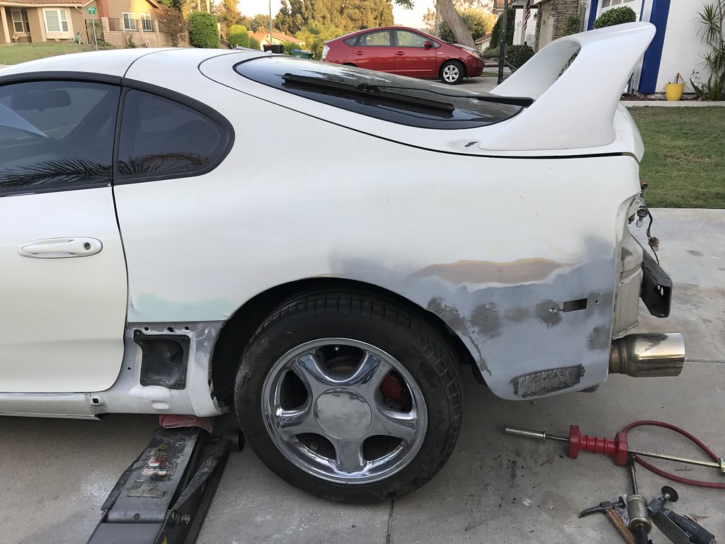

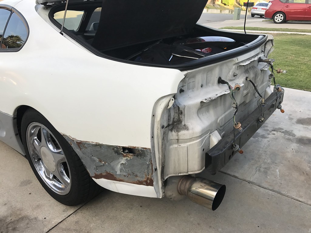

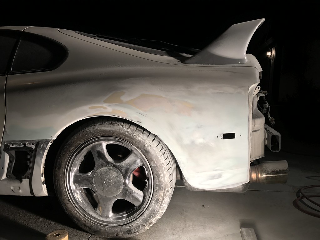

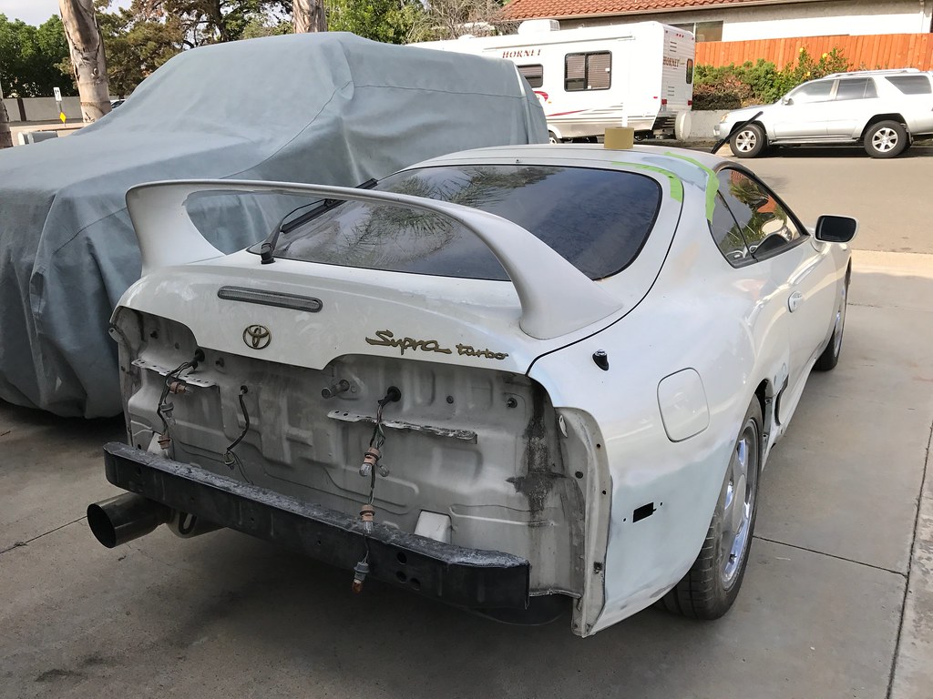

It was not long before we realized the filler was around the entire wheelwell.

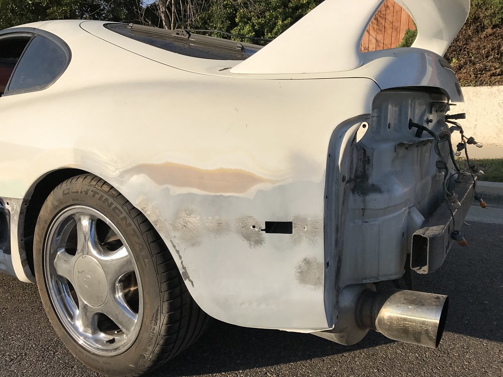

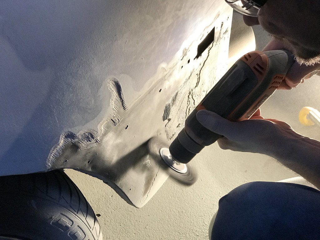

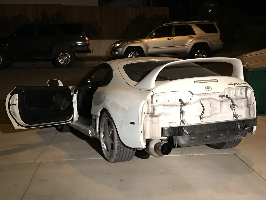

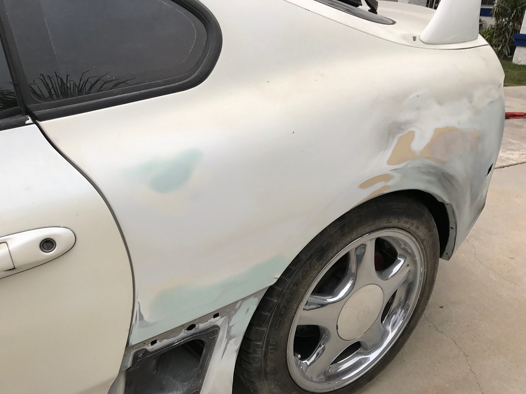

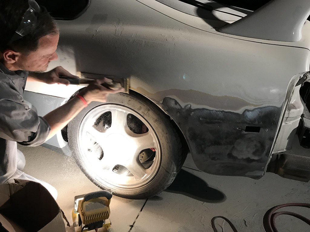

The next morning and I had something like this… layers of filler showing.

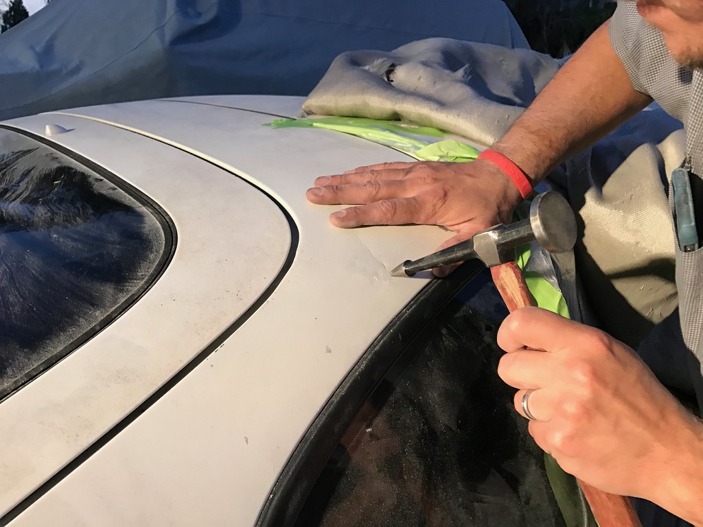

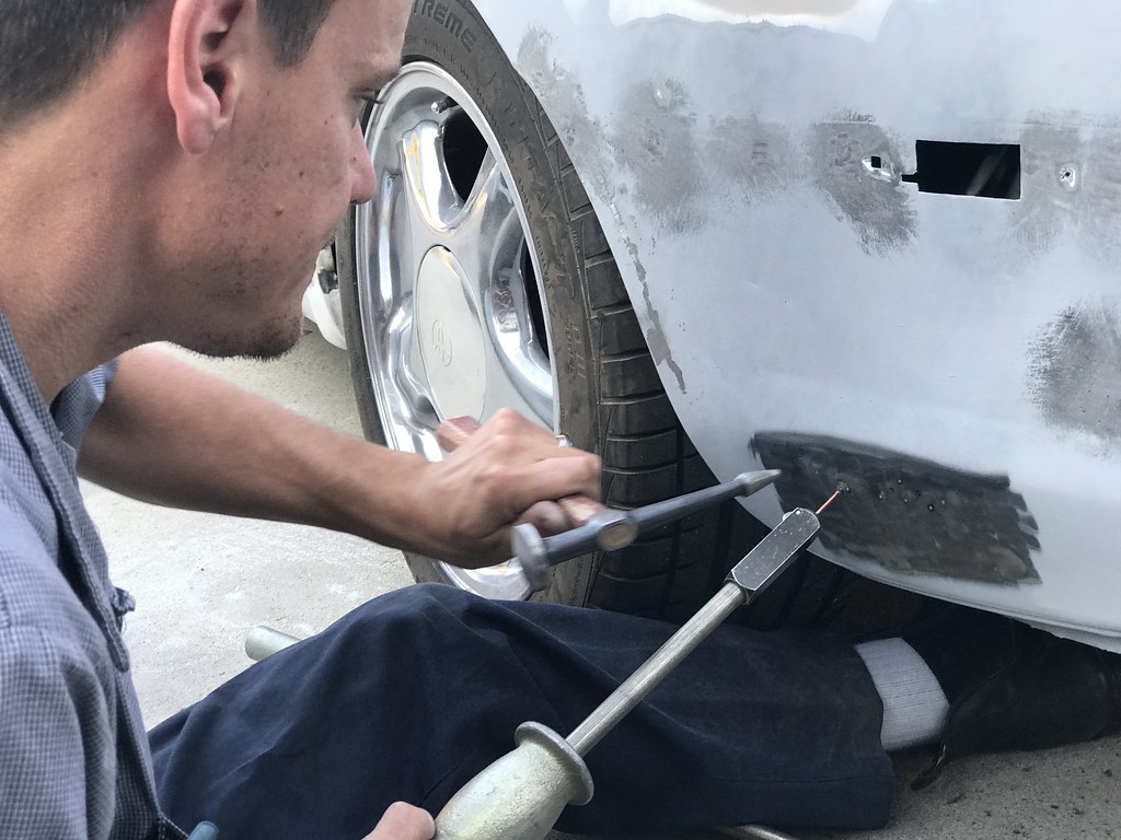

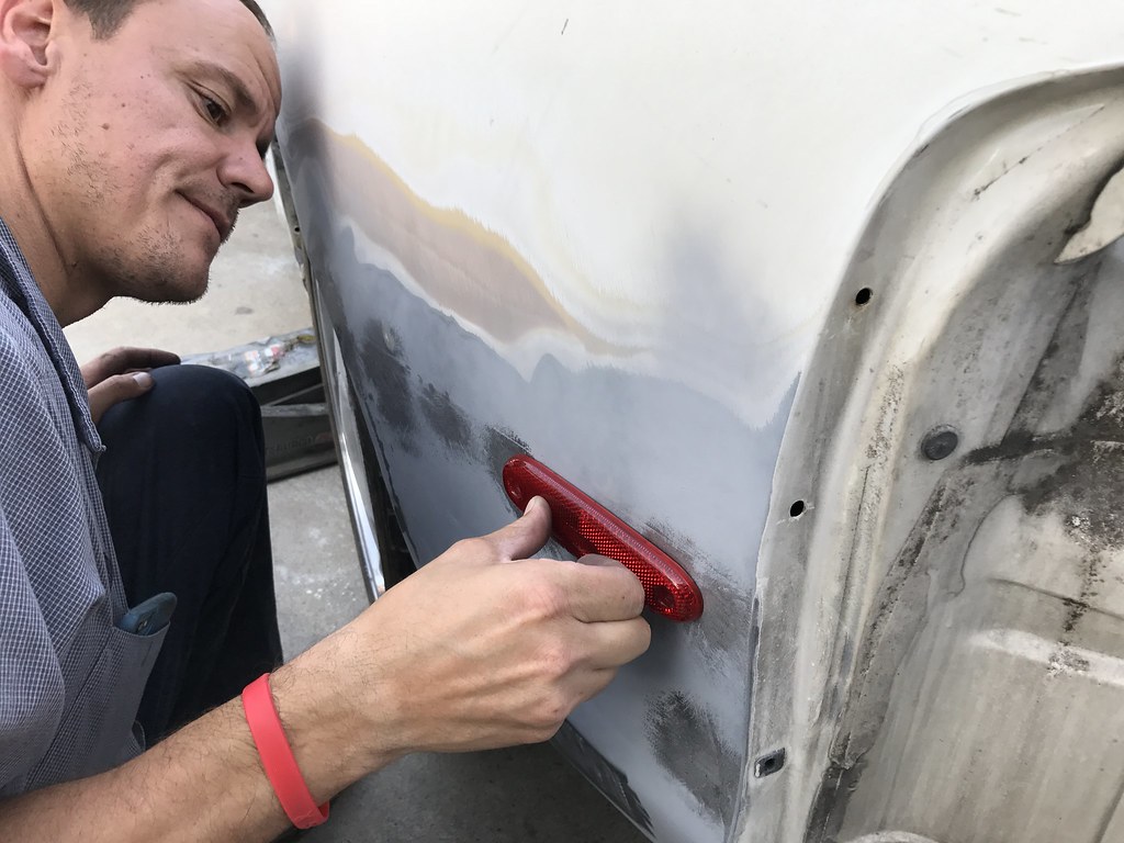

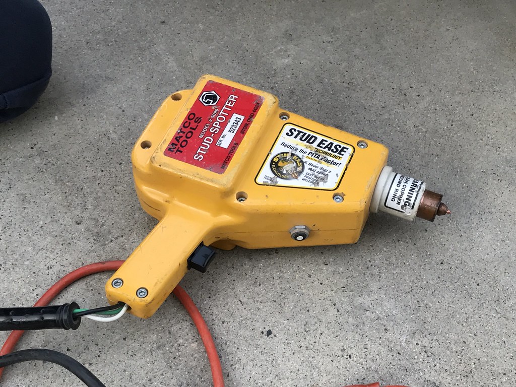

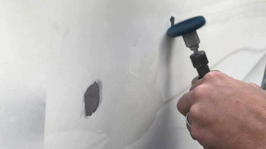

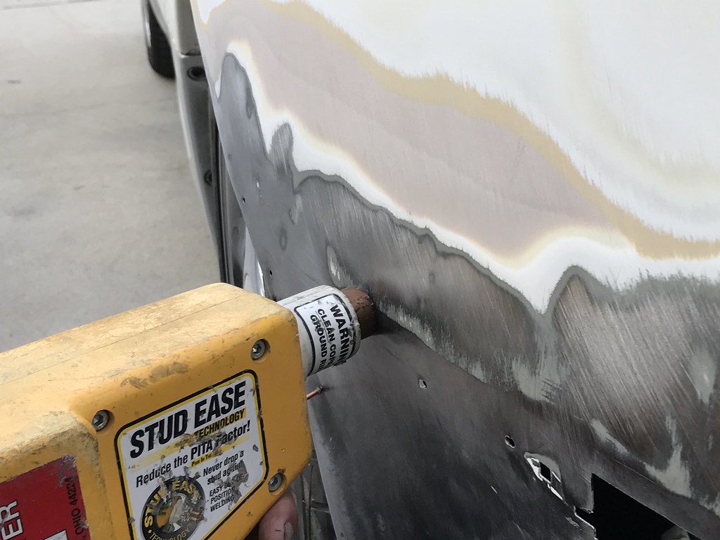

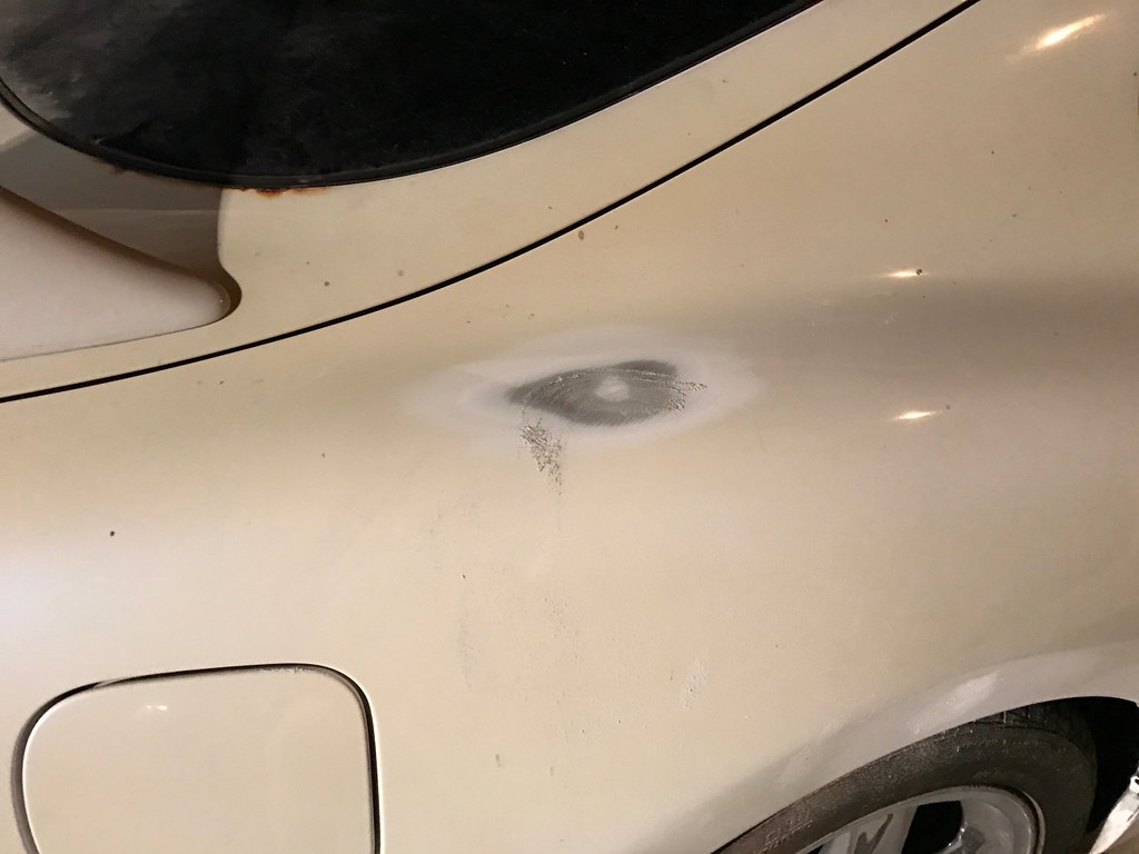

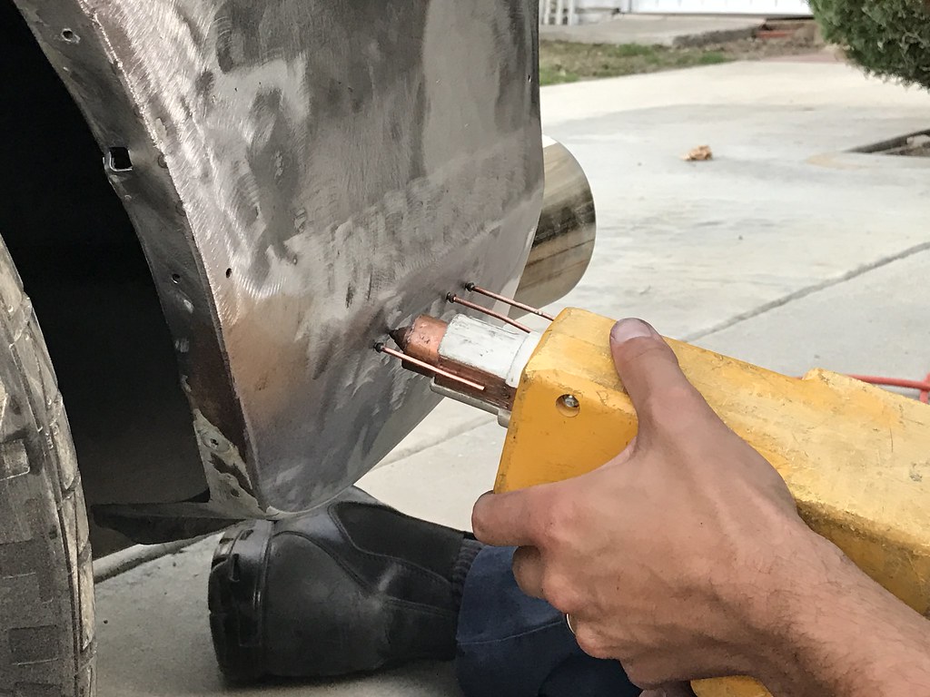

Pulling the dents from the panel. This thing was all sorts of dented.

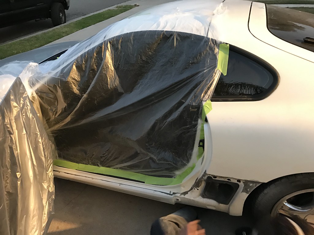

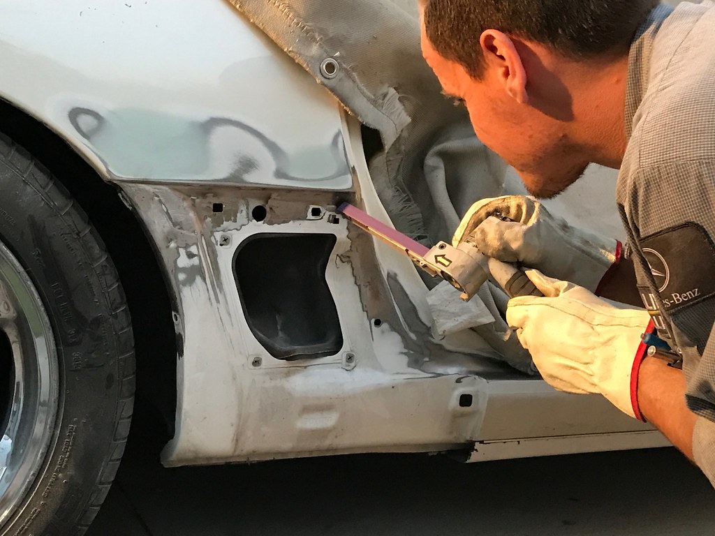

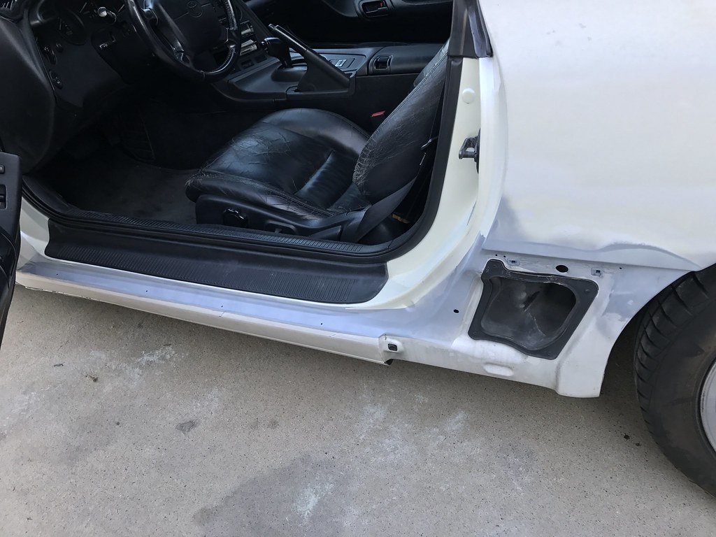

Side brake duct where the sideskirt once was.

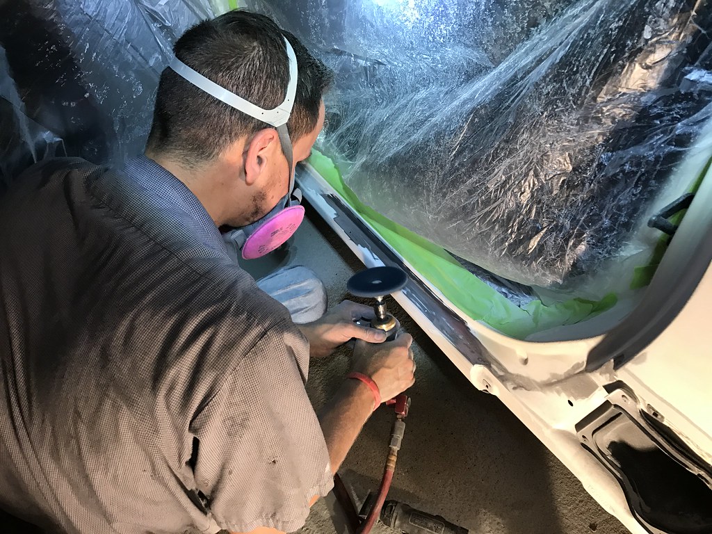

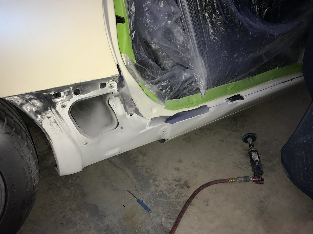

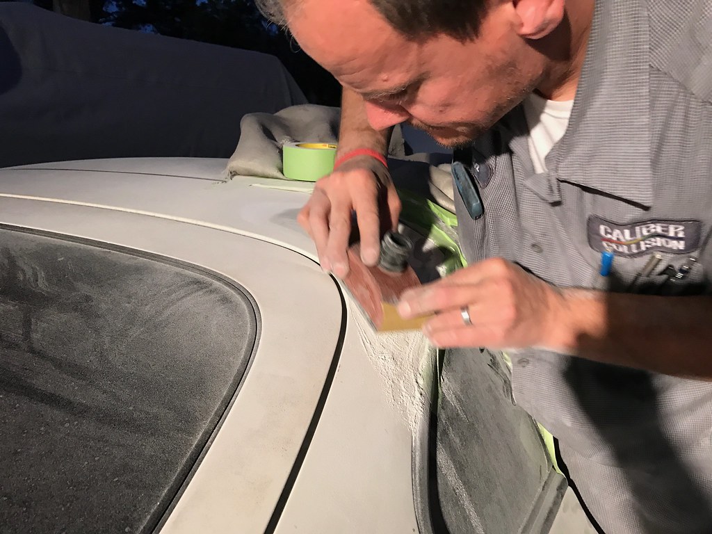

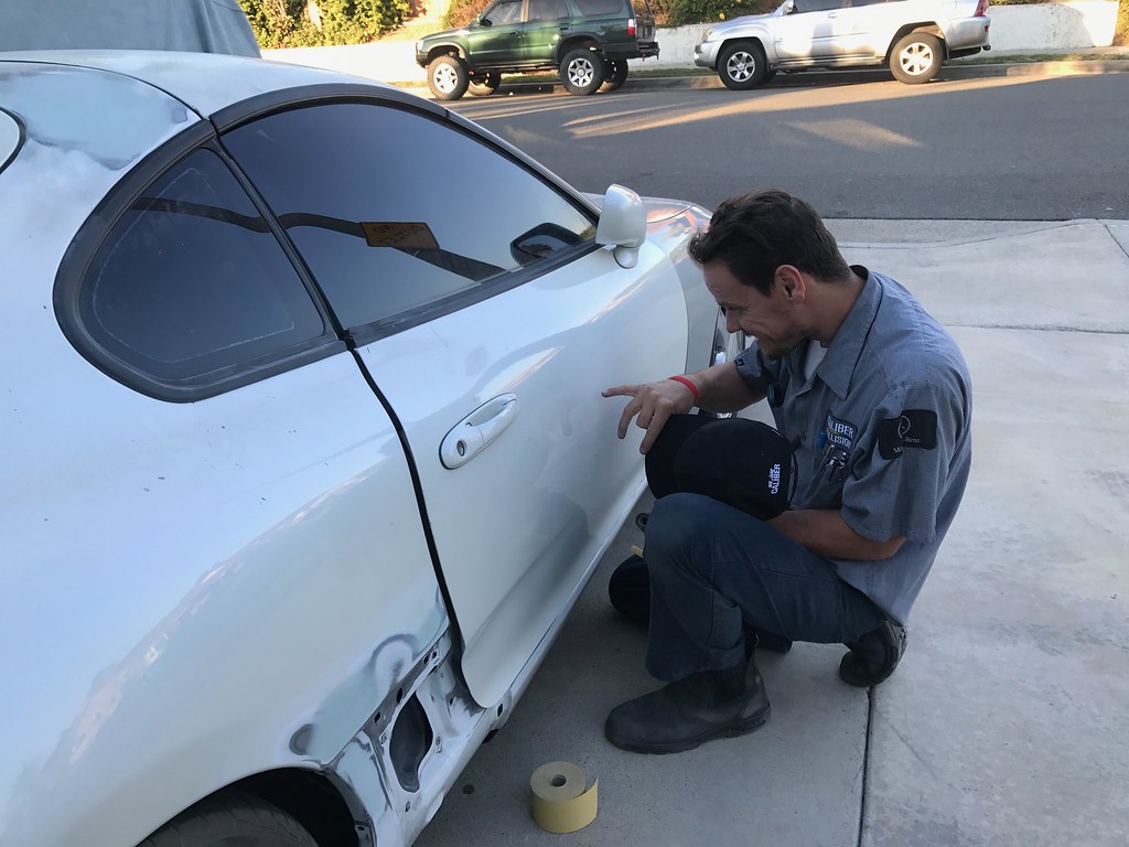

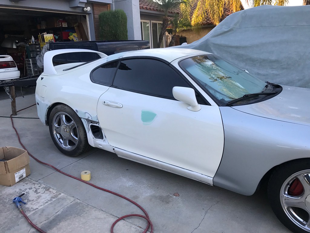

Test fitting and removing further filler from the door jams.
Light coat of SEM self etching primer to protect from moisture.

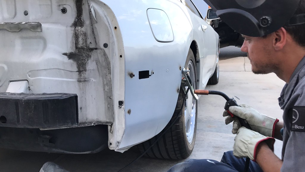

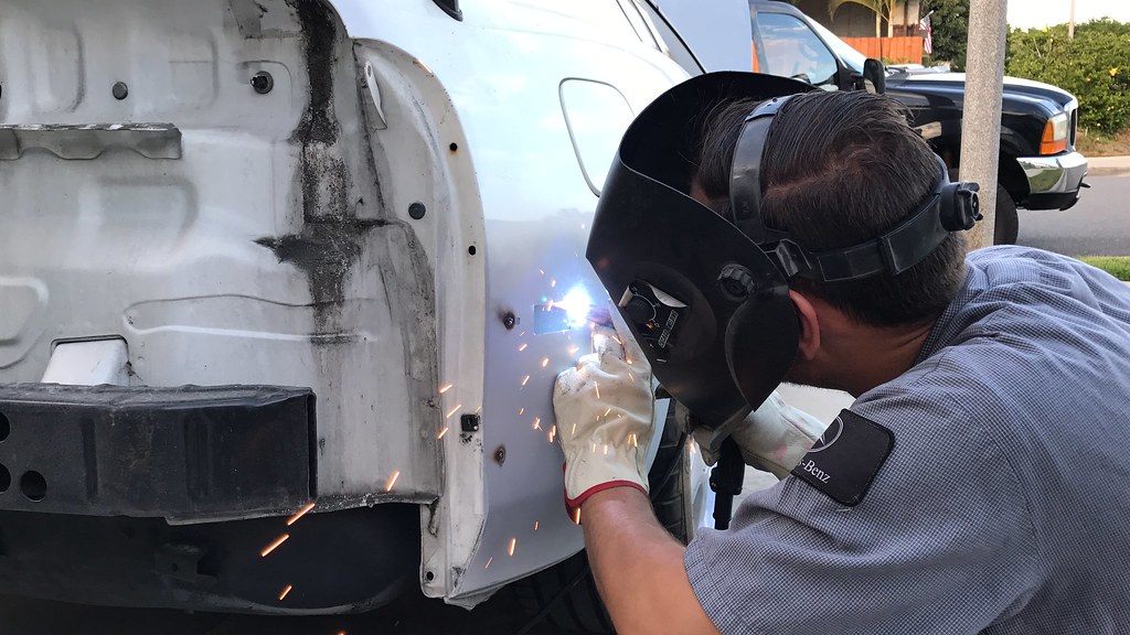

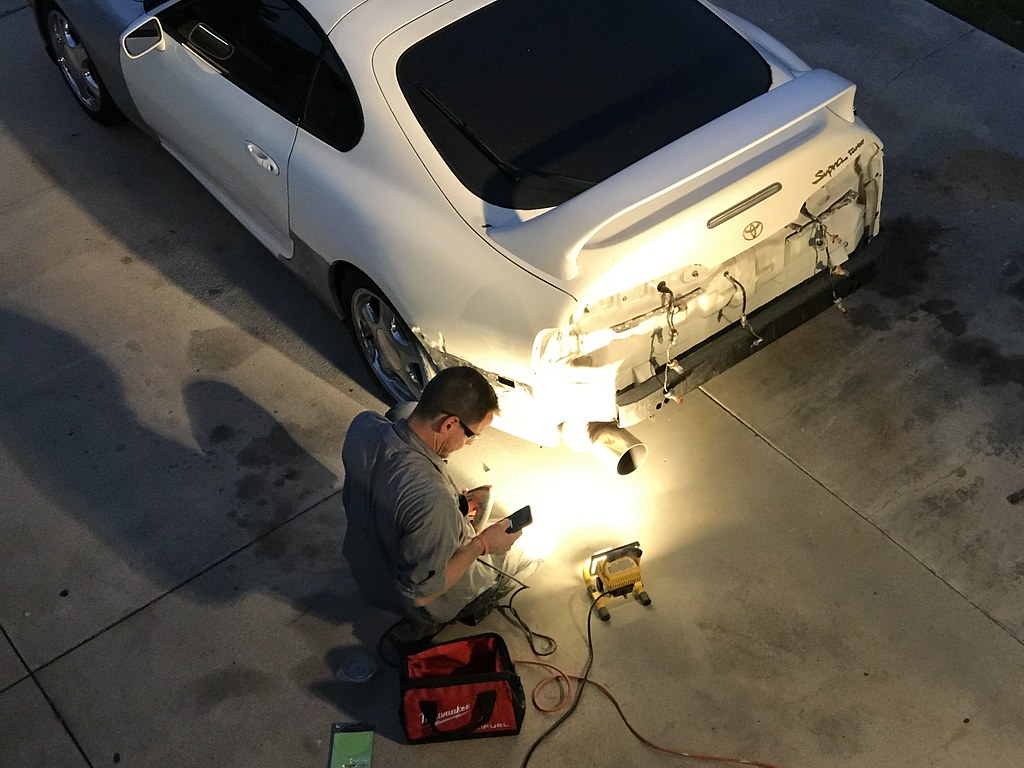

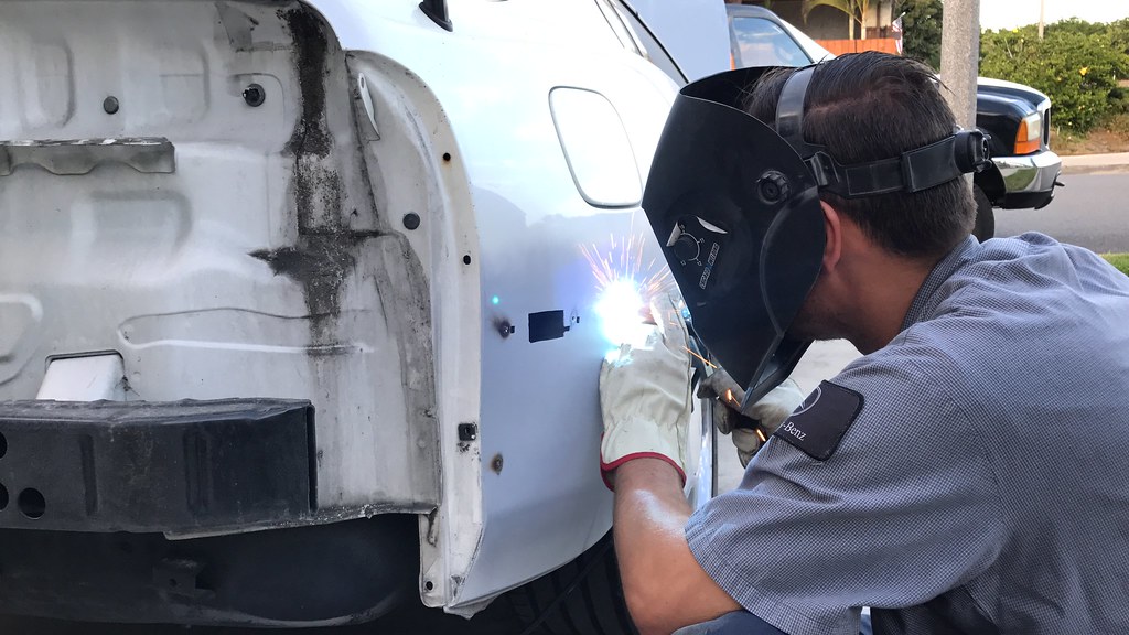

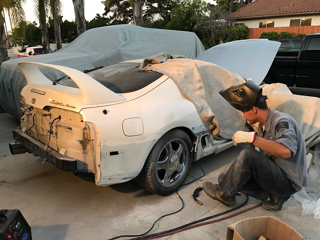

Next day, welding day. Here comes Justin with the bottle.
Power surge protector:

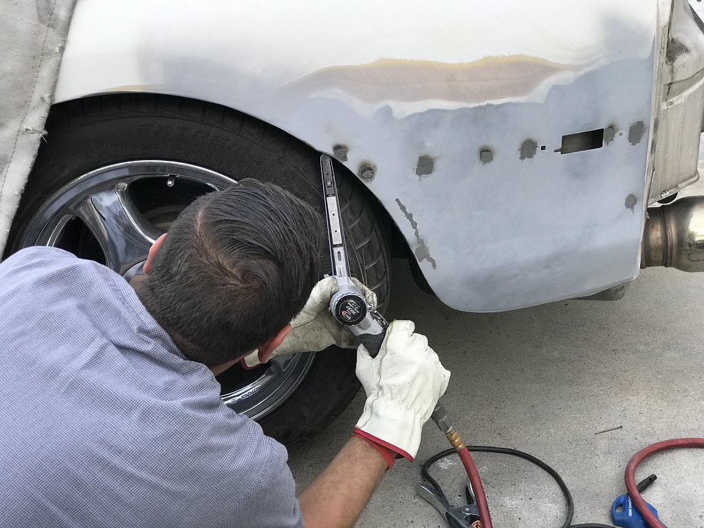

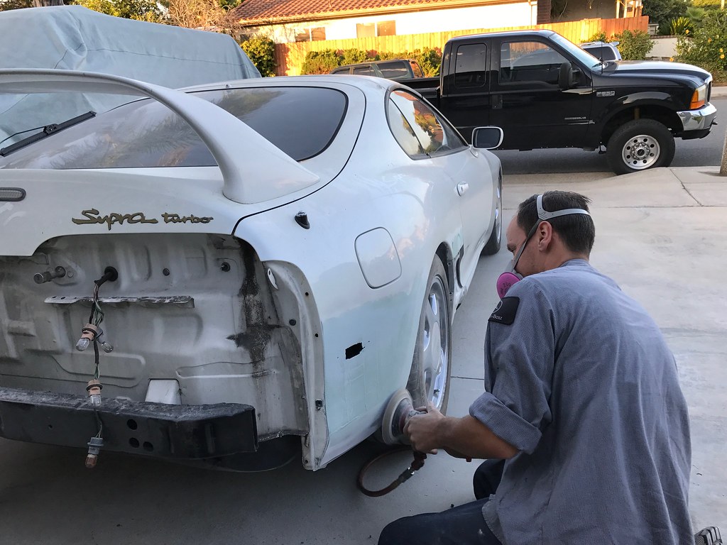

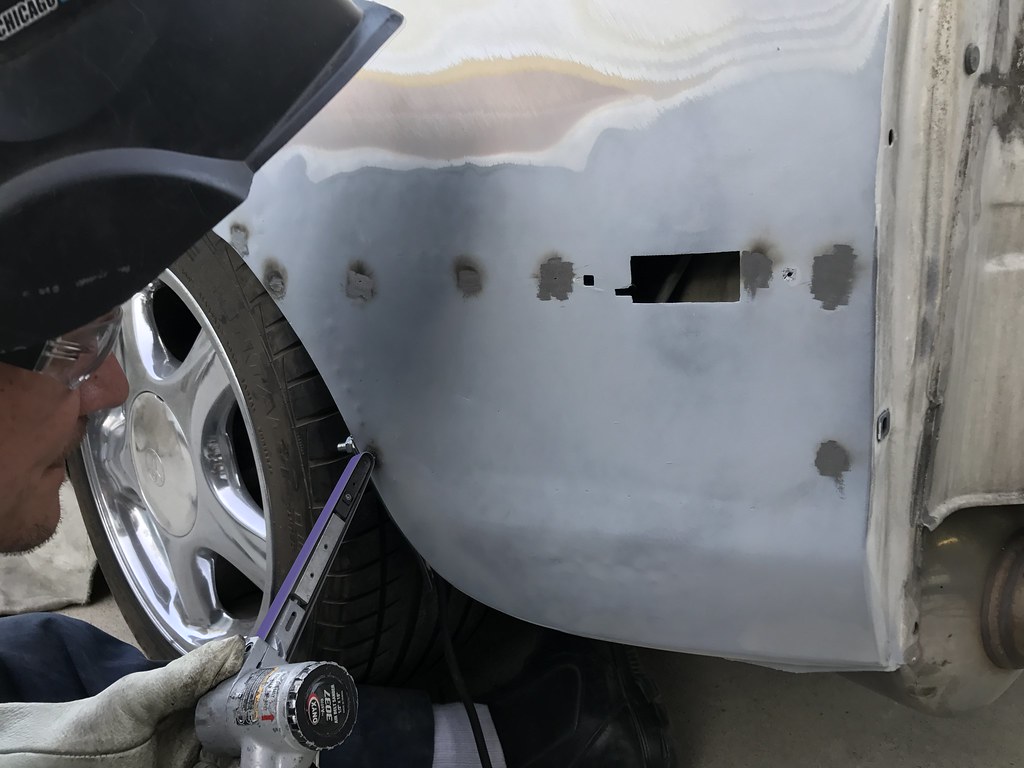

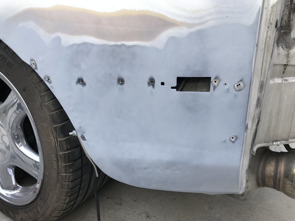

Welding holes shut. Rivets, be damned.

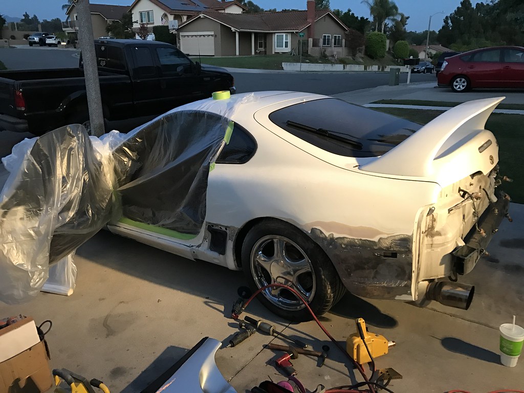

Quarter next:

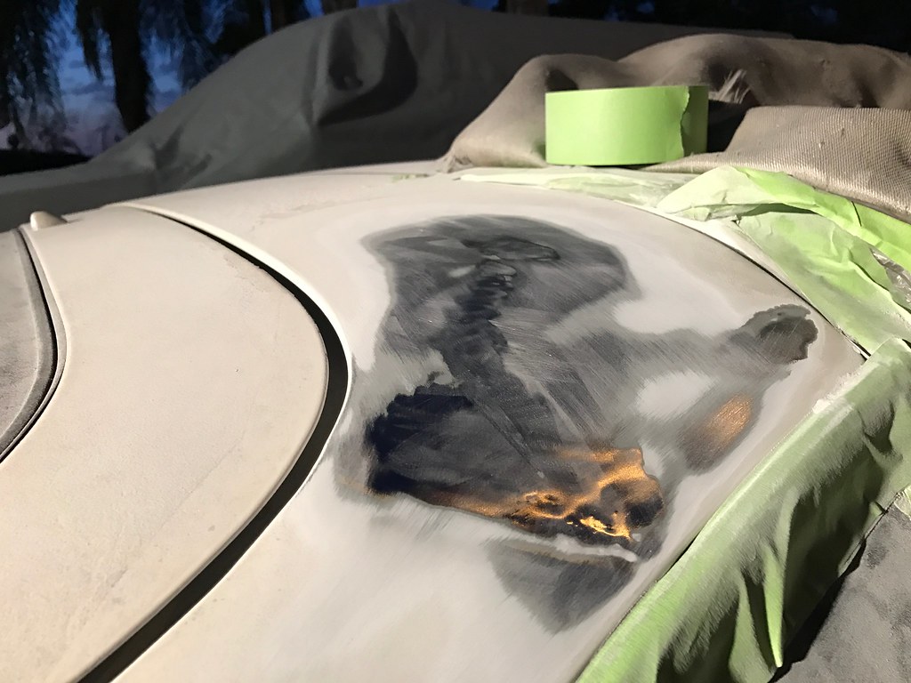

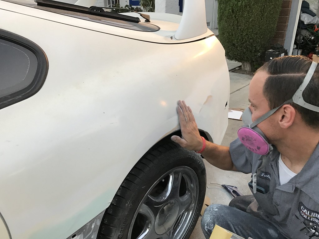

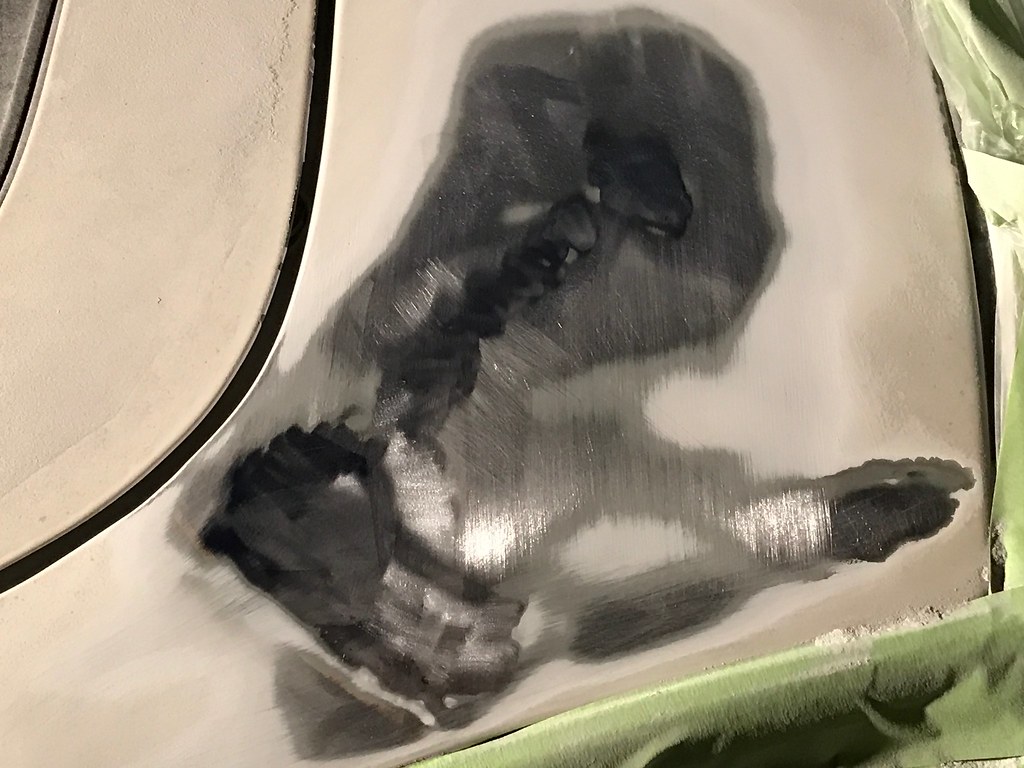

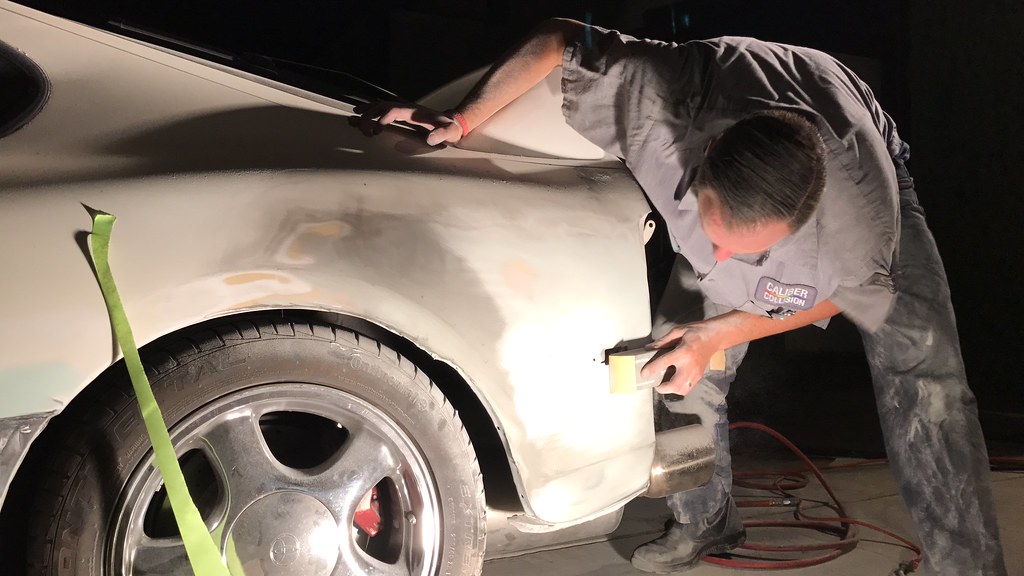

Back at it again. This quarter has already been through quite a bit and is already completely unrecognizable. This time it’s getting close to finished, out comes the guide coat.
The other side went very smoothly and quickly.

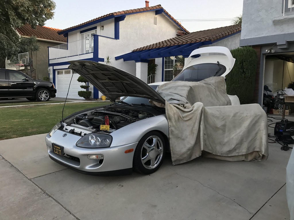

Lets take a moment to discuss some drivetrain updates:

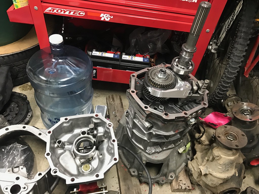

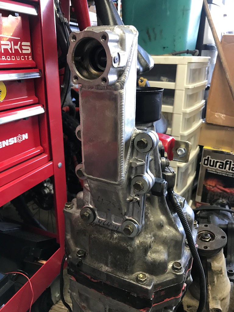

R154 shifter extension has been completed. This was a brand new shifter housing extended 4.75" to match the MKIV's shifter location.
Tail housing off.
Installed, tail housing resealed with Permatex Ultra Black RTV.

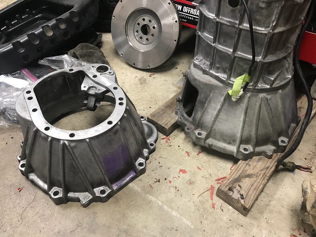

Then I was intending to swap out the 7M bell housing on the transmission to a 1JZ bell, as that's what is required to fit an R154 to the 2JZ. I start by comparing the new bell against the old, and was shocked to find they were the same. They both even had a purple paint splotch, which is indicative of a 1JZ bell. Mind you, the transmission was advertised as having a 7M bell.
I double checked my spare R154, which for sure has a 7M bell, and wouldn't you know, it was different. A 7M bell is worth maybe $50, and a 1JZ bell is worth $350. That sure put my mind at ease!

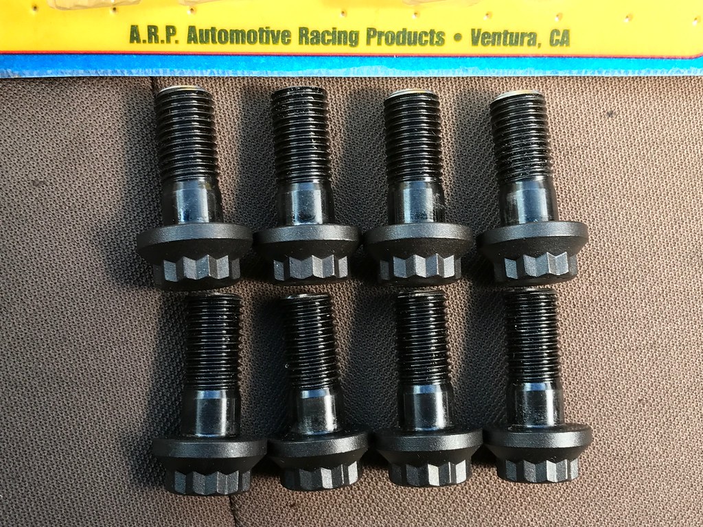

2.5mm trimmed off a full length set of ARP flywheel bolts.

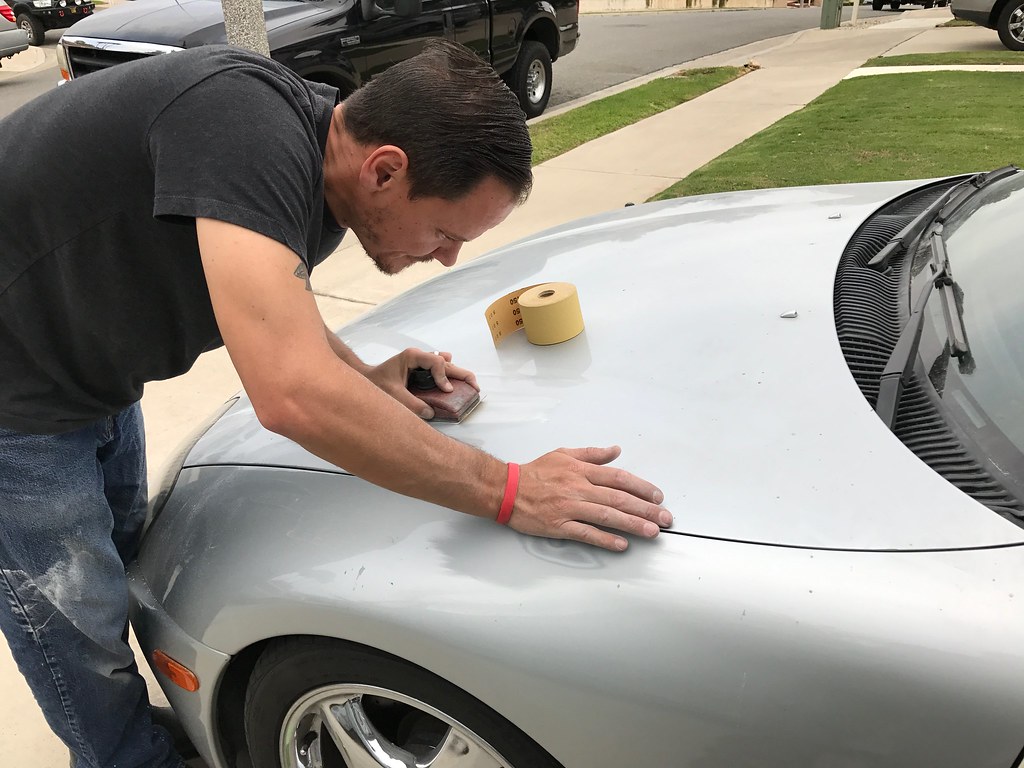

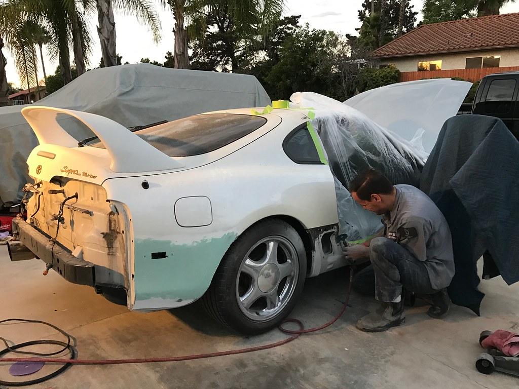

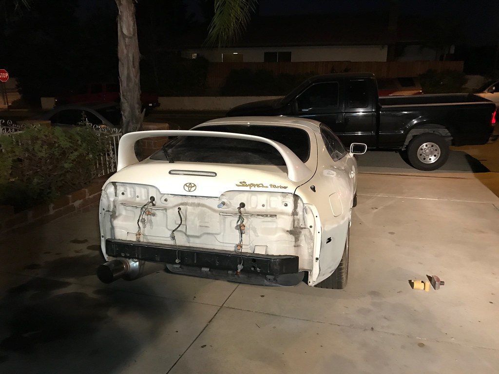

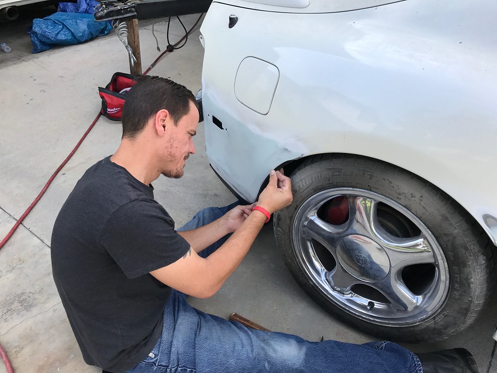

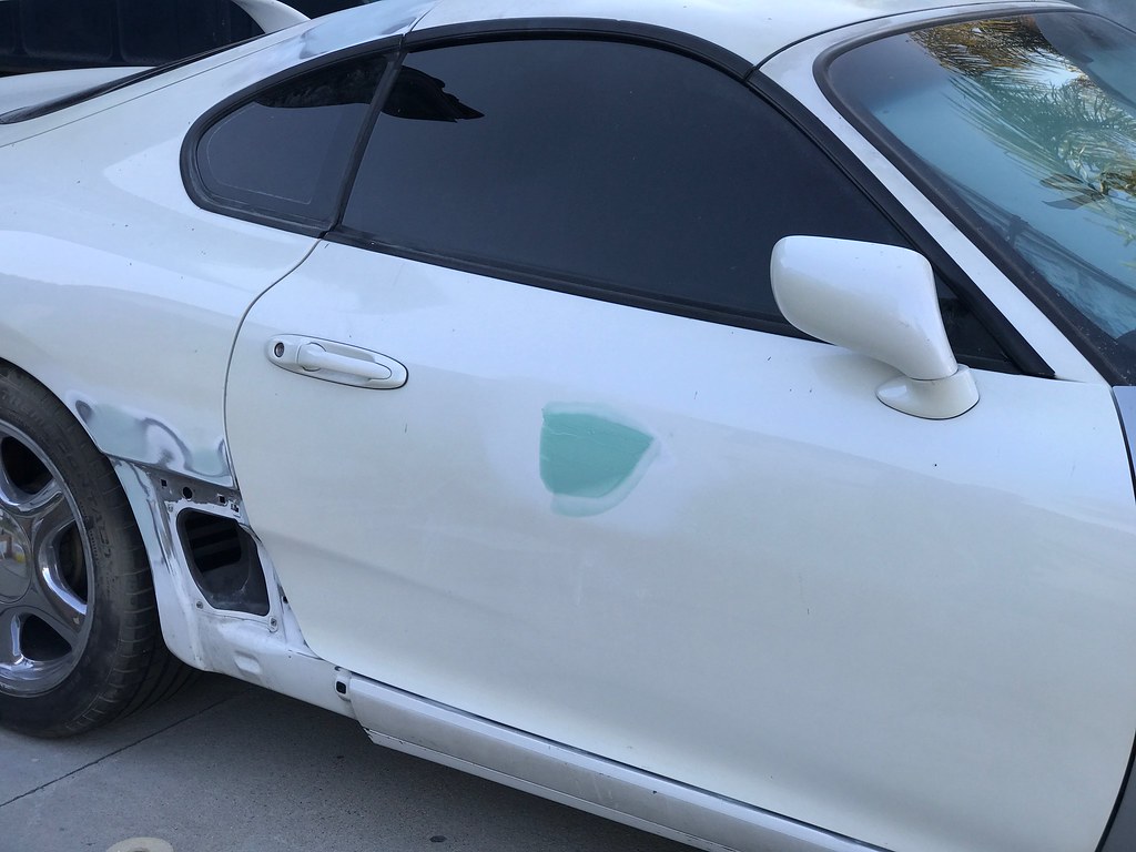

The right quarter, as mentioned before, needed minimal work compared to the left quarter. Neither are done, so here's more on those.

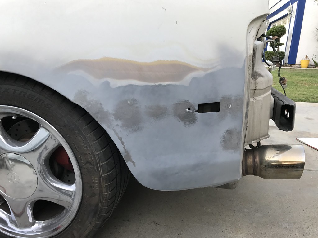

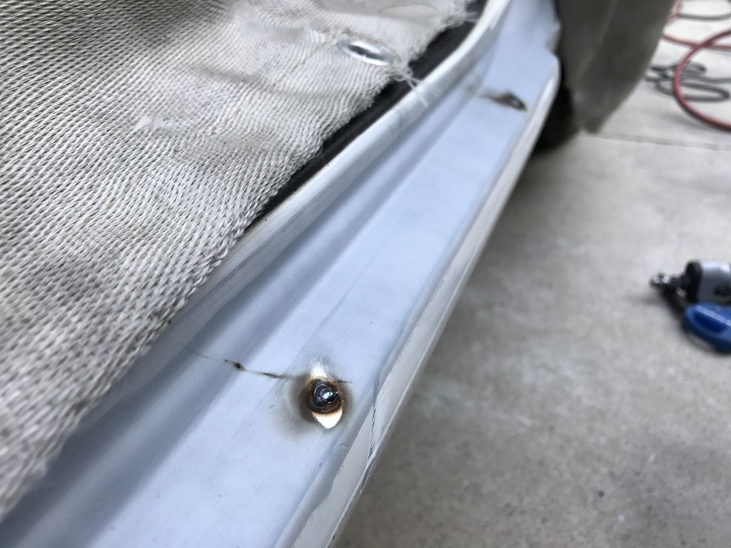

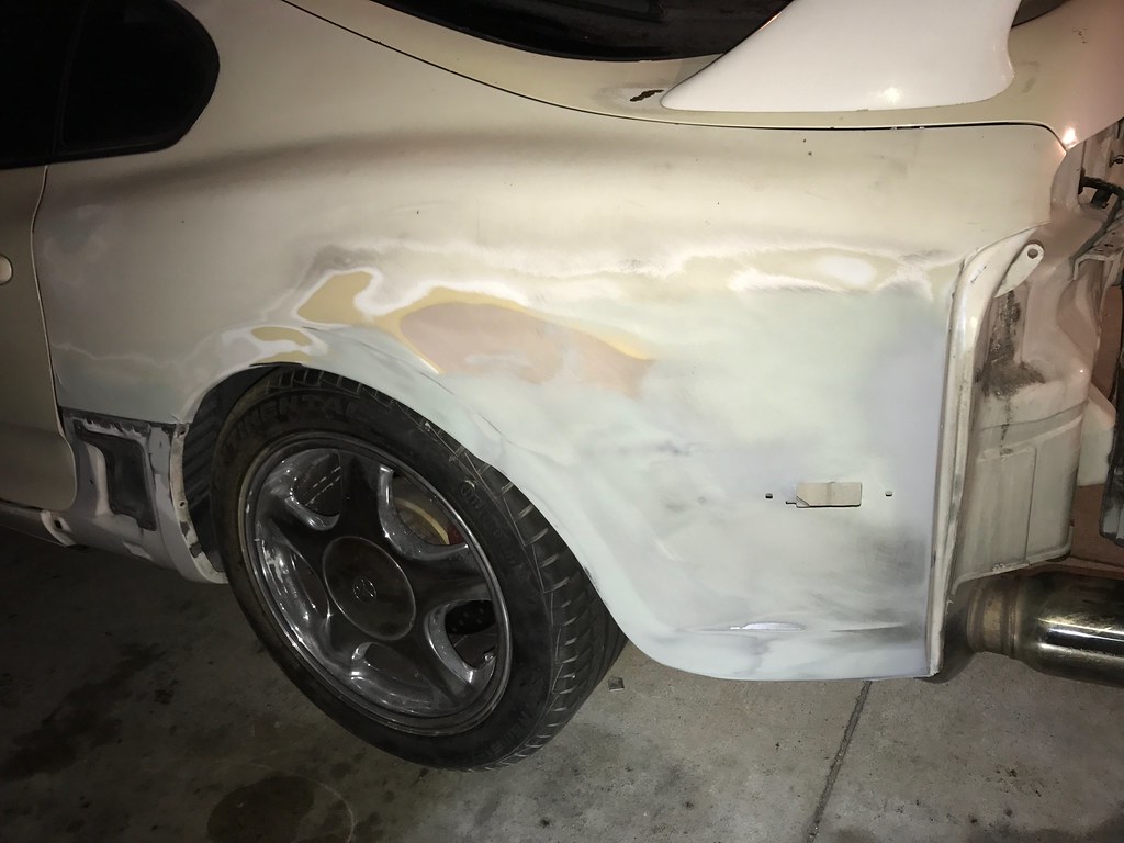

Starting this update with the right side, the rivet holes being welded.

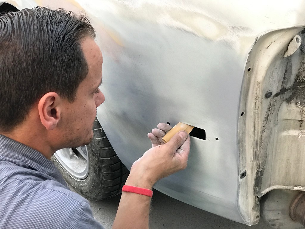

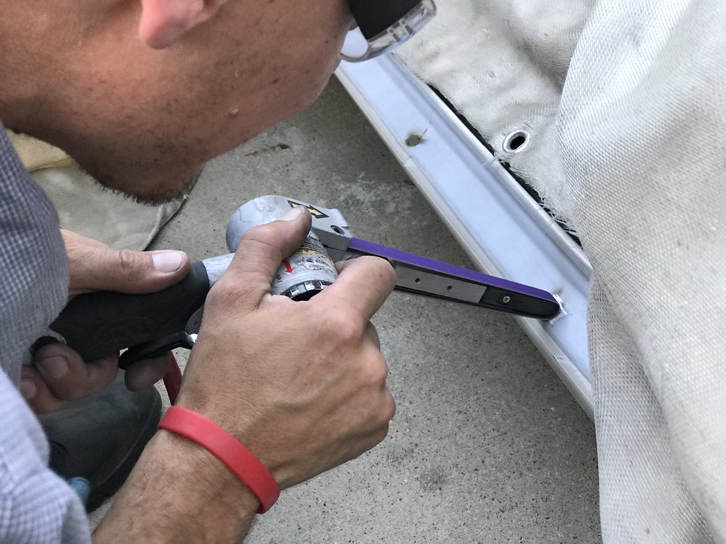

Welded up, ground down, and sanded.
This includes the wheel well holes, despite the fact that they'll be covered up.

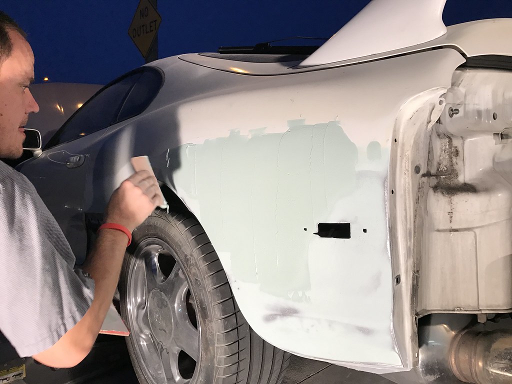

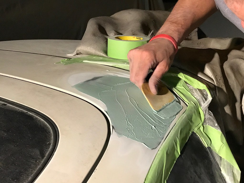

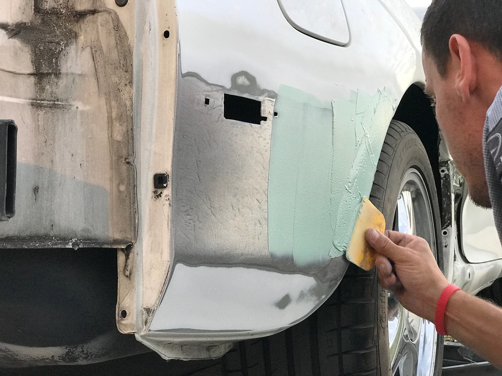

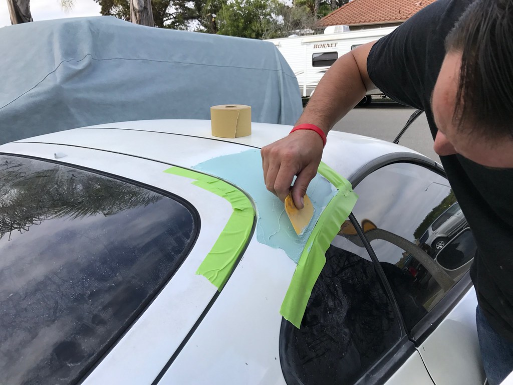

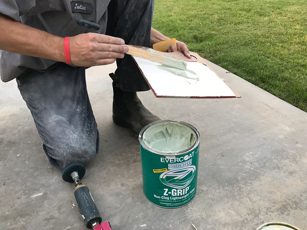

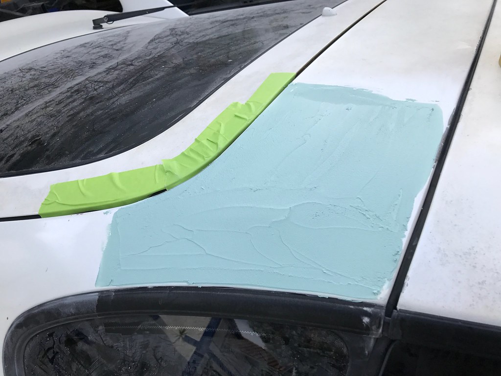

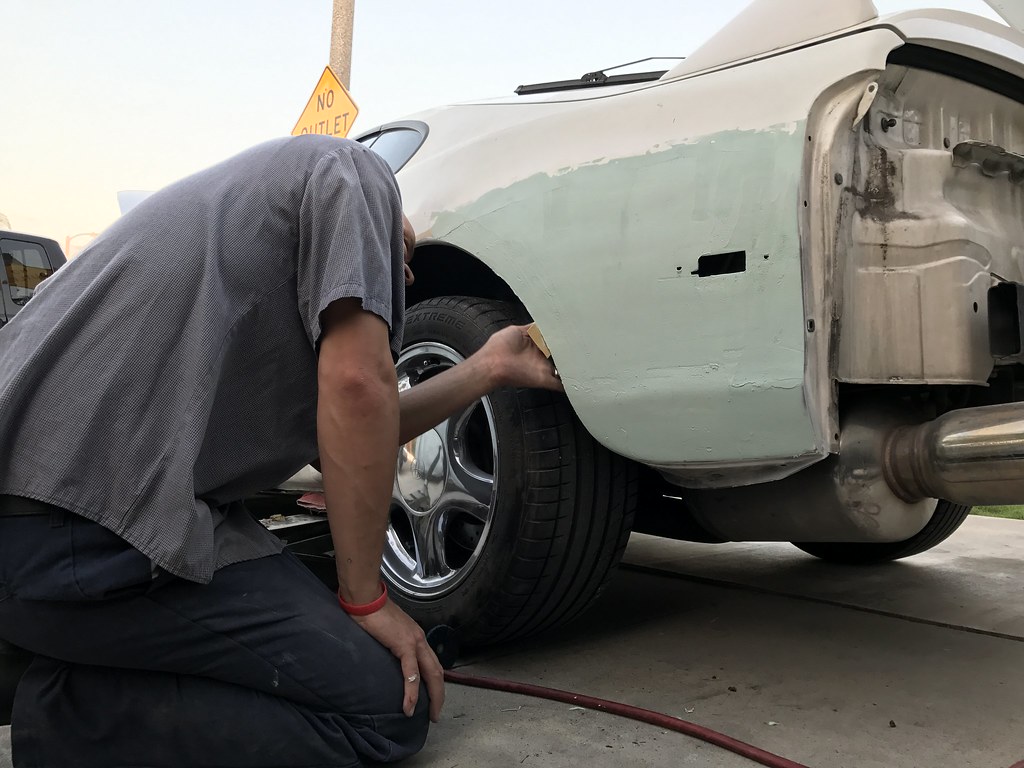

Body filler time.
And set to dry as we move to other aspects of the vehicle.

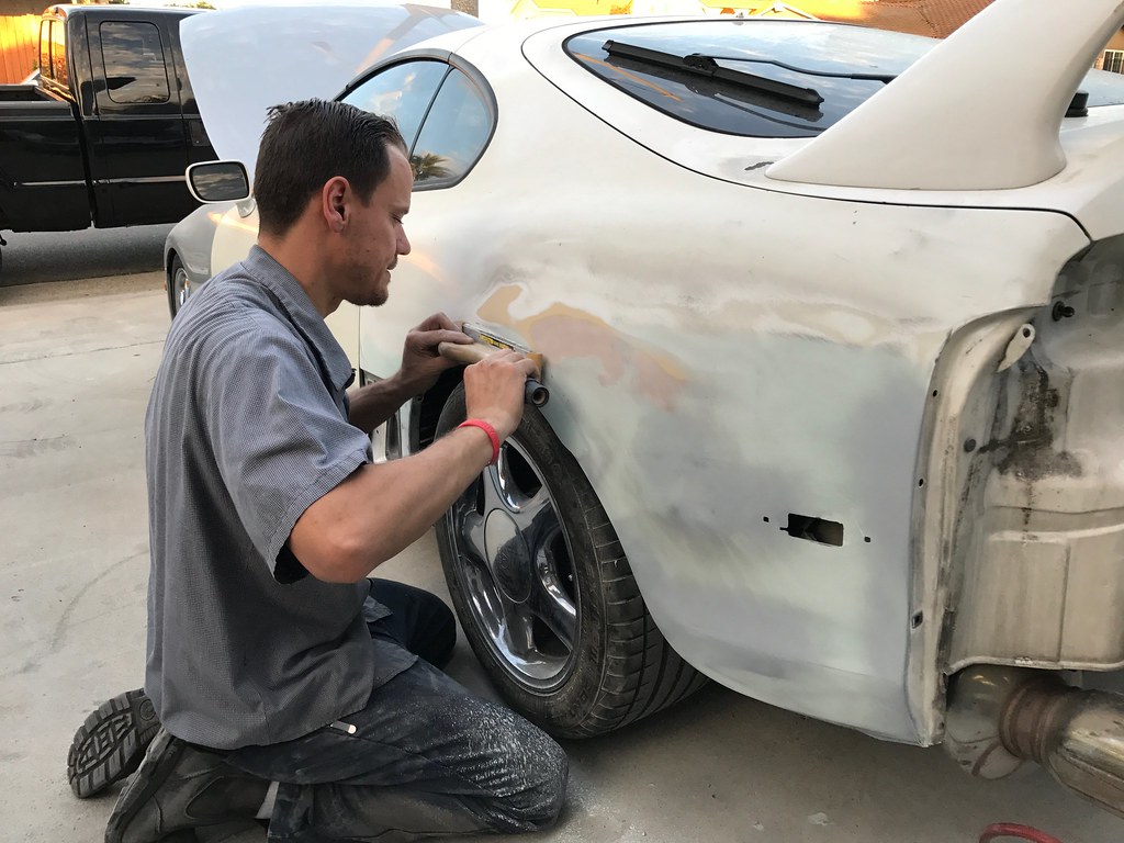

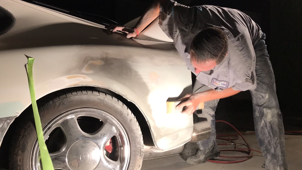

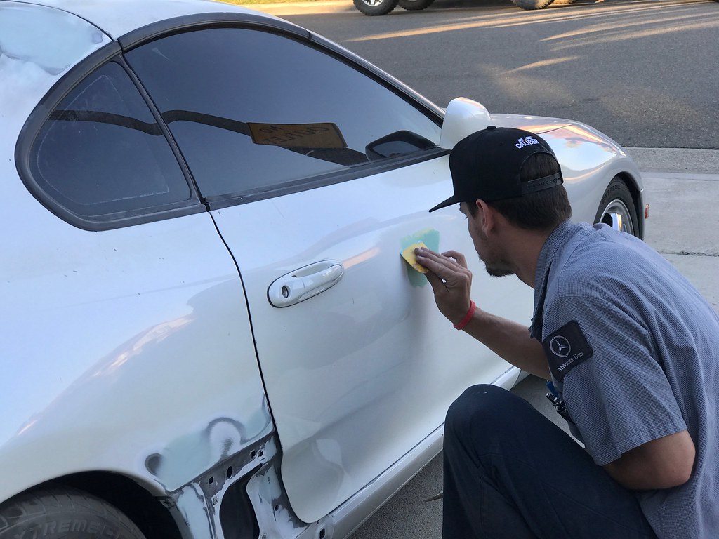

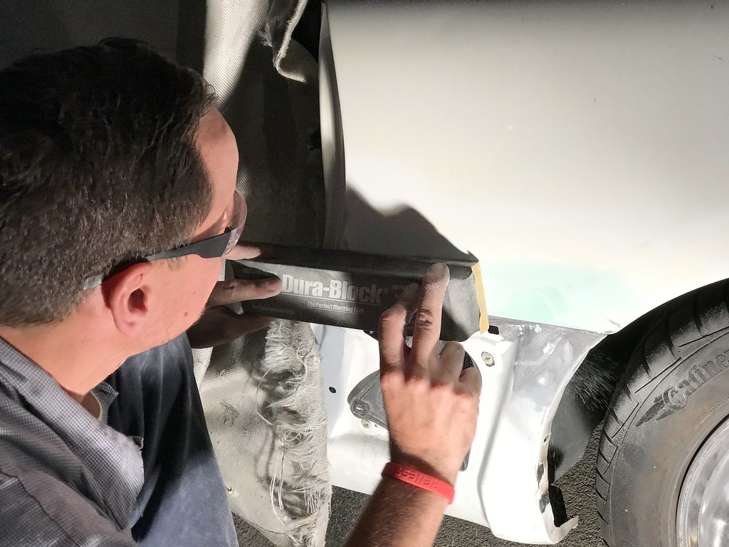

The passenger side being in such good shape was a great template to get the lines right on the driver side. Here's Justin sharpening up the lines just right.
Continuing onto the passenger side brake duct.

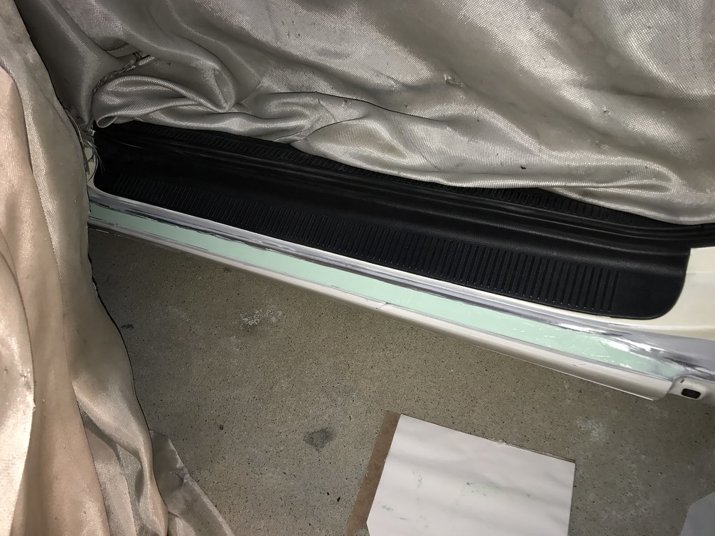

Passenger door jam being taken care of as well.

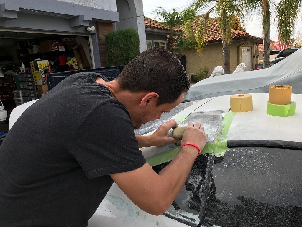

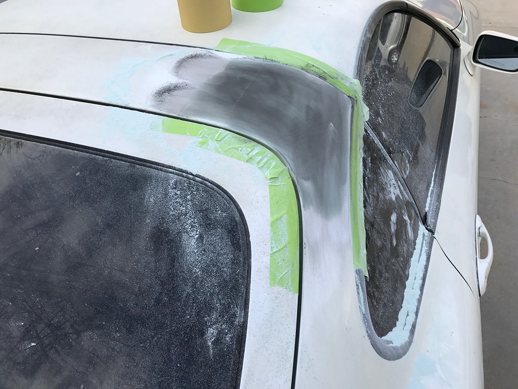

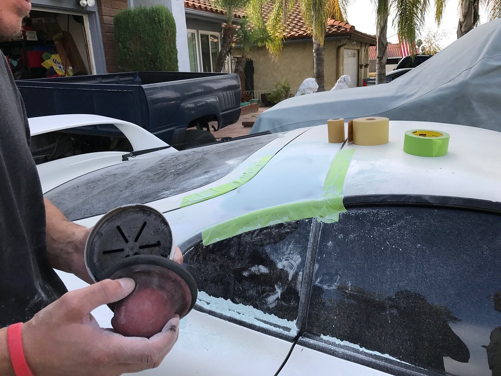

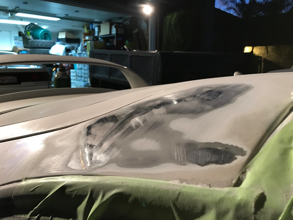

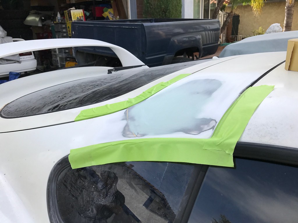

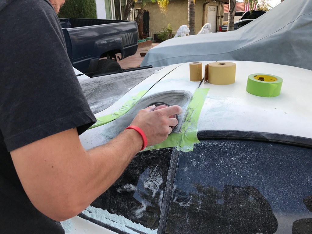

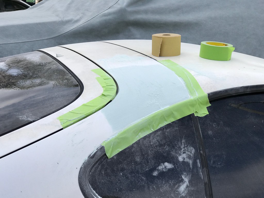

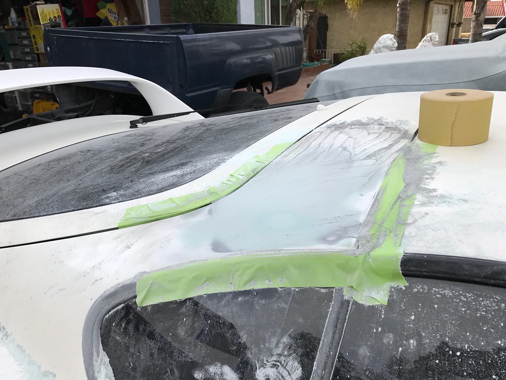

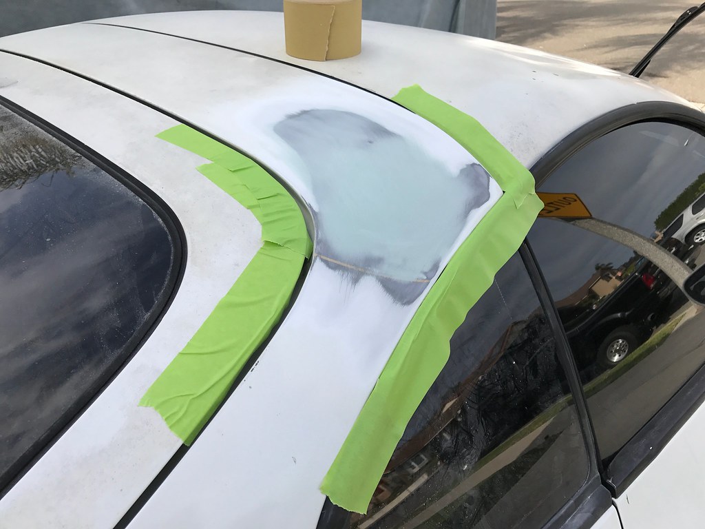

Continuing onto a very strange section of damage on the passenger side of the roof, chassis side. The targa has some dents also which will be addressed in the near future.

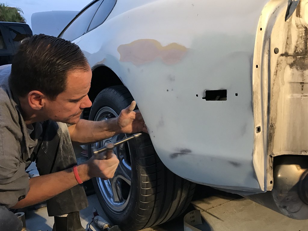

Taking down the high spots, pulling out the lows.

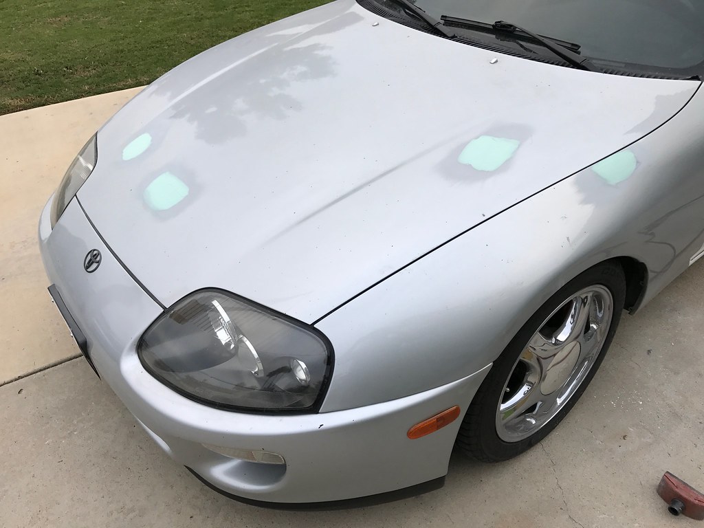

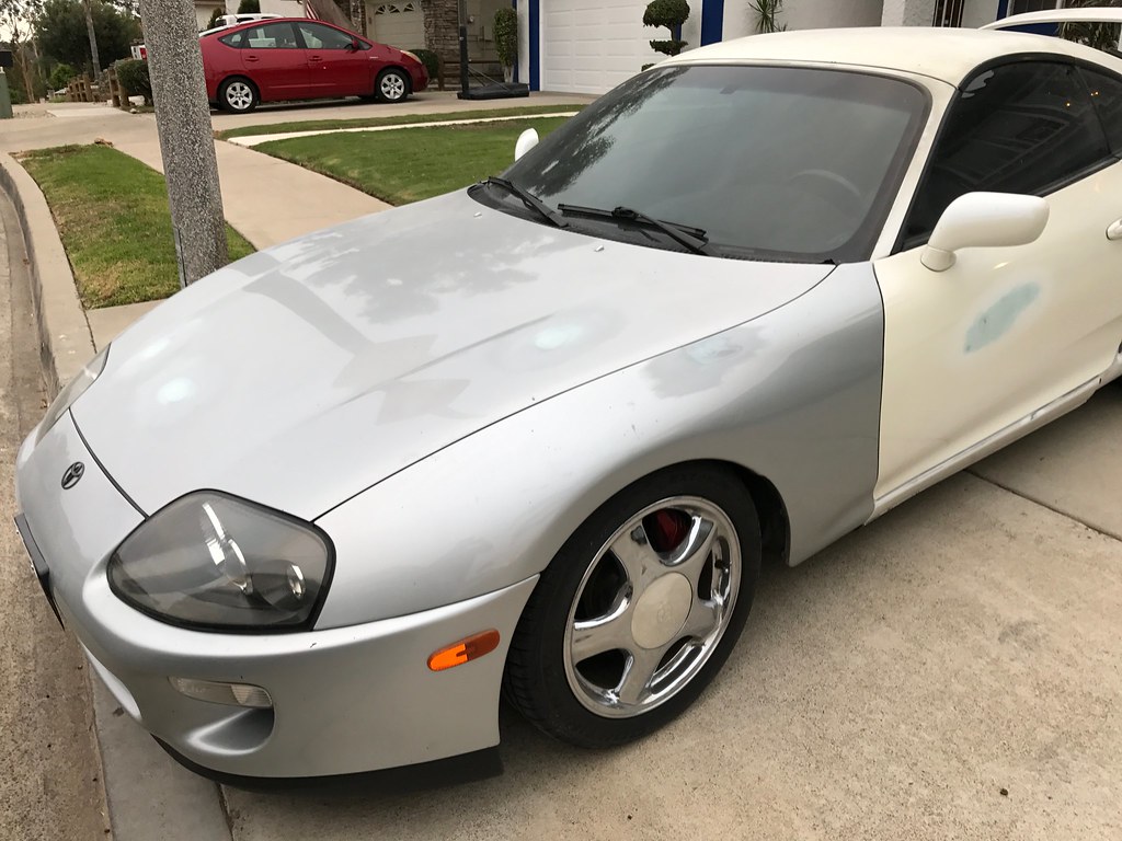

Moving onto the side of the car, we have some low spots that are pretty tough to see. This is after a light sanding.

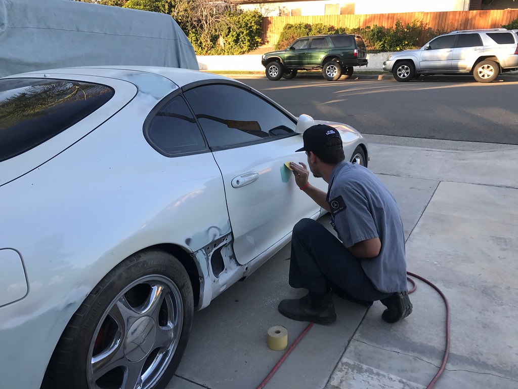

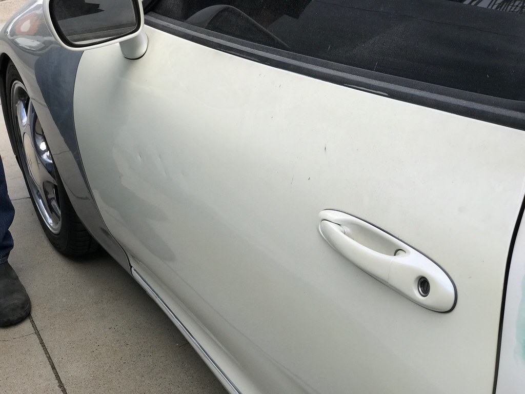

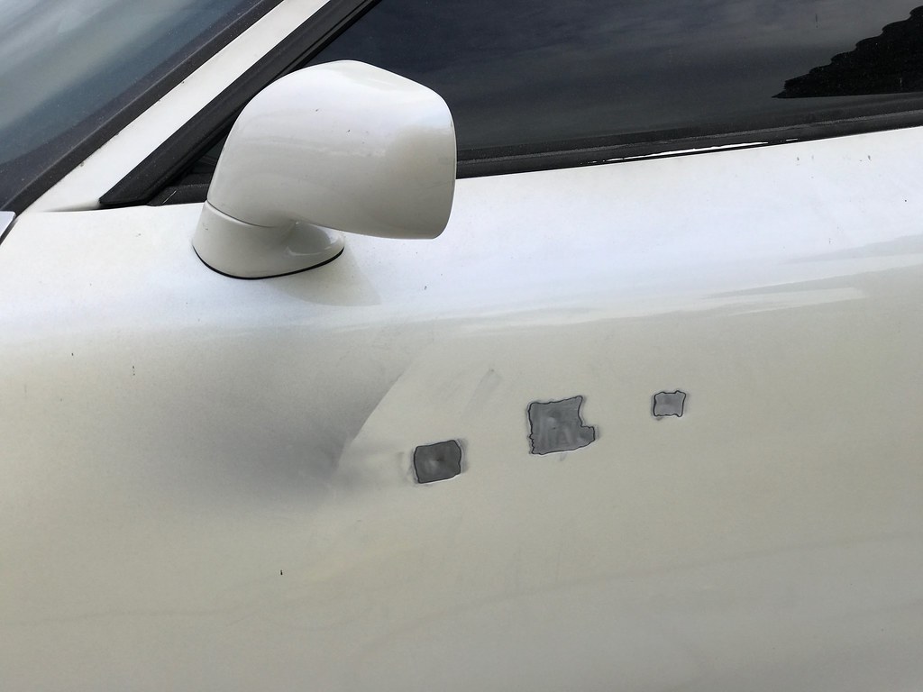

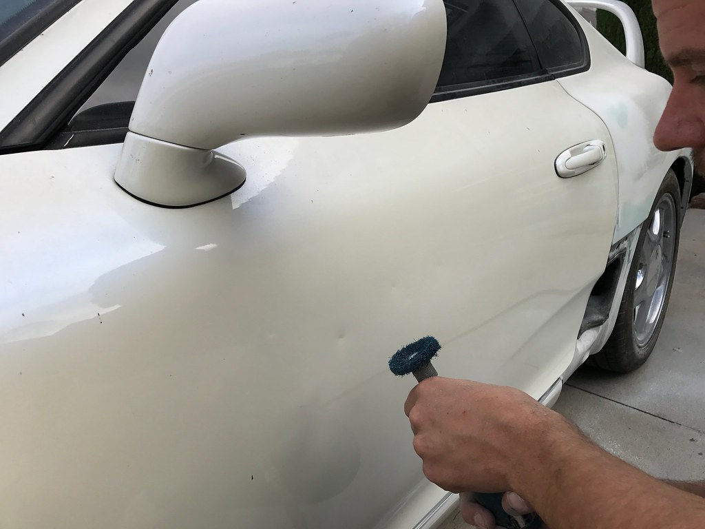

Driver door has some dents also.

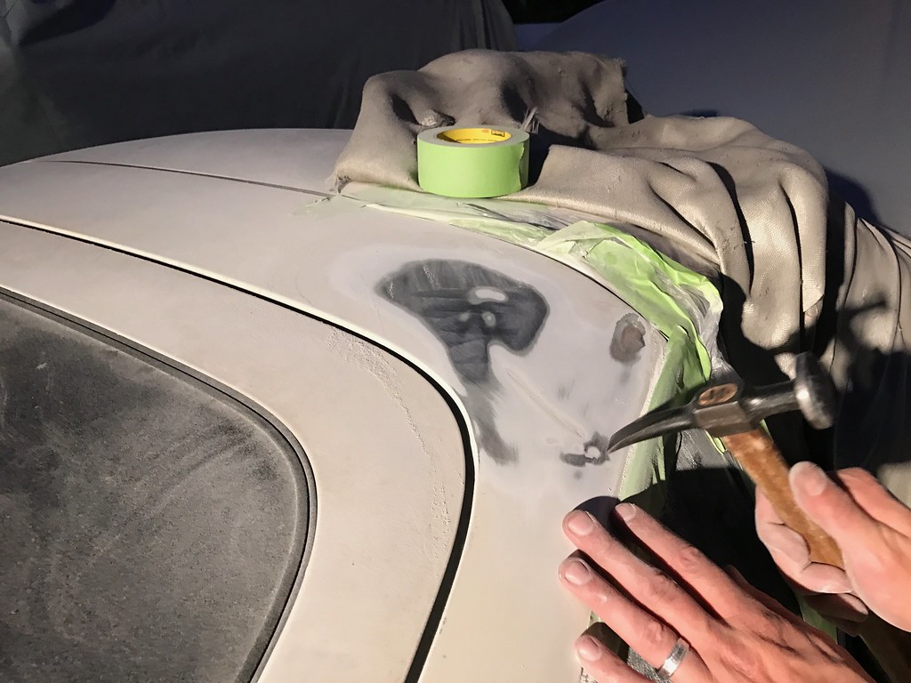

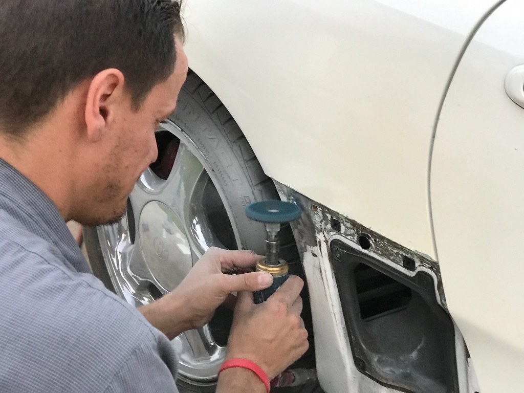

Miscellaneous dent removal
More line work. Still not perfect, but getting there.

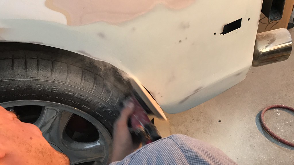

There's a slight dent in the wheel well that's also getting addressed.
More dents.
