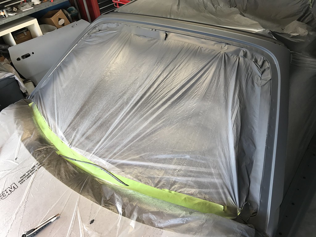

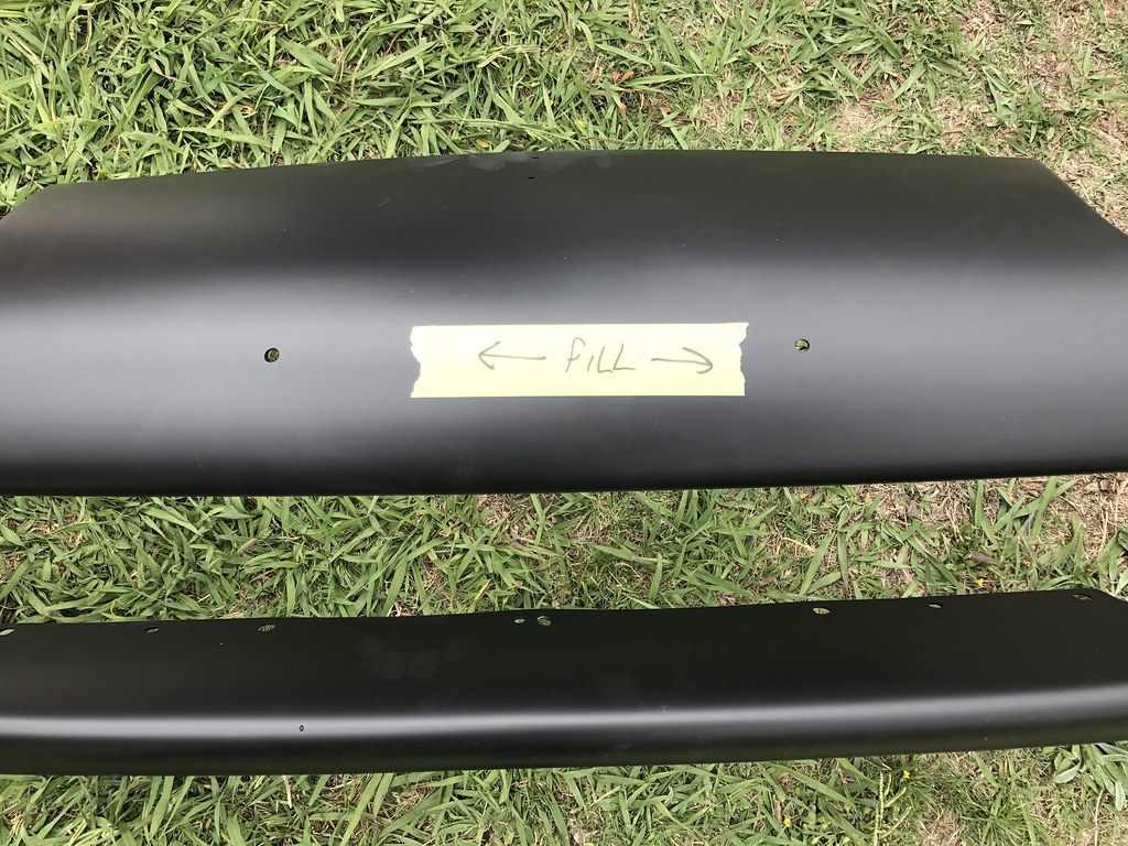

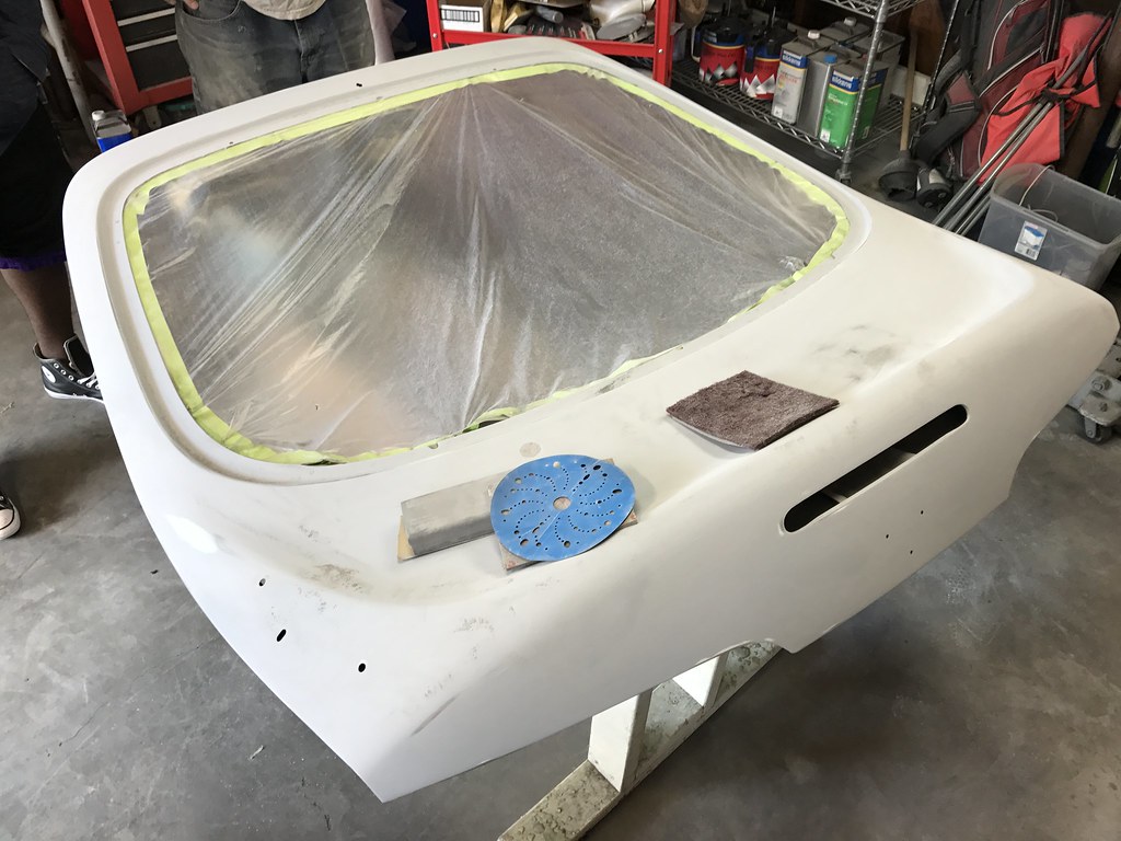

The hatch round 2....

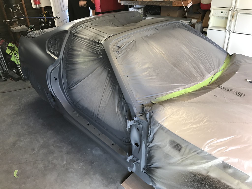

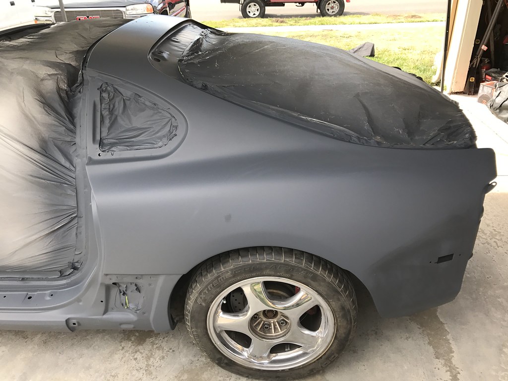

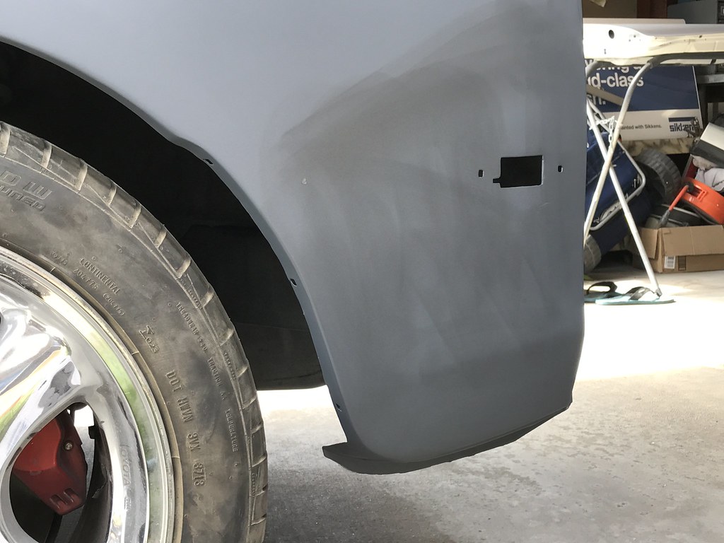

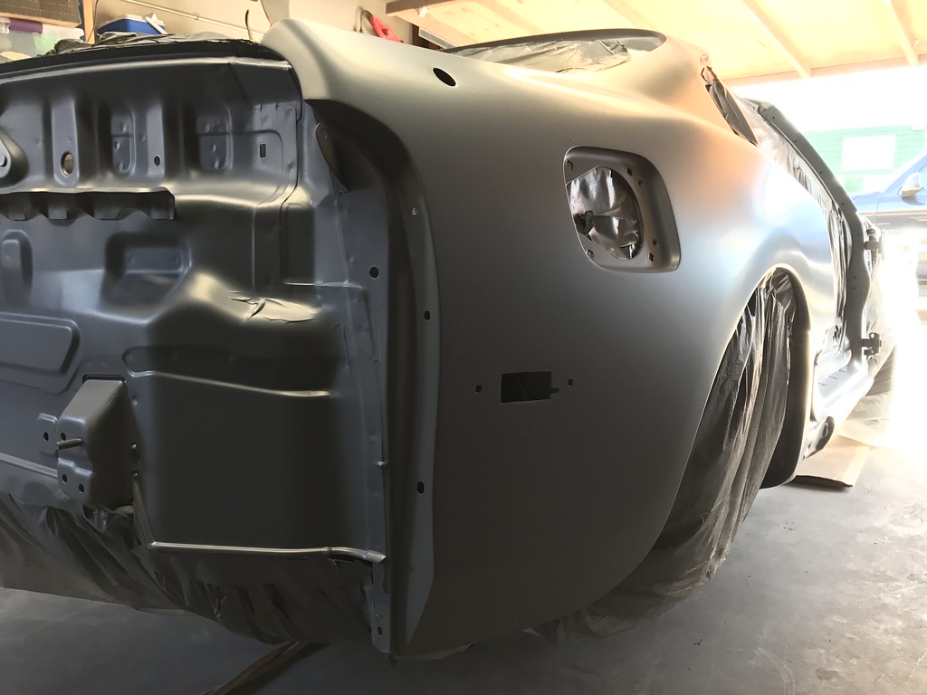

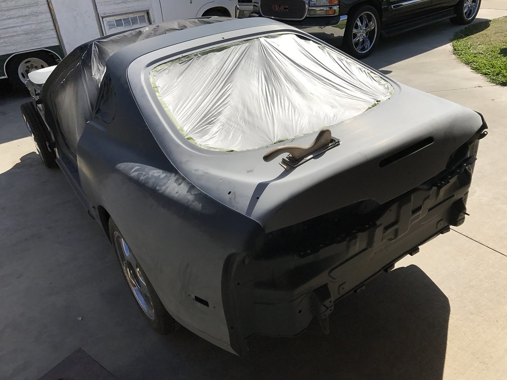

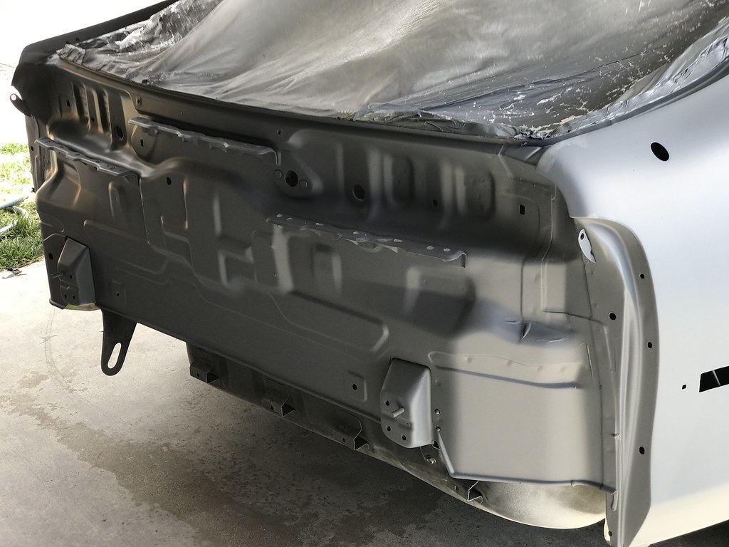

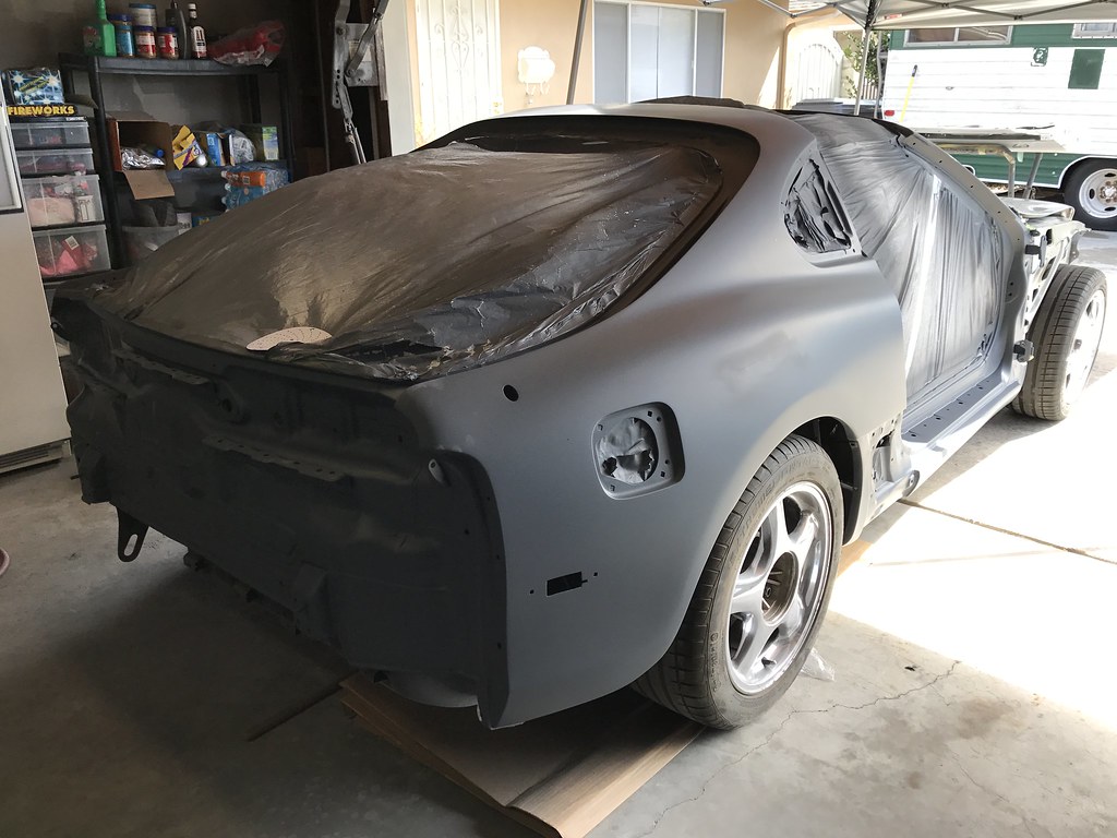

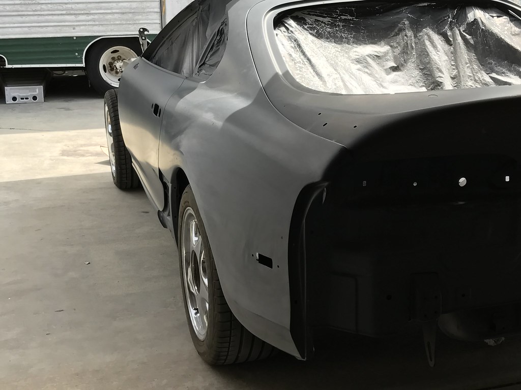

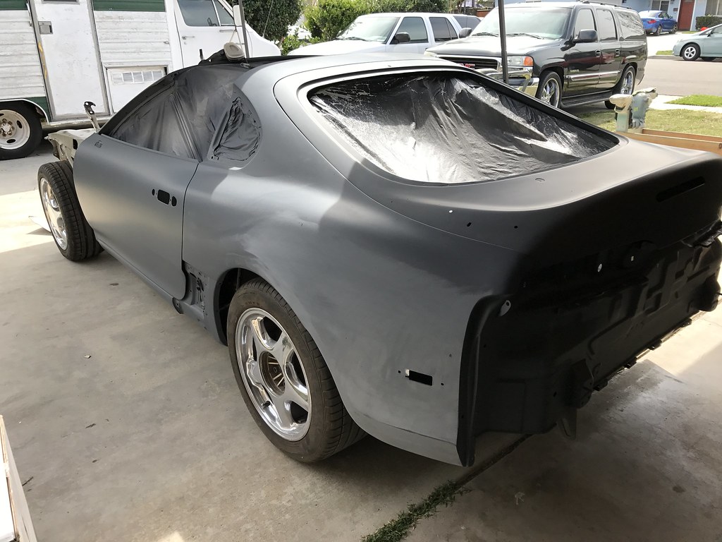

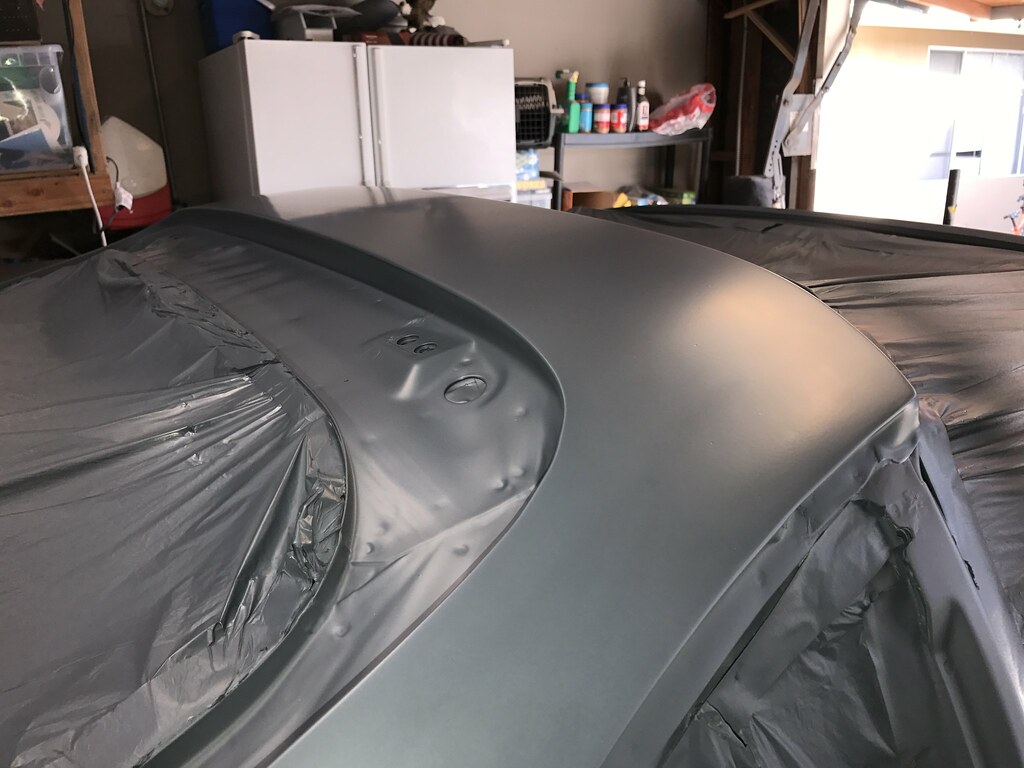

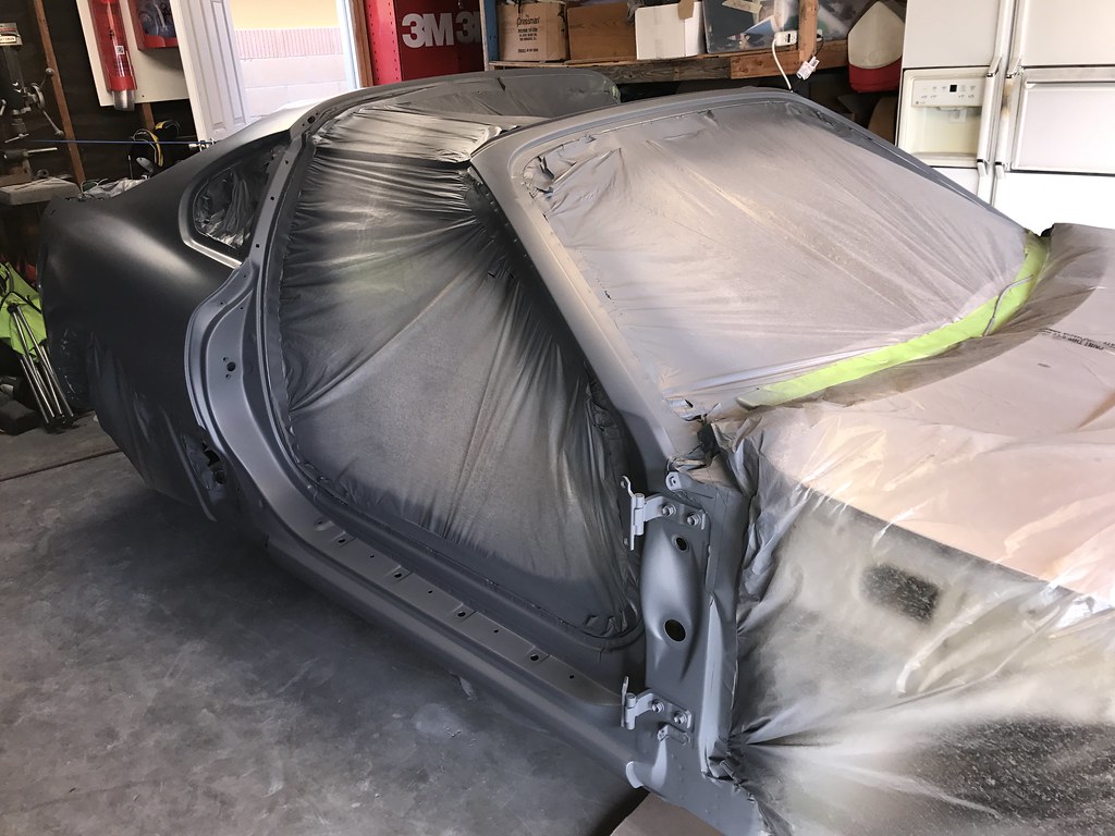

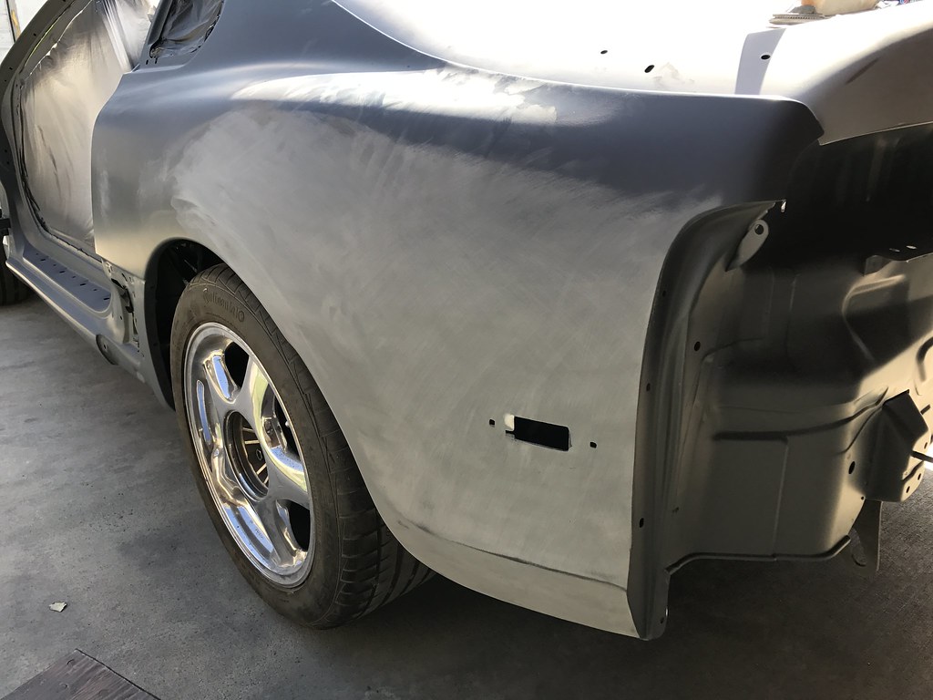

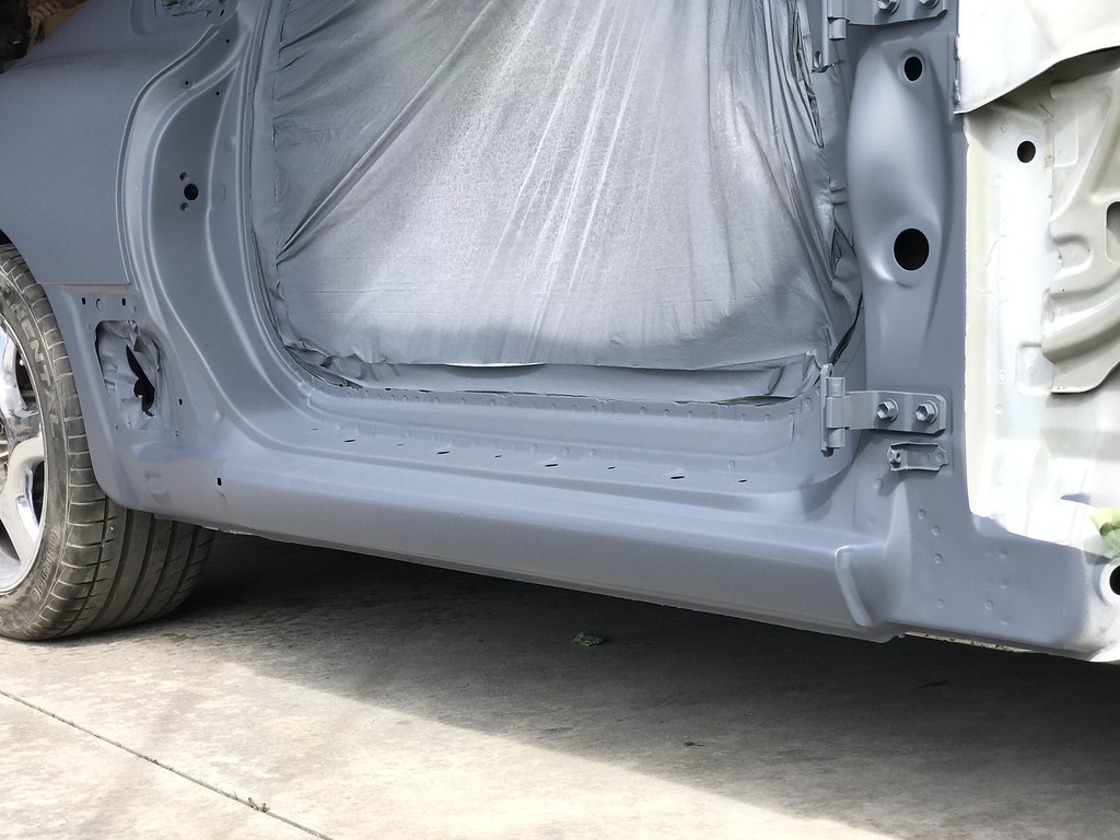

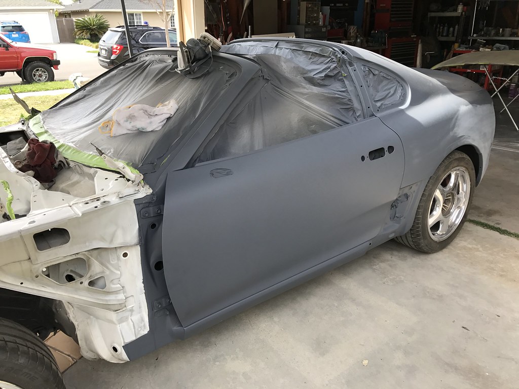

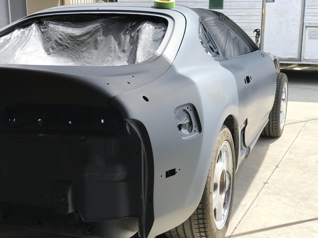

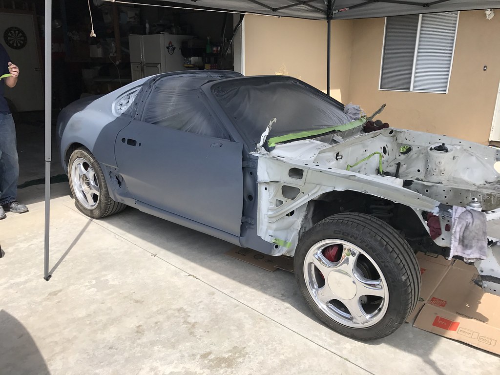

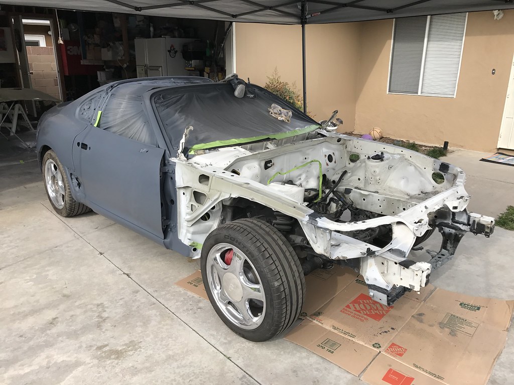

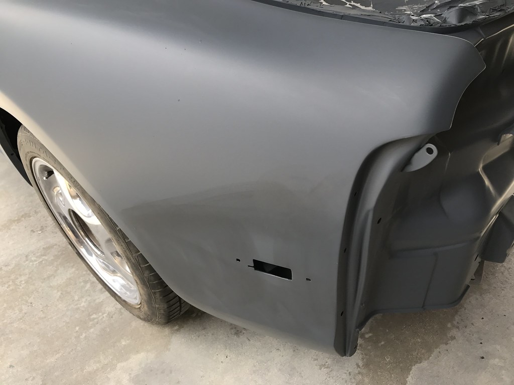

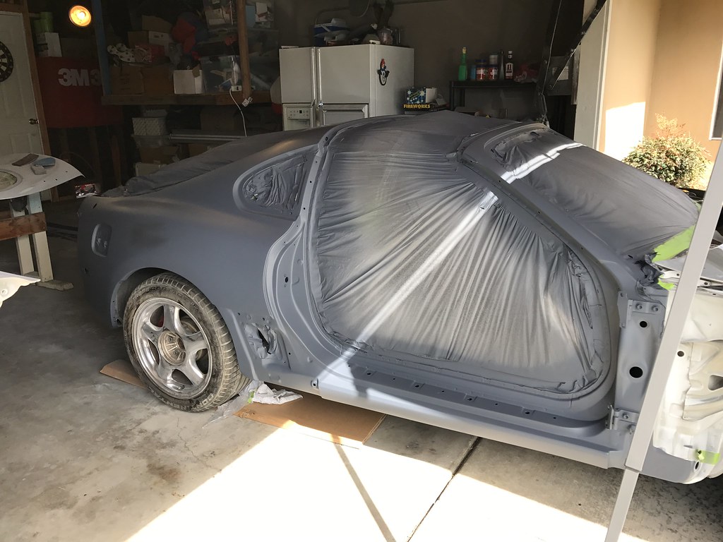

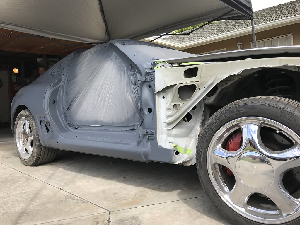

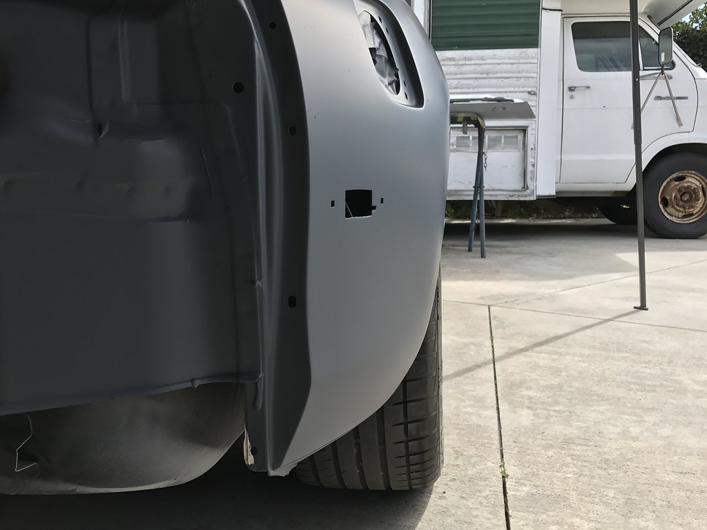

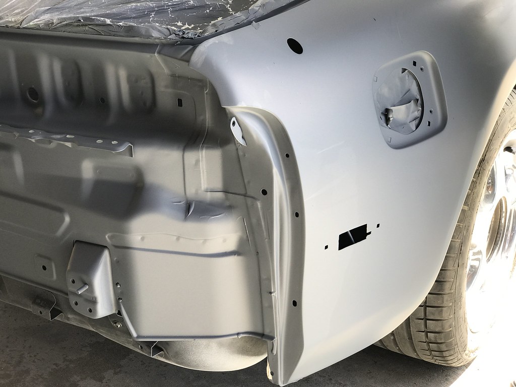

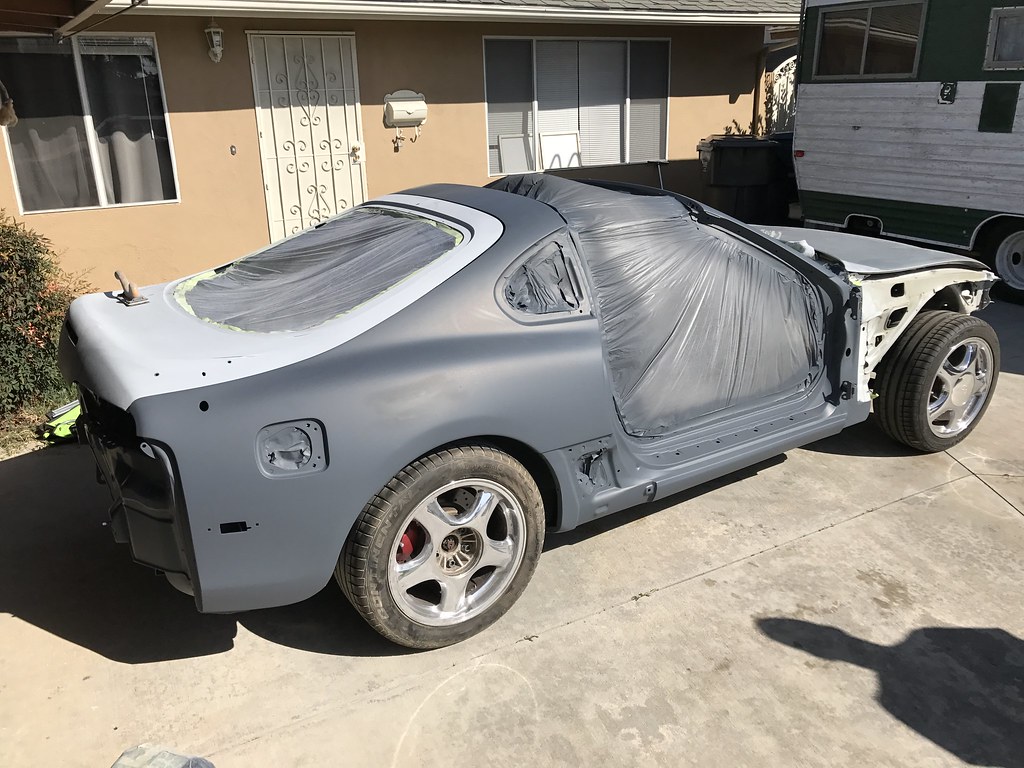

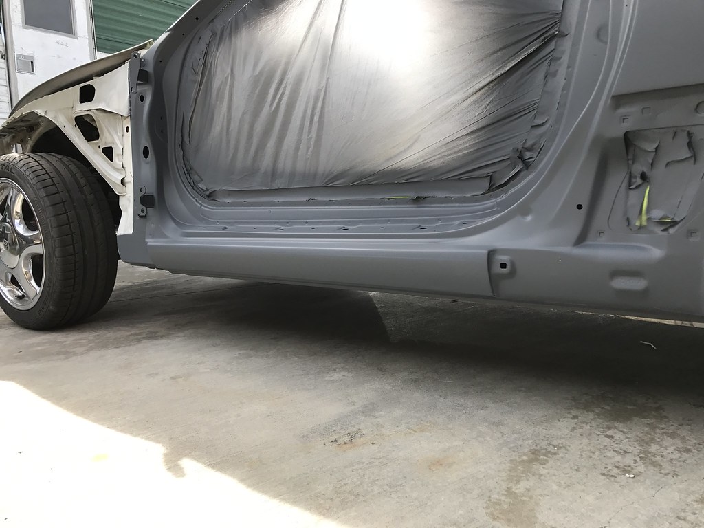

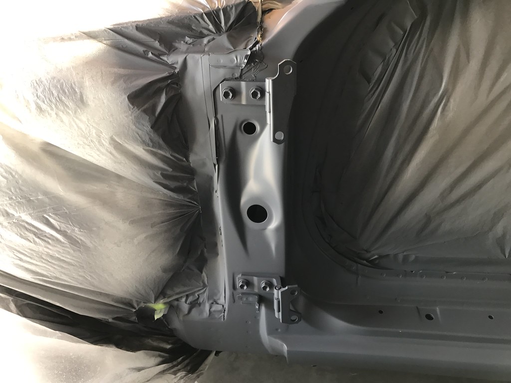

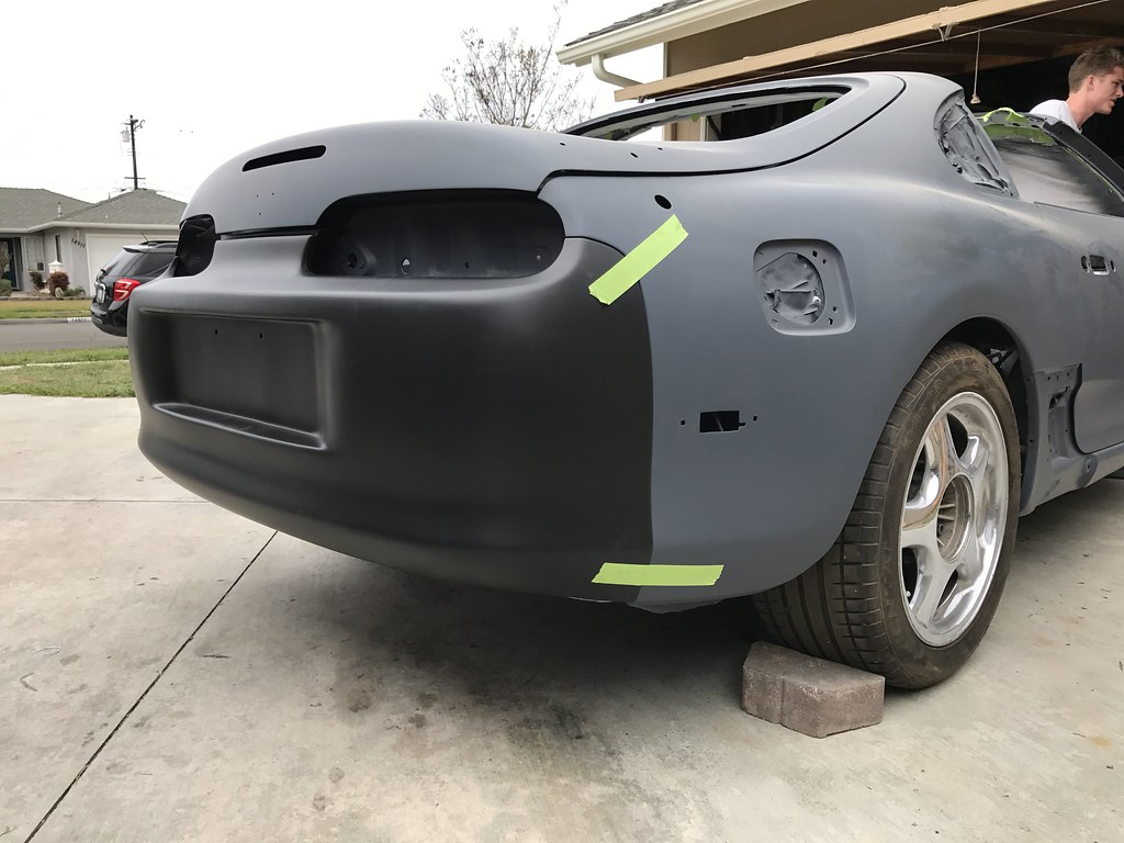

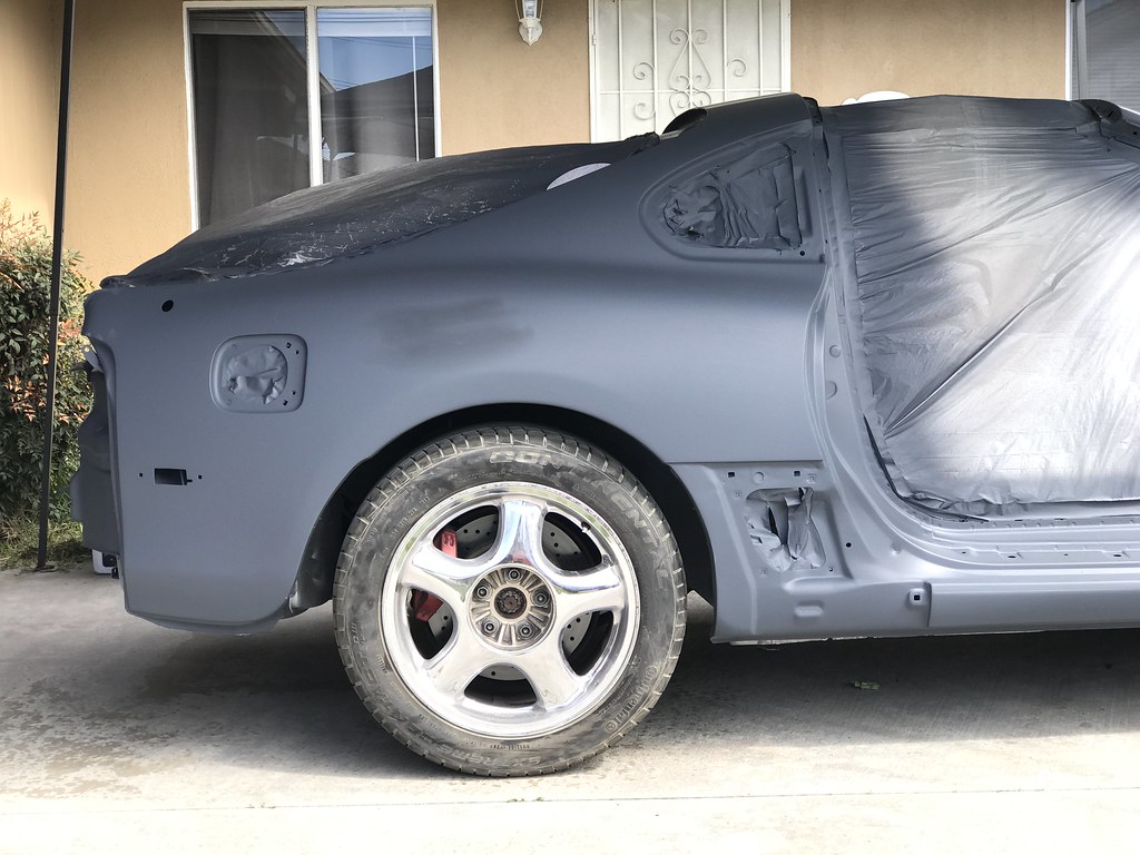

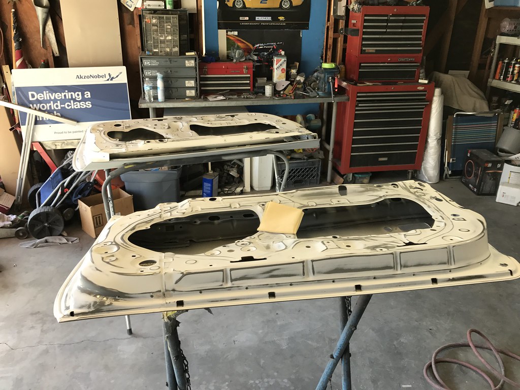

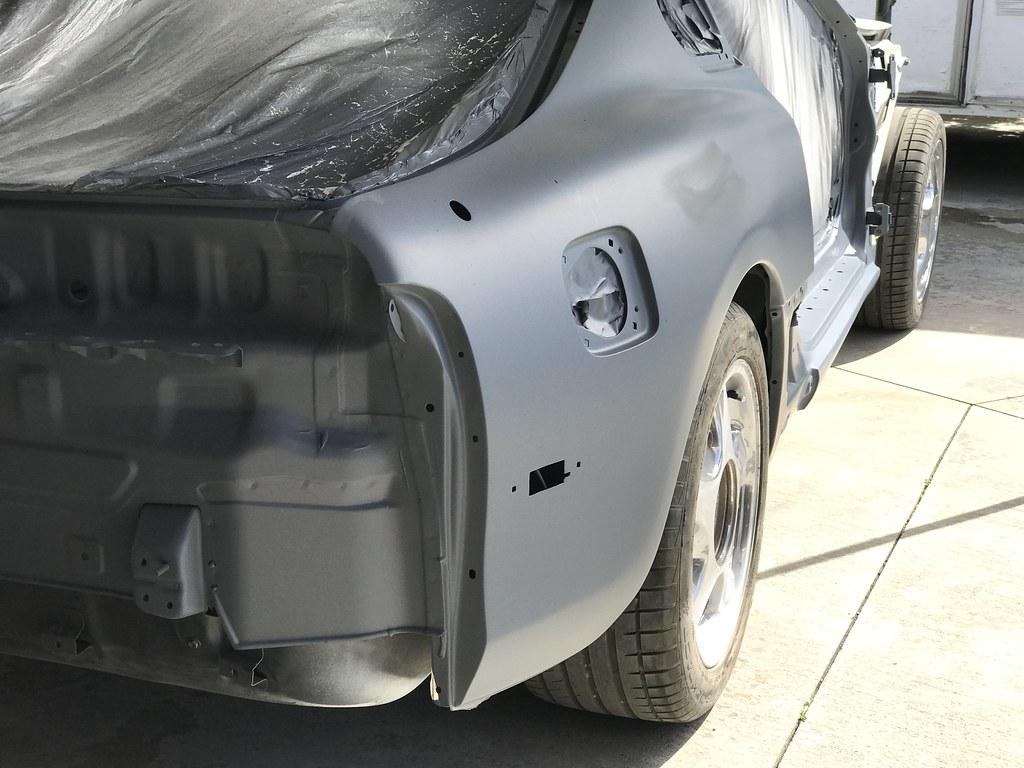

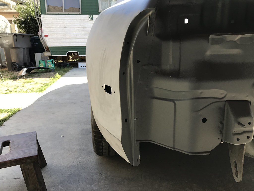

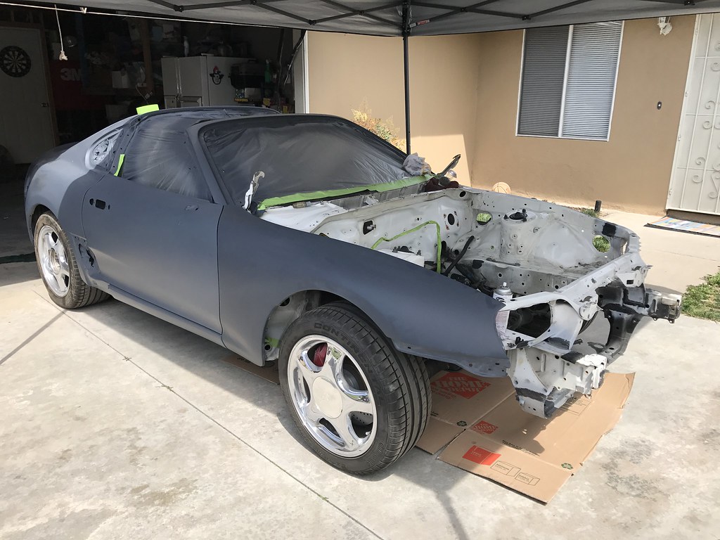

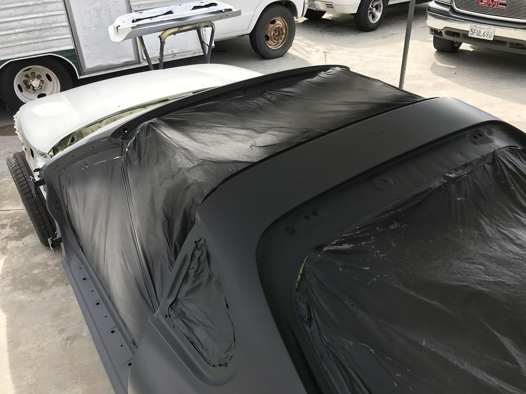

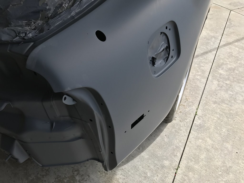

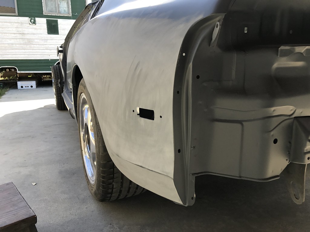

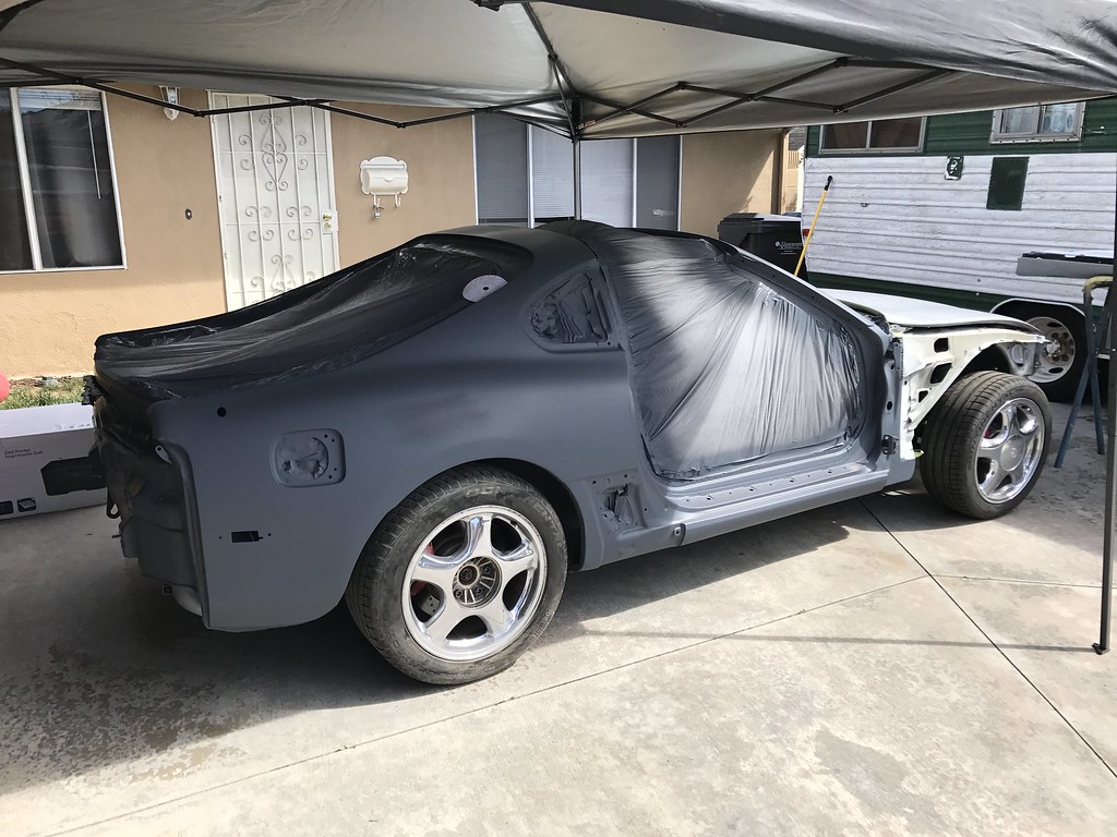

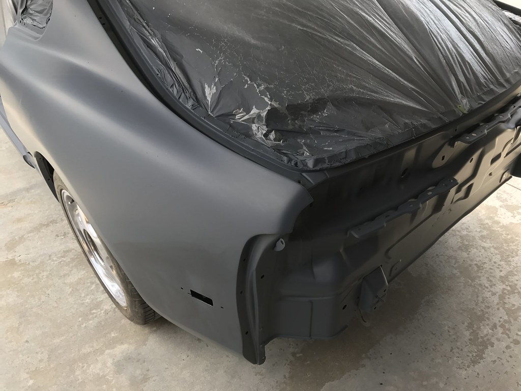

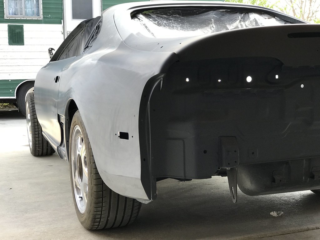

A little more work done after primer. The right quarter needed a tiny spot of work while the left quarter is still being fine tuned.

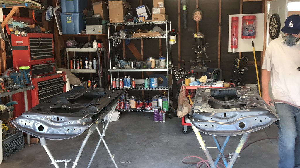

Some pictures in the light

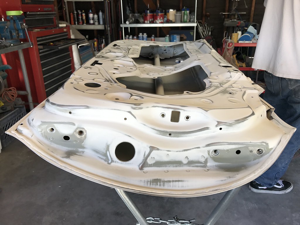

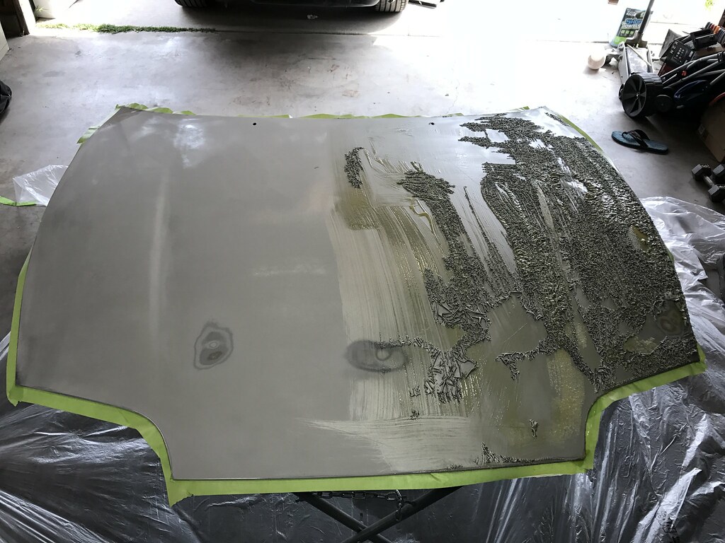

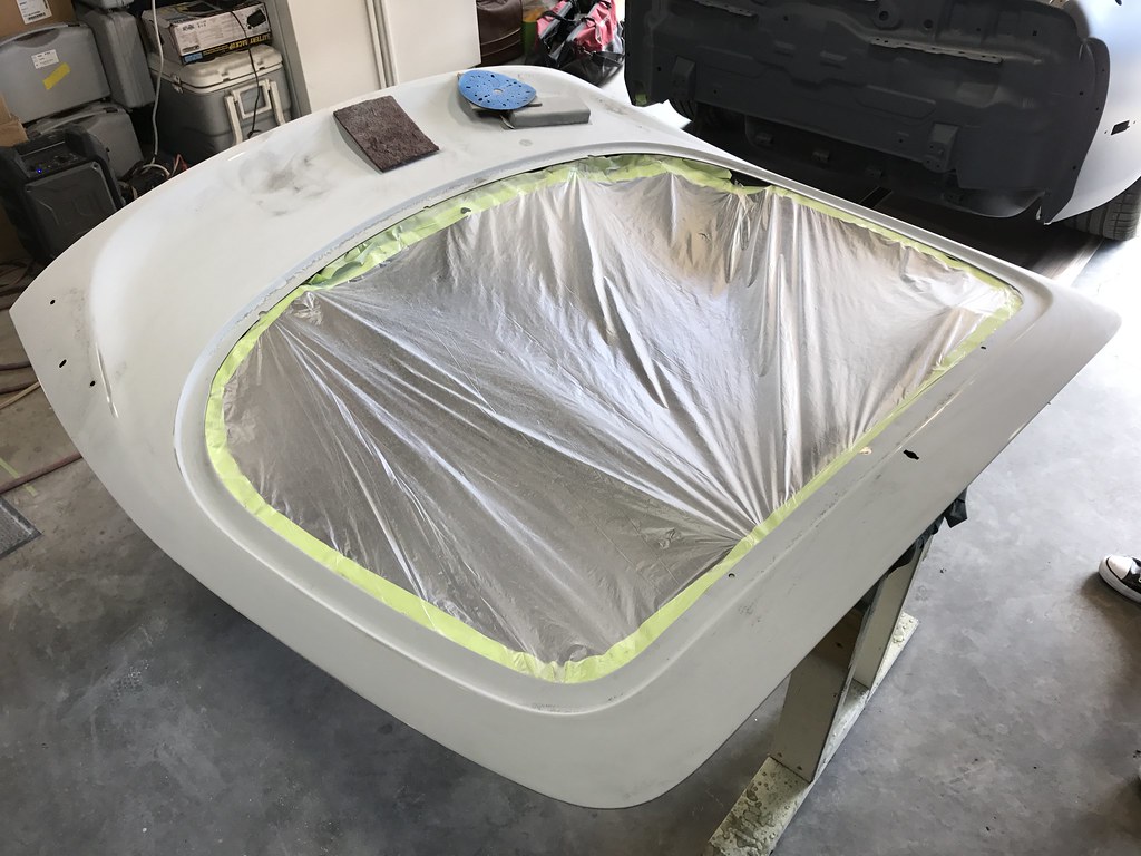

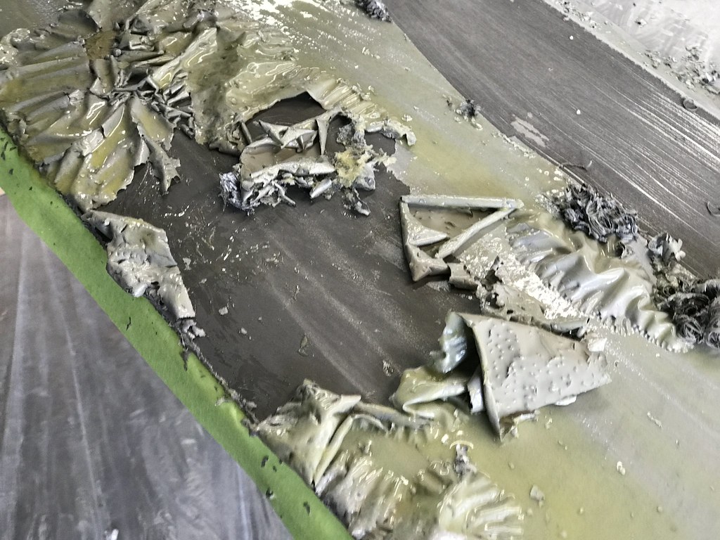

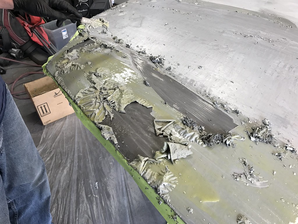

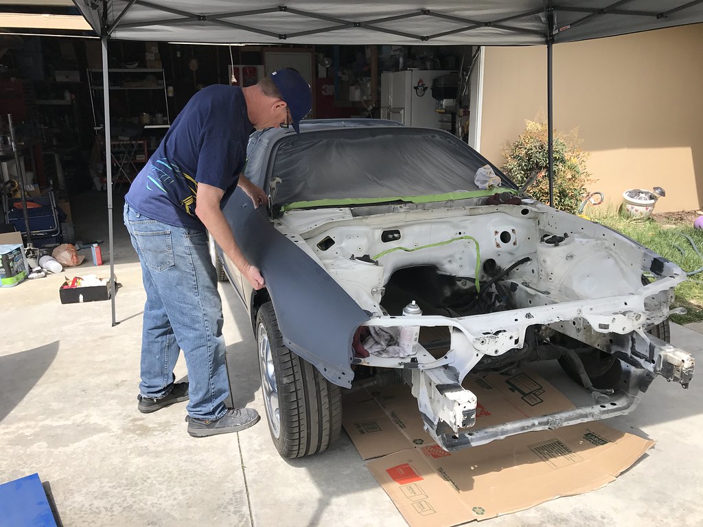

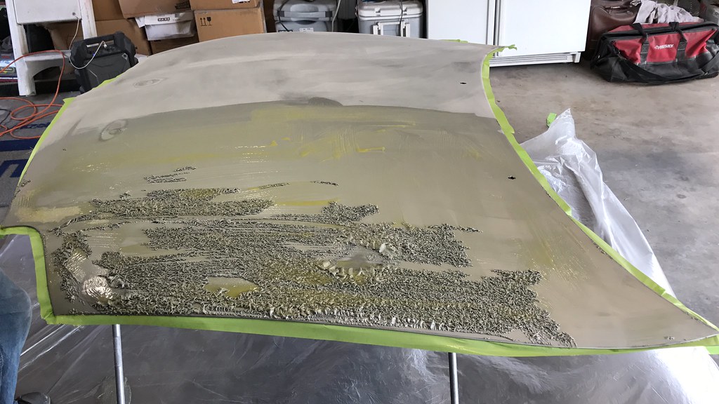

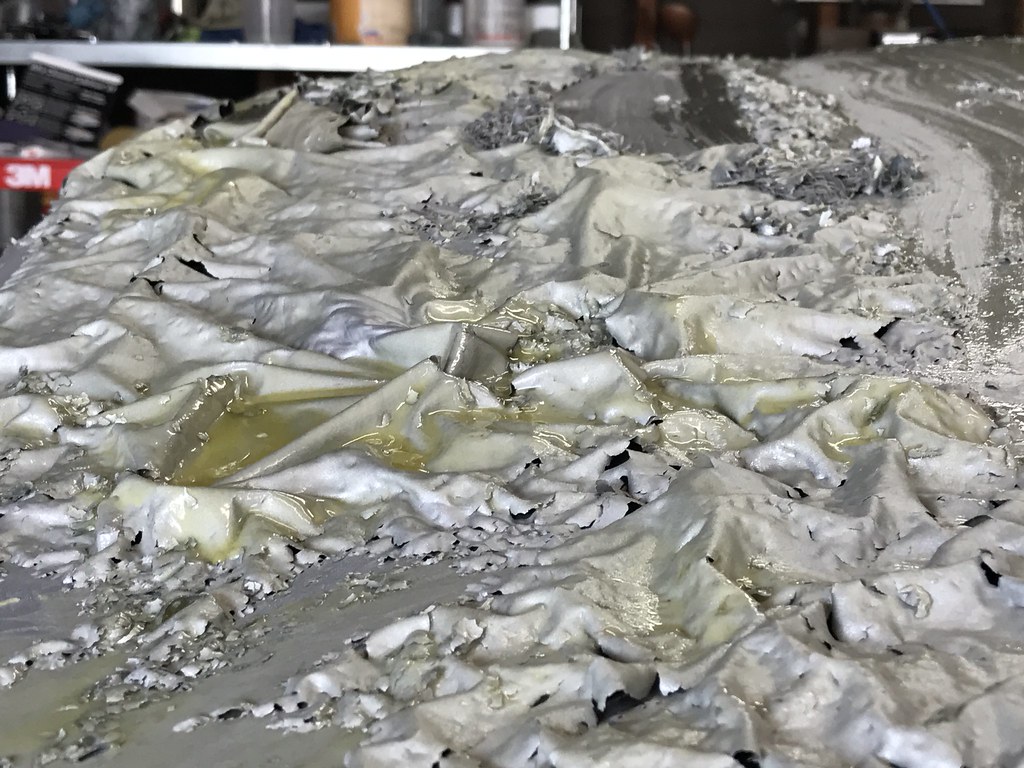

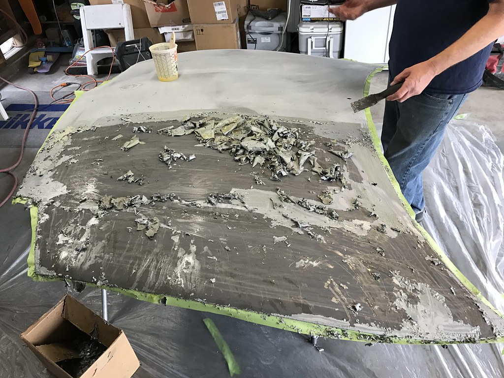

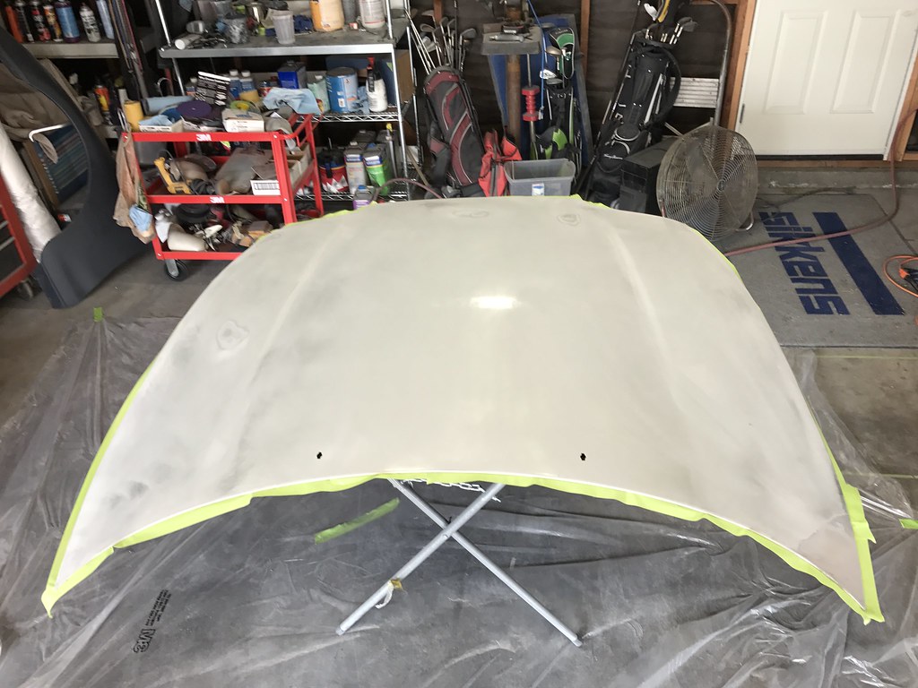

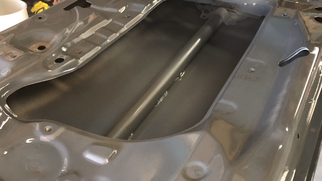

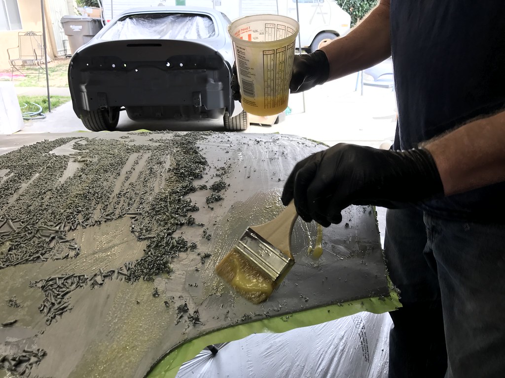

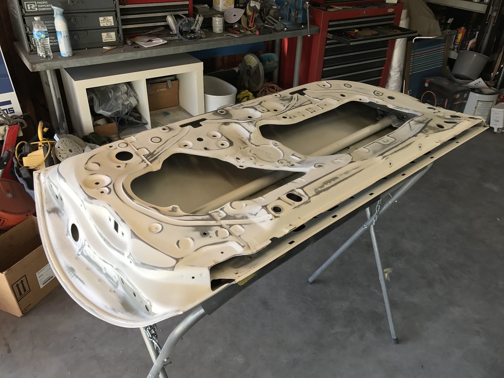

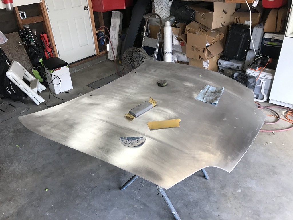

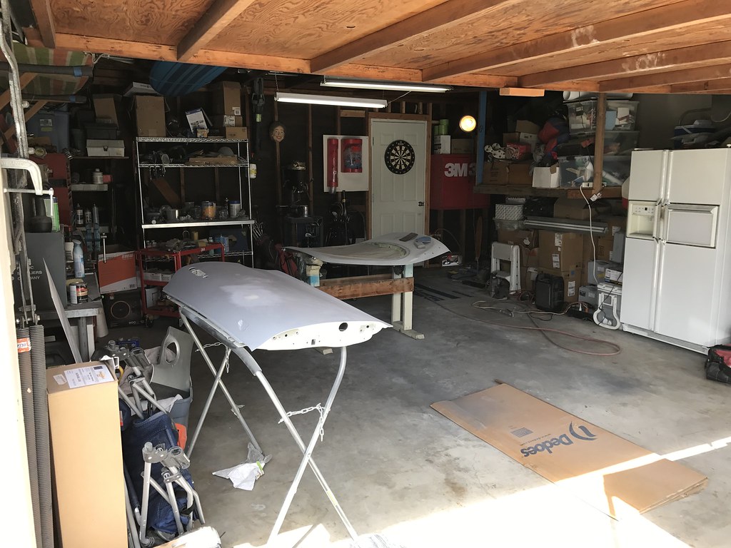

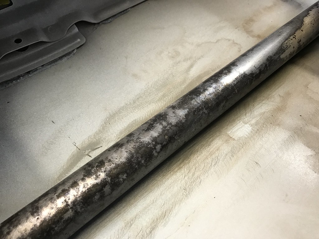

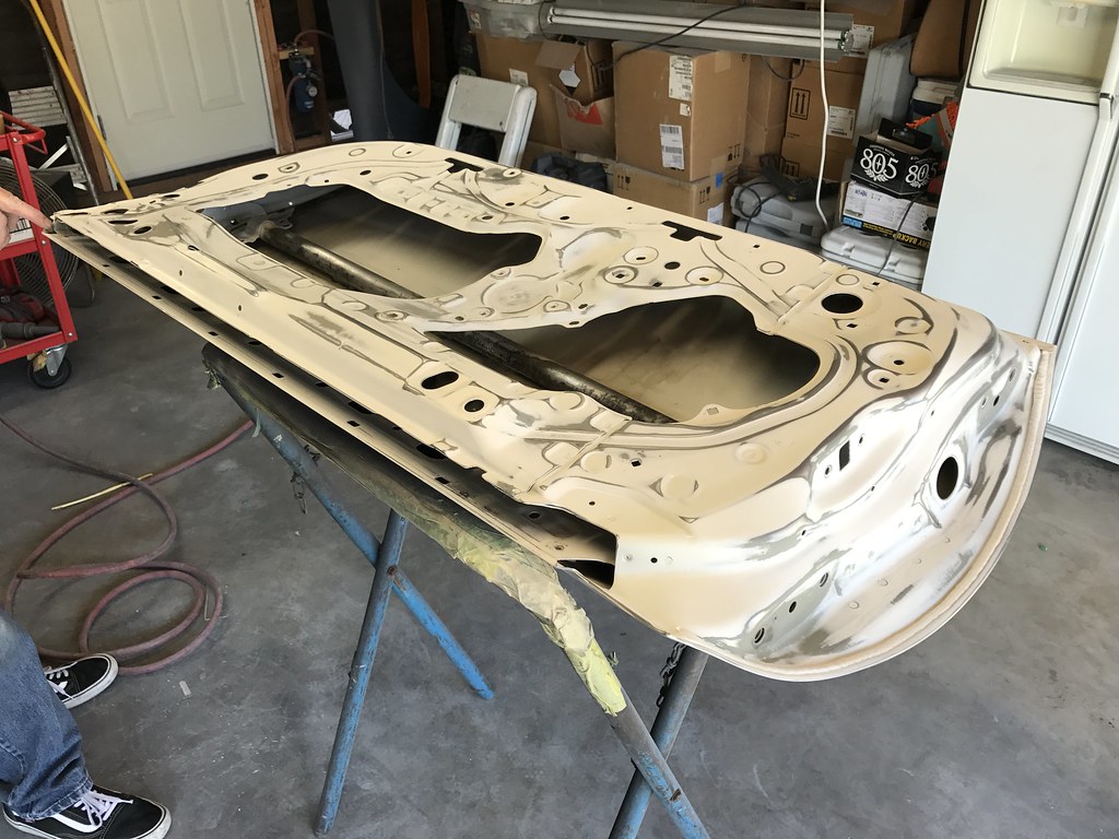

The hood was painted before, so there's a few too many layers of paint to work with. It's going to get stripped.
Applying more to get through the tough stuff.

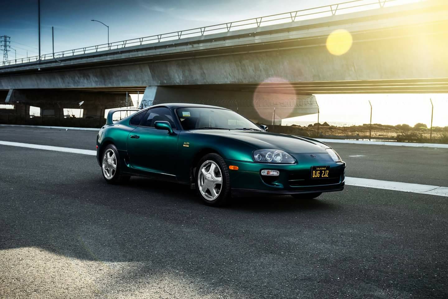

It's done. [emoji11][emoji16]
Man, I gotta call the painter back, he painted it DJG! lol This is actually a very similar green, IJM is a slight bit darker, less blue. Here's a comparison between DJG and IJM:
(IJM LEFT, DJG RIGHT)

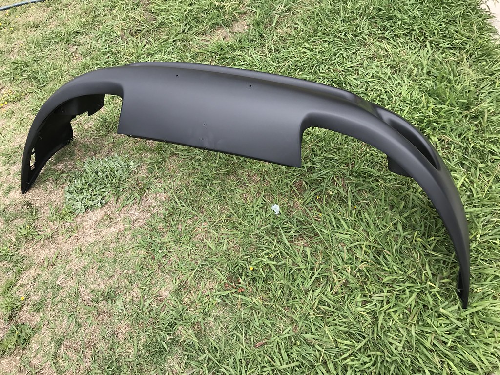

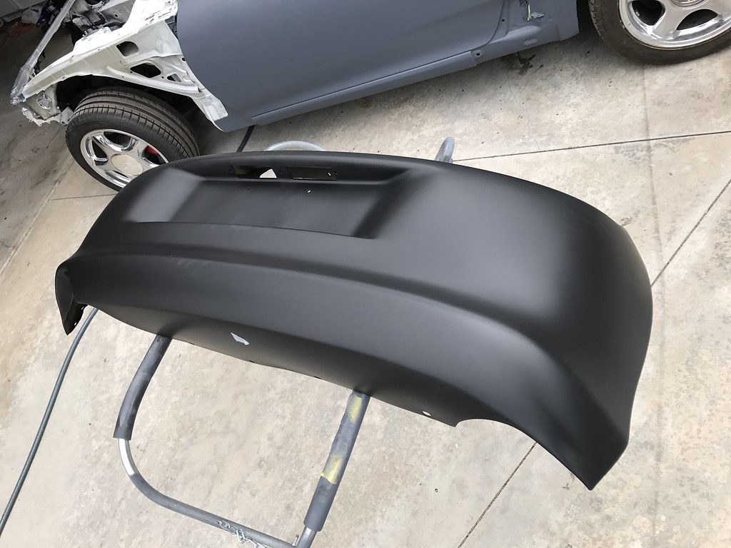

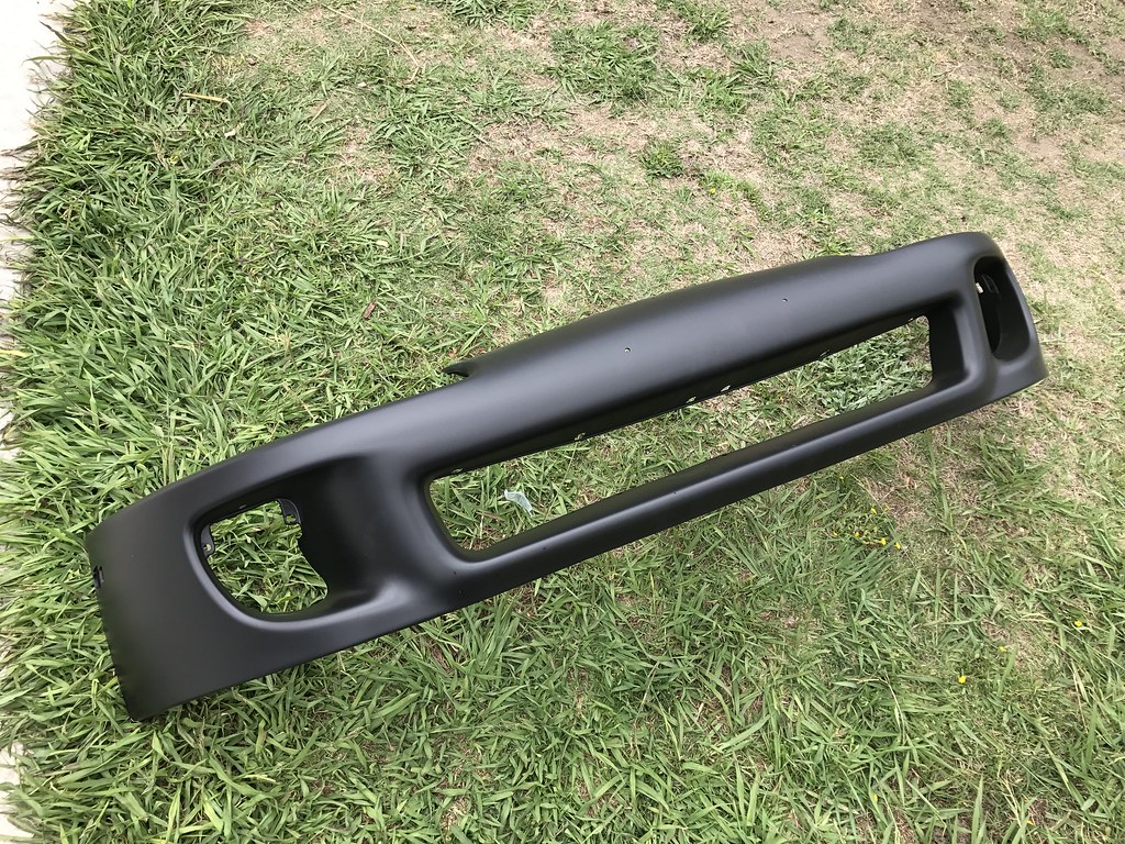

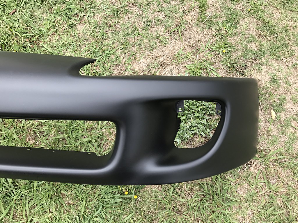

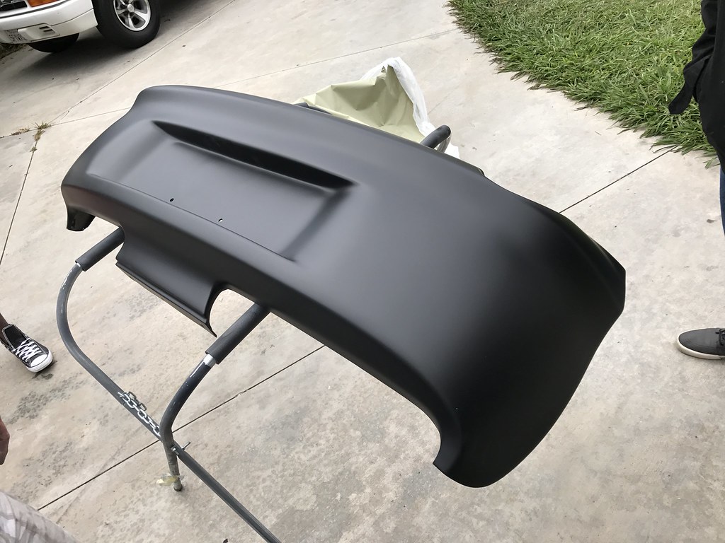

Bumpers are back from the repair shop. Very impressed with how well they repaired these - even the rear bumper looks like new.
Rear bumper Before:
After:
Test fit:

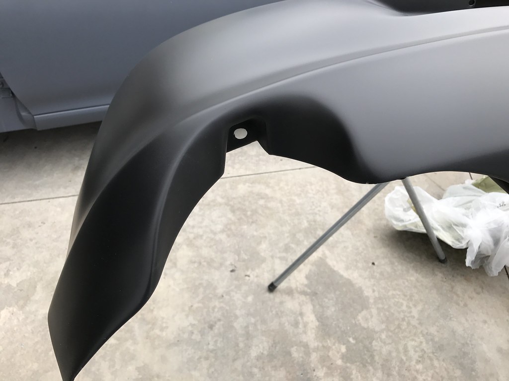

Front bumper before:
After:

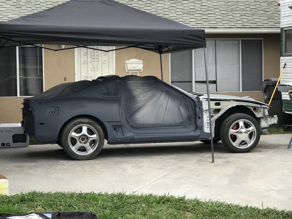

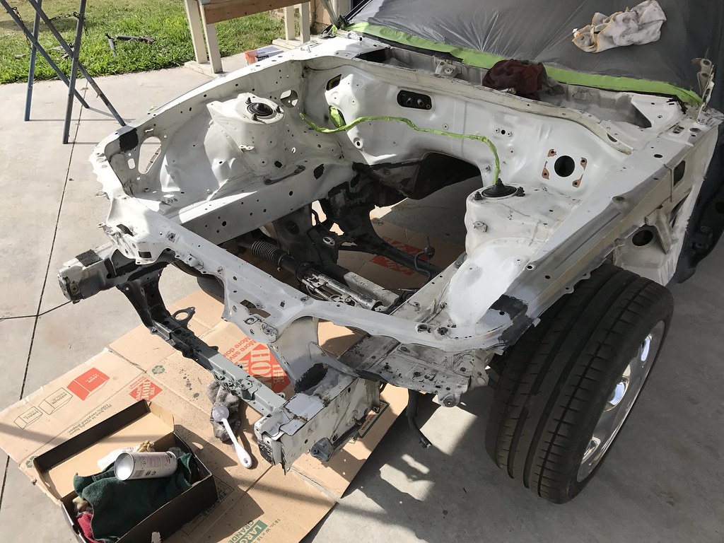

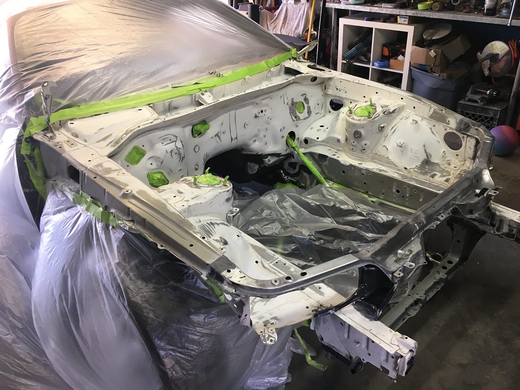

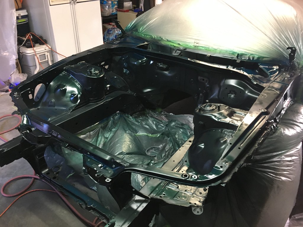

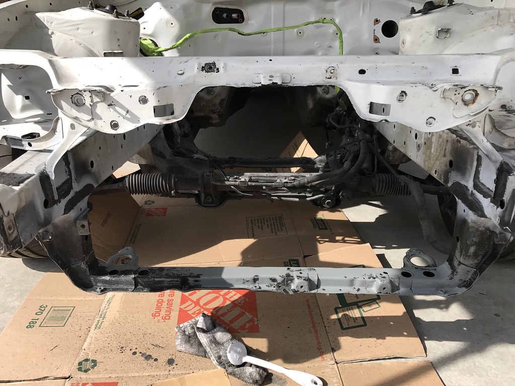

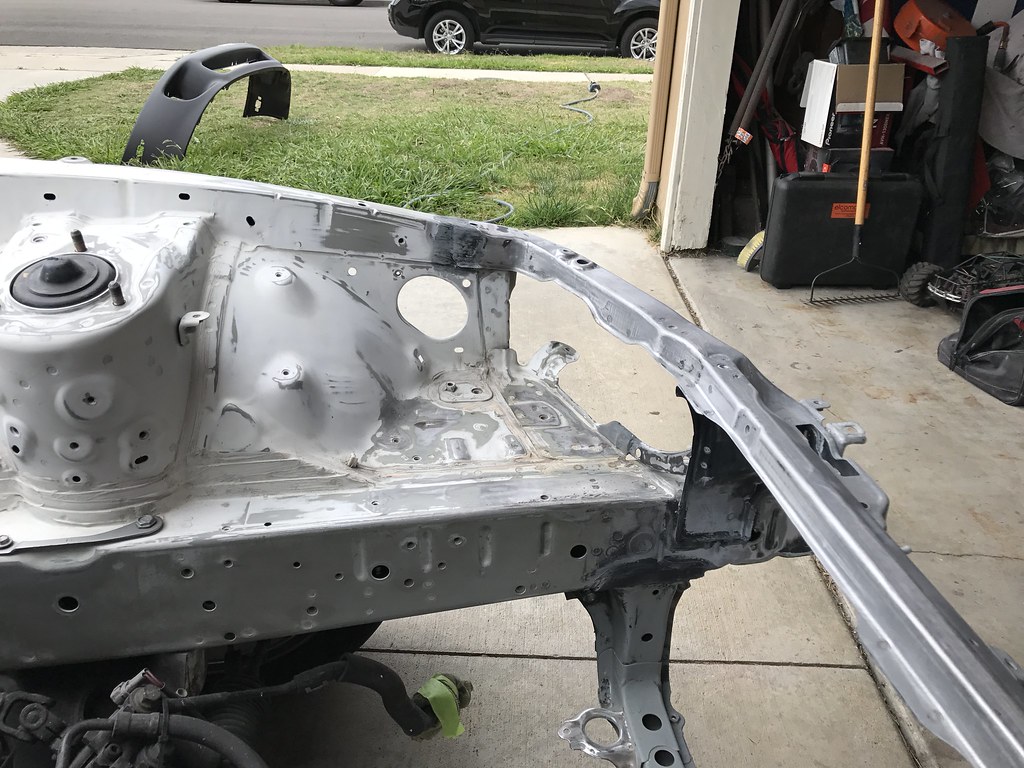

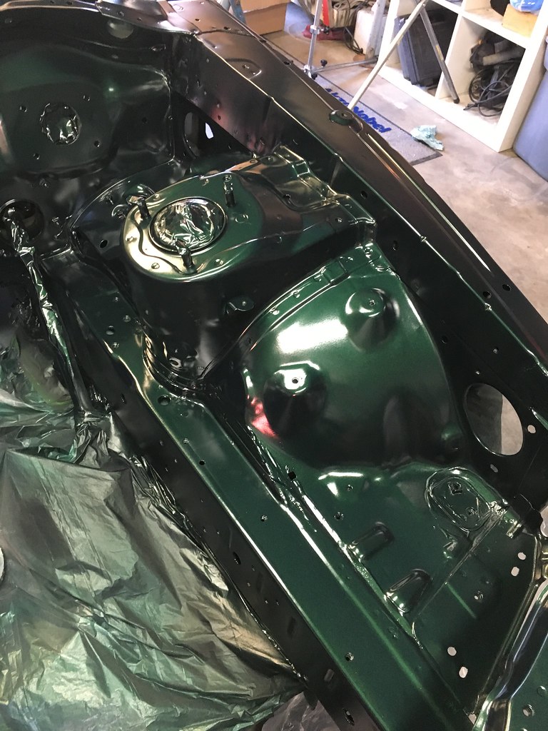

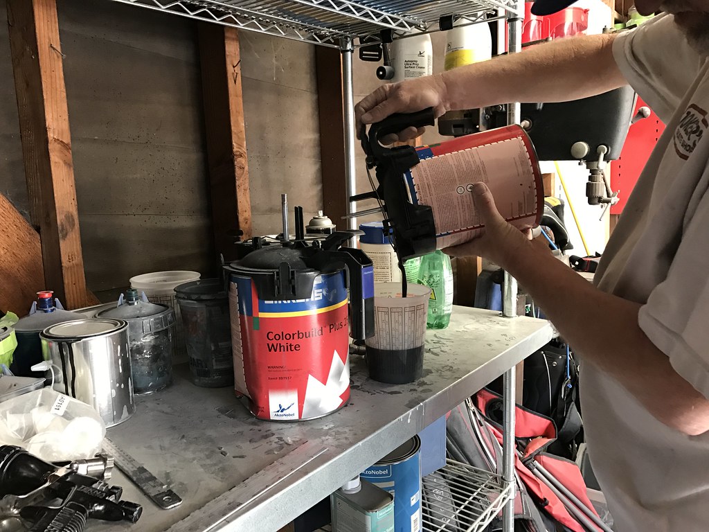

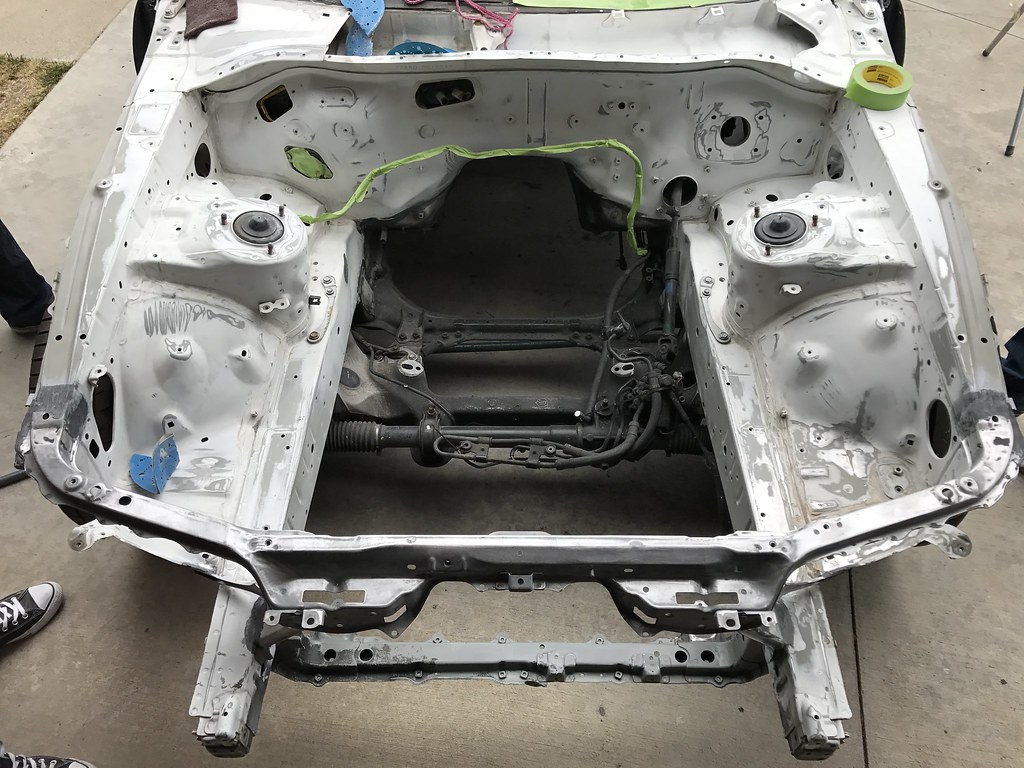

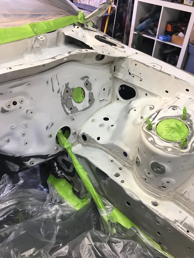

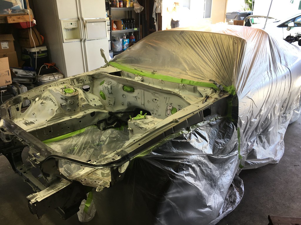

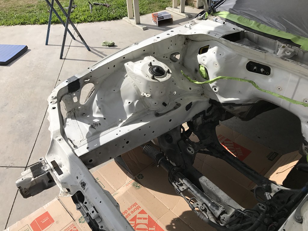

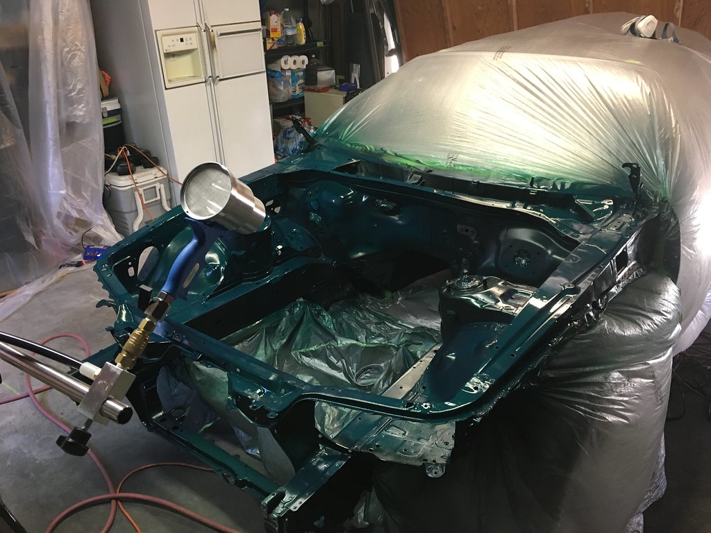

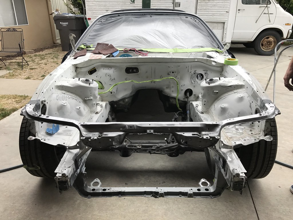

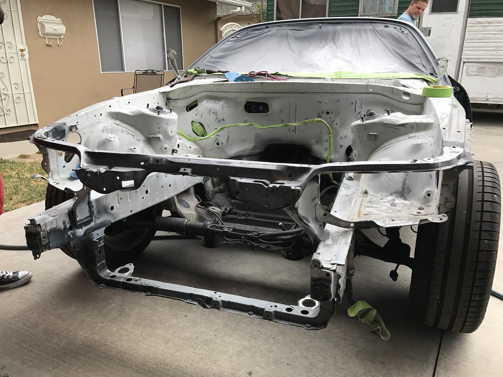

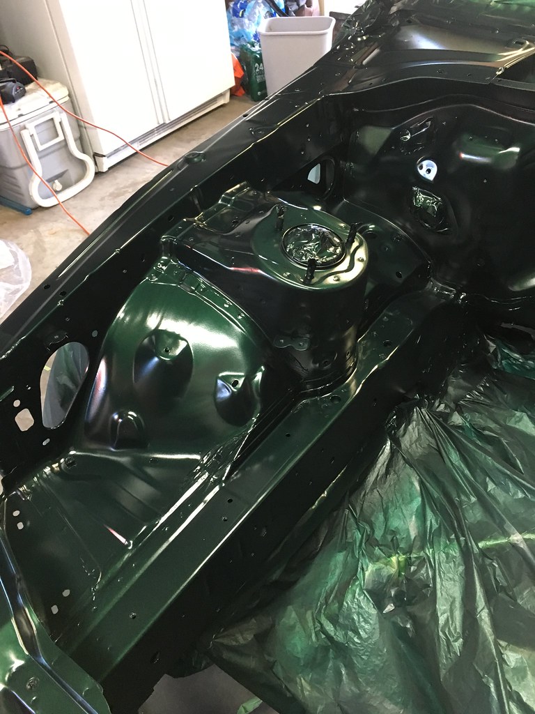

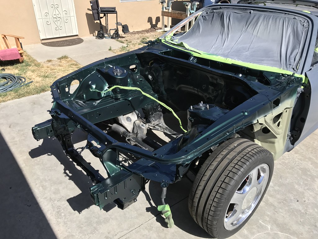

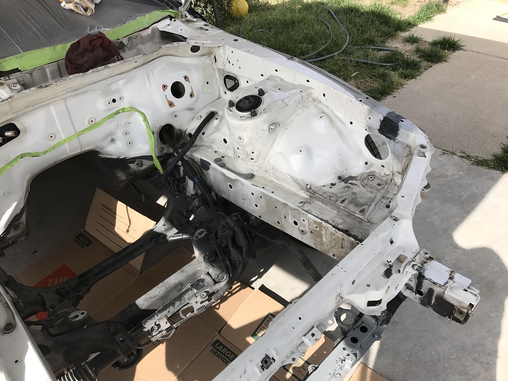

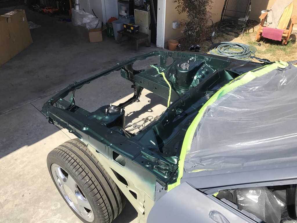

Engine bay about to get its first coat.

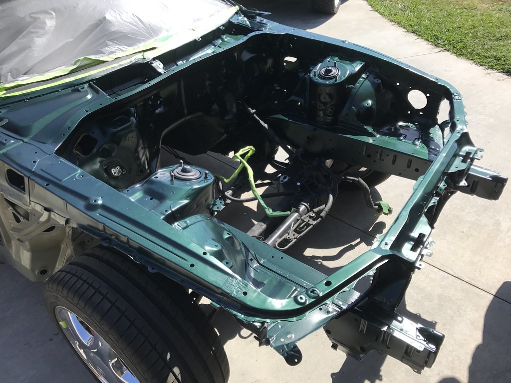

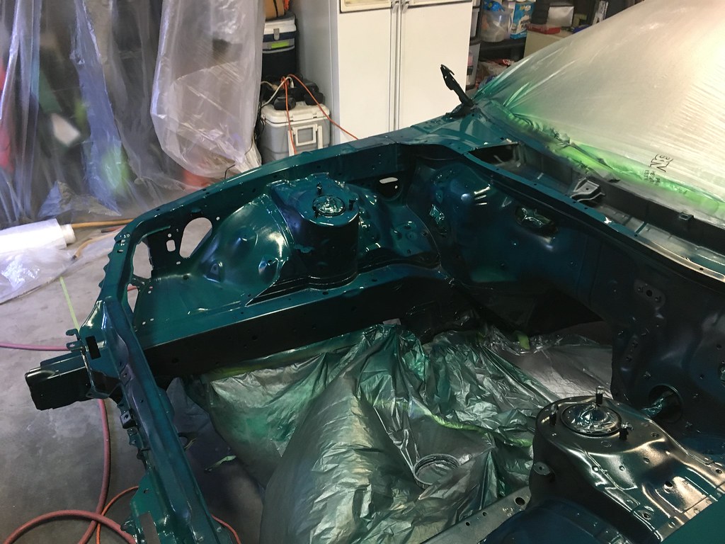

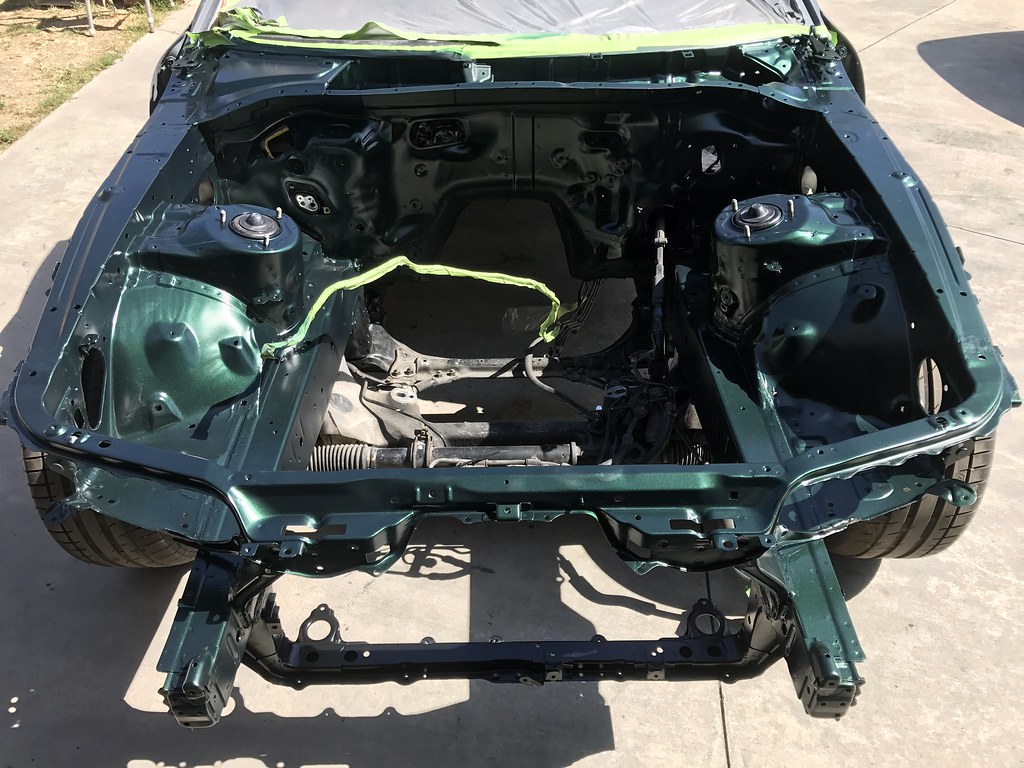

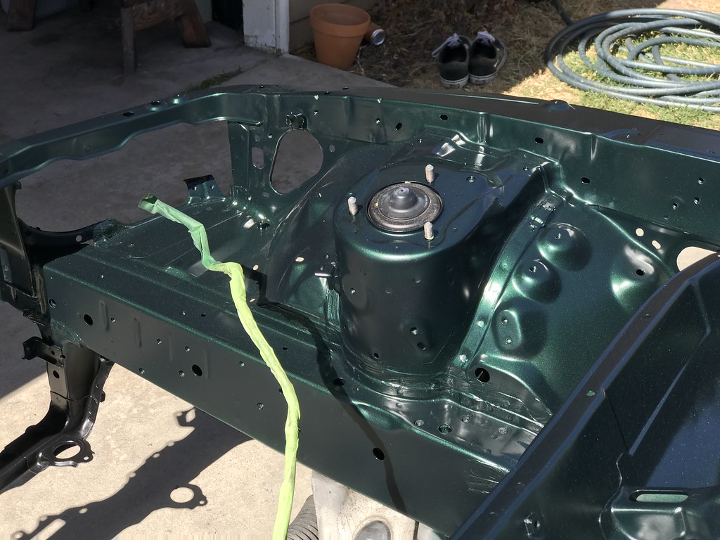

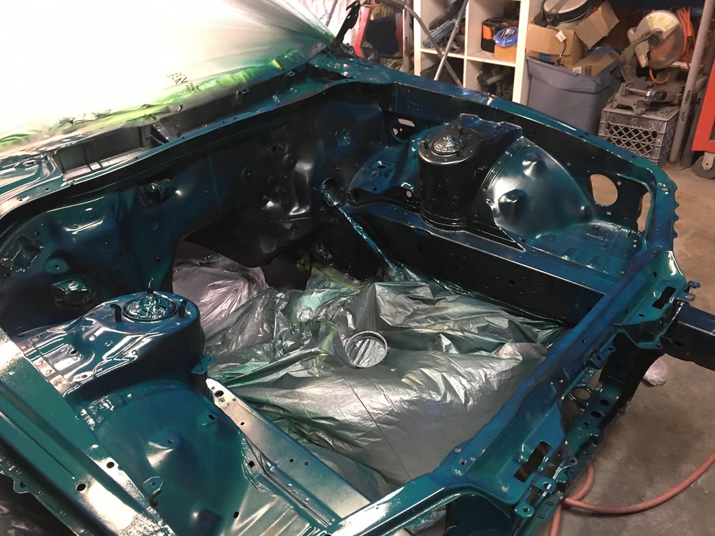

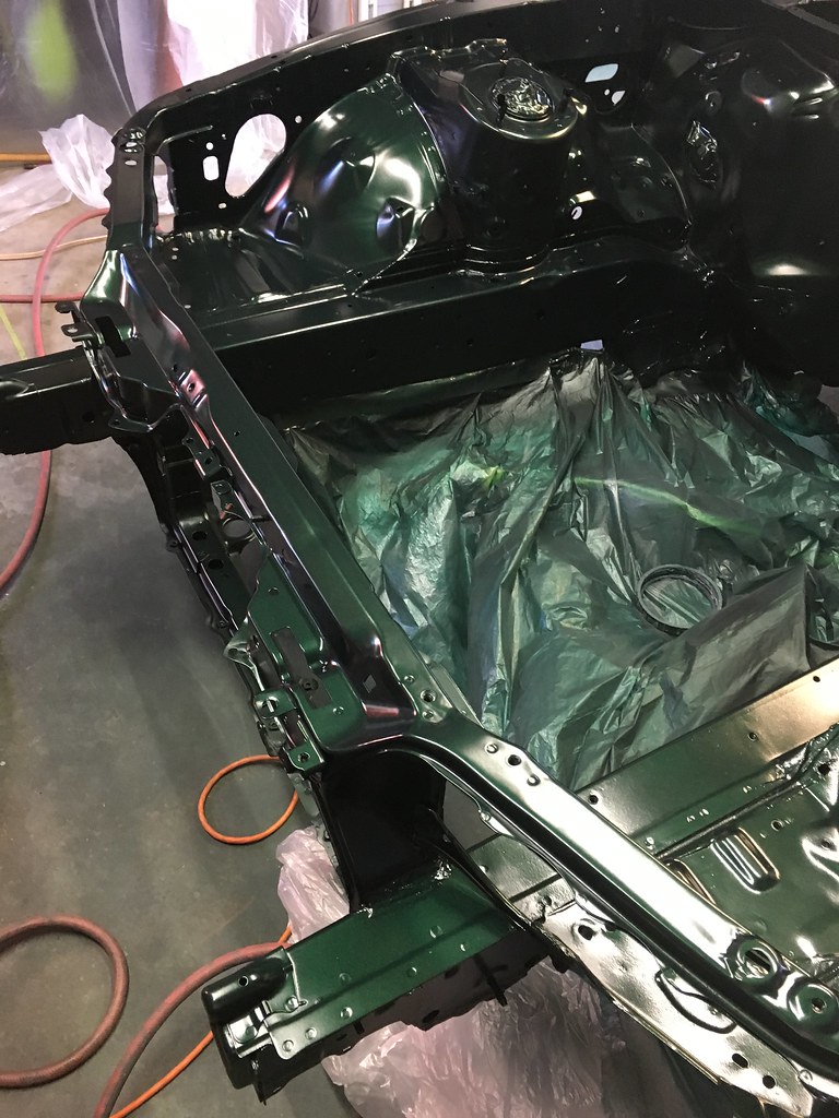

Imperial Jade making its first appearance on the car. Notice how the water based paint shows as blue during the drying process.

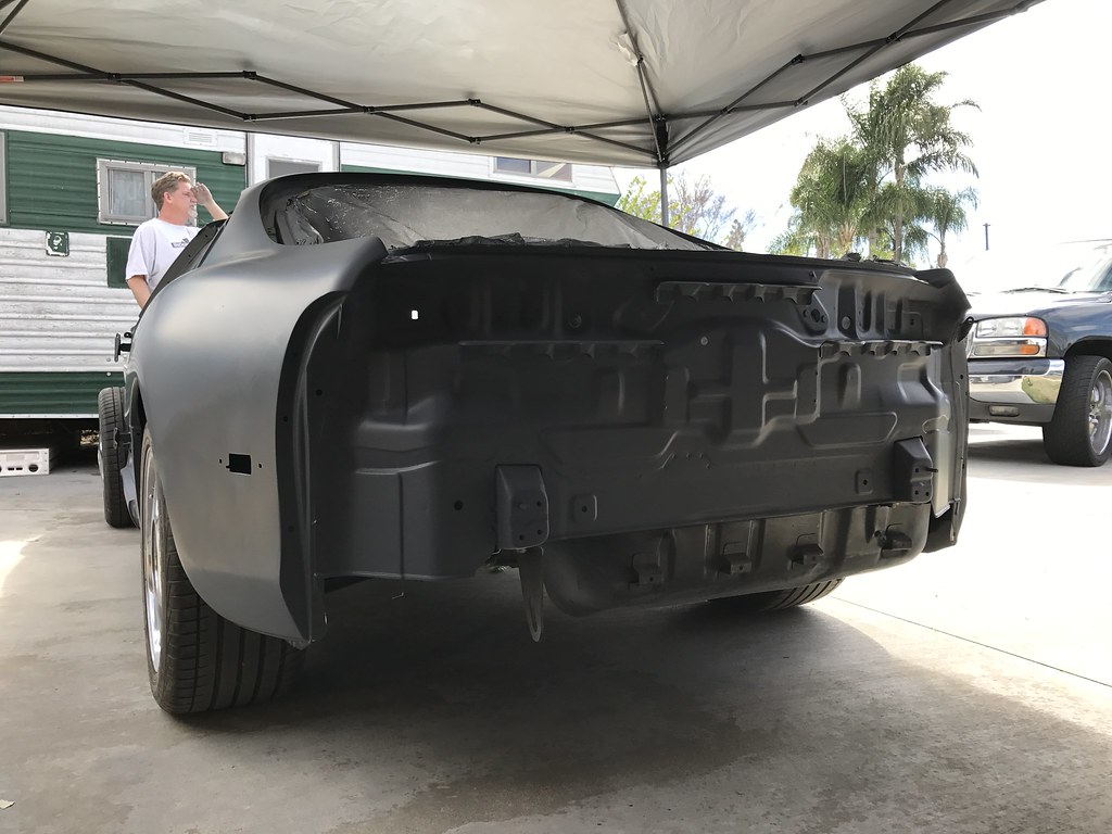

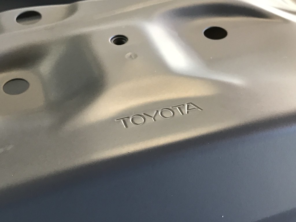

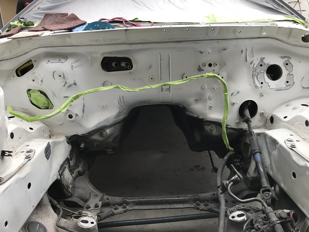

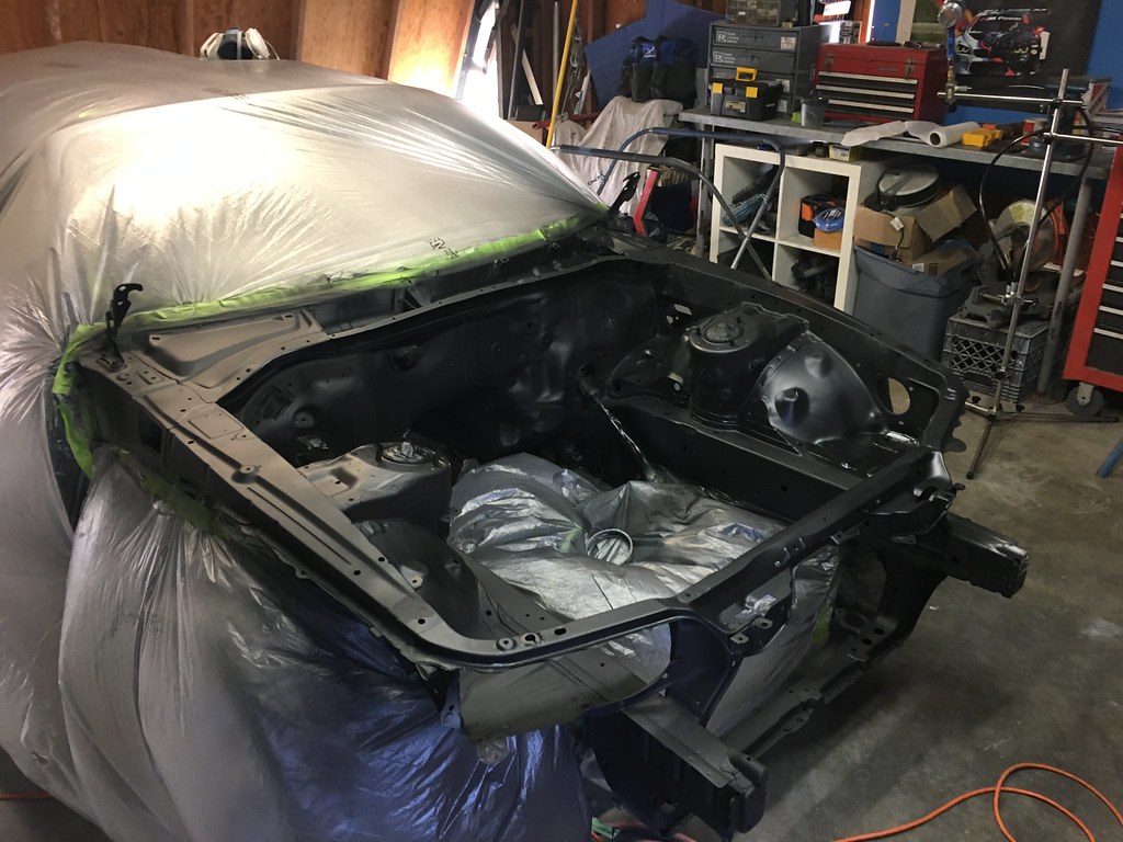

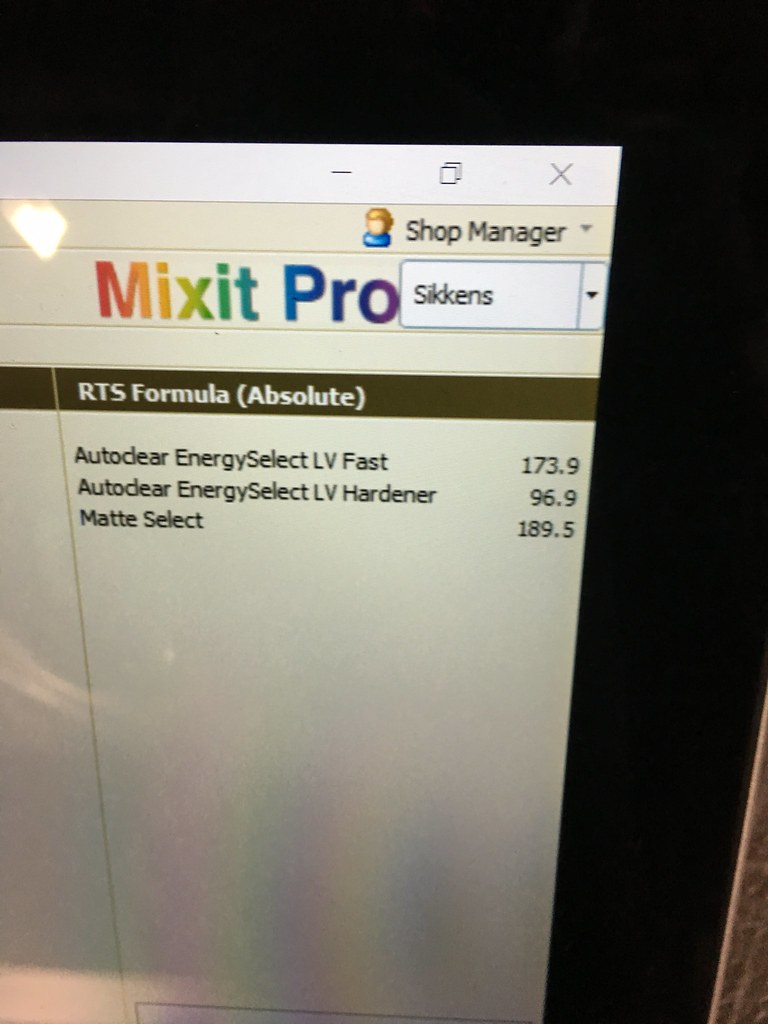

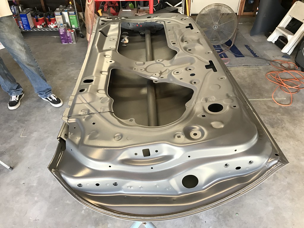

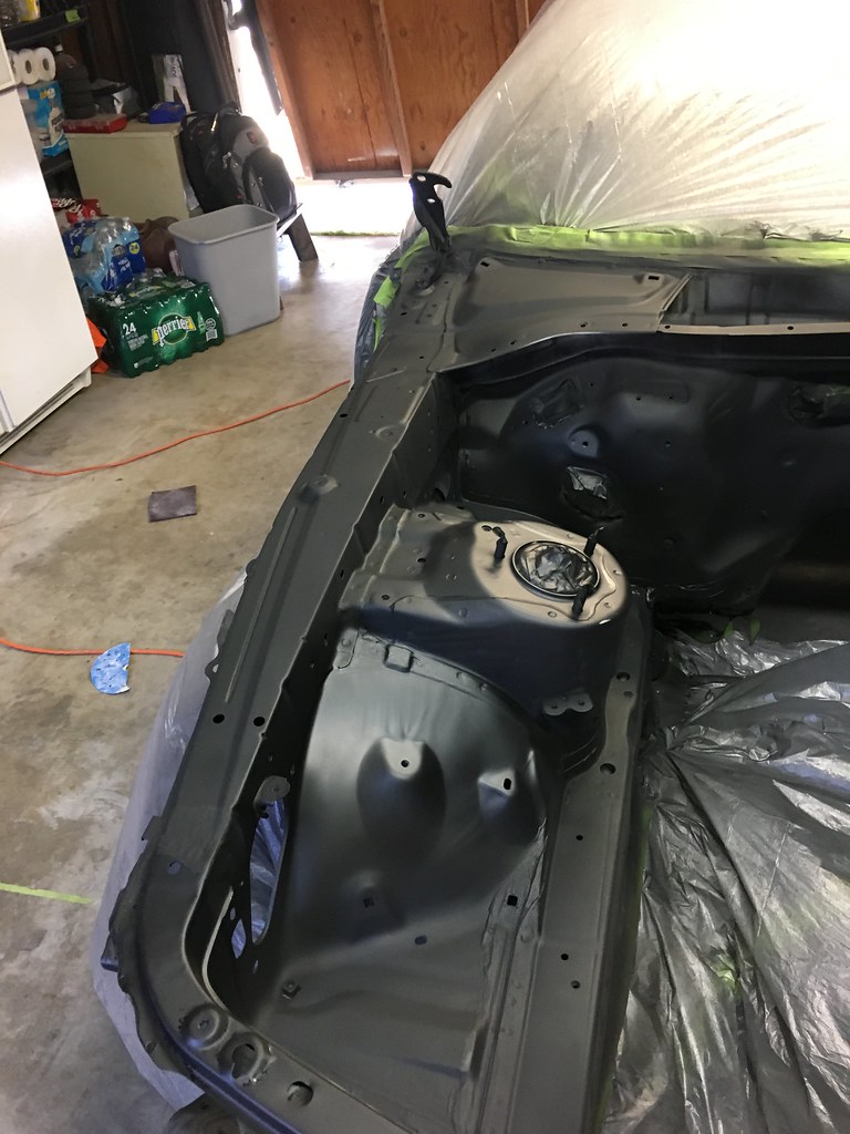

A matte finish was used in the engine bay to replicate the OEM finish.

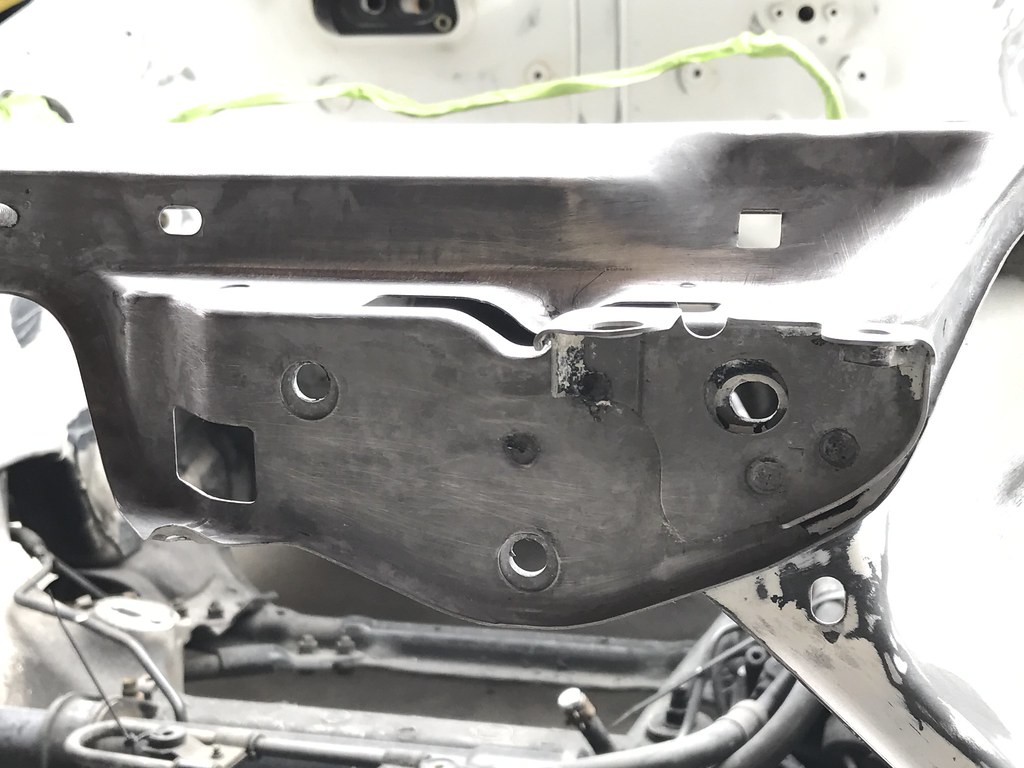

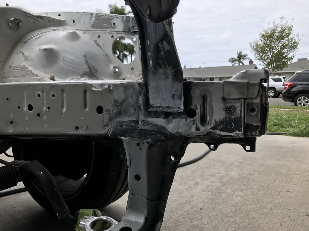

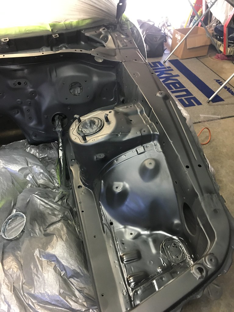

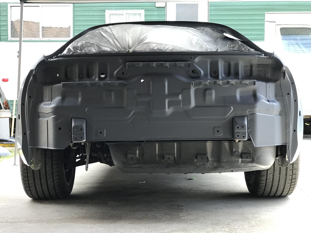

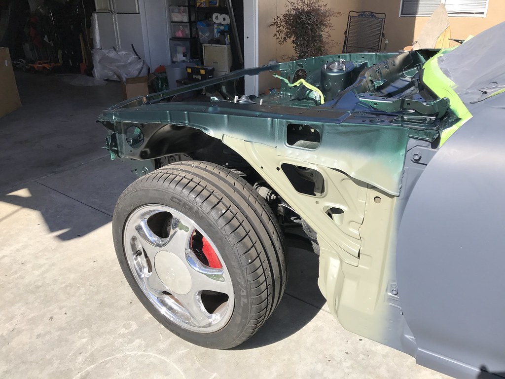

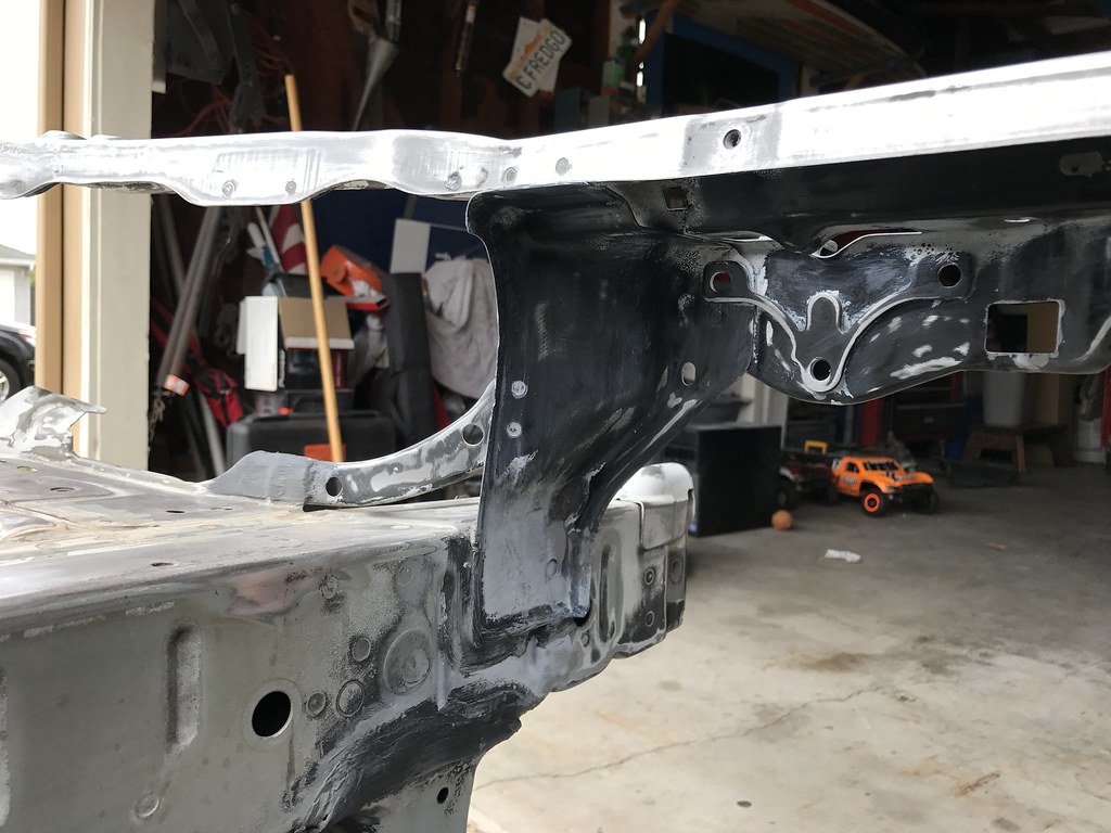

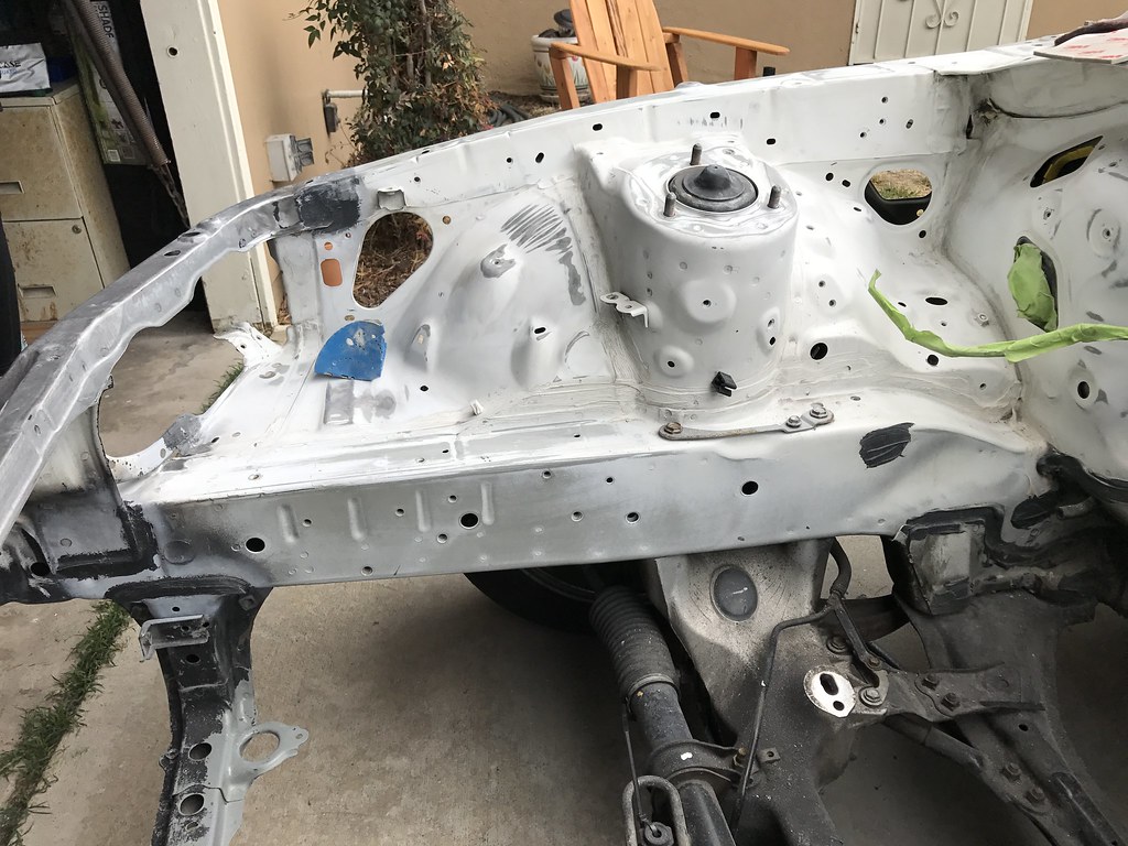

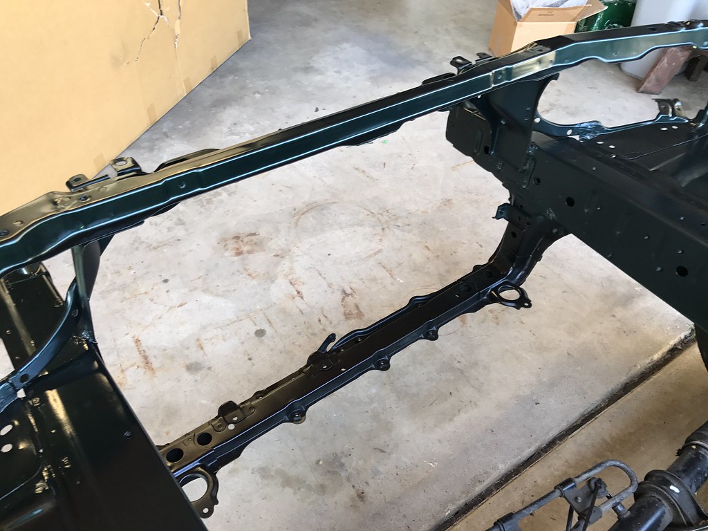

From the Toyota factory, all unpainted metal comes with a tannish coating that is often left showing in certain sections, say for example, behind the fenders. In order to get the most OEM look possible, that tan coating was redone before the paint layers.

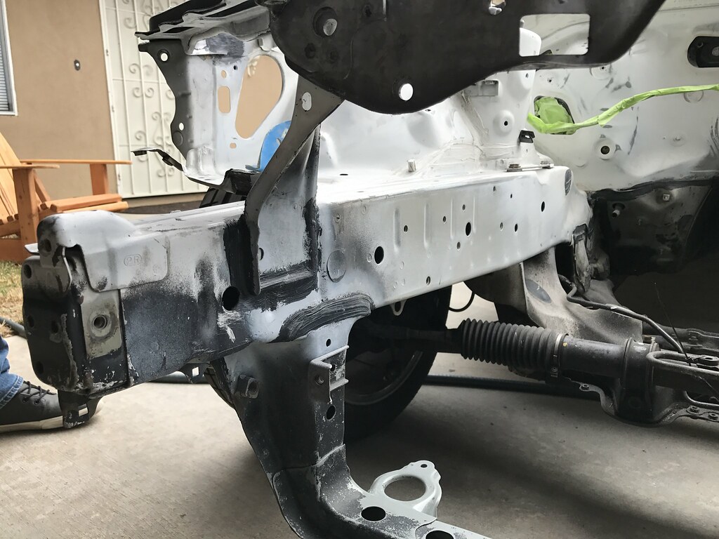

The lower tie bar where the radiator sits was done in flat black.
Excuse the hand and finger prints, those were put there after drying, not permanent whatsoever. There's also a bit of dust that settled once the car was dried and rolled outside, also, not in the paint, wipes right off.

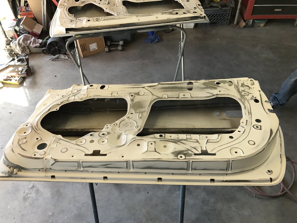

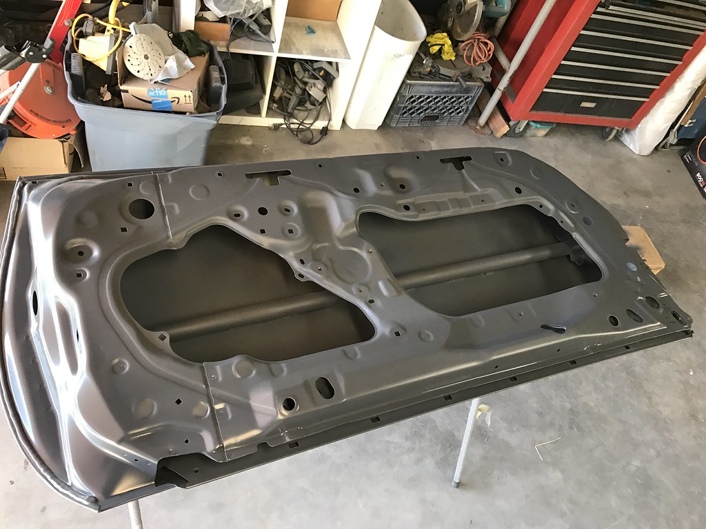

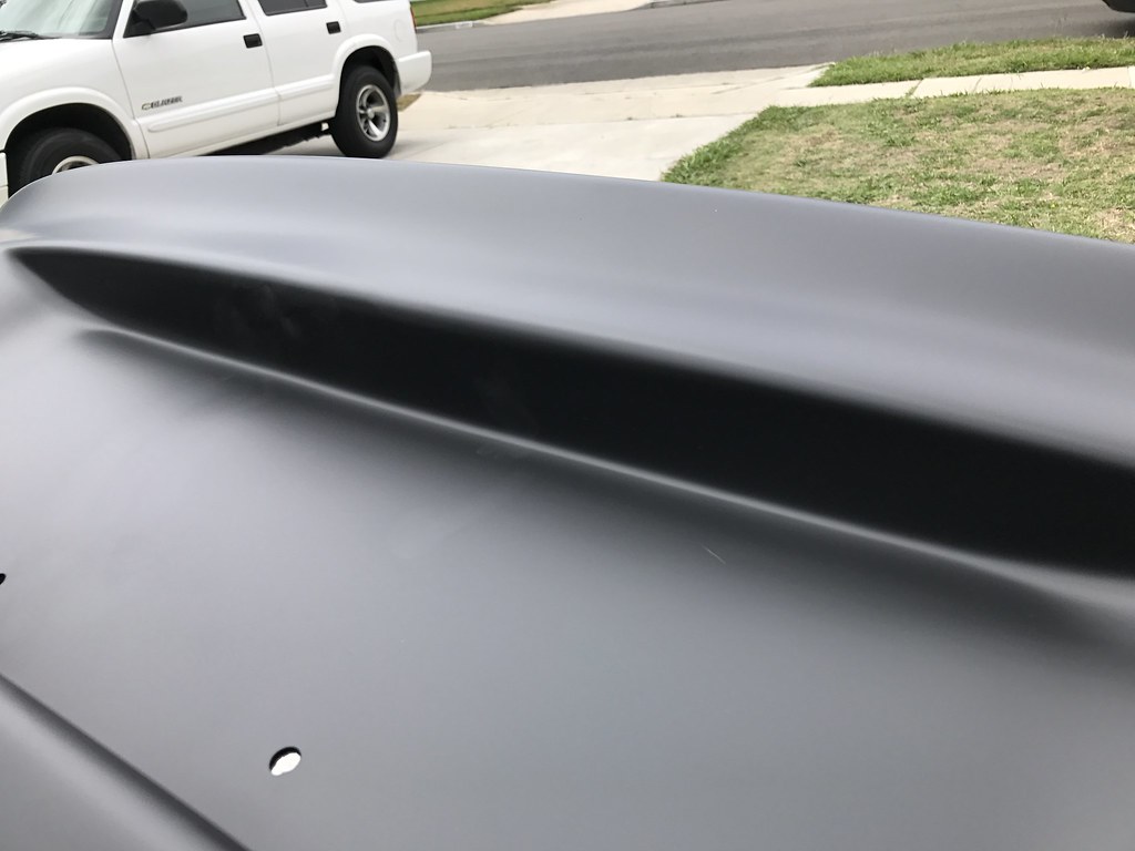

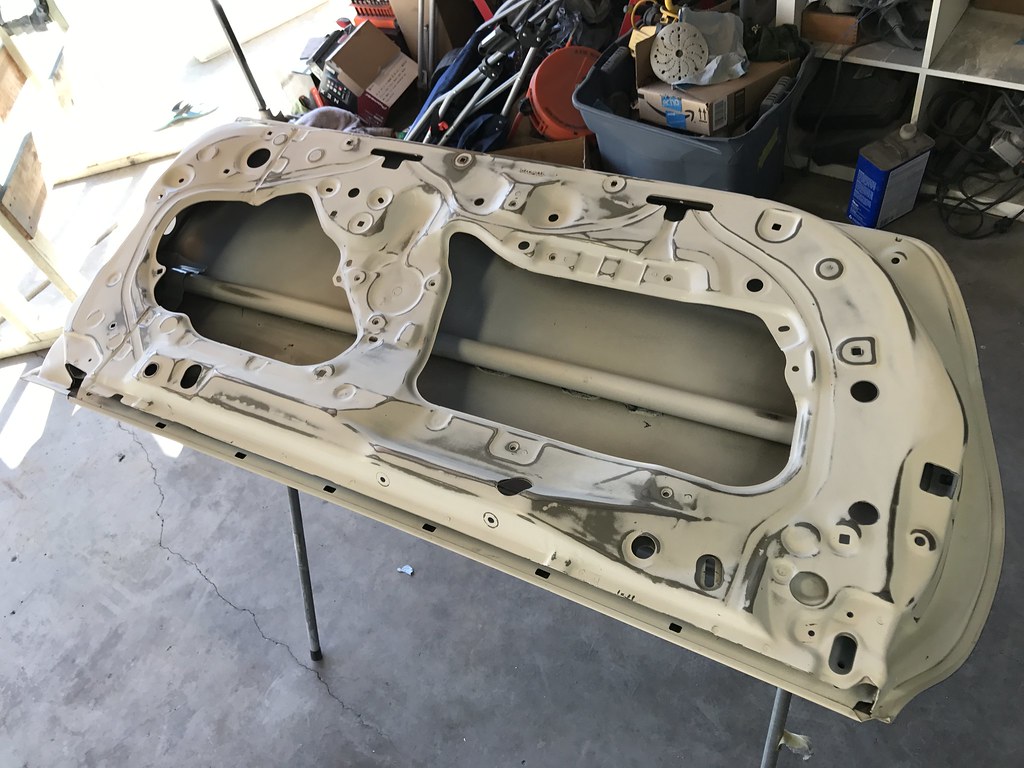

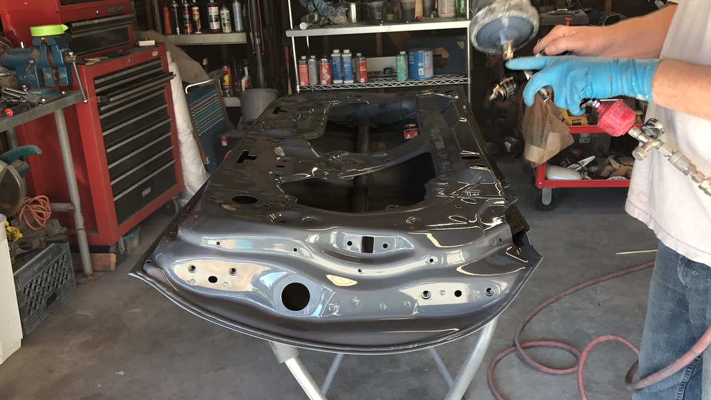

Next will be the underside of the hood, which will also be done in Matte. We'll then move onto jamming the targa, doors, and hatch in gloss IJM.

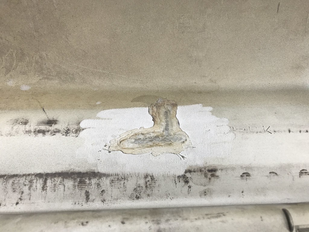

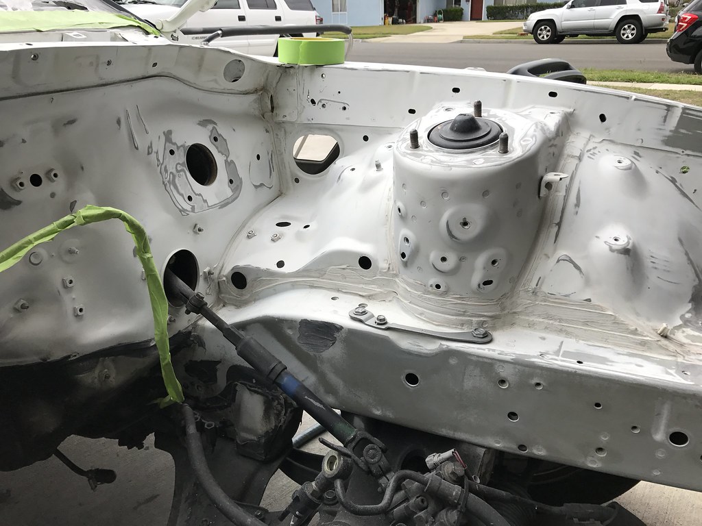

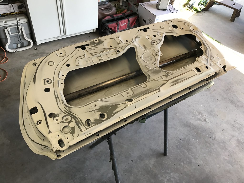

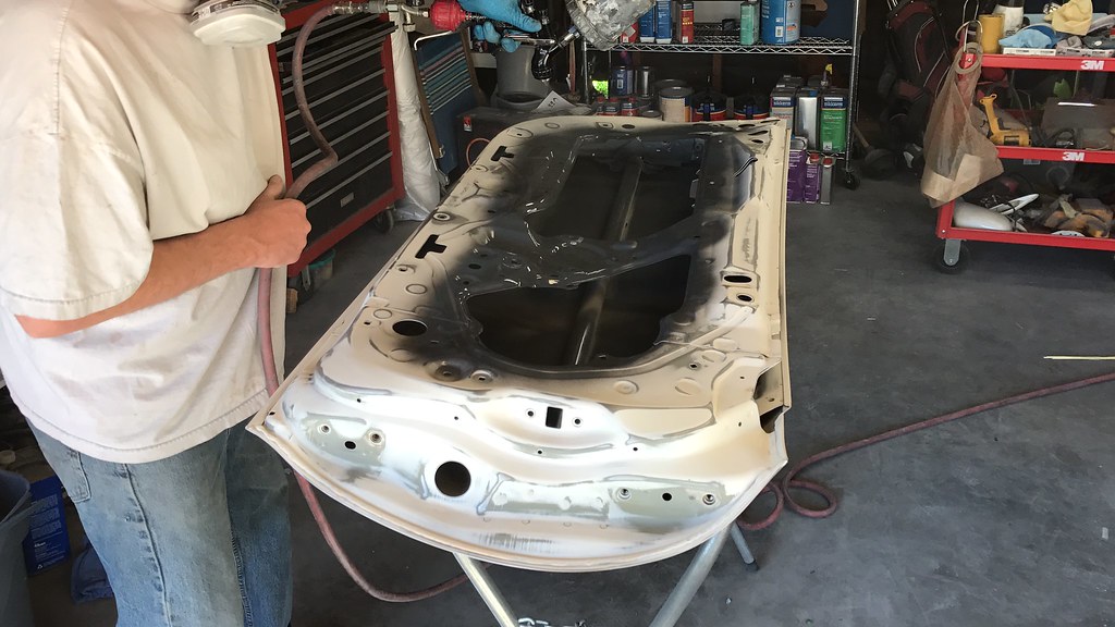

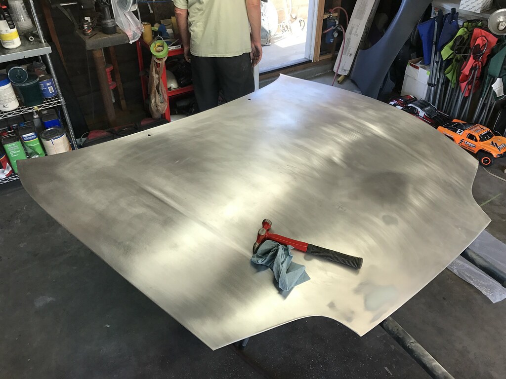

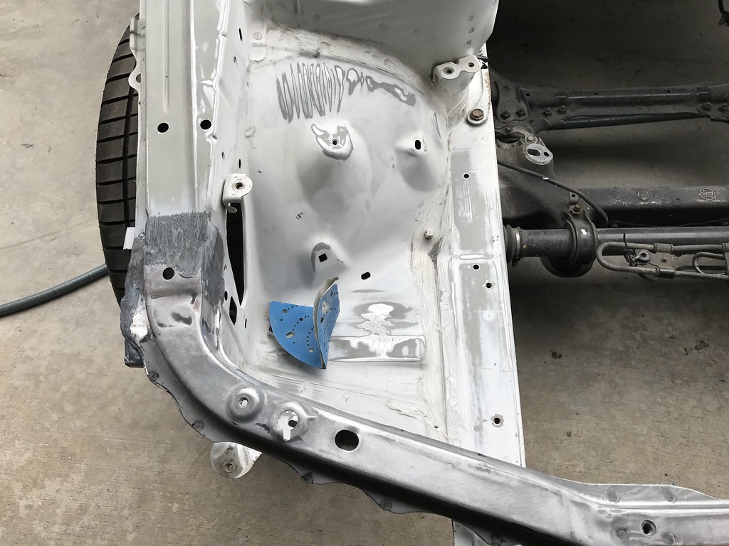

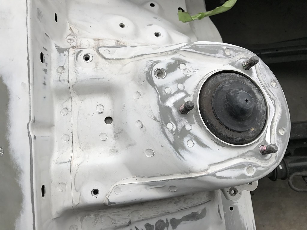

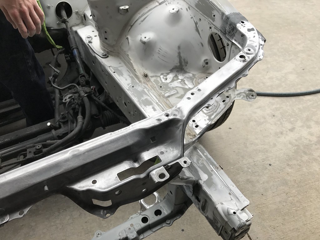

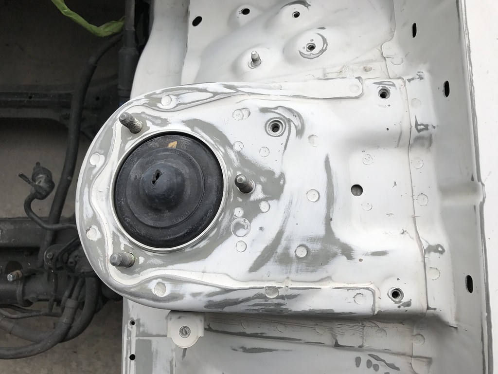

The hood was stripped to bare metal and most of the dings were metal finished. Minimal filler was needed where some dings were inaccessible from the underside.
