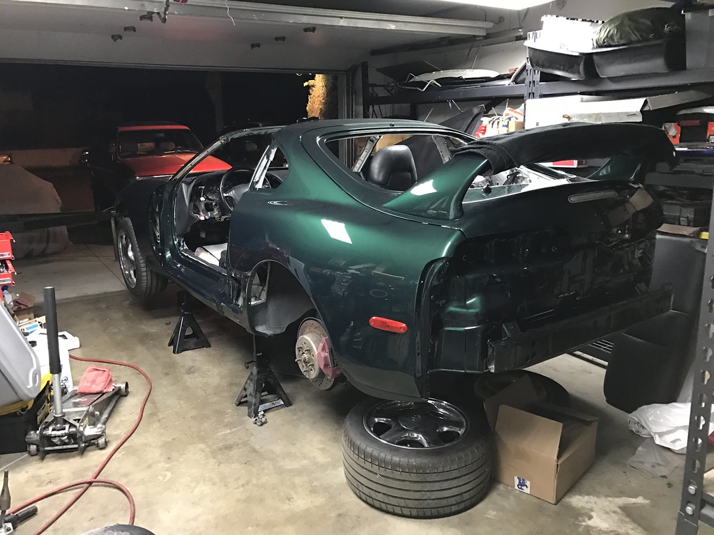

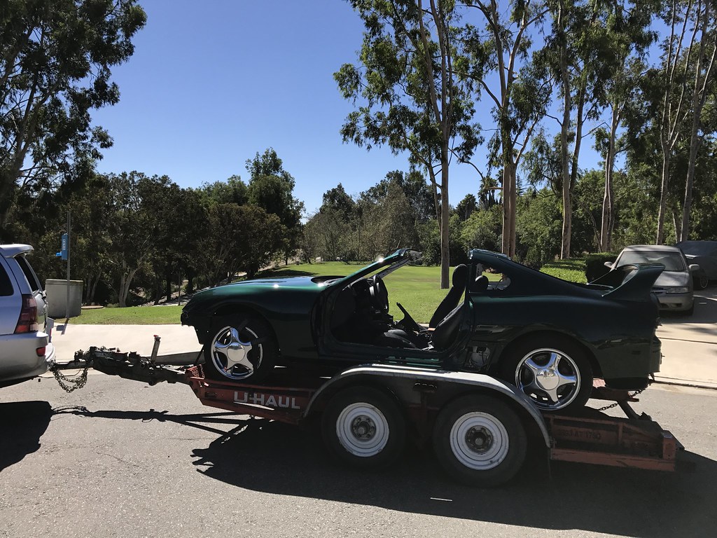

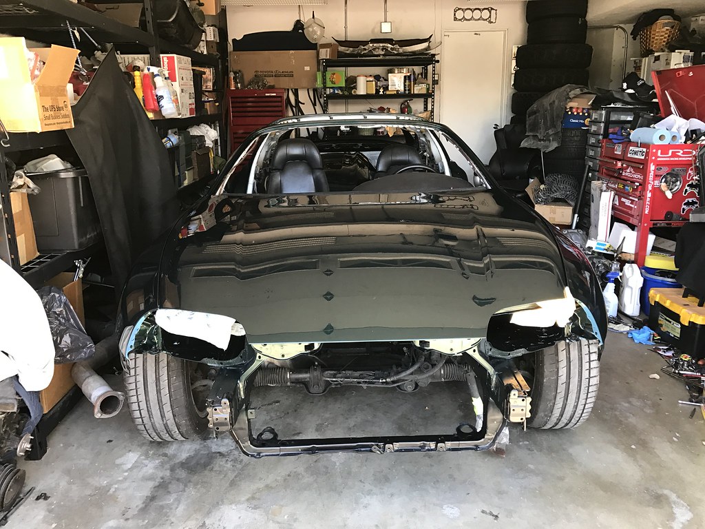

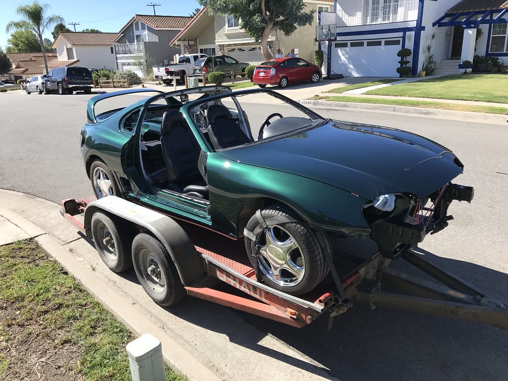

In anticipation of the car coming home, reality set in on the glass situation.

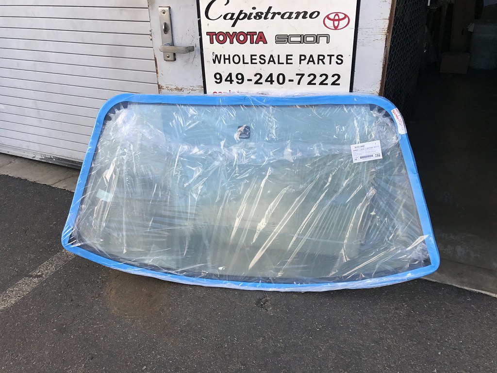

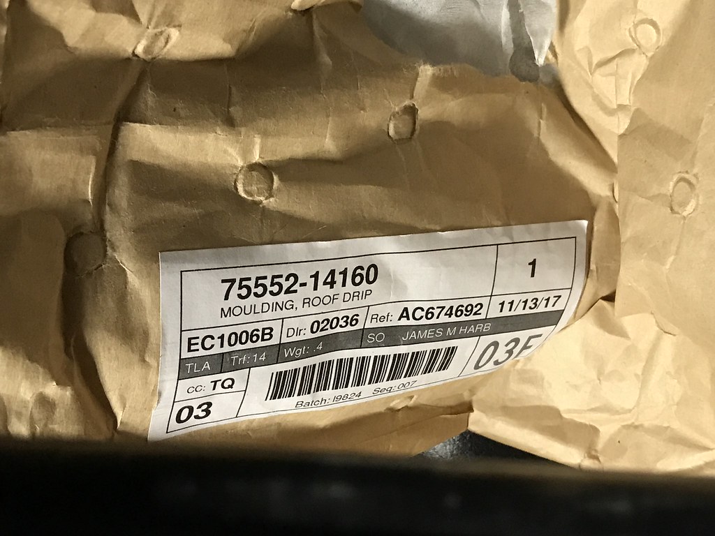

The front windshield was not original, and broke upon removal anyway, so that was a no brainer. Got a new one from Toyota.
The original rear windshield was scratched and the defroster grid was not functional. One new one left in the country, I got it. Packaging was supreme!

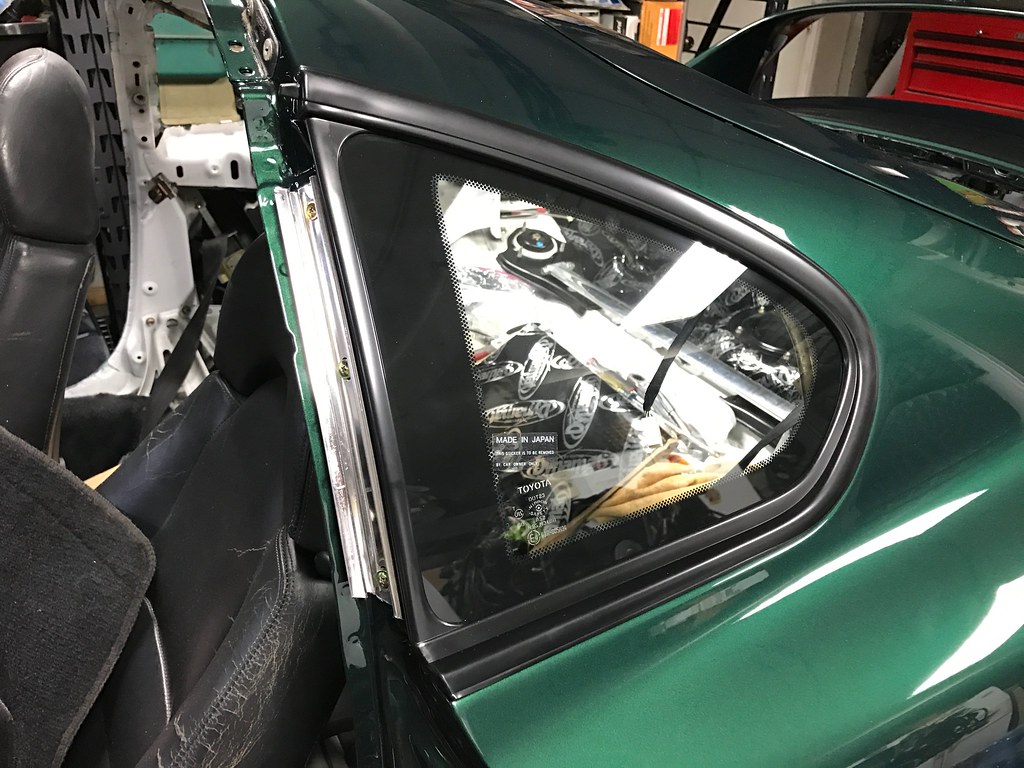

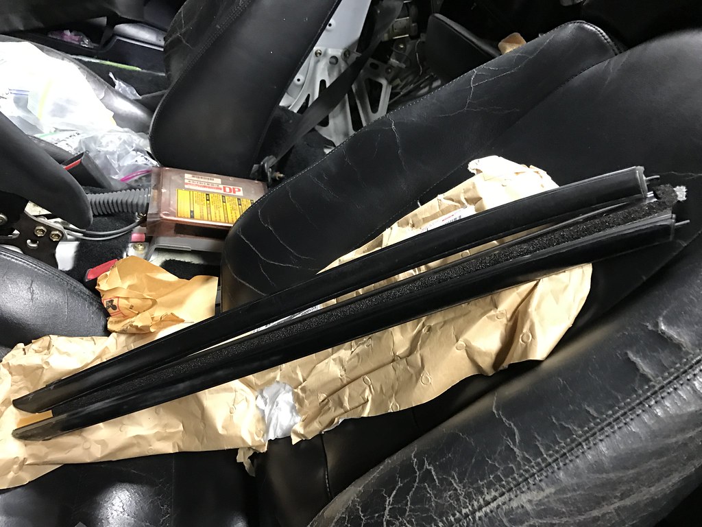

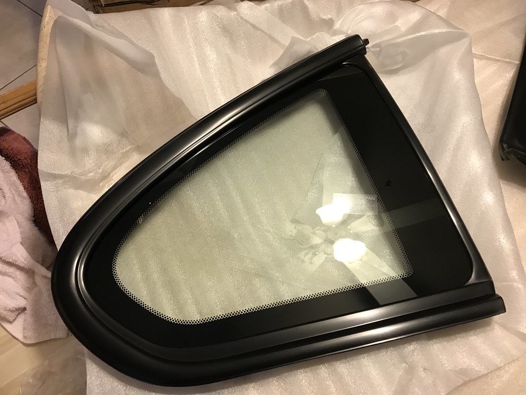

The original quarter window trims lost their luster many moons ago, looking quite out of place against the new trim targa and door trim pieces. I found a set of both quarter windows new from eBay, even the discontinued right hand side.

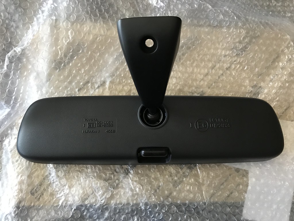

New rear view mirror

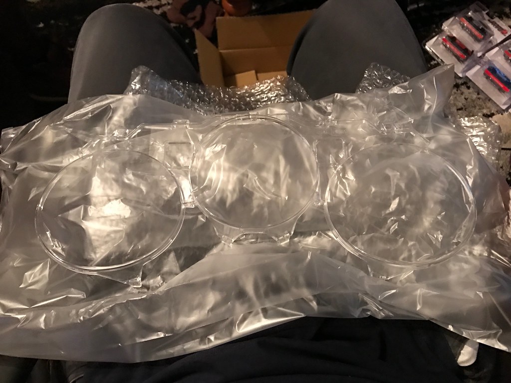

The instrument cluster "glass"

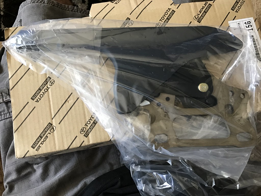

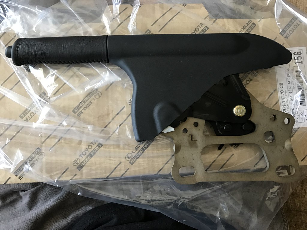

New e-brake handle

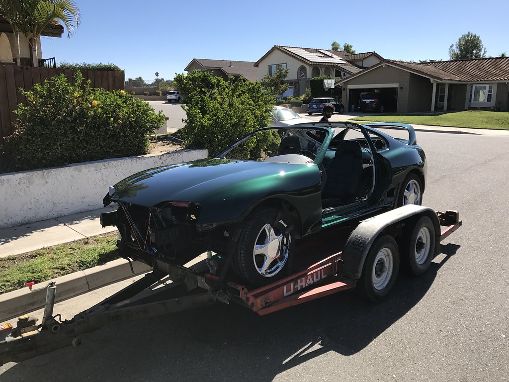

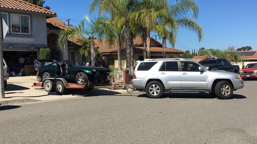

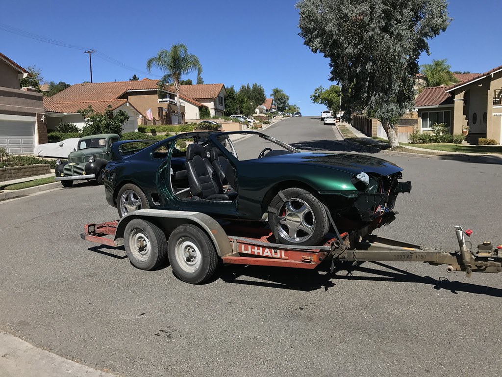

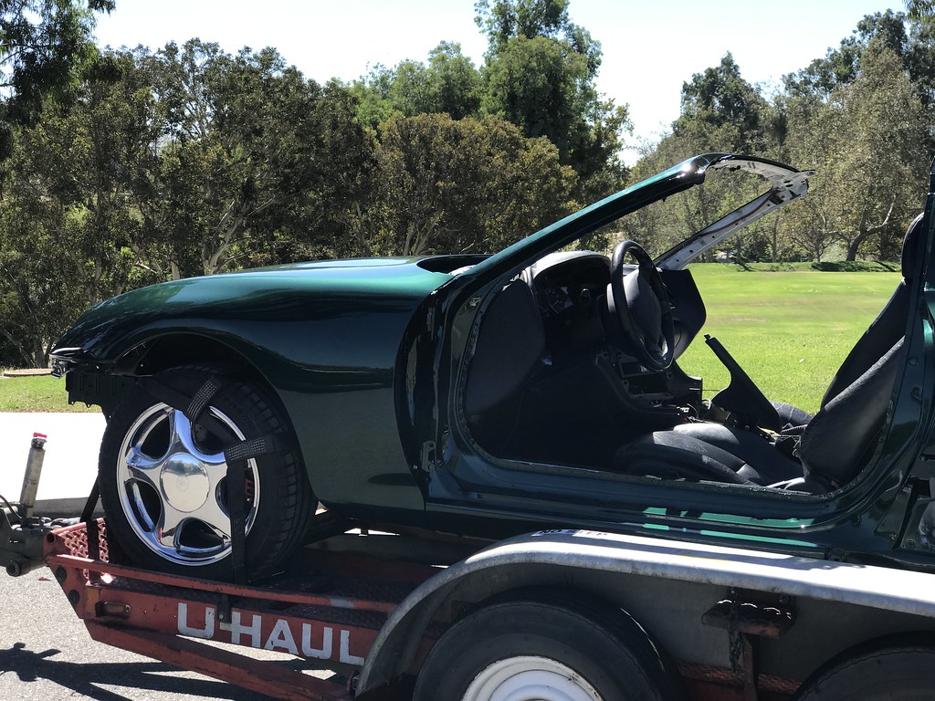

Time to take her home (her dizzy head is conscience laden)
Some parts to wait until later.

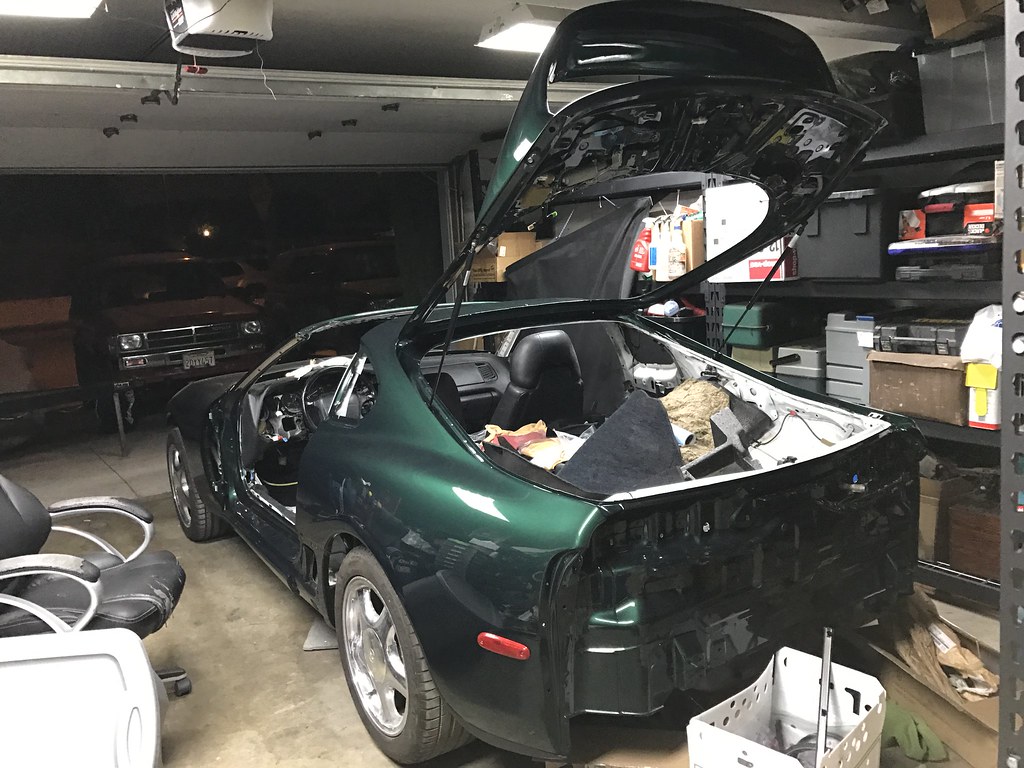

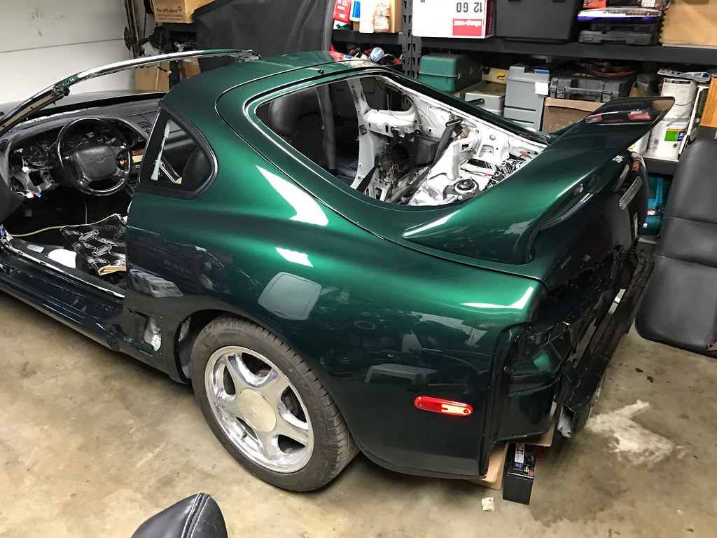

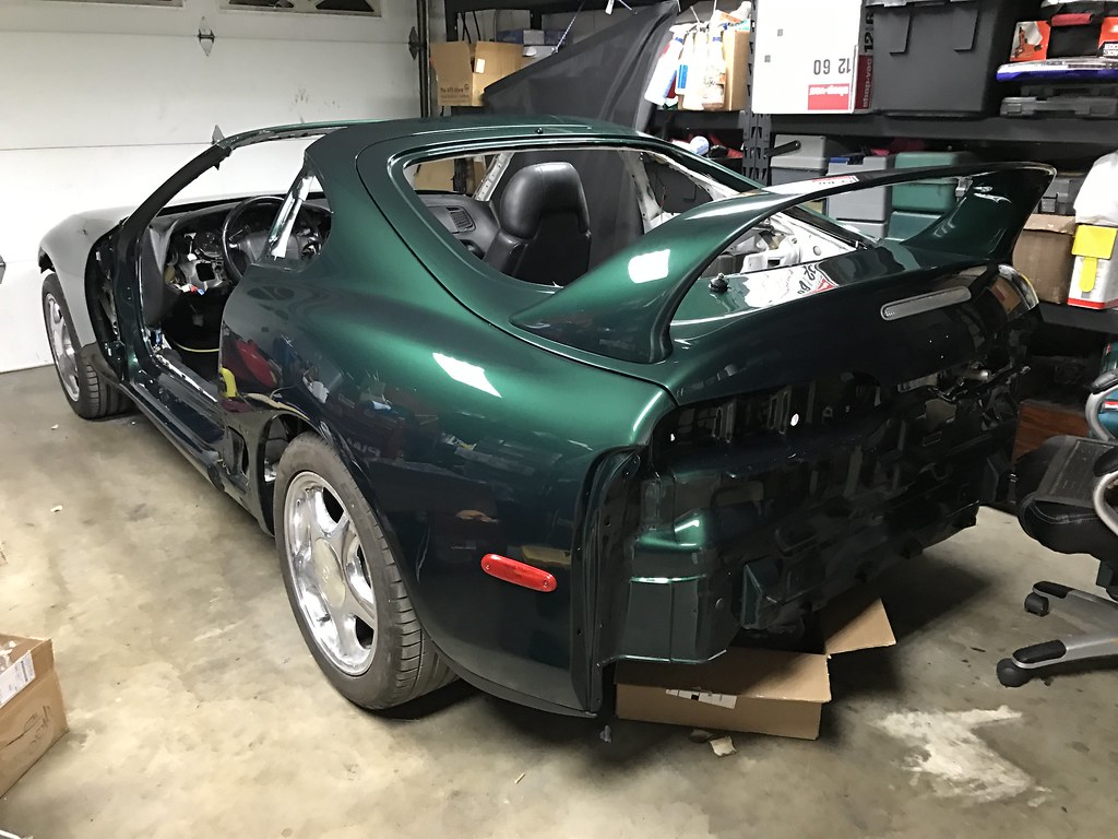

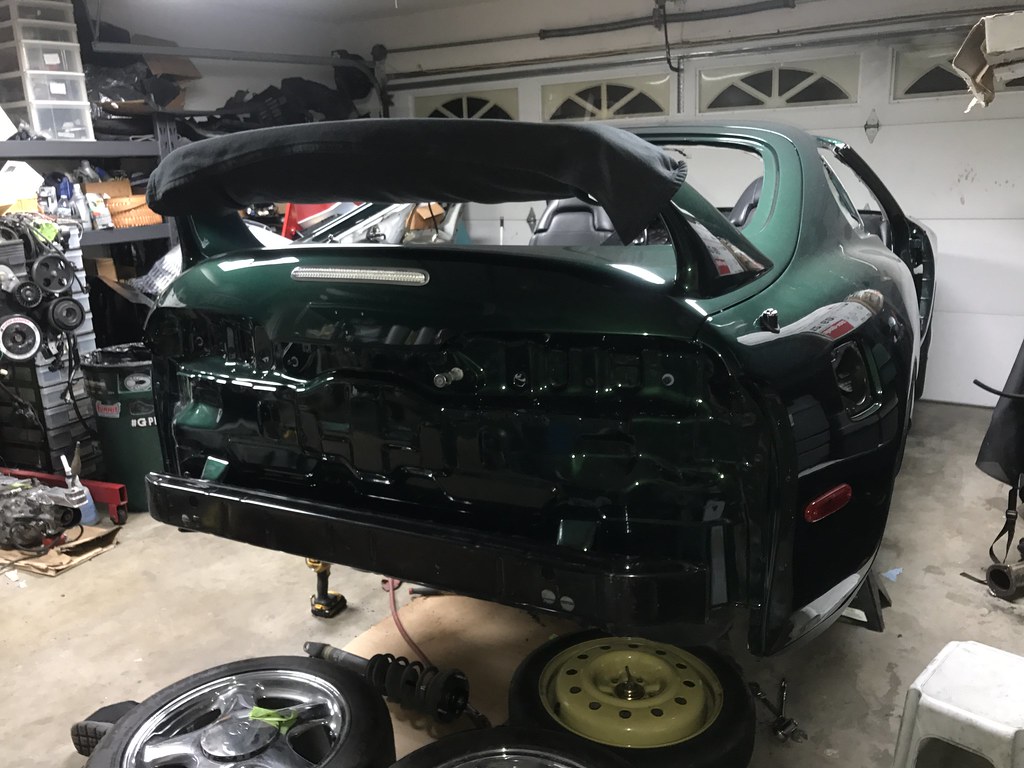

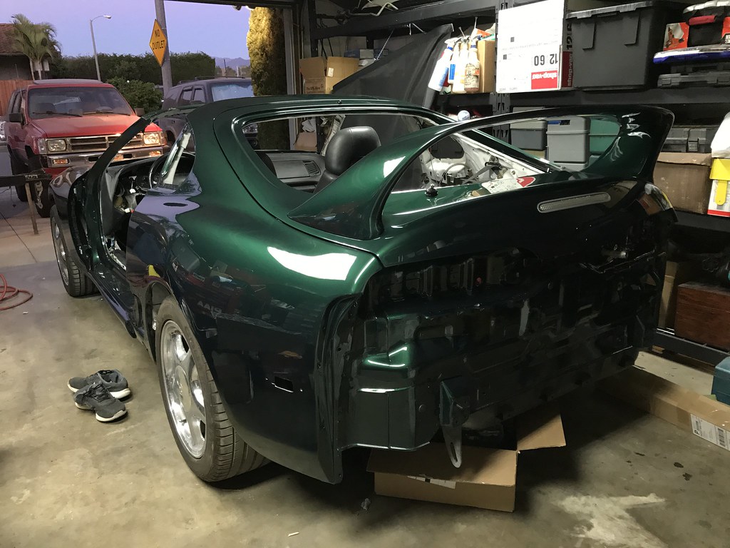

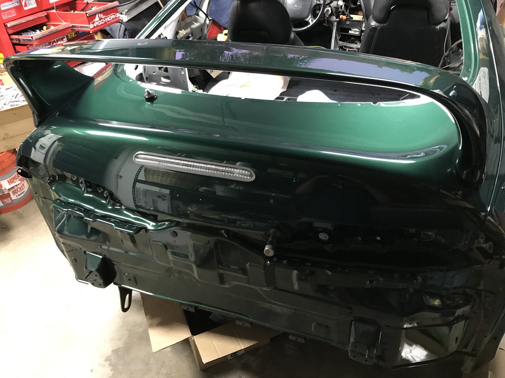

Lets start with the rear of the car.

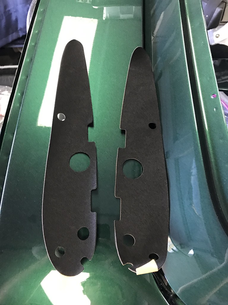

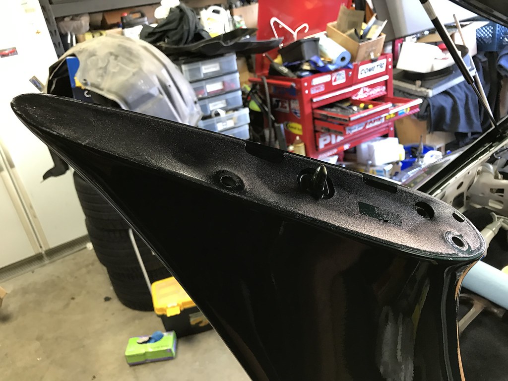

Spoiler gaskets
New rear mister spray nozzle

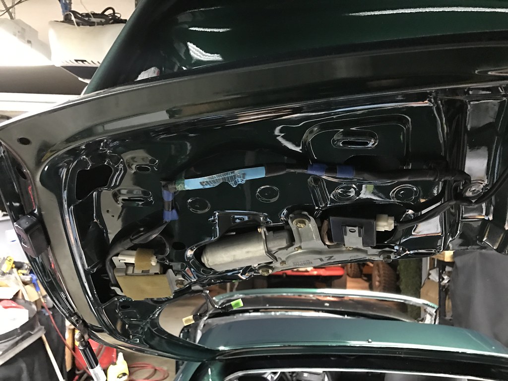

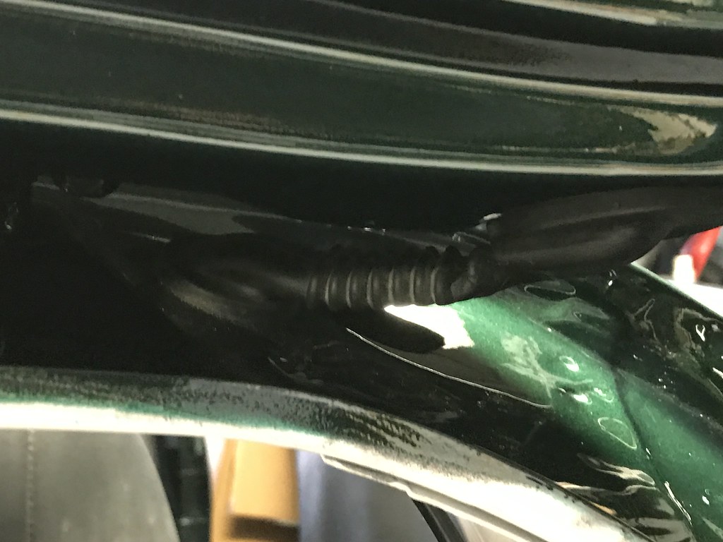

Hatch wiring reinstalled and grommets cleaned
Rear wiper motor, tail light, and lock cylinder installed.

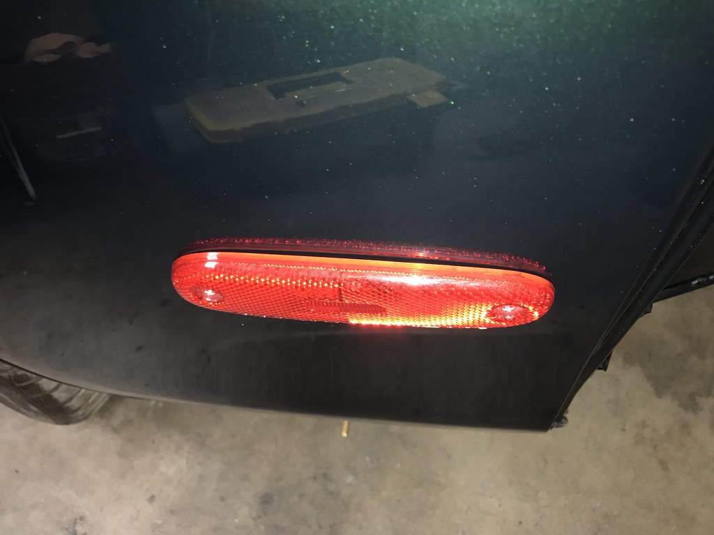

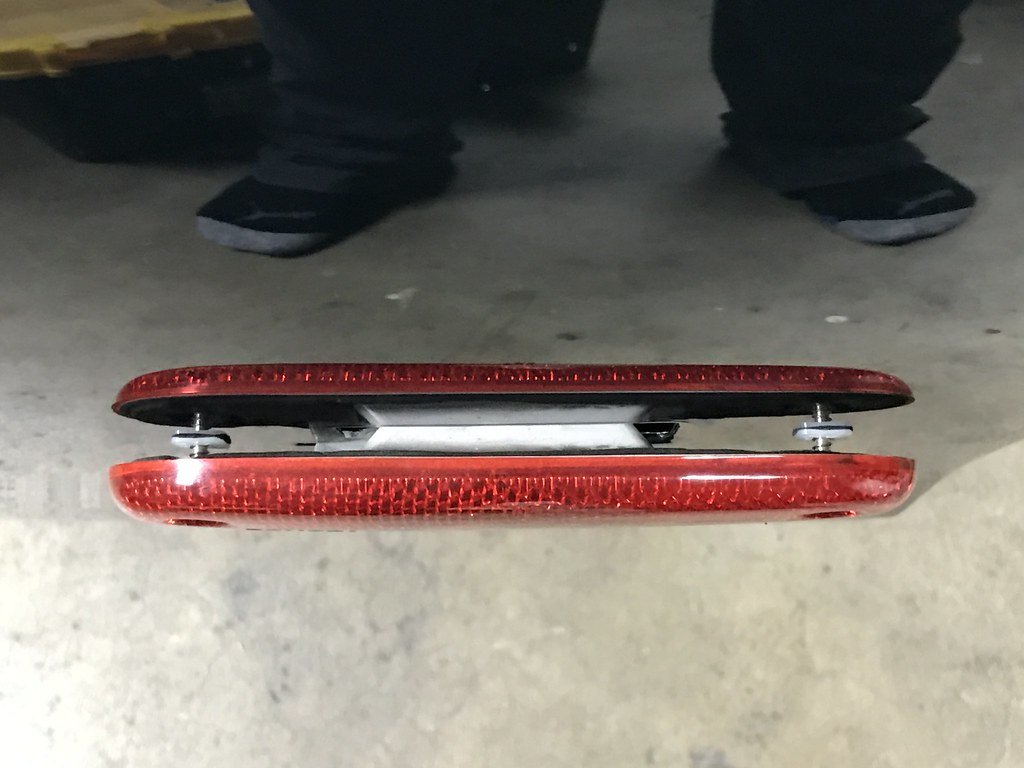

Marker lamp screw grommets installed, light on

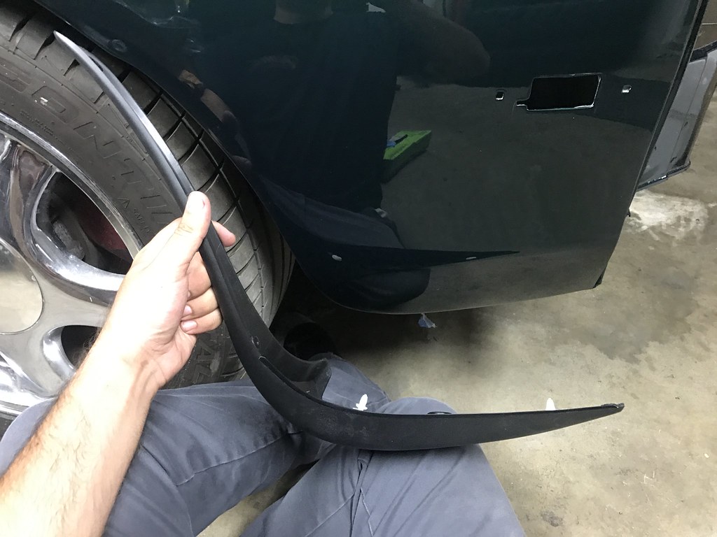

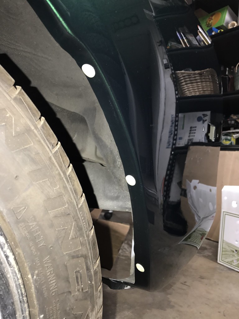

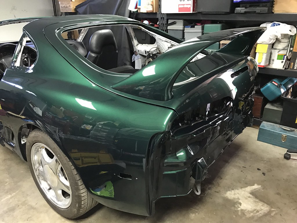

Rear spat mounting
Look at those brand new hatch struts in action!! :D

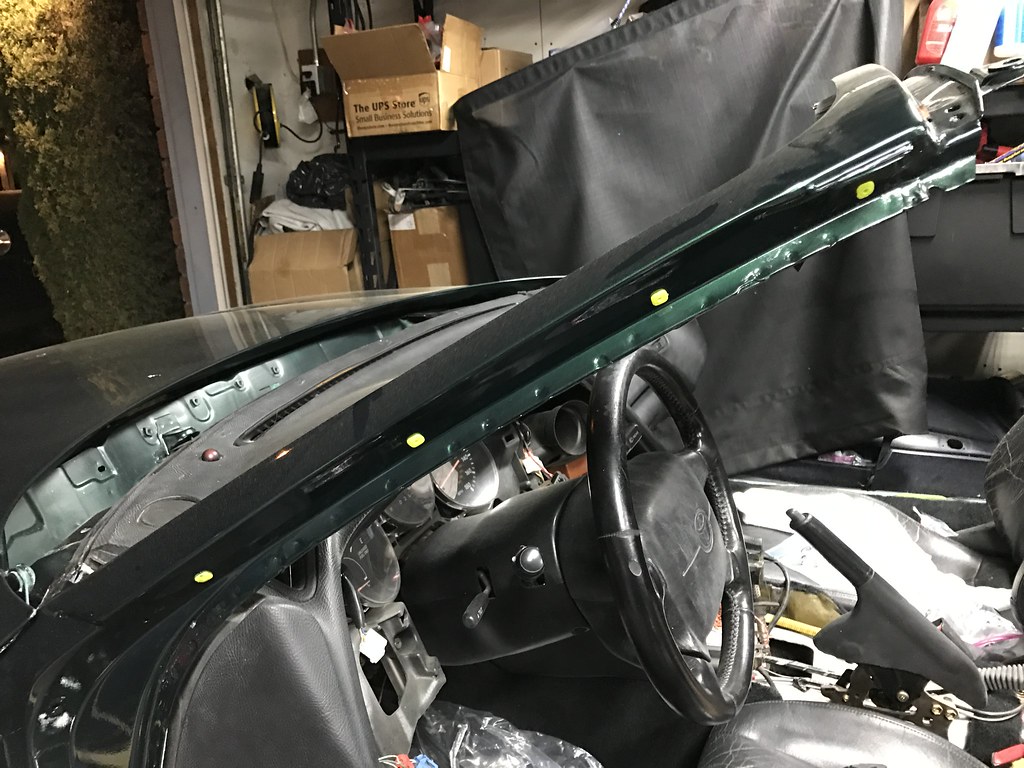

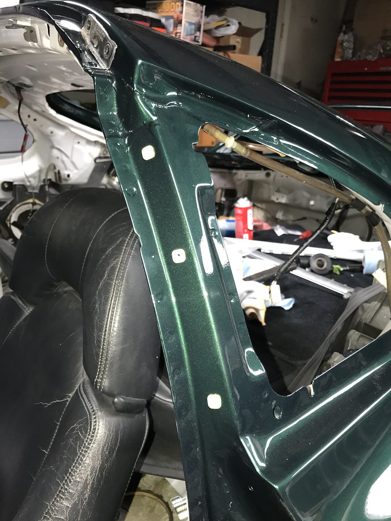

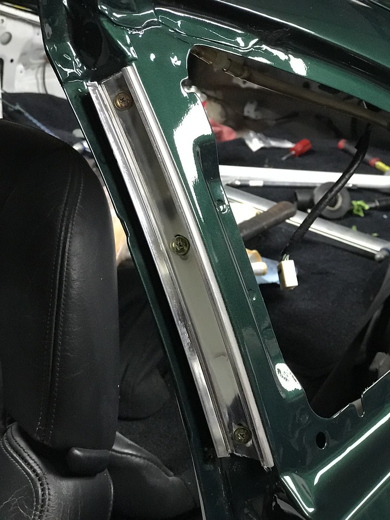

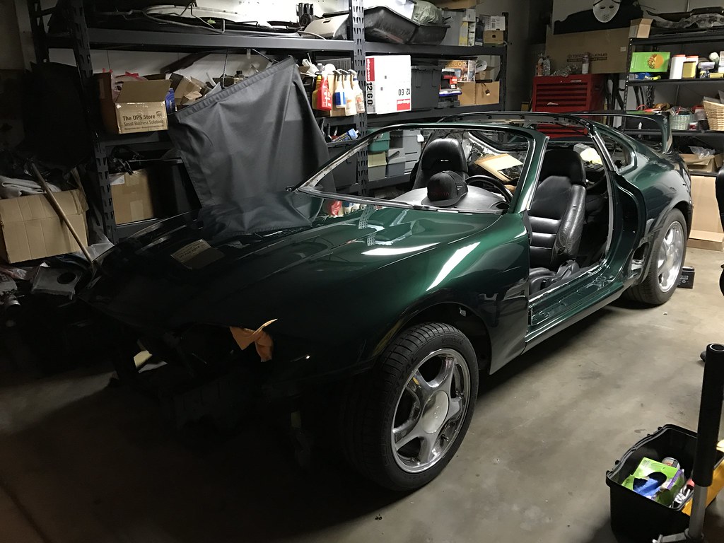

B pillar seal retainer and grommets
A pillar trim

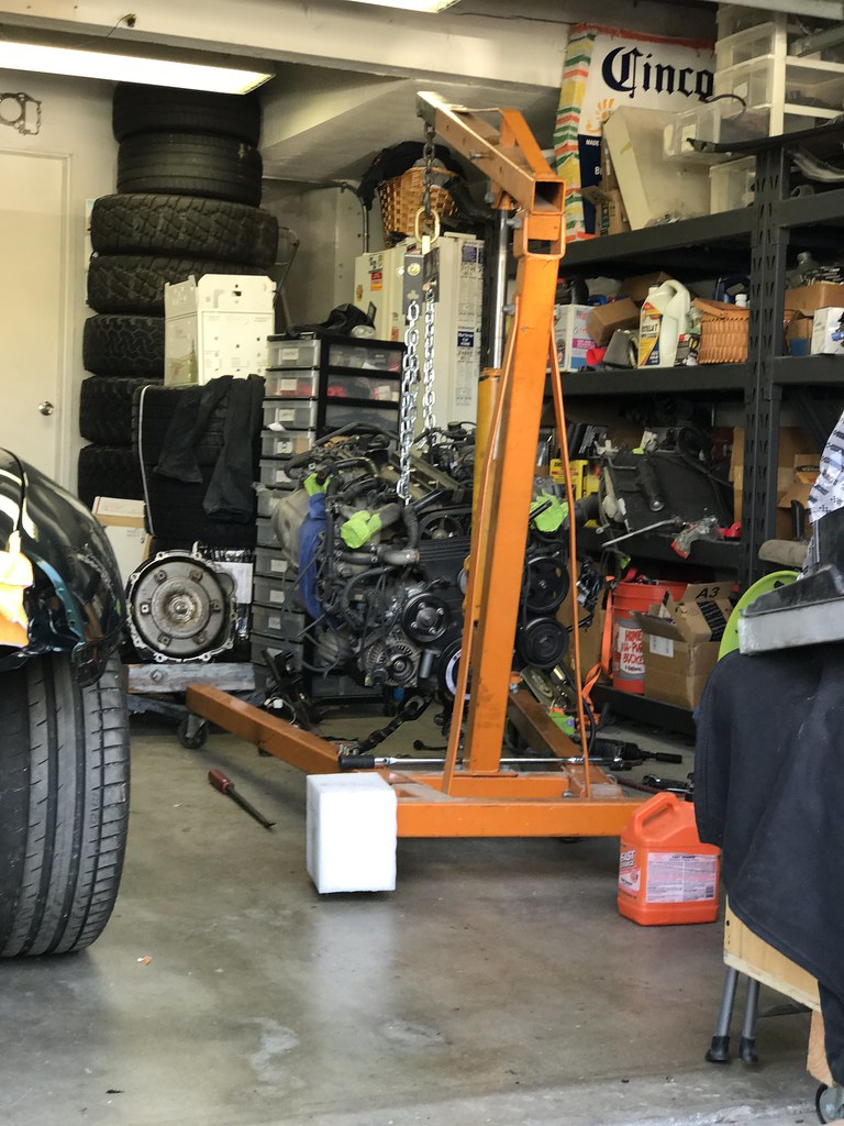

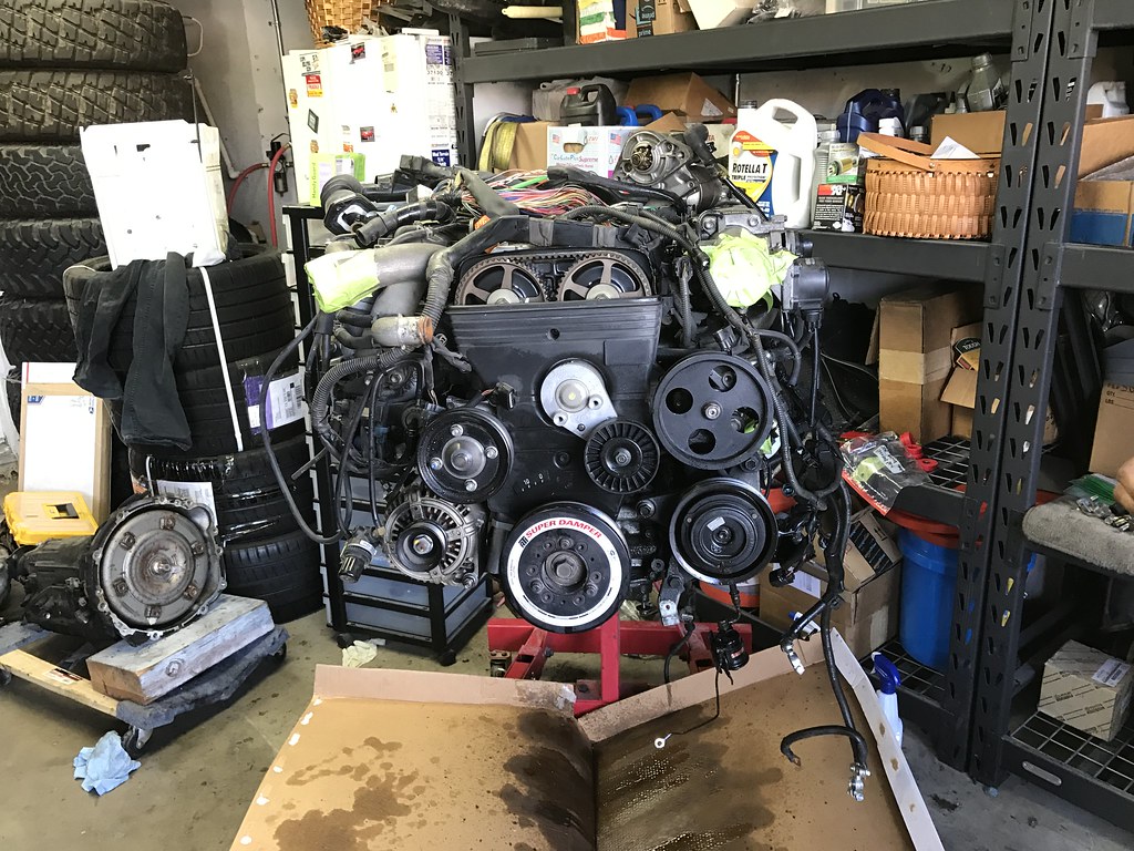

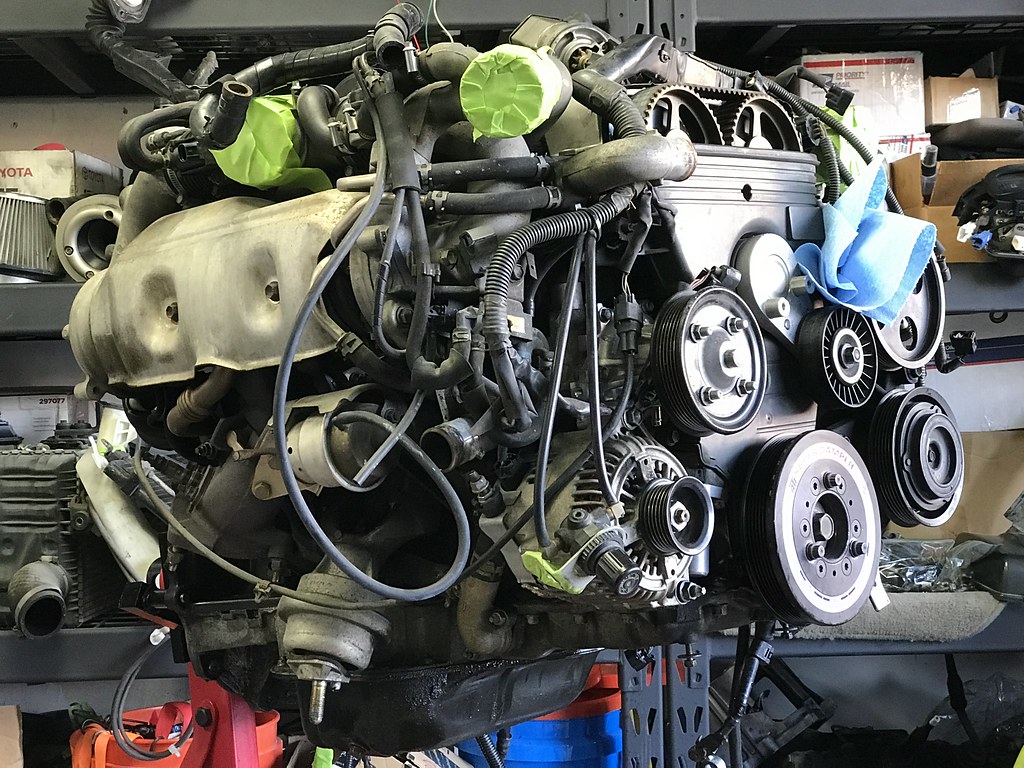

2JZ-GTE divorced from the automatic it was mated to years ago

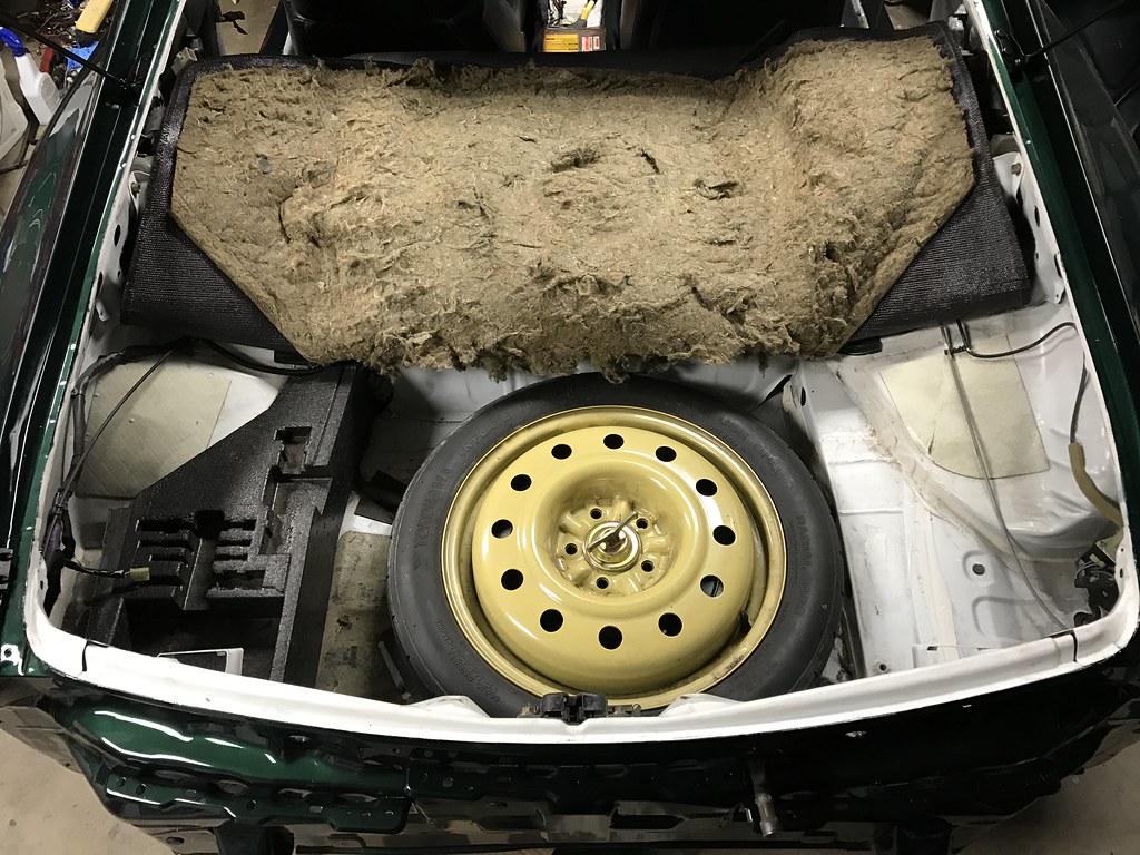

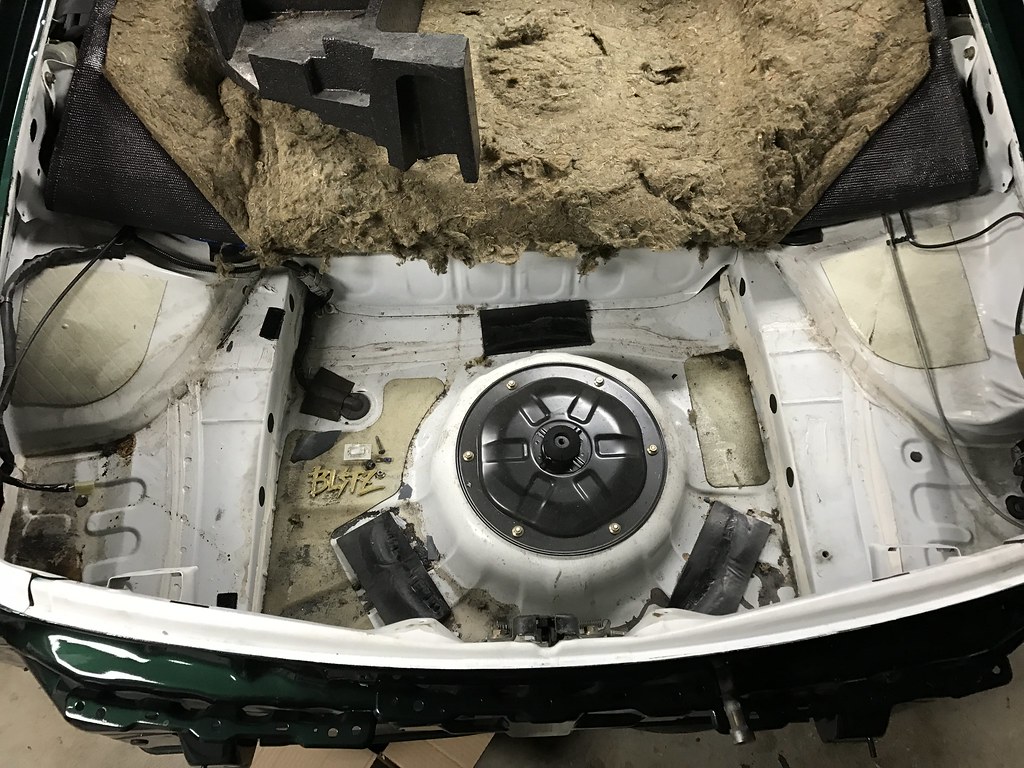

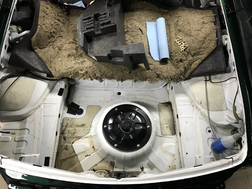

Definitely a lot of cleaning to be done, but that's for another time. Right now it's time for the chassis.

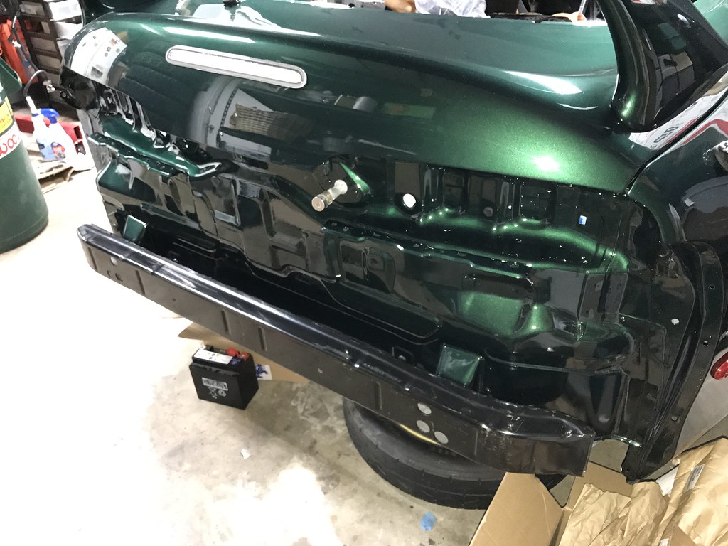

Rear crash bar

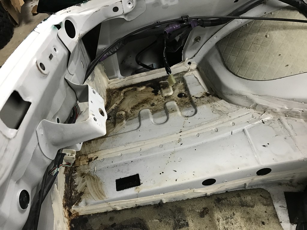

Hmmmmmmmmmm there's a lot of white still showing here...

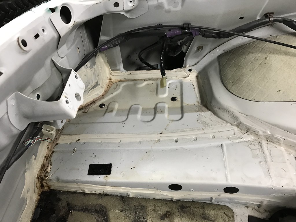

continued.

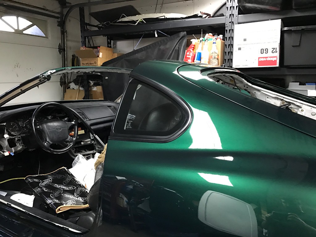

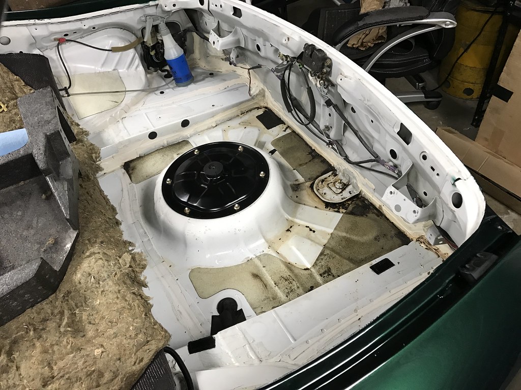

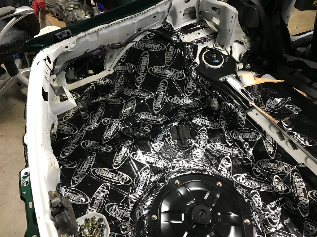

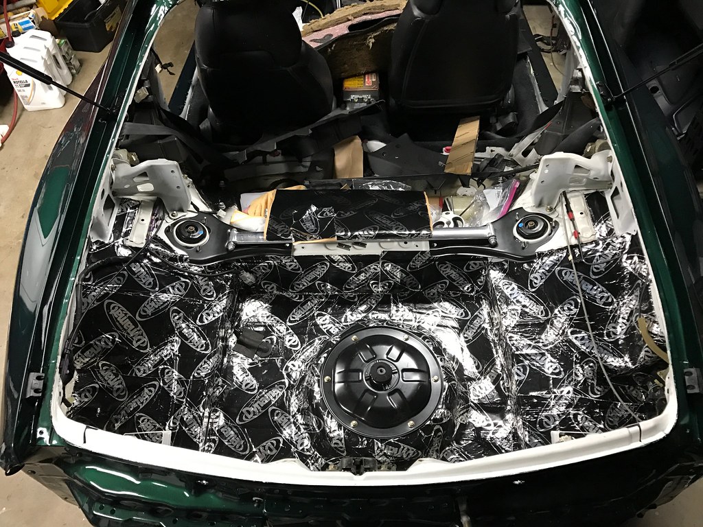

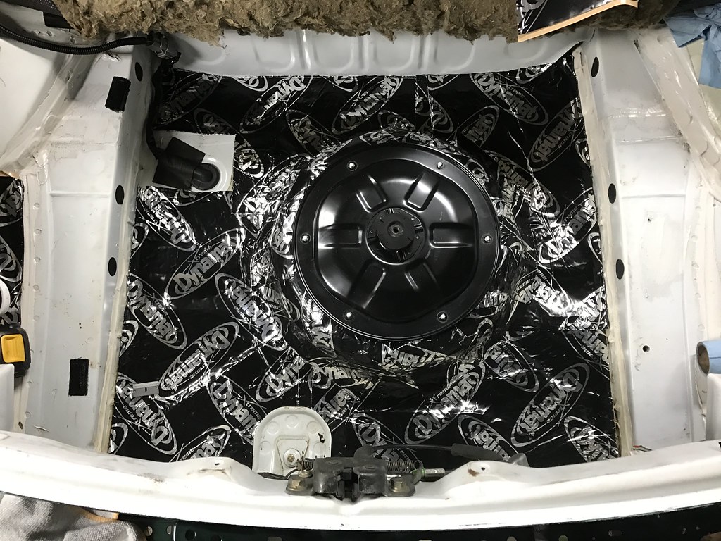

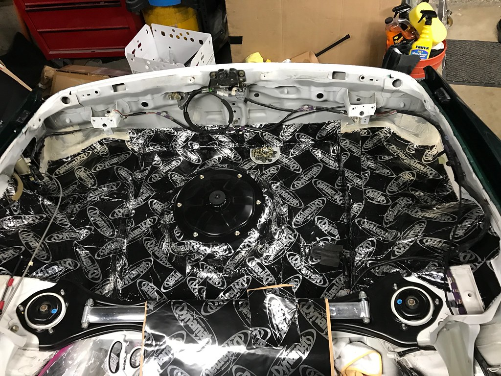

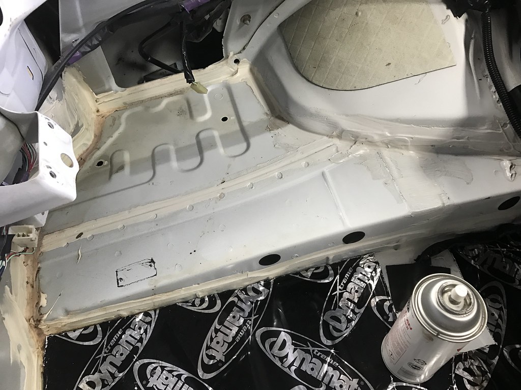

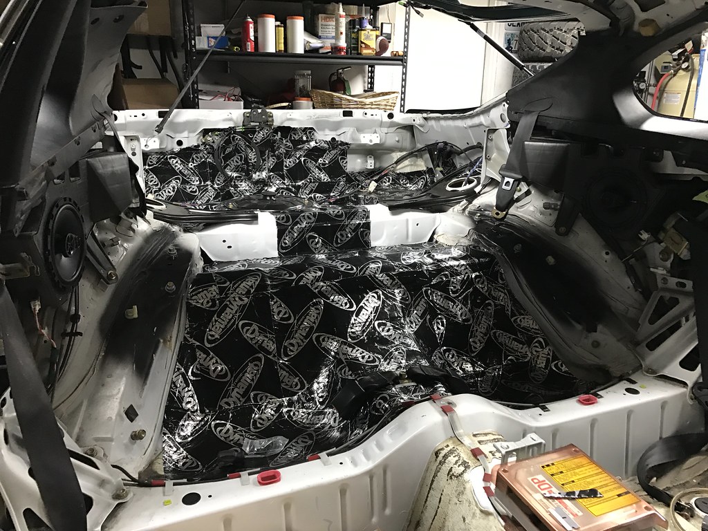

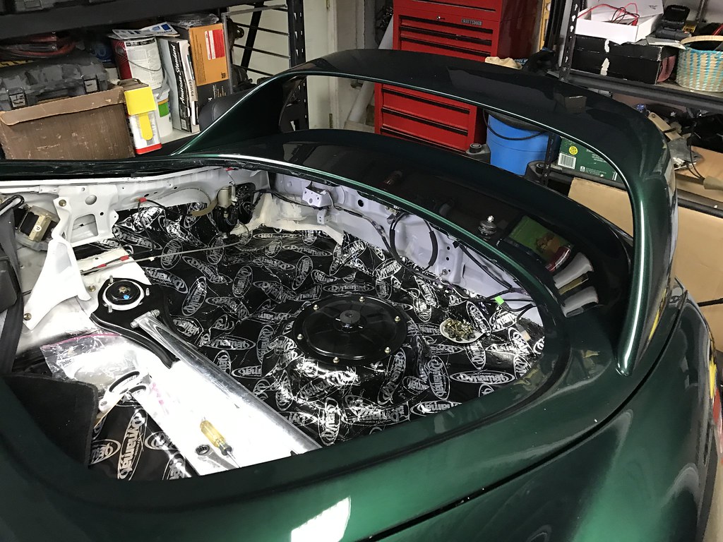

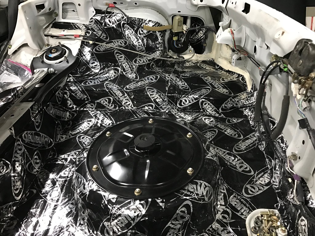

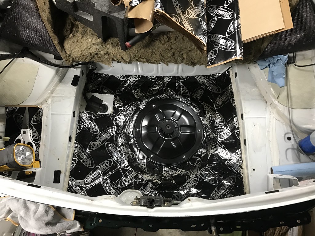

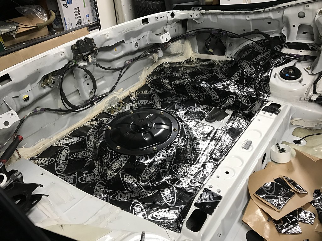

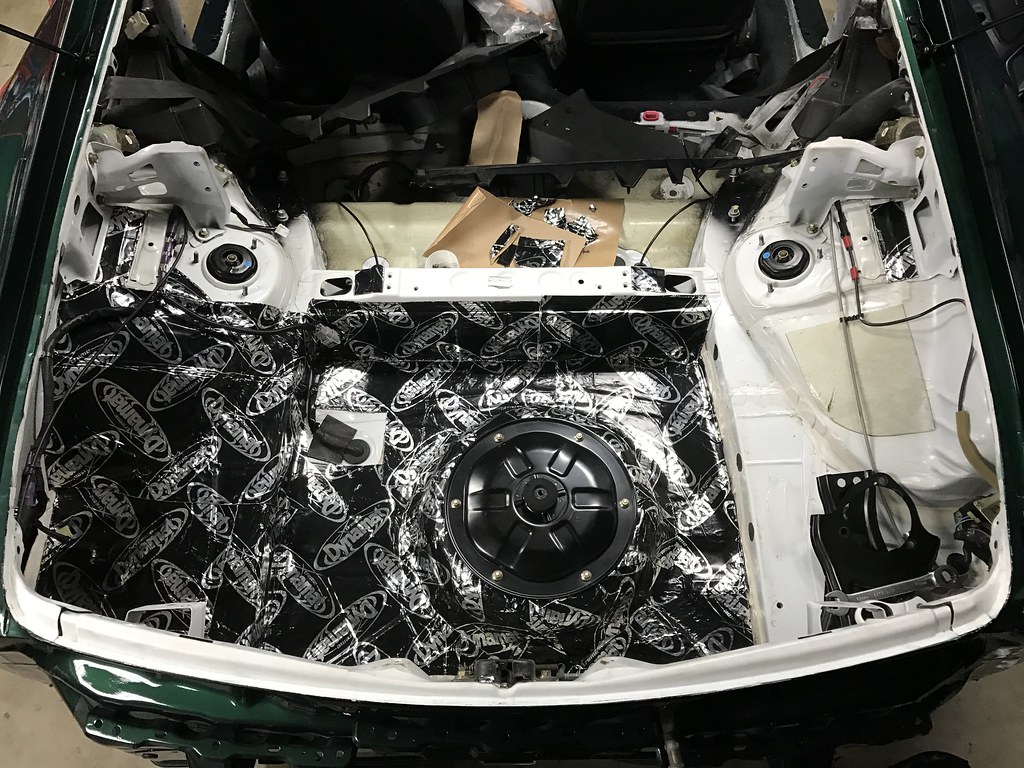

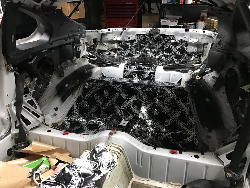

Dynamat Xtreme oughta help things out a bit.
Center done, left side next
Right side completed, as well as the insides of the quarter panels.
More Dynamat work to cover, later on!

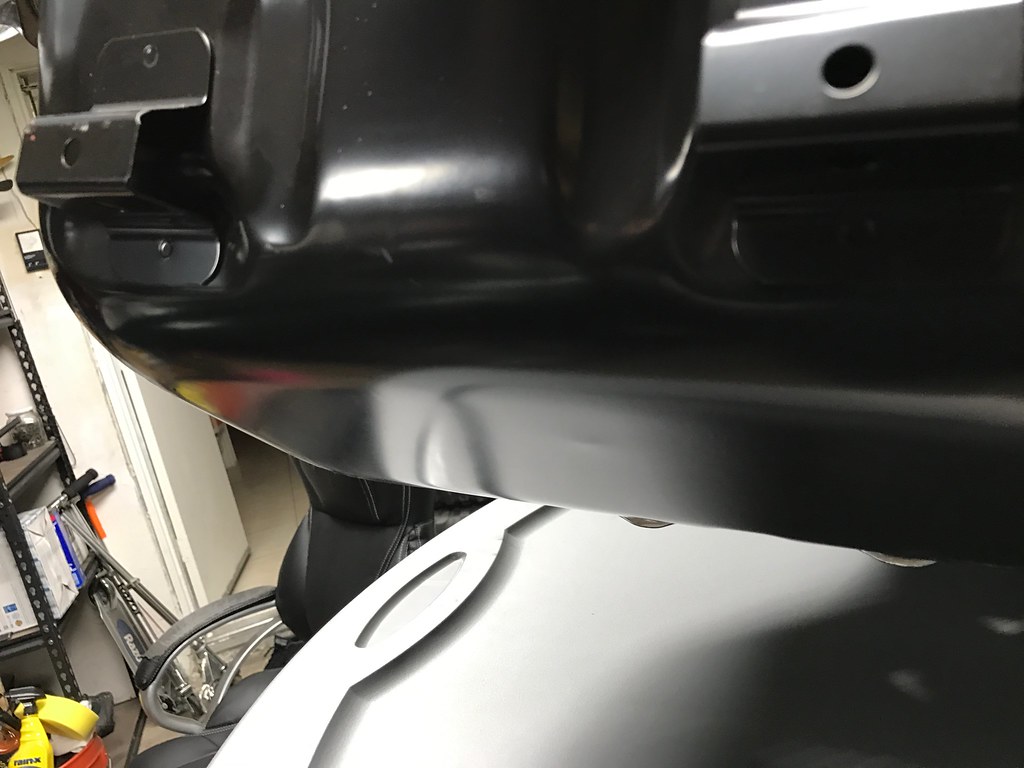

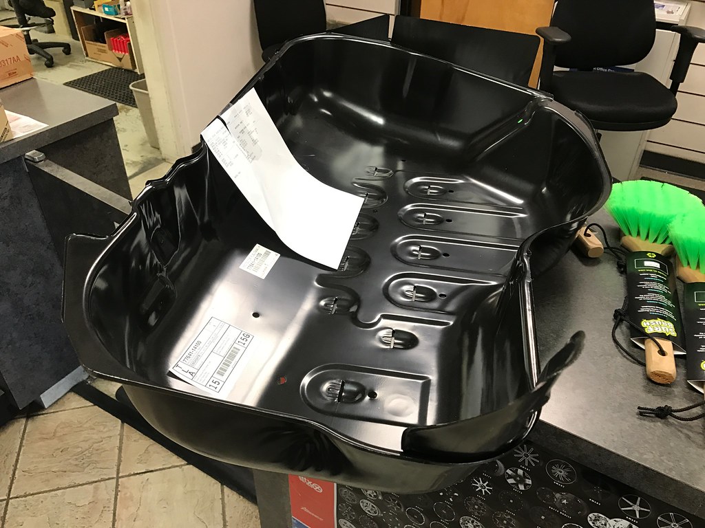

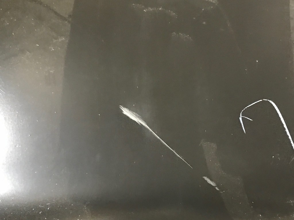

It is surprising to learn that Toyota stores their metal fuel tank skids without boxes. Each MKIV skid remaining is scratched and dented.
The one that I got was the best of the 3 left. It's got one dent and needs paint. The tail lights and rear bumper will be mounted once the new rear tank skid is fixed and painted.

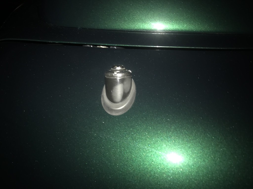

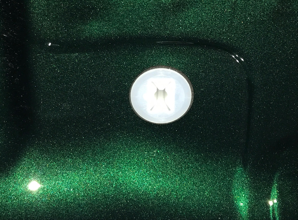

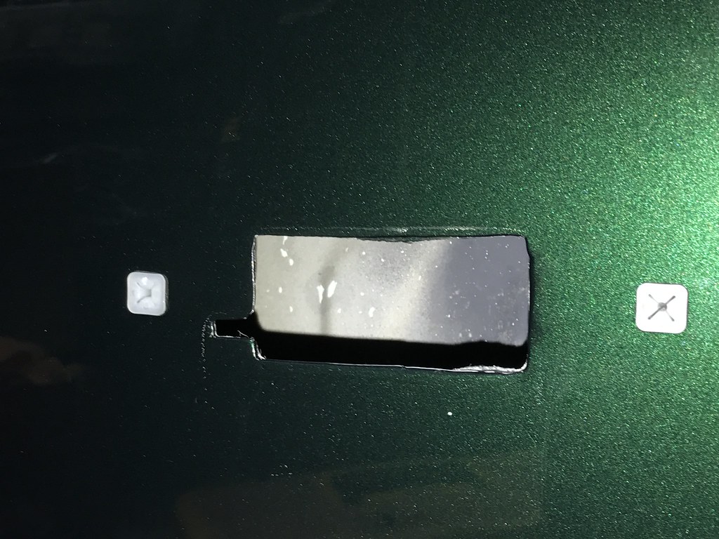

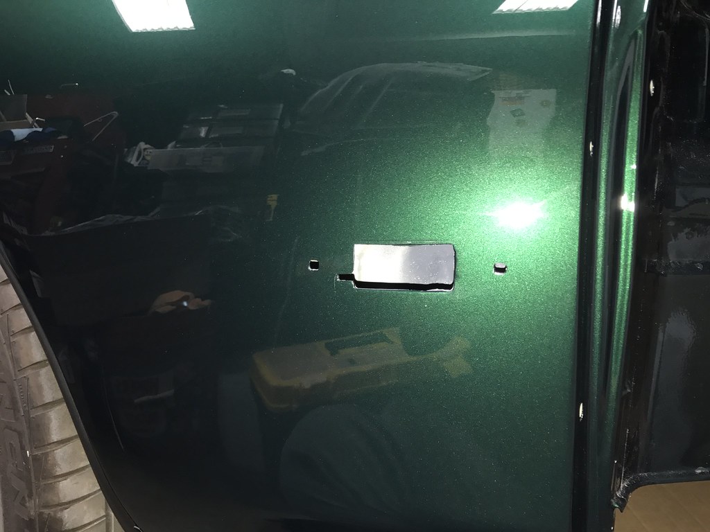

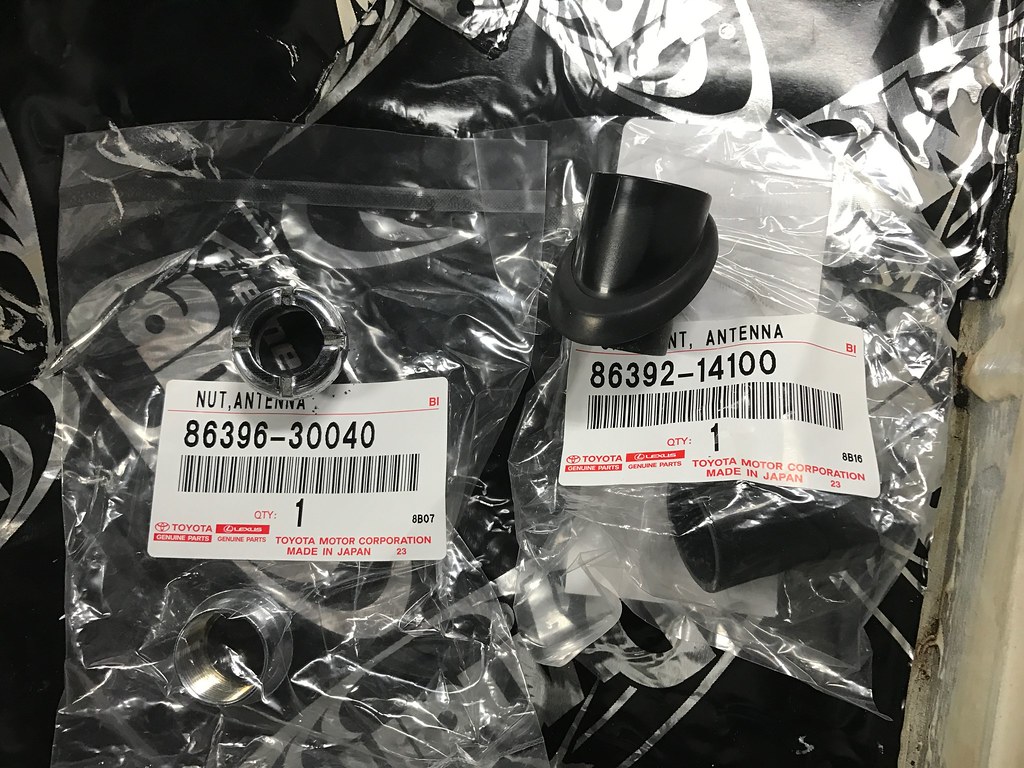

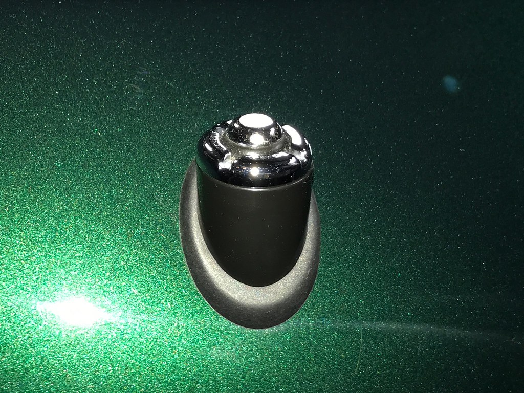

Antenna trim before
Ooooh, nice and new
Antenna trim after

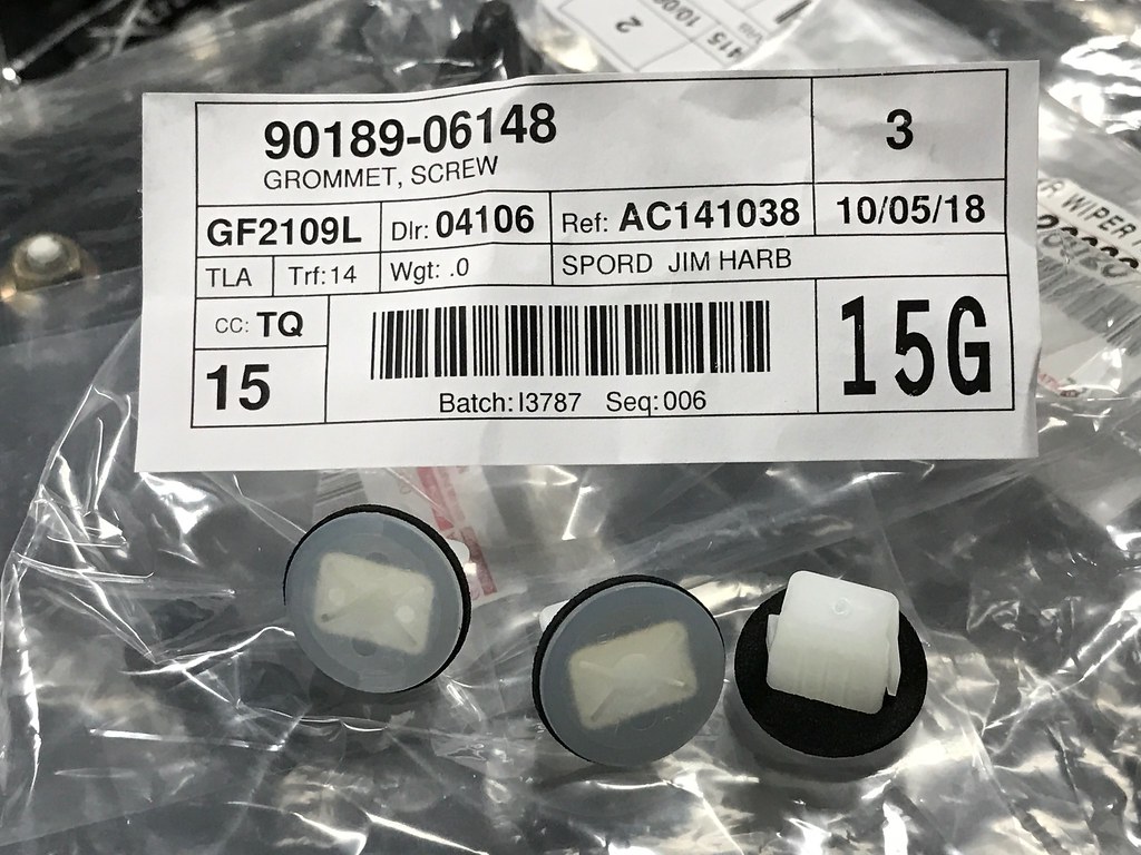

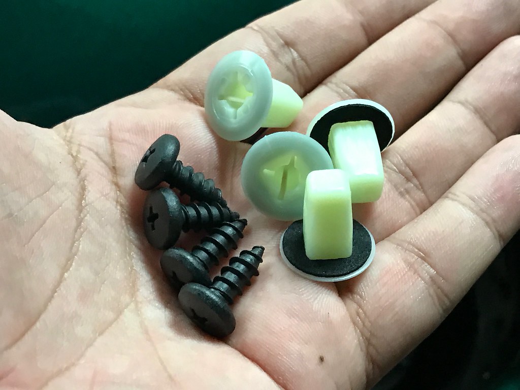

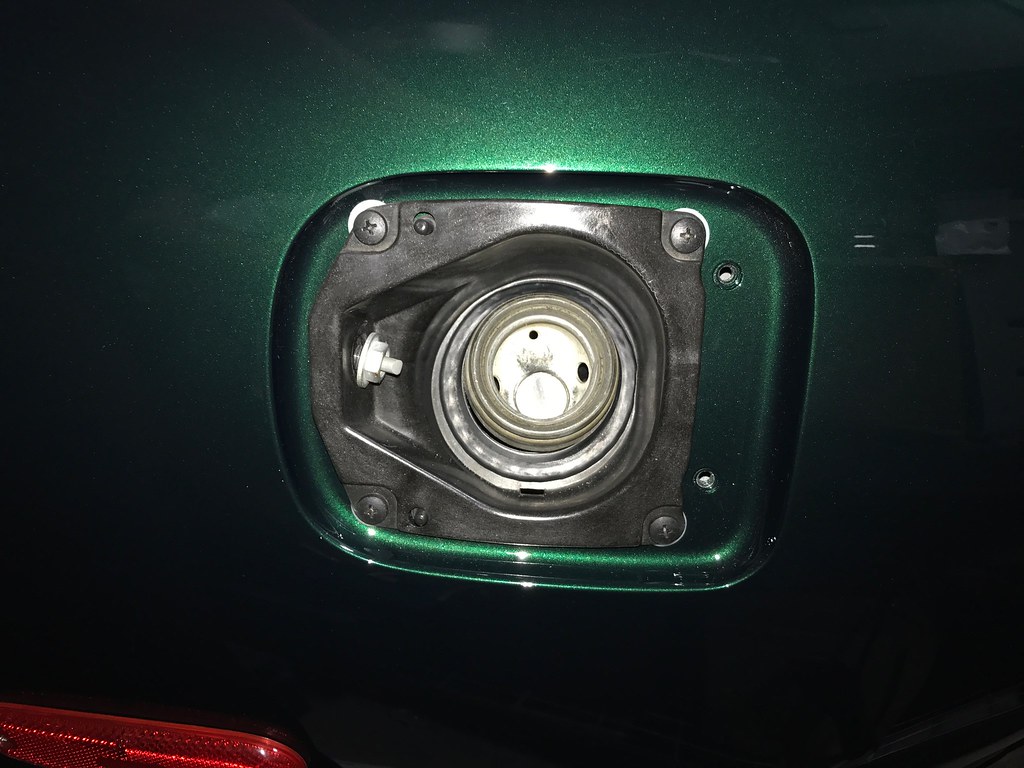

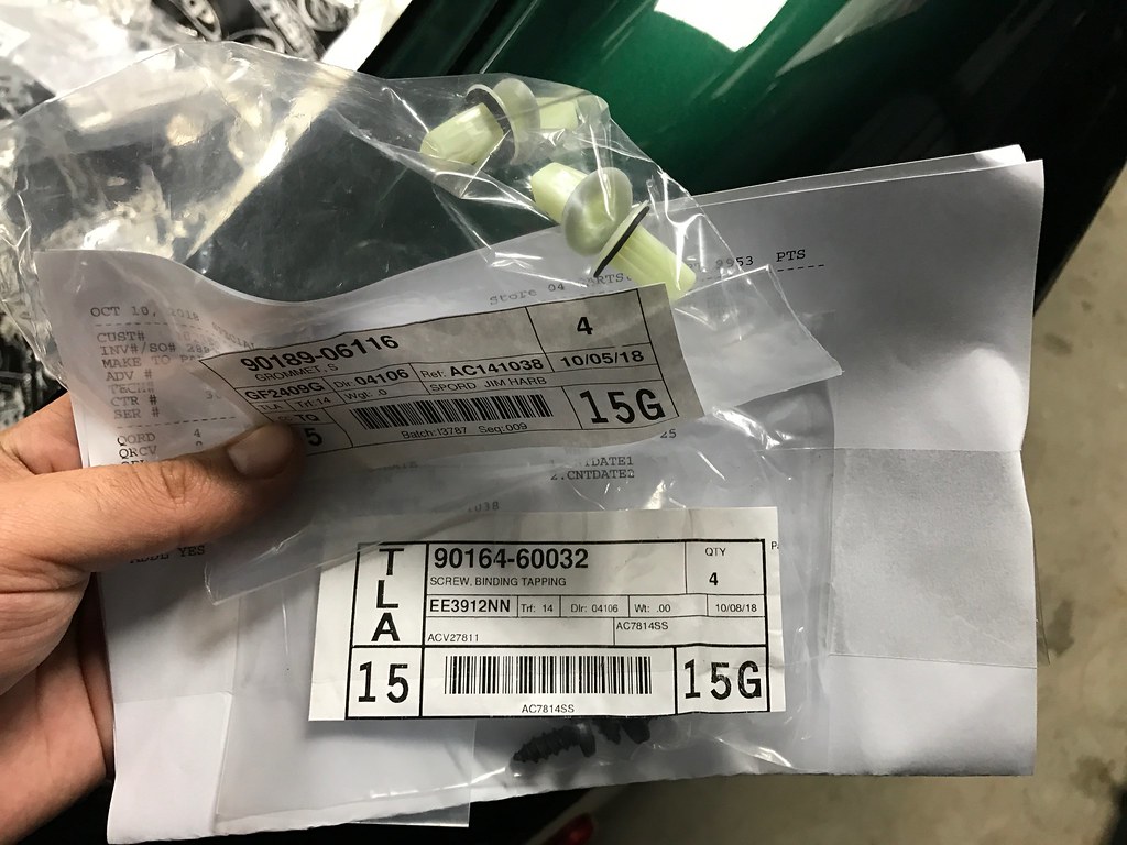

Fuel filler surround grommets and screws

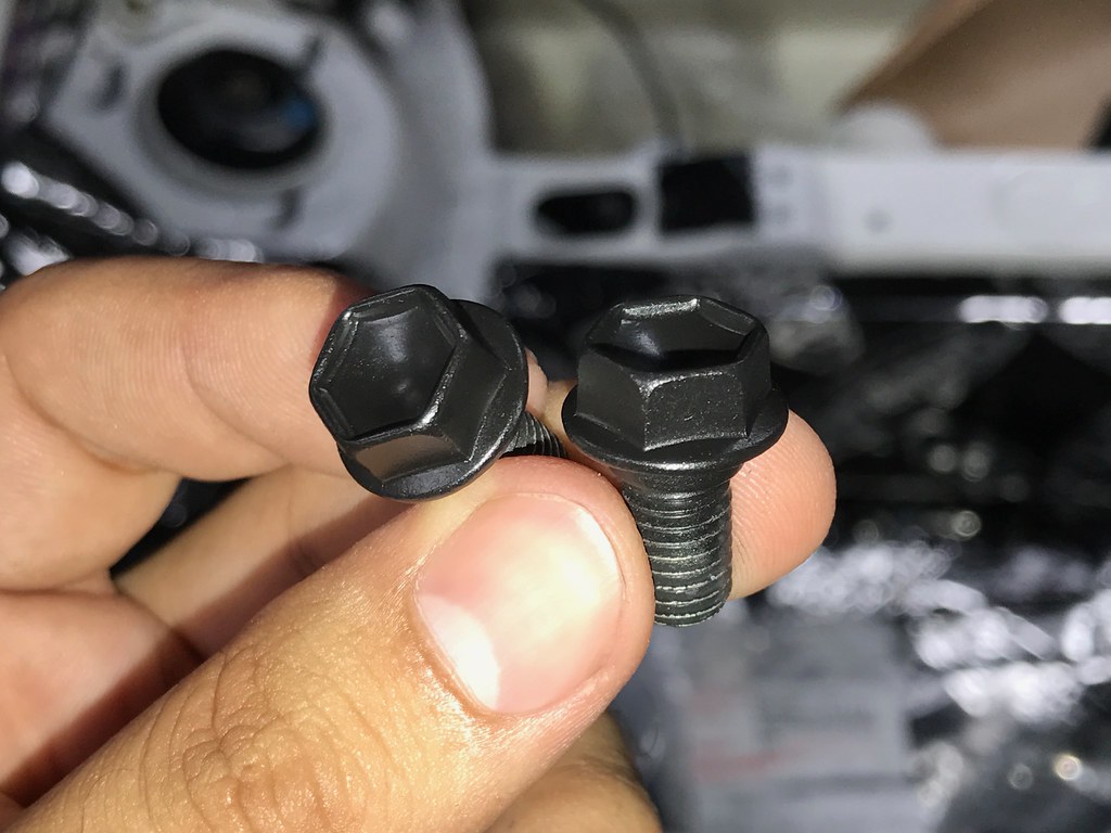

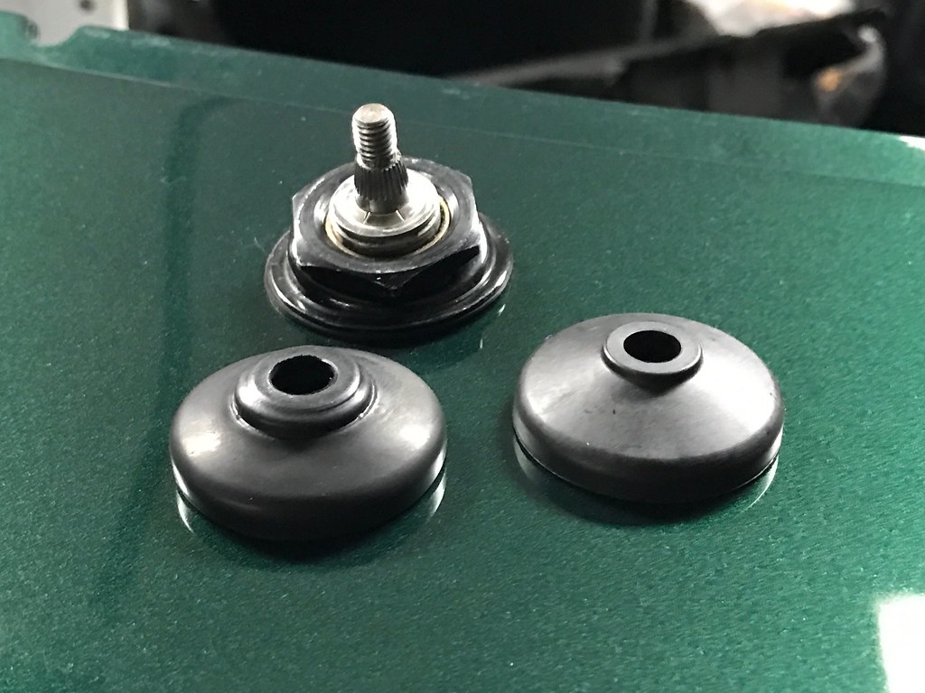

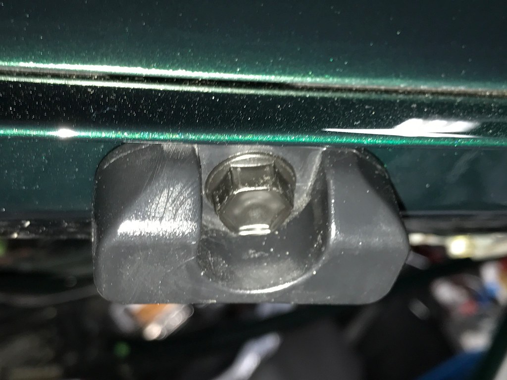

Bolts for the hatch bump stops. They are usually kept in quantity, these were scratched up. I gave them a quick coat of SEM Trim Black #39143.

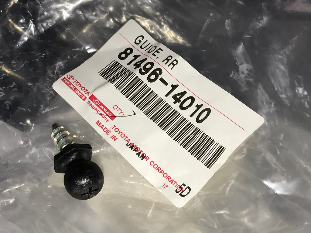

Tail light guide grommets
Tail light guides

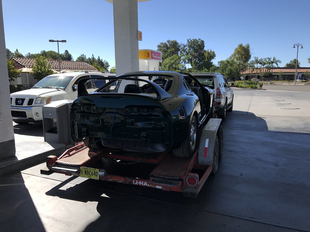

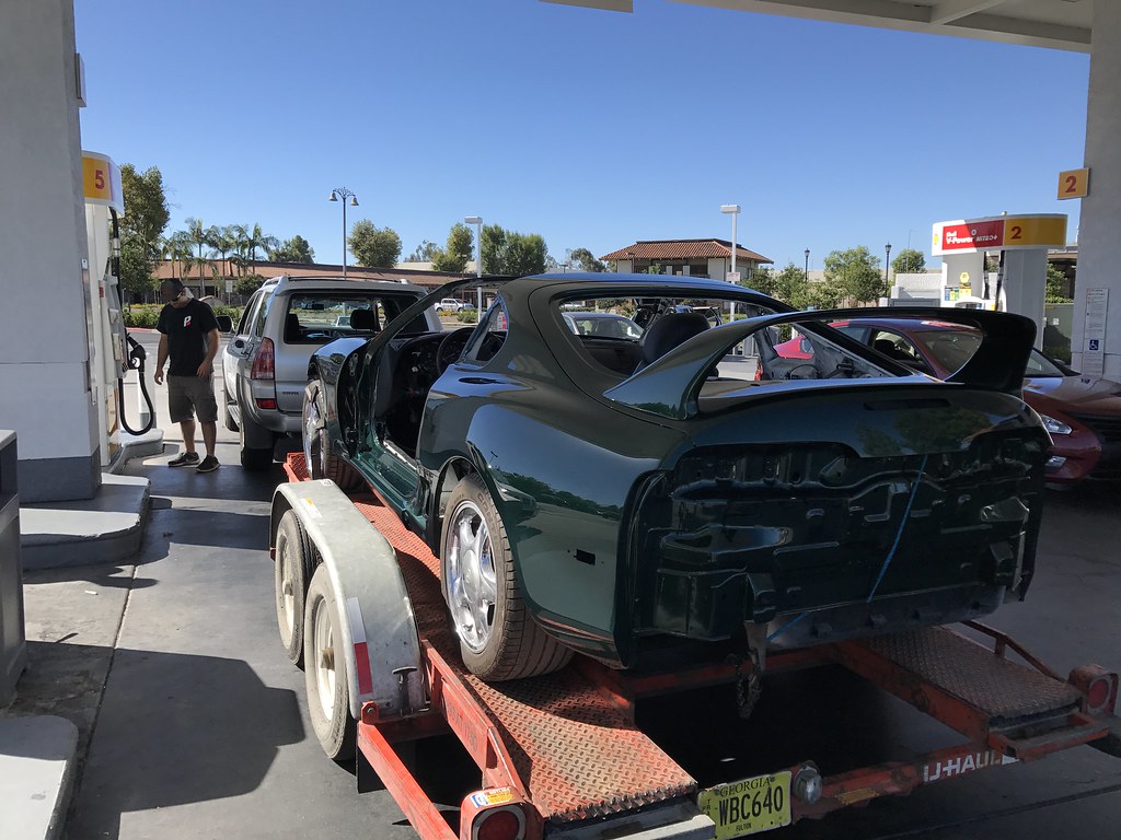

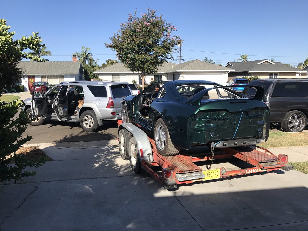

I would of been really really nervous bringing it home on open trailer, damn nervous.

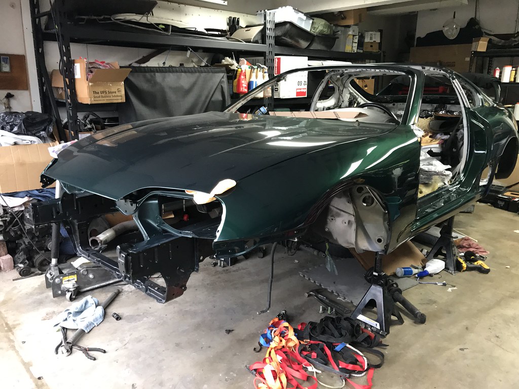

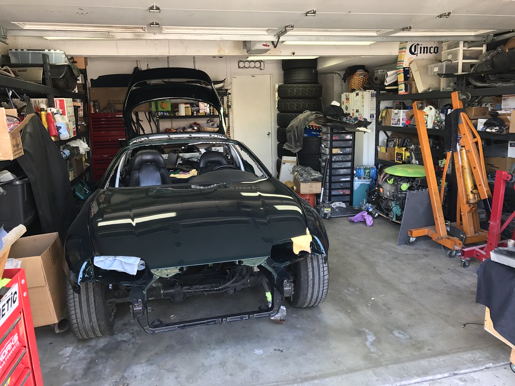

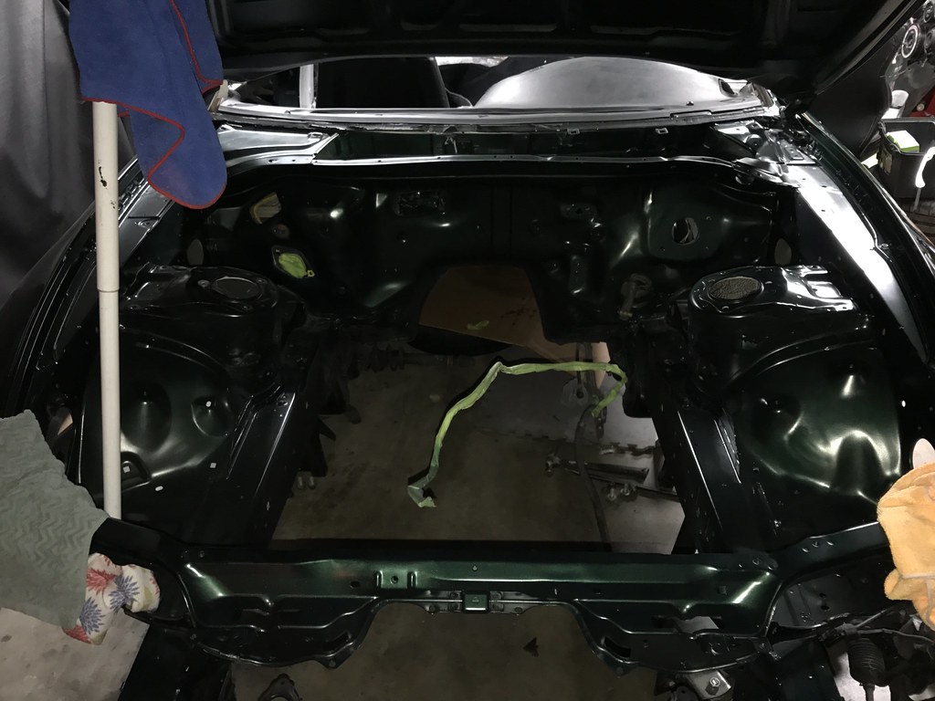

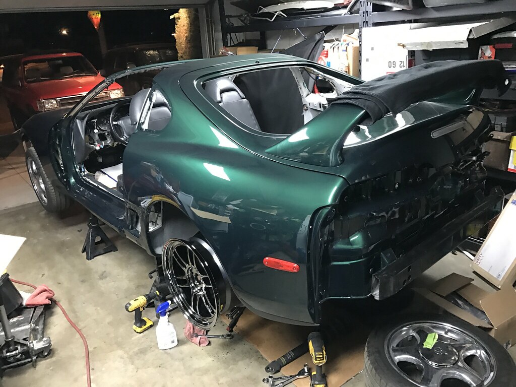

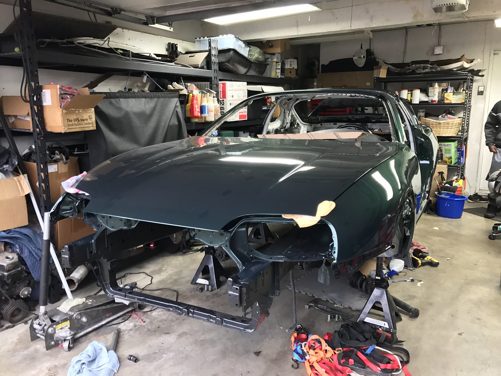

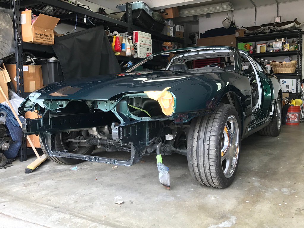

Back to where we left off...

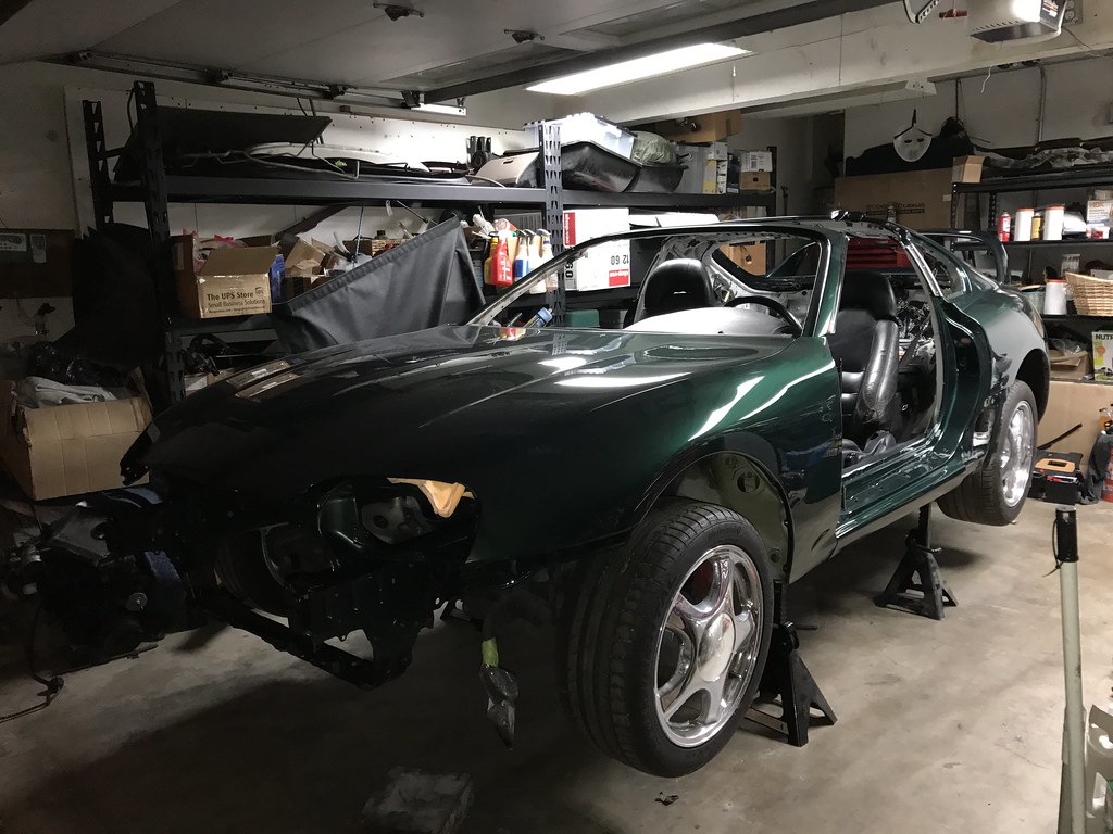

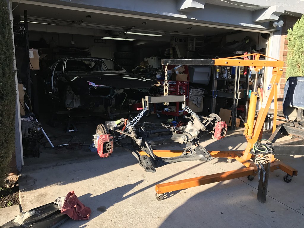

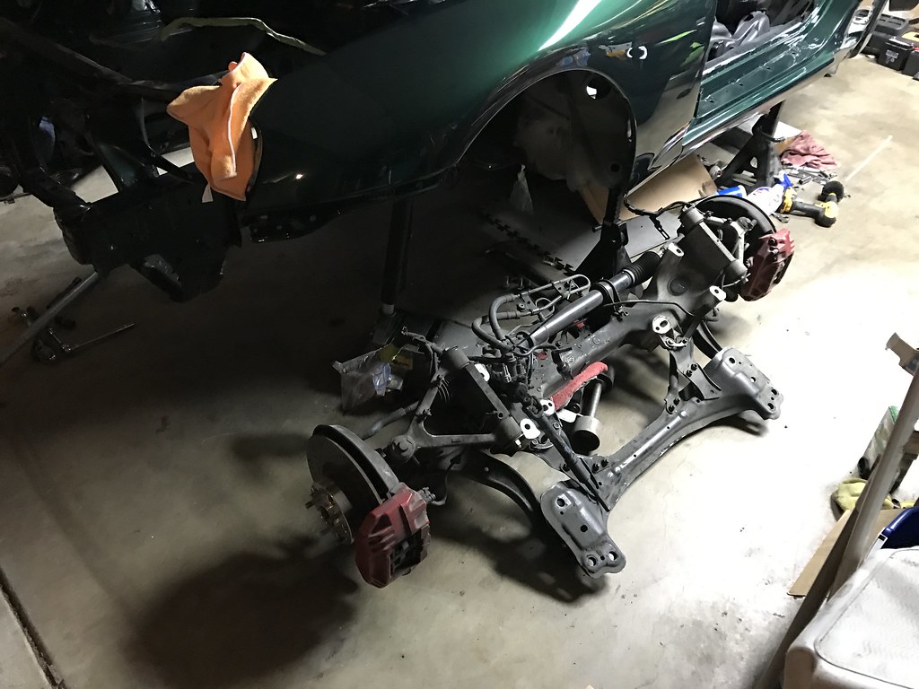

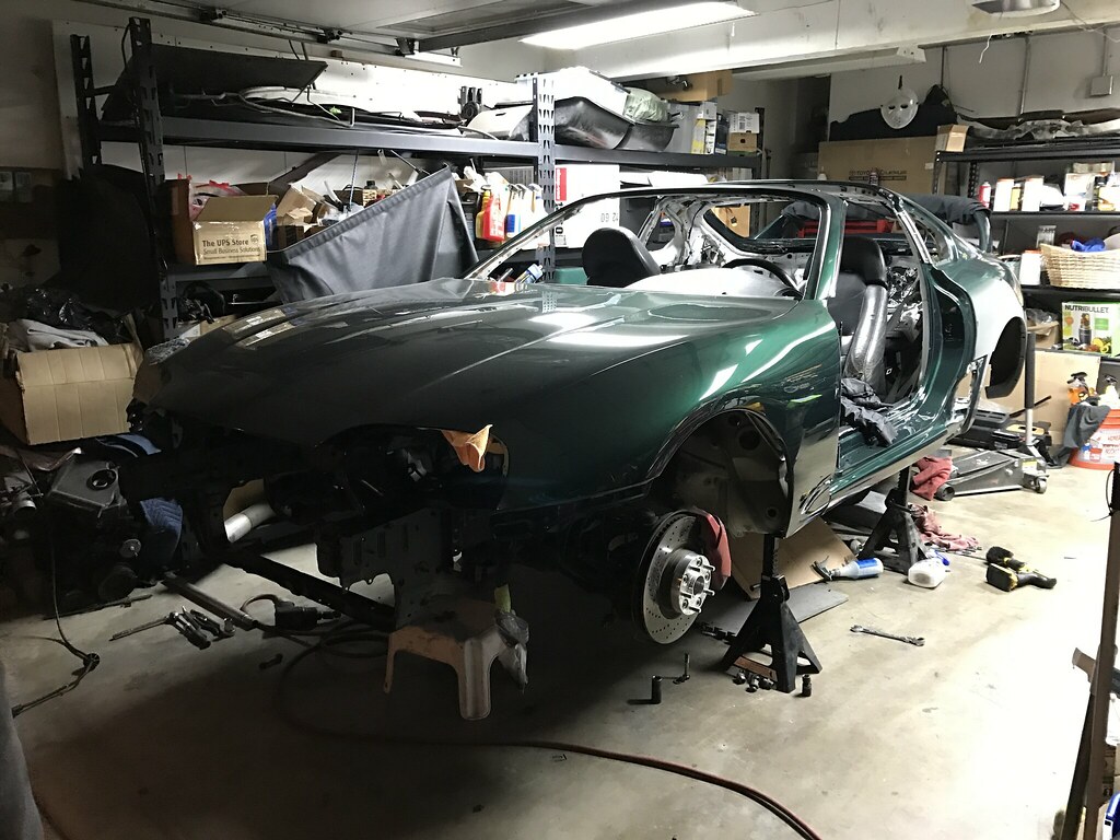

Gotta get this thing on stands to get the subframes out.
The underside of the car is pretty dirty as you'd probably guess after 25 years.

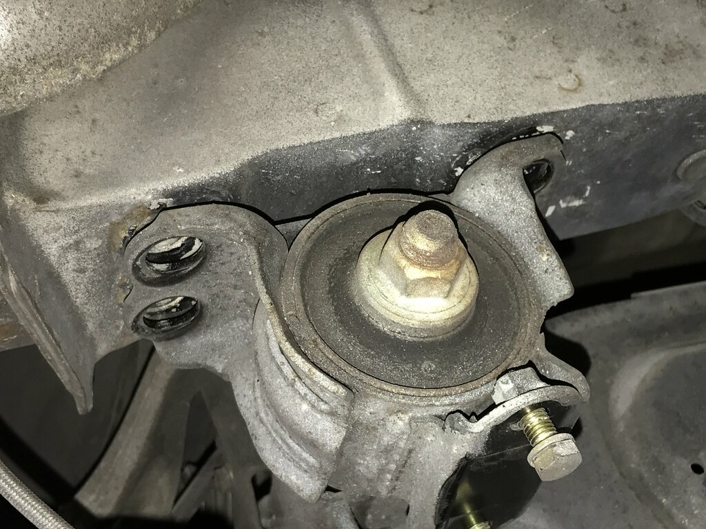

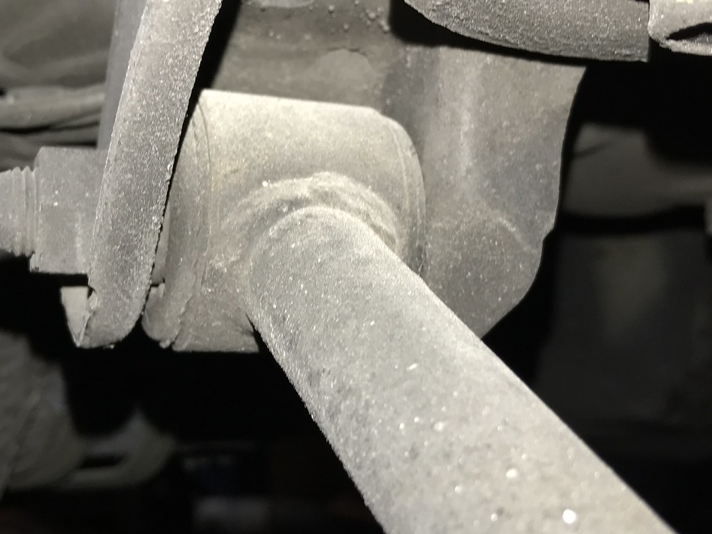

The suspension bushings are in pretty fantastic shape for being 25 years old.

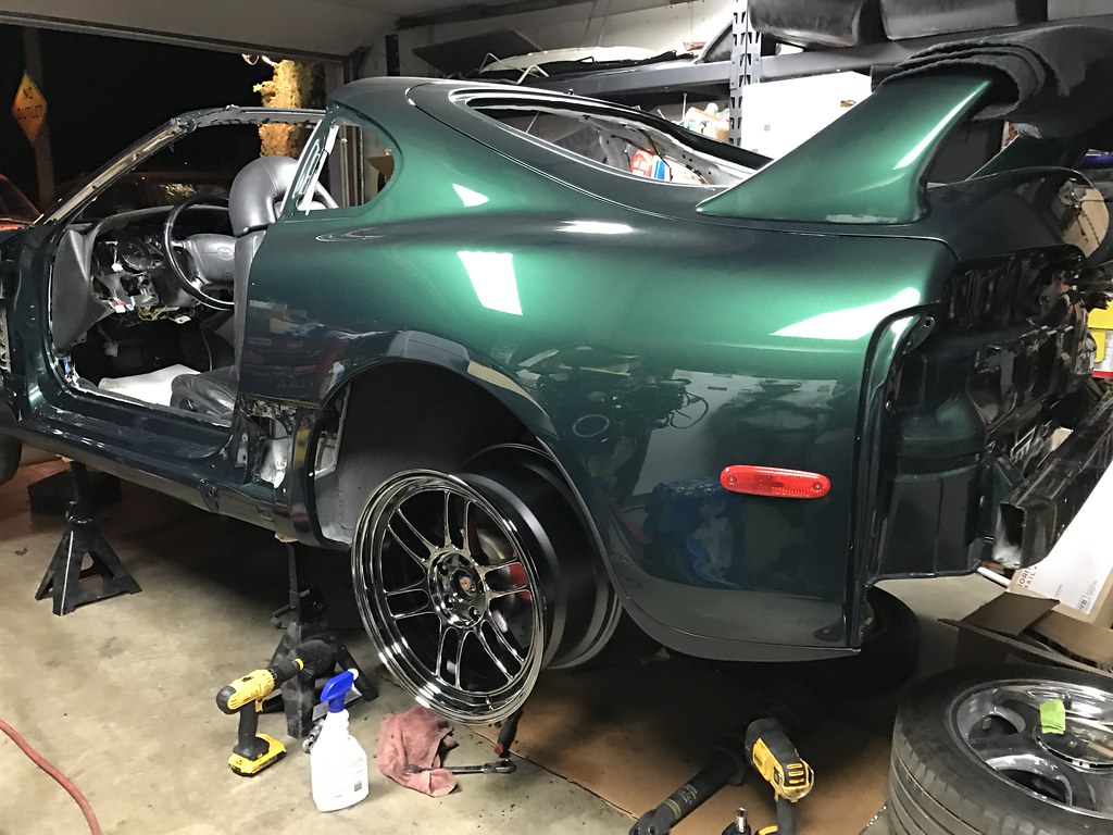

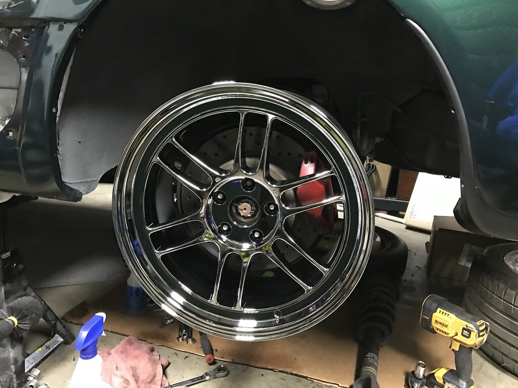

Just a quick test fit for one of the SBC Enkei RPF1's... the color contrasts well with the Imperial Jade.

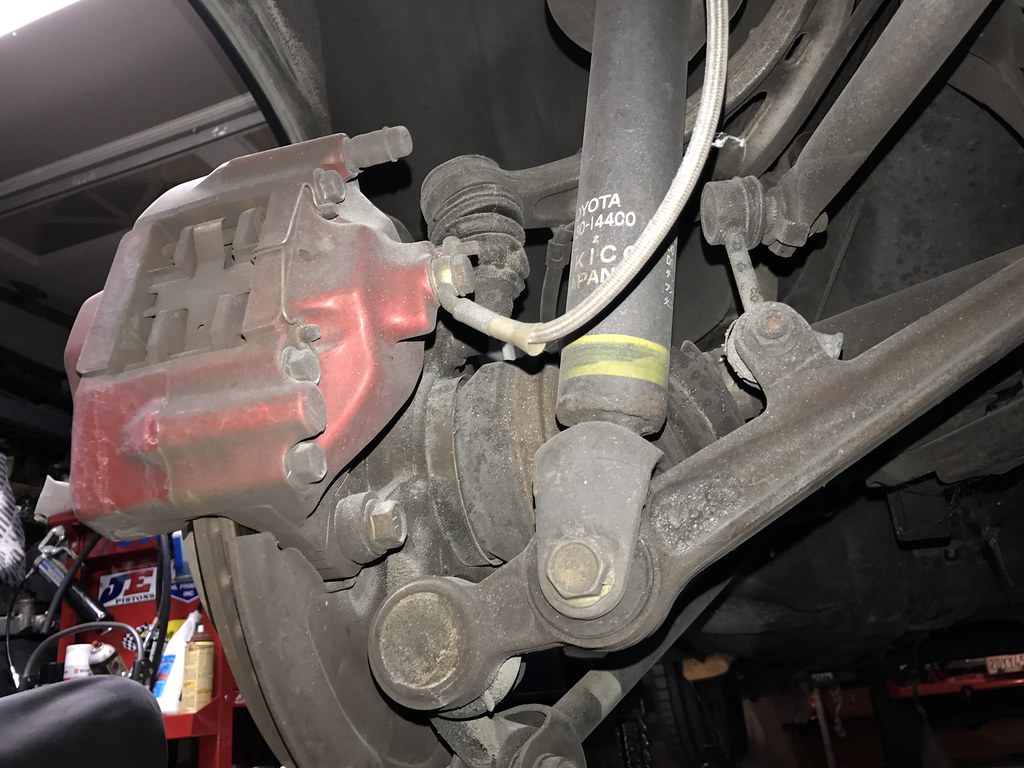

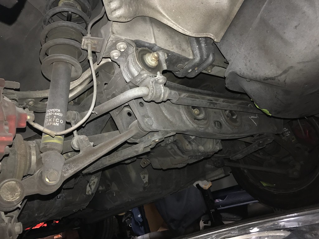

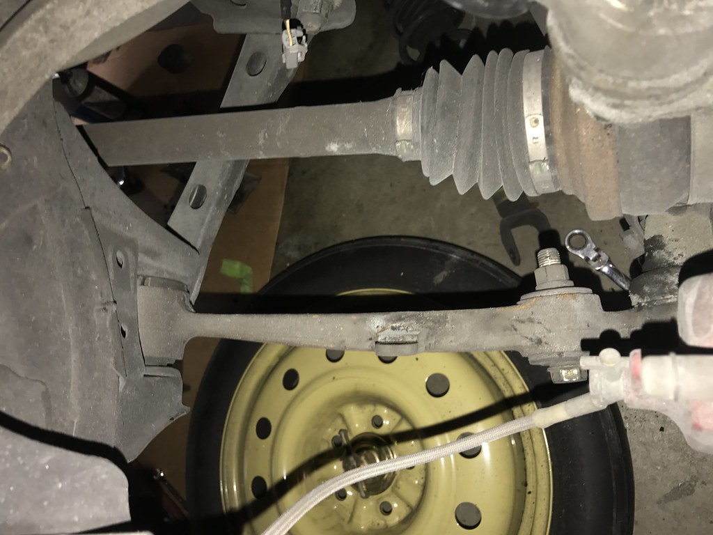

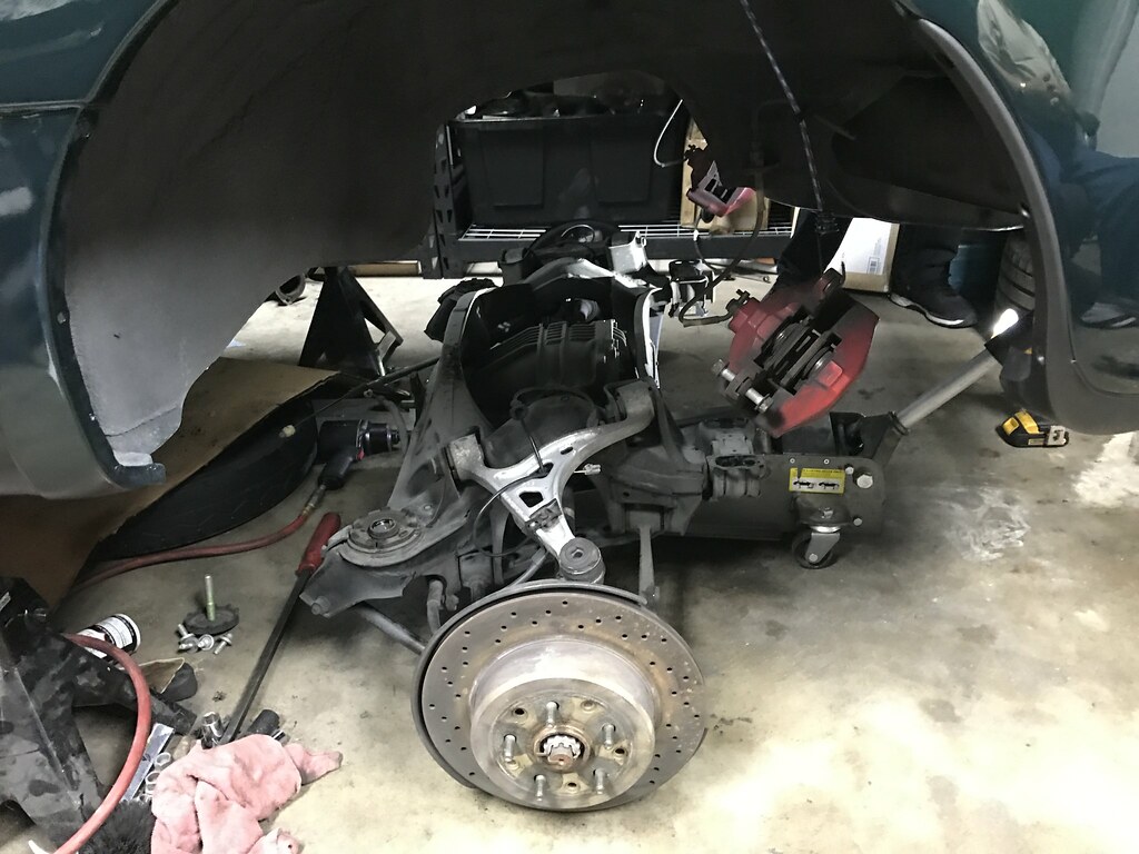

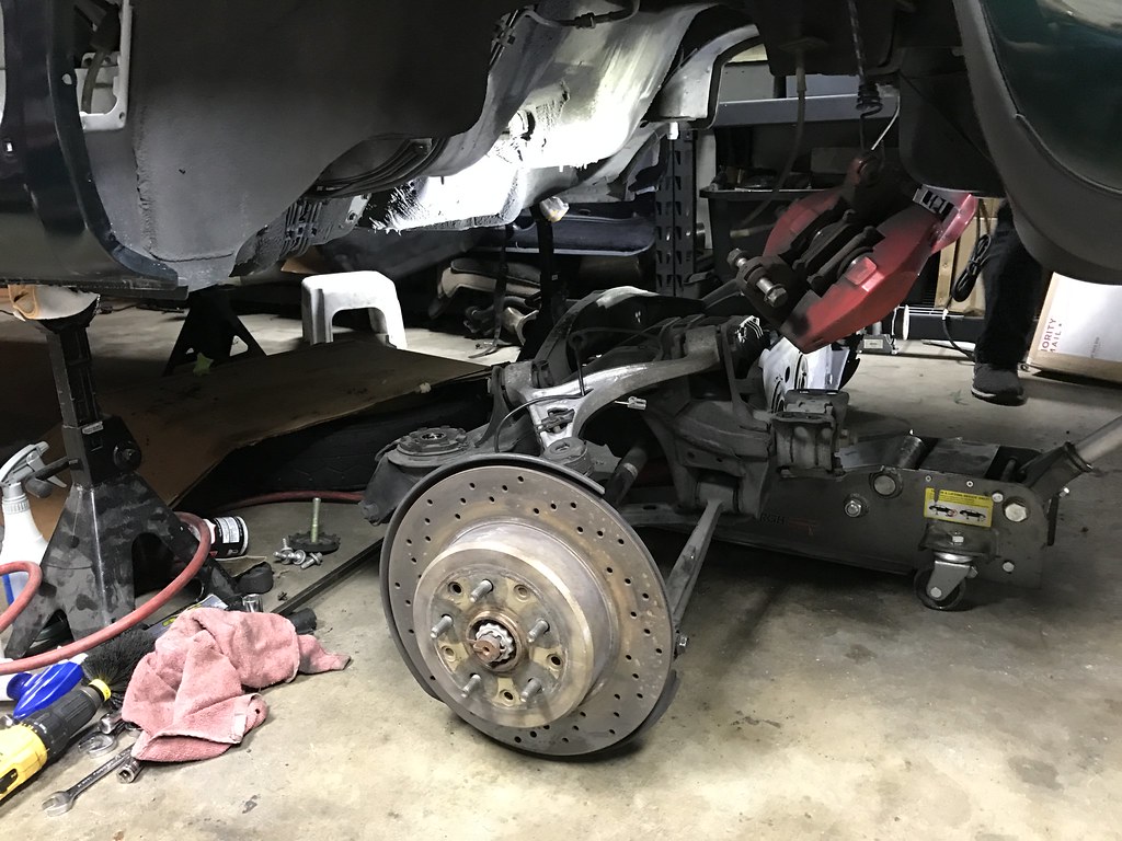

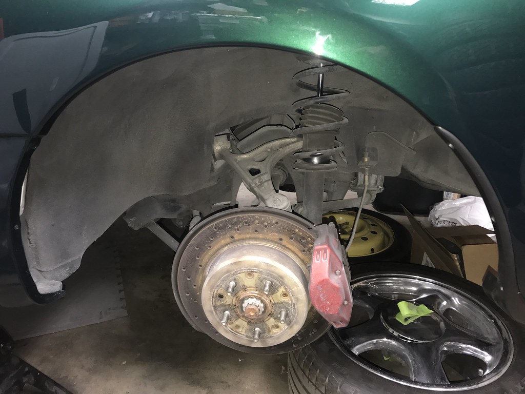

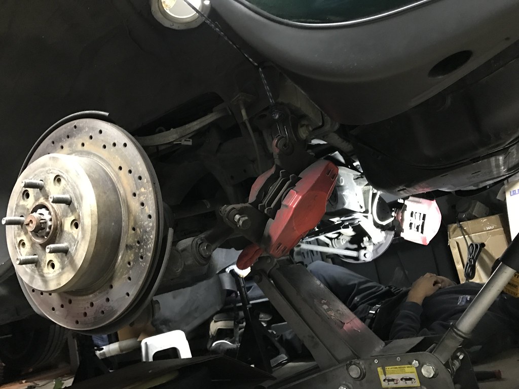

Pulling out the struts revealed that the car has been sitting on a set of old school H&R lowering springs on stock Tokico shocks for the majority of its life.

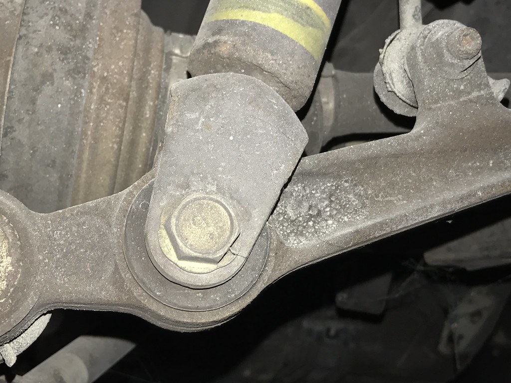

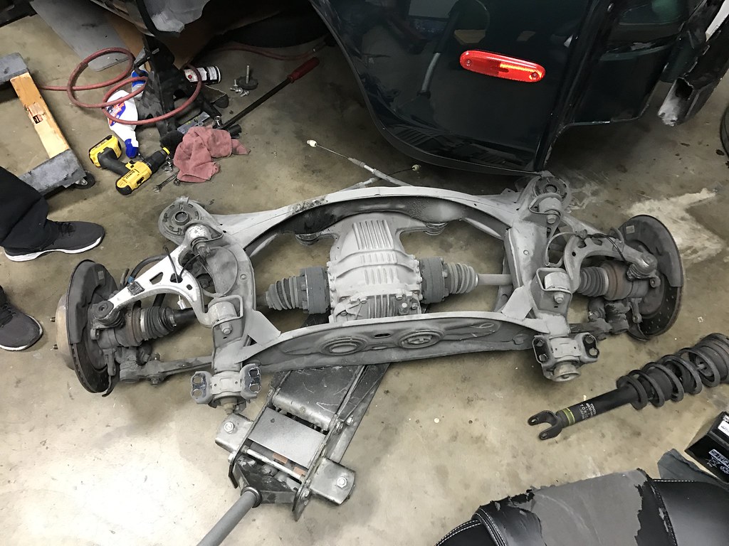

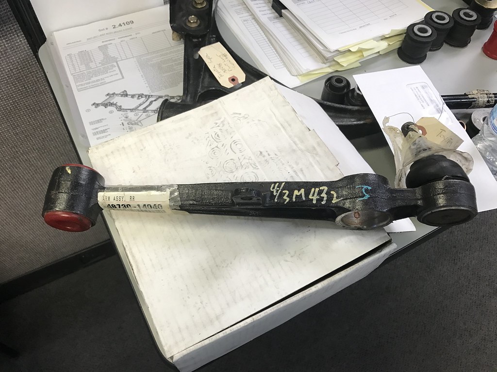

Upon removal of the rear passenger side, it became clear that the control arm had been bent. Striking to find that the alignment had been able to compensate for the bend.
I have obtained a brand new OEM arm to replace it. Notice the funny looking red bushing... it ain't stock.

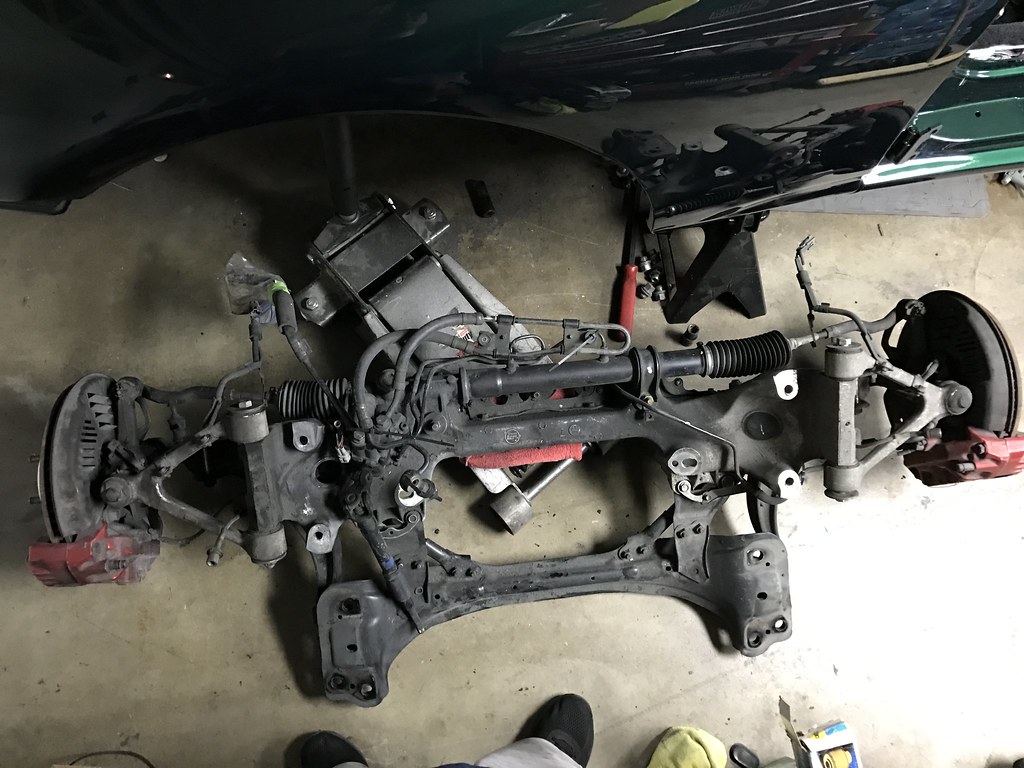

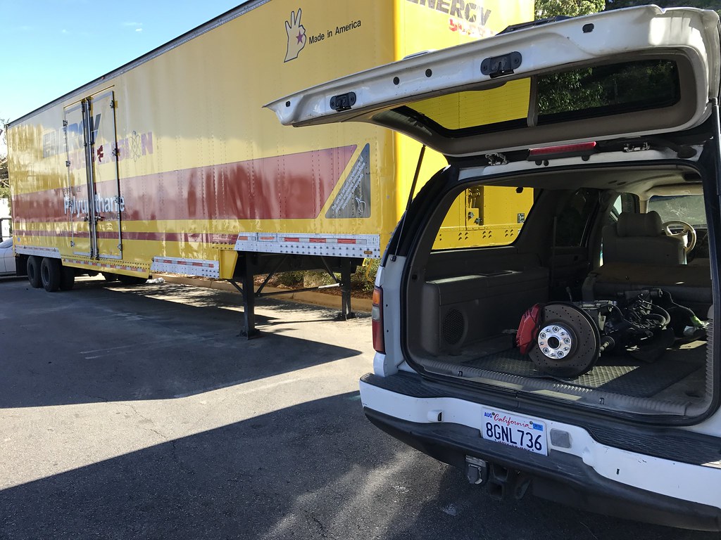

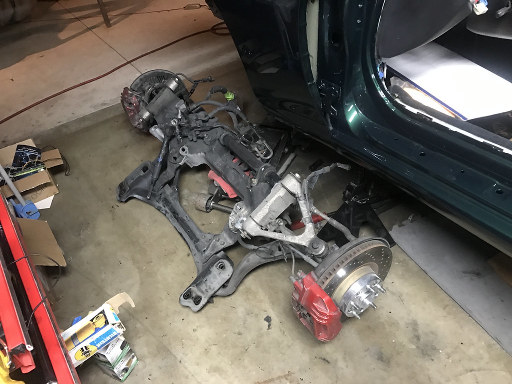

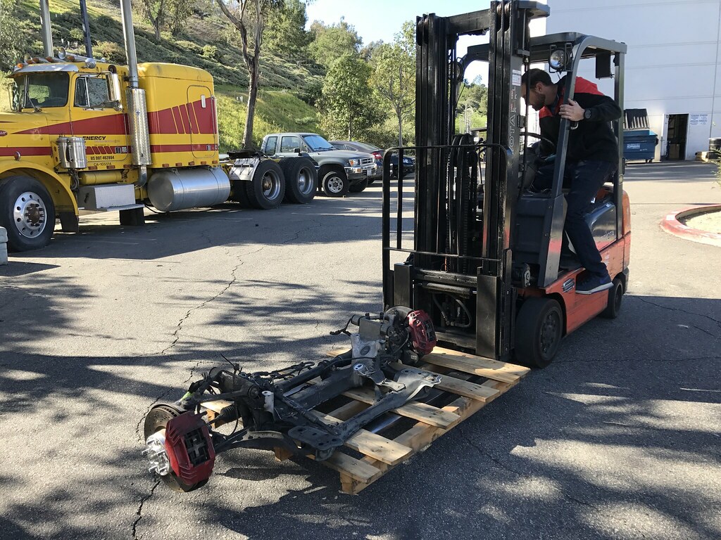

Dropping the subframe assemblies was fairly easy with the help of a friend.
Just going to drop these off here and see what happens... :D
More on that later on.

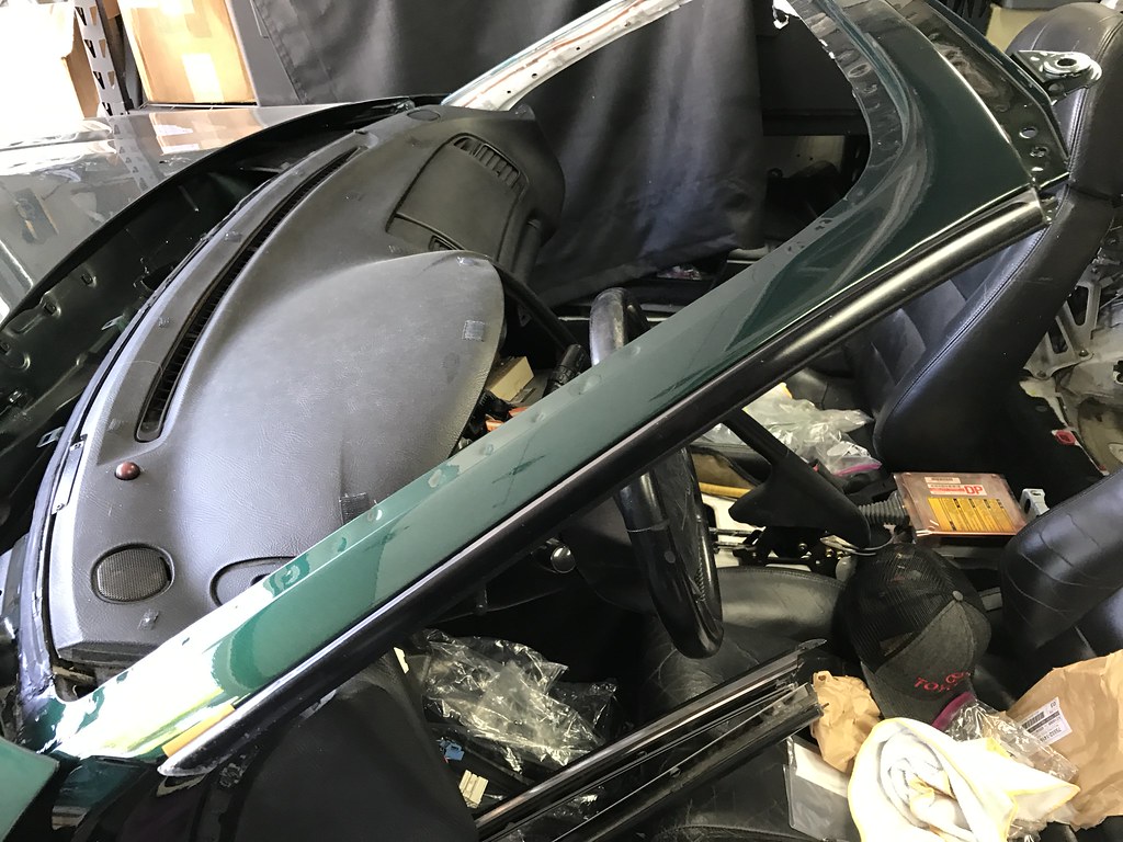

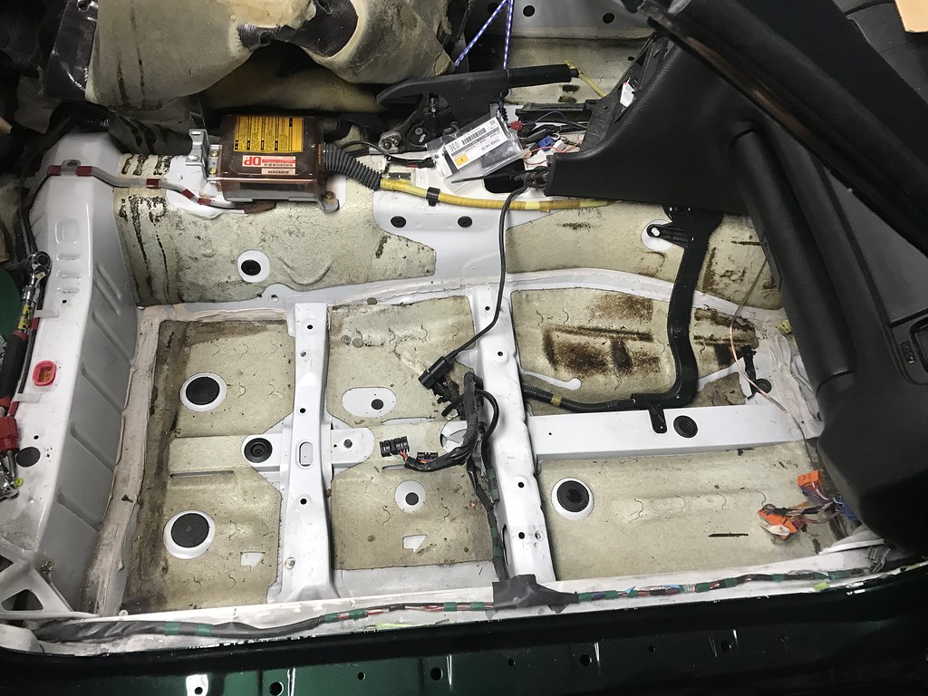

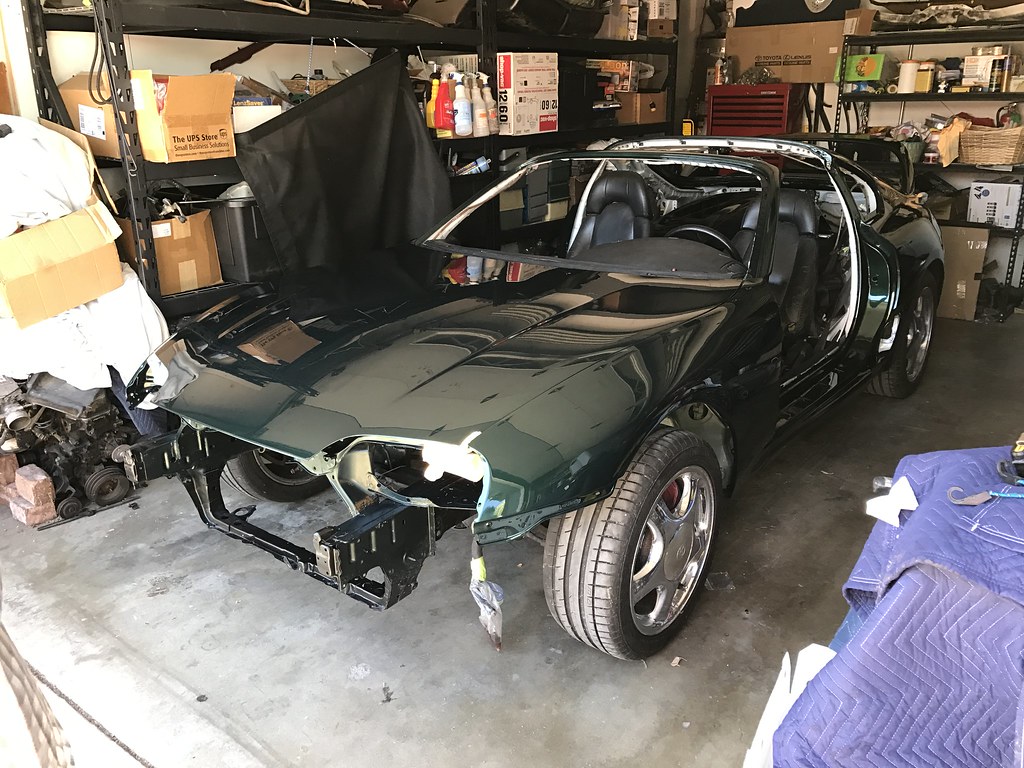

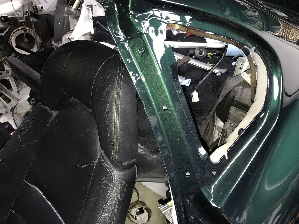

The interior is in the way and must come out to progress to the next step.
- Interior removal
- Dynamat
Then we can progress to the undercarriage.
- Repair of floorboard damage underneath driver seat
- More dynamat
- Removal of automatic transmission tunnel, installation of manual transmission tunnel
- Matte black undercoating

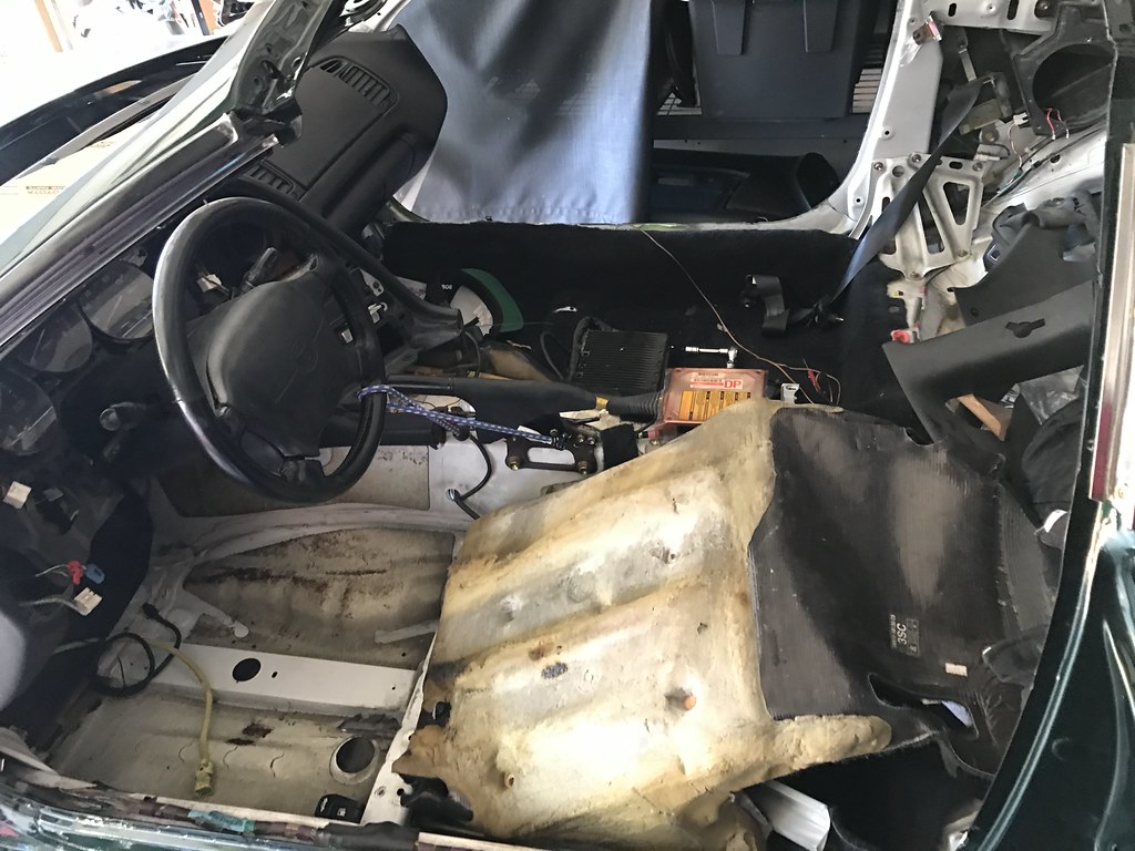

Carpet and seats coming out.

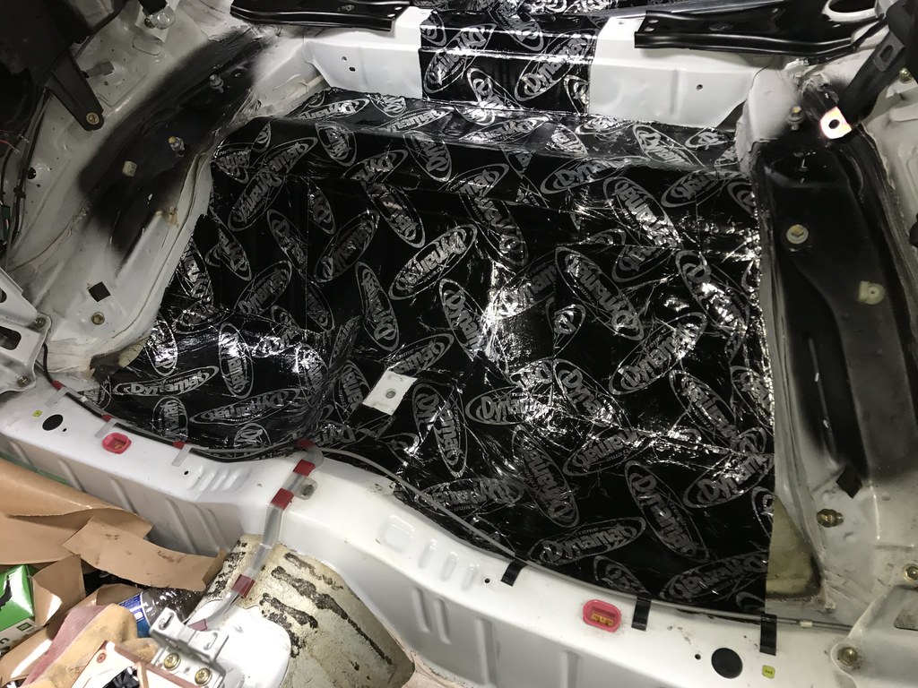

Dynamat in the backseat area

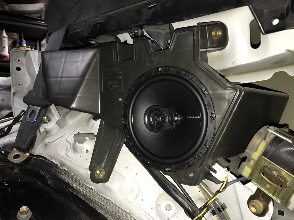

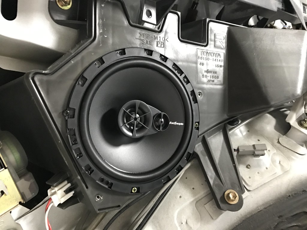

Got sick of looking at the old OEM speakers, so before I pull the boxes to dynamat the inner quarter panel, a quick test fit of the new Rockford Fosgate speakers.
