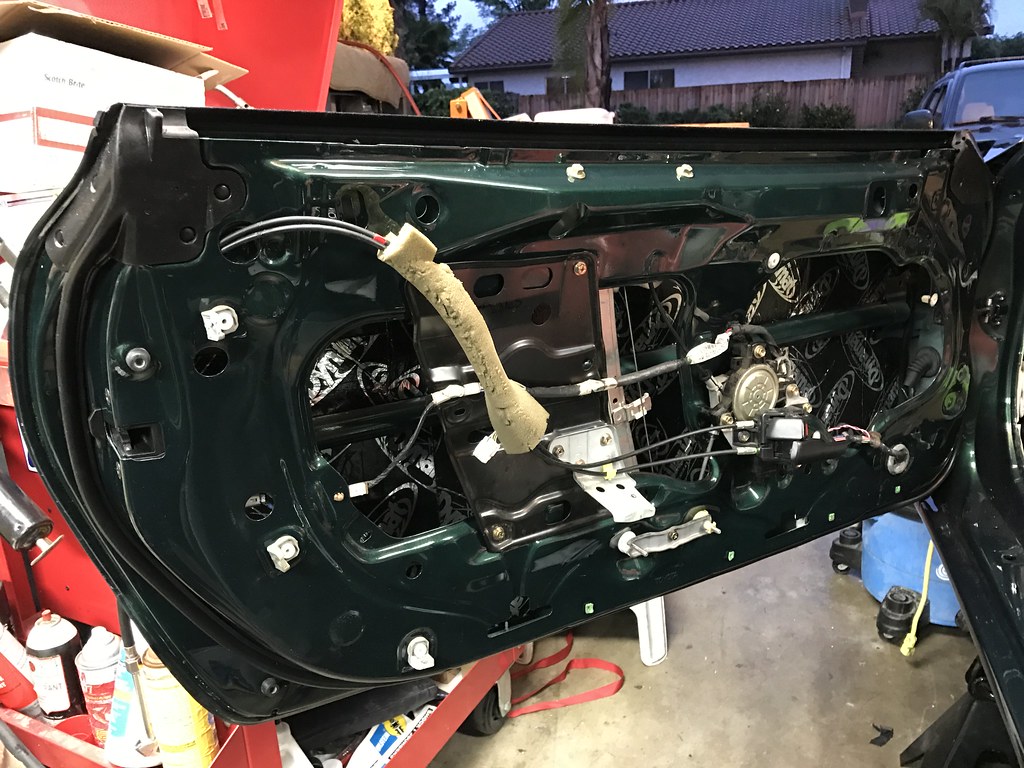

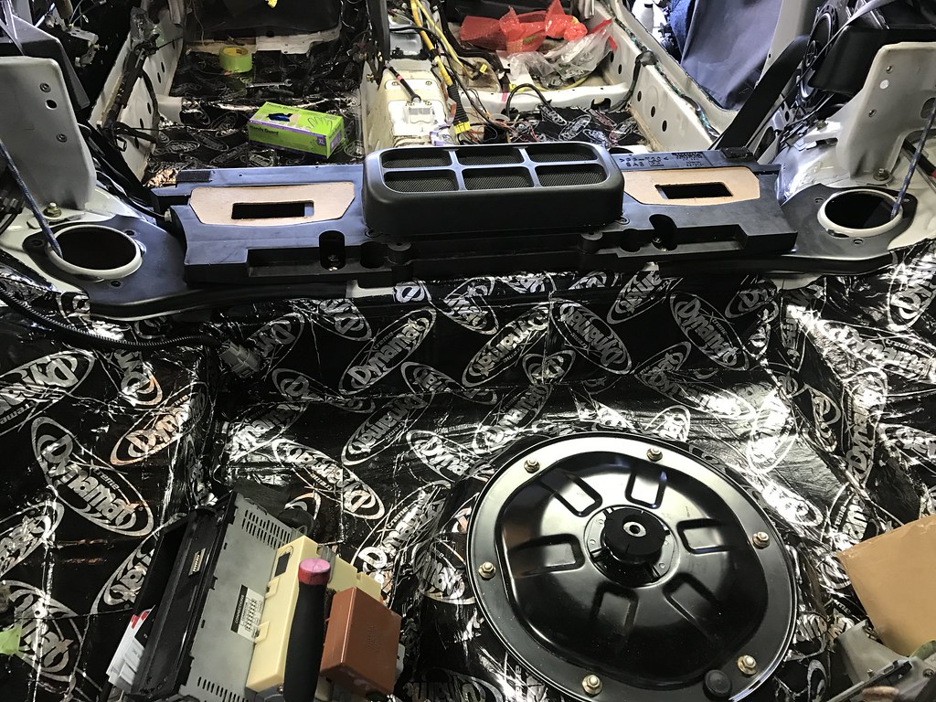

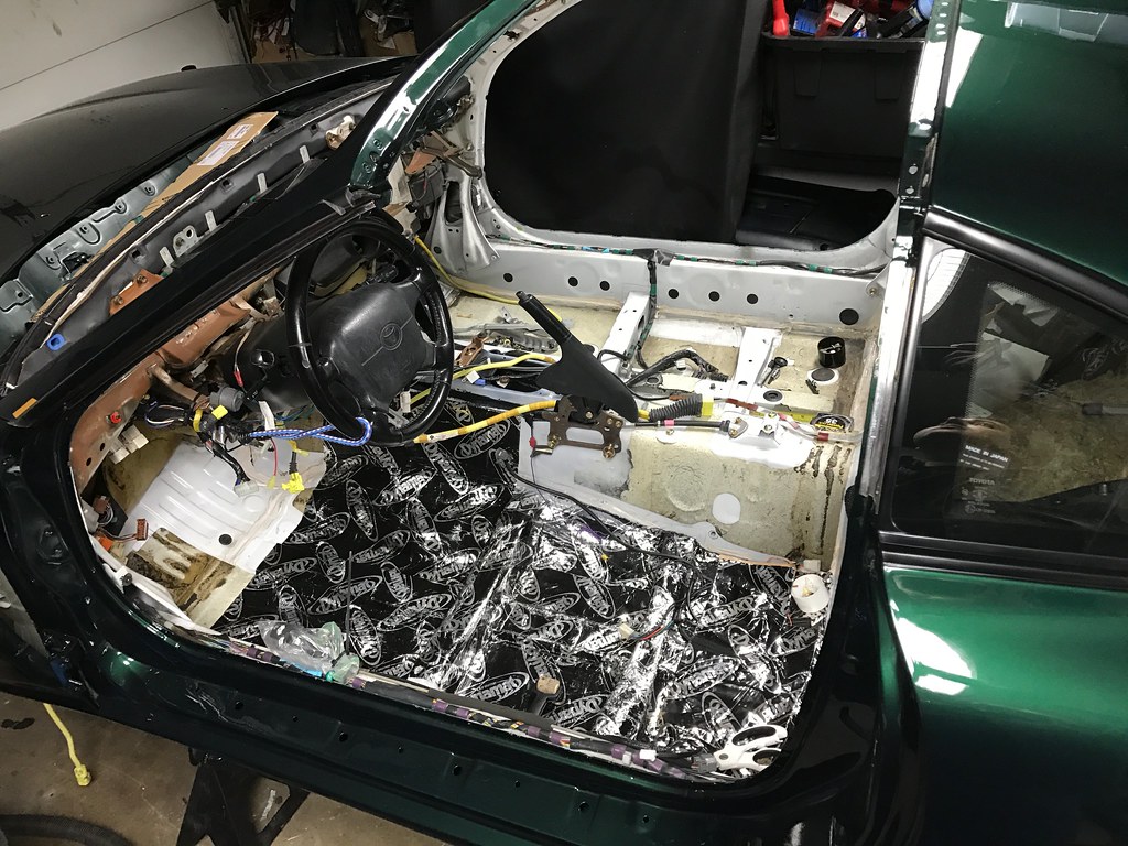

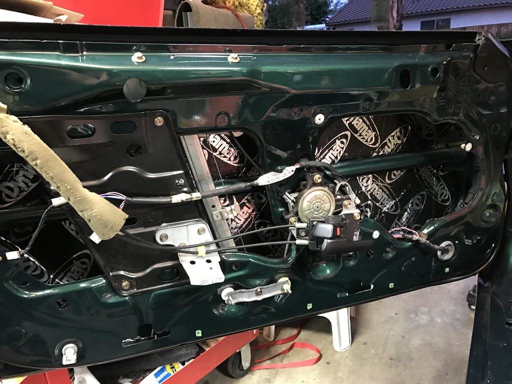

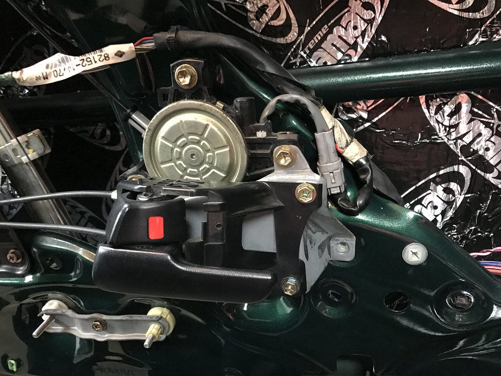

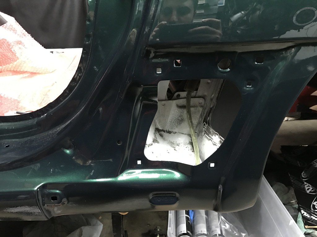

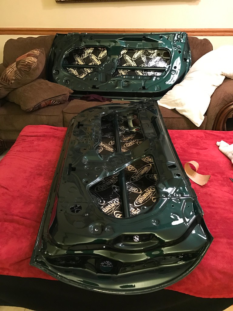

A little more Dynamat in the driver's floor area. The previous damaged spots are now completely covered. Still lots more floor to be covered.

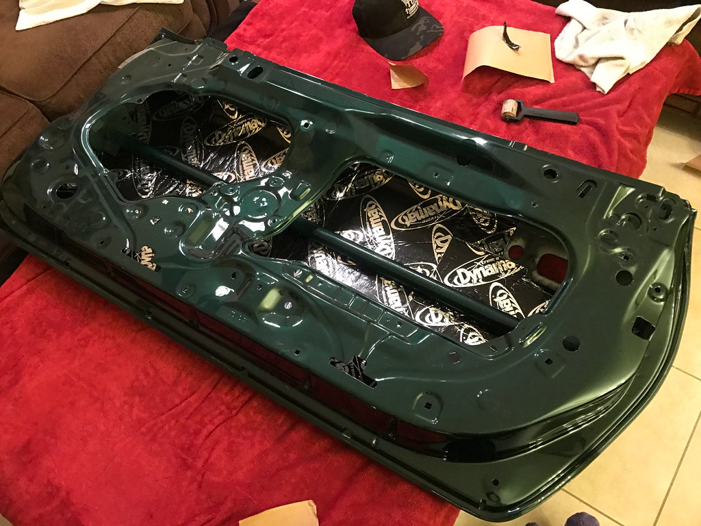

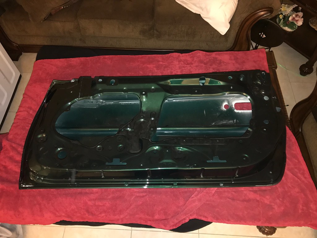

I want to get assembling on the door shells, so they took priority over the dynamat phase. Both doors took less time than the driver's floor pan.

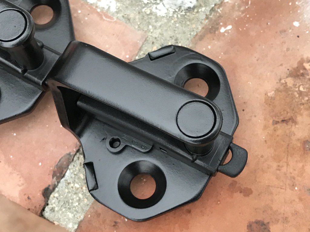

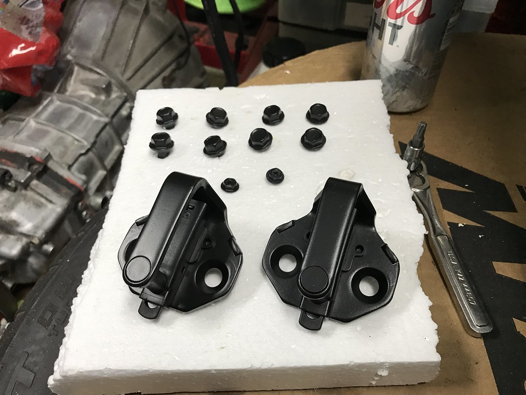

The door latches, strikers, and hardware had pearl white still on them. I used paint thinner, red scotchbrite hand pads, and SEM Trim Black 39143 to fix that.

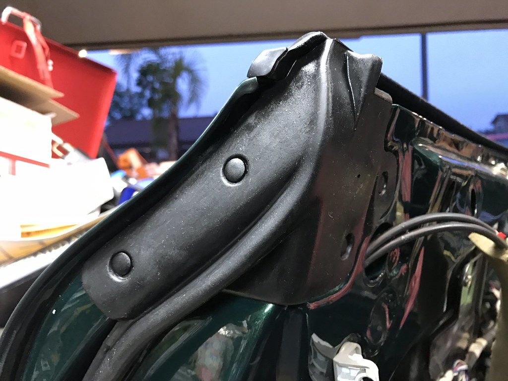

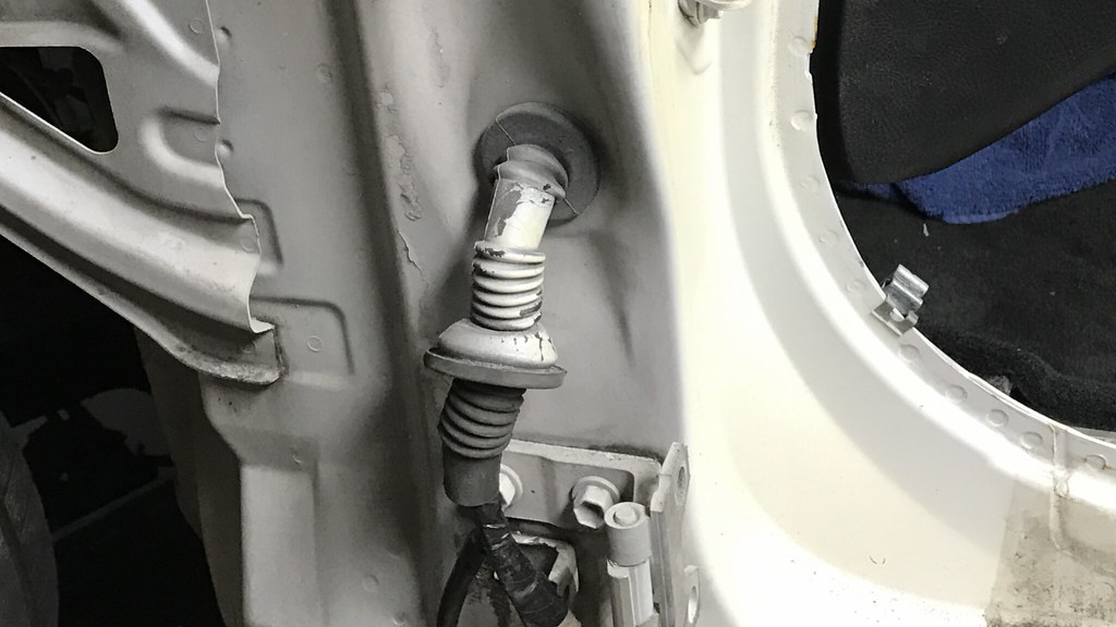

This boot used to be fully pearl white. No one bothered to mask it when doing the door jams years ago.
It took an hour to clean it, but I'm very pleased with the result!

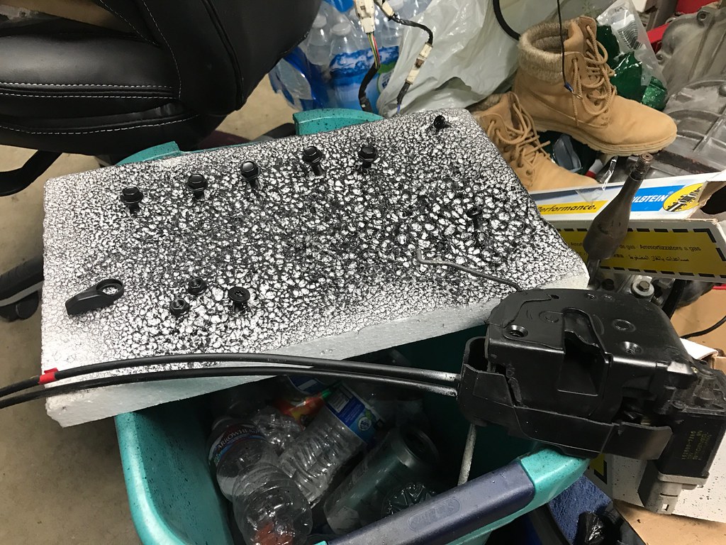

Here's some of the painted stuff and the rest will come tonight or tomorrow.
All items painted with SEM trim black 39143.
Door strikers
Temporary door and fuel door bolts. Will be ordering a lot of new Toyota bolts to be color matched

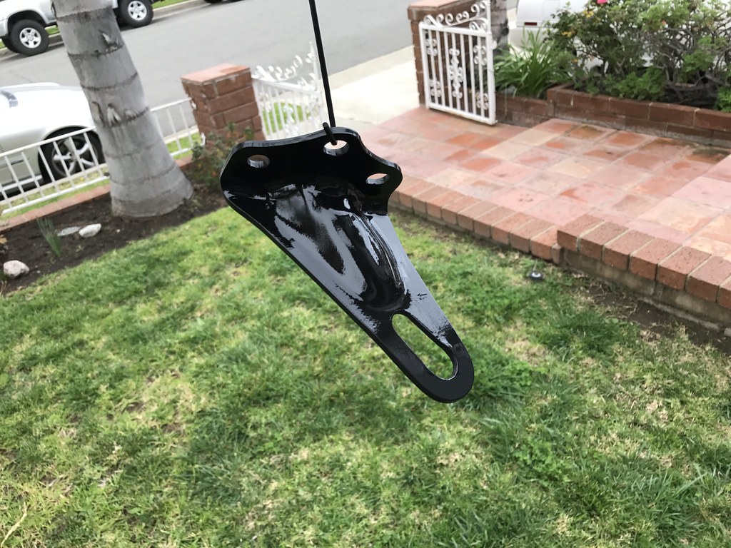

Rear tow hook

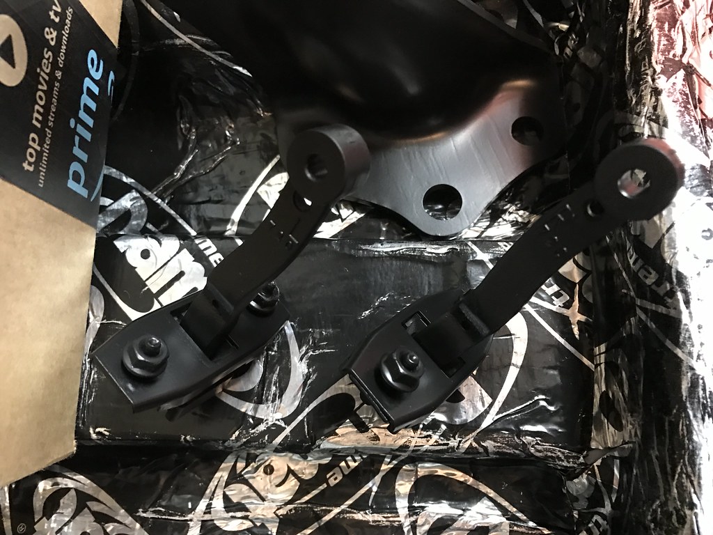

Door check straps

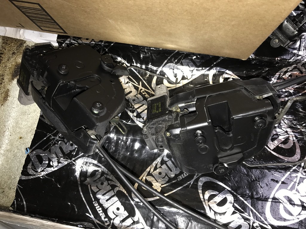

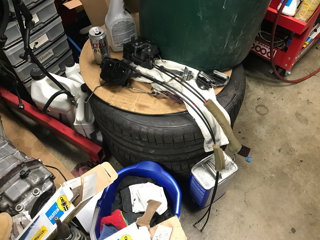

Lock actuators and hardware

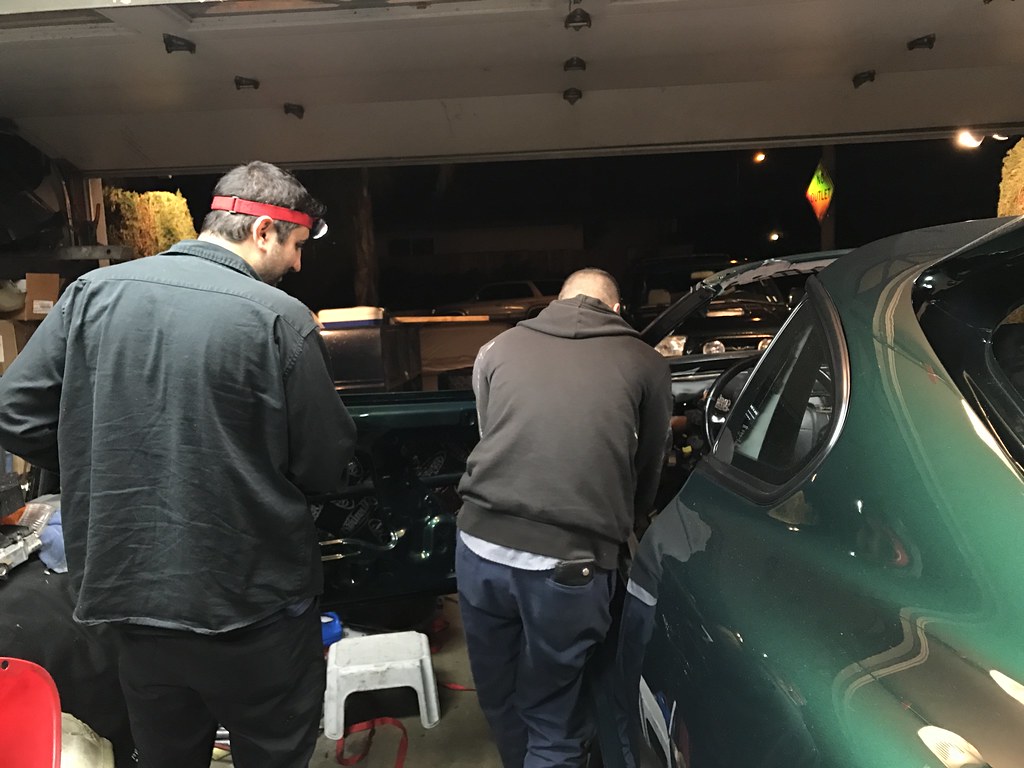

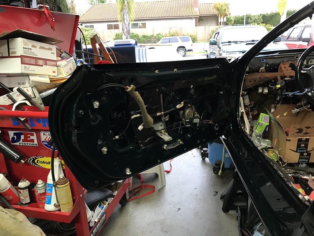

While the door is still light, it's easier to hang for assembly.
First thing to be installed is the check strap, so you don't open the door too far.

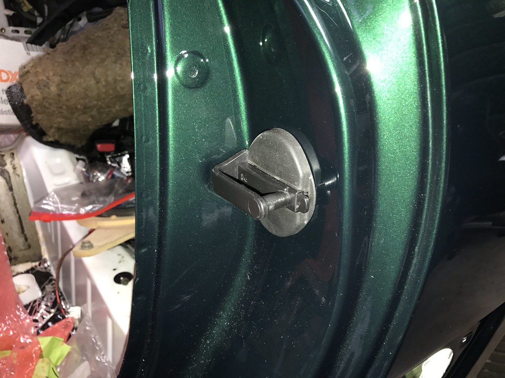

Next things are the latch and door striker.

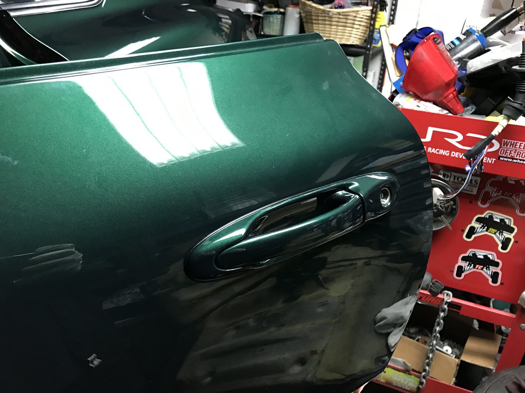

Door handle

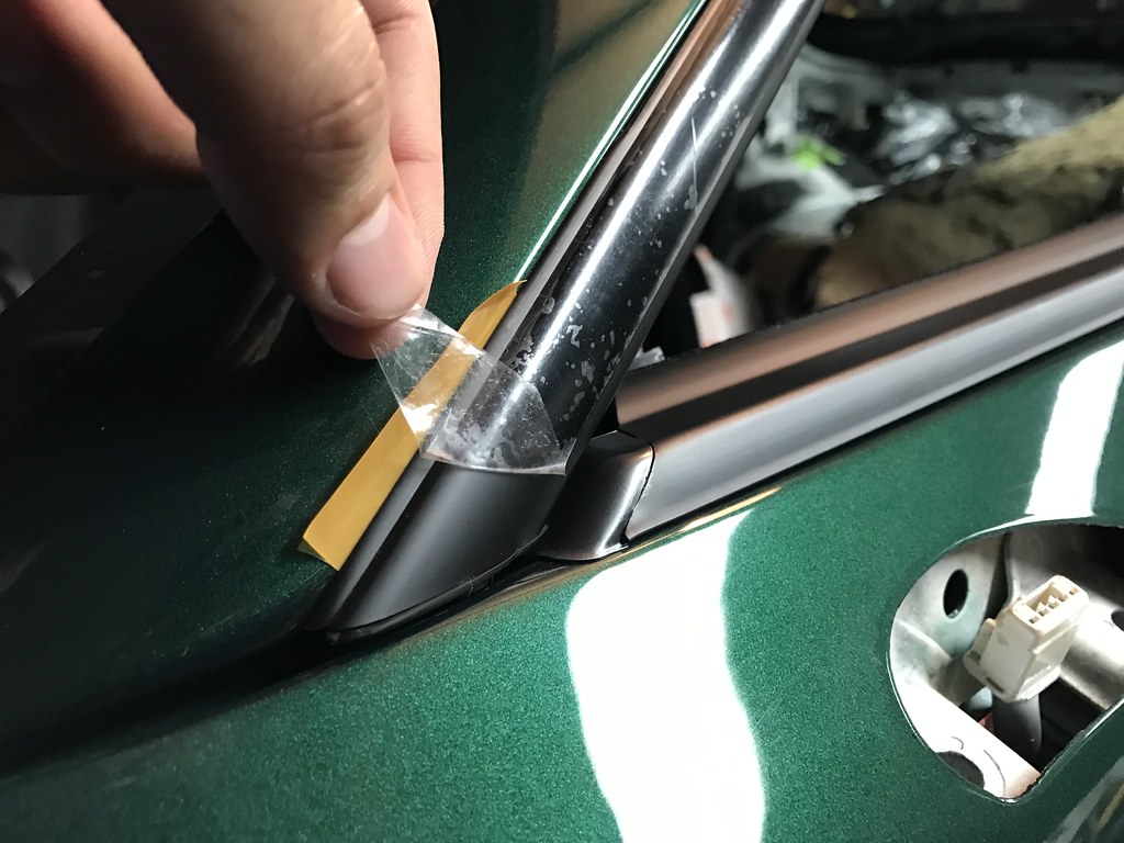

Belt molding installed with new screws
Flashback...
Night and Day! Brand new door seal also installed. Next is installing the window and a little soldering of a broken wire.

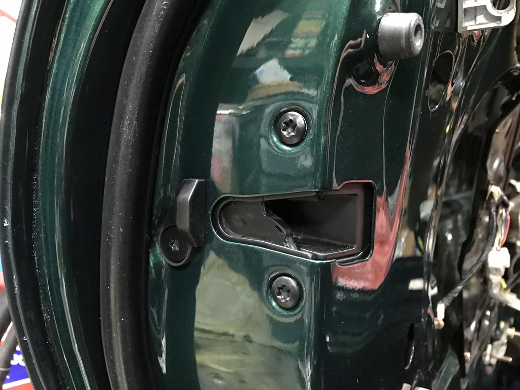

Closeup on the door latch... will be replacing the black hardware with color matched hardware later on.

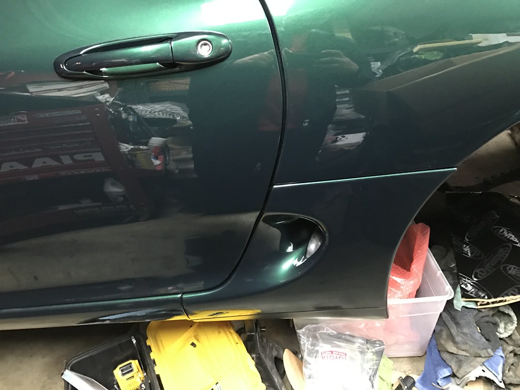

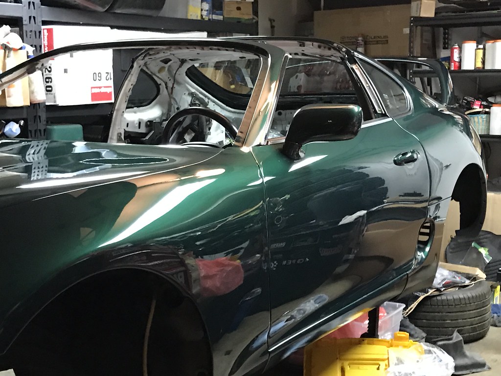

Wiped her down and used some spray on wax... shiny!

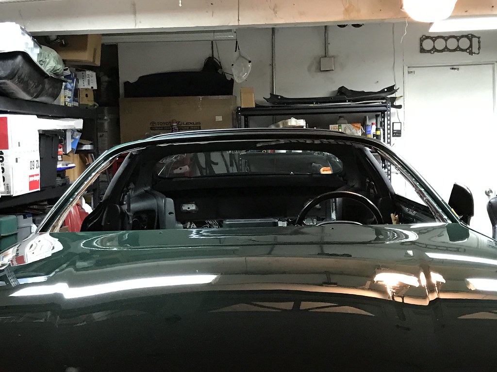

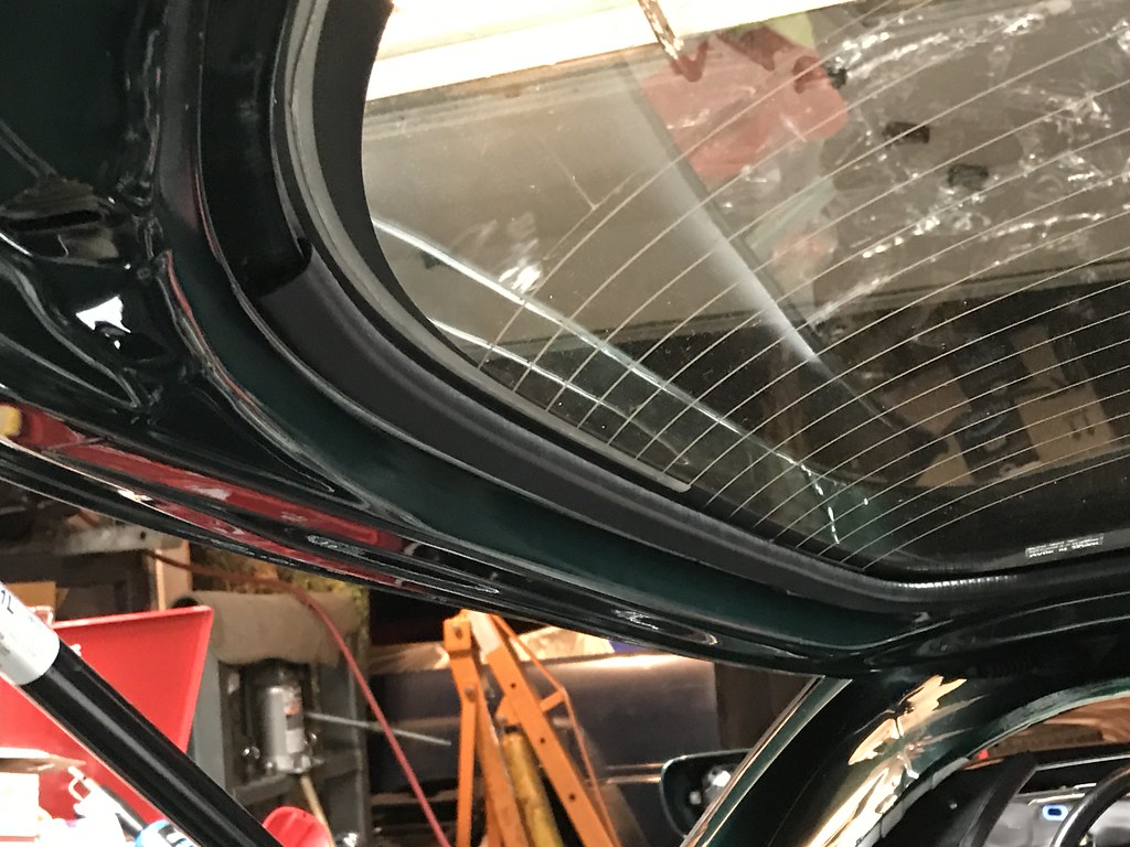

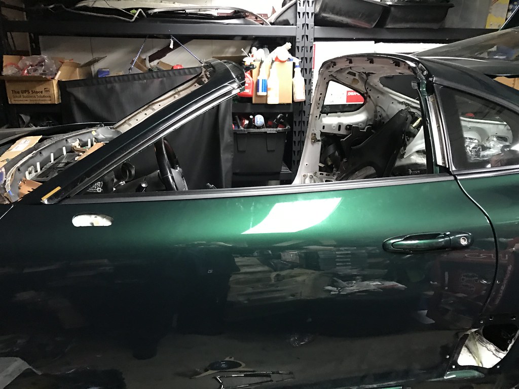

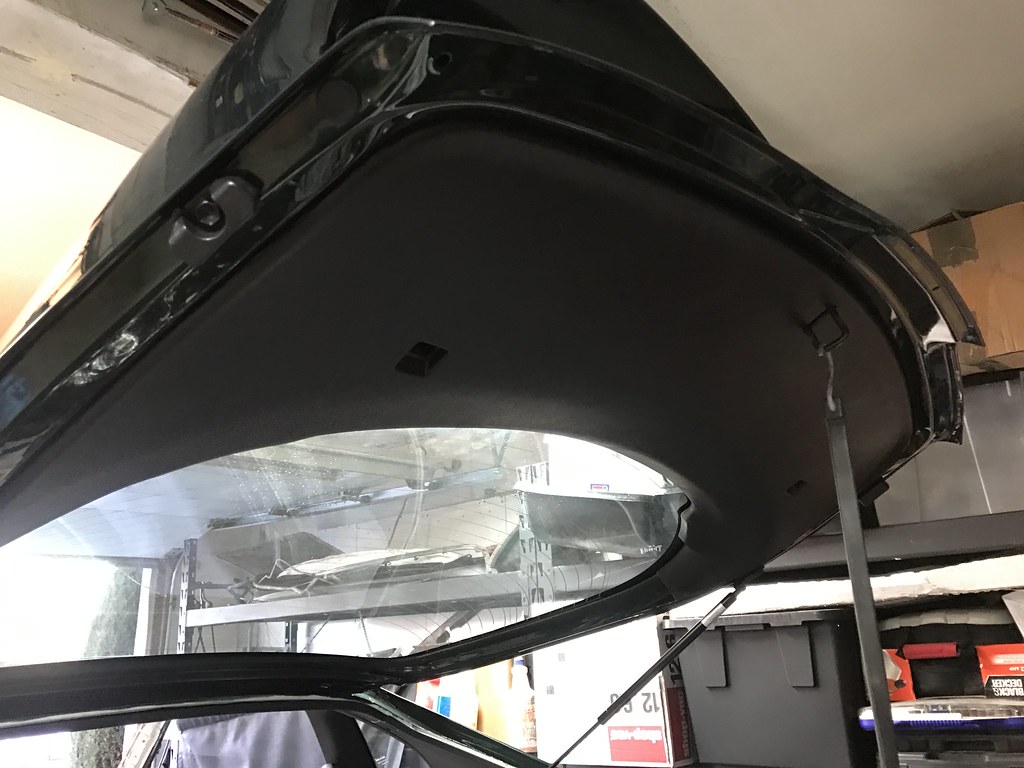

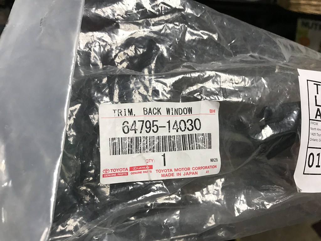

Rear window trim for the inside has been installed... the hatch is just about done. Needs the interior panel installed and that's it.

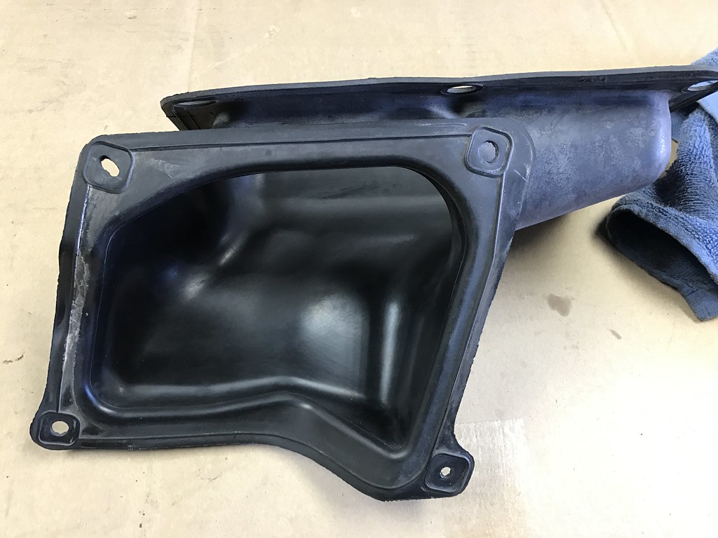

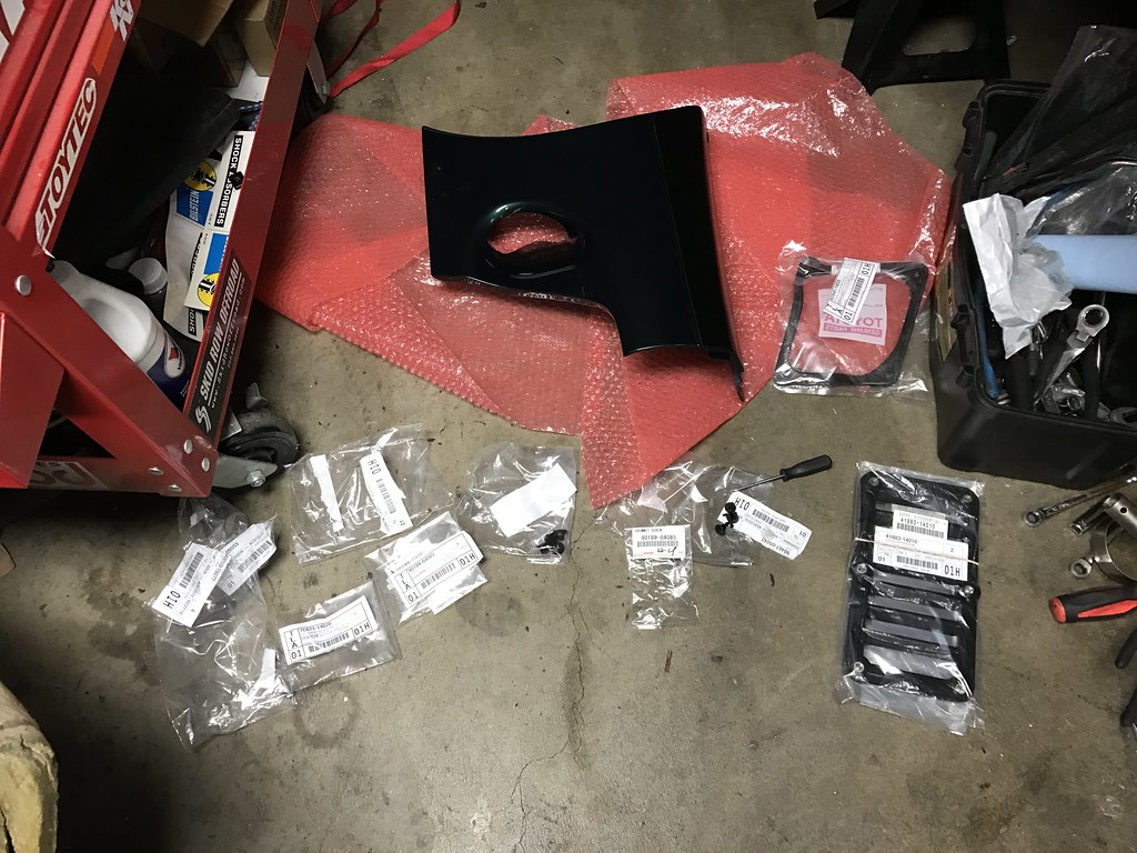

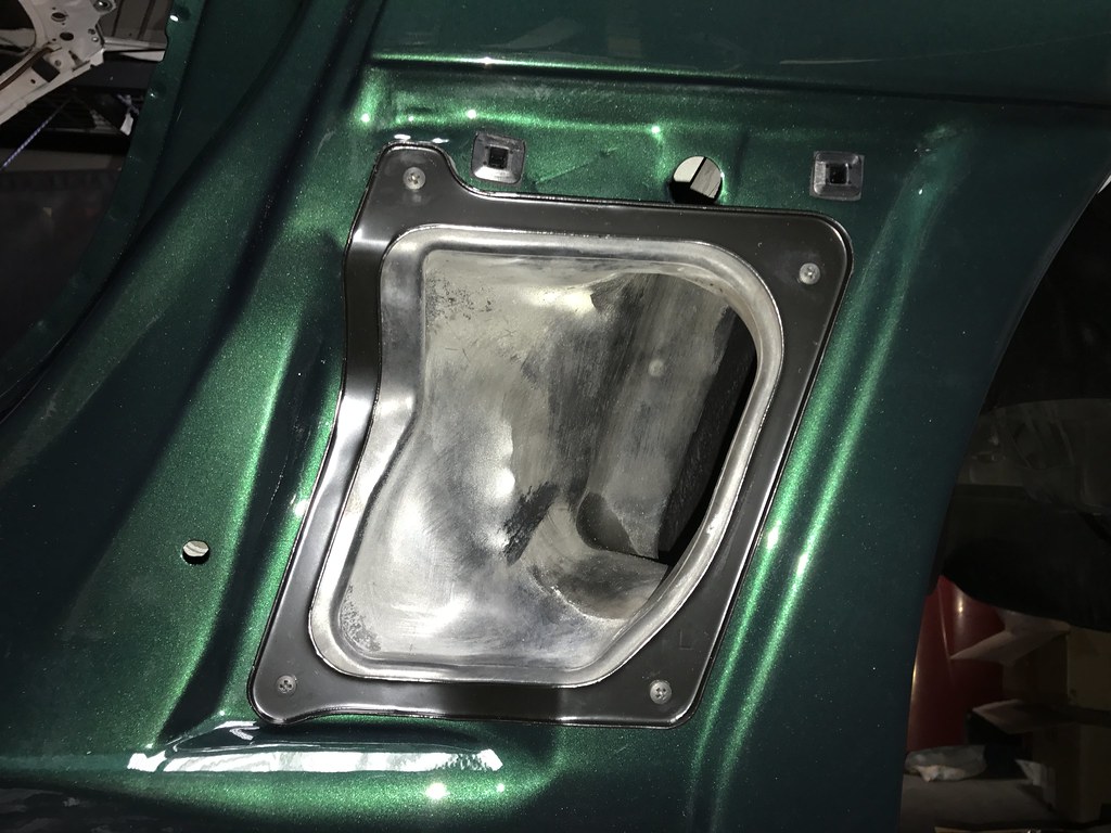

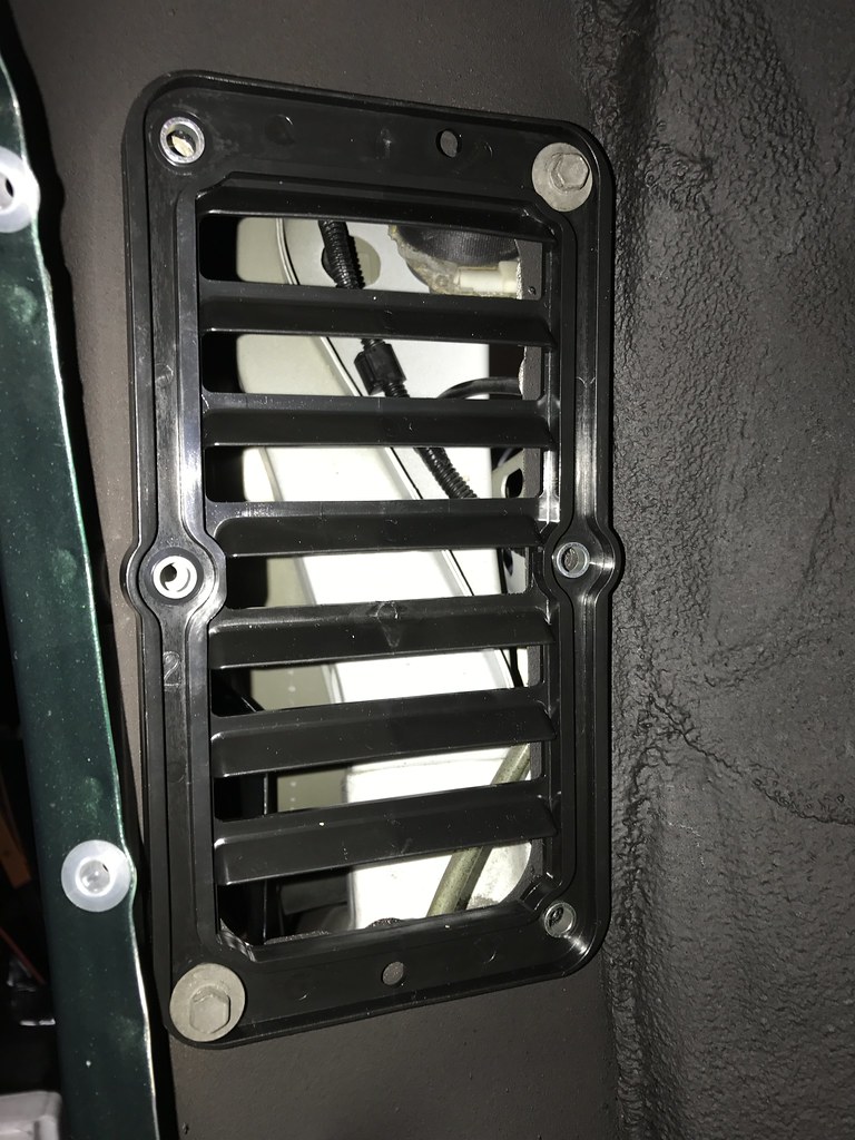

Side duct...
Side duct boot retainer

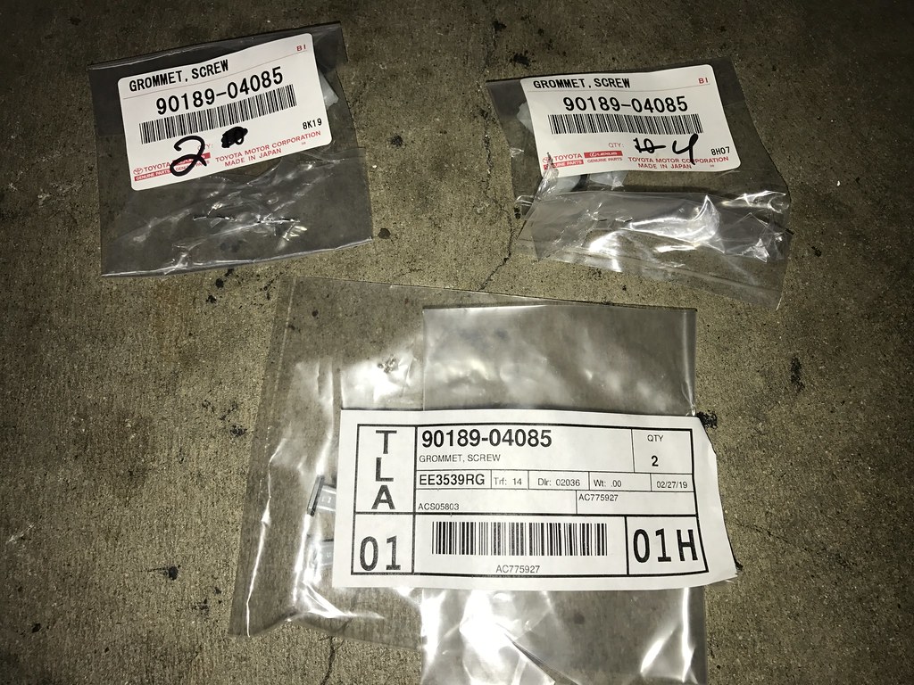

Boot retainer grommets
Duct retainer grommets
Wheel well clip retainers

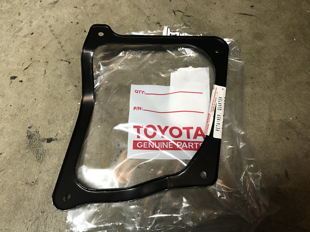

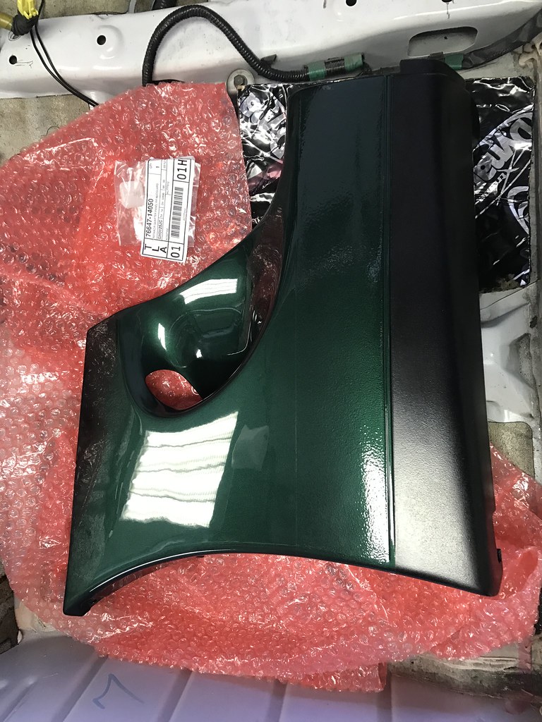

I realized that I'd forgotten to order the lower clip that attaches the front end of the duct, so those are on order and the duct will have to come off once more. I also have all of the new rocker panel trim to install which will help the panel flow a bit more.
New duct grates

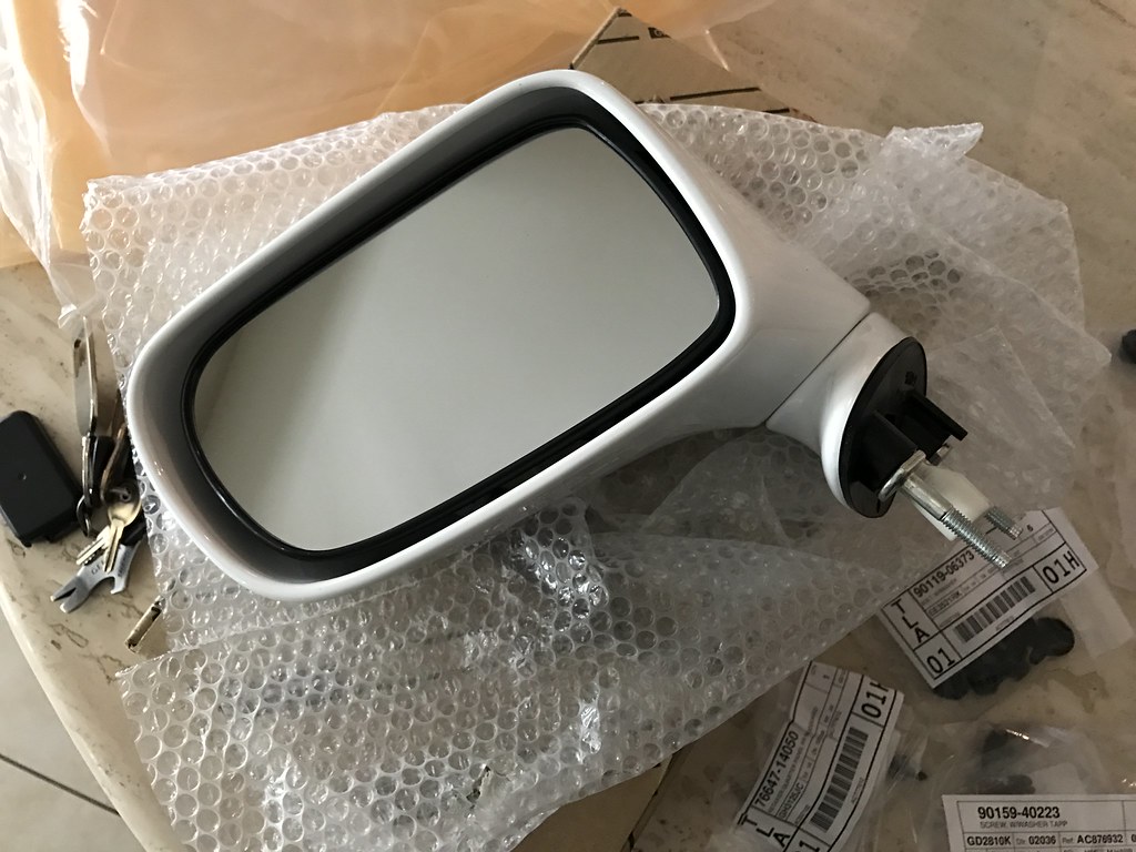

Mirror installed

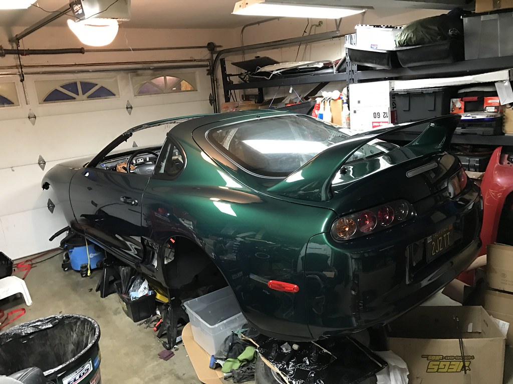

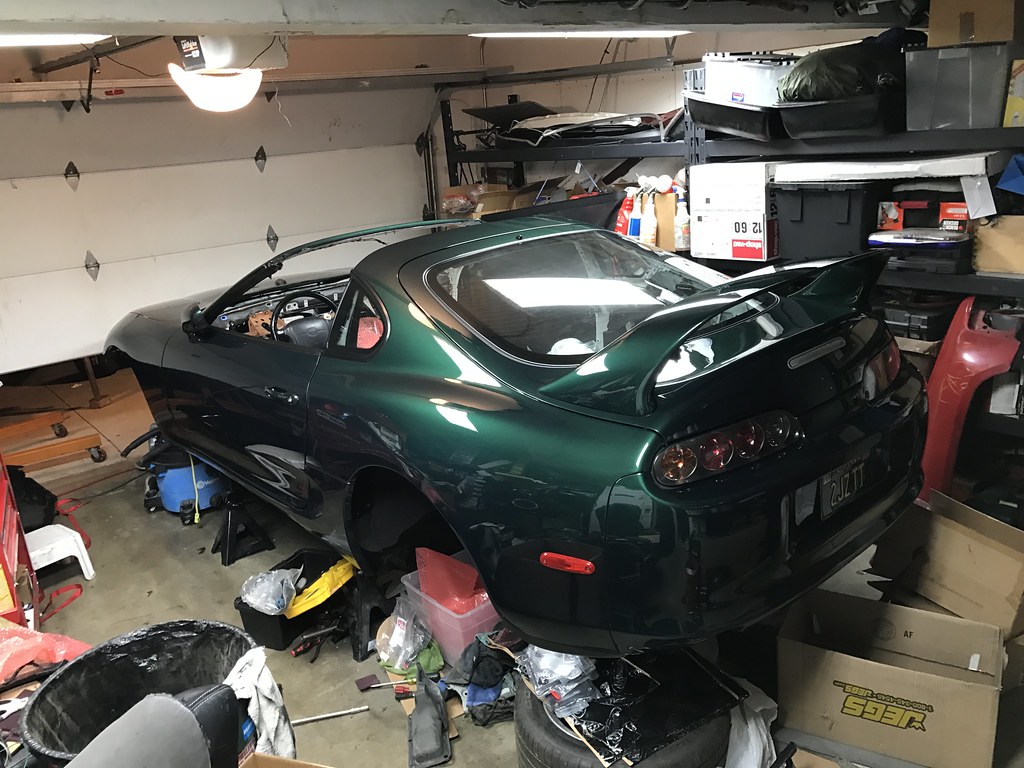

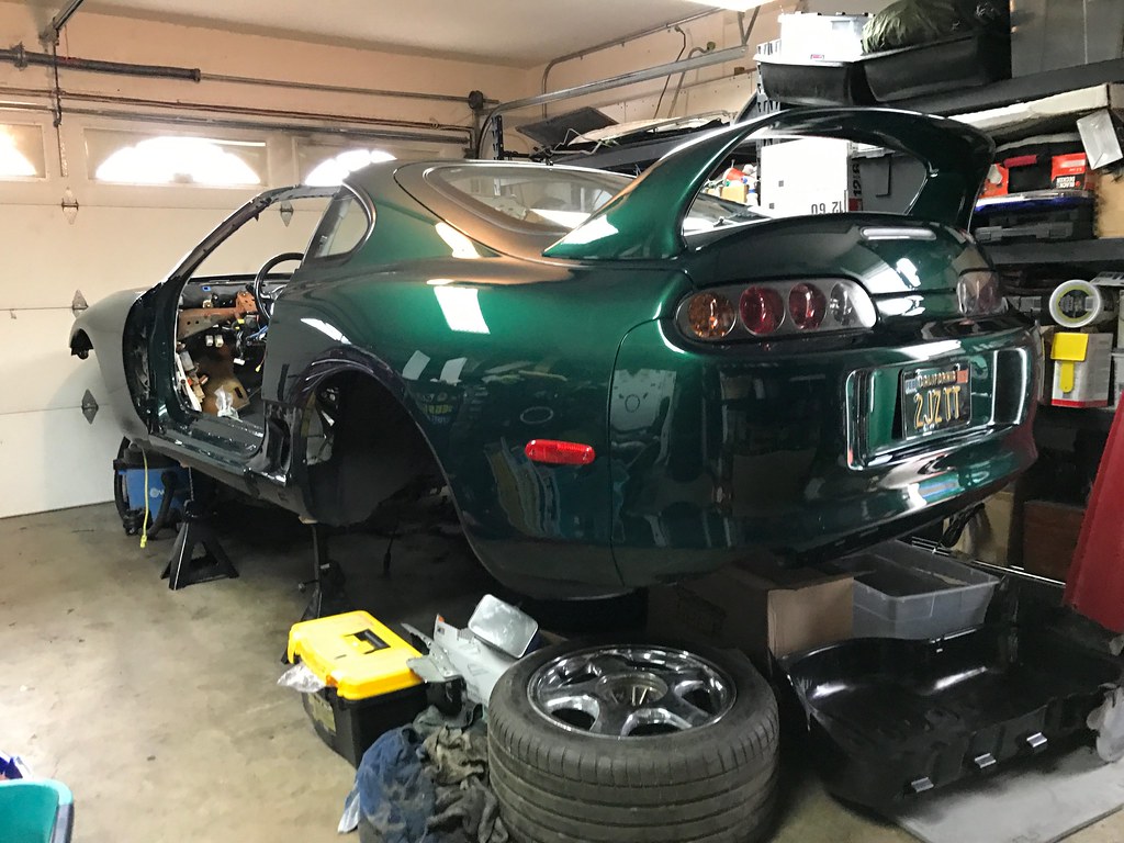

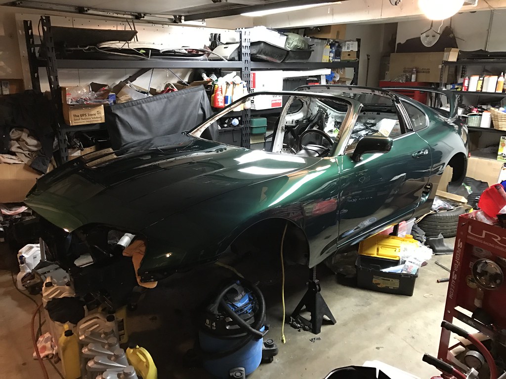

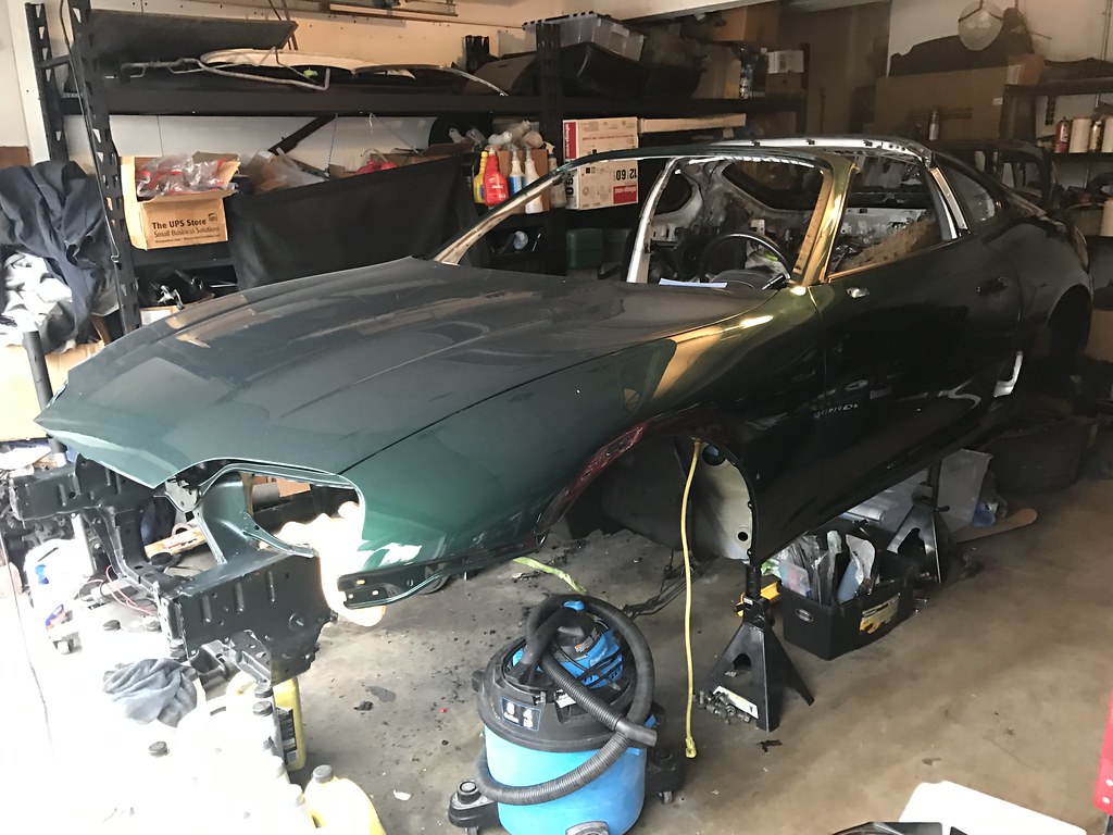

Squint and it kinda looks like a car... lol
The obligatory garage angle

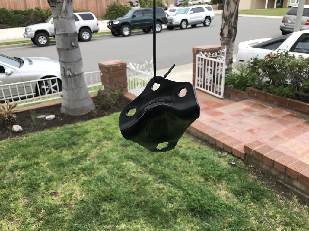

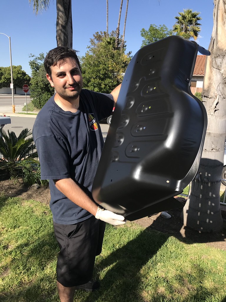

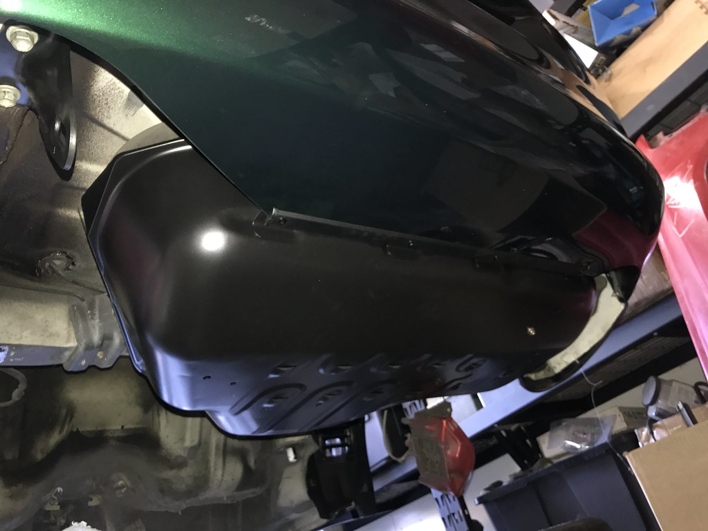

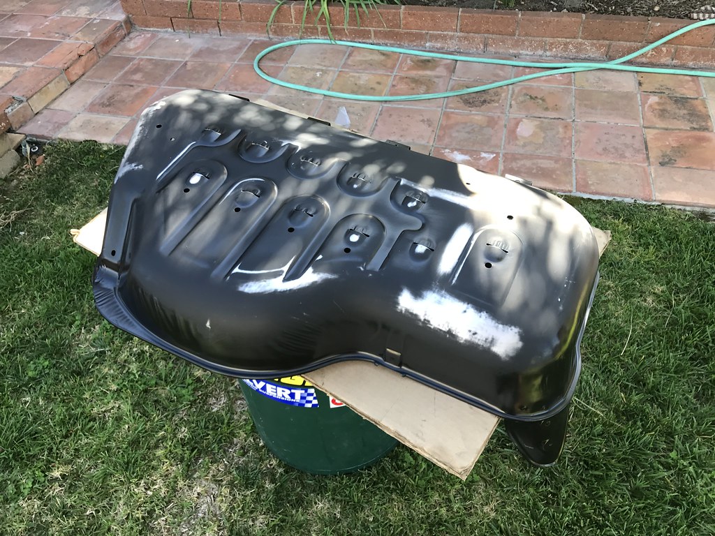

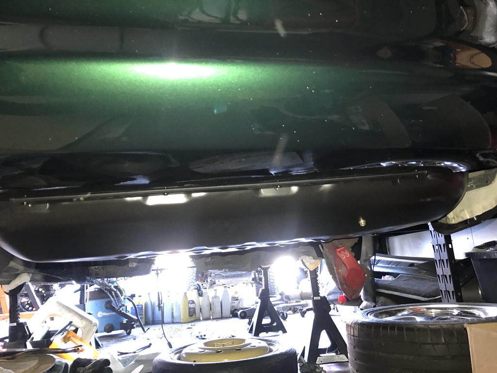

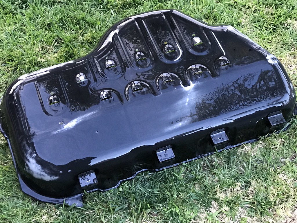

Sanded the scratches out of the fuel tank skid.
Gave it a healthy coating of flat black using SEM 39143
Installed with new bumper retainer and zinc coated bolts...

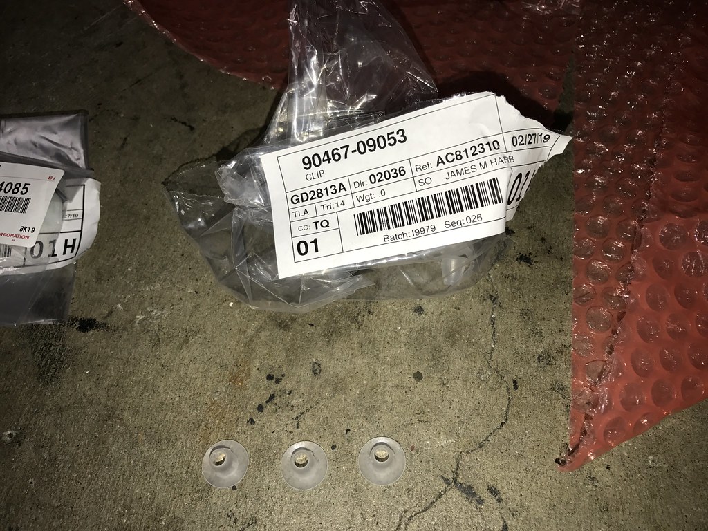

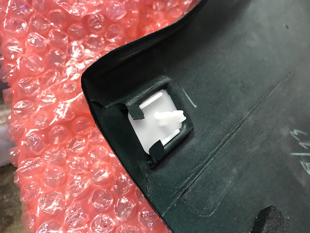

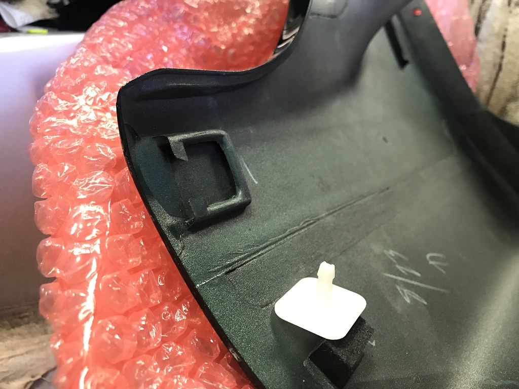

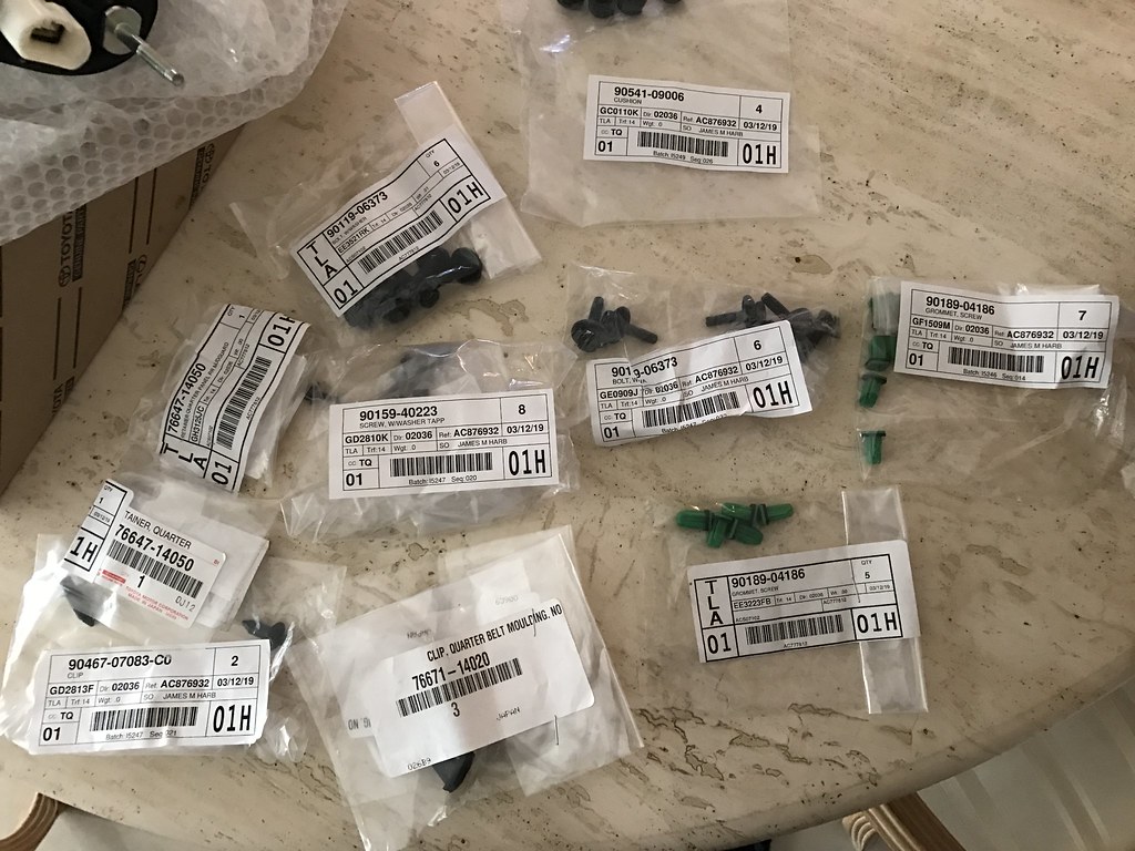

More clips...

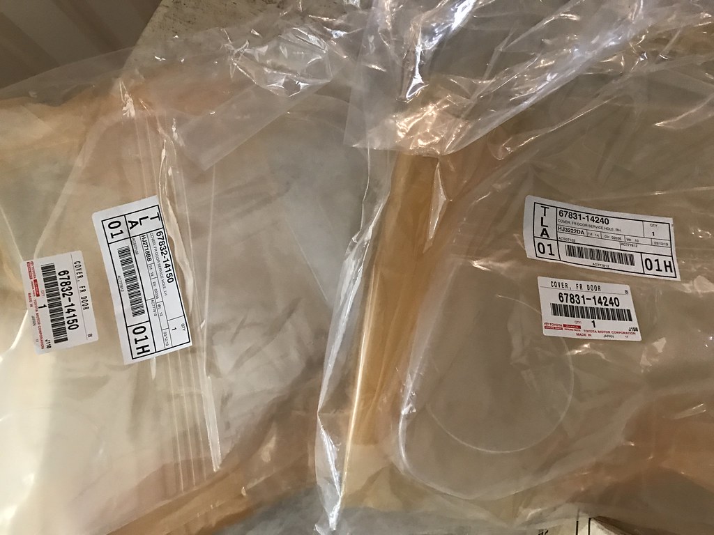

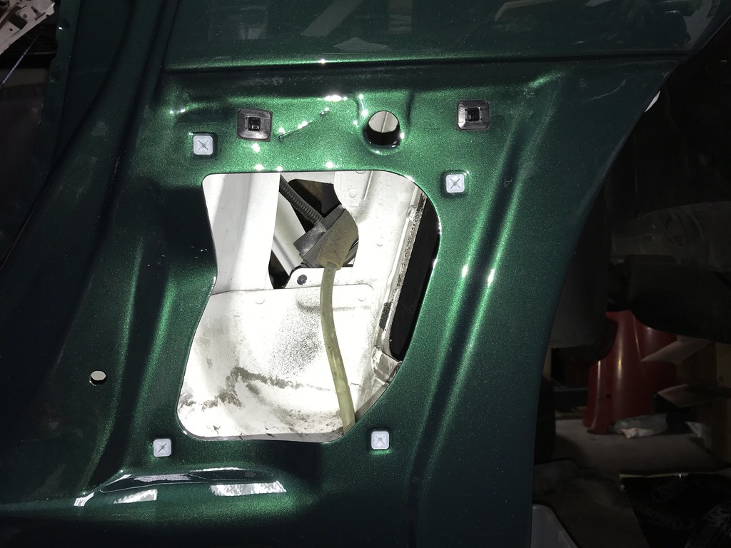

Even got a replacement pair of door plastic covers...
Had to get a complete new mirror assembly to find a suitable replacement glass. I had tried out some aftermarket Burco lenses, but did not like how there's a part number visible when installed. This was the only way...

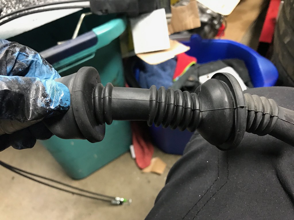

Going to the passenger side duct. Cleaning the rubber boot with lacquer thinner.
Freshly painted :D

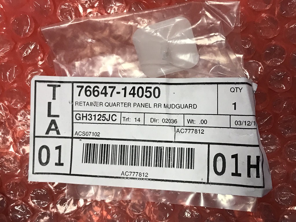

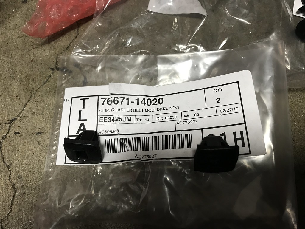

Side clips/retainers have arrived.

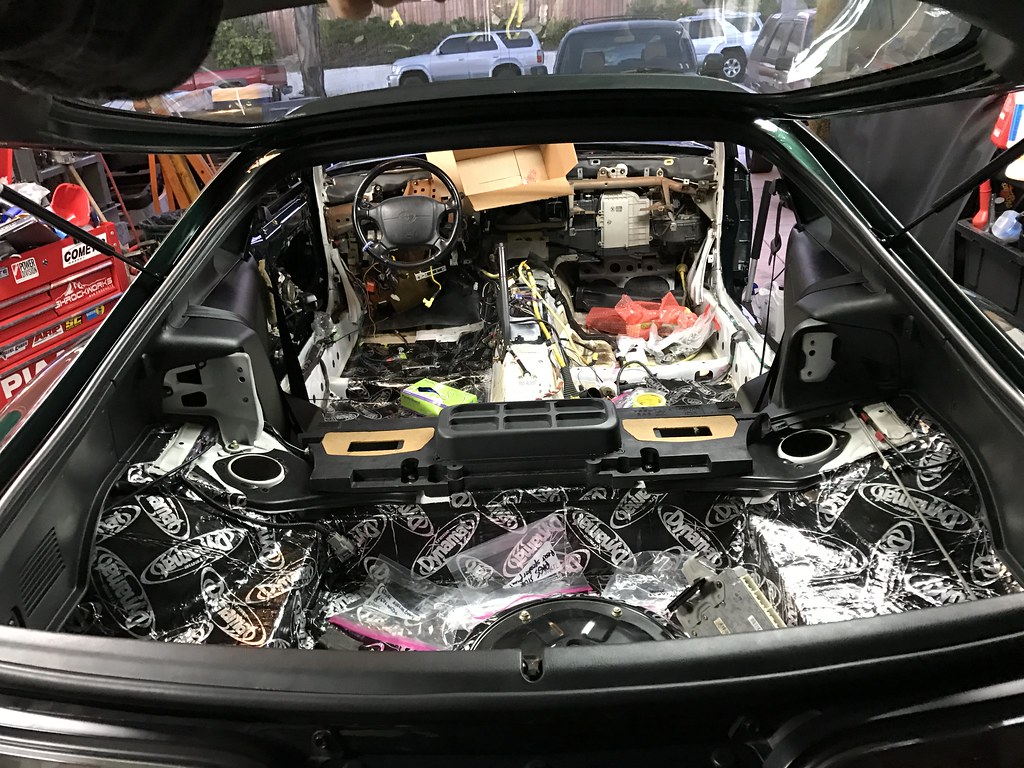

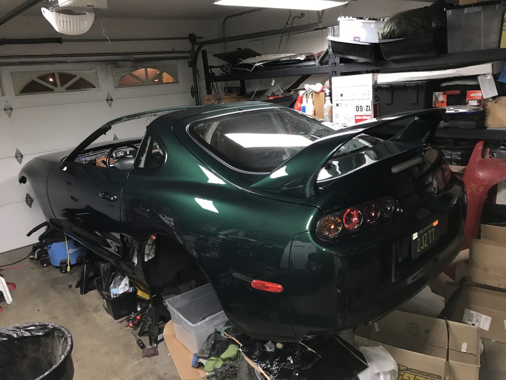

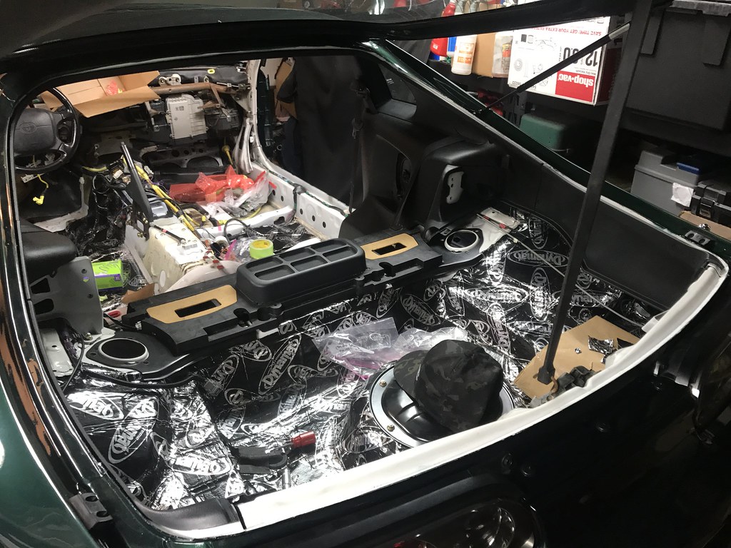

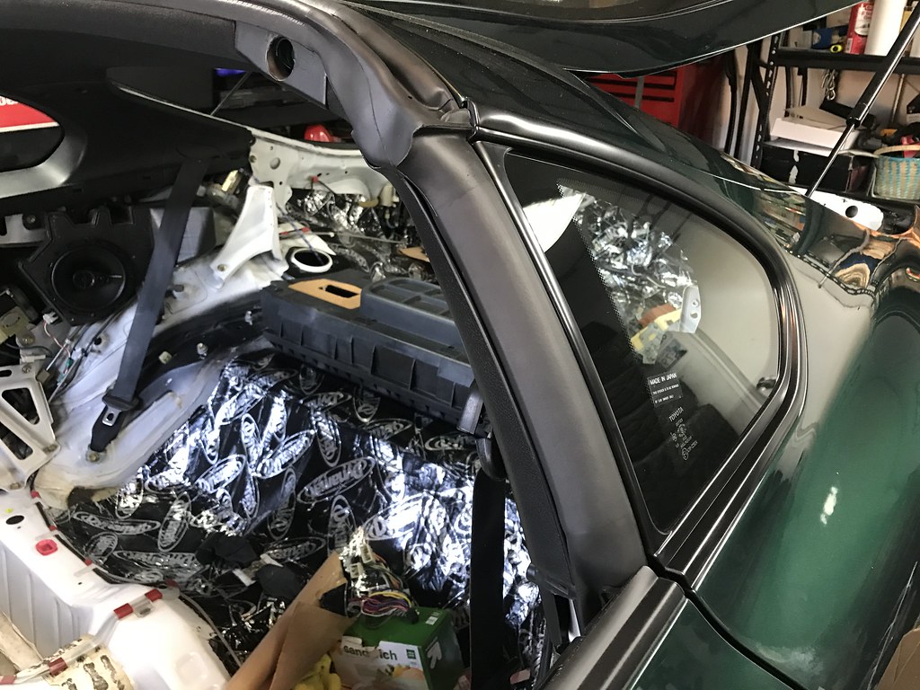

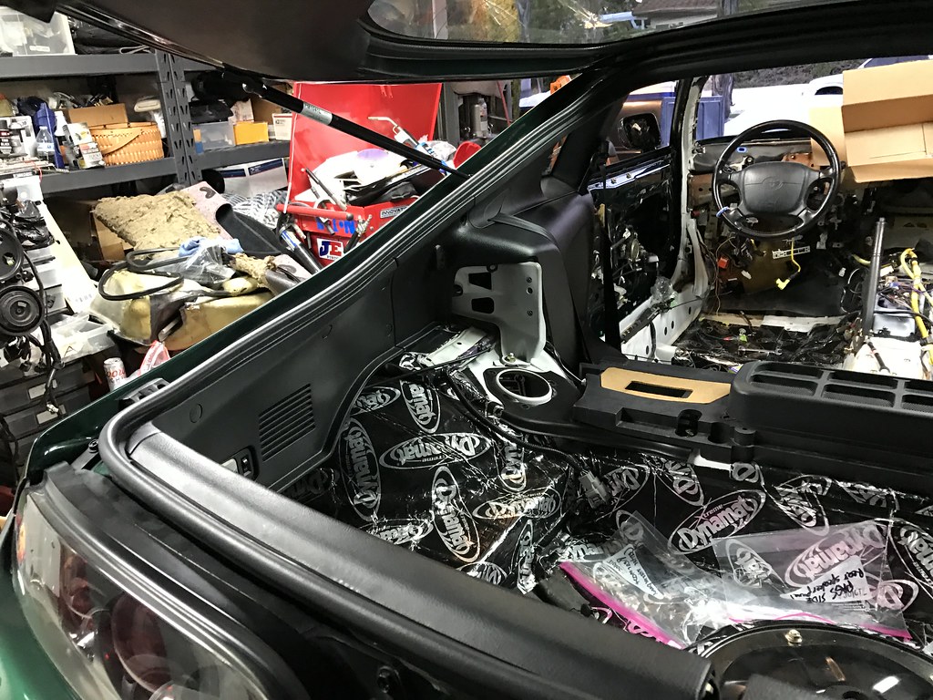

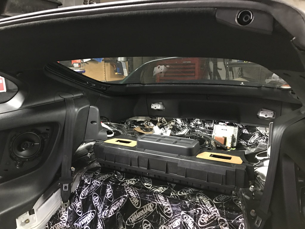

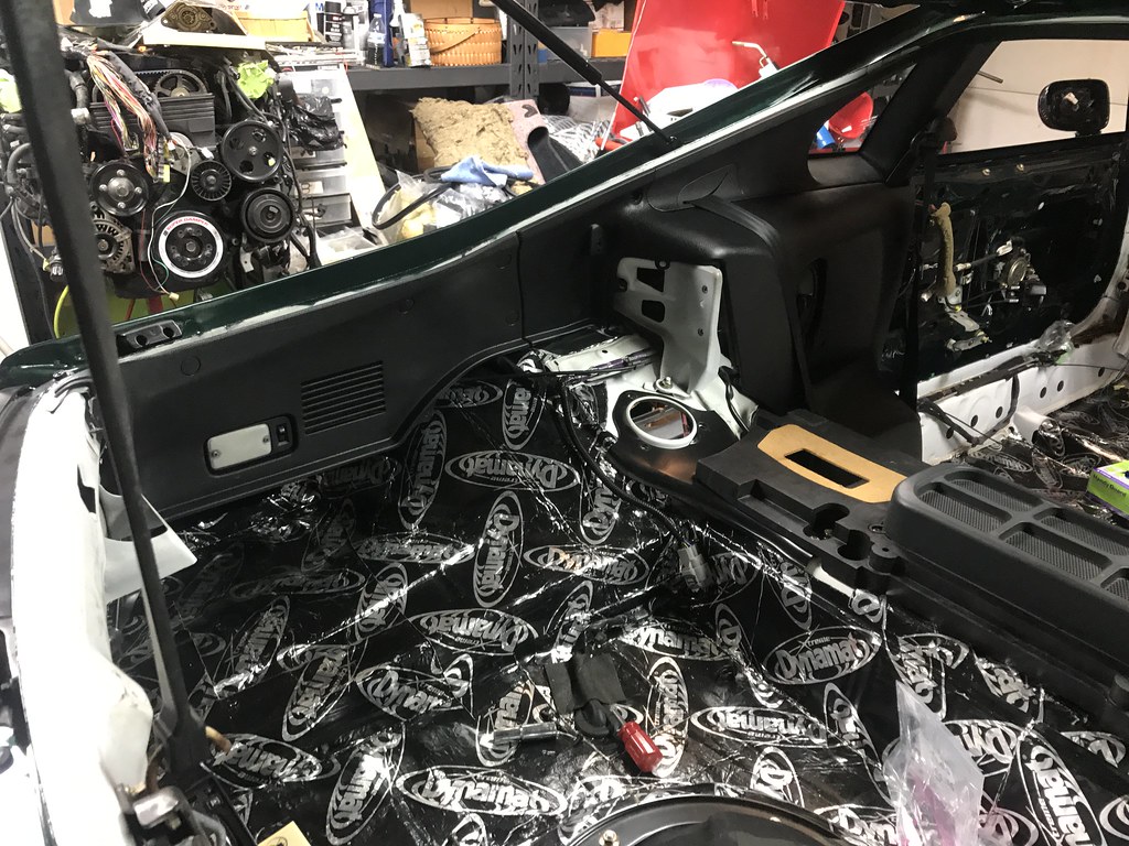

Subwoofer box back in after the dynamat

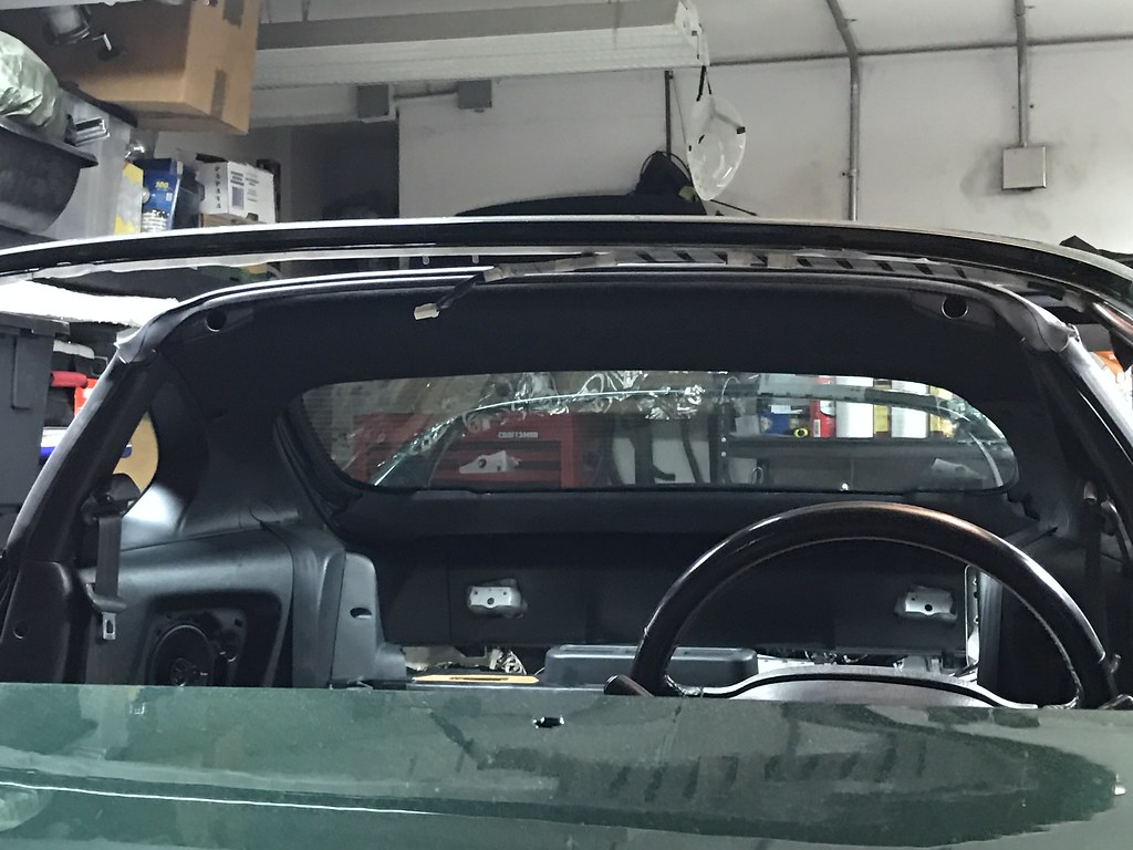

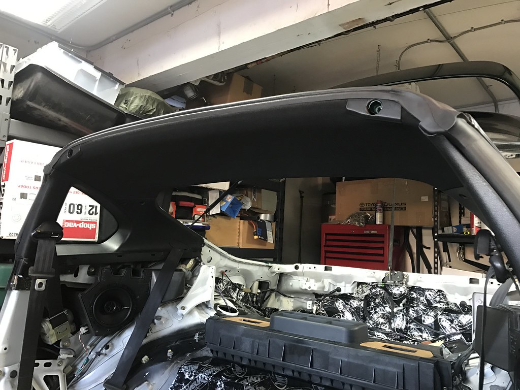

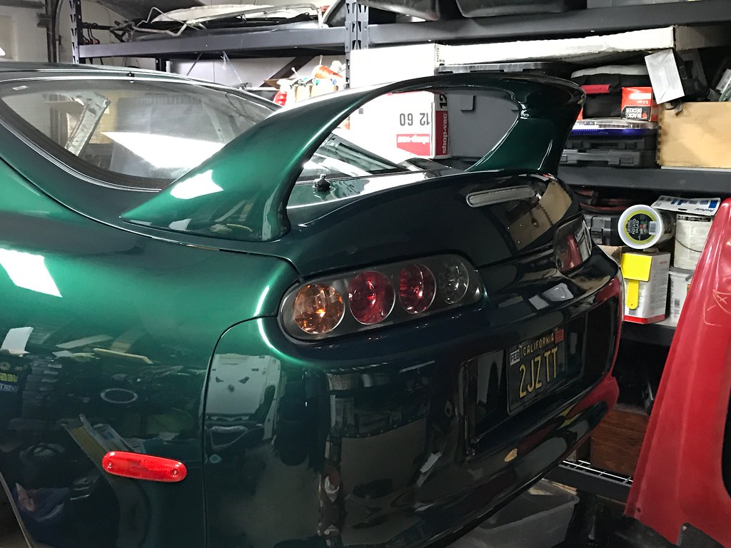

New rear targa seal has been installed
plus the rear headliner and quarter window panels.
Rear hatch plastic installed with cargo cover retractors
Passenger side plastics
Driver side plastics
Cargo area is almost complete.
Brand new hatch seal

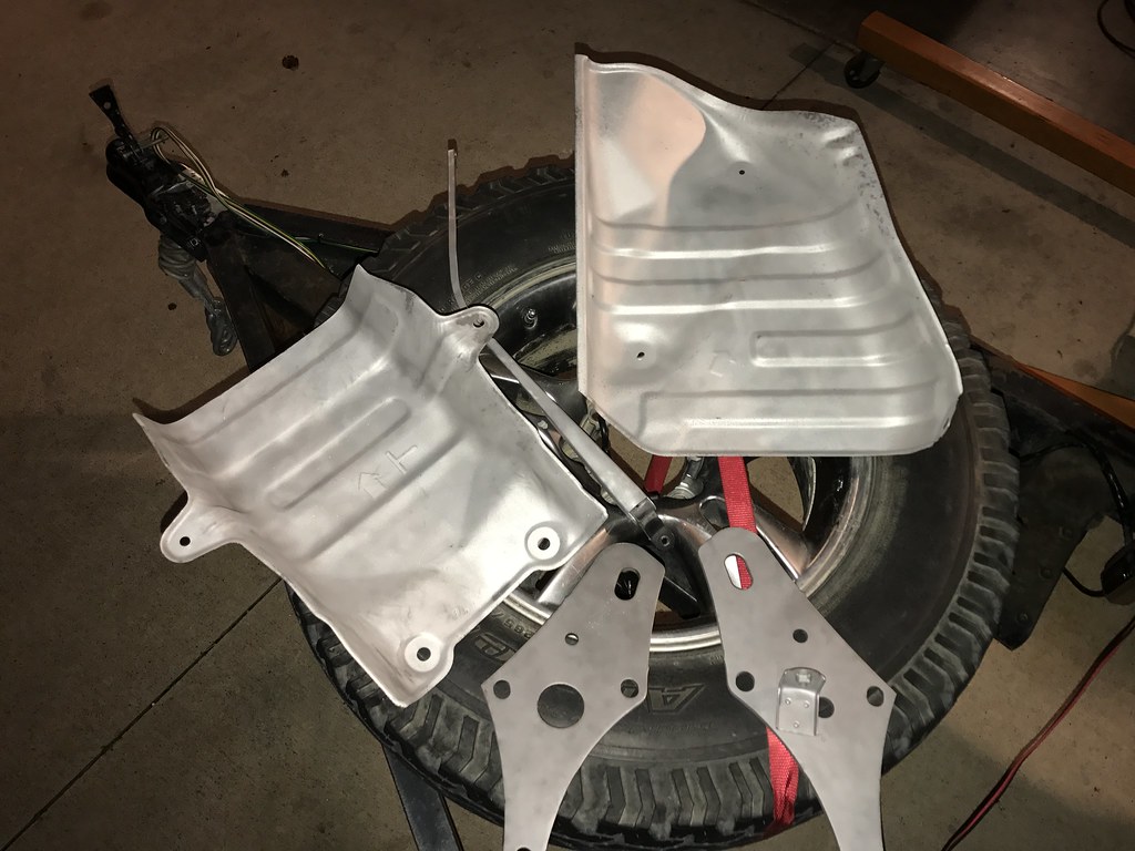

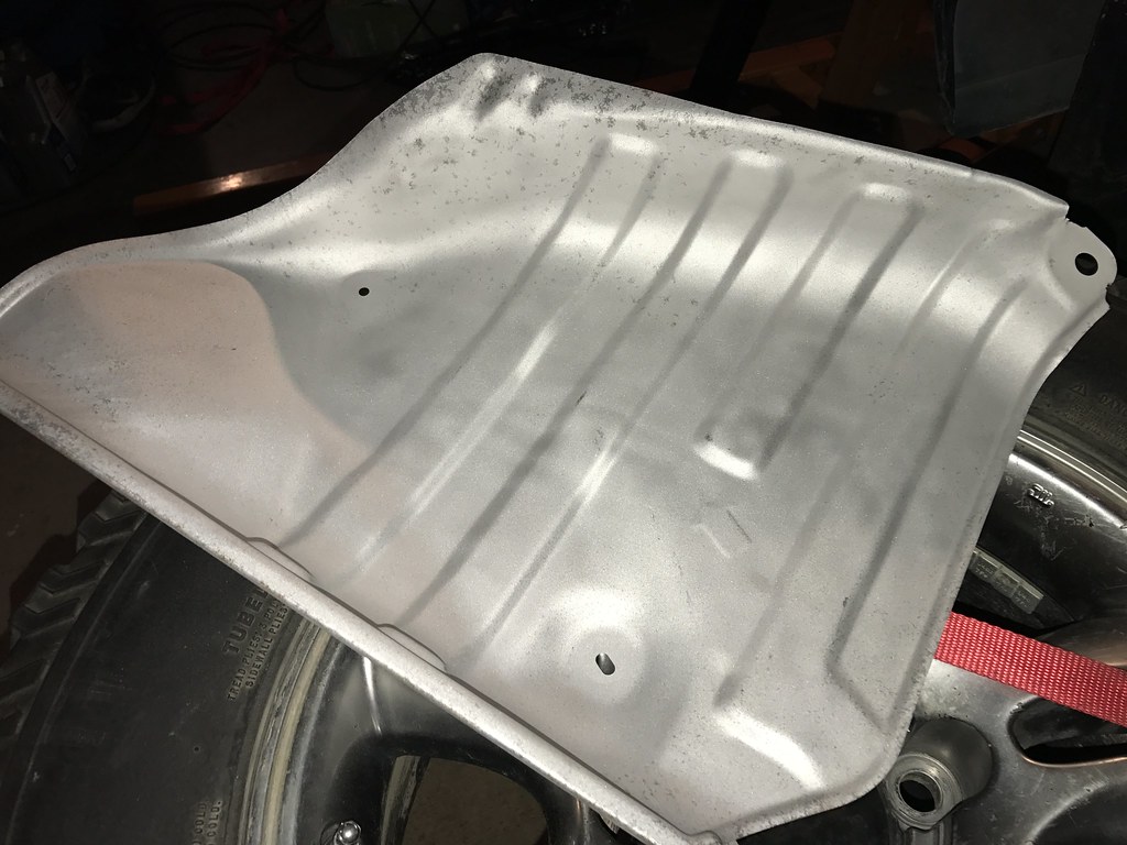

I also borrowed a sandblaster and cleaned up the exhaust heat shields, rear wiper arm, and front two tow hooks, all to be painted with SEM trim black 39143.
The shields were especially disgusting, seeing how they came out is really motivating me to sandblast more parts.

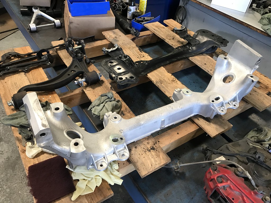

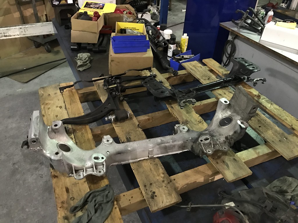

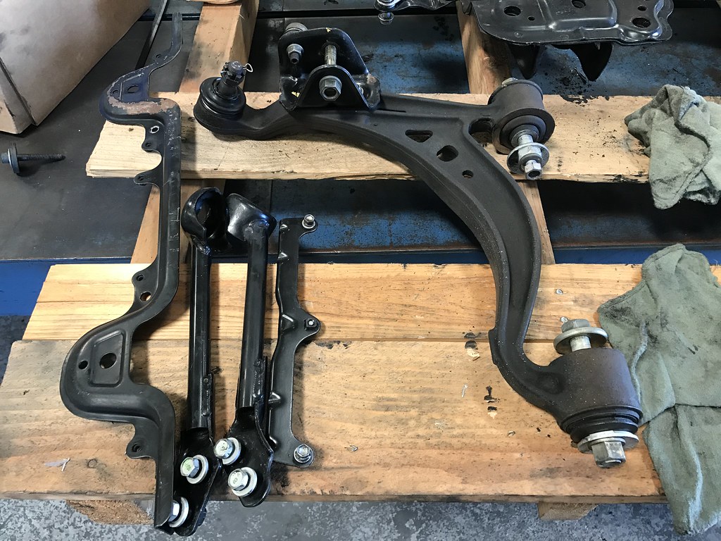

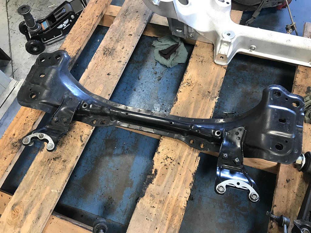

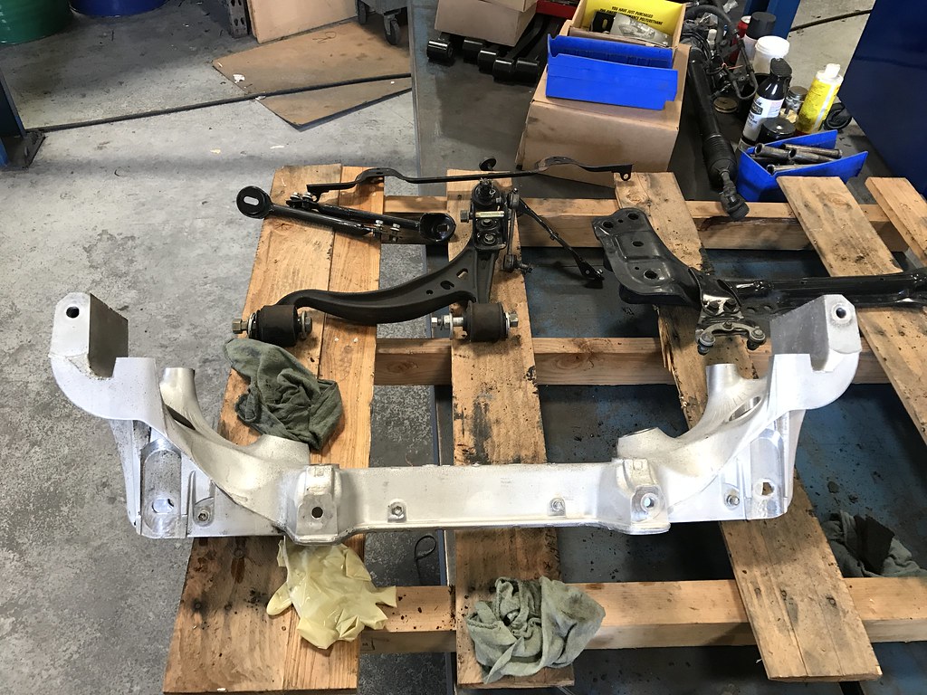

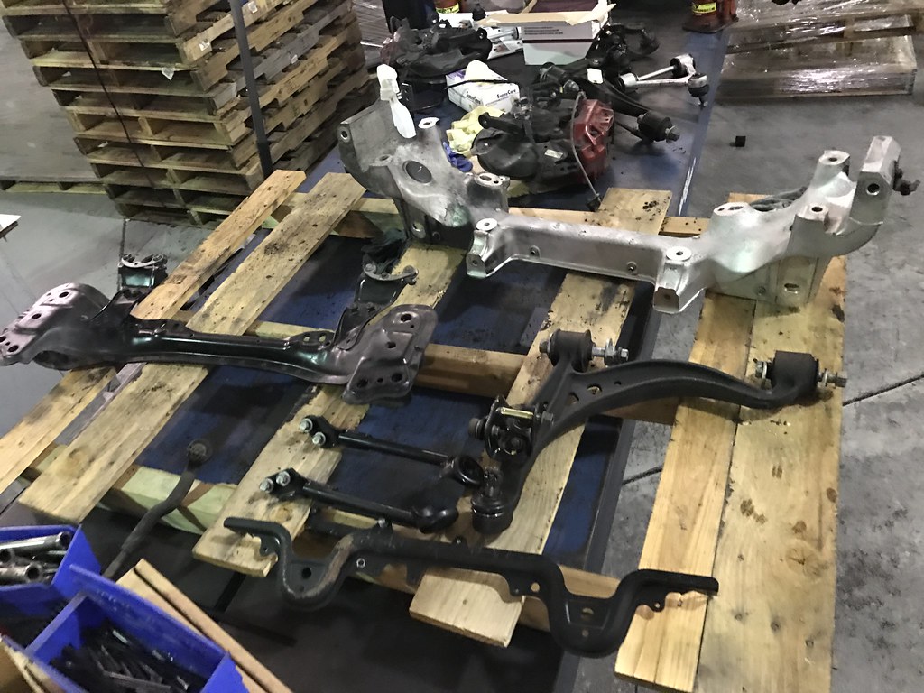

Finally got the ball rolling here on the new bushings.
I'm waiting for the prototypes to be made, in the meantime, I'm cleaning
All blown apart
Started cleaning the aluminum part, it's coming out pretty nice.
Round 1
Round 2
Parts on the left are going to be sandblasted later on.
This part was ultra-coated in grease and took some serious time to clean.
The very first set of MKIV lower control arm bushings should be ready to go on this car within the next two weeks...

Howdy! Sorry for the lack of updates, it took forever to get the subframes back from Energy. Thank you for coming back!
<!-- BEGIN TEMPLATE: dbtech_usertag_mention --> @ChildrenOfBodom <!-- END TEMPLATE: dbtech_usertag_mention --> any updates? Can't wait to see this thing finished.
The subframes took way longer than anticipated, I'm hoping to have regular updates from here until the project's completion.

Thanks huski! I'll try to roll out updates faster now that I have the subframes back from Energy Suspension.
