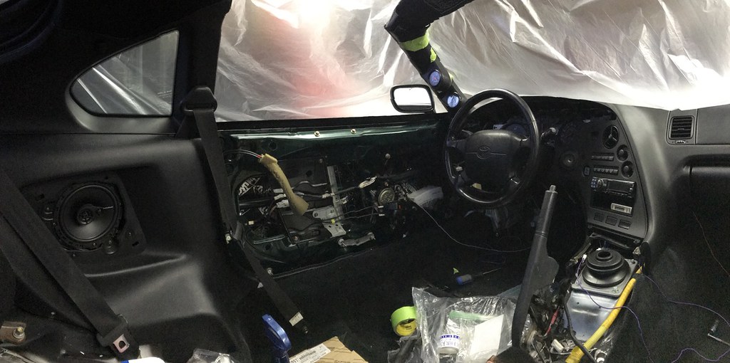

I got through installing the alarm system, which was a huge task. I don't plan to post much detail on that, for obvious reasons, but it is a top of the line system and has numerous backups. I took my time making sure it would be stealthy and as difficult as possible. All the sensors, bells, and whistles.

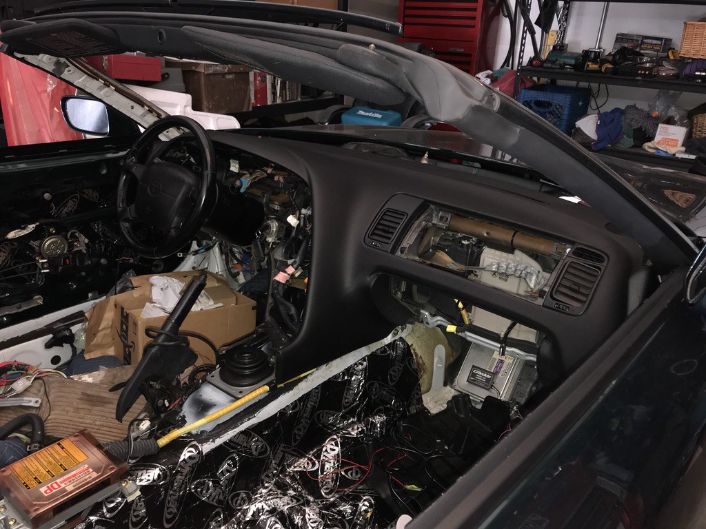

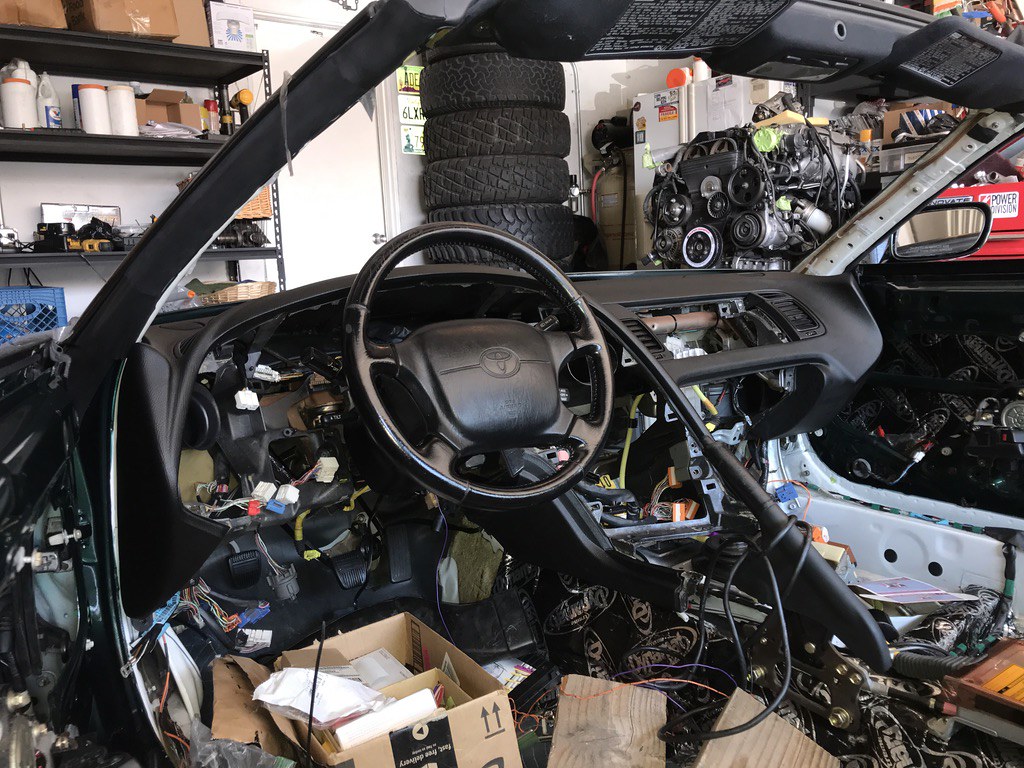

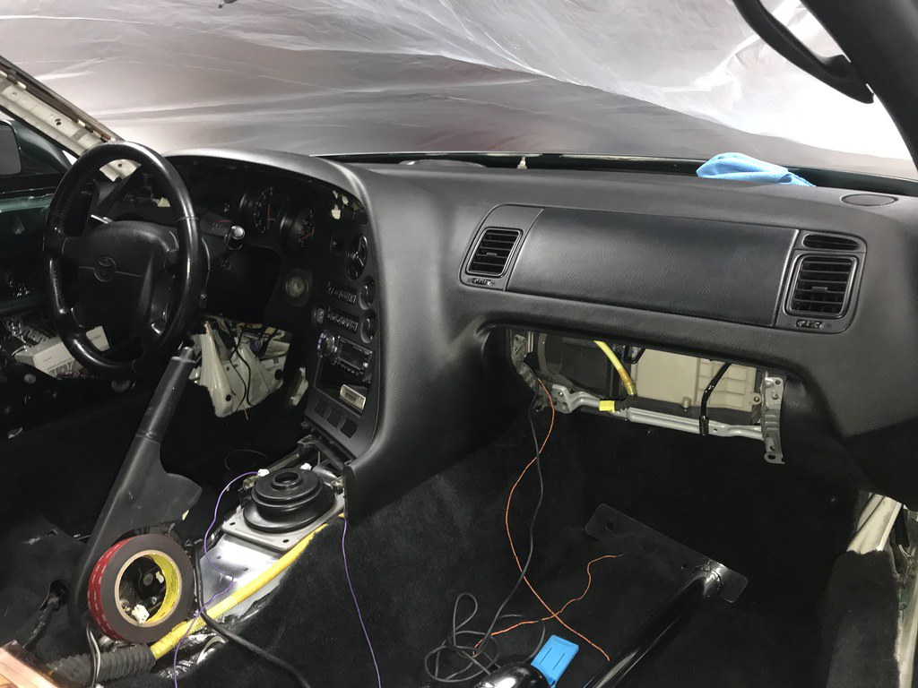

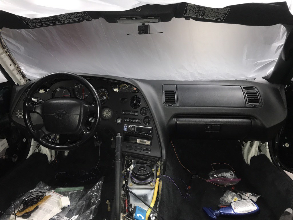

With the alarm install finished, the new dashboard went into its new home.

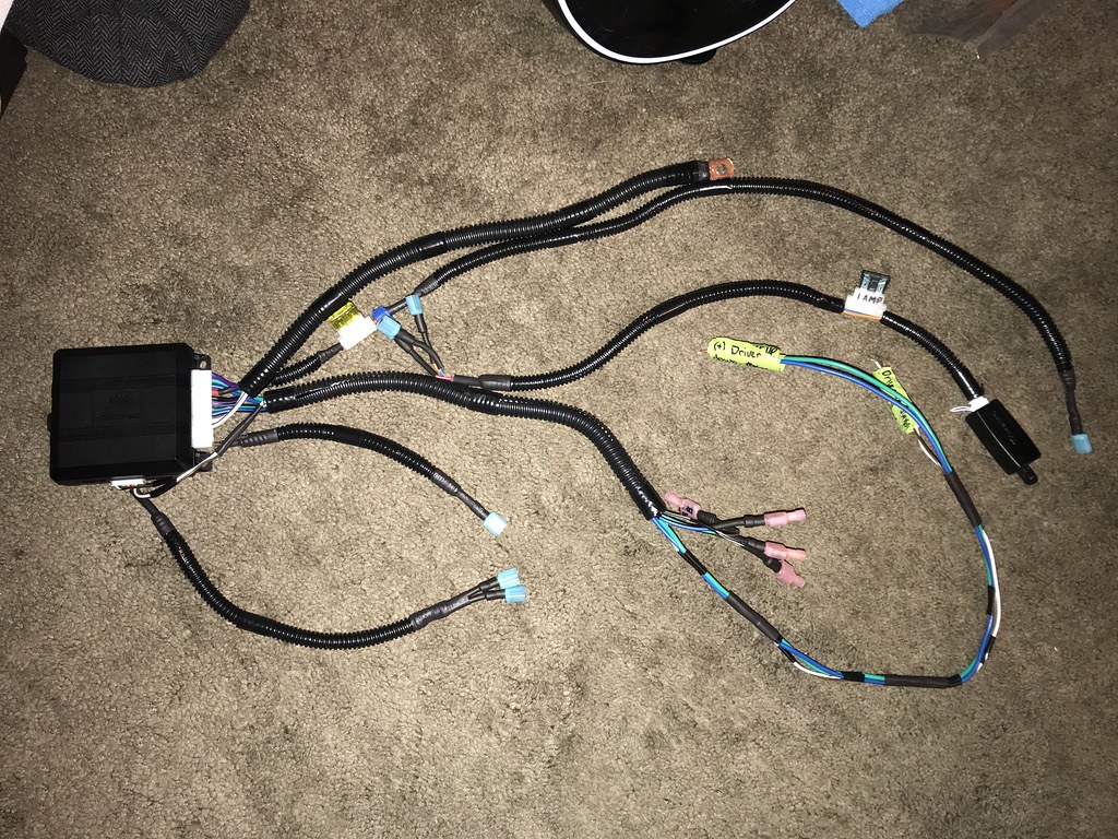

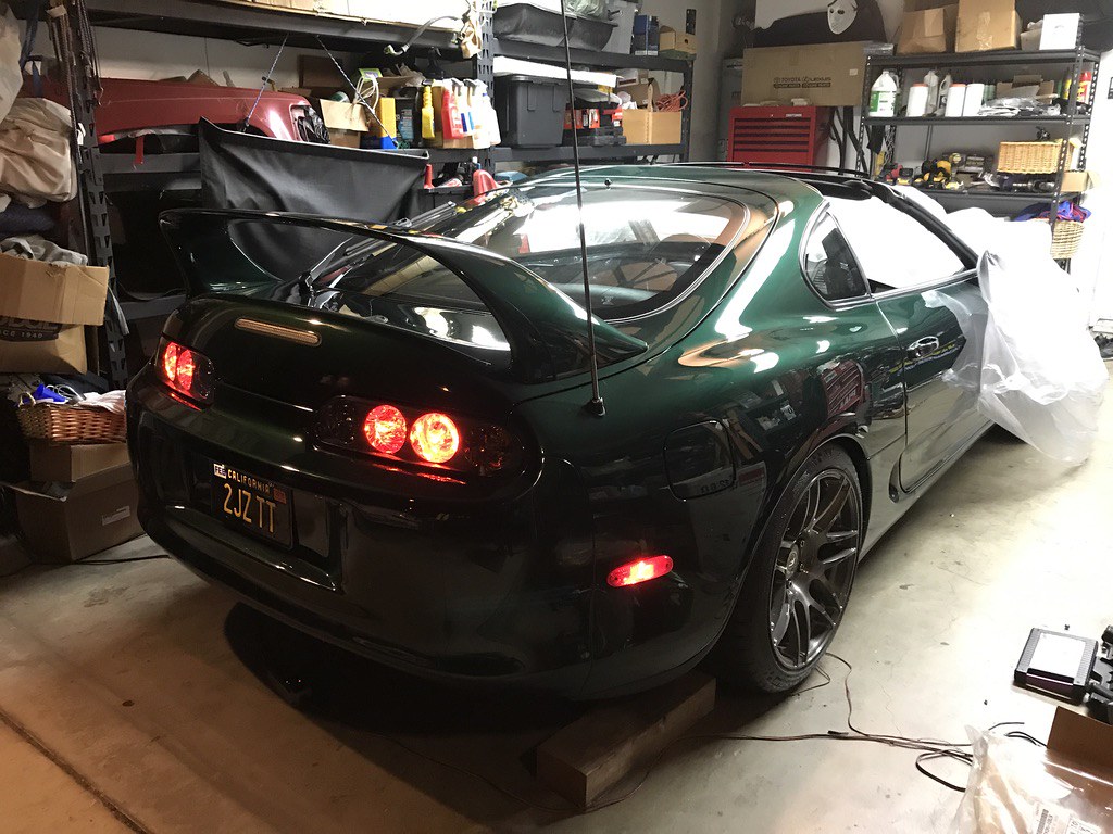

After that, I went into testing various electronic functions. I had make one mistake in the alarm install, the parking light polarity, since I had wired the parking lights to the steering column and not in the driver kick panel.

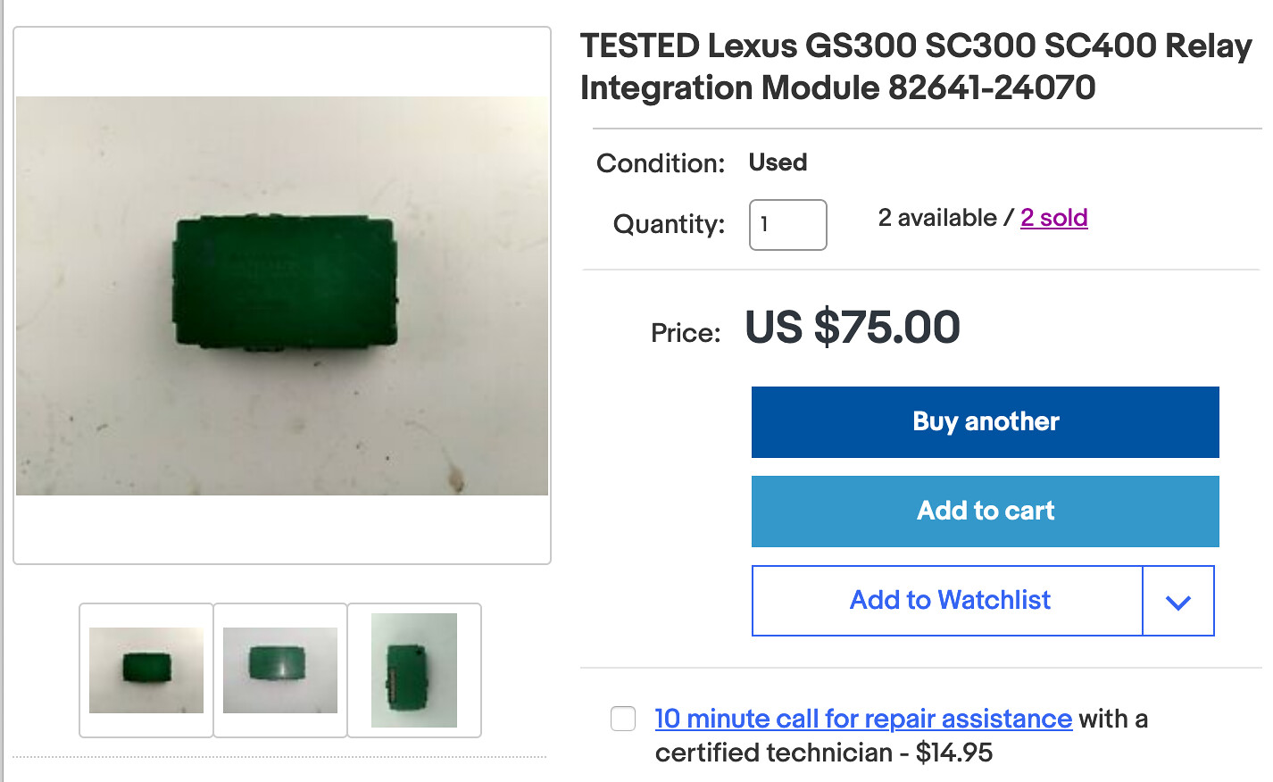

If you wire the parking lights to the kick panel, it needs 12V+, but at the column, it's a switched ground.
Upon initial testing of the alarm, the 12V+ signal that went to the steering column parking light wire had been incorrect, and the very first thing to be shorted in the circuit is the integration relay. The integration relay controls all of the courtesy lights, parking lights, etc. It's located BEHIND the driver's junction block, which was a total pain in the ass to get to.
Got a replacement relay from eBay and corrected the polarity, now it's all functioning as intended.

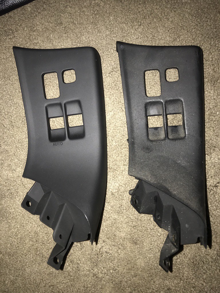

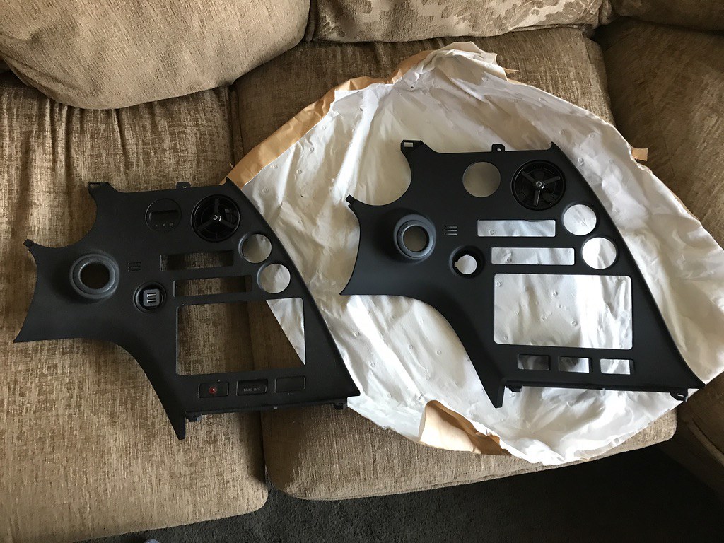

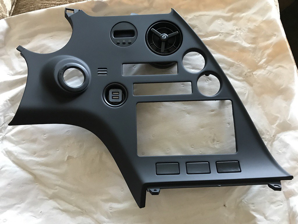

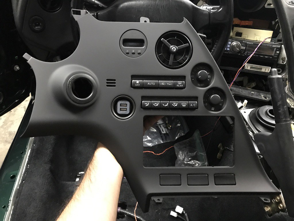

With the dash in place, the new panels came out of the boxes for parts swapping.
First up was the center panel. Swapped over the clock and cigarette lighter. Removed the HVAC module.

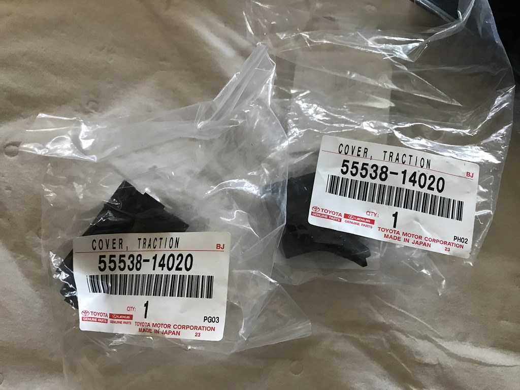

New traction button covers. The far right cover was discontinued, so had to reuse the old one.

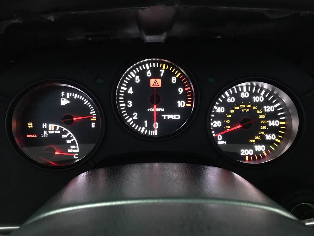

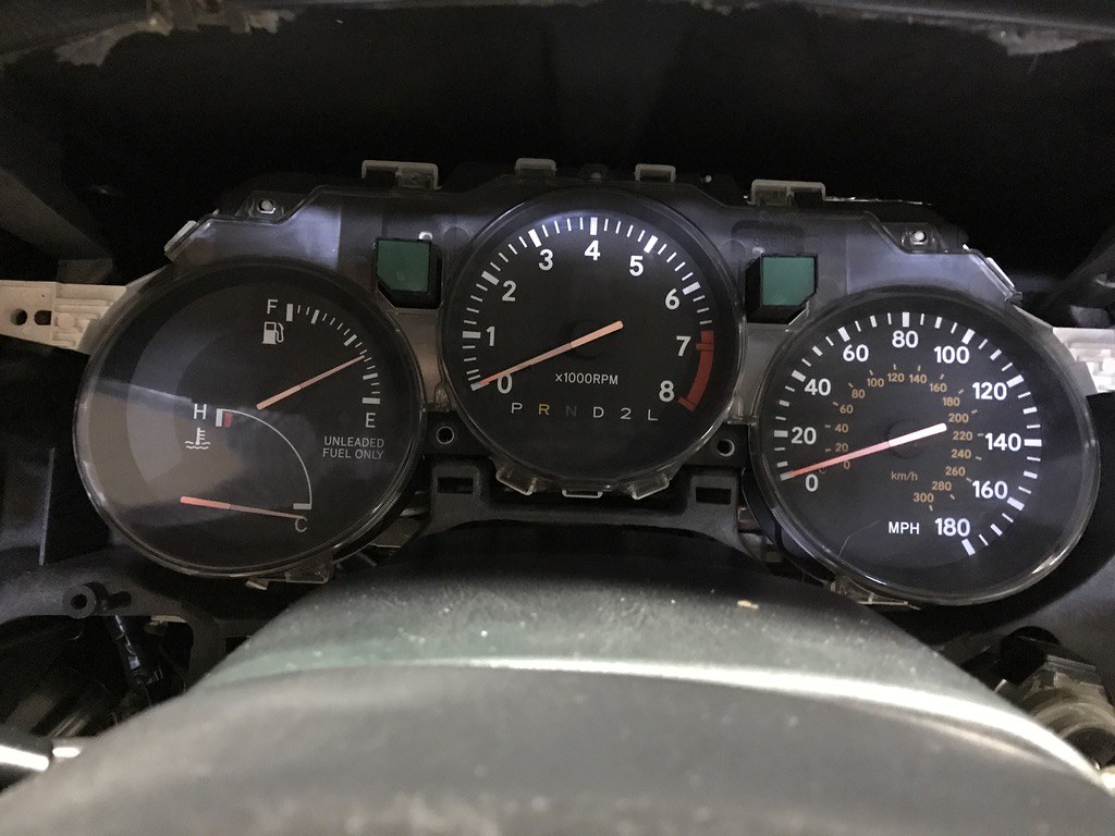

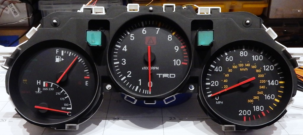

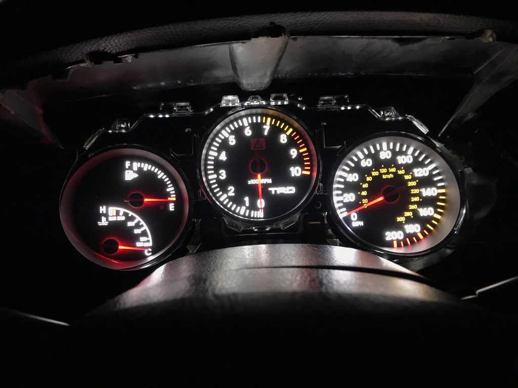

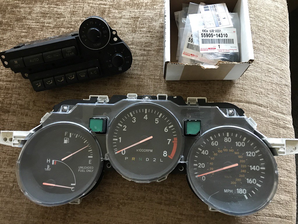

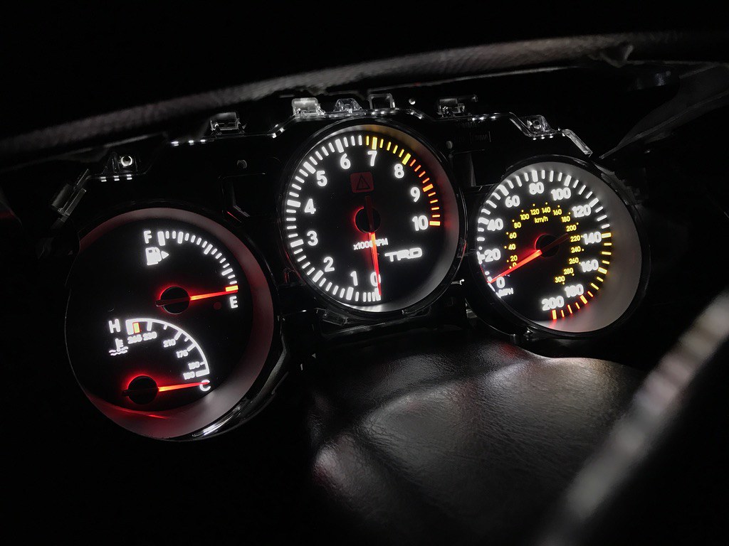

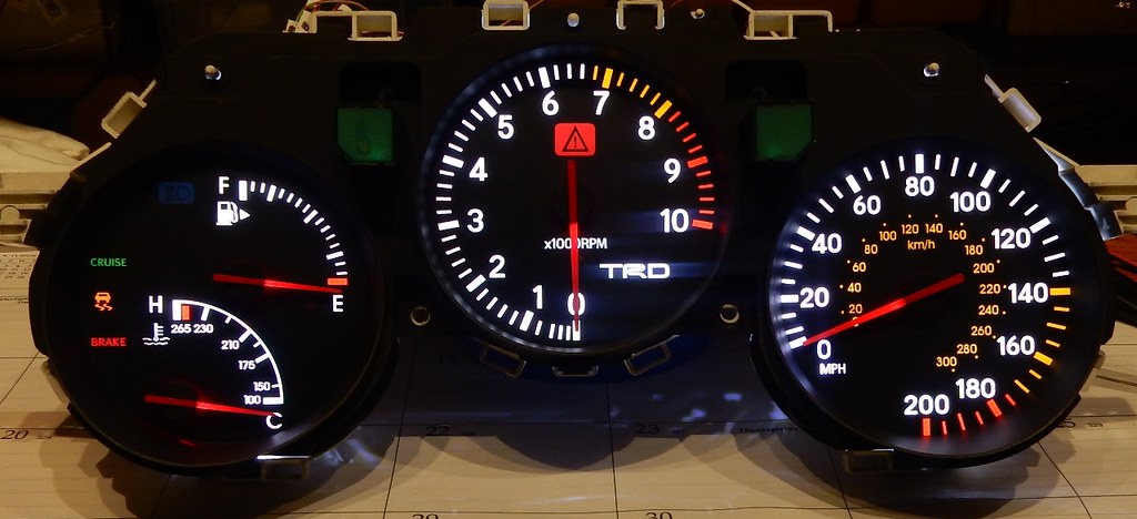

The next thing was the gauge cluster. This car did not go through this amount of work to be left with an auto tach with faded ugly needles.

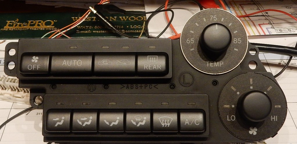

I gathered up all of the new HVAC buttons and knobs, the HVAC unit, and the gauge cluster, then sent them to Stu Hagen.
I asked for a 10K TRD Tach with the needle in the proper 6-o'clock position, a 200mph speedo, coolant temp with readout, and white backlighting.

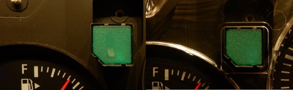

The left turn signal filter on the cluster was damaged. Stu polished it out.

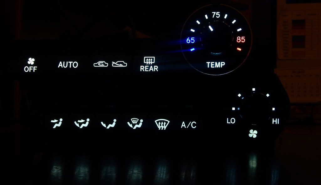

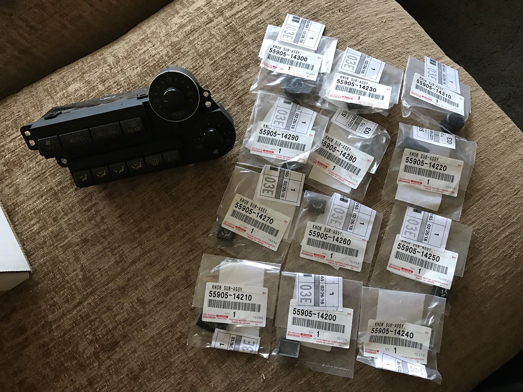

The HVAC received all new buttons and knobs, as well as a set of white LED's. The temp knob has a red and blue LED's for hot and cold.

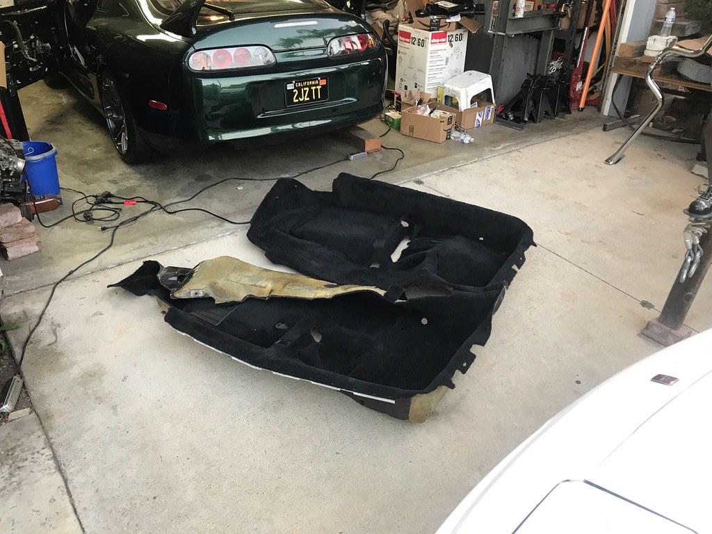

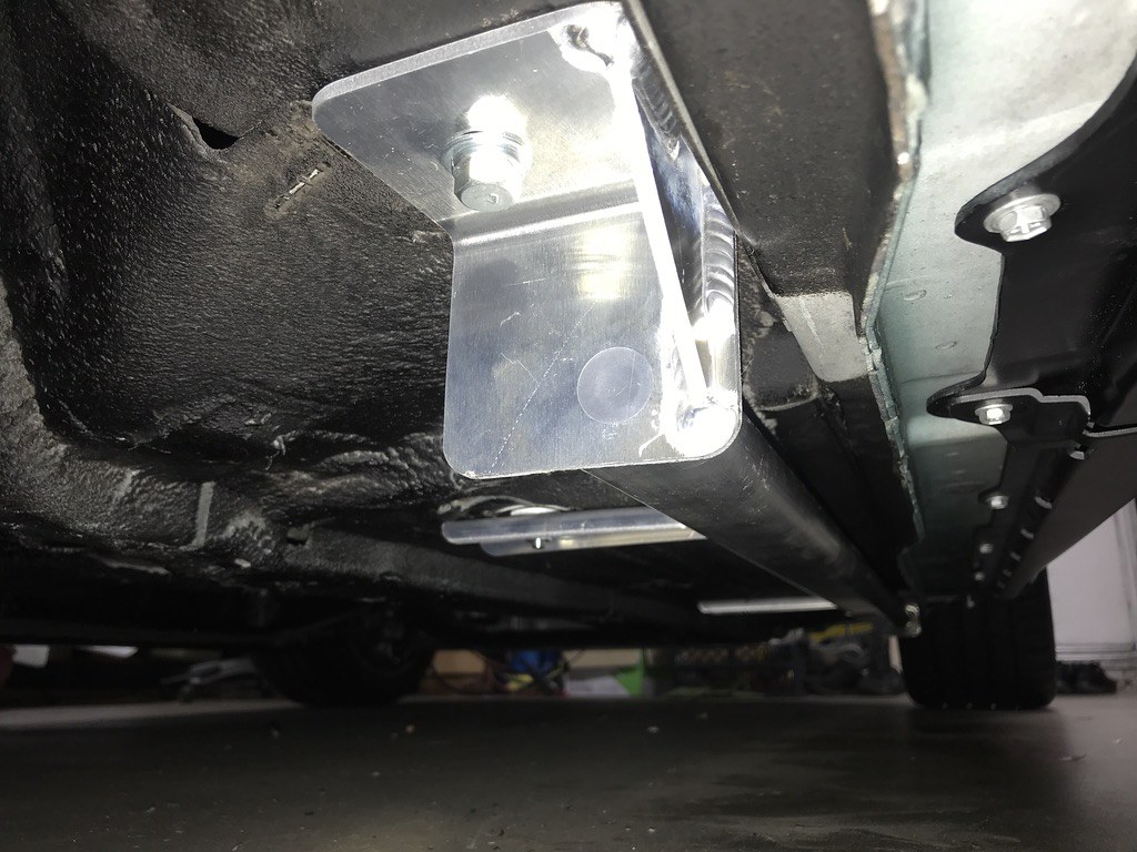

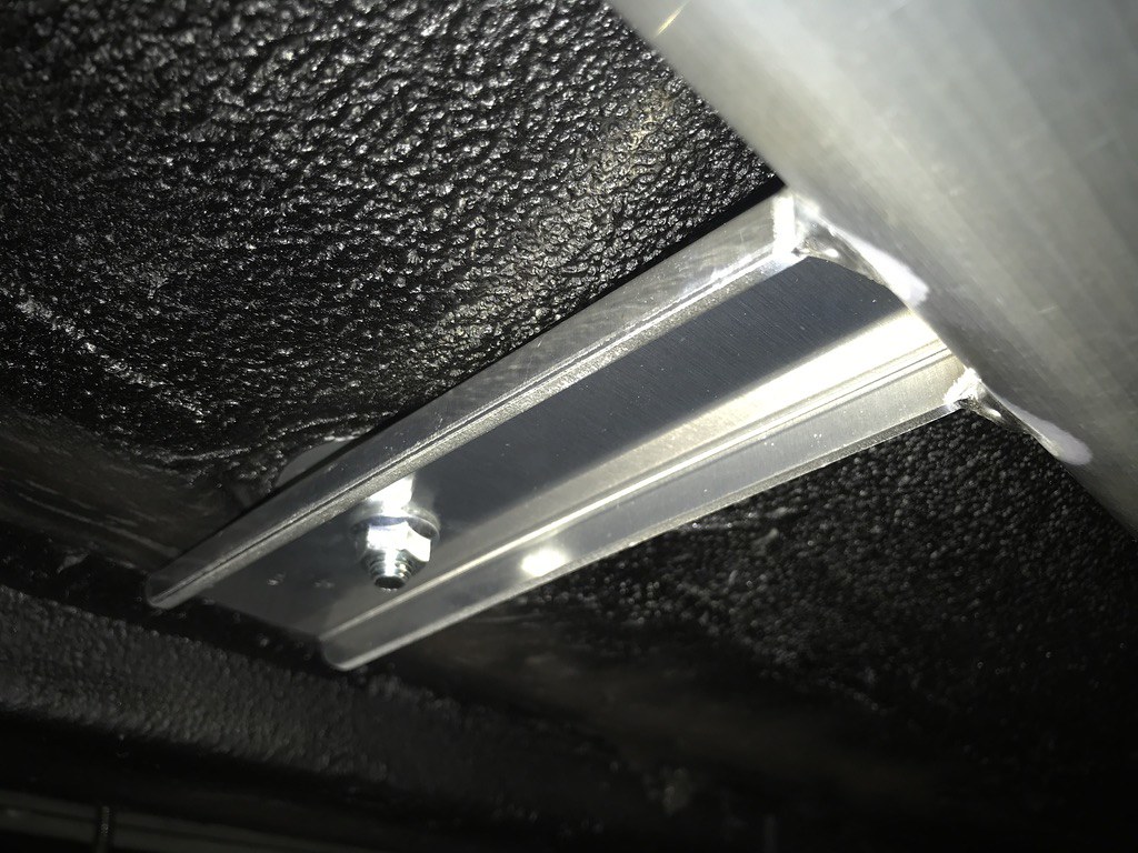

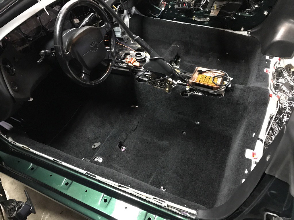

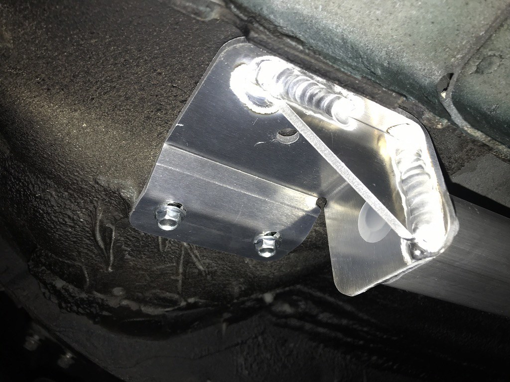

There are a ton of people who swear by Do-Luck and their floor bars. I got a set through RHDJapan along with a rear cross bar. May not use the cross bar as I would really prefer to leave the carpet intact. Might go with a harness bar from SP instead, since there's no carpet modification necessary.
Seriously, can you imagine how hard/expensive it'd be to get a new carpet for one of these? Most of the examples of Do-Luck cross bar installation that I've seen online basically obliterated the carpet. Who wants to see that?

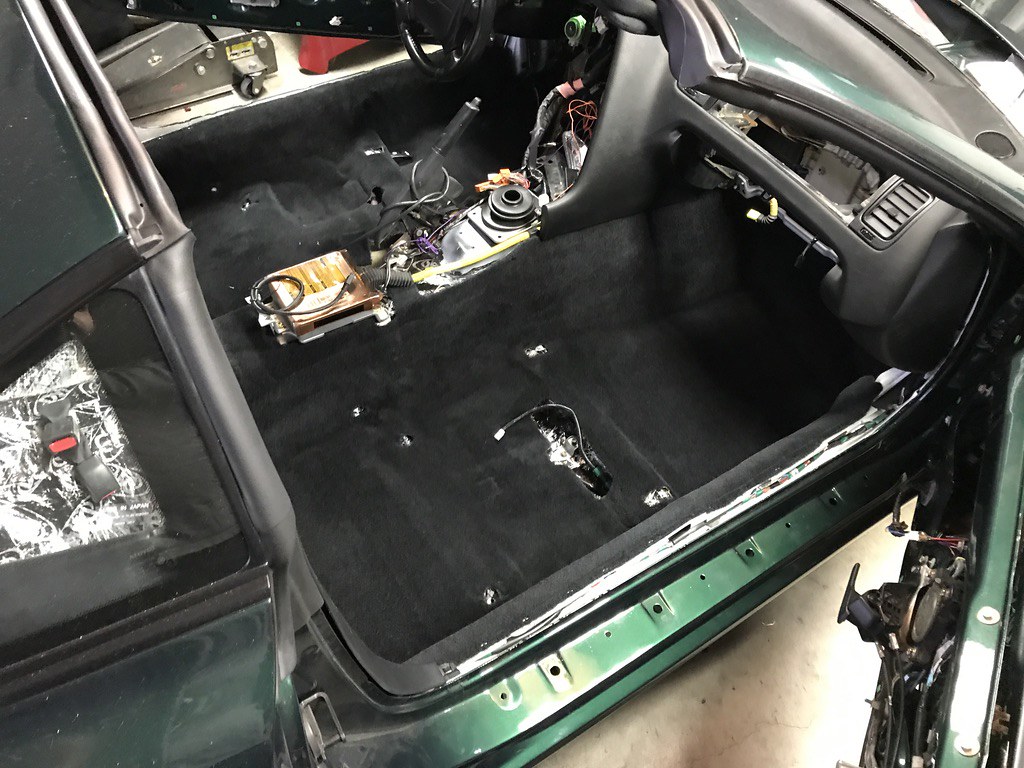

Floor bars installed:
From inside the cabin:
Original carpet all cleaned up
Cluster shining bright with new "glass"

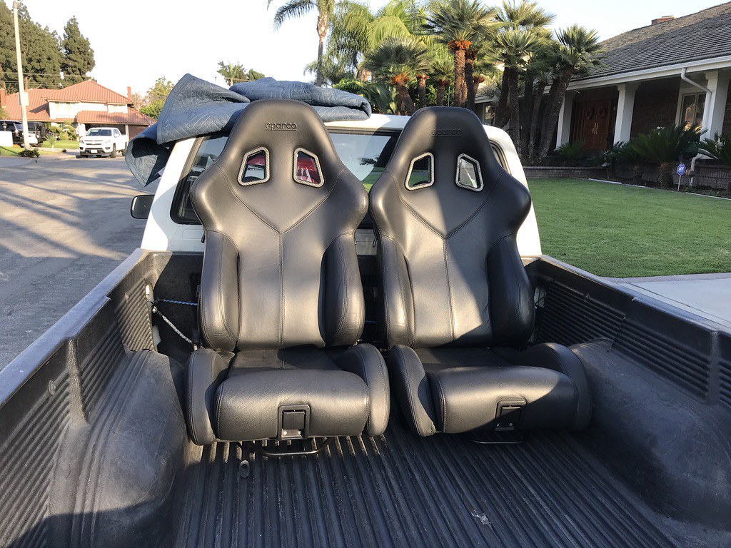

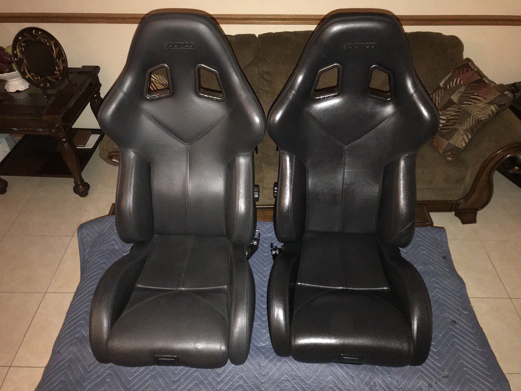

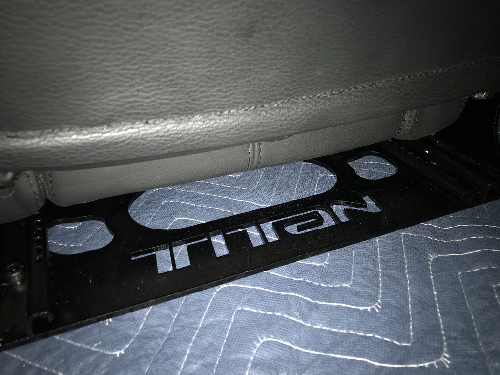

In their place will be a beautiful set of black Italian leather Sparco Milano Prestige II's. They have carbon-style plastics which look pretty nice. These are well renowned by the likes Peter Kop (the original owner of them), Ken Henderson, and many others. The Sparco brackets are known to be crap, so these are going in with Titan brackets.
I got the seats from a local Supra owner, Martin, who has a beautiful DJG 97. His single turbo setup is quite inspiring, so I'm just now getting into the research required for a proper single turbo swap.

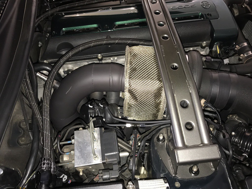

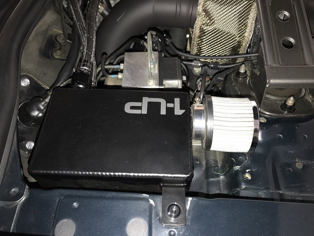

I really like the 1UP catch can setup with braided lines.

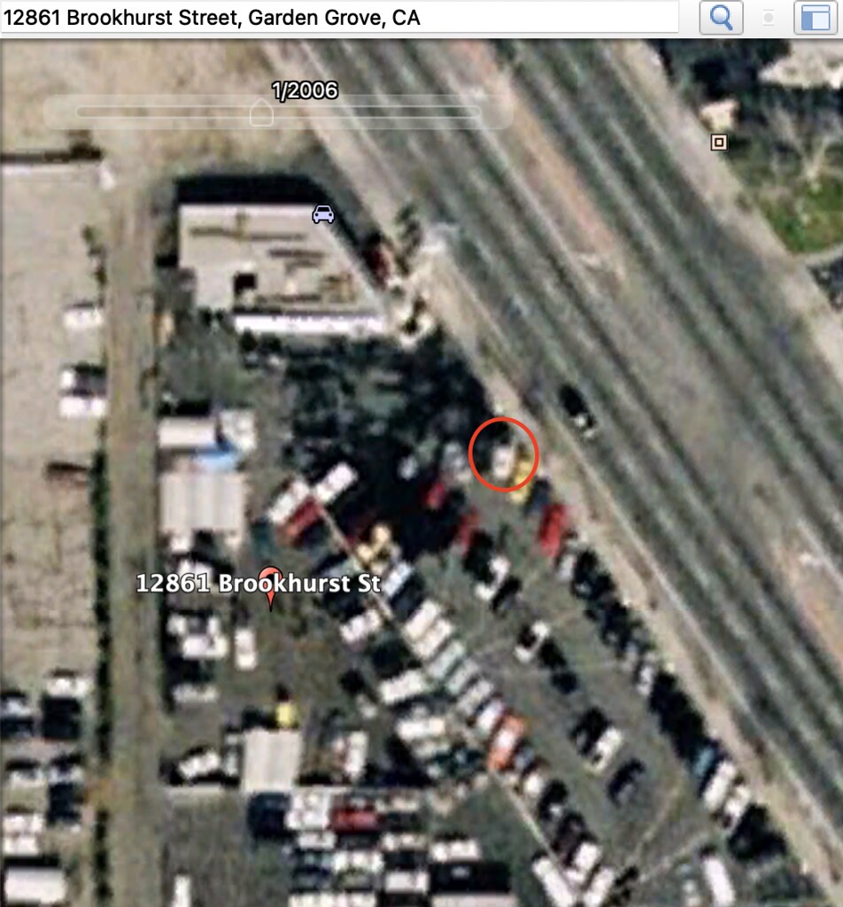

While sifting through some of the previous owner records, I found a card for Focus Auto Sales in Garden Grove. Google shows that location had closed years ago and is now an empty lot.
Using the Wayback Machine website and a little google-fu, seems like the dealership sold primarily JDM cars, and lots of Supras. The Carfax report showed that a dealer got hold of the car in late October of 2005, with the most recent previous owner buying it from them in February 2006.
Historical aerial maps of Focus Auto Sales from Google Earth Pro came up with this, taken January 2006. Seeing as there is only one car on the lot that’s white with a carbon fiber hood, I’ll bet that’s it right up in the forefront.
I wish someone could tell me more about the history of this car… Any info or photos that might still exist from the dealership around that era would be incredible! Is Jacko Luong (@supraskyline) still around SF?

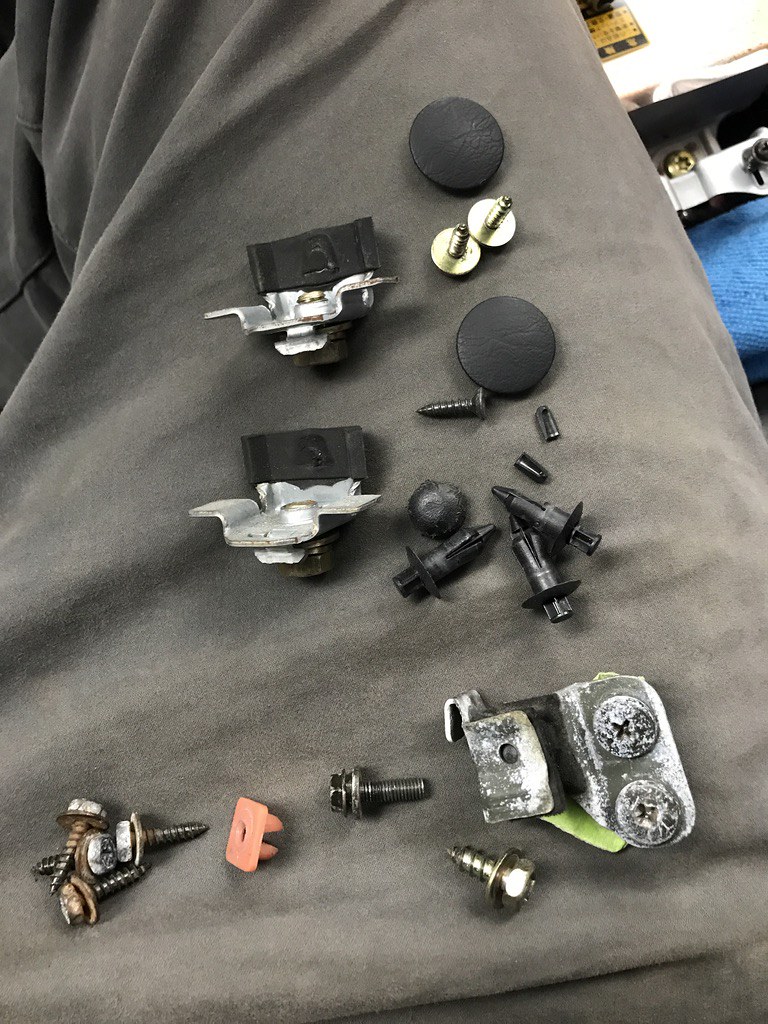

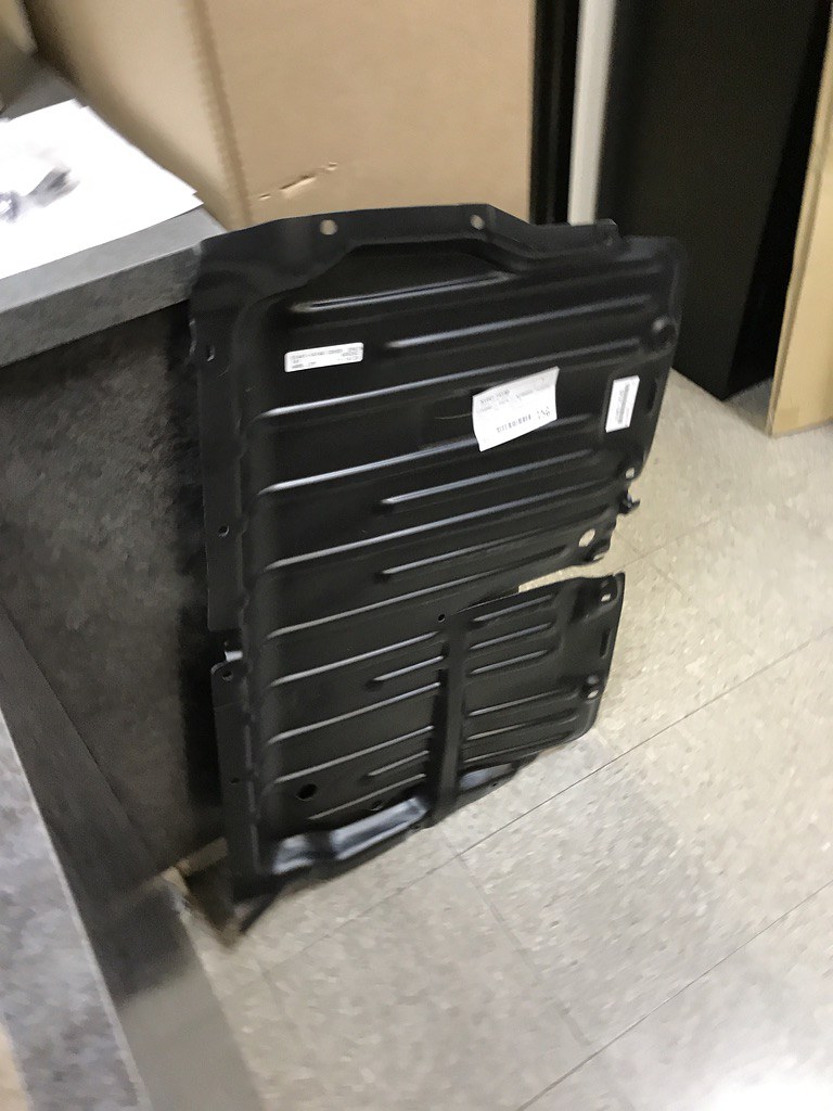

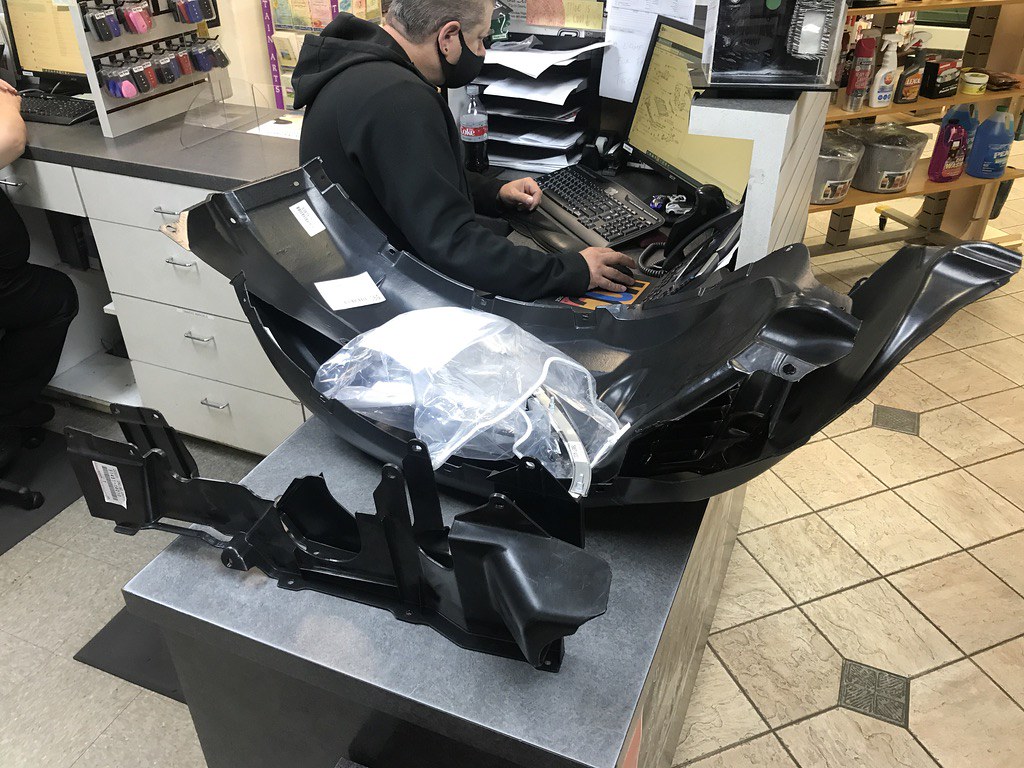

Onto another round of OEM parts.
- All new front wheel well liners and engine bay covers (left, right, and lower) as well as their associated hardware
- Front bumper lip retainers
- AC hard lines
- Hood insulator
- Windshield dam kit
- Windshield wiper cowl
- Carpet clips
- Shifter surround bolts
- Radio bracket bolts (to car and to radio)
- Wiper fluid reservoir upper assembly 85301-14010
TRD boxes are graphite TRD pro wheels for my 4Runner.

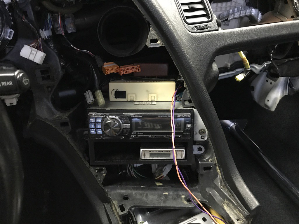

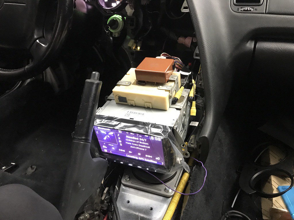

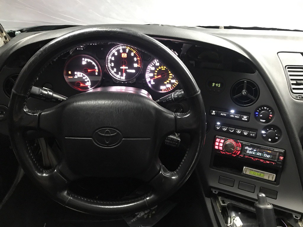

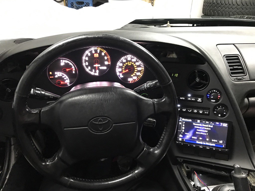

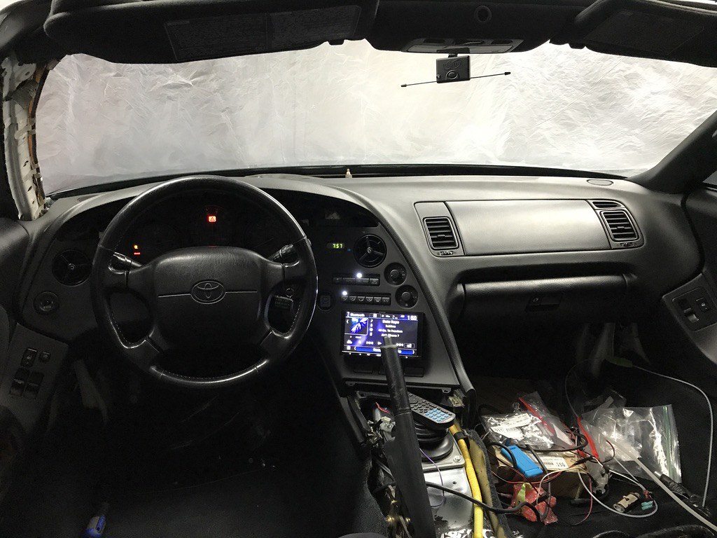

Since the dash is coming together, the plan is to upgrade the head unit to a double-din Kenwood DNX997XR, then use Stu Hagen’s method of using the OEM audio amp to power the OEM sub.
The old Alpine CDA-9884 that was in there before has been installed just for the meantime.

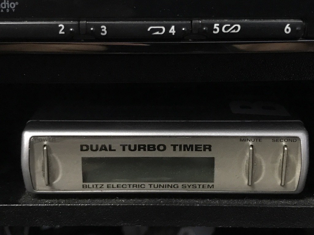

The Blitz turbo timer is definite old-school cool, and fits nicely below a single-din radio, but there’d be nowhere to mount it with a double-din. It’d have to go into the glove box since there would be no cutting involved to get it in there. The turbo timer setup is all subject to change once an engine management upgrade happens (leaning towards a plug and play ProEFI with conversion harness).
Trying to get a glimpse of a completed dashboard

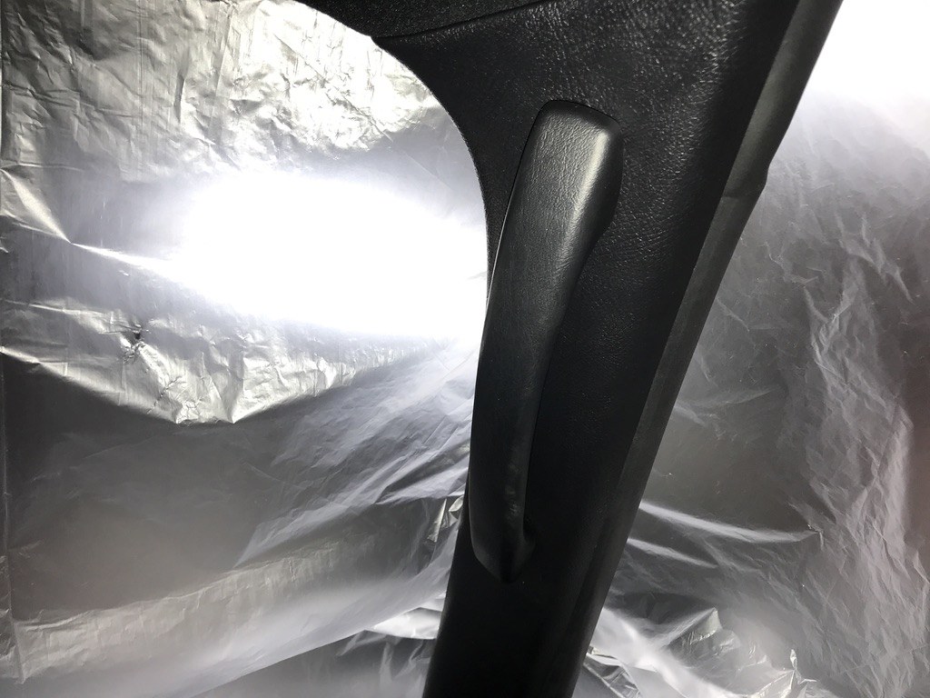

Passenger A pillar cover and handle

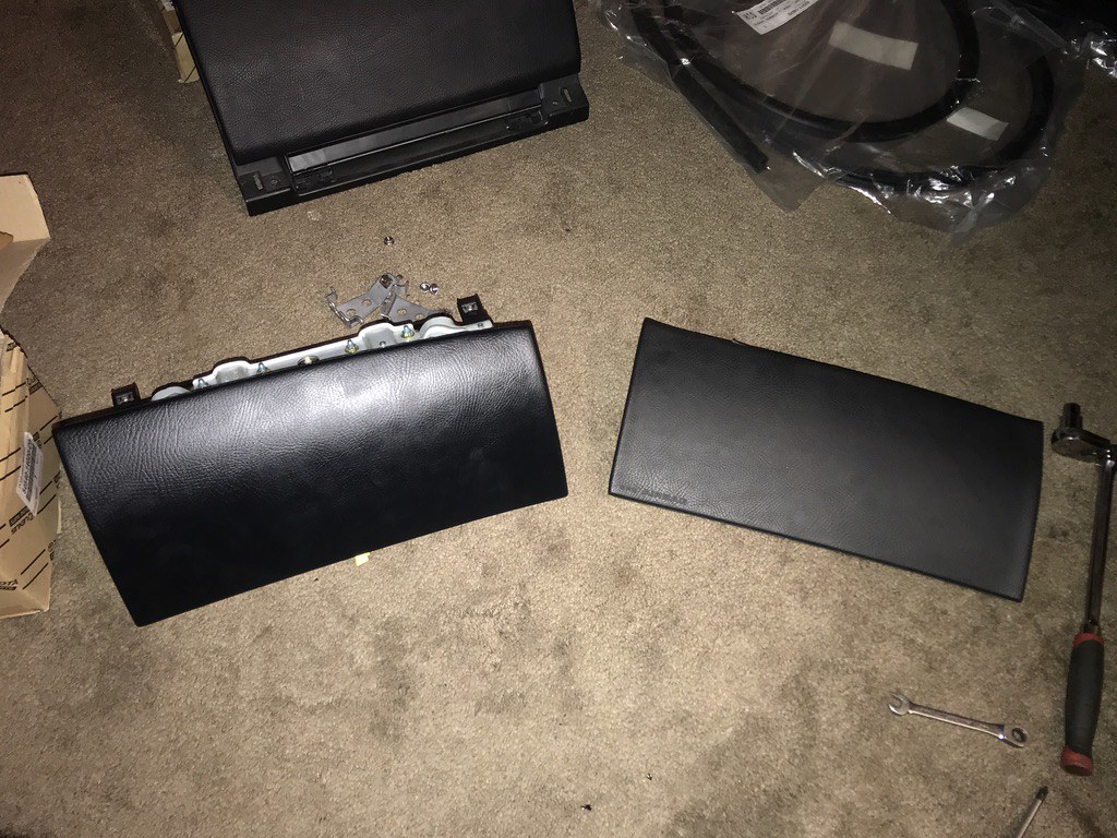

Airbag cover swapped with a modified delete panel

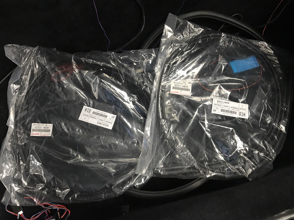

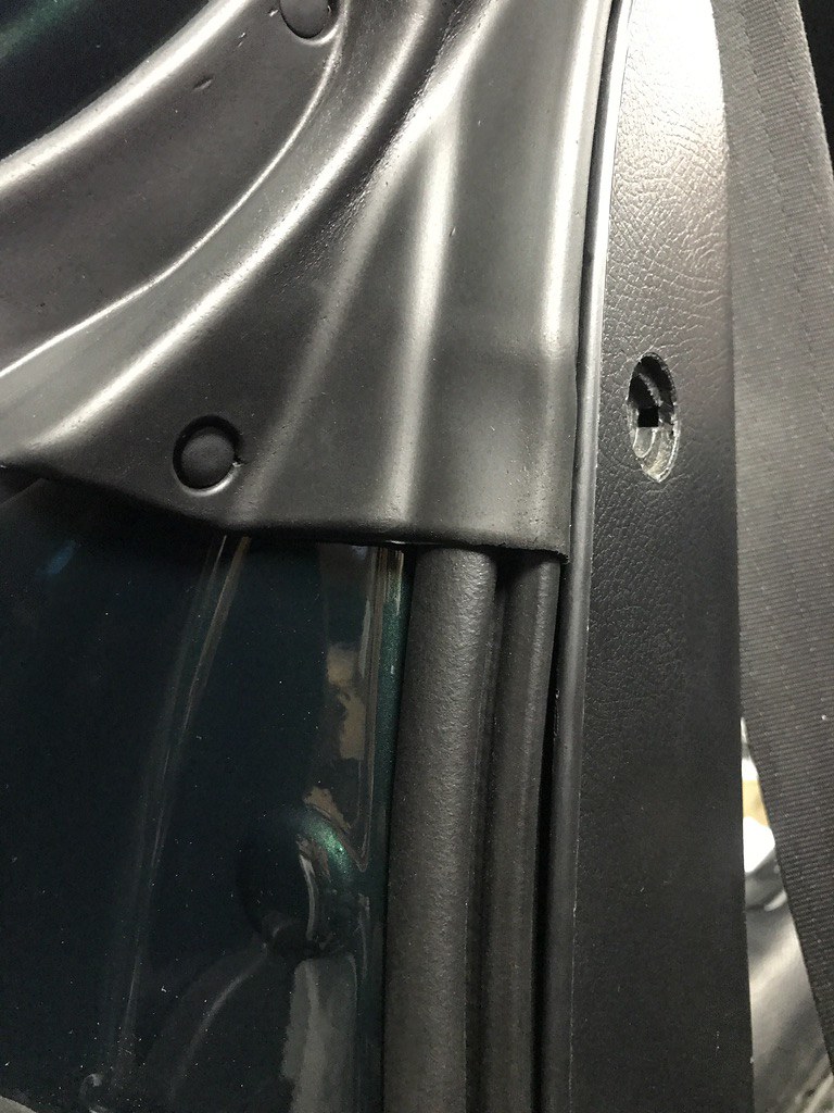

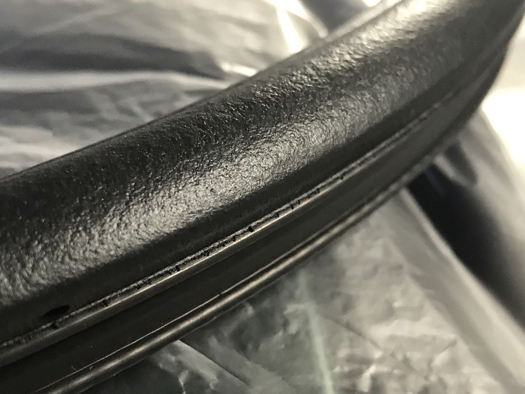

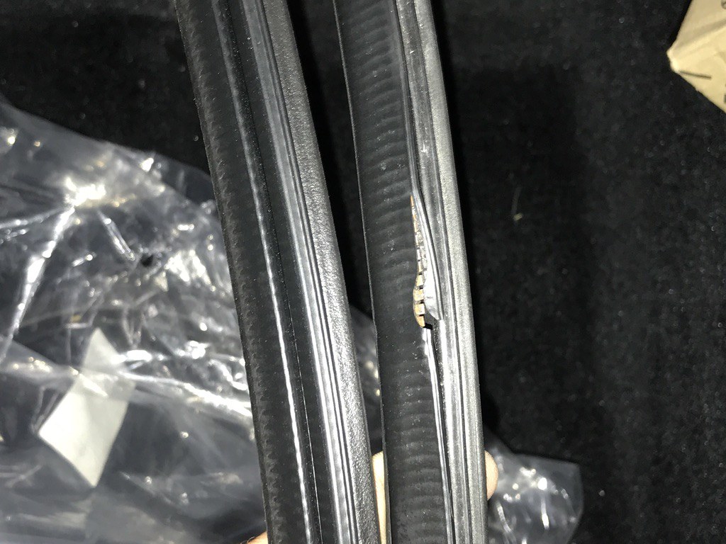

Chassis side door seals replaced with new
Comparison to original seals
There are new seals throughout the whole car. Clean and fresh.

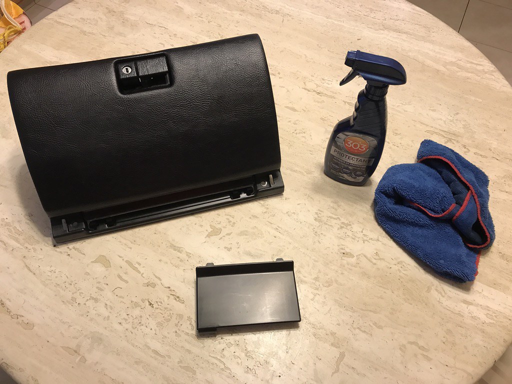

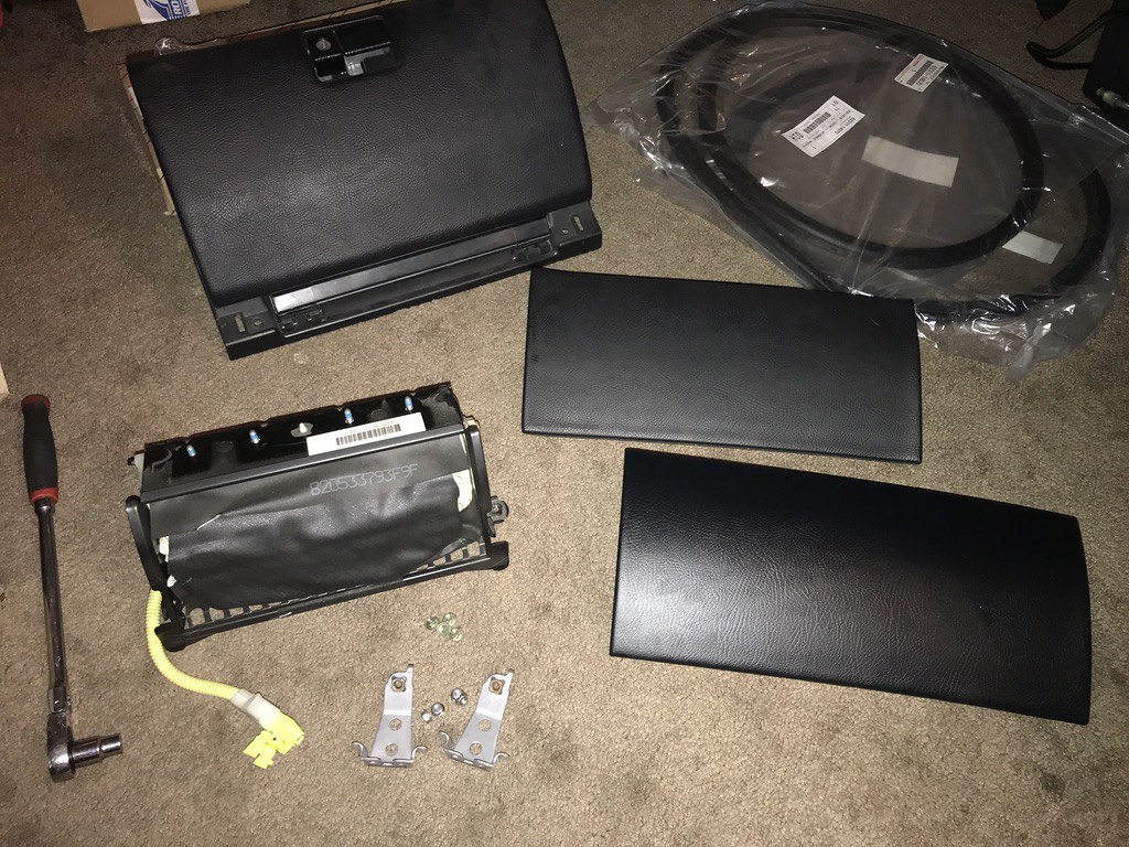

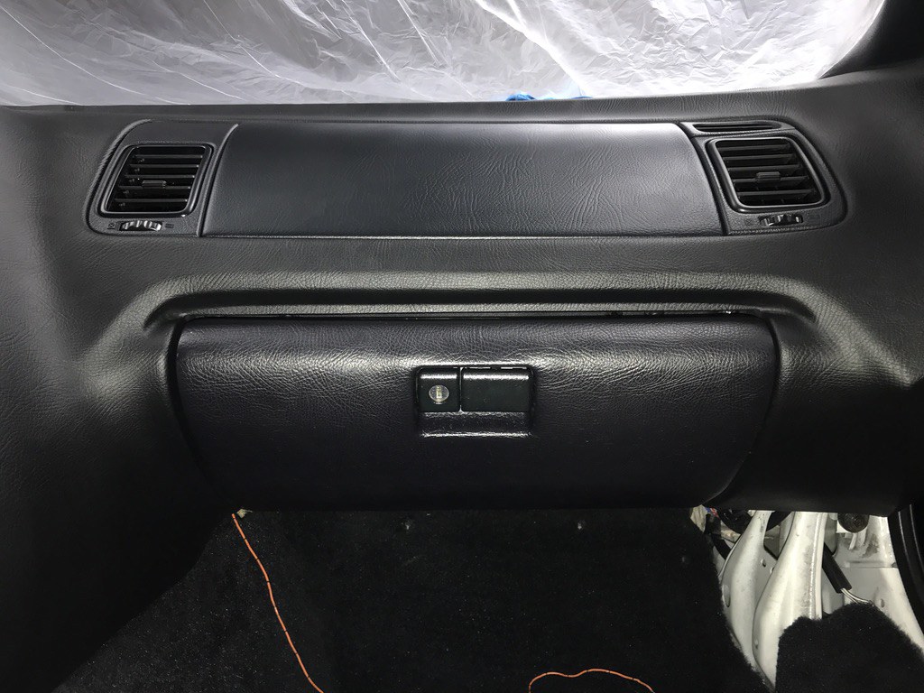

Original glovebox cleaned and treated with 303 protectant

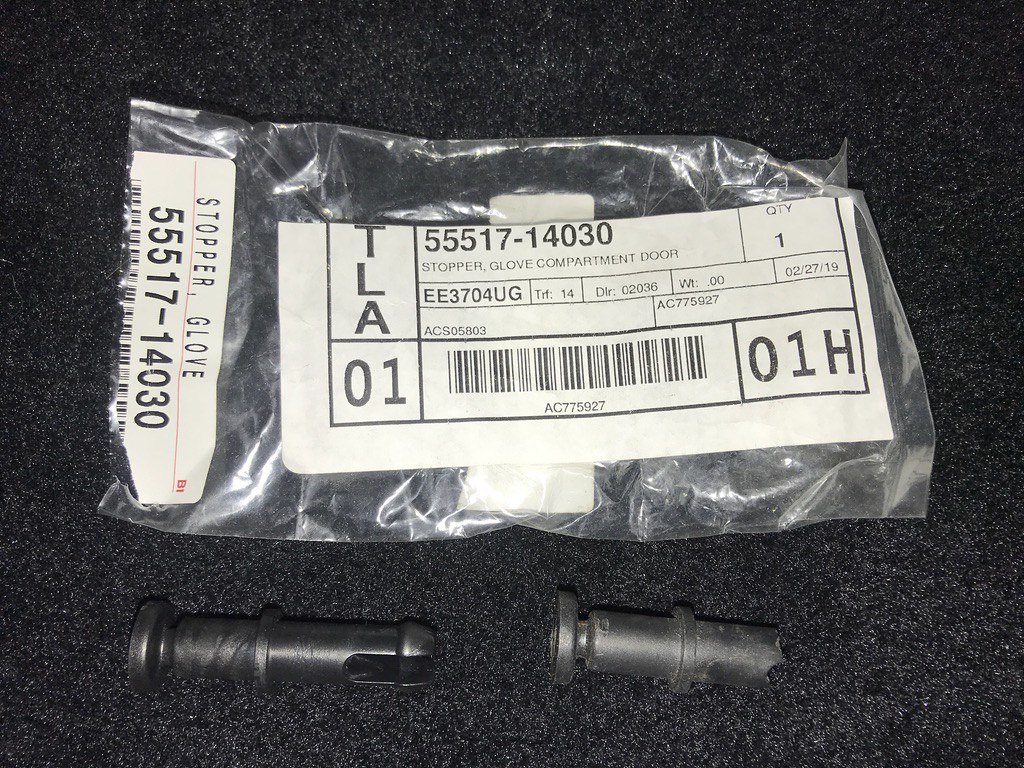

New spring stopper as the old one was broken
Glovebox and airbag install complete

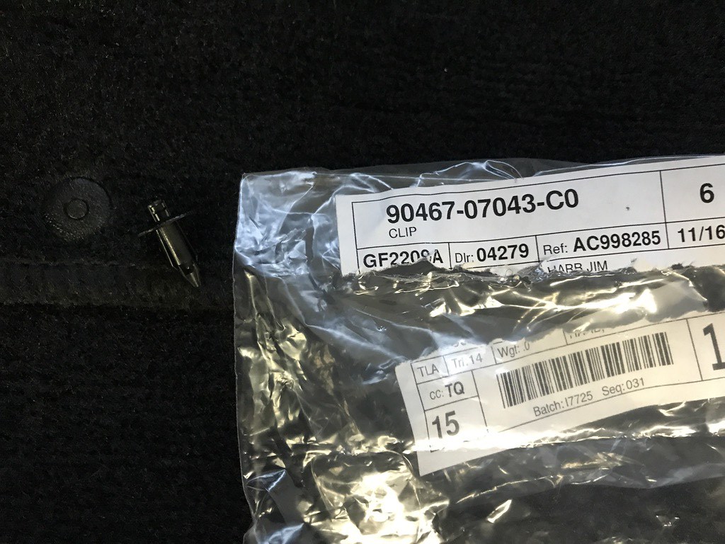

Rear carpet clips (cargo area carpet where it attaches to back seat)

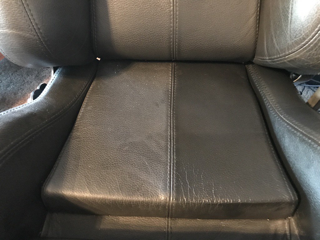

I went at the Sparco Milano Prestige II seats with Meguiar’s Leather Cleaner & Conditioner and a microfiber cloth.
Quick before and after.

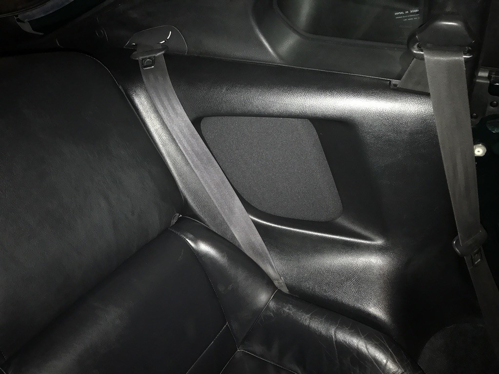

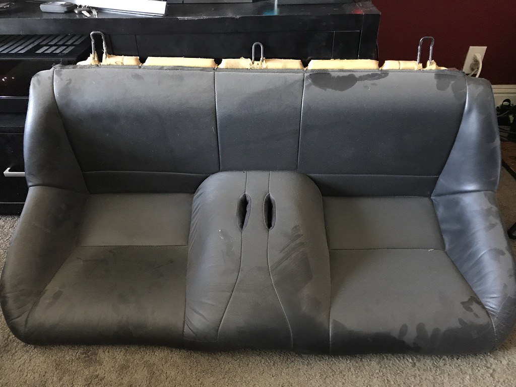

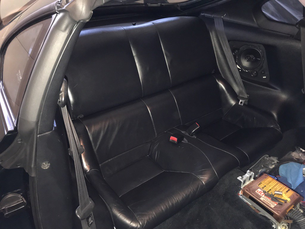

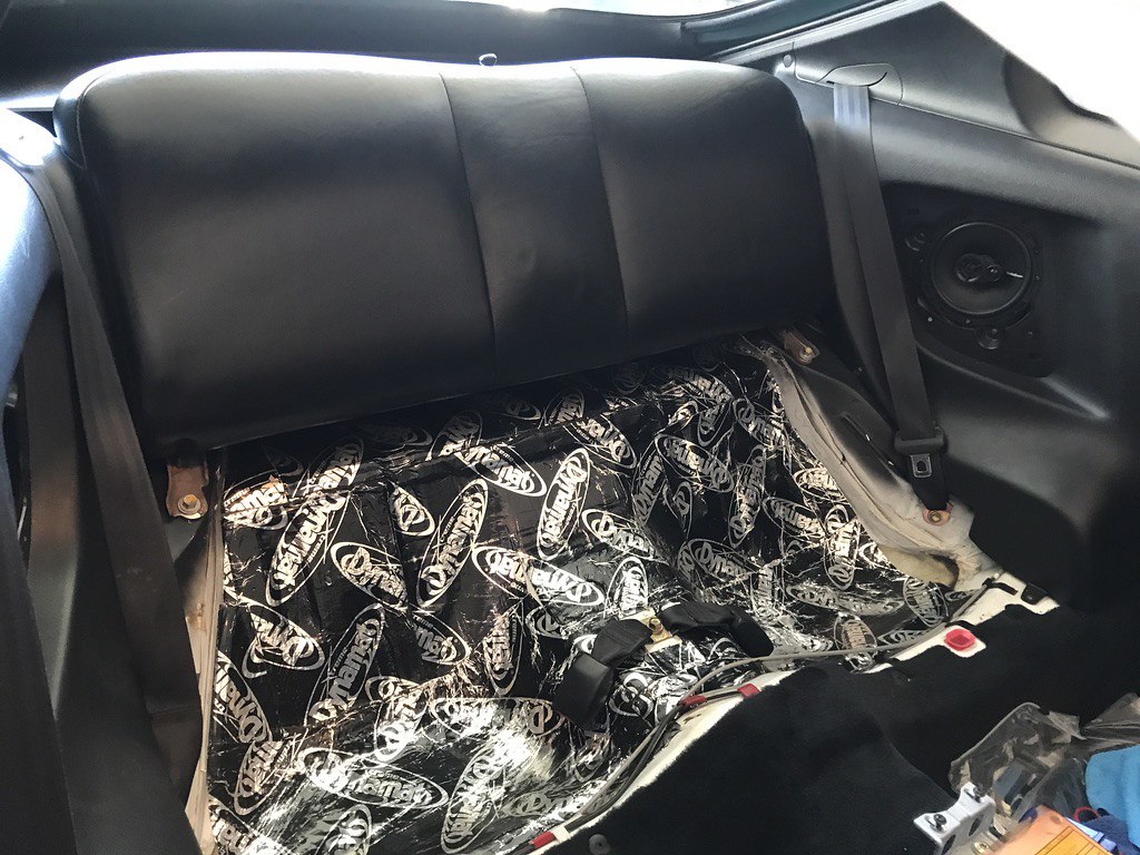

The original back seat had a large burn on the right hand seat, through the leather and into the foam. I purchased this back seat all the way back in 2015 when I had acquired the OEM fenders, hood, and other panels. It’s been sitting in storage since, as the dust buildup shows:
I still may want to replace or rewrap the rear seats as they aren’t perfect, but ultimately, no one sits back there anyway.

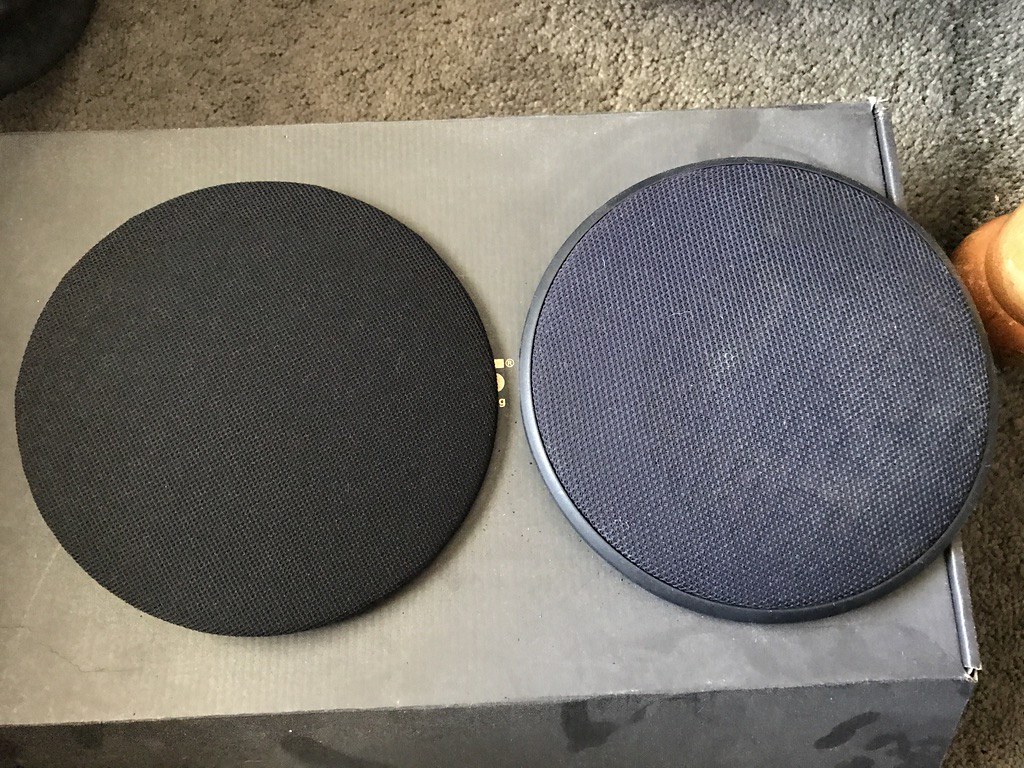

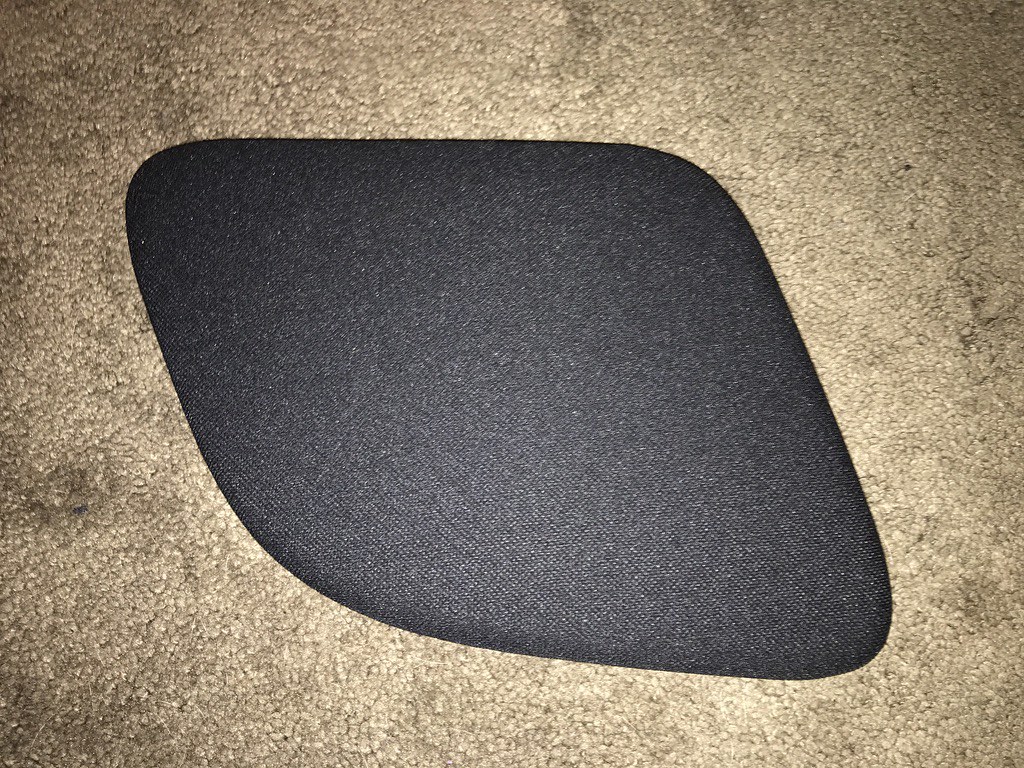

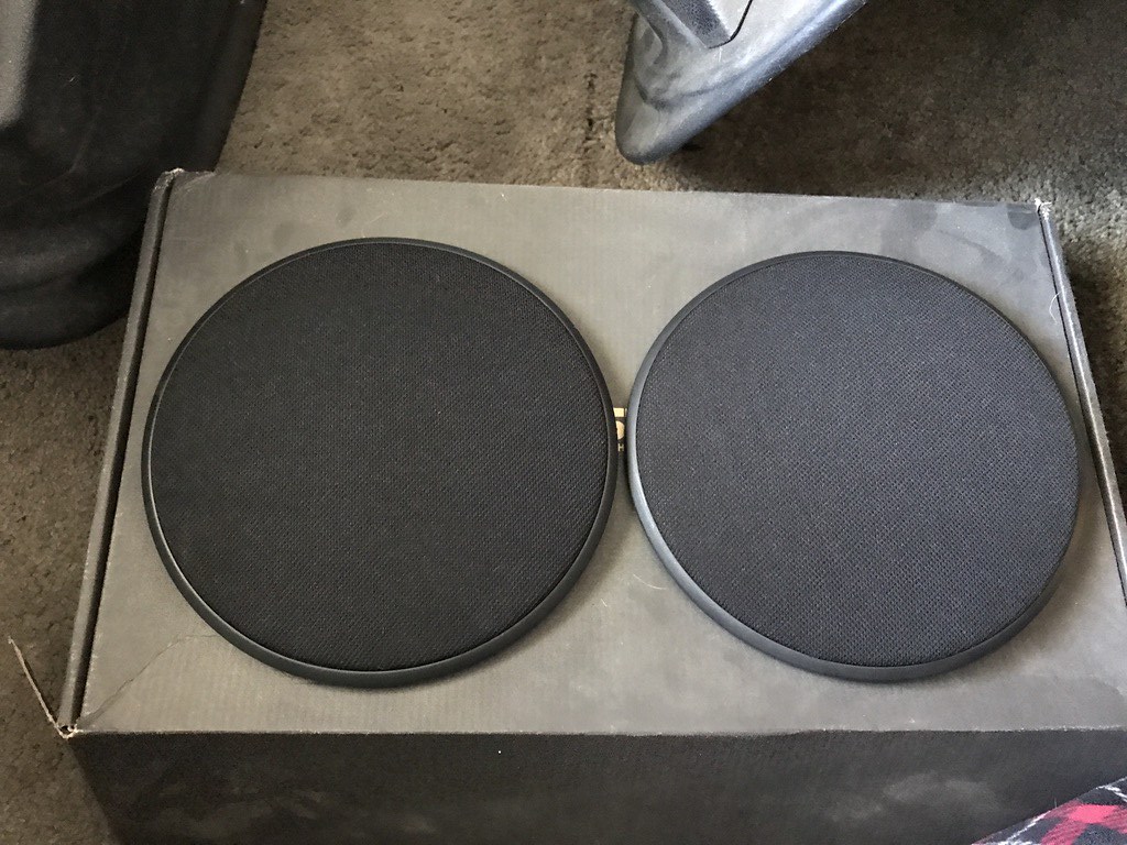

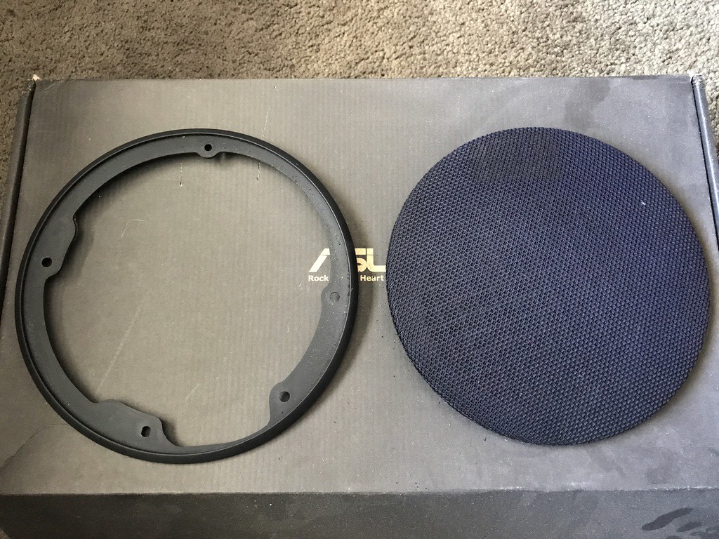

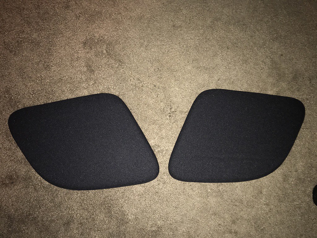

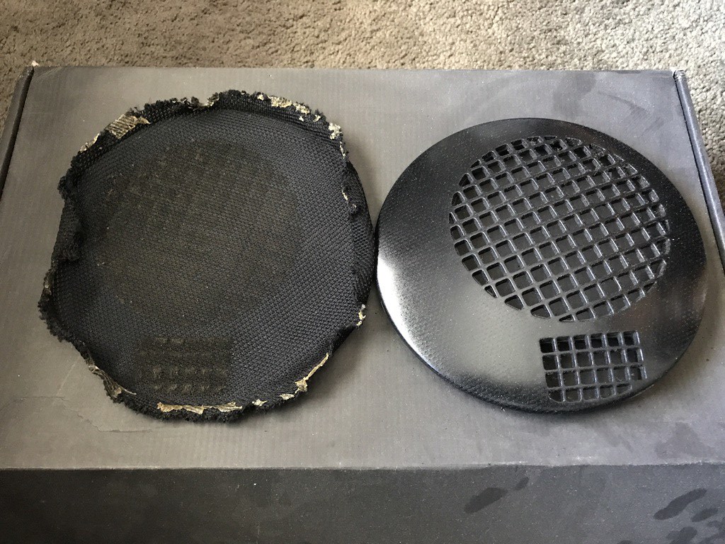

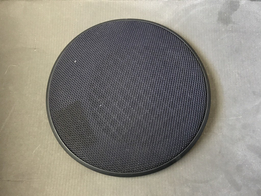

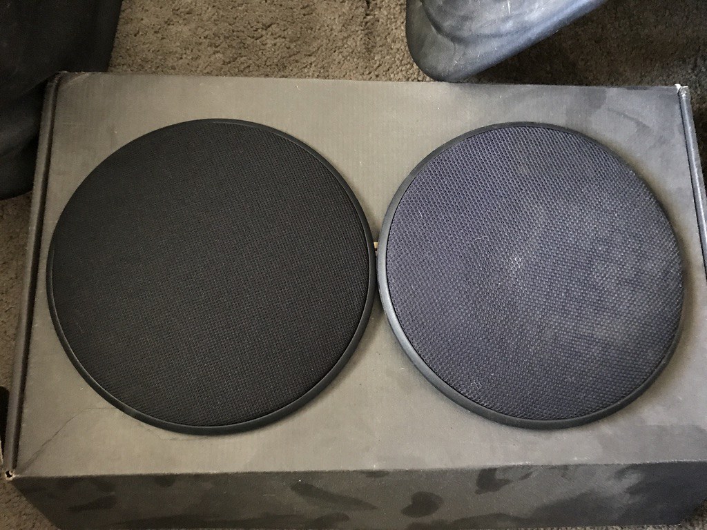

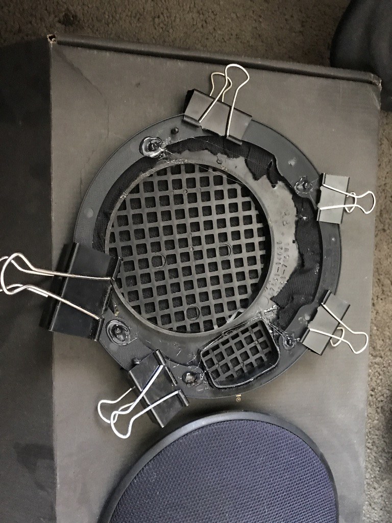

Up next was the rear speaker grills. I chose to rewrap them with Mellotone premium speaker fabric. I used a gorilla hot glue gun to secure the new fabric to the plastic grill.
Before:
After:
The front speaker grills were similarly ugly, so they got the same Mellotone fabric.
First, the grills must be disassembled from the plastic trim ring.
With the old fabric removed:
New fabric vs old:
Gluing back together, including the trim ring
And assembled!

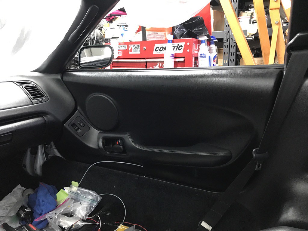

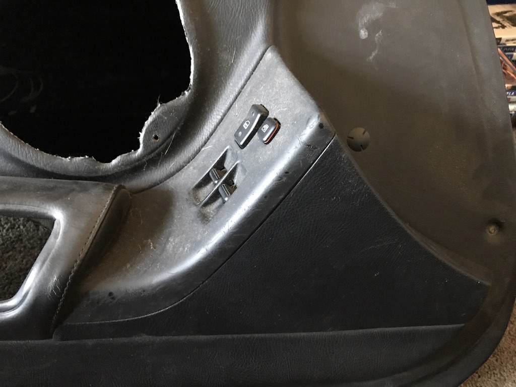

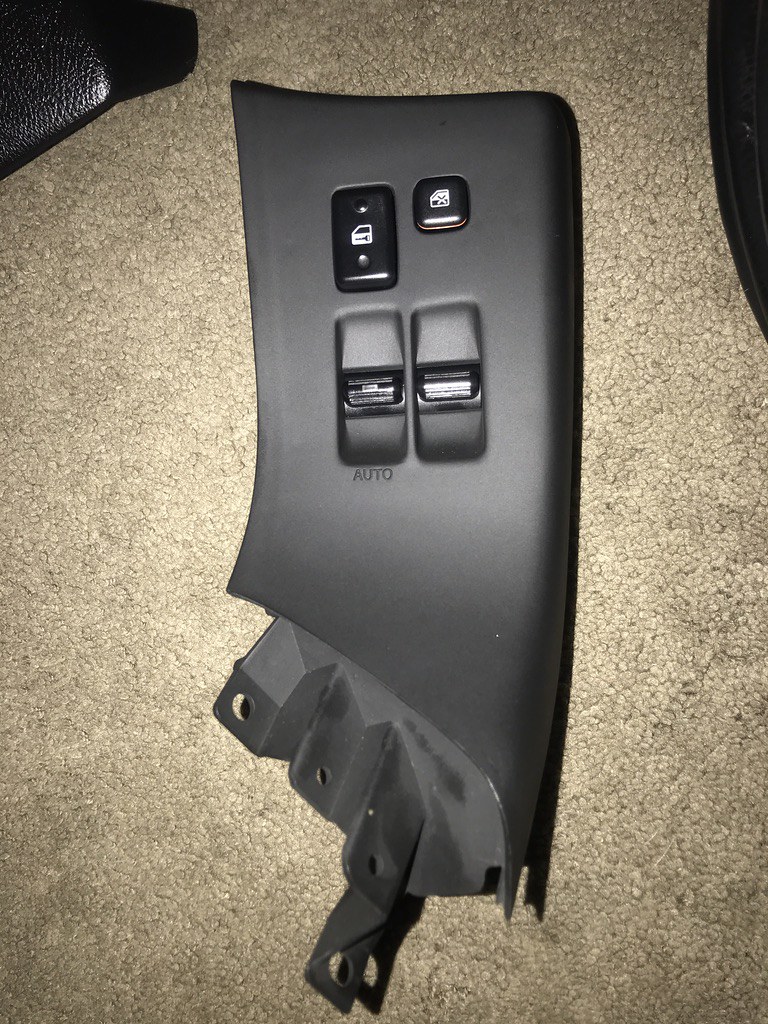

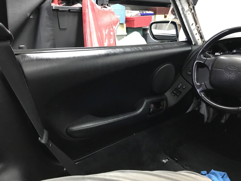

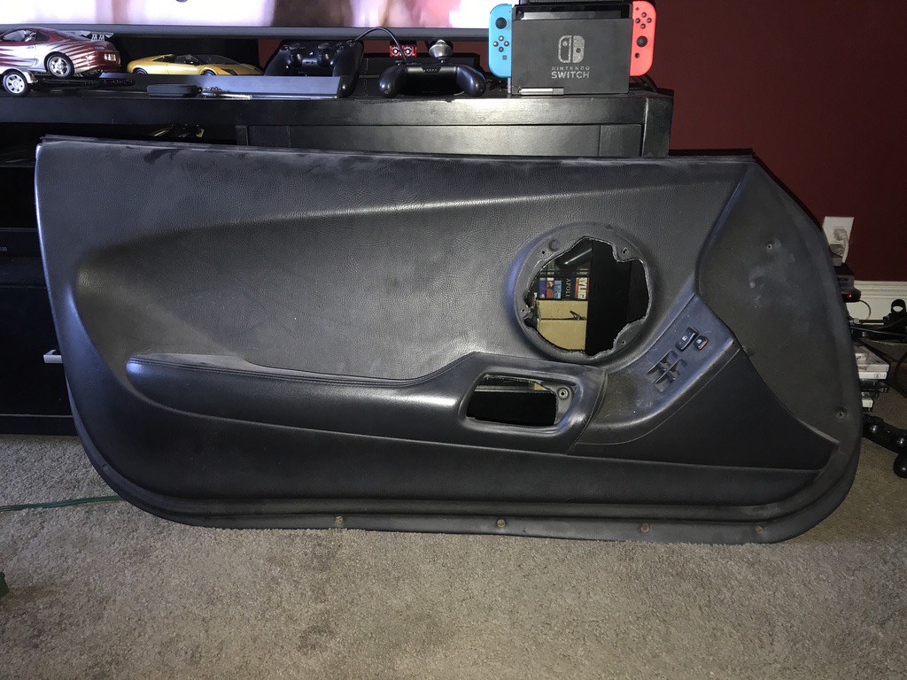

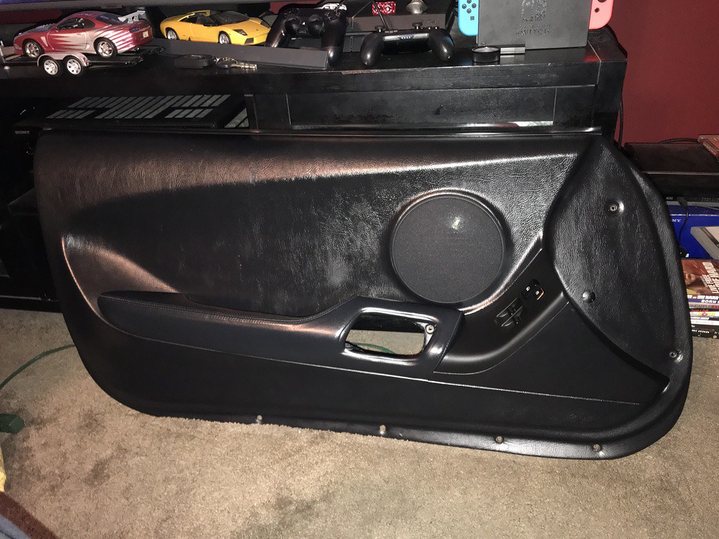

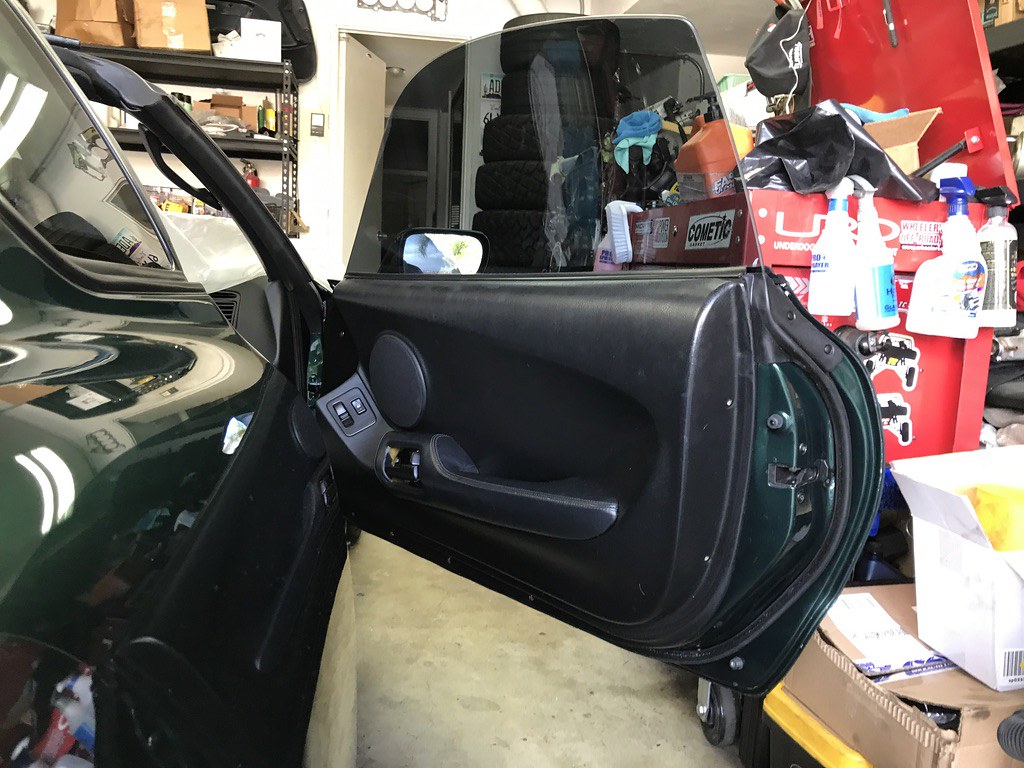

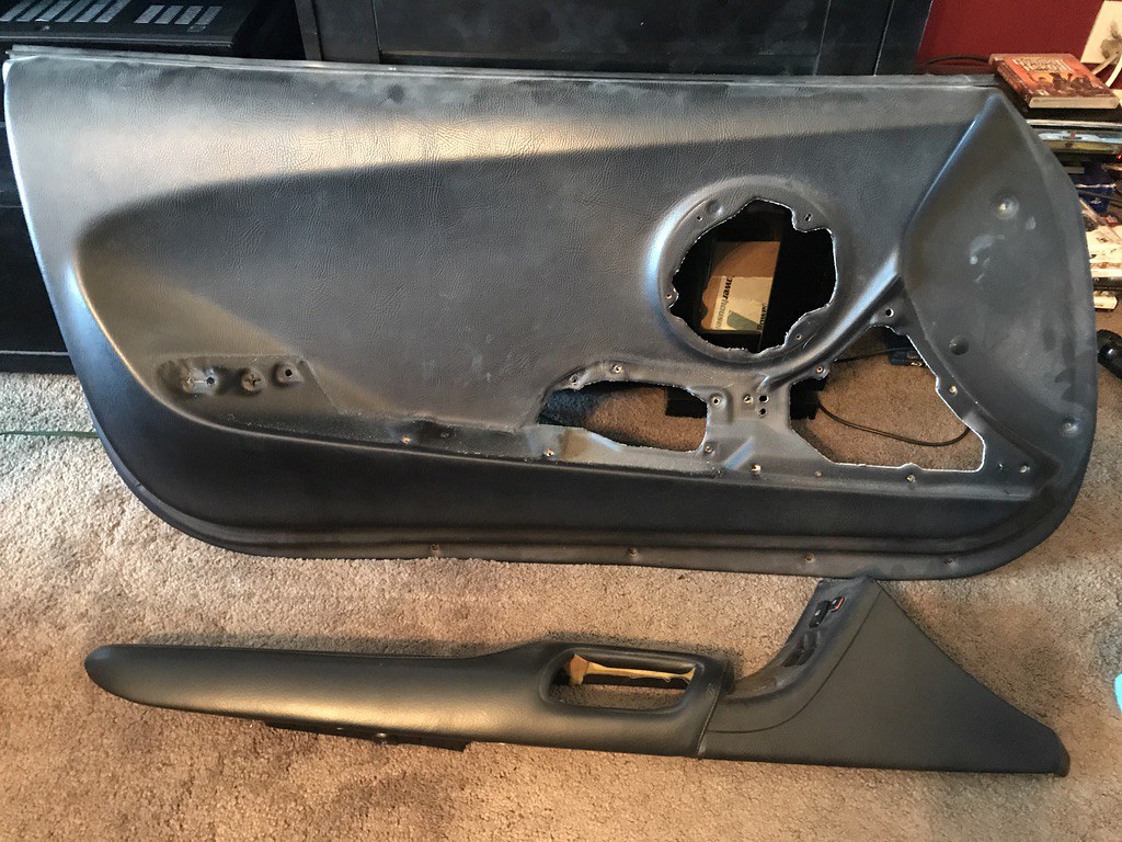

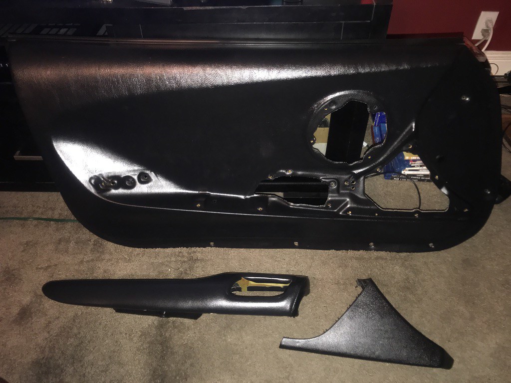

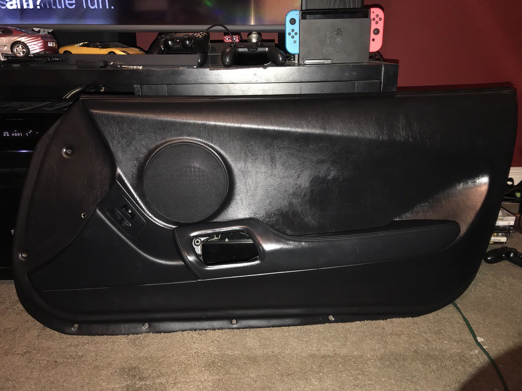

The door panels are original to the car, and have been sitting in storage since 2017.
Armrest and window switches removed.
Treated with 303 interior protectant and Meguiar’s Leather cleaner and conditioner.

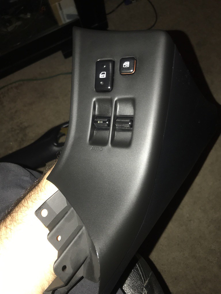

This brand new window switch surround has been sitting on my shelf for 5 years. Finally time to install!
With switches
Assembled with rewrapped speaker grilled
Also caught up on the passenger side door panel

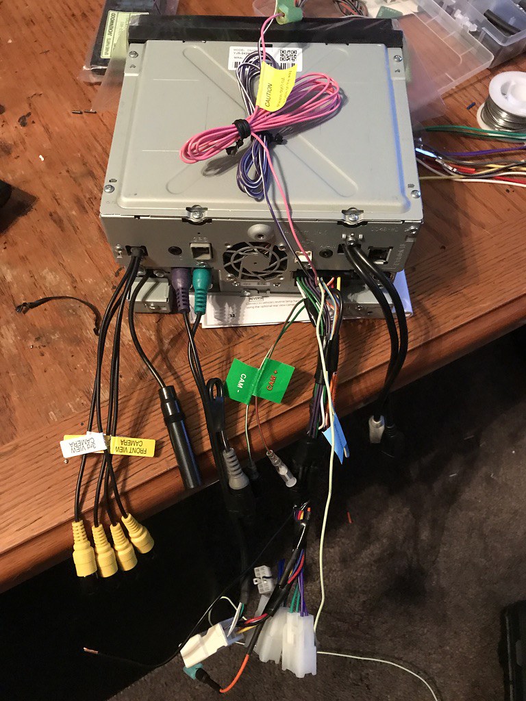

Normally, I don’t quite care much about car audio. I usually leave the radio off and enjoy the symphony that is the 2JZ-GTE, but I figured I cannot go this far without a little bit of attention to the audio system.
I have been using a 2004-era Alpine radio with an iPod in the glovebox, but I suppose it’s time to get a little more modern.
Using Stu Hagen’s guide to reusing the OEM amplifier to power the OEM subwoofer, I got a few Scosche brand harnesses and wired up a Kenwood DNX-997XR, which is their latest and greatest head unit.
* 6.8" High Definition Monitor with Capacitive Touch Panel
* Android Auto™ & Android Auto™ Wireless
* Wired and Wireless Apple CarPlay™
* High-Resolution Audio Wireless
* Wireless Mirroring for Android
* USB Mirroring for iPhone and Android
* 4 Camera Inputs / HD Rear Camera Ready
* Built-in Bluetooth, HD Radio & WiFi
* 3 Preouts 5V
* Garmin Navigation with 3D Terrain View
For added help, I also got front and rear view cameras for parking, and a full time hard wired HD dash cam.

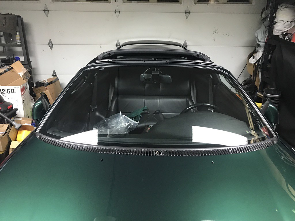

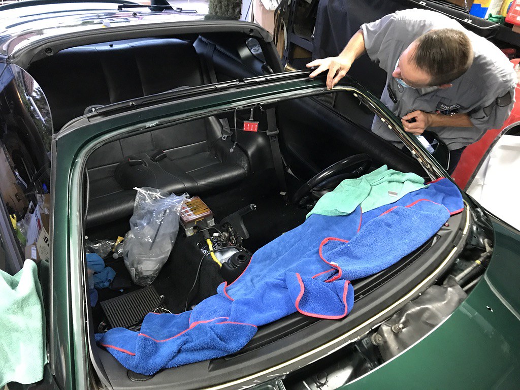

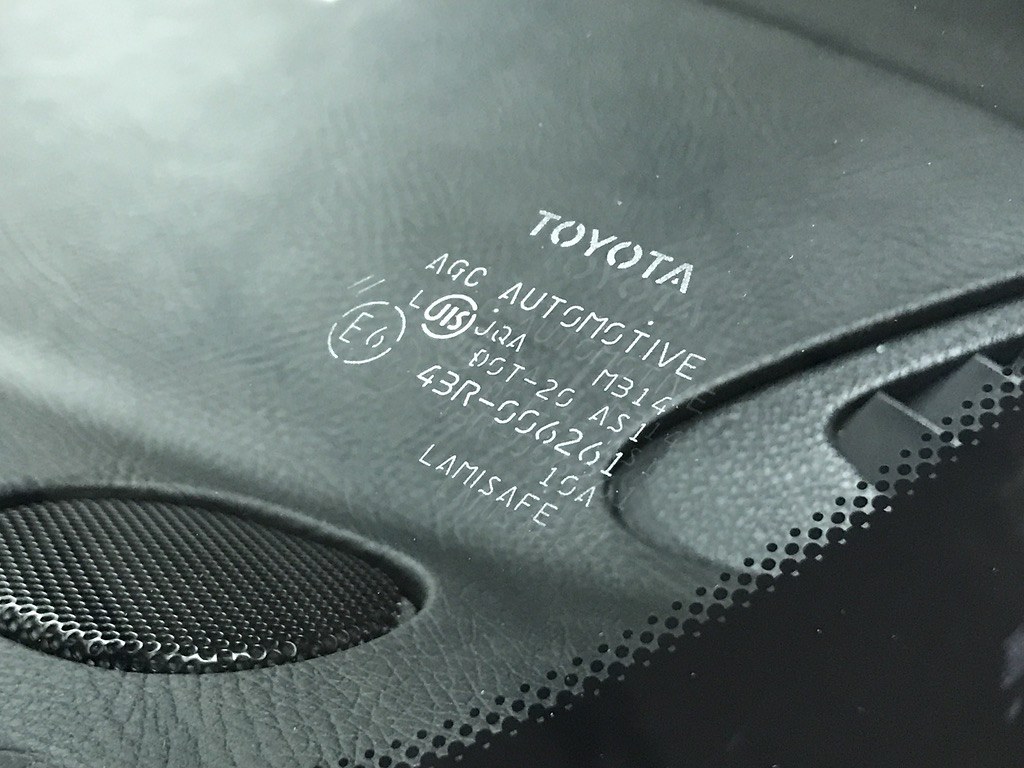

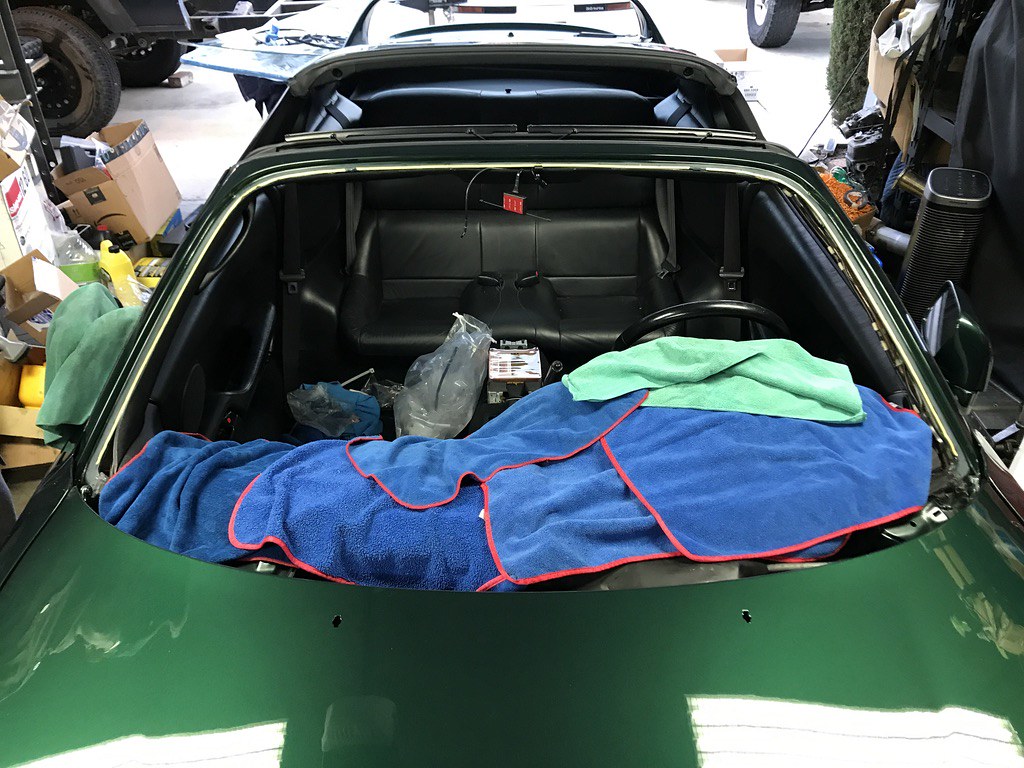

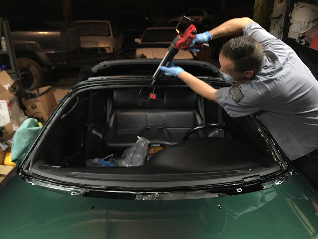

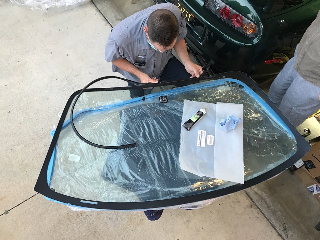

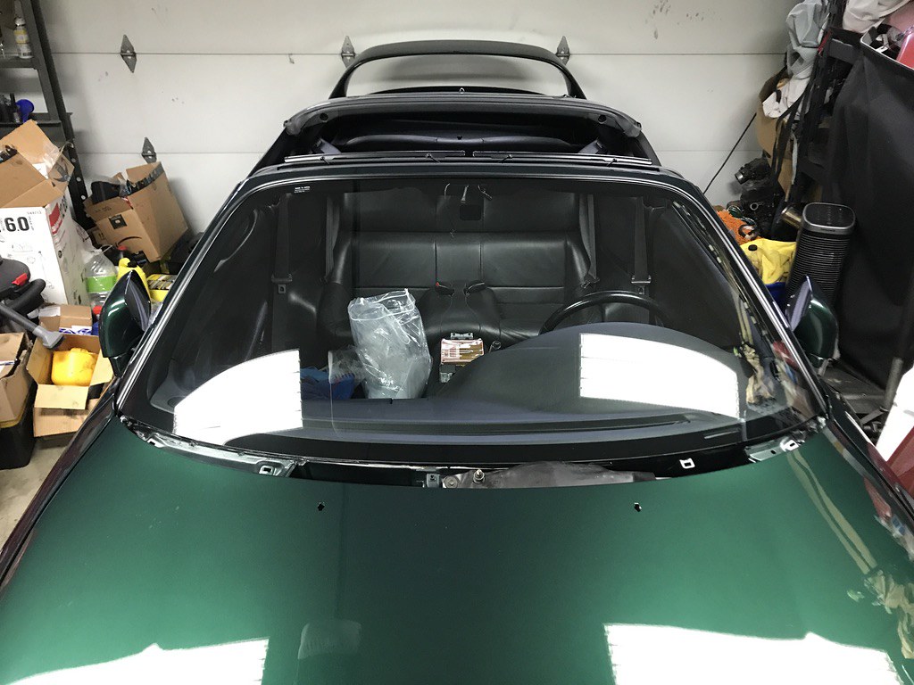

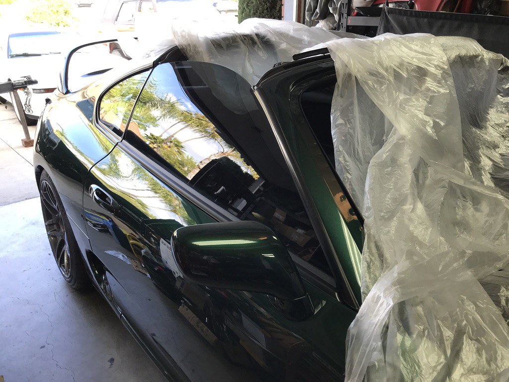

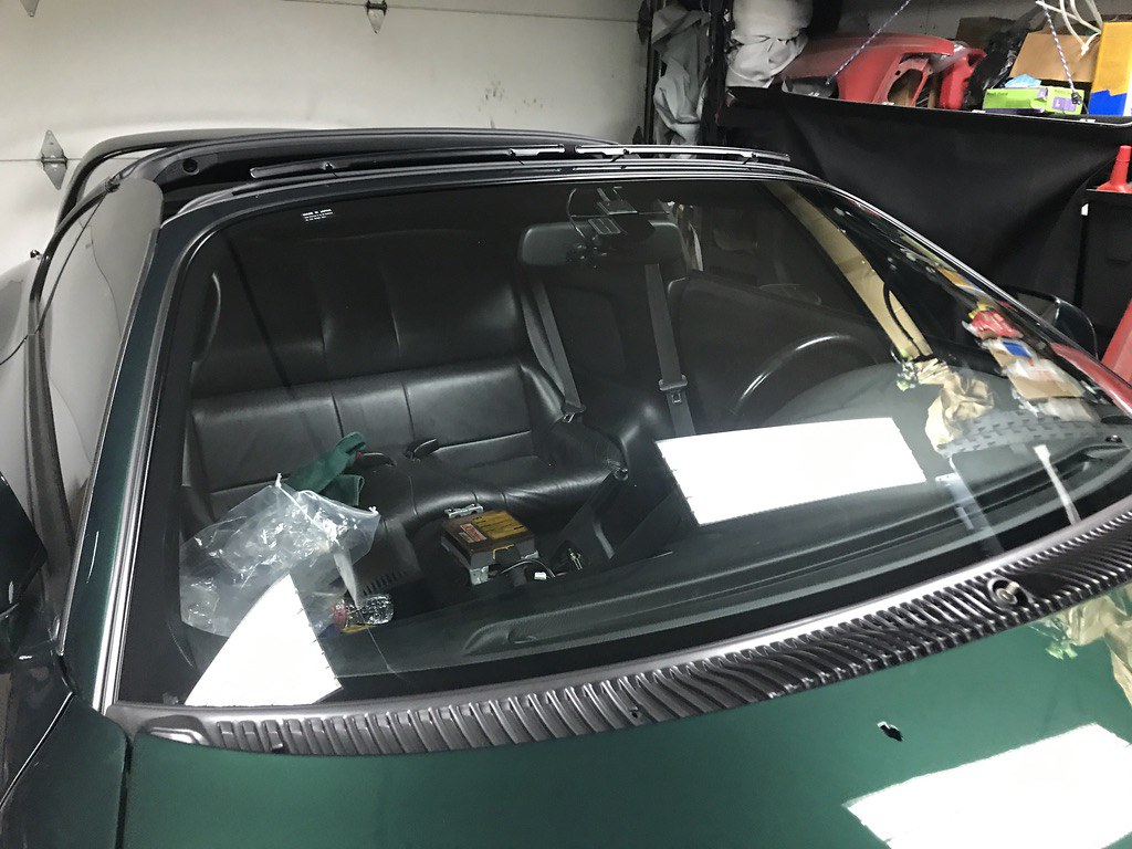

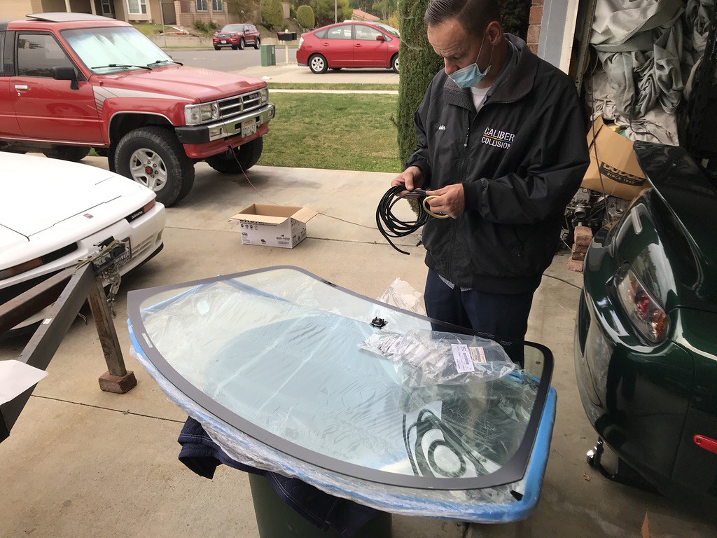

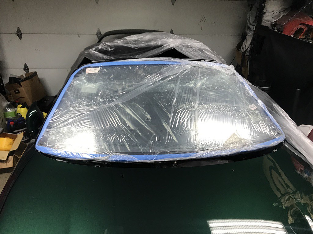

The last piece of glass to be glued in is the windshield. This is an OEM windshield from Toyota.
This is, unfortunately, the last time that Justin will be helping with this project, since he has purchased a new home in another state and will be leaving CA for good. He will be missed!!!

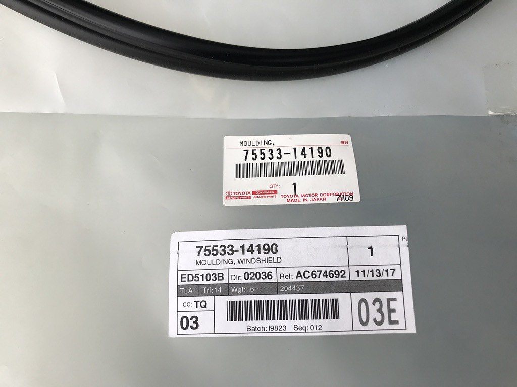

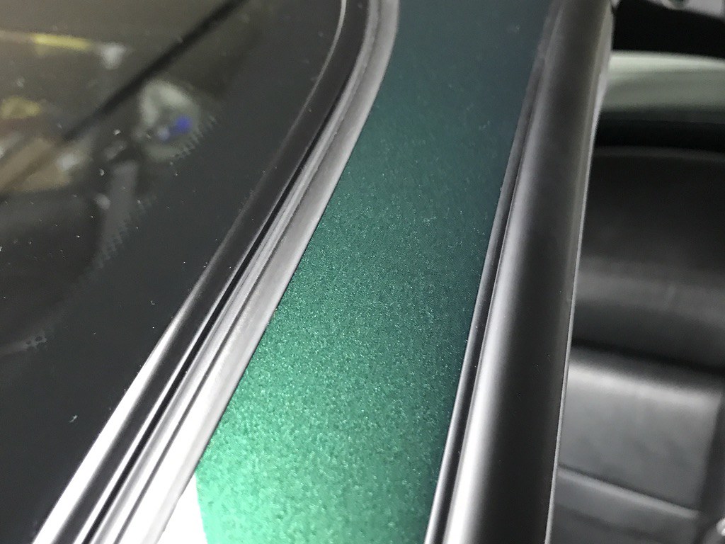

OEM outside window moulding

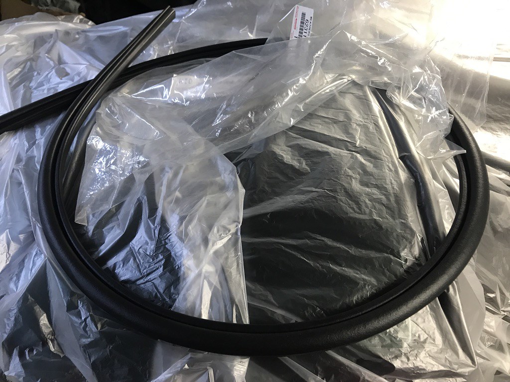

OEM Dam kit preparation. This kit is basically a rubber strip designed to provide a “dam” for the window caulking, to prevent the glue from being visible from inside the car. It gets laid down before the glue goes down.
The yellow strip shown is the adhesive strip being laid down, where the rubber strip is later laid down.
Using the same Mercedes-Benz window glue kit as the side and rear windows.
And installed!

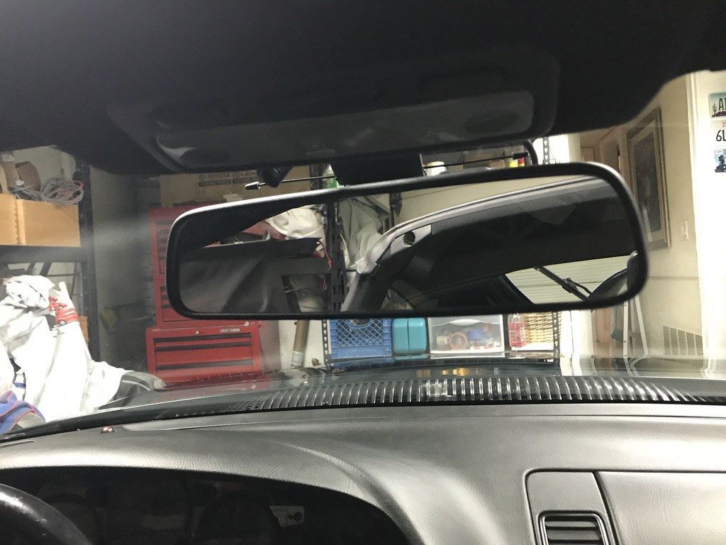

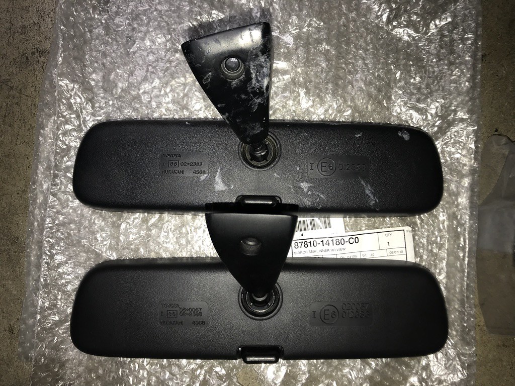

Old Rear view mirror (top) and new (bottom)

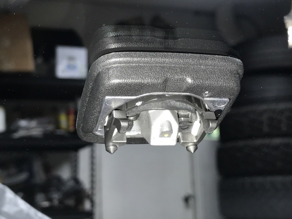

New base for mirror
Installed. Alarm antenna, radio microphone, and dash cam also installed.

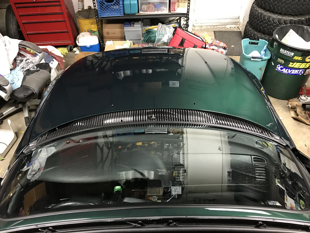

Brand new OEM Cowl!
