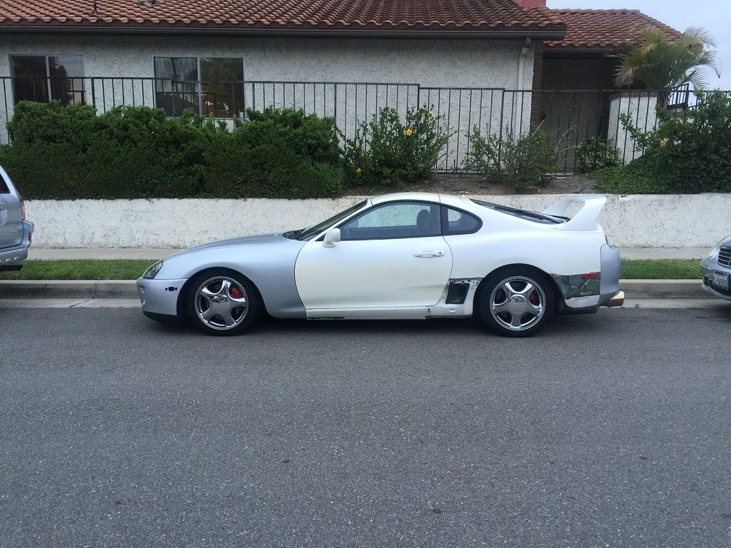

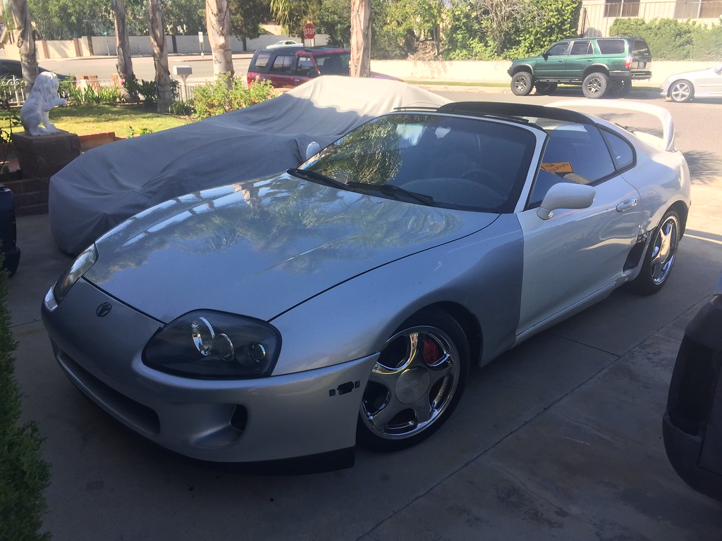

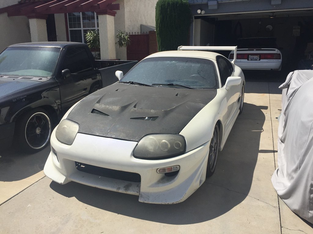

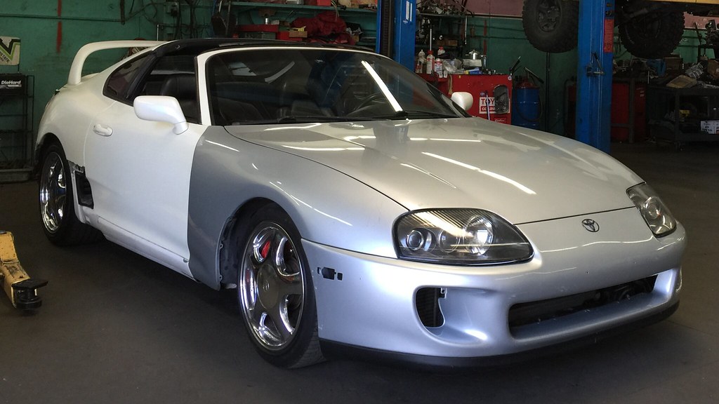

Before and after... less than a month since I bought it
Love it. Do you have plans for painting it eventually? And are you going for a targa top?

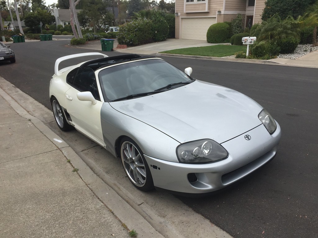

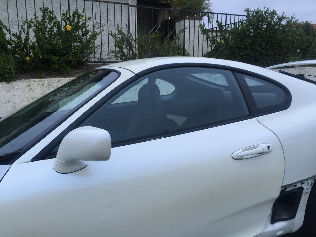

Yeah, this things got a ways to go. After mechanical repair, the exterior is going to change drastically.
1. Remove bondo from sides of car and door jambs
2. Drill out rivets, weld holes and smooth
3. Rust repair or replace rear hatch if necessary
4. dent removal (targa top, driver's door, a few dings elsewhere)
5. paint match the inner door jambs
6. paint replacement parts from silver to white inside
7. reassemble car, then paint factory white

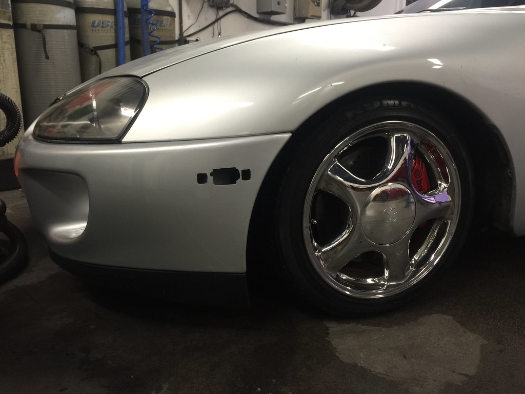

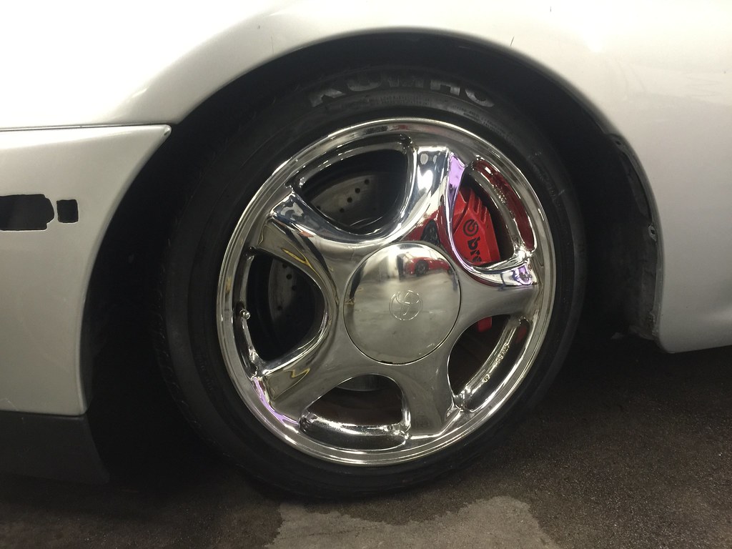

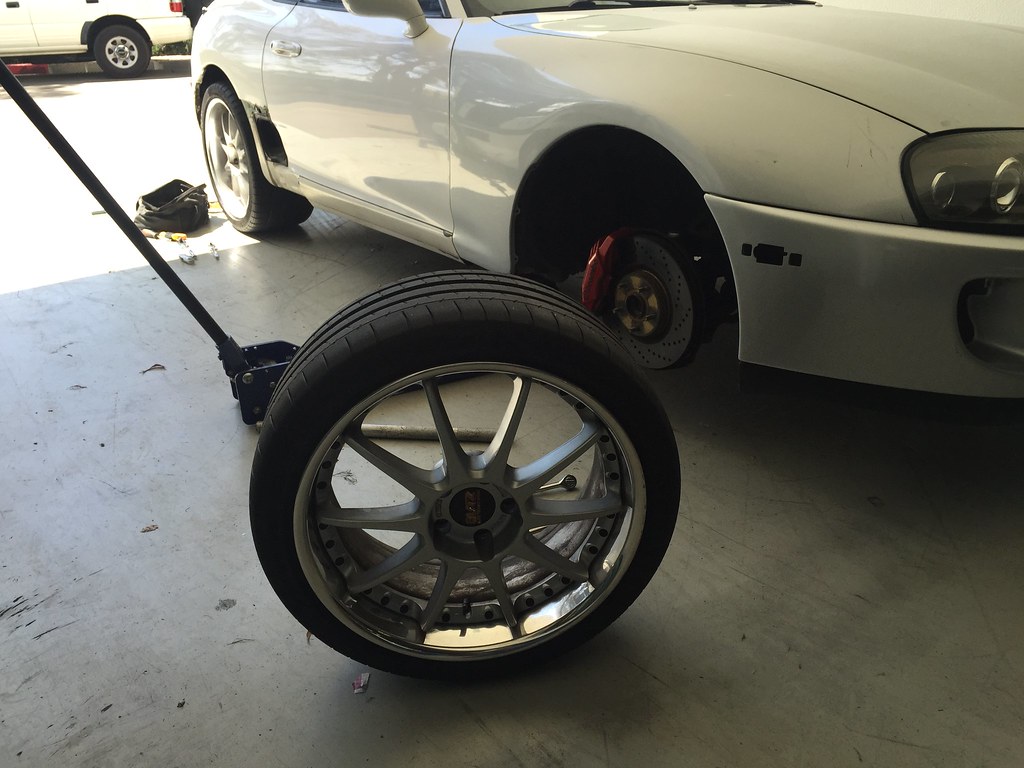

The Blitz wheels are gone - Traded them for a set of chrome TT wheels plus $1,000 cash.
The chrome isn't my taste, but sure beats curbed heavy 19's. Might end up painting the chromes or trading them.

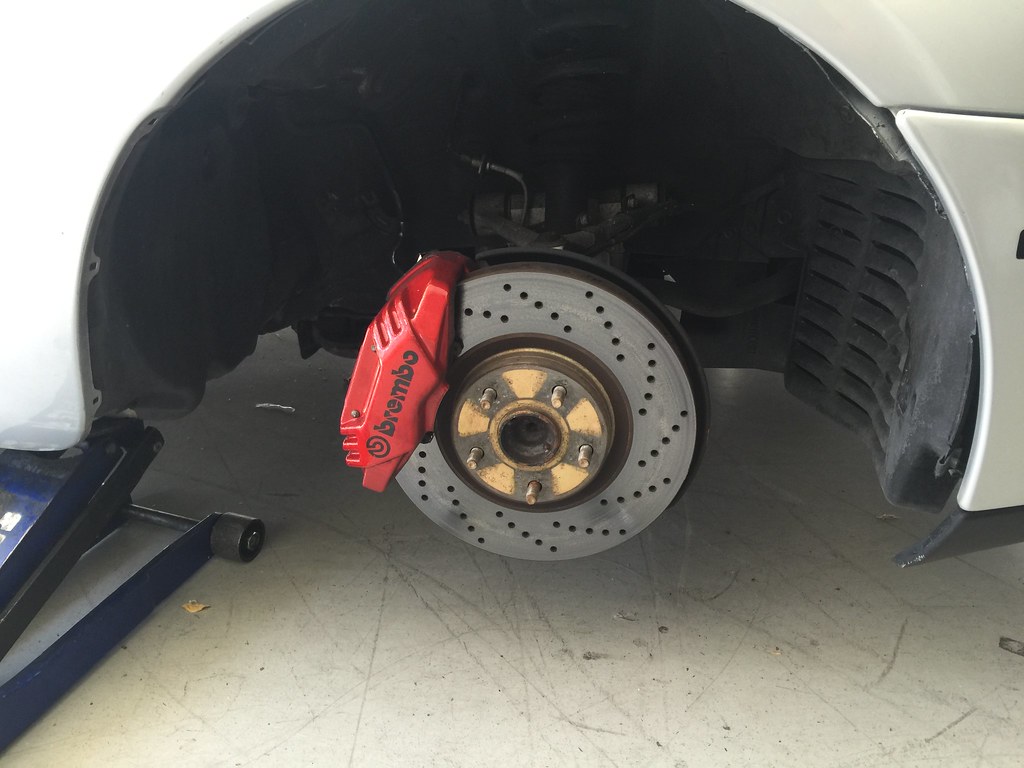

The sorry state of the brakes - new rotors and pads will be finding their way onto this car. The silly brembo stickers will be removed from the stock TT calipers.
Bonus! Stainless steel braided lines!
Chrome sure is ugly... though nothing on the car matches yet anyway.
Also on the hunt for some decent tires.

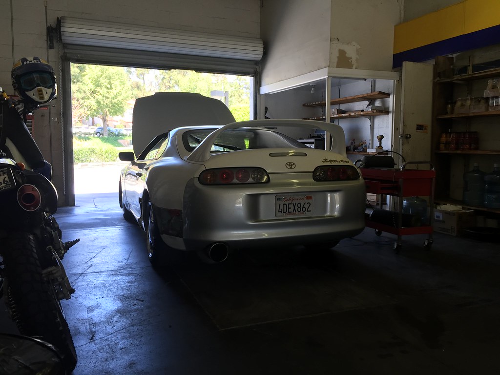

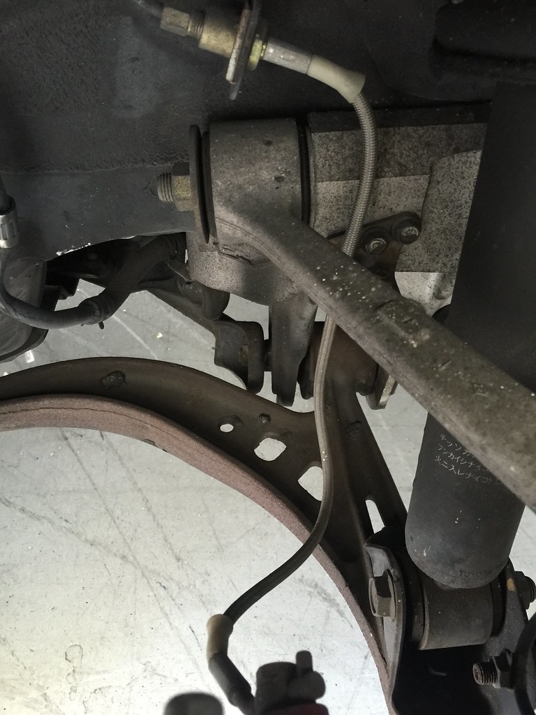

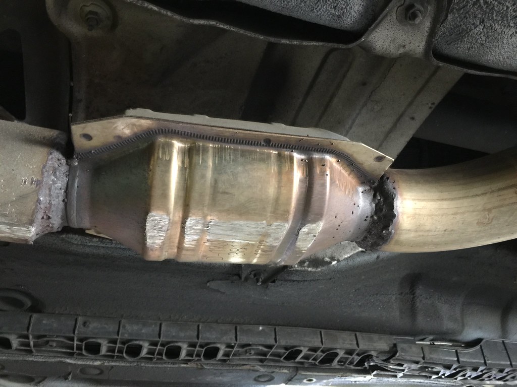

Later went down to my friend John's. Using his lift, I was able to check the undercarriage.
After finding shit like this, you better believe it's getting straight piped with the correct size tubing. Test pipe for a temporary smog solution.

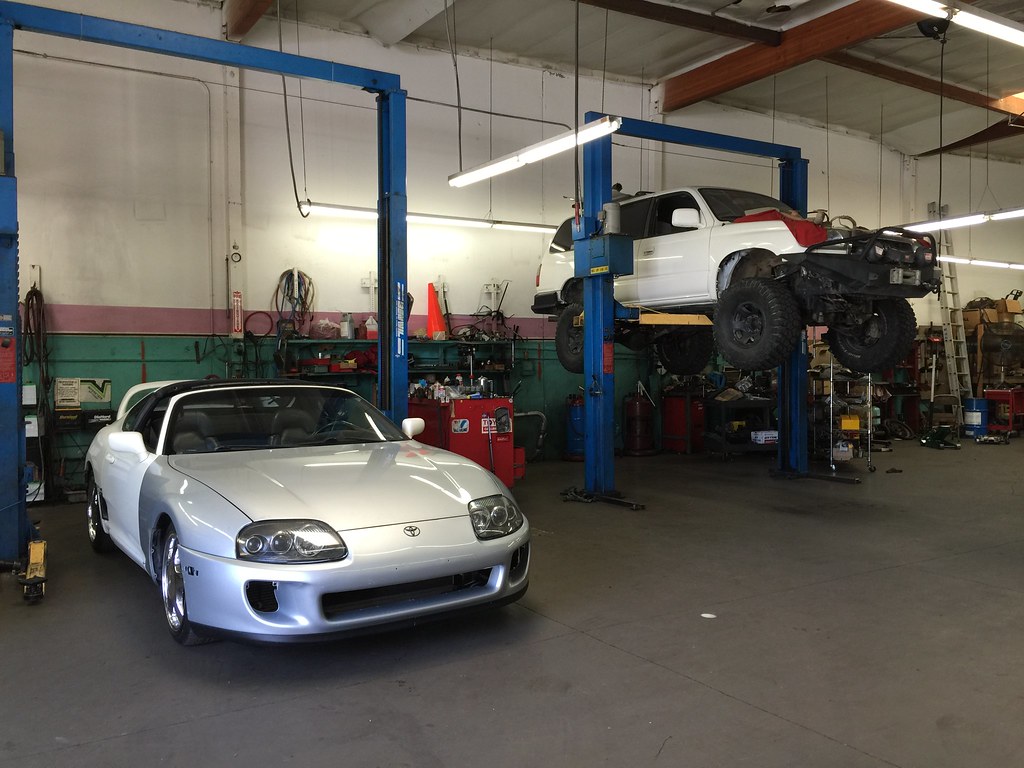

Alongside: John's latest vehicle, a 98 4Runner 4x4. It's got bumpers, Total Chaos UCA's, coilovers, and KM2's. I've posted pictures of that 4Runner on here a few times and now my friend owns it, lol.

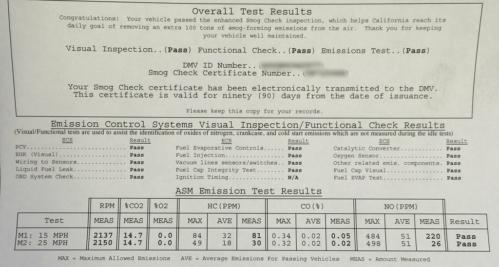

WILL IT PASS SMOG?
YES :)

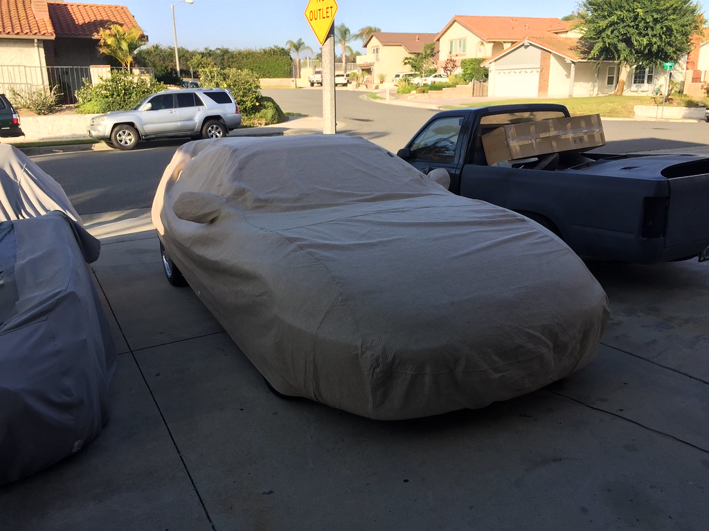

So I'm guessing you just pushed it to the driveway? If I were you, I would tell him to take it or it's yours haha.
Supra's looking good BTW. Can't wait for the paint!
I've tried to acquire it... it'd have been put to use years ago. I'm glad I didn't, or else I'd have probably never fixed up the 87 4Runner.
Yeah the Supra is a bit frankenstein right now, but it'll be nice when it's all painted.

The car is actually already pearlescent white, and I hate it, lol. Too over the top for me.
The white will likely be a nicer two stage rather than the original single stage, but nothing crazy. I like it simple.

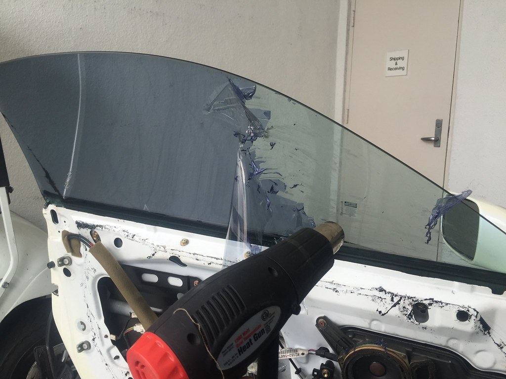

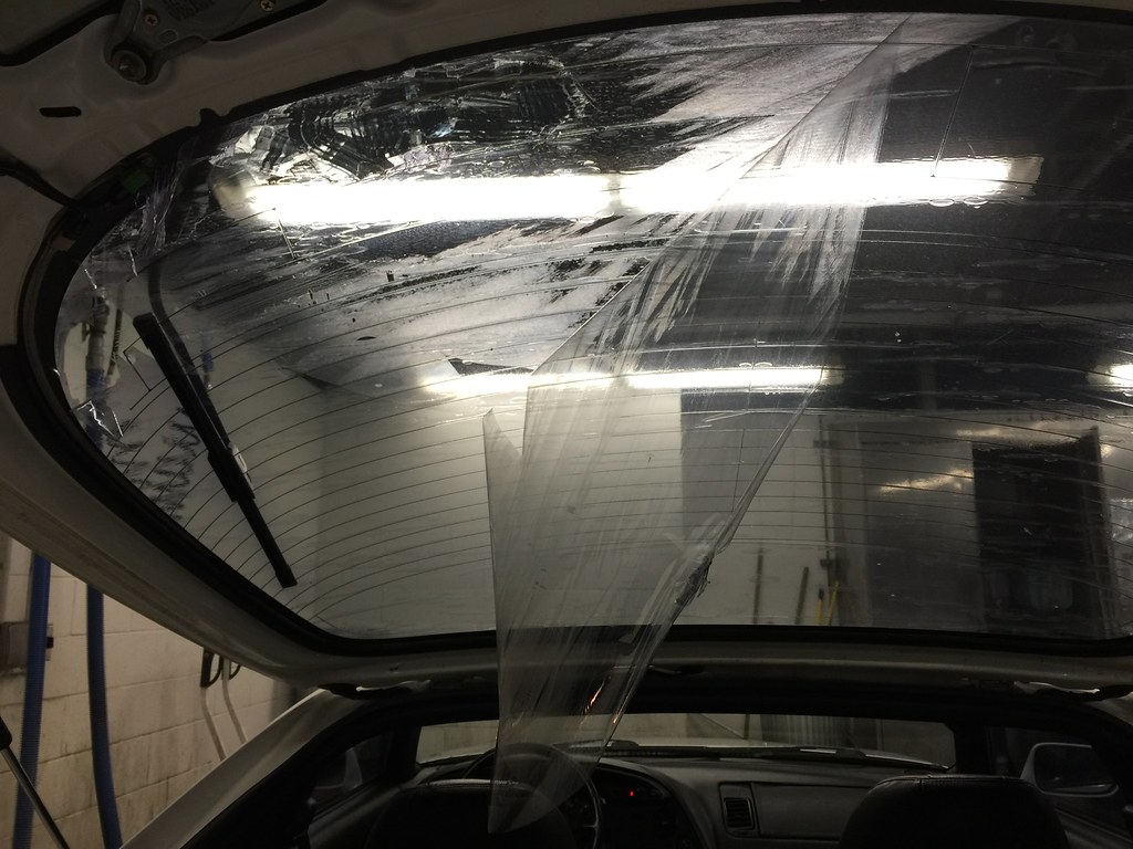

Sent the tint back to hell from where it came. Faded to purple es muy mexicano. :usa2:

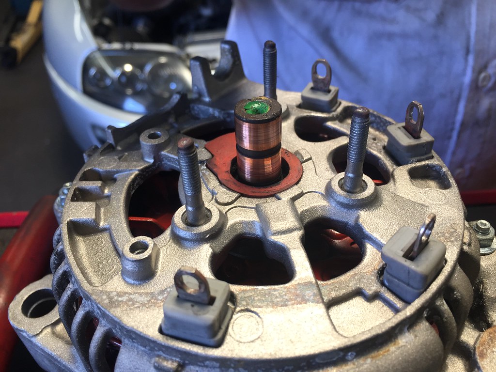

My friend John had an alternator from a Lexus RX330 he had parted out. The thing shared internals, voltage regulators, brushes, stator... it was the same alternator with the exception of the mounting locations on the housing and the size of the positive terminal.
My alternator randomly failed - the trick was switching the piece with the positive terminal. The lexus terminal was too short, so John cut it off, tapped it, then did the same for the longer Supra terminal. Screwed the longer terminal onto the now-threaded Lexus terminal - I've got an alternator. 14.3V of alternating goodness.
Shown: alternator with the backing, voltage regulator, brushes, and the terminal piece removed.
