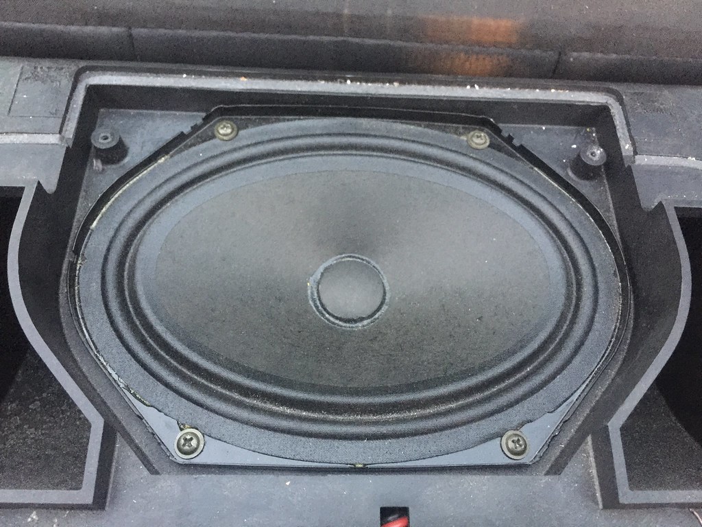

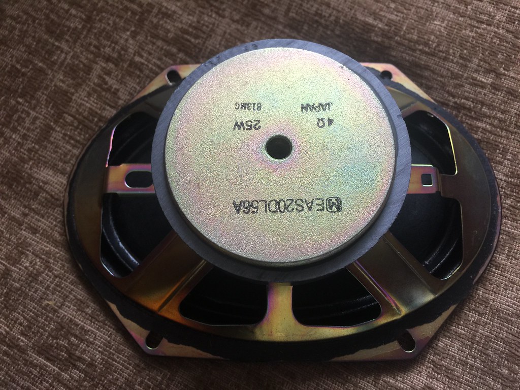

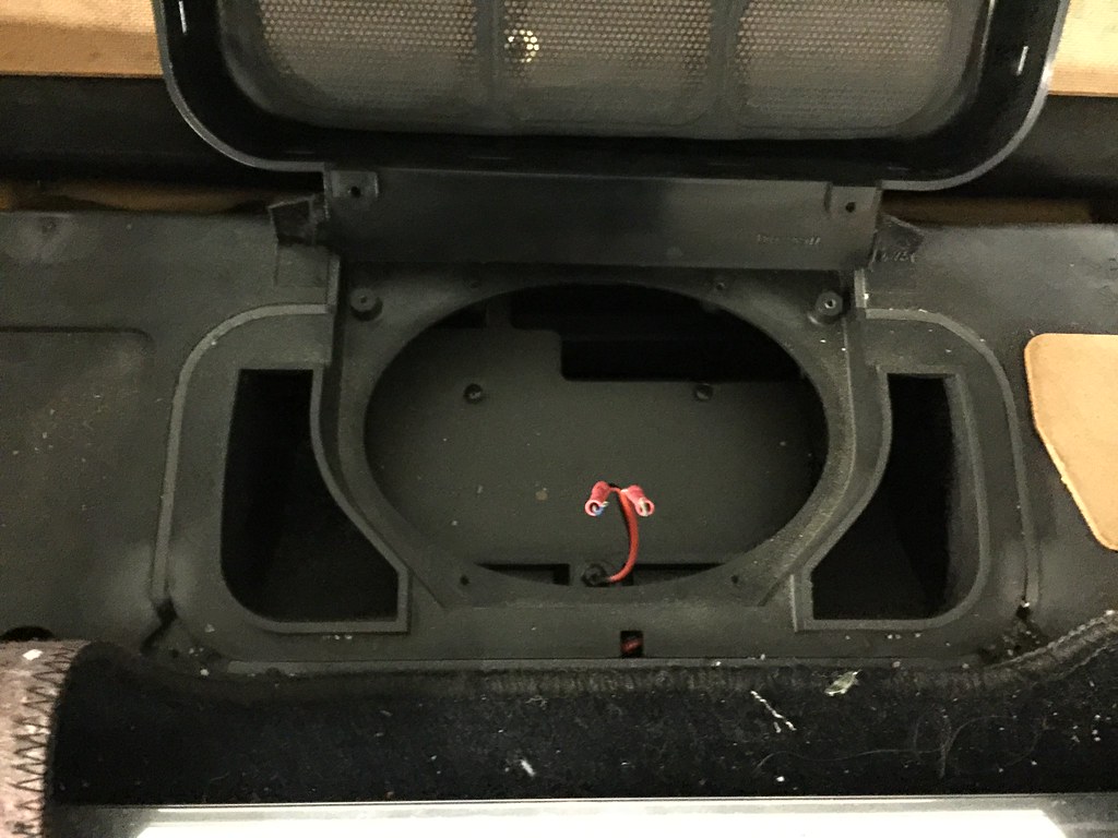

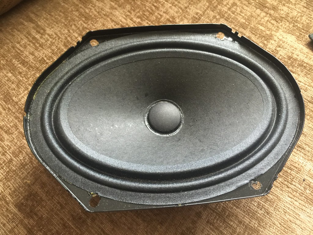

After reading about the OEM 5x7 subwoofer, I was curious why mine must not be working. Popped the clips from the carpet and unscrewed the cover... that'll do it! Ordered one from eBay.
OEM 5x7 subwoofer!
Wiring and insulation from a MKIII supra speaker box. Perfect fit.

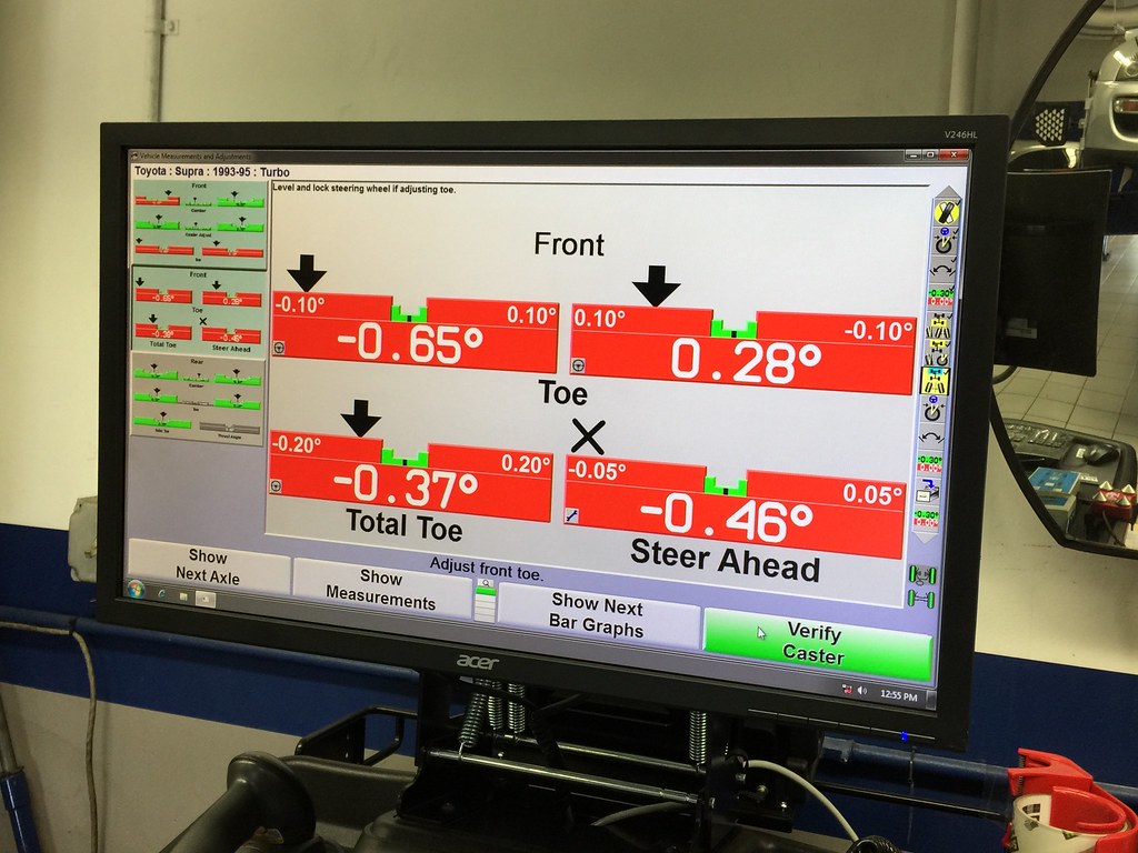

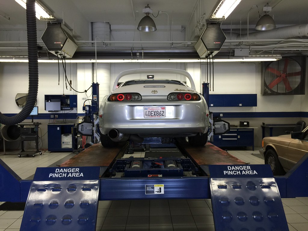

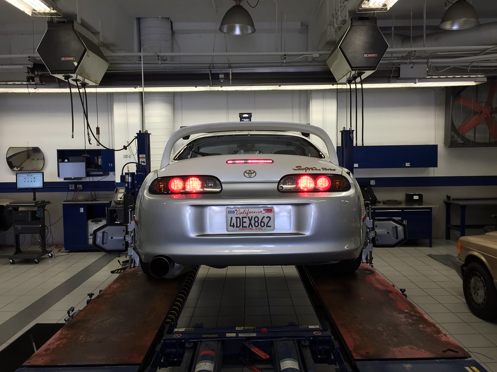

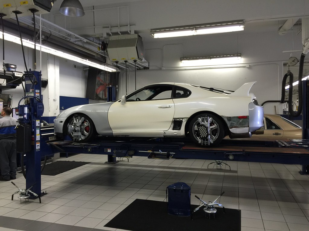

The car has a bad pull, so I paid our alignment tech a visit. The toe was terrible up front. Thankfully, the car will soon have a new matching set of tires.

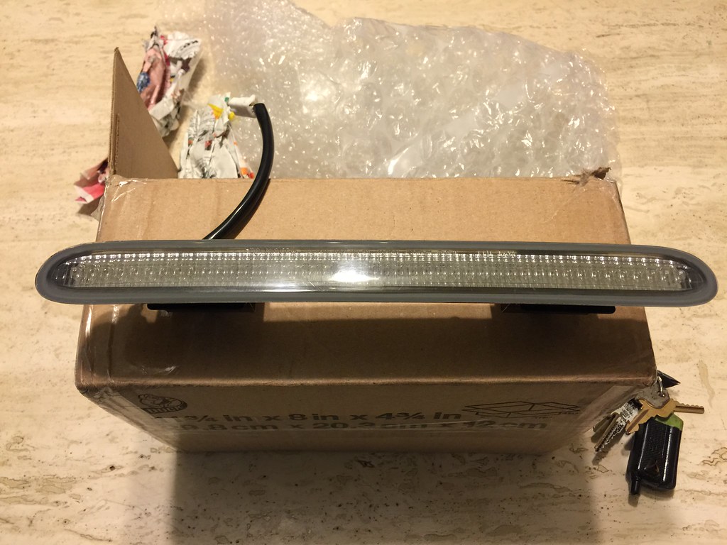

Unfortunately, it appears the third brake light has some burnt LEDs. Oddly, the number of burnt LEDs doubled while the lights were held on. The burned out ones on the left side stopped working on the alignment rack. I found another tail light for sale.
Replacement LED tail light. Strangely, when I was testing the new one, I found that the old one seems to be working on all LED's again... :wtf:
keeping this as a spare.

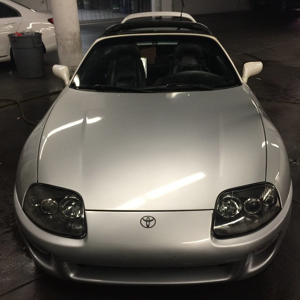

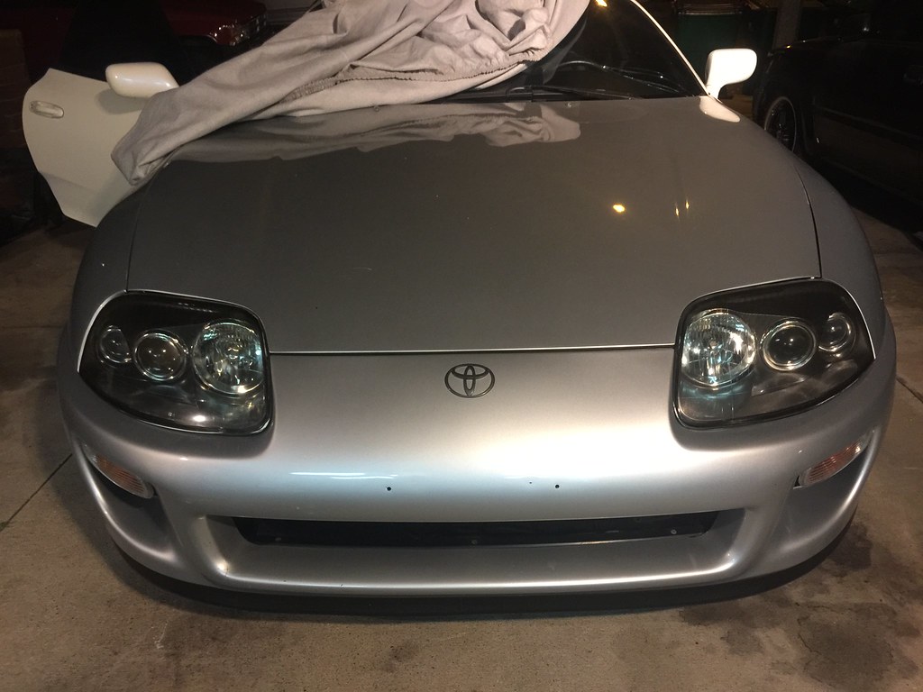

Headlights polished and waxed

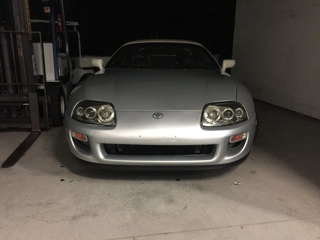

Front marker lights installed

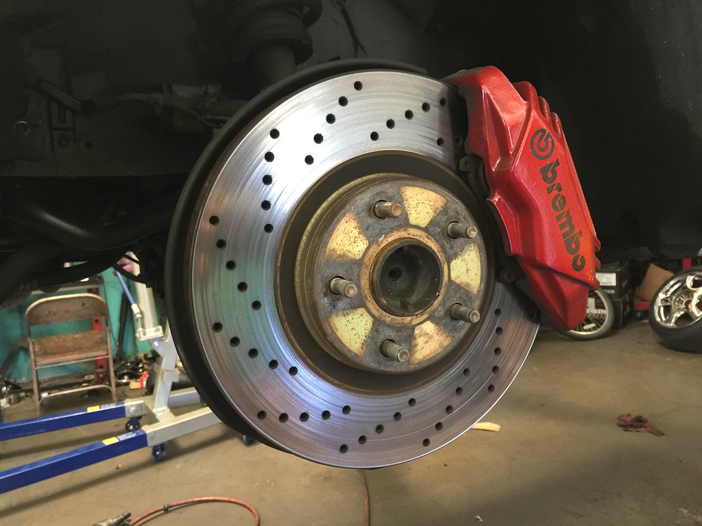

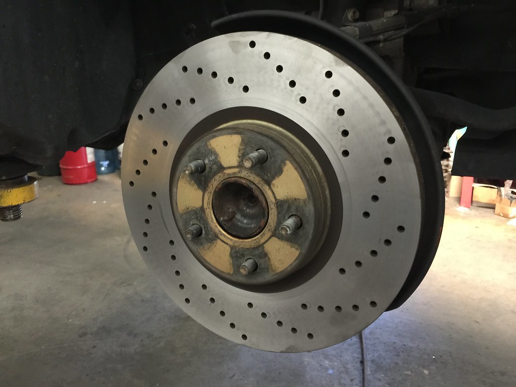

Brake rotors have a lot of thickness left, therefor I chose to resurface them and install new Akebono pads. Later on, I plan to remove the brembo stickers from the stock TT calipers and repaint them.

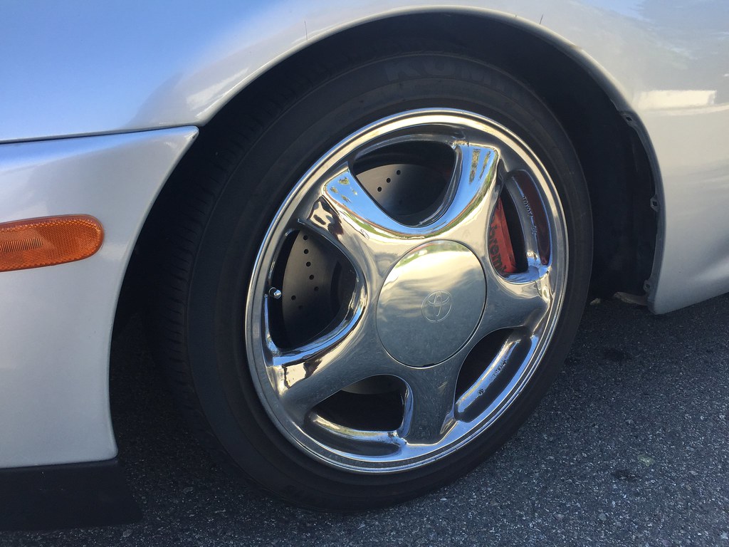

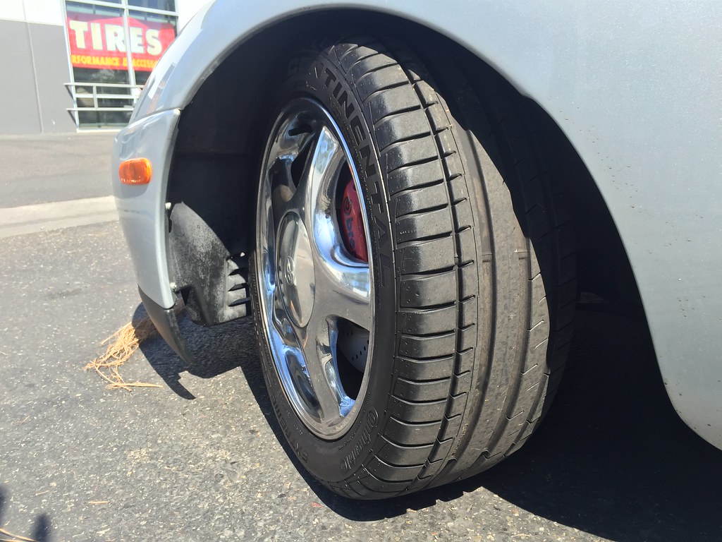

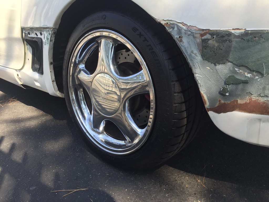

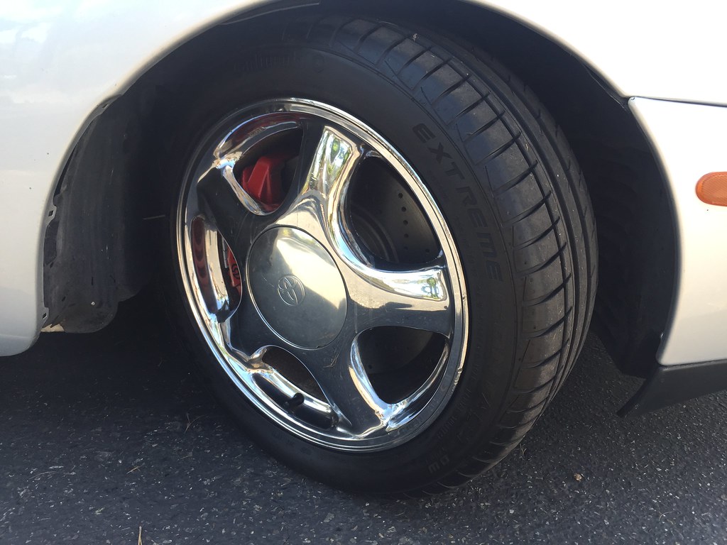

The 17" wheels on this car look much better with the proper tire..
Before, the front was on 215's...
Continental Extreme Contact DW 235/45/17 and 255/40/17

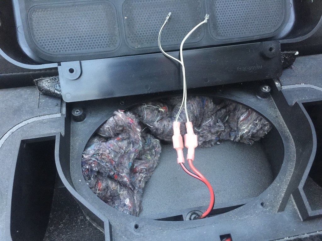

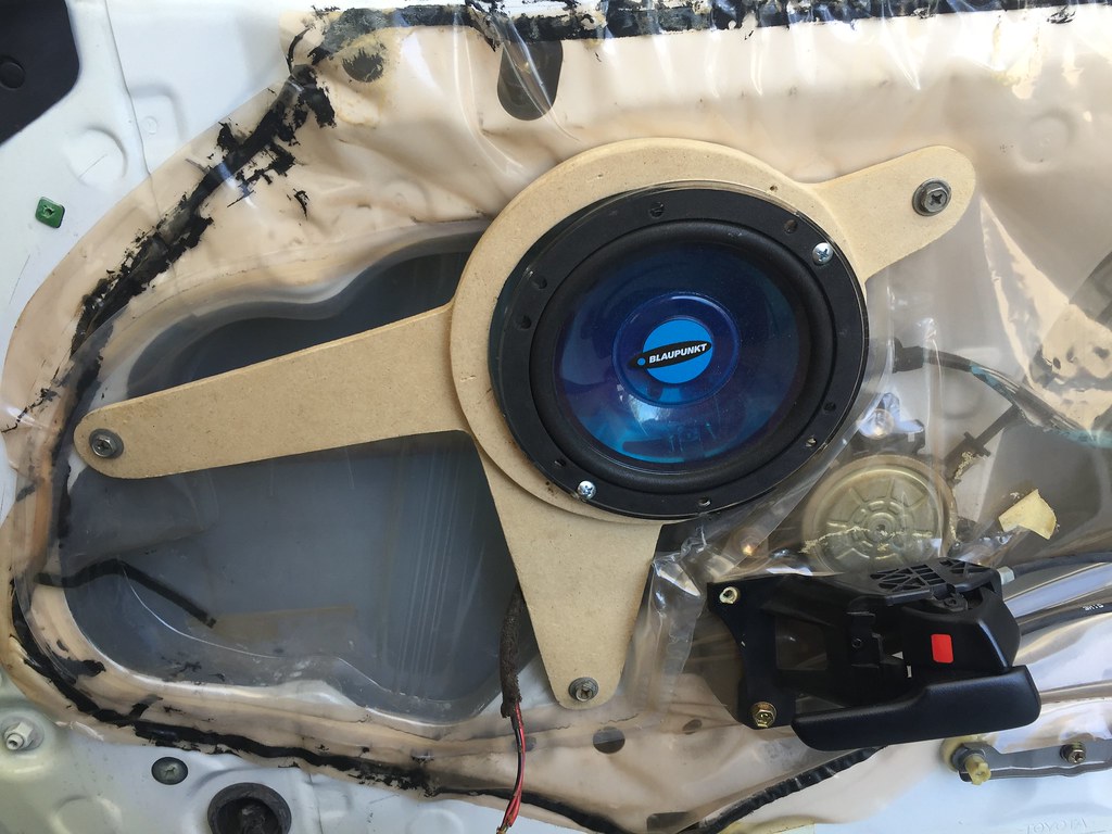

Pulled the speaker boxes, removed the harnesses from each, and plugged in a set of 6" Blaupunkt speakers I had laying around. Sounds SO much better, even if they're still just alright speakers.

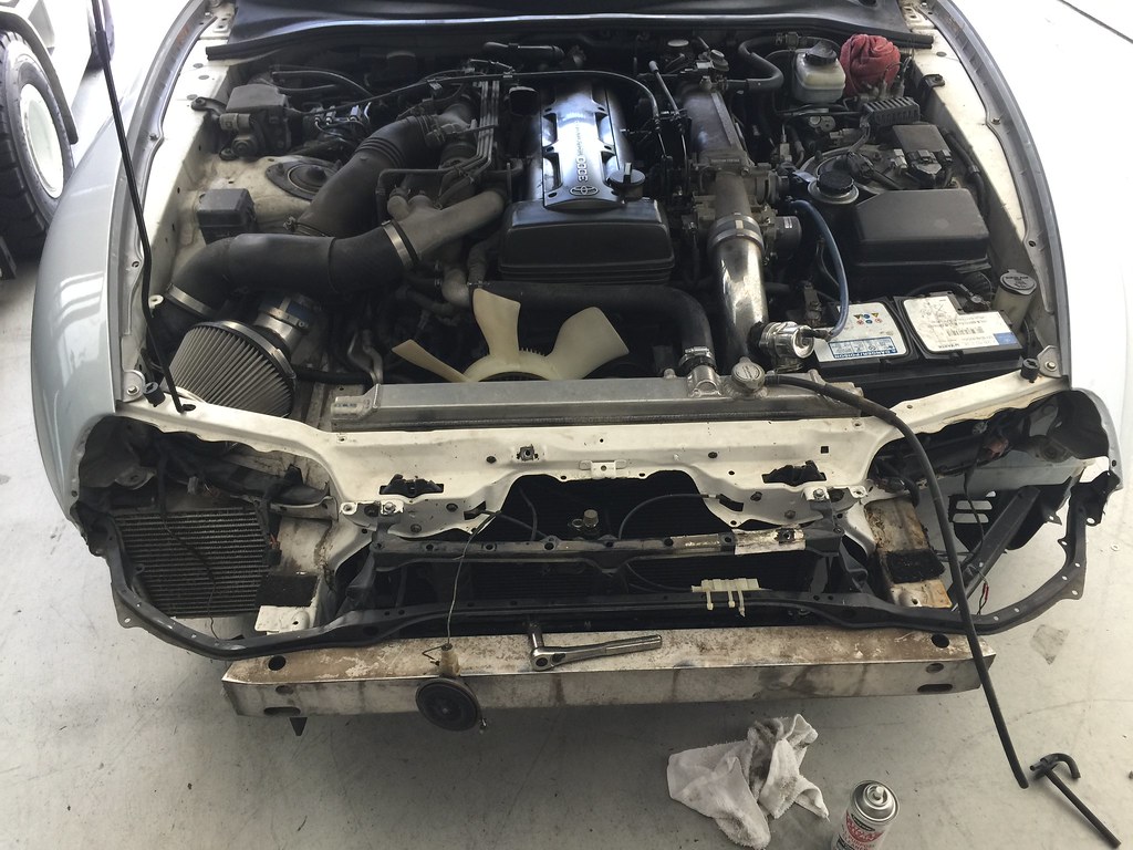

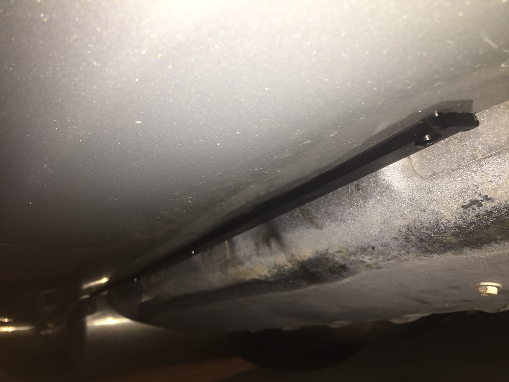

Crash bar

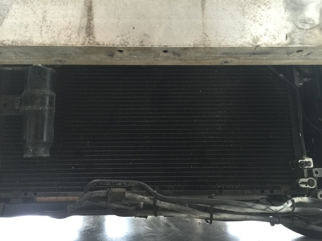

A/C condenser + dryer
bumper brackets
Overflow tank

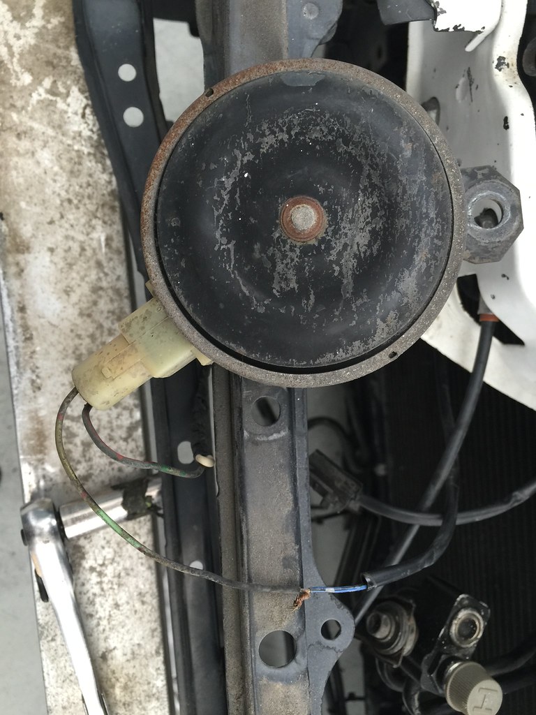

Realized someone spliced in what looks like a 1980's Toyota Pickup horn... on the list: horns.

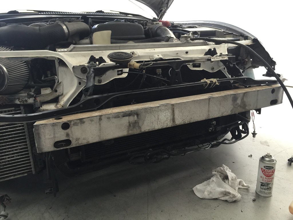

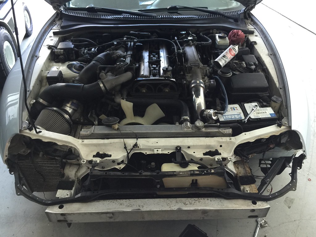

A/C condenser bolted in. Smashed up cooler lines need to go, those are zipties I added (only ones I've put on the car) to keep them from smacking the ground until they're replaced.
Overflow tank installed. Previously, no overflow at all, just the rubber line pointed at the ground.

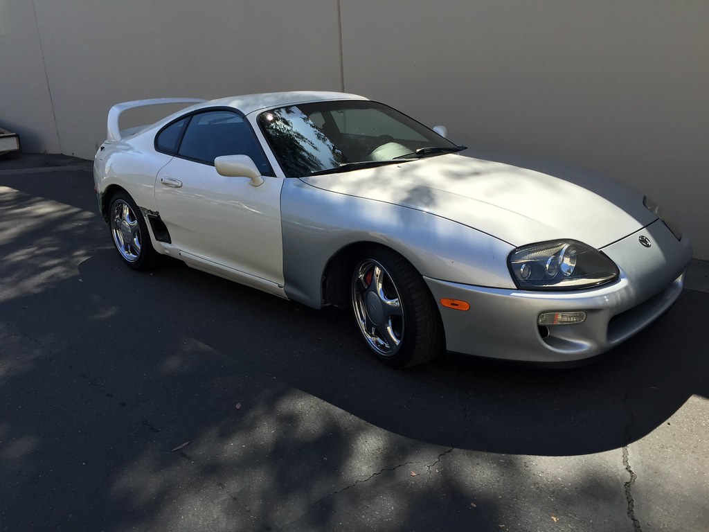

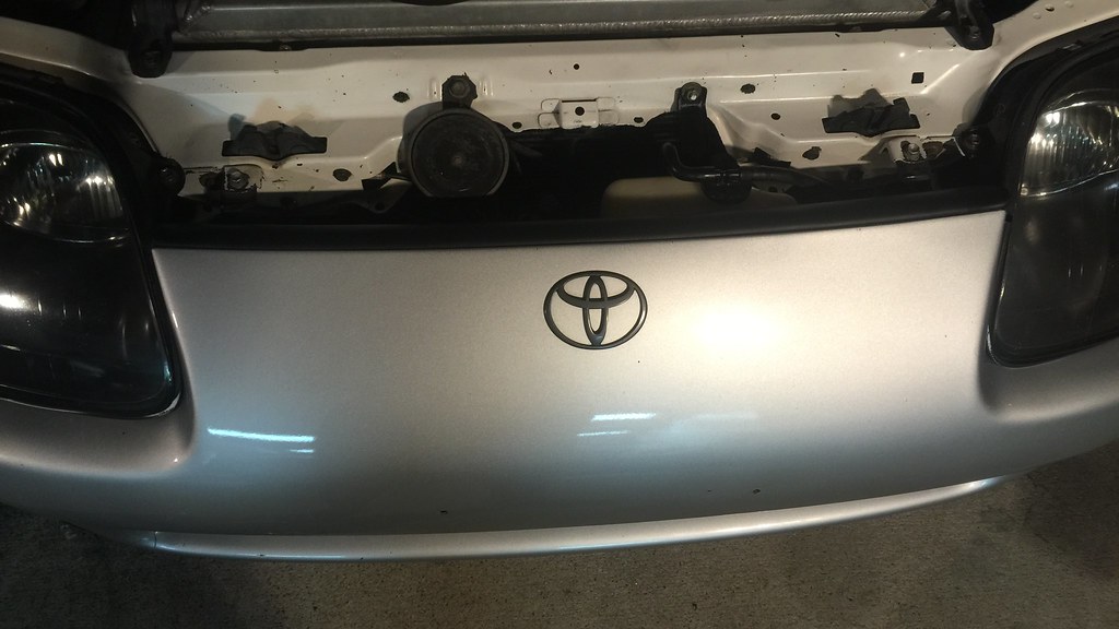

Adjusted the fender and hood gaps, located the side parking light wires (which were cut, need to find pigtails and plugs now), and reinstalled the front bumper properly. All is well in front clip-fitment world.

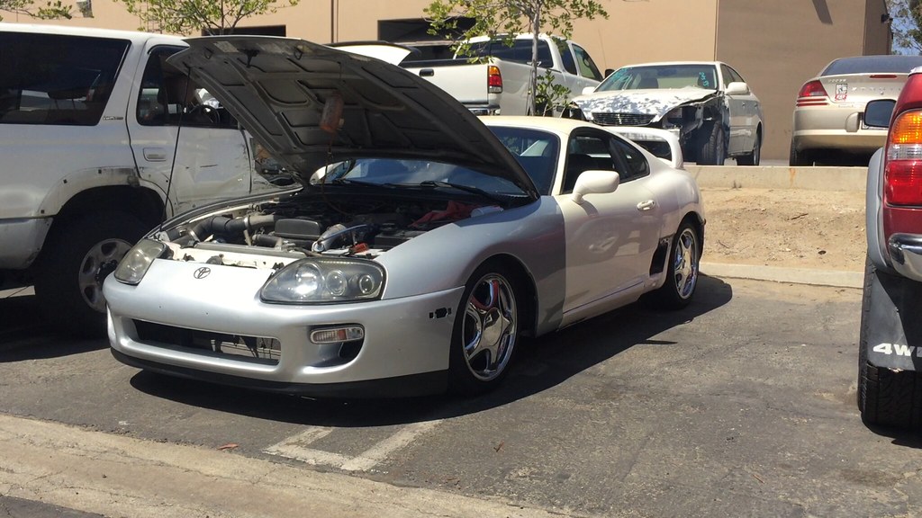

Supra has been having an issue at WOT around 4200RPM, power loss. Still chasing that one down... suspecting the second turbo isn't properly engaging. Going to test out the true twin setup and see if perhaps the second turbo solenoid is acting up.

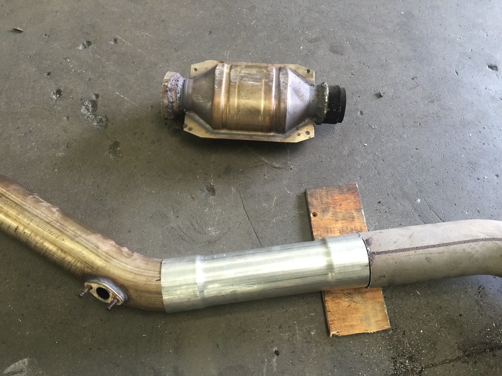

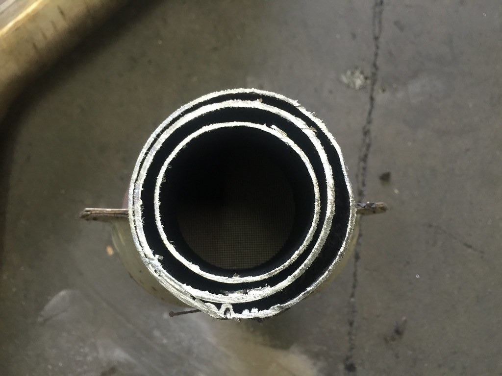

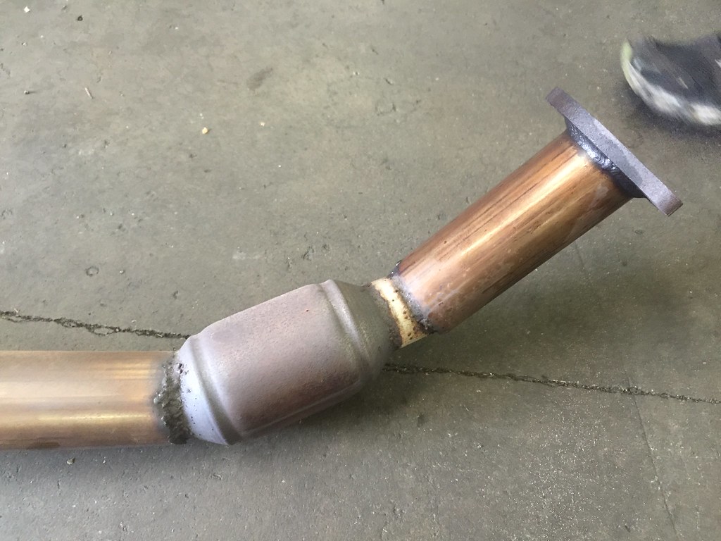

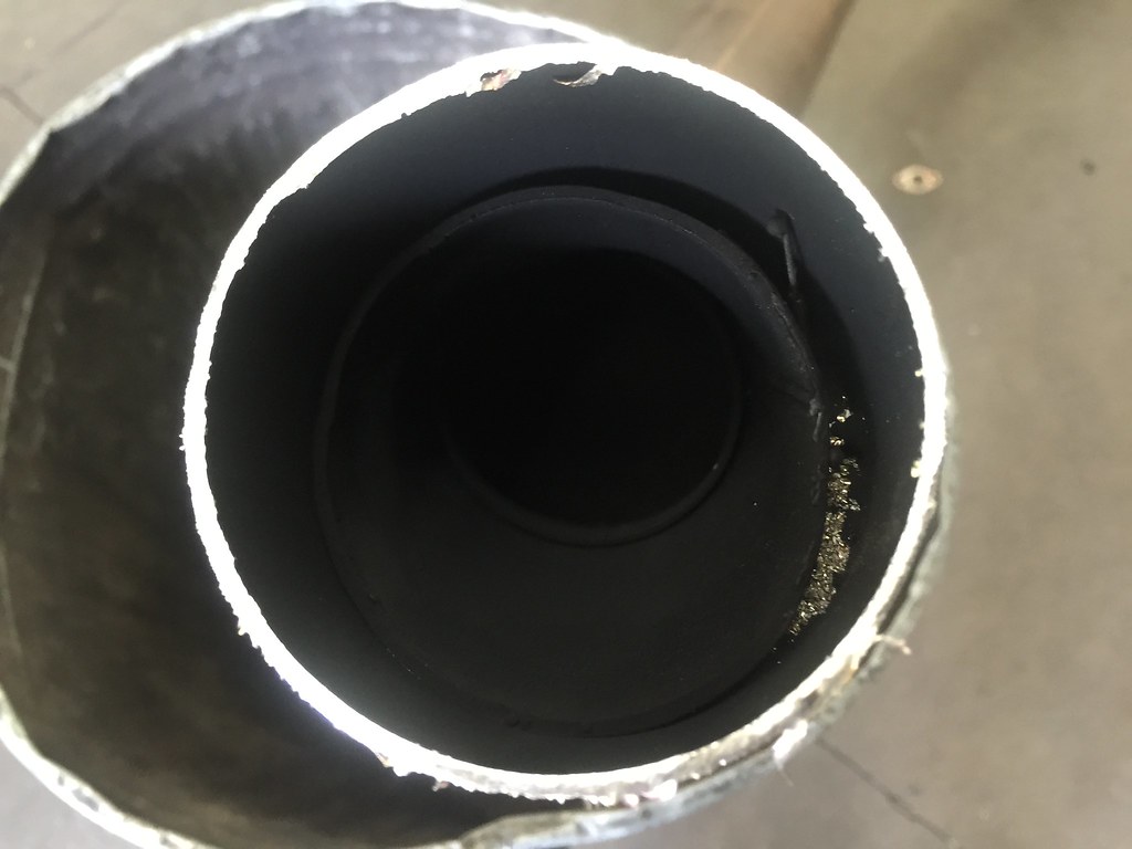

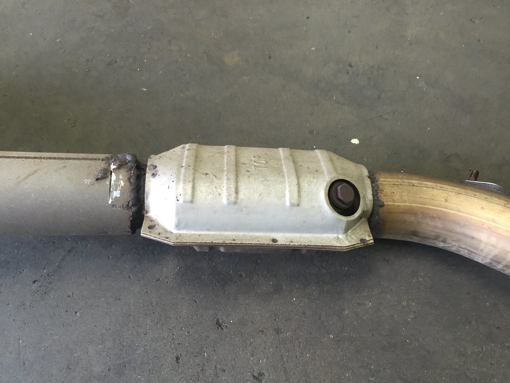

The restrictive catalytic converters have been removed. 3.5" exhaust with 2" cat... WTF.
This ones even worse... entire section has been replaced with a 45 degree mandrel bend.
Air flow loves stuff like this!
Falling on hard times doesn't even call for this
Exhaust goes from 3" stainless to 3.5" HKS Super Drager.

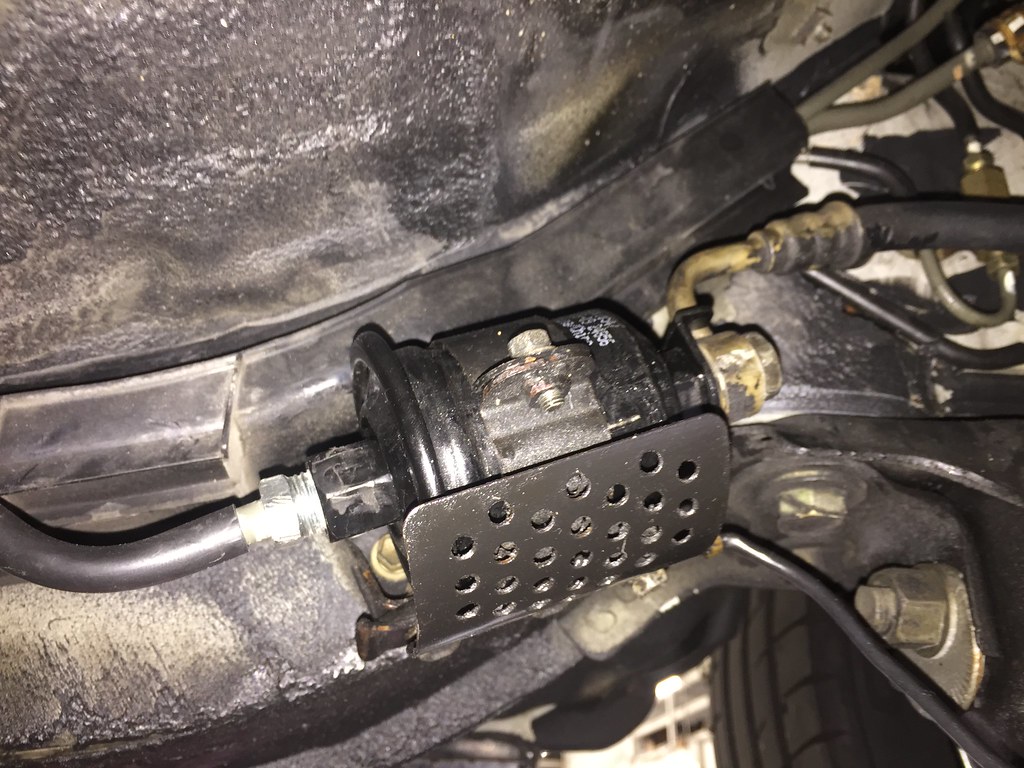

New fuel filter... under the car is very saturated with ATF from a power steering pump leak. The old fuel filter was the original with the car. The undercarriage will be meeting a steam pressure washer soon.

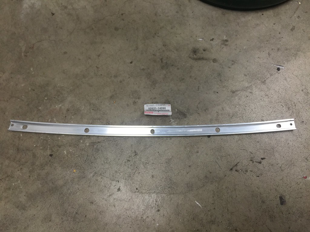

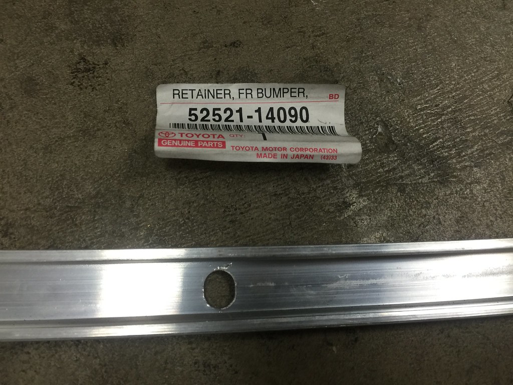

Front bumper mounting bracket between the headlights
Hood seal
Rear bumper mounting bracket

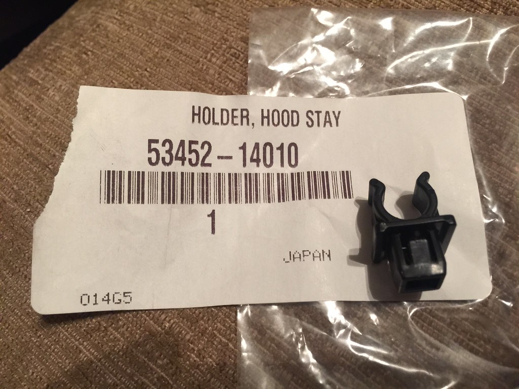

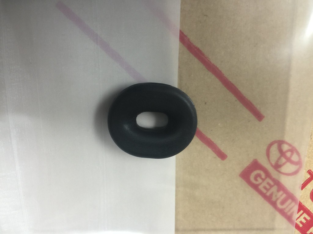

Hood prop grommet
New hood prop stay

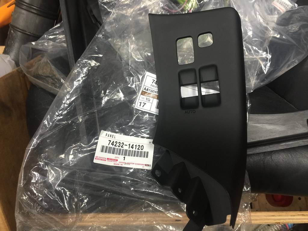

93-96 black driver's side window switch panel
