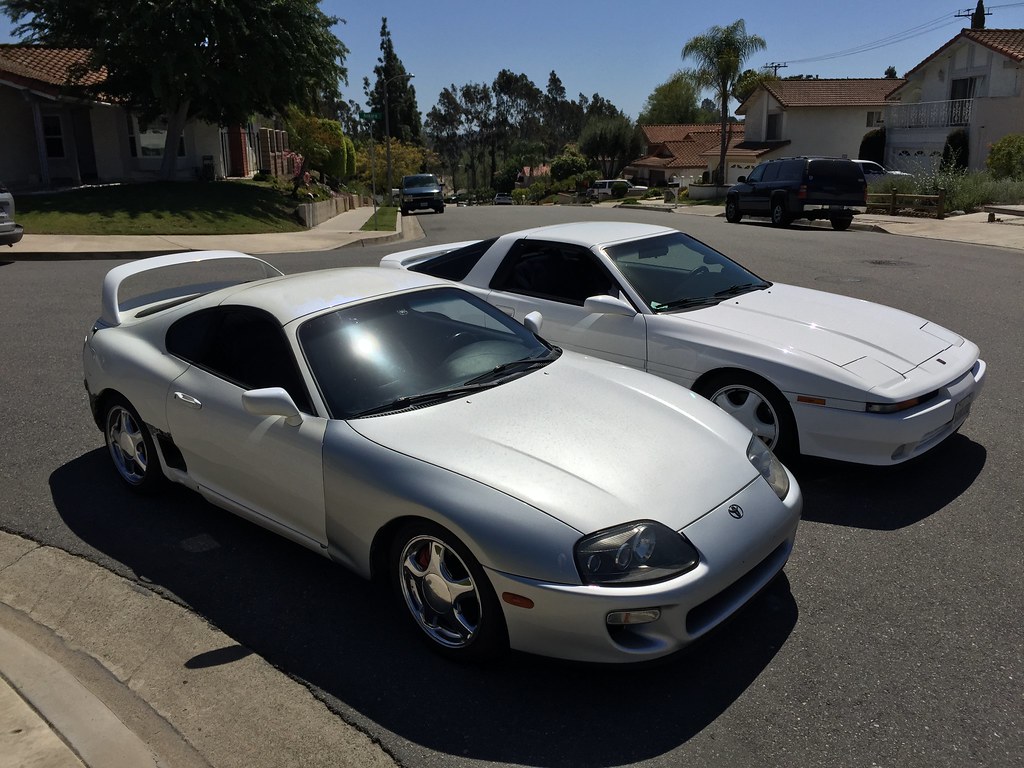

Awesome progress James! SIV is just a month away! Hope to see you with either of your Supras there. Unfortunately neither of my Supras will be joining me this year but I'm still going for the festivities. SIV is an amazing time you never want to miss. This year should be the best yet! Lots of big names making their way out. Really looking forward to the drag strip action on Sunday.
I saw the photos and it looked like a great time. I was unable to attend, but now that both Supras are up and running, I'm planning for next time! Will you be taking the Supra out this upcoming SIV, or is it too early for you to know?

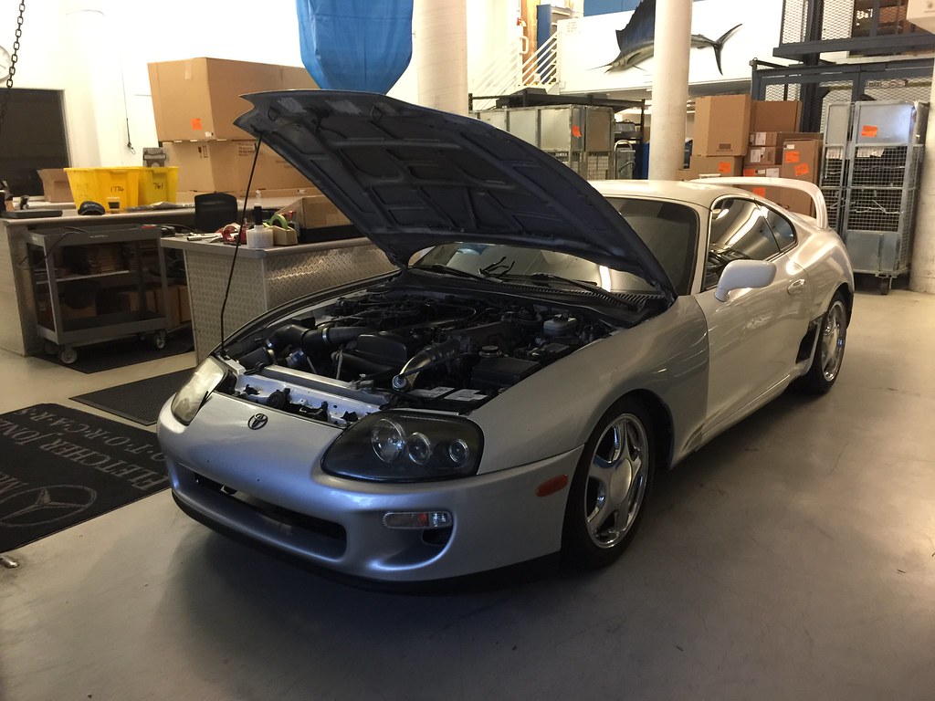

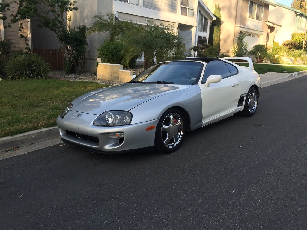

The paint work will be done at my actual place of work, a Mercedes-Benz dealership. It's not easy to get a deal there, it has to be done under the table, cash only. I've been patiently waiting for my body guy to be free enough to handle the bondo removal/rivet hole welding (he's a really busy dude, but gives me a great labor price per hour). Once he's done, I'll talk to the prep guy to handle all the smoothing and finalizing. If all goes well there, I'll talk to the paint guy to get it in the spray booth. It's harder to get it done this way, but I won't have to pay the shop labor rate.

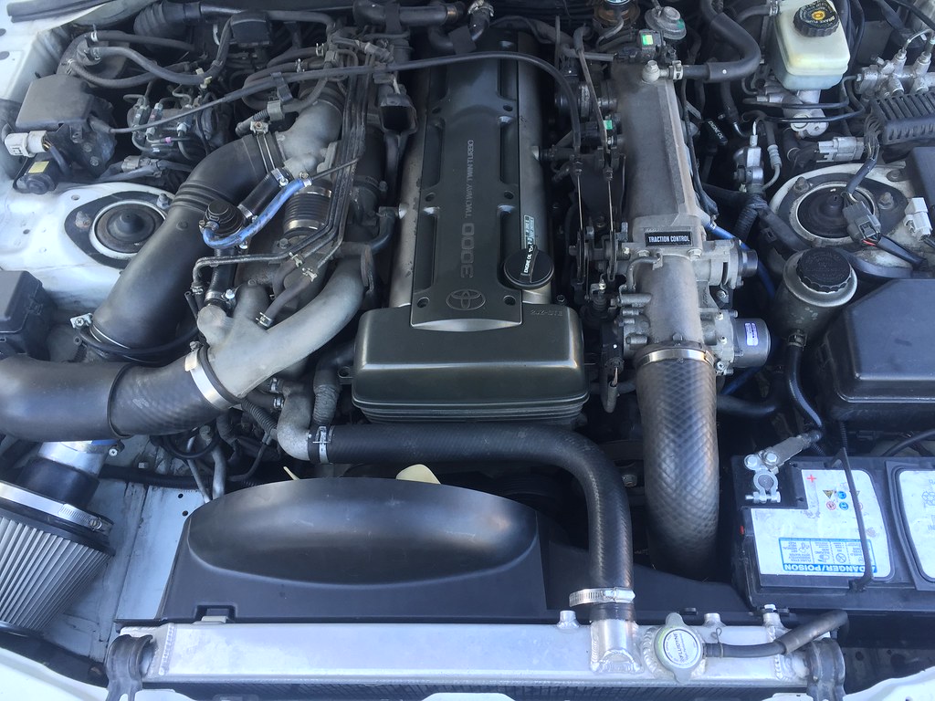

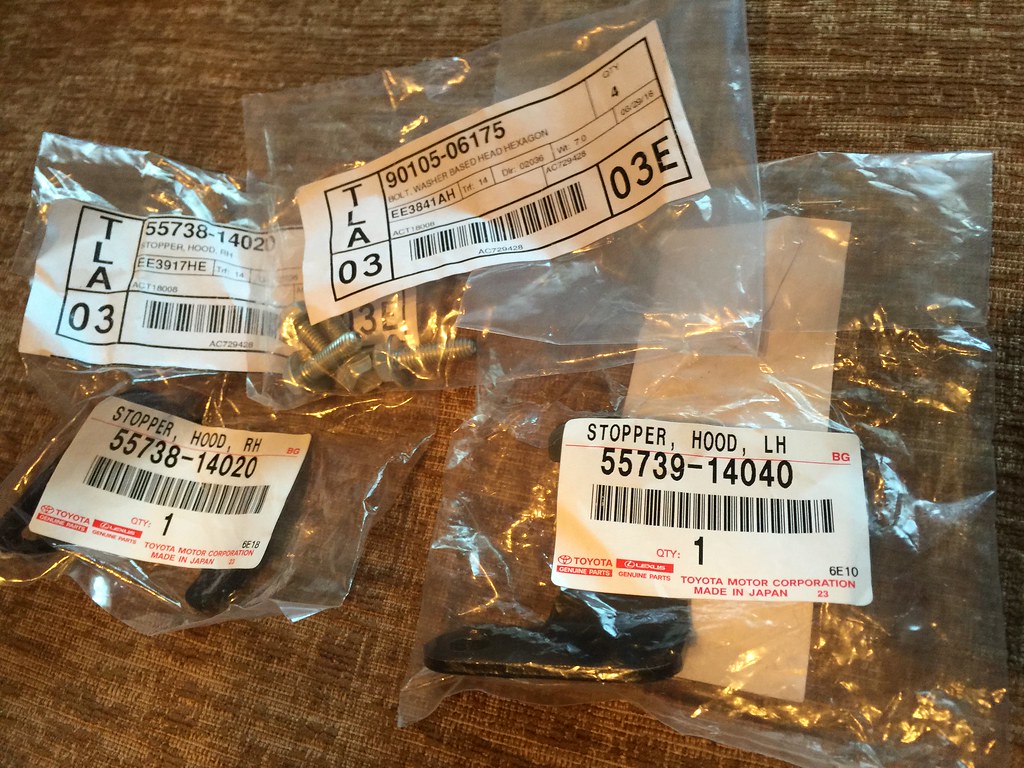

OEM hood prop, clip, and grommet installed.

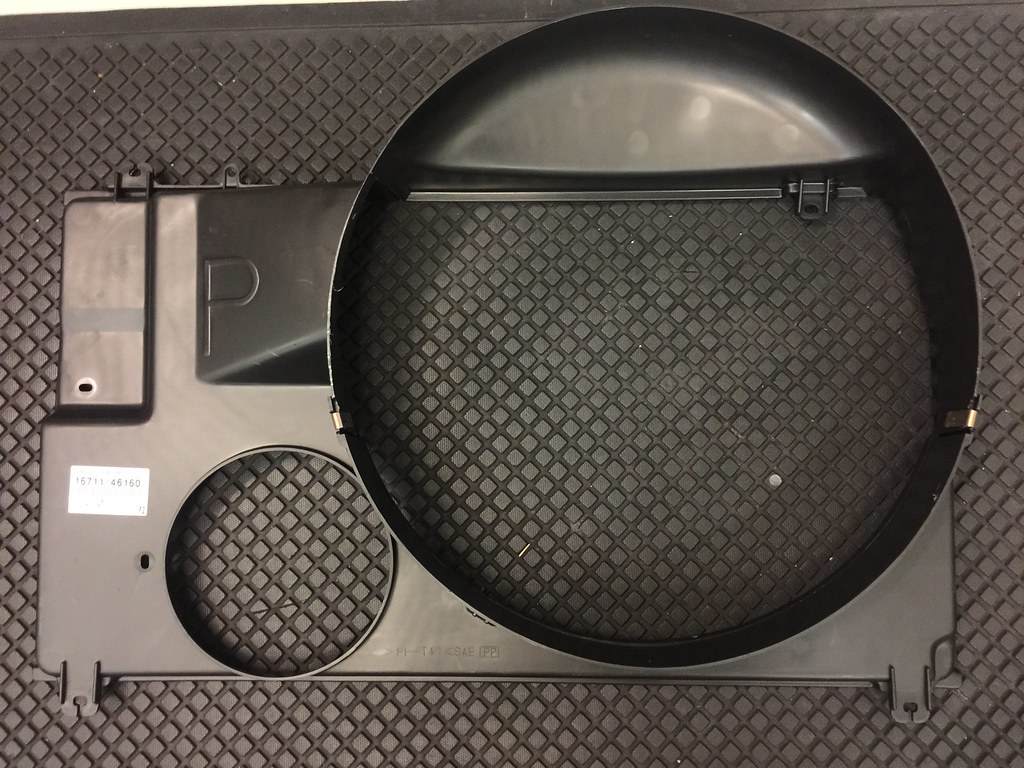

New OEM TT fan shroud. The bolt holes on the Fluidyne radiator don't line up very well for the A/C fan to be mounted properly, so that had to come out. It will go back on at a later date when the A/C is back to operable condition.

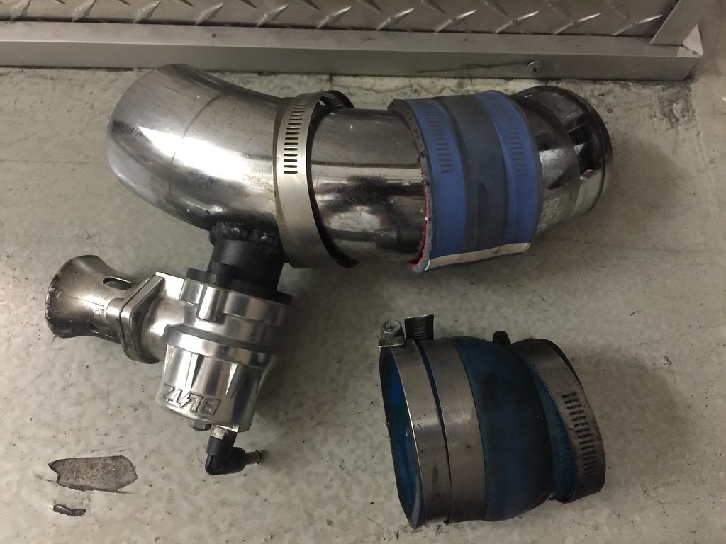

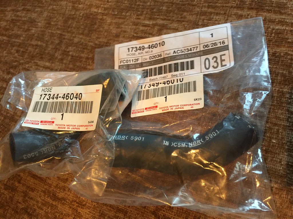

Blitz BOV removed and replaced with factory BOV and factory charge pipe. This thing is just too silly and loud for driving on the street. Popo magnet.

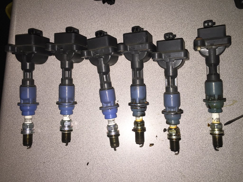

Removed the old plugs and installed a new set of NGK Iridium 2667 BKR7EIX. All misfire issues through the power band are gone. Also tightened down the valve covers also since there was some oil seepage. Here are the old plugs... pretty nasty.

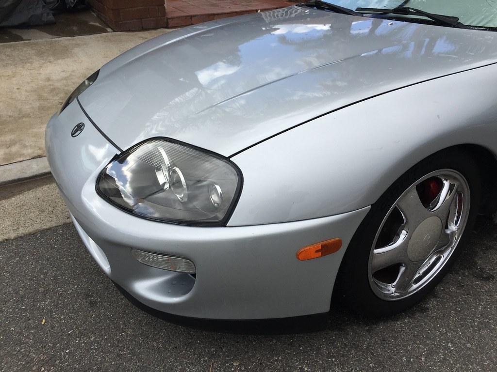

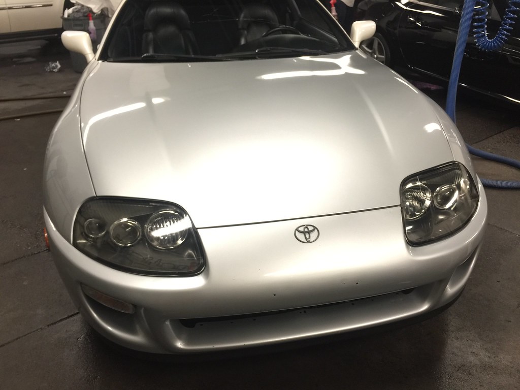

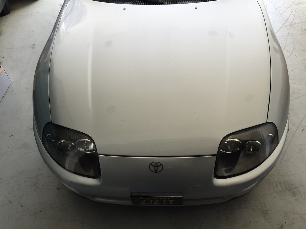

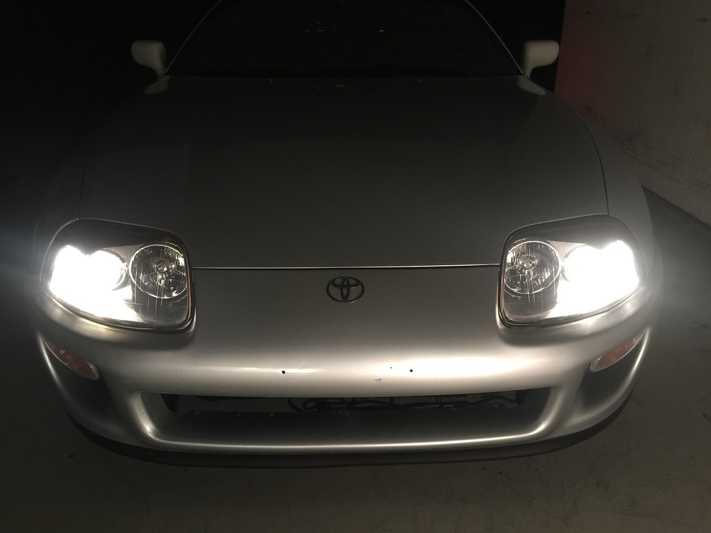

Last time getting the headlights polished out, using Meguiar's compound.
There is now Clear-Bra on the headlights to prevent further oxidation. It is holding up very well, no yellowing at all since this was done (going on 6 months)

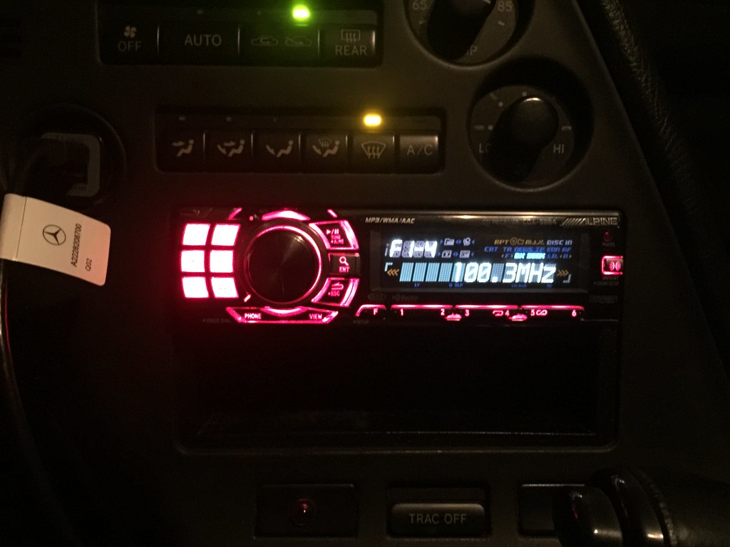

The stock radio was cool at first, but I've gotten over it aleady. The lack of iPod connectivity is inconvenient. The selection of music on the radio sucks most of the time, and I don't like wearing out the buttons changing presets constantly. Not even considering CD's.
Surprise, an Alpine CDA-9884. This is the same model radio in every vehicle I own. It is a great unit and usually cheap. I happened to get this one for an ultra cheap $30 shipped on eBay. It was $20 for a used iPod nano to store my music.

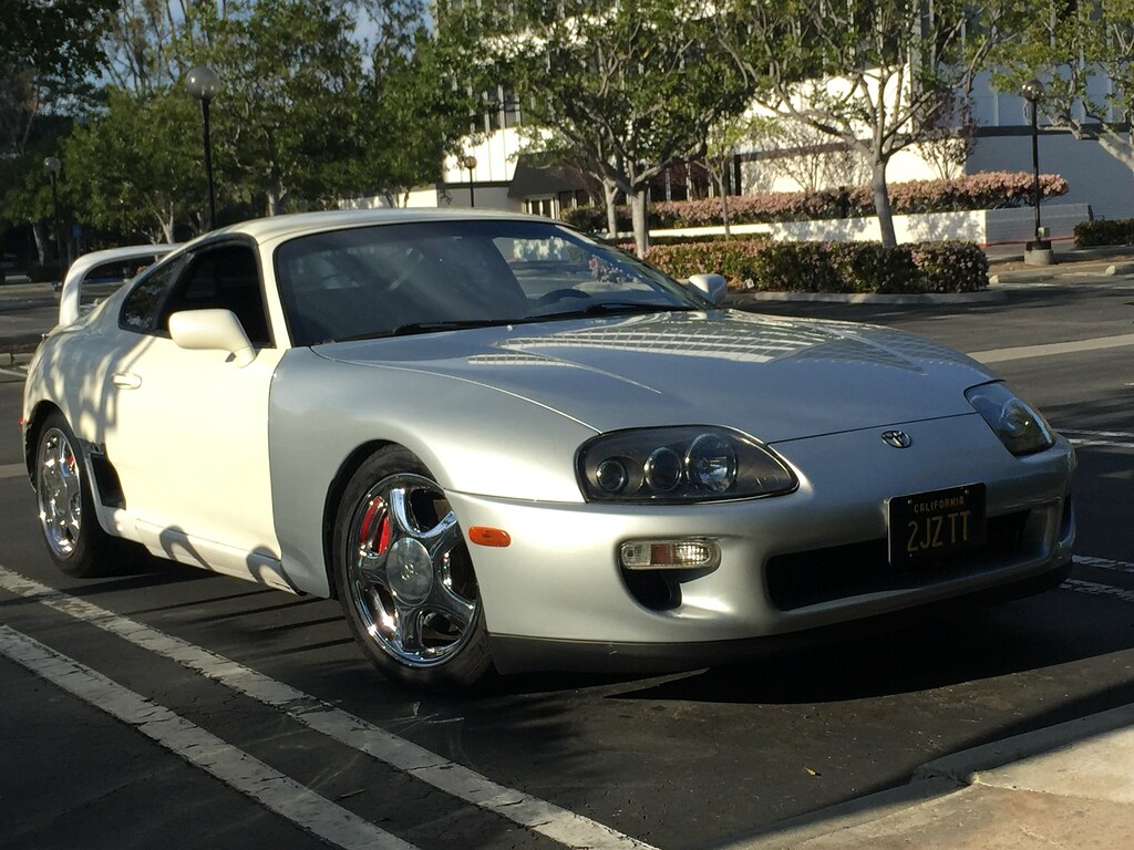

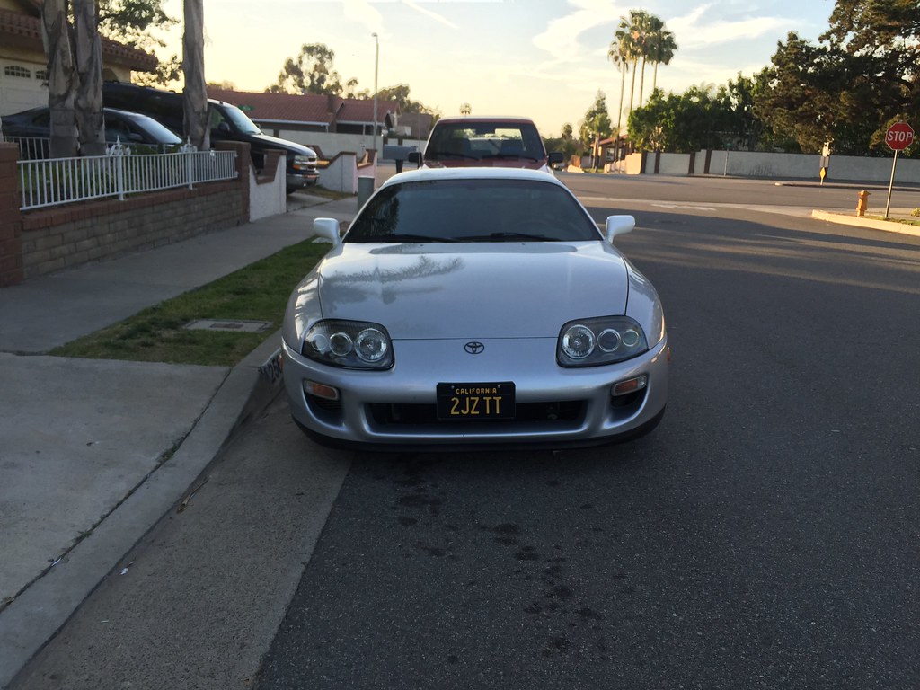

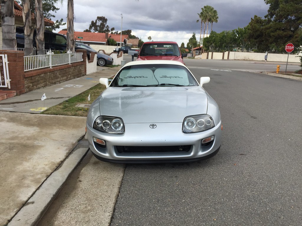

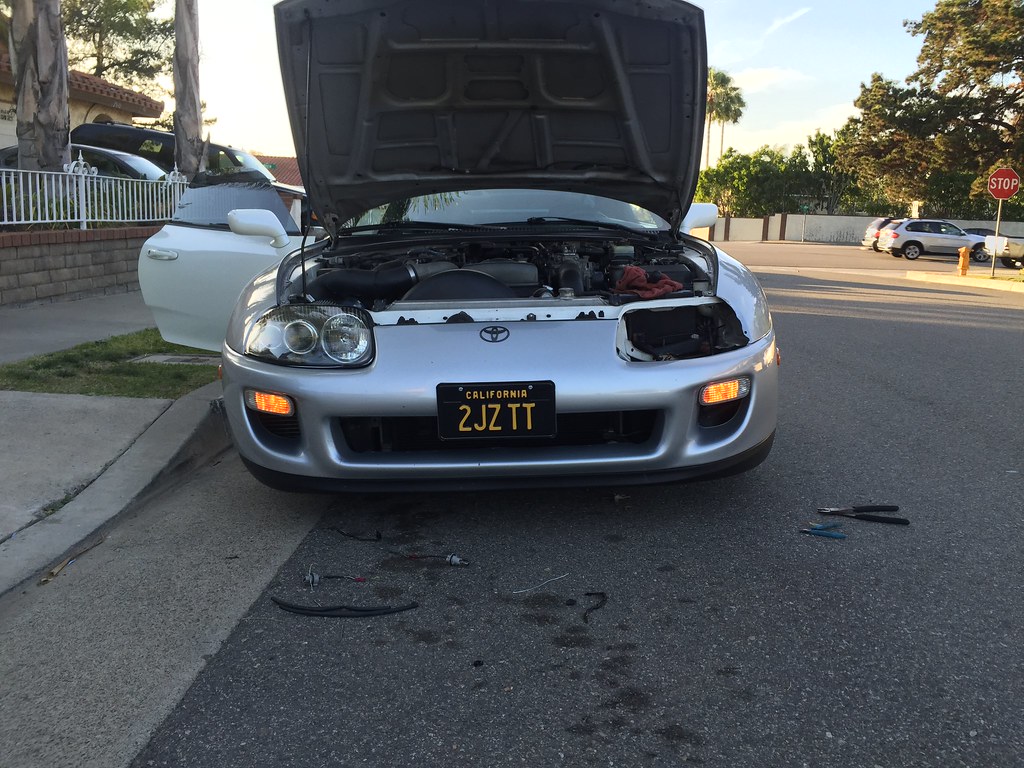

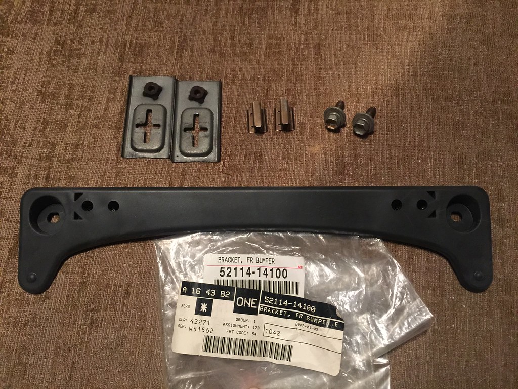

I got pulled over and received a ticket for no front plate. The car didn't come with one, so there was no option other than ordering new plates. As far as the combination goes, 2JZ TT was available. I'm not 100% sure how I feel about that now that it's on the car (it's pretty obvious, I could get a captain obvious plate frame). The black 1960's legacy plate idea is cool, but I'm second guessing if it's a good fit. This car is pretty ugly anyway, the chrome wheels don't help.

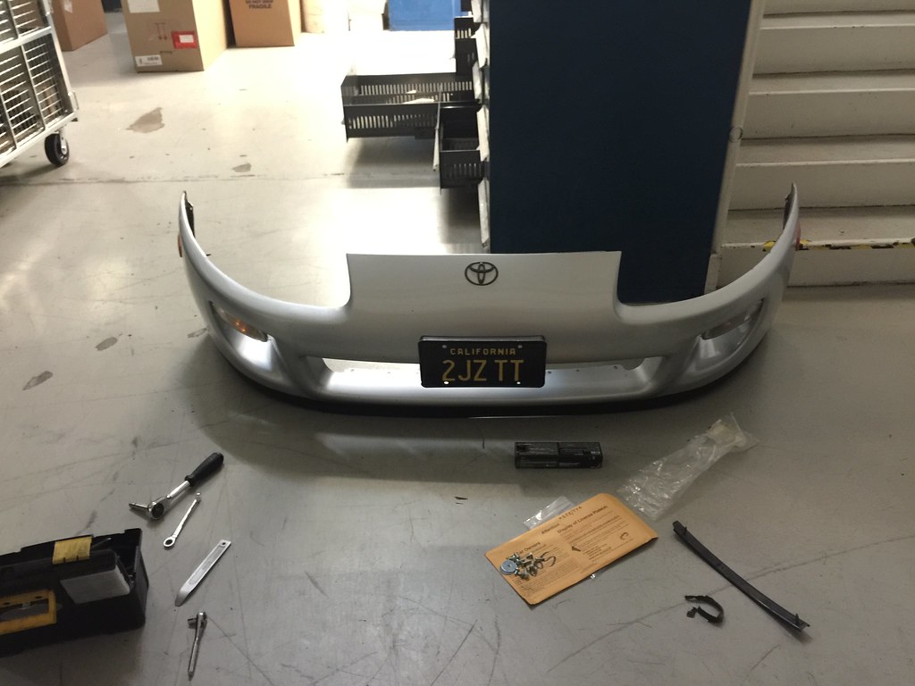

New plate bracket, complete with hardware...
Had to remove the whole front bumper to put this on.

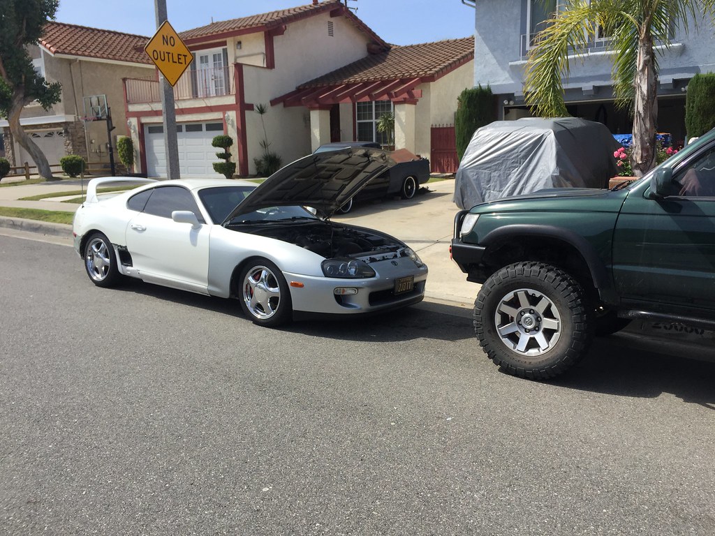

The opposite of the first day I owned this car, now it's jump starting the green 99 4Runner. The 99's battery had a cell go bad.

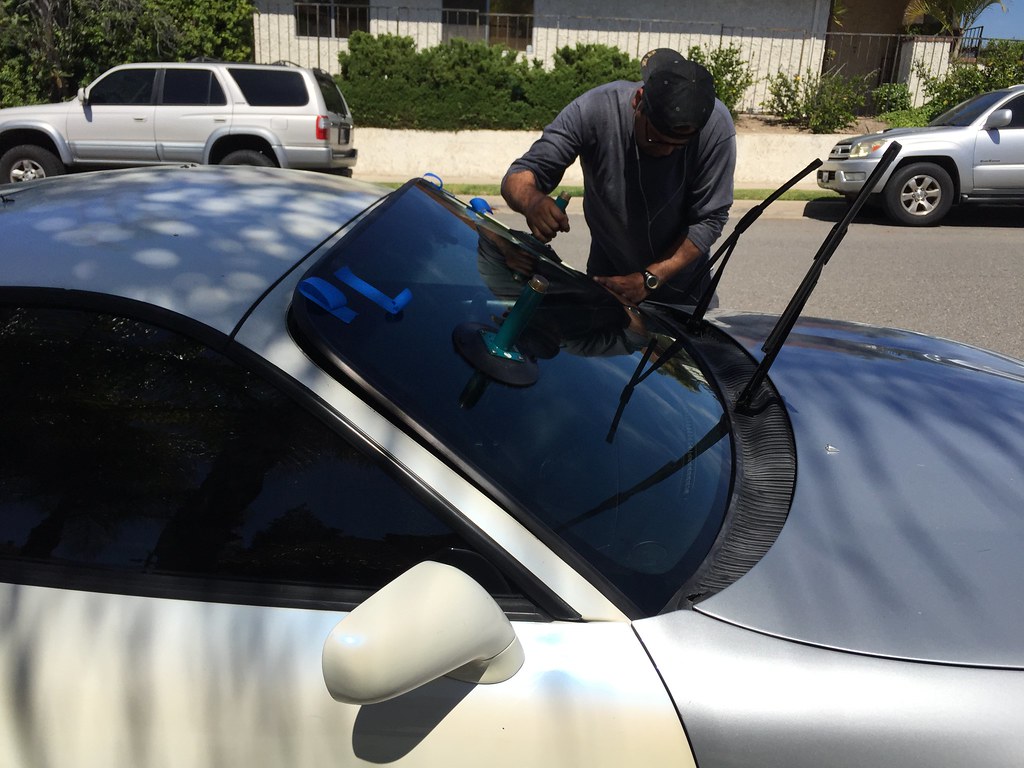

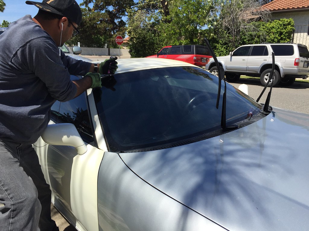

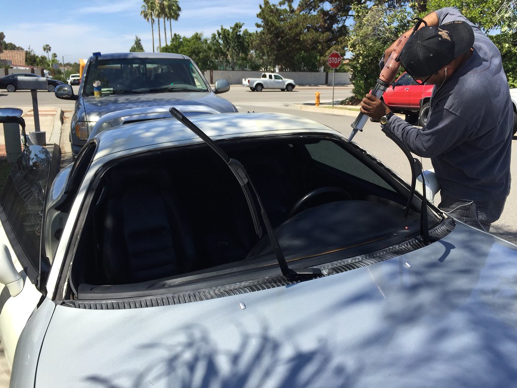

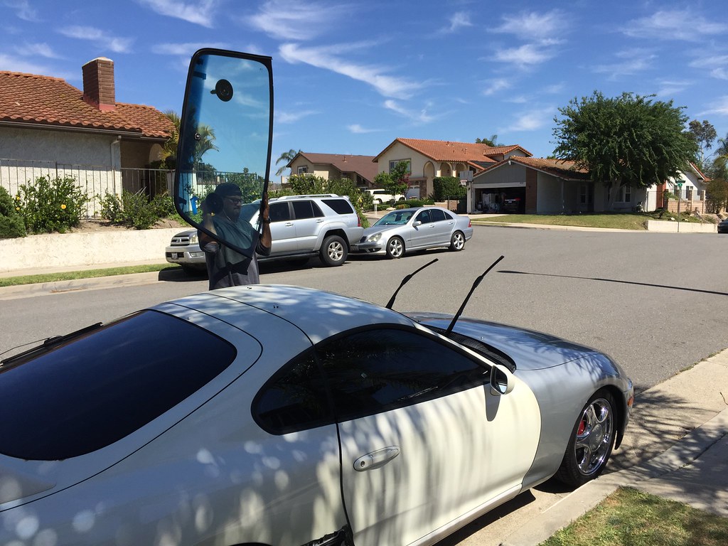

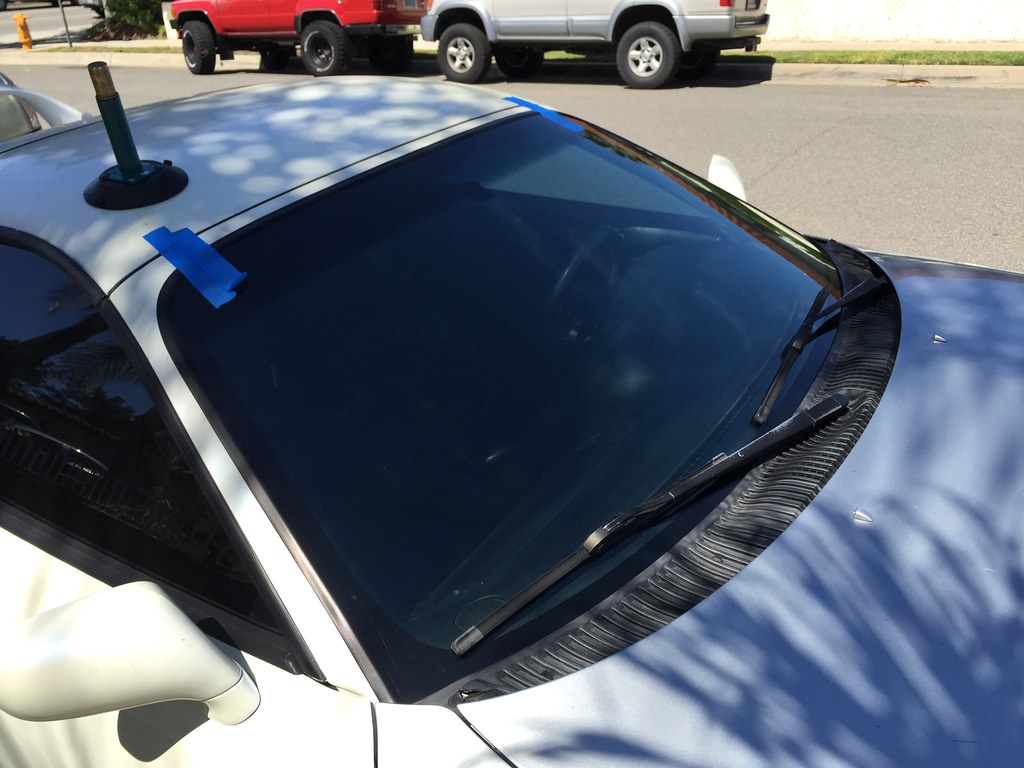

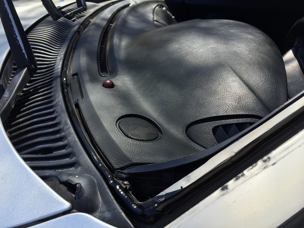

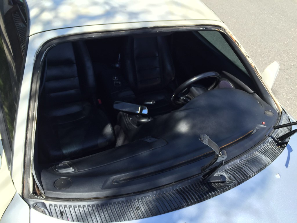

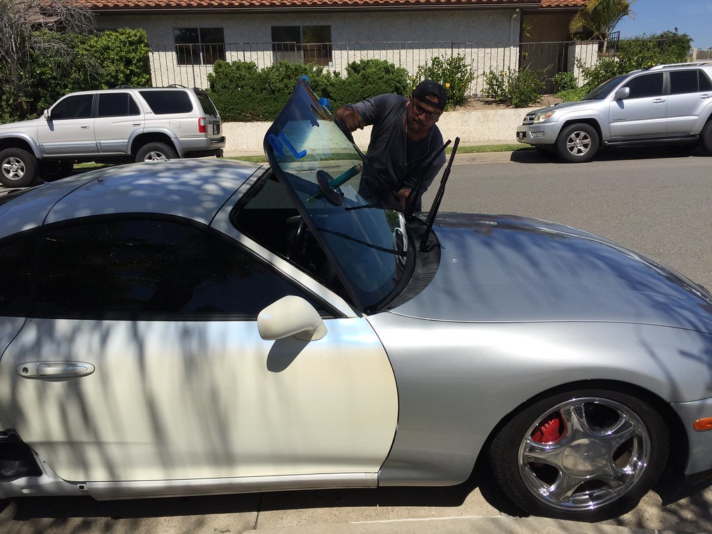

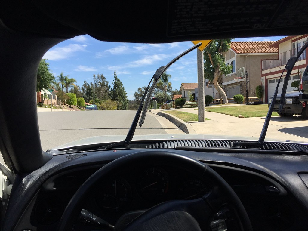

Time for a new windshield. The old one was cracked in a lot of places. The rear view mirror was broken off the windshield badly enough to rip a whole chunk of glass out, with cracks up and down the whole left side.

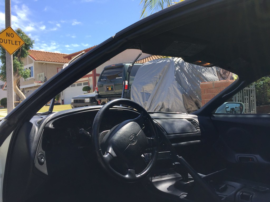

The dash has been in the sun most of its life, I use a windshield cover every day and I haven't seen anything get worse in the last year I've owned it. It's not all that bad, I could probably color in the foam showing on the edge of the defroster vents.

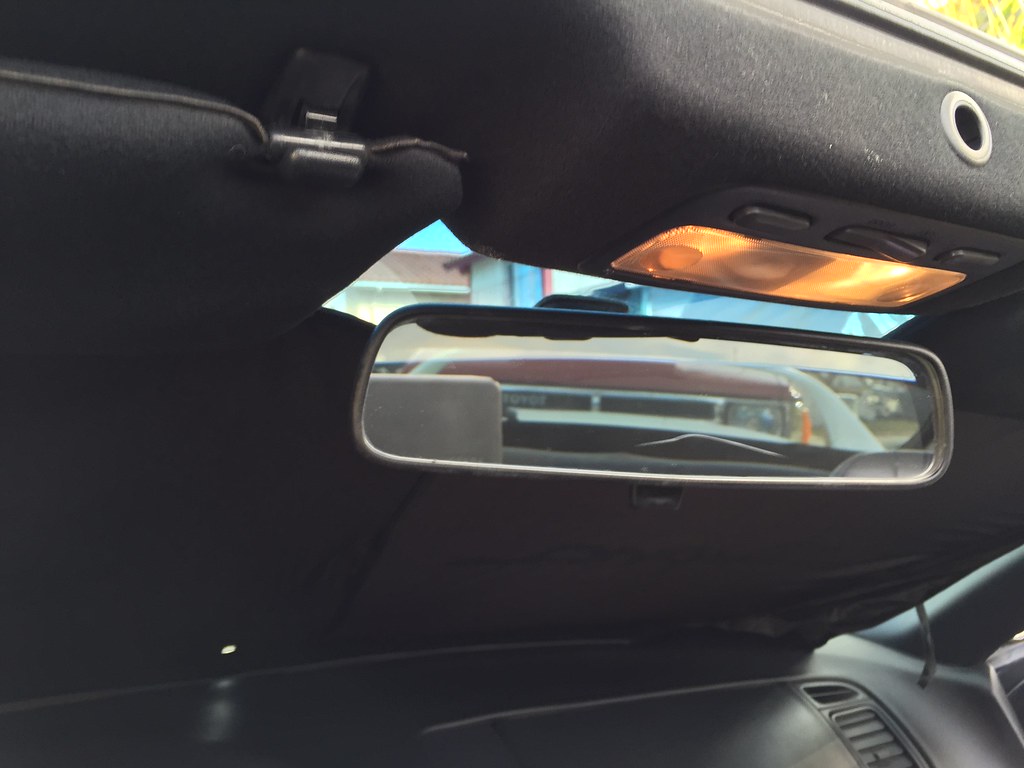

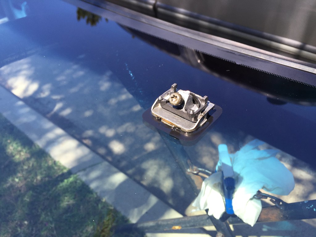

Rear view mirror mount. It took me a while to chip the old glass and glue off. I never liked mirrors that glued to the windshield...
Window adhesive
Some cowl damage. That needs to come off, along with those wiper arms, for a bath in SEM trim black. Brand new Rain X Latitude wiper blades have been installed front and rear.
When you install windshields for a living!
The mirror has a big scratch across it, which sucks, but I can easily replace it whenever I find another one. Probably gonna get a new one from the dealer, along with the small black trim along the base. One torx screw is all it takes to remove.

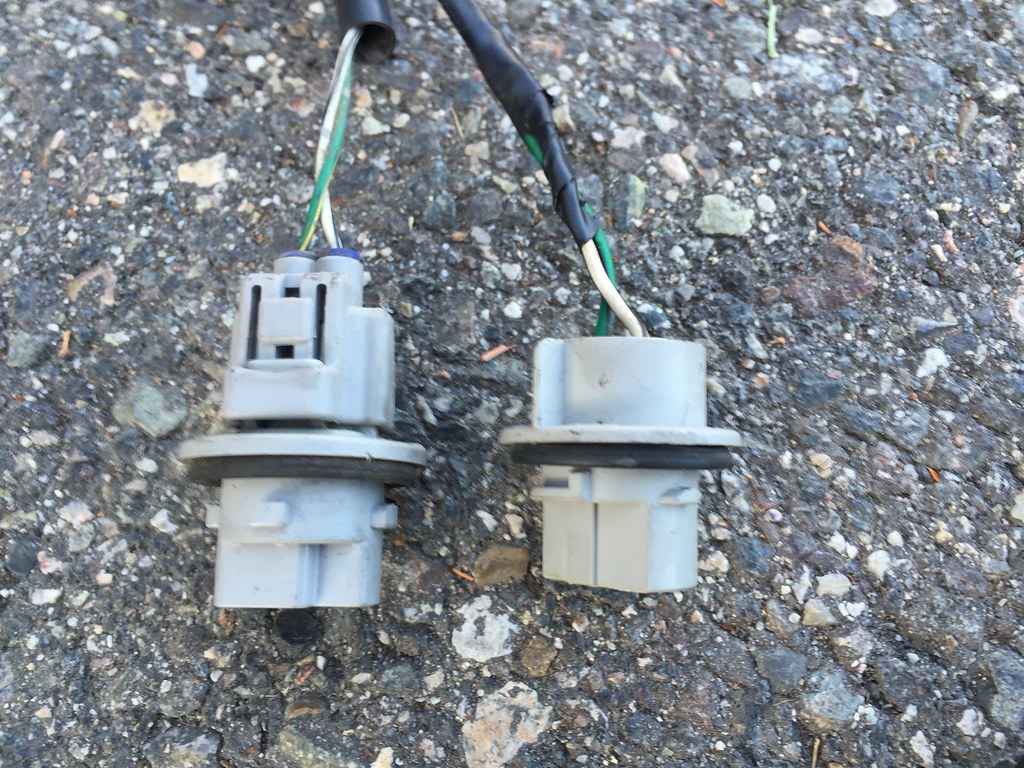

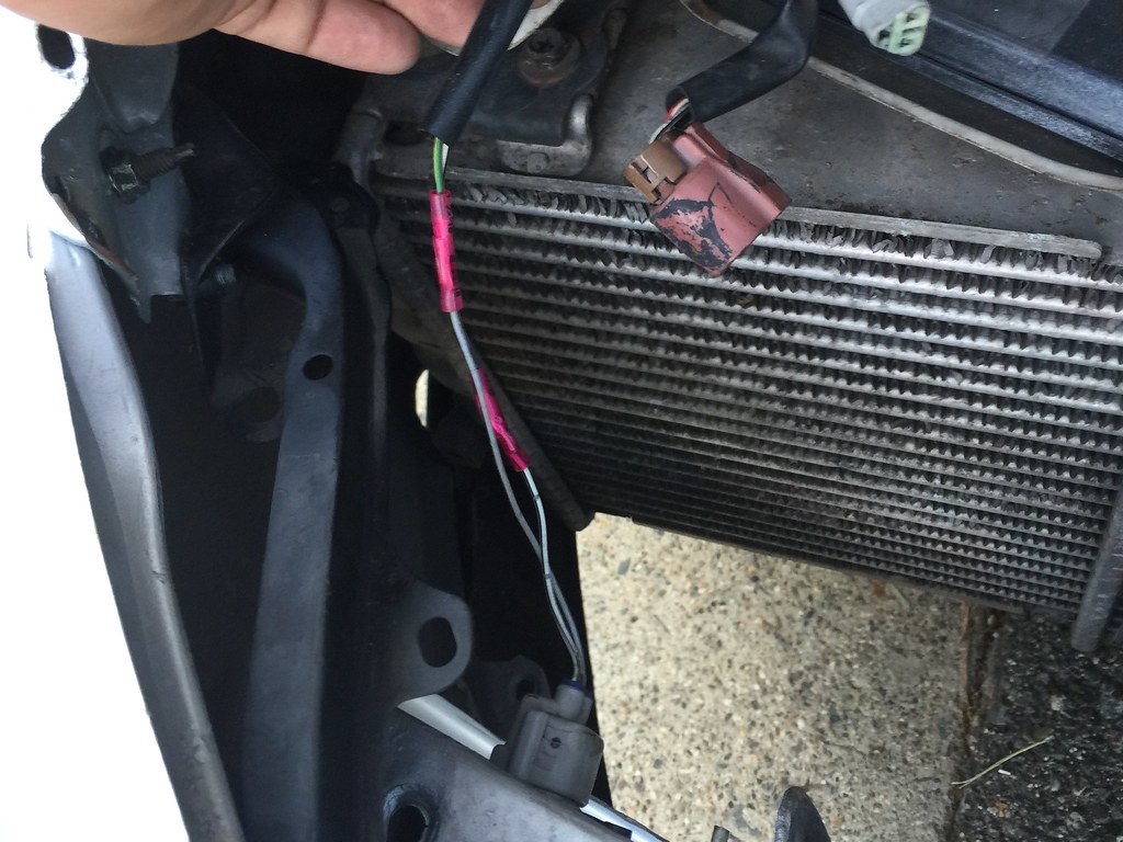

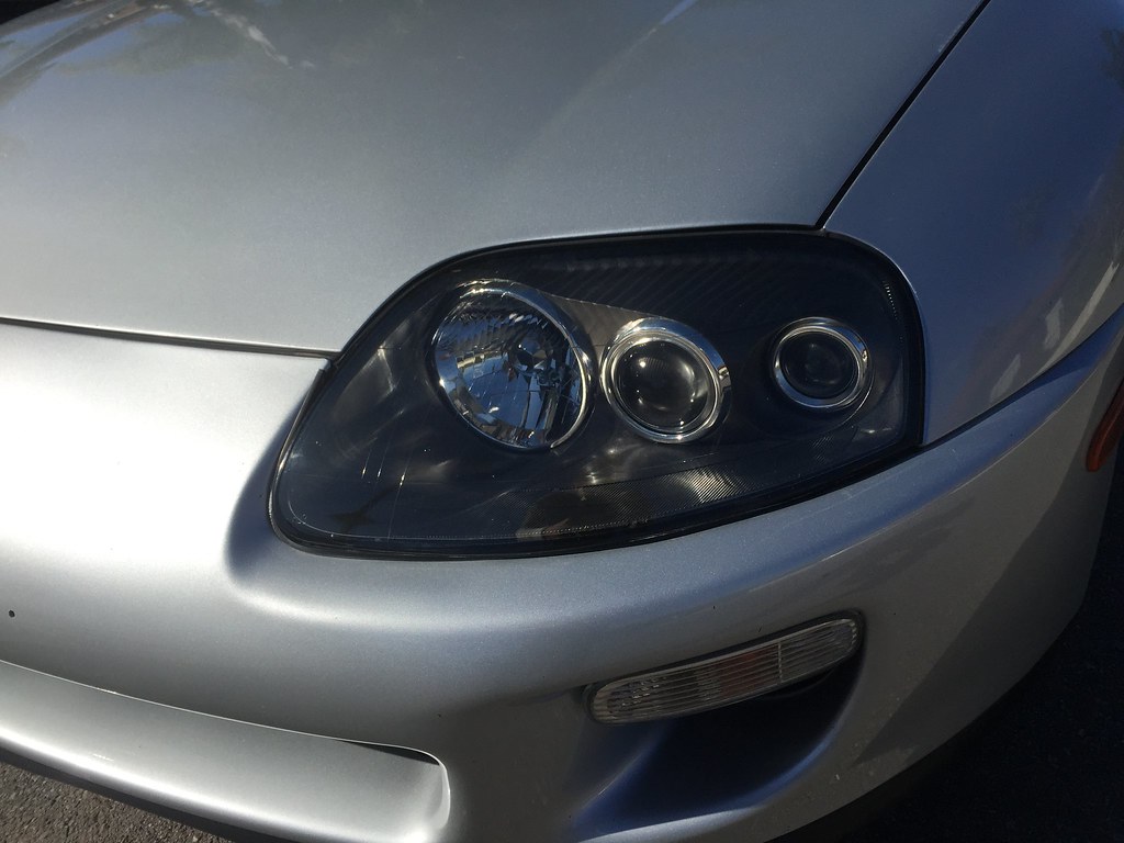

One thing that was really annoying was the front end light set up... whoever did this whole light swap thing did a terrible job finding the right sockets to use. The left side front signal was a small socket bulb that fit 194 and 921 bulbs.
921 bulb managed to keep the flasher from blinking fast, but a 194 was too small and would trigger fast blink. The bulb socket did not fit in the housing of the signal at all, unless jammed.
The right side front signal used a proper size socket that actually did fit into the signal housing. That side had a 7440 bulb, much larger than a 194 or 921.
Correct size shown on the left, incorrect shown on the right.

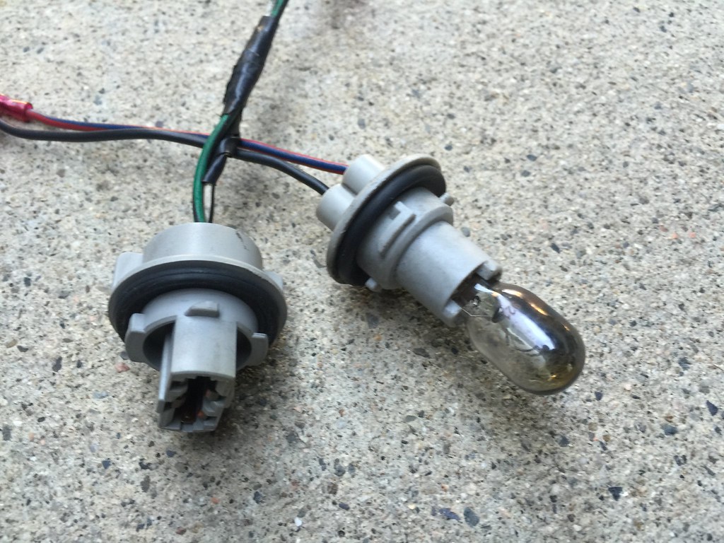

Well, I've got a parts 4Runner sitting around with perfectly good front signal sockets. They happen to use 7440s, just like the Supra. A quick test and they fit great into the Supra housings. They also use a plug on the back of the socket for easy removal. BONUS, since I had no plug at all! So both sides of the Supra now have 4Runner signal sockets/pigtails.
Next, the front markers need sockets. Maybe the 4Runner can donate some sockets there, too.
4Runner style on left, Removed from Supra on right.
A few minutes and a few connectors. The headlights pop out really easy and give you full access to the back of the signal housings. Much easier to crimp wires in that space than squeezing in below the light. The new turn signal wires are just the right length to reach the signal comfortably, not absurdly long like whatever genius wired in the wrong socket.

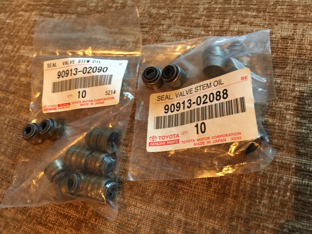

The manual swap was going to be next, but of course the valve stem seals were becoming an issue. The swap will have to wait, because a manual transmission will do no good without a properly running motor.

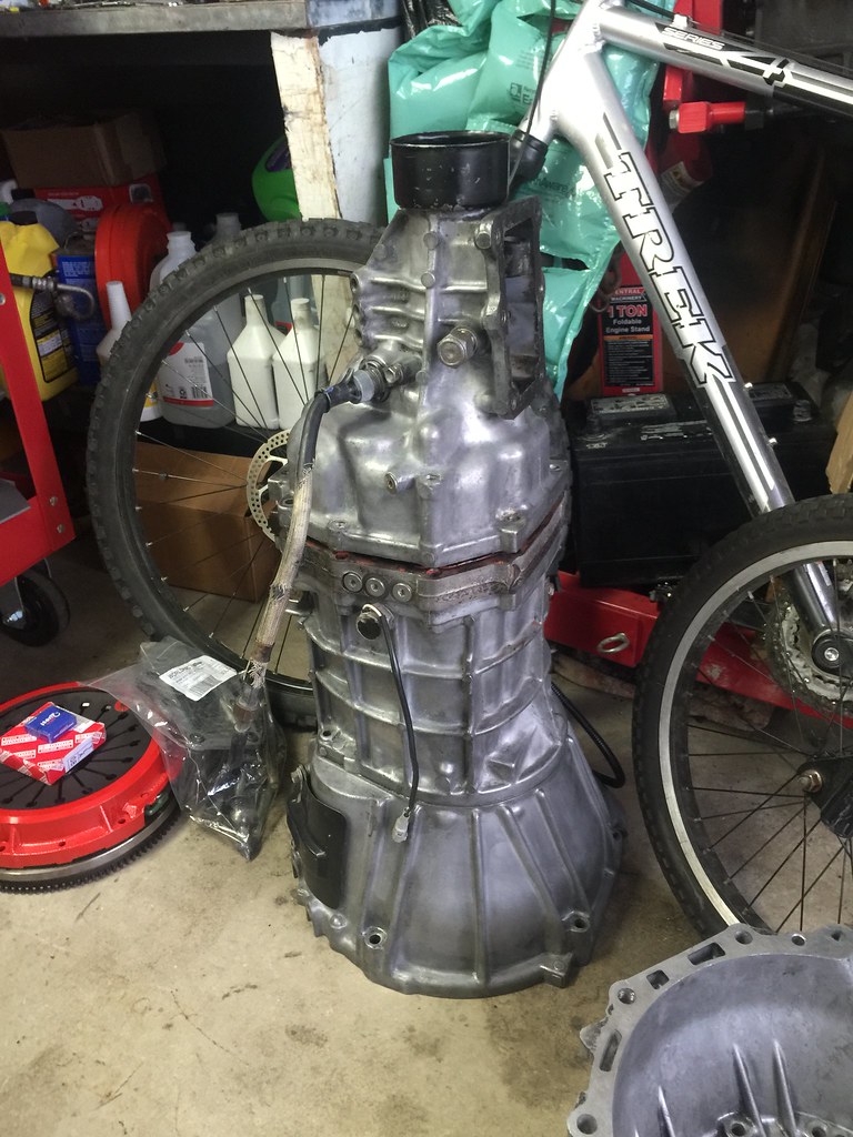

A craigslist ad came up under a search for "R154" that wasn't for some JDM parts dealer. It was some SC300 owner who wrecked his car before he could swap out the automatic. He had an R154 and some brand new swap parts. He paid full price for the parts which were mostly all new and in the box. $2,200 is what he wanted. He was going to throw in a new retainer gasket and grommet, because he's a nice guy.
I get there to see the transmission and he's got it standing up face down on the bell housing. We make a deal at $2,100 and he loads the transmission into my truck the same way, face down on the bell housing. I thought this was odd and decided to tip the transmission over a bit. I take a look and the input shaft tip is entirely broken off. The price suddenly went down to $1,640. Hombre from Santa Ana with a job in Irvine became a jerk because I didn't want to pay full price for his broken transmission.
He texted me a few days later saying he got the retainer gasket and grommet, then returned them. His reason: "it seemed like you didn't want them anymore." **** that guy. Just happens to be I've got the original retainer gasket from the R154 that went into the MK3.
R154 transmission with broken input shaft

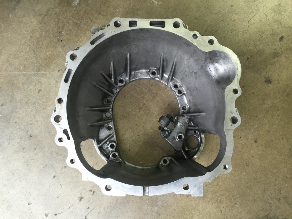

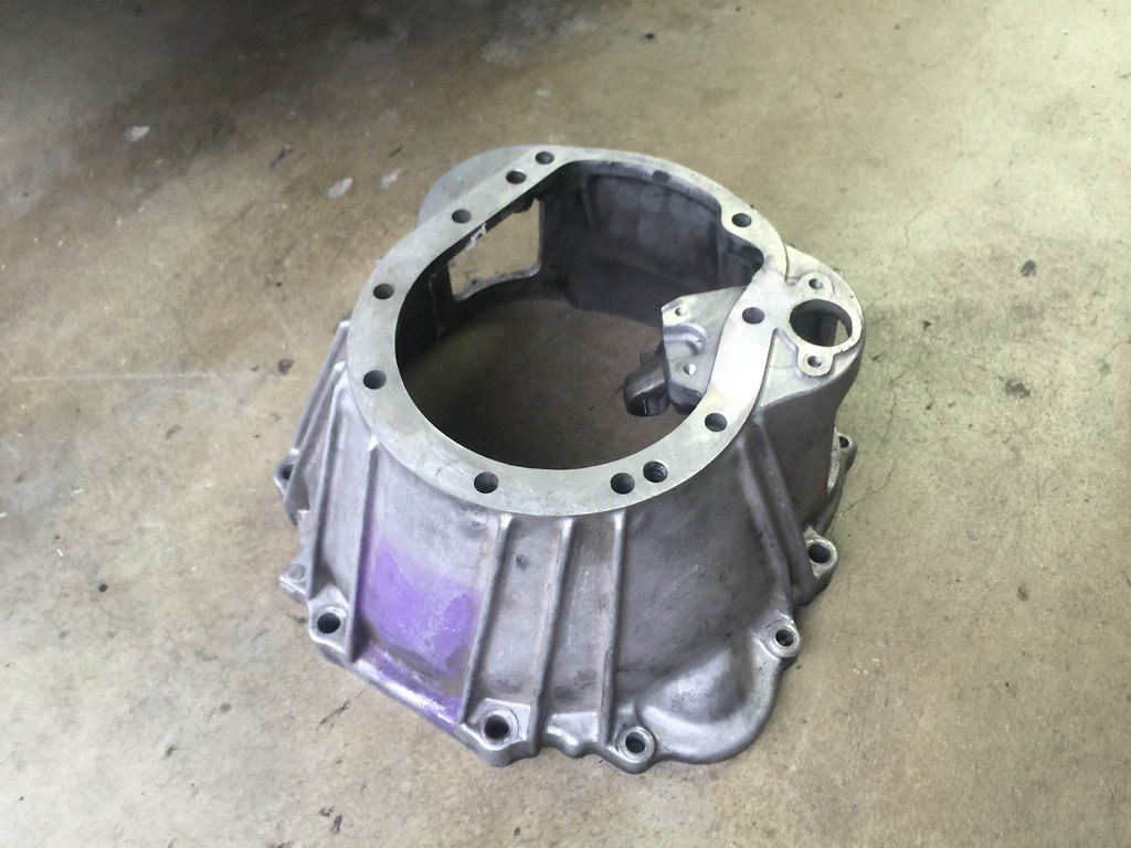

1JZ Bell housing
1JZ flywheel
R154 clutch kit, new in box, good for 500whp+
Driveshaft
R154 shifter extension for MK4 Supra
R154 transmission:

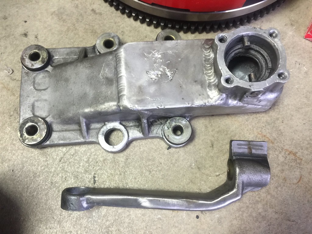

Shifter extension housing for MKIV supra.
1JZ-GTE bell housing to mate the 2JZ to R154

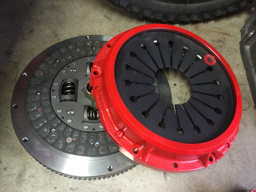

Driftmotion's Stage 2 clutch kit + 1JZ-GTE OEM flywheel. Might go lightweight on the flywheel instead. All brand new parts.

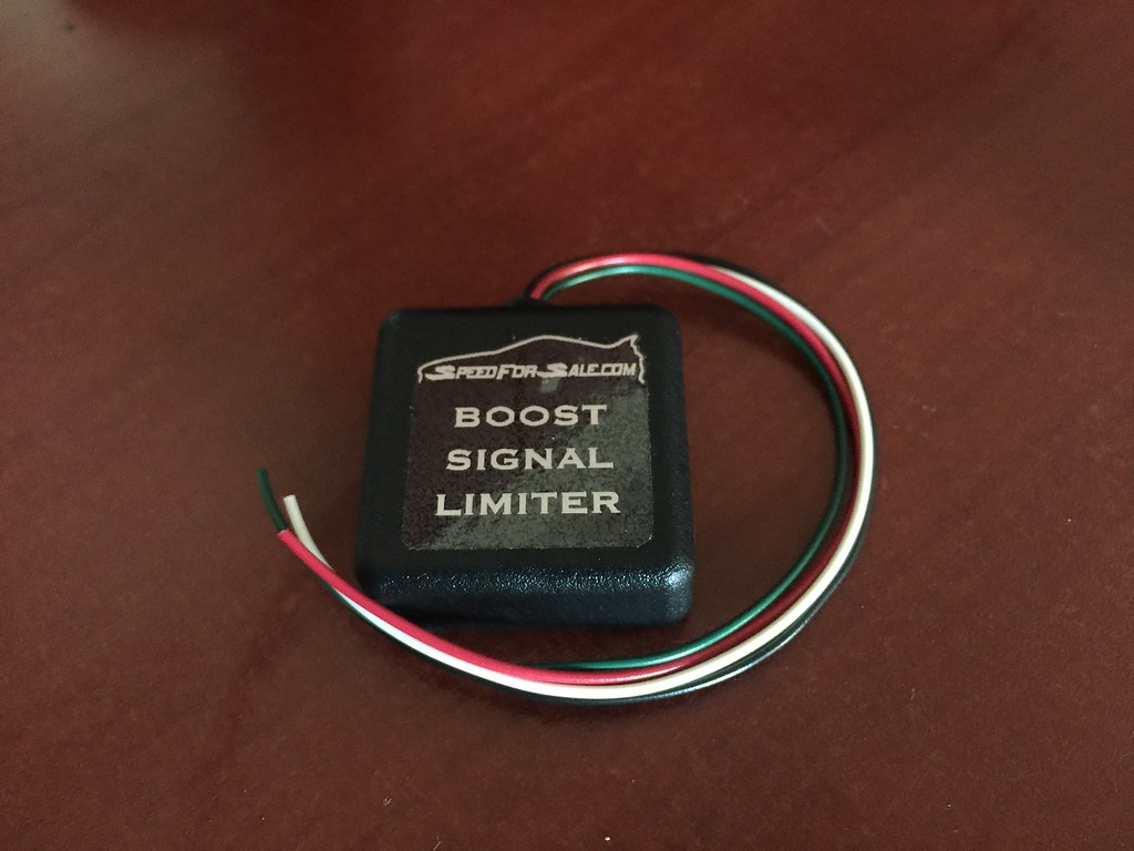

SpeedForSale Boost Cut Controller Device for MKIV Supra

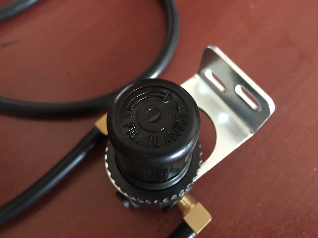

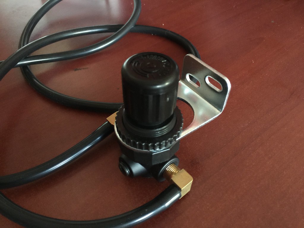

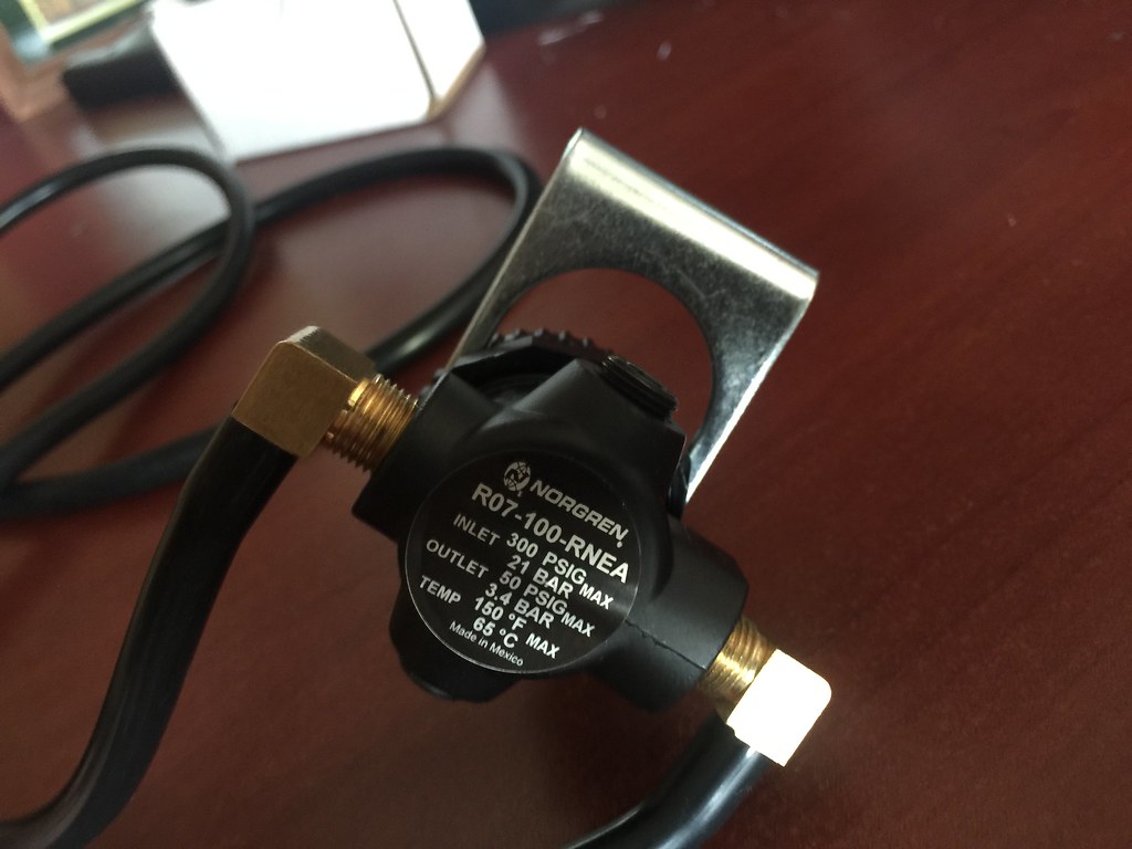

Norgren R07-100-RNEA 1-50PSI Pressure regulator (Manual boost controller, same as the Turbonetics kits)

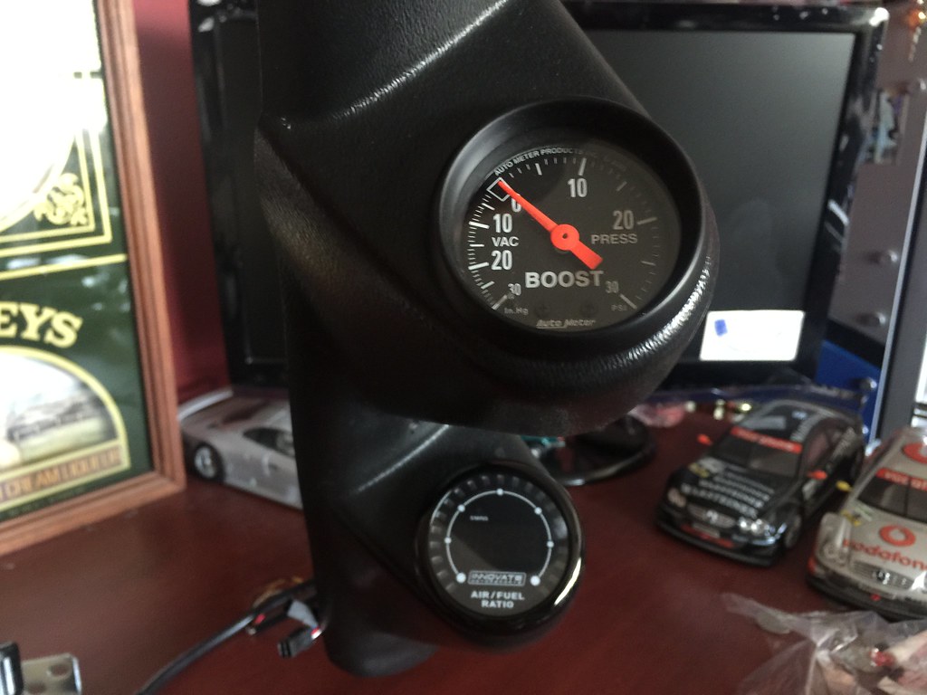

Autometer 2614 Mechanical boost gauge
Innovate MTX-L Wideband
Lotek Double Gauge Pod holder for A-pillar - satin black
Not very happy with the pod holder pictured so I ordered a new one.

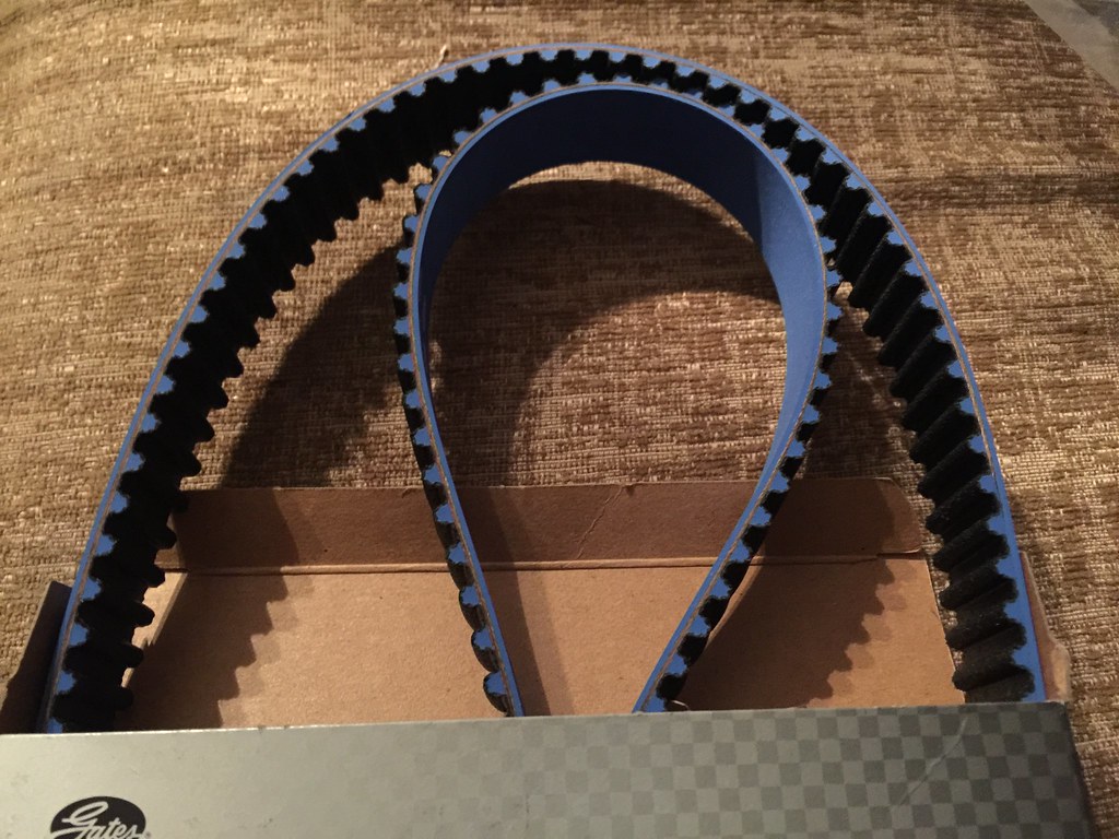

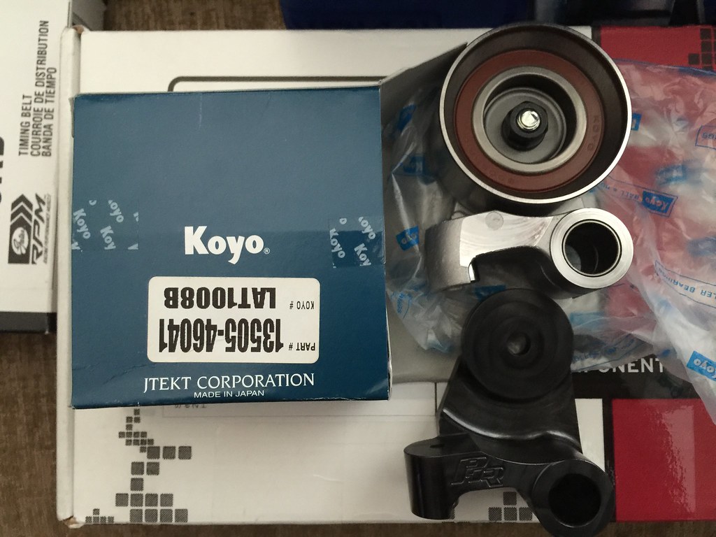

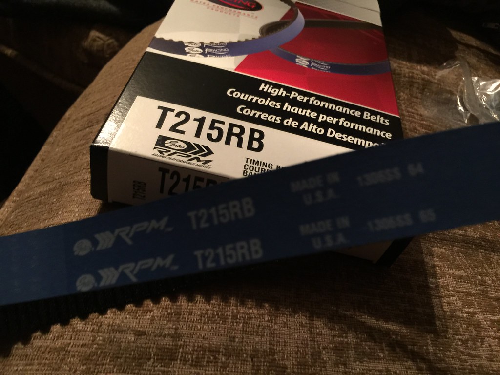

Gates Racing timing belt T215RB

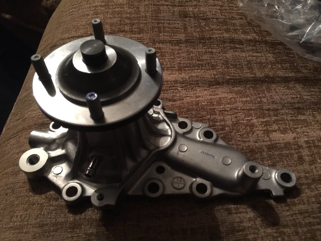

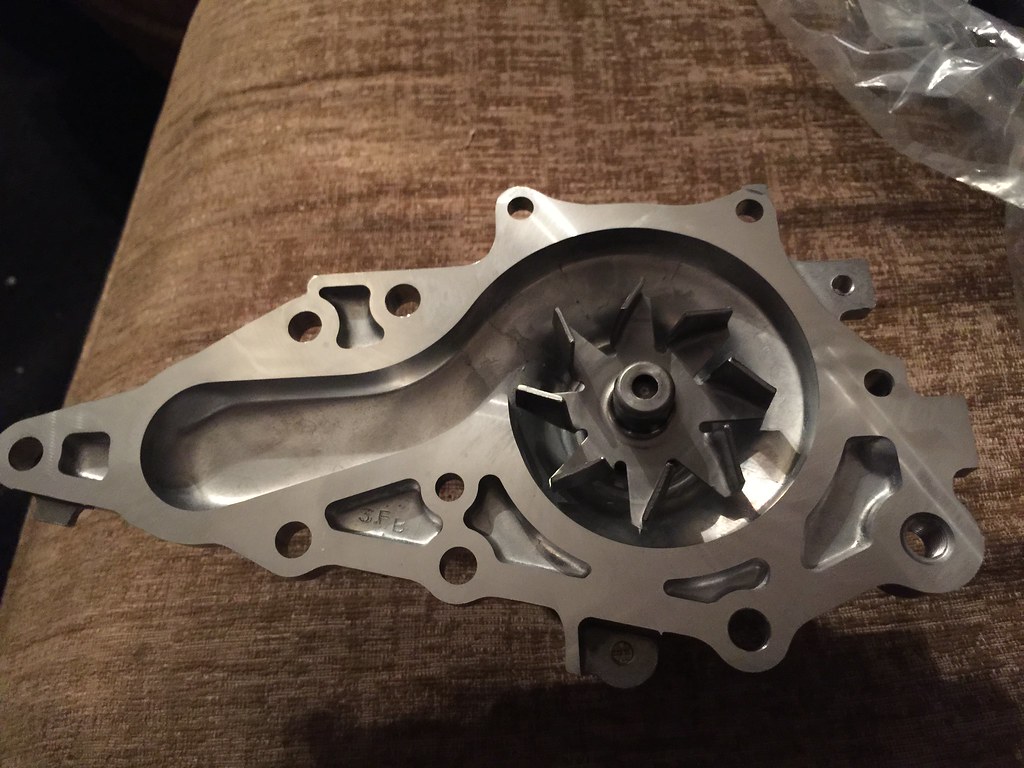

AISIN water pump WPT038

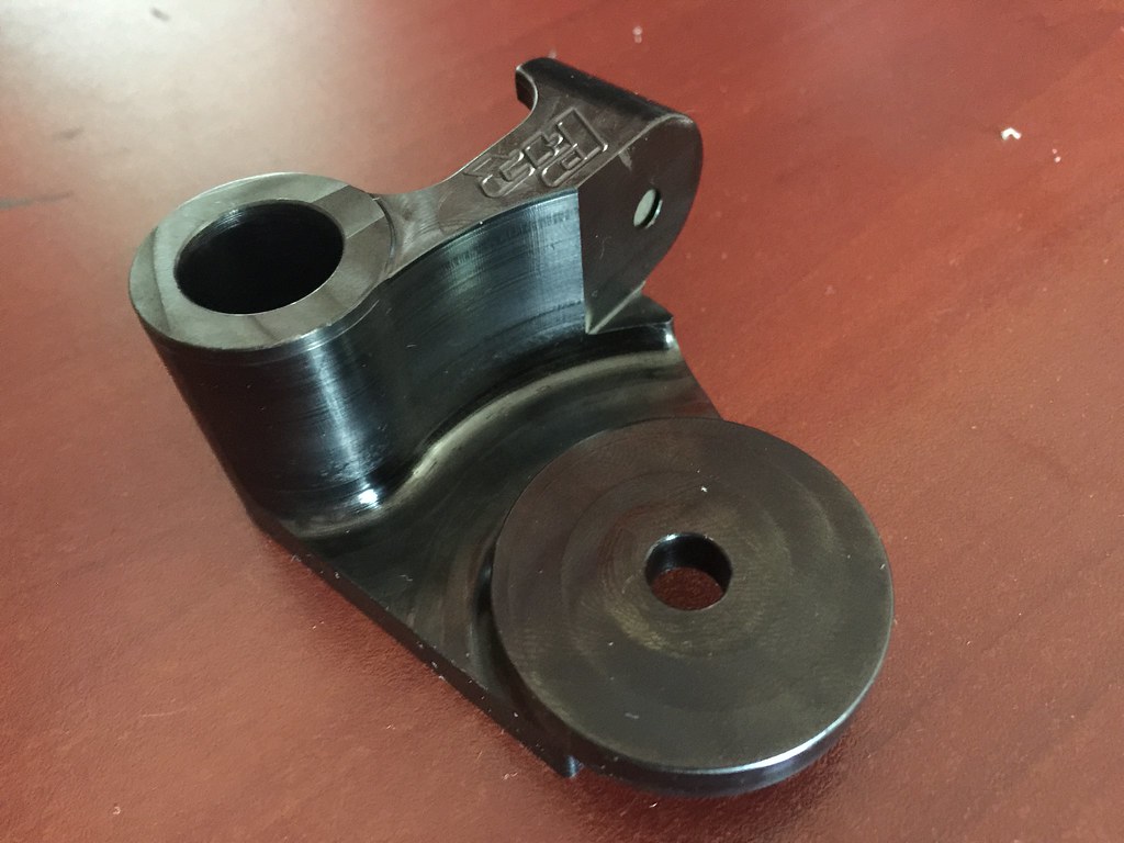

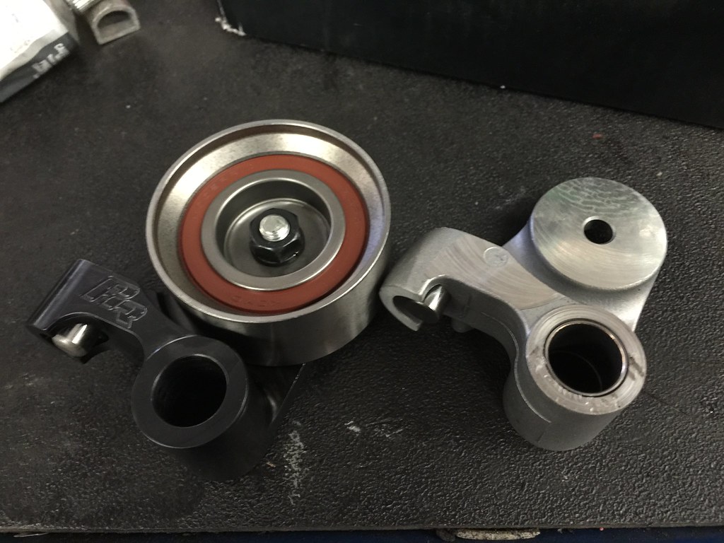

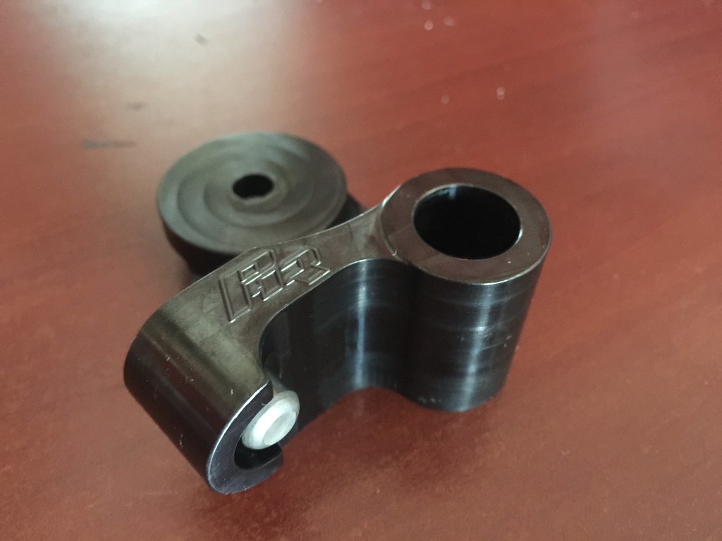

PowerHouse Racing billet timing belt idler pulley bracket. This is necessary due to the new GSC S1 camshafts having high enough lift to make the 2JZ-GTE an interference engine. This eliminates the weak link in the timing belt setup - the cheap cast aluminum idler pulley bracket.

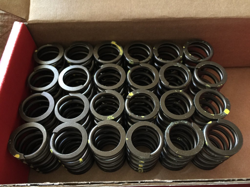

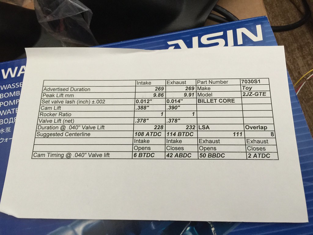

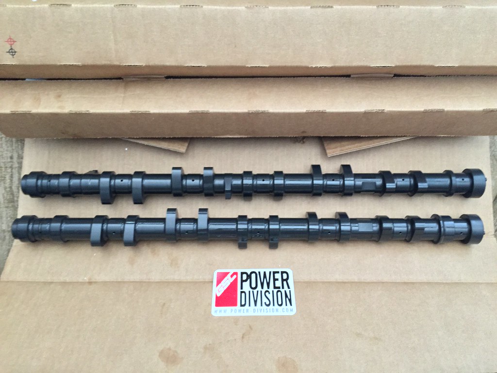

GSC S1 7030S1 camshafts

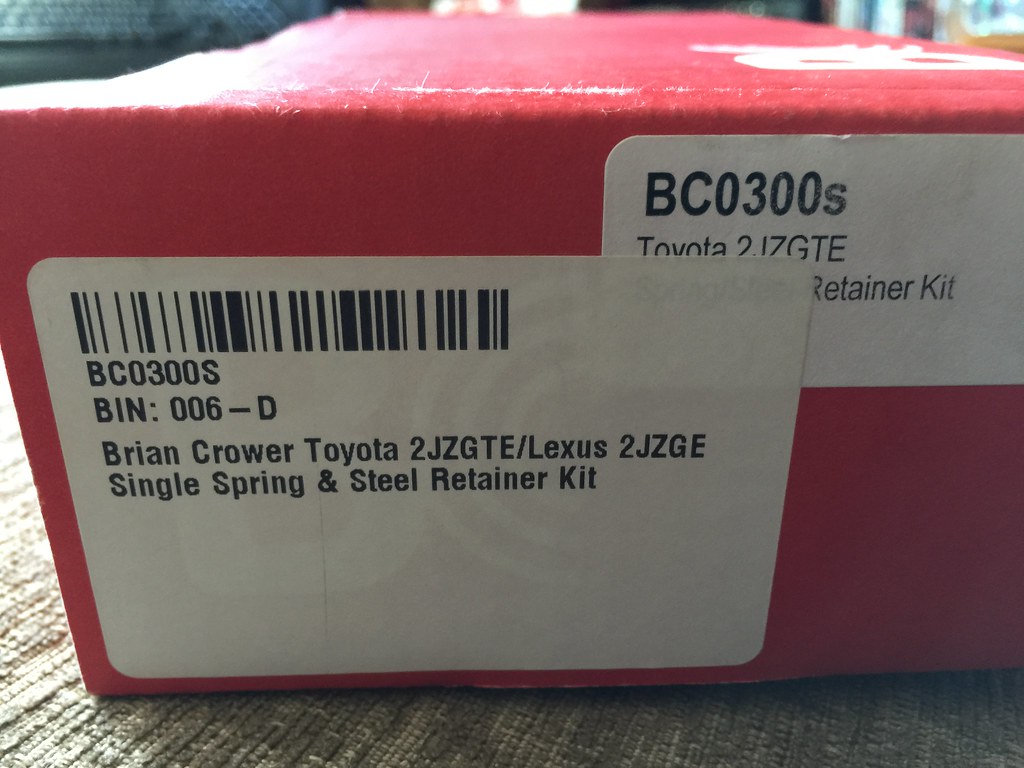

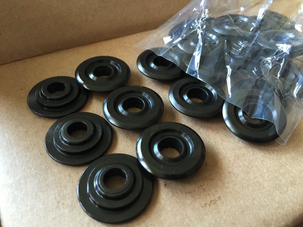

Brian Crower BC0300S Valve Spring and chromoly steel retainer kit

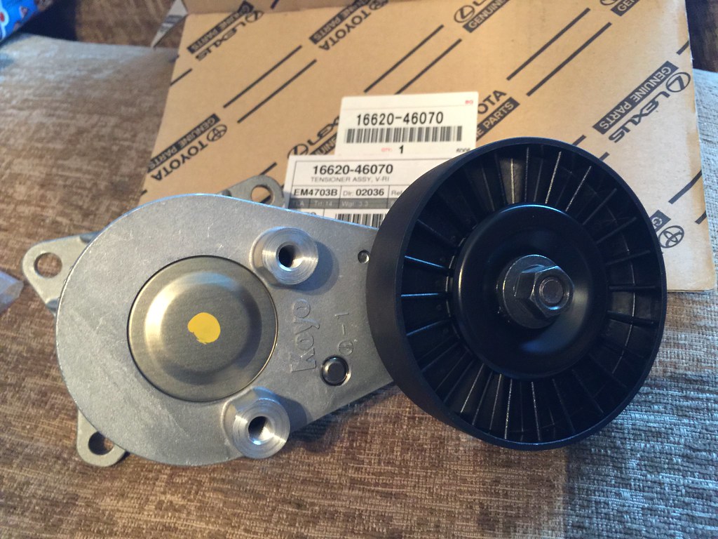

16620-46070 Serpentine Belt Tensioner for 2JZ-GTE w/ manual trans

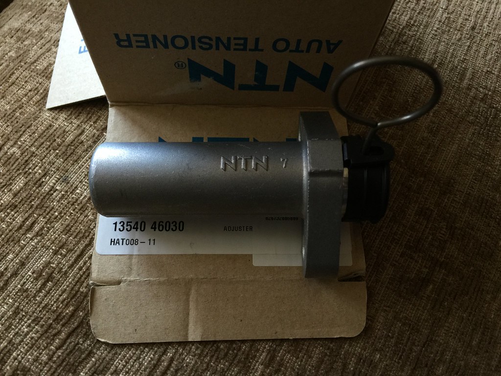

13540-46030 NTN Timing Belt Tensioner for 2JZ-GTE
13505-46041 KOYO Idler Pulley
90913-02088 Valve Stem Seal, Exhaust x12
90913-02090 Valve Stem Seal, Intake x12

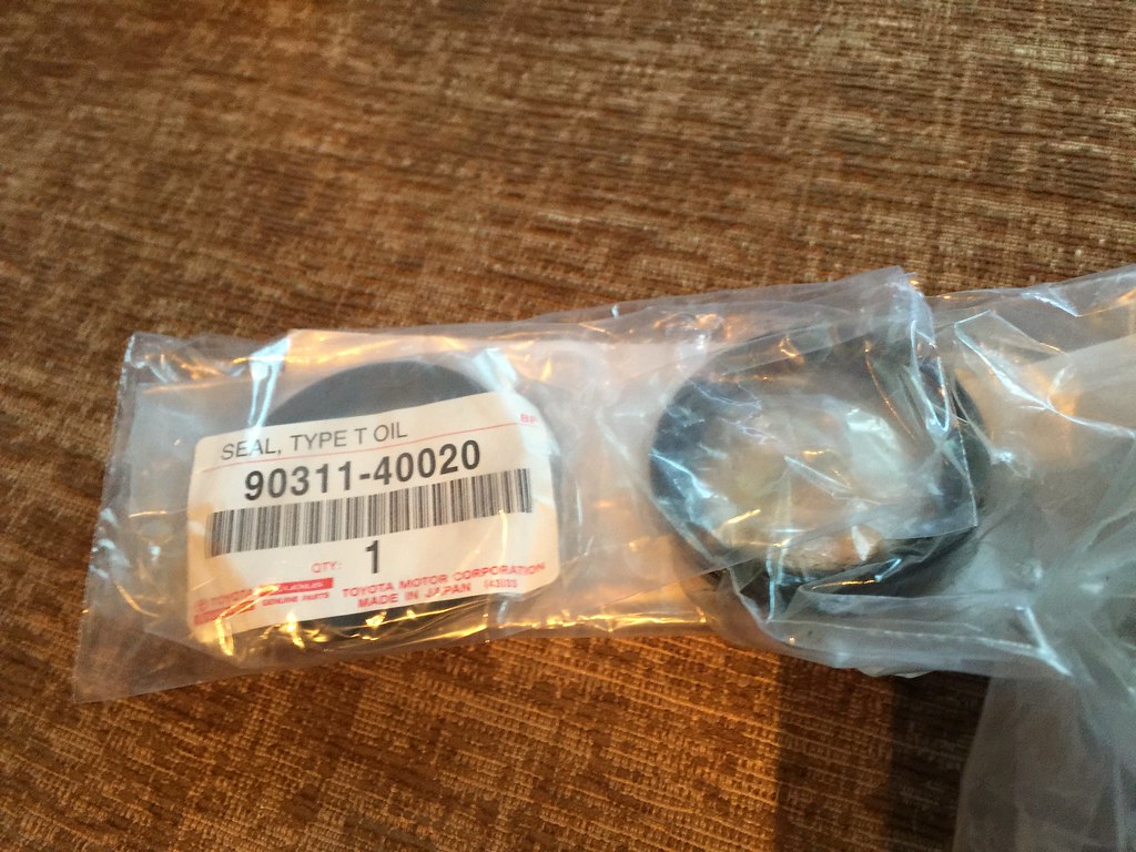

90311-40020 Camshaft Seals x2

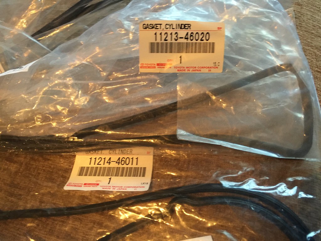

11213-46020 Valve Cover Gasket RH
11214-46011 Valve Cover Gasket LH

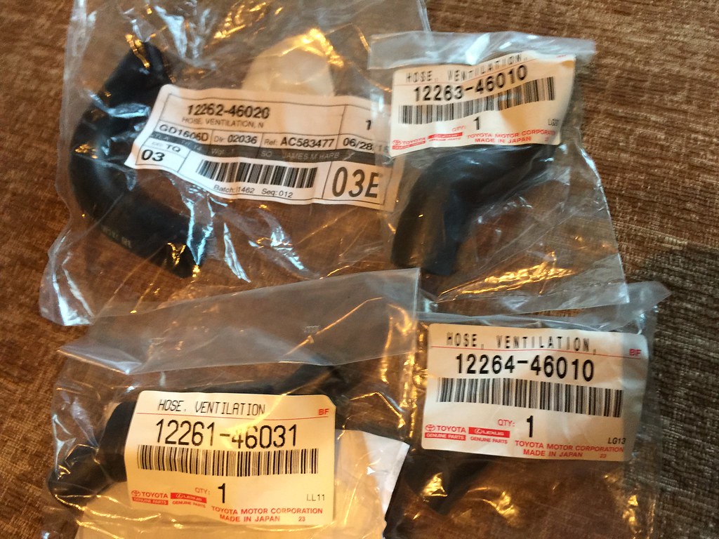

12263-46010 Center PCV Hose
12264-46010 Center PCV Hose
12262-46020 PCV Hose, RH
12261-46031 PCV Hose, LH

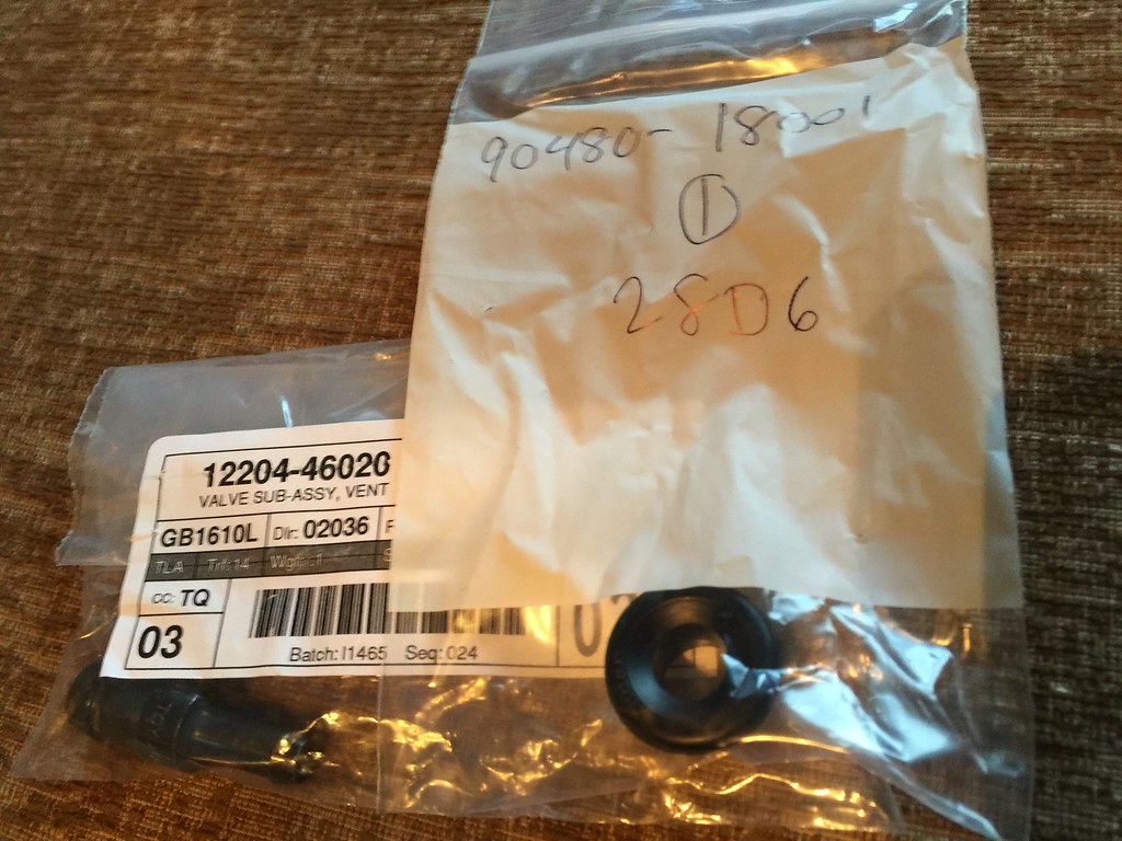

12204-46020 PCV Valve
90480-18001 PCV Grommet
Brian Crower BC0300S Valve Springs
Chromoly steel retainer kit
