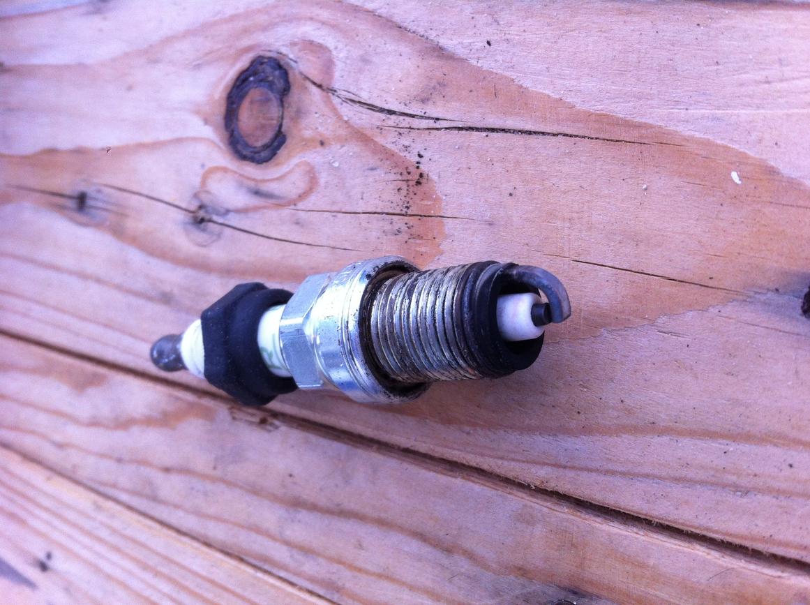

So I replaced the spark plugs and the wire set. Problem solved.... That was until a month later when I got up this morning. My car had a bad case of the Monday's. Cylinder 4 was misfiring all the way to work with all the same symptoms and the same code. When I got home I pulled the spark plug out of cylinder 4. It looked a little burnt around the tip. The boot looked good. Here is a pic of the plug. What do you think I should try next?

There is a good chance its your fuel injector. The good news is you can buy a reman injector for $30. The bad news is it is on the drivers side. Plan to spend big money to pay a shop or a good afternoon taking off the intake. If you do it, plan to fix the leaking valve cover gaskets while you are in that far.
It looks like you're not using the dual electrode spark plugs.
I would consider using the duals when you redo everything.

Tell the guy at Autozone that the guy in Japan that engineered the truck and decided it needed dual ground plugs may know quite a bit more than he does.

There is good reason why you want the duals, do a search but I believe that the plugs fire twice in a cycle. Our trucks also don't have a distributor rather they have coil packs. Make sure that you get a good seal when clicking in the plugs and use some dielectric grease.
To help trouble shoot if the problem still persists after the above, you could try swapping the 'bad' coil with a good one. If the problem follows the coil you know that is what you need to replace.

I put some more anti seize on that sparkplug, put it back, and reset the CEL light. Drove to work today, no problems at all. Very weird....
