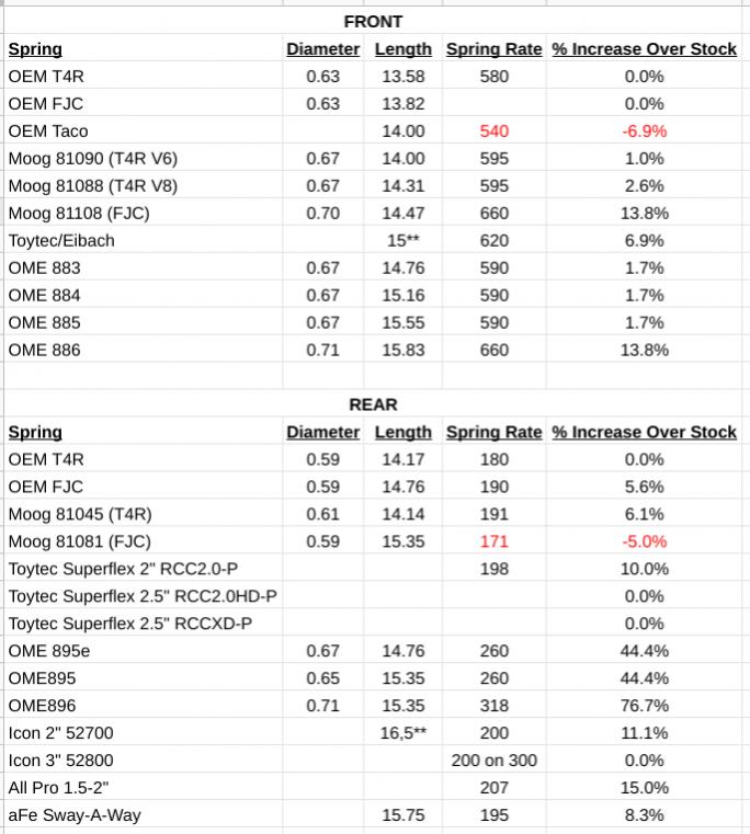

I've see a lot of discussion regarding the FJ swap and whether or not the Moog FJ coils were a better option than OEM FJ coils. After doing some searching, I've found some of the numbers for the Moog coils, and paired that with some info I already had.
A couple notes:
  1. The measurement for the OEM 4runner front coils is for a V8 4wd. The front coils on a v6 4wd are .2" shorter. 2wd 4runners use a different coil, but so far I haven't found specs on those. All models use the same rear coils.
  2. I couldn't find the spring rate for the front OEM FJ coils. I saw numbers all over the place, ranging from 530 lb / in to 630 lb / in. Most seemed to be in the 550 lb / in range, but from my experience the FJ coils are slightly stiffer than the OEM T4R coils, so that number doesn't add up.
  3. The 540 lb / in number for the Tacoma coils doesn't make sense either. I found the same number in several places (could have been all from the same source) so I posted it. Based on my experience, I'd say the Tacoma coil is stiffer than the FJ.
  4. Some aftermarket coils only show the % increase over stock, so I tried to calculate the spring rate. These numbers are in dark blue and in bold.
It's hard to compare the OEM FJ to Moog FJ coils since I don't have all the numbers. What I can tell is that front Moog FJ coils have the same spring rate as the OME 886 coils, which is very stiff. If I were to order Moog coils, I'd order the 4runner version (v6 or v8 depending on how much lift you want) for the front. I can't say on the rear since Moog did not provide the coil rate for those. I'd expect a minimum of 1" lift in the rear with the Moog coils based on the height. My only concern would be spring rate, and whether or not it'd be too stiff.

Icon 2.0s are 16.5" long

I updated the spreadsheet with some new-ish info. Icon told me that their rear 2" springs have a spring rate of 200lbs (he could have been rounding down from 207); he also told me that the 3" dual-rate springs are 200 over 300 (which may also be rounded).
There are now several types/sizes of Superflex springs, I'm waiting to hear back from Toytec about their specific spring rates.

FYI, I contacted Eibach for more info on their springs, and they provided the following:
E30-82-073-01-20 front coils
Free length = 360mm, Rate = 720 lbs/in, Wire size = 17mm
E30-82-073-01-02 rear coils
Free Length = 373mm, Rate = 205 lbs/in, Wire size = 15.5mm
E30-82-073-02-02 rear coils
Free length = 382mm, Rate = 250 lbs/in, Wire size = 16.5mm
I was surprised at the spring rate on those front coils, so I asked again just to confirm, and yes they are 720 lb springs. Those are dang heavy (24% over stock) but the Eibach rep. said with the Tacoma overlanding crowd they had a lot of people asking for increased rates to compensate for heavy gear (bumpers, winches, sliders, etc.).
