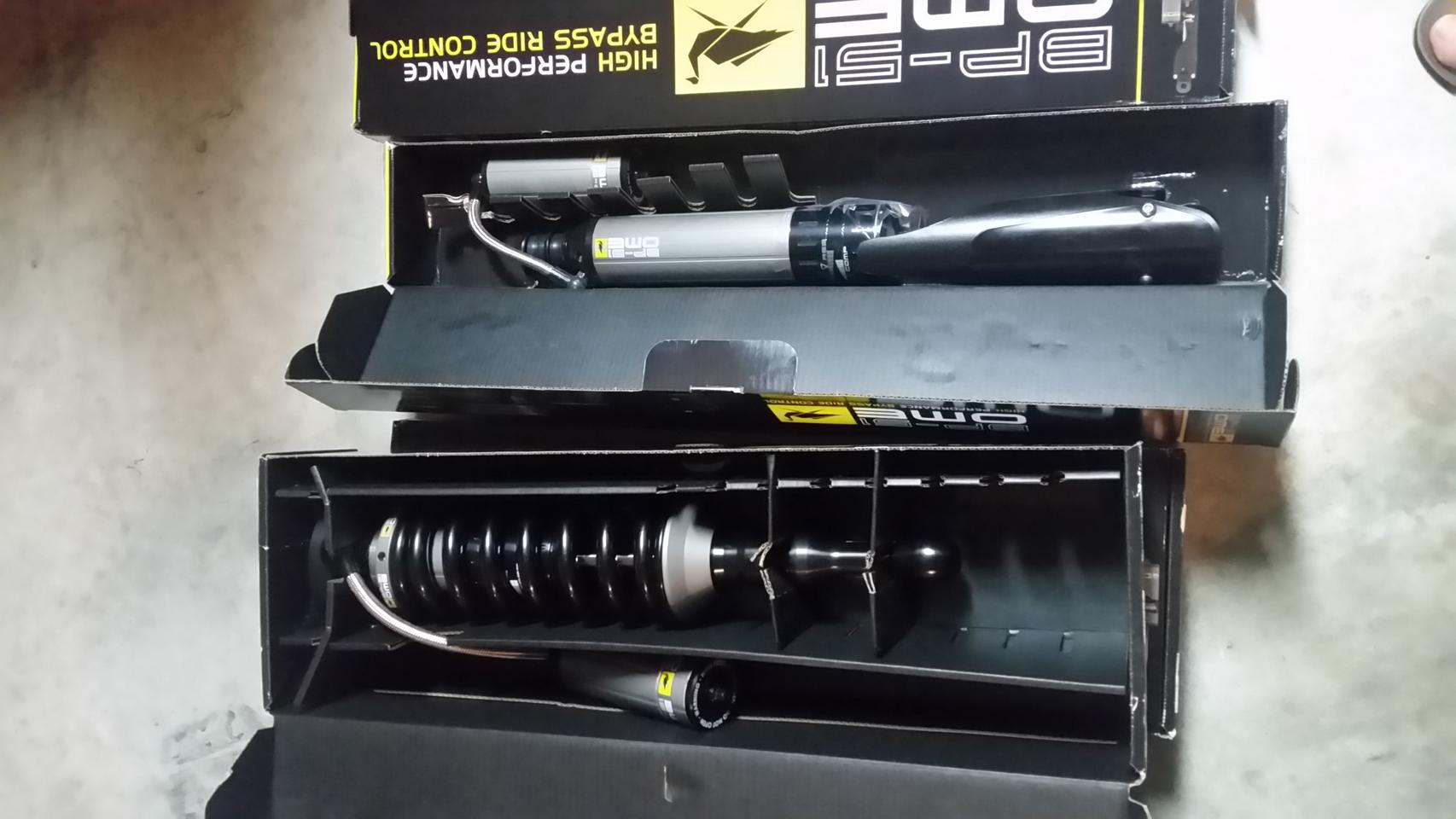

I just purchased the BP-51s last Thursday, after opening the boxes, these things were absolutely worth every penny! Pieces of artwork that I may just want to mount on my wall, haha. I ordered the 895E springs (I don't have a bull bar or winch and mostly commute on the highway), they are rebuildable, and they can be installed with the stock UCAs (what I plan on doing this week and will post up pics). I plan on going with camburg UCAs down the road, but will run on the stock UCAs for a while.

It begins...

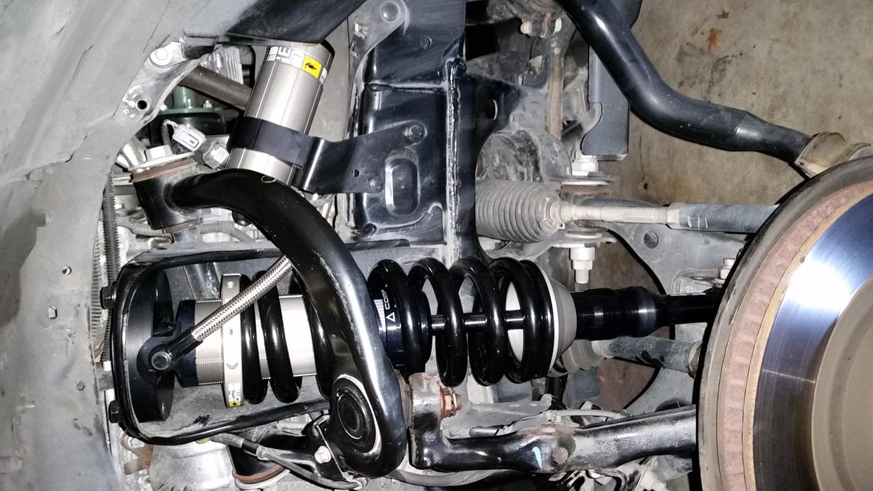

T4Ranger, I am very much looking forward to your experience with these. I will be purchasing suspension for my TE this year and I am currently leaning toward the BP-51's. Al the marketing make these out to be the setup to beat. Also, they are OME so there's a lot of confidence behind them. Subscribed.
Teaser... I'll definitely start a new thread on the install and results!
