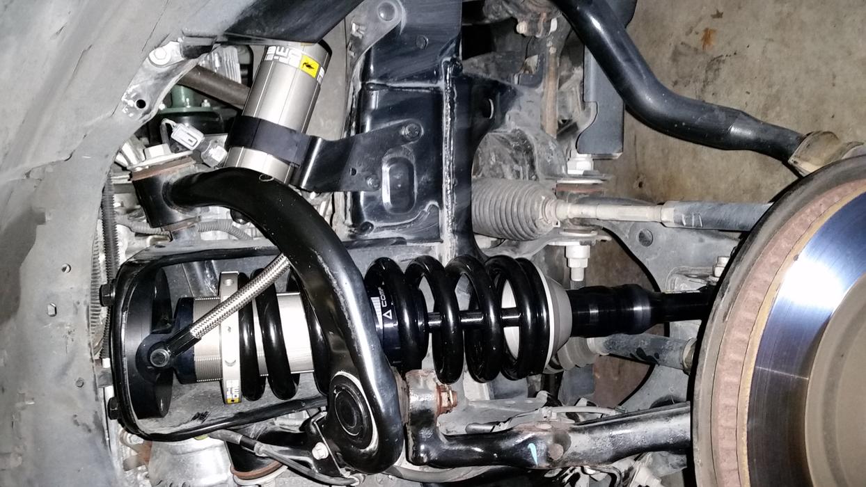

How's the install going so far? Looks great!!
It took longer than expected, but it's in! The reservoir brackets were a PITA and it was the first time I attempted to put the KDSS back together... that was definitely the worst part and most time consuming...
Bp-51
Looks great! How much are you raising the front? Let me know how your caster comes in during alignment. I am curious how the stock UCA's will be. I love the idea of keeping them, I think UCA's are very overpriced.

T4Ranger - Did you have to adjust the top hat of the coilover? I think out of the box it came ready for extra weight on the front for a bull bar bumper. Just wondering what to expect as far as increased lift up front. I do not have any extra weight on the front of my 4Runner.

I do not have any additional weight upfront either. I did not adjust the top collar. Installed as they came right out of the box. Again, I'm going to wait another week or two and remeasure all 4 corners.

Thanks for the feedback!!! Do you think it added approx 2" - 2.5" of lift in the front?
Wondering if it is close to level with the height of the rear in stock form.
