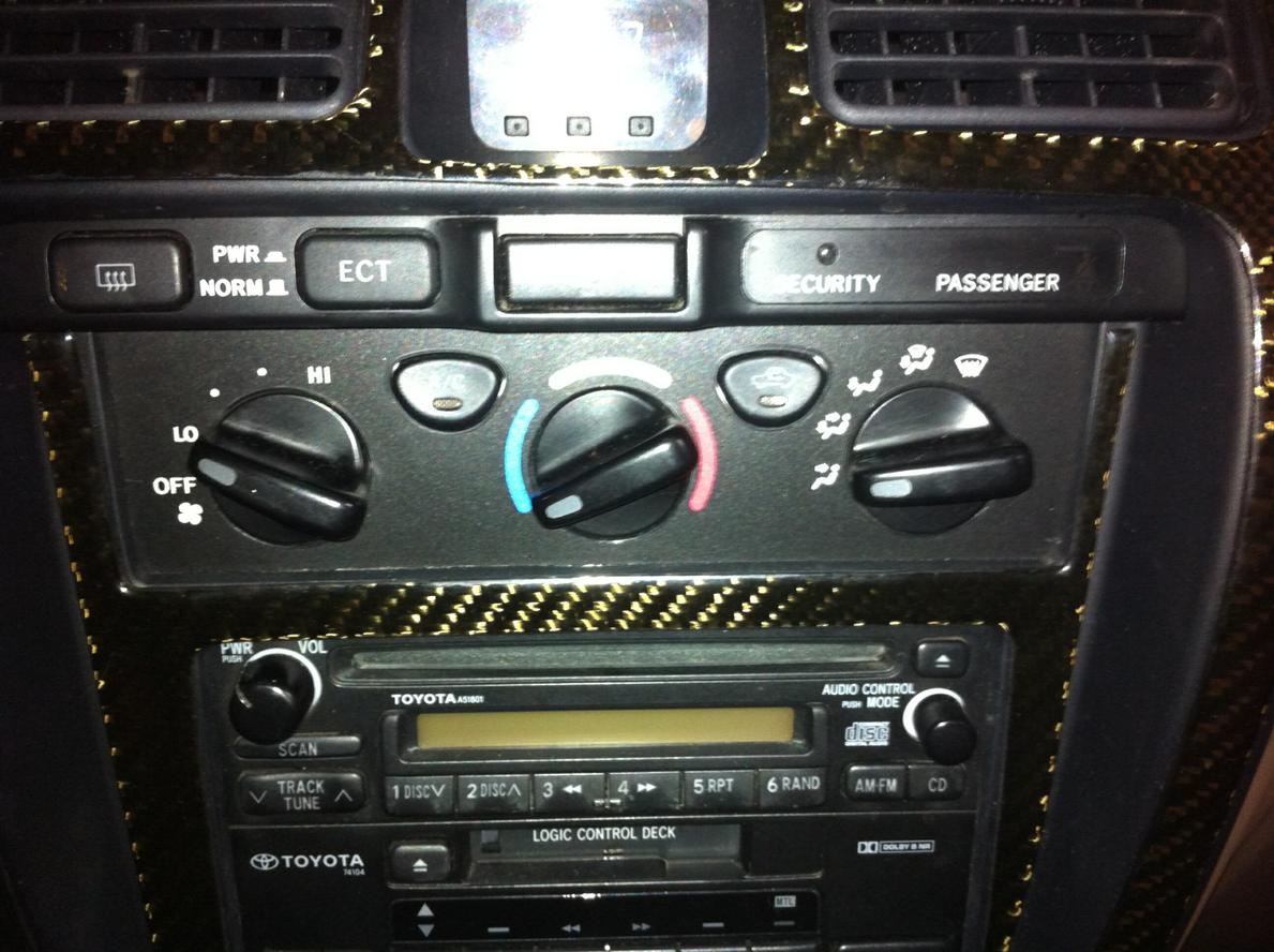

Is it possible to convert my 2000 SR5 HAVC dial controls to a digital Limited style? Has anyone done this before?

Sorry dude...didn't mean to hi-jack your thread. I assumed the reason for the mirror was to be able to know what temp it is outside and the use of a possible pre-wired temp wire in our 4Runner...since both of these are accomplished with the Limited HAVAC controller, I thought I would throw it out there to help myself and others. I apologize...I'll start my own thread to answer my question...

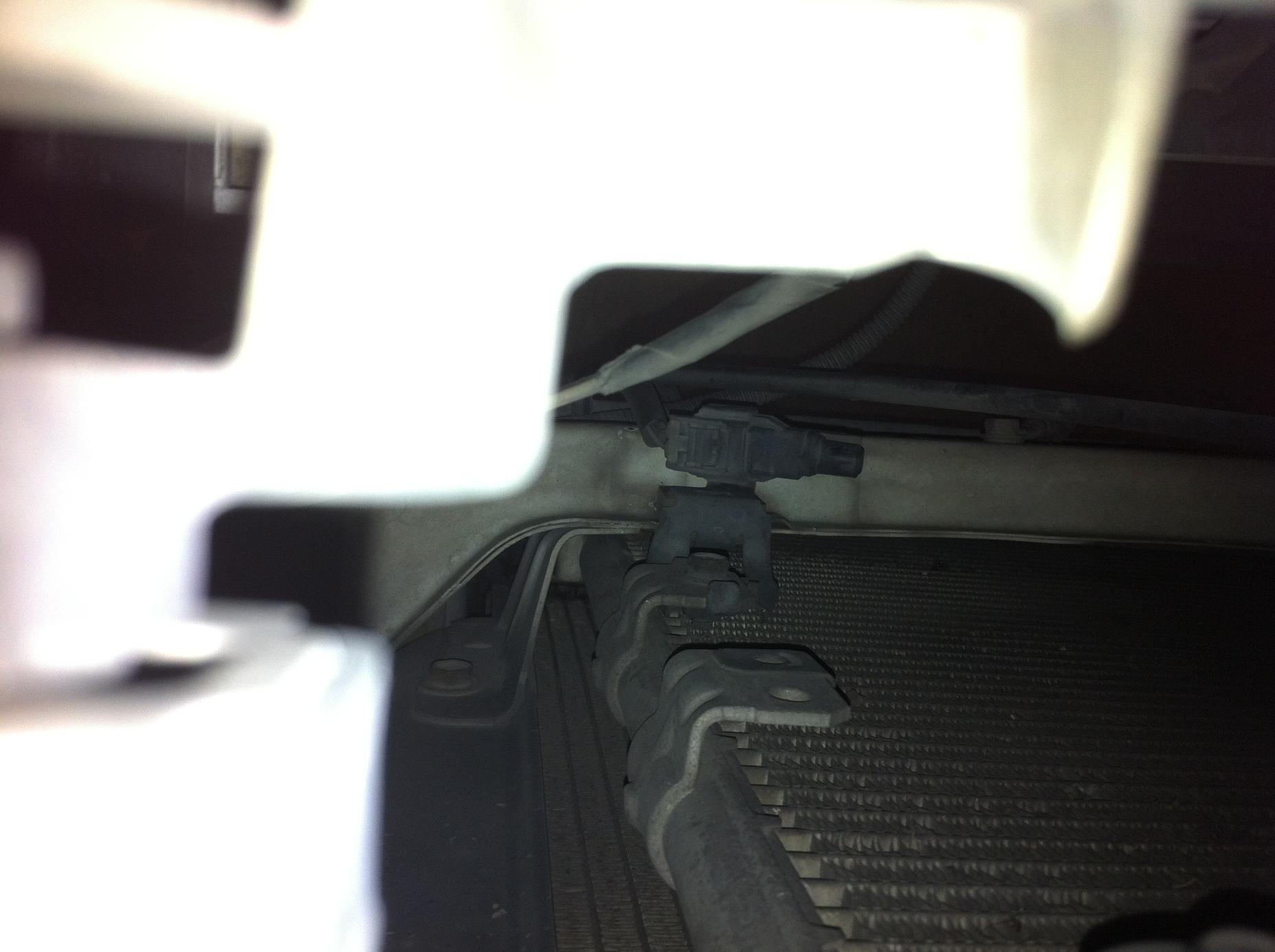

the limited (and not all do) was the only 4runner that I know of that has the digital temp controls.....otherwise it was pre-ordered when truck was bought new....but all 4runners 99-02 were pre-wired for the temp sensor/foglights... the temp sensor is behind the grill/bumper area before the radiator... I'll post pics tomorrow from the mirror I installed, it came from a wrecked GM truck, so I got all of it including the plastic parts that hid the wires as the go up to the headliner....

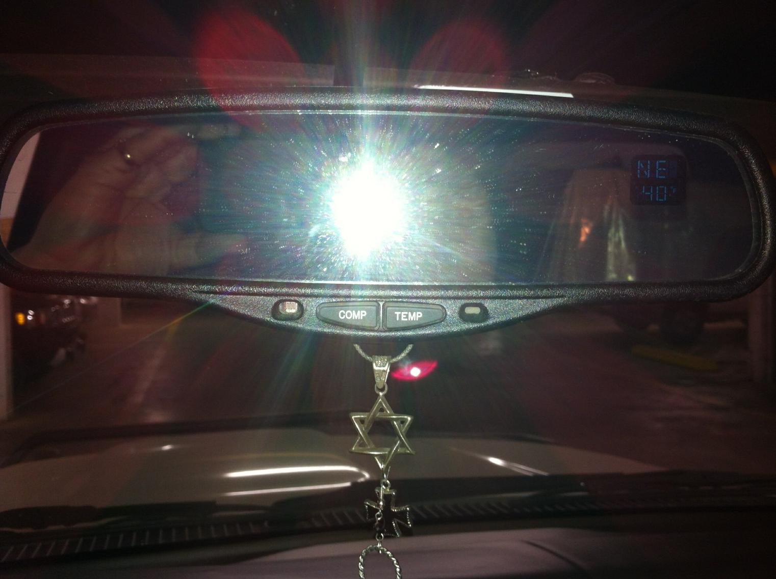

1 pic is the installed mirror w/temp and compass

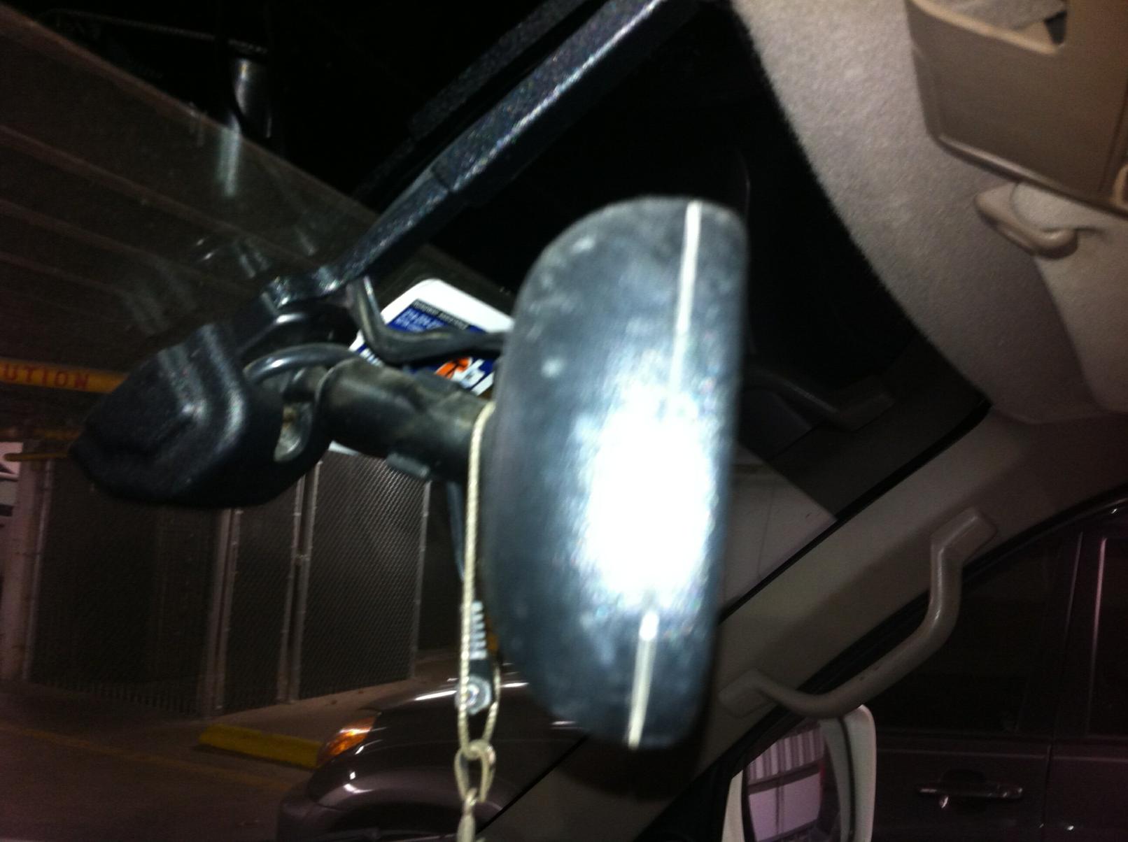

2 pic is side veiw showing the hidden wires

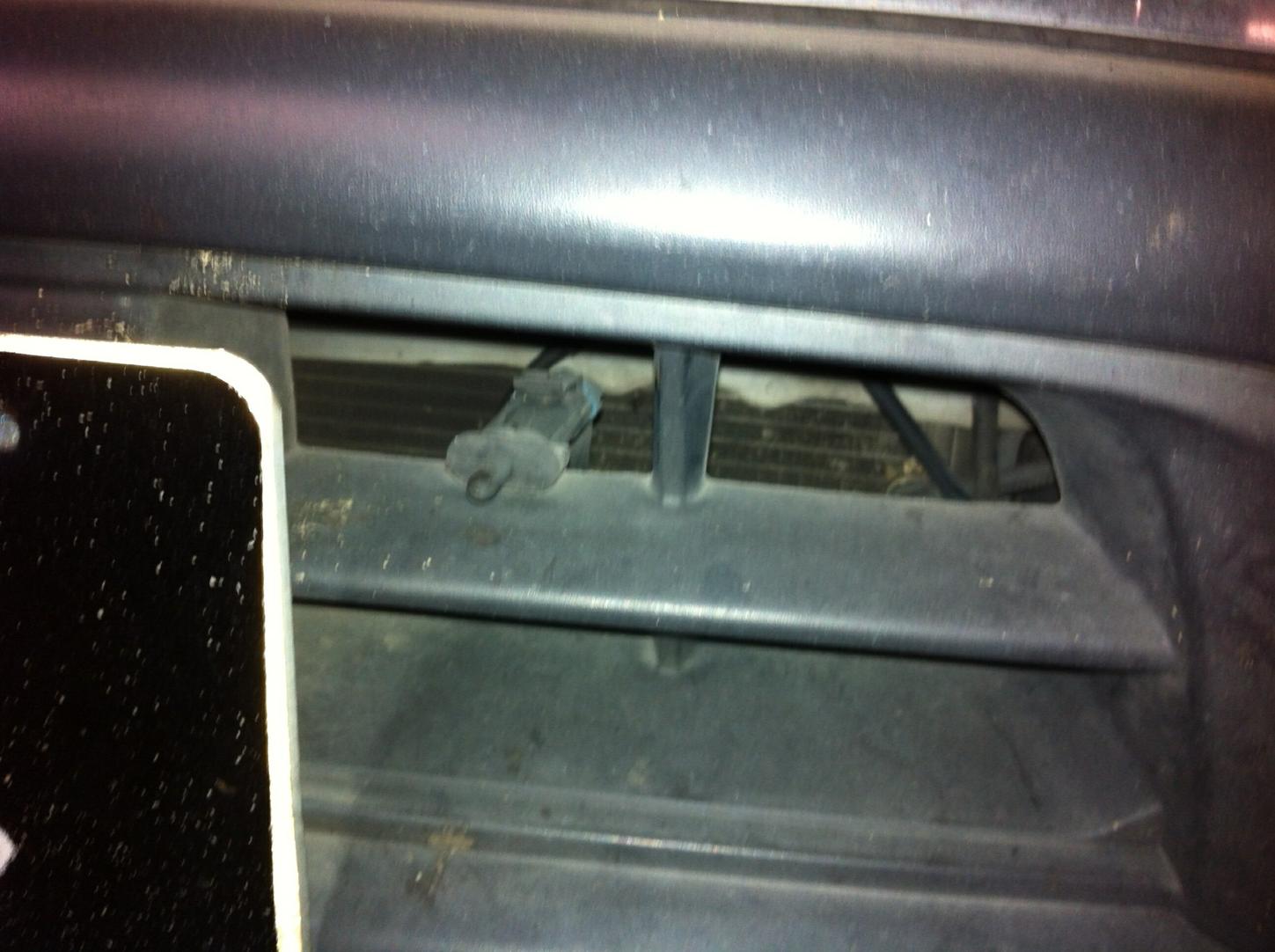

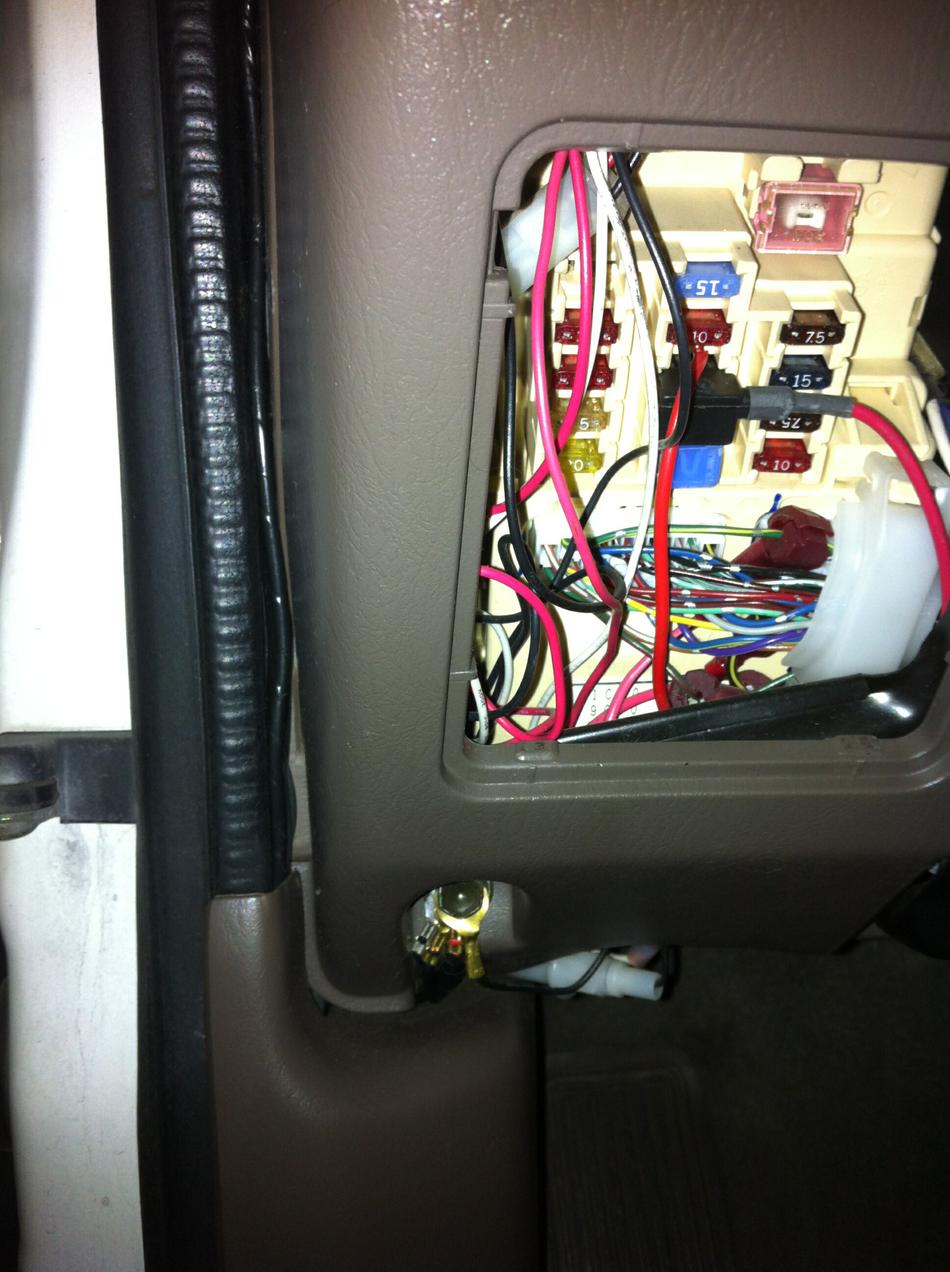

3 pic is showing rhe under dash fuse box and the hot wire connect also showing the brass bolt below where I used it as a ground
4 pic is showing where I installed the outside temp sensor (before I found out truck was already pre-wired w/temp sensor)
5 pic is showing where the factory temp sensor is

you talking about my mirror in the pics? the flash from the camera made it look dimmer than it is, cause it is bright during the day and I think (not sure) it dims some at night so as not to be too bright, and yes that is the adhesive that I used to attach the mirror to the windsheild, four wires is all you need two go to the sensor and red one to the fuse box and black one to ground, before you attach the mirror make sure you have the mirror trial fitted to see that it is at the right level, use like a sharpie to mark where the metal piece attaches to the glass, I used masking tape to hold it in place till it dried...everything else easy, hiding the wires up under the headliner, down the A pillar, to the fuse box, and the sensor wires through the ruber groumet in the fire wall to the engine bay.... good luck....did you get the mirror that shows both temp and compass at the same time, ot the one where you have to switch it back and forth? mine dispays both at the same time and has the square dispay, the other one is a rectangular dispaly and only shows temp or compass not both at the same time.

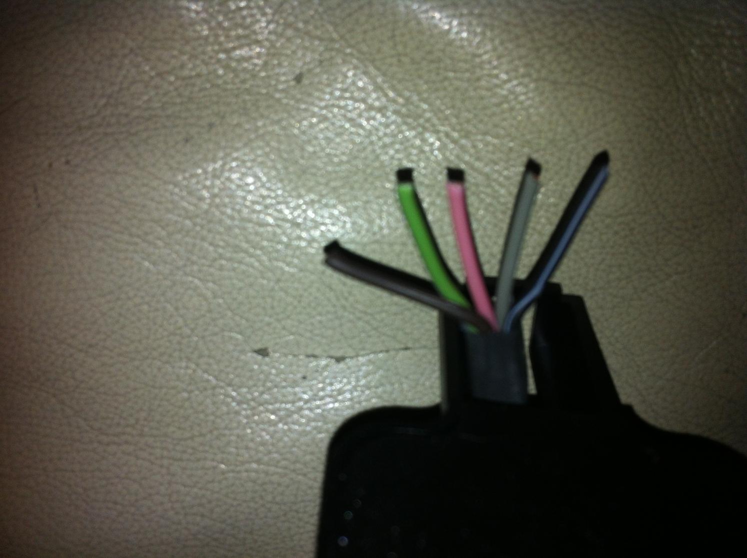

oh okay I thought you got another one from a GM, just use the wiring configuation that you have that got your mirror working in the picture. because the wiring harness on this GM mirror is different. (black/white, green, pink, grey, brown)
