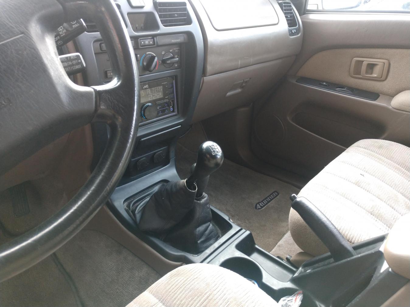

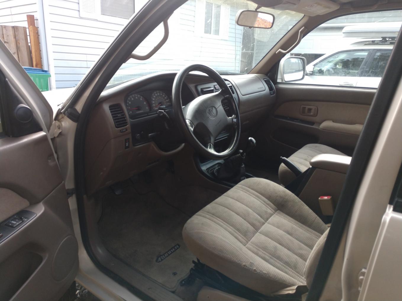

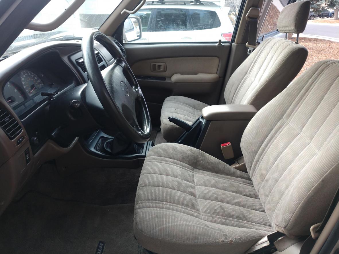

Cleaned up the front interior, swapped out the center console for the clean one, got the lower dash all buttoned up and the heat valve working. Also as a bonus, the center console I put in has the dual cupholder for the rear. Sweet!

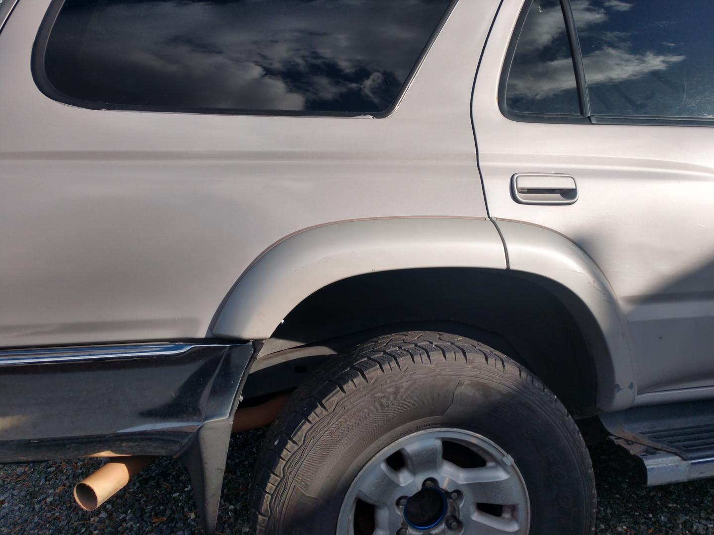

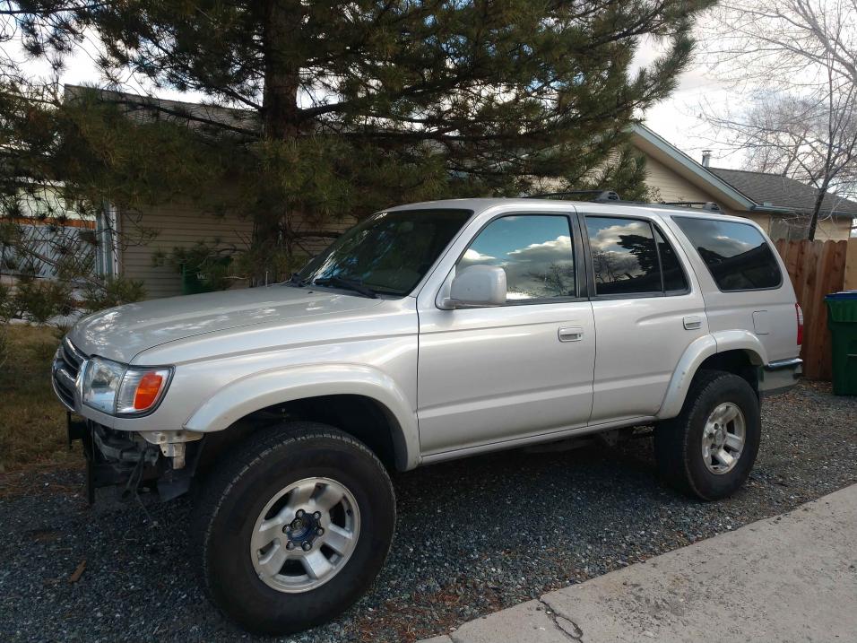

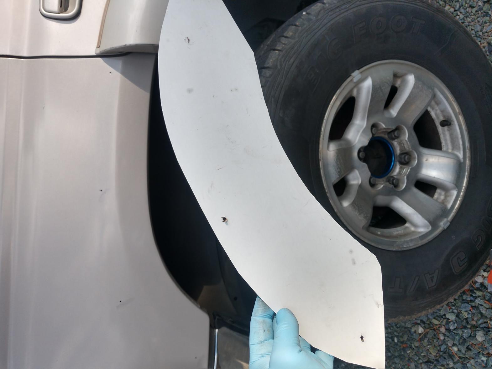

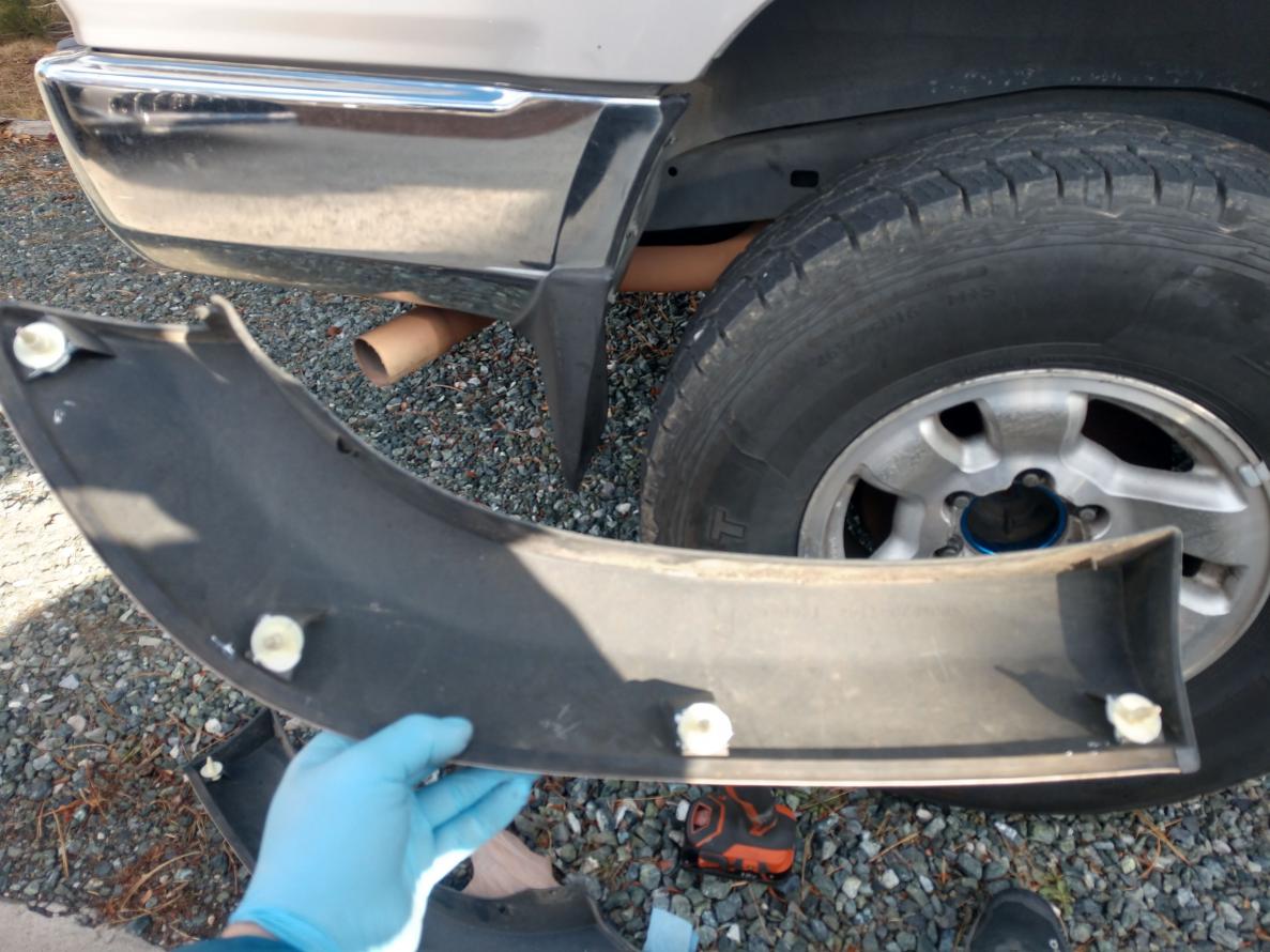

In other news, found some clips that almost were a perfect fit at Ace hardware for the mounting of the rear flares. The flare clip tab was just too thick for the clips, causing the retaining portion to break when I pushed them into place. I used a screw driver and removed the middle portion of the retaining clip and I was able to get a pretty good fit. I added some gorilla glue construction adhesive to give the clips a little more strength against vibration and pressure.
I then made a template from cardboard by punching holes through where the holes were on the other 4runner. After that, marked the truck up. I used red locktite on the tip of the clips to make sure the positioning of the holes matched with the template. All was good and I drilled 4 pilot holes for the larger 5/16th bit. Once the holes were drilled, I cleaned it up and added rtv to the clips to weather seal the holes and keep it from rusting too easily.
Took about 2 hours. To do that...while I was doing it I decided to remove the running boards and paint the points that were welded for the trans mount.

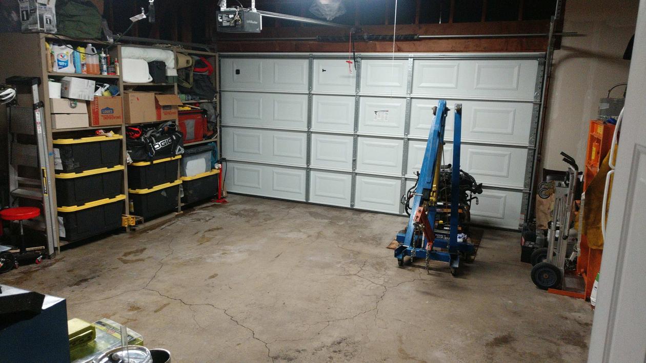

Spent the rest of the day cleaning the garage up. Got it looking pretty good minus the engine and crane...gotta get rid of that. Purple power on the floor and a quick rinse with a squeegee and most of the oil and dirt lifted up.

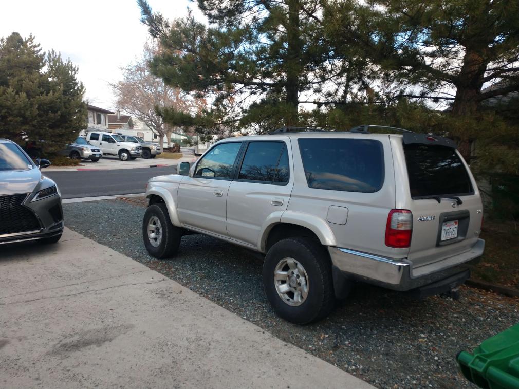

Took it in for a smog check to get it registered this week. Drove about 5 min to warm it up and dropped it by. Got a pass, no issues.

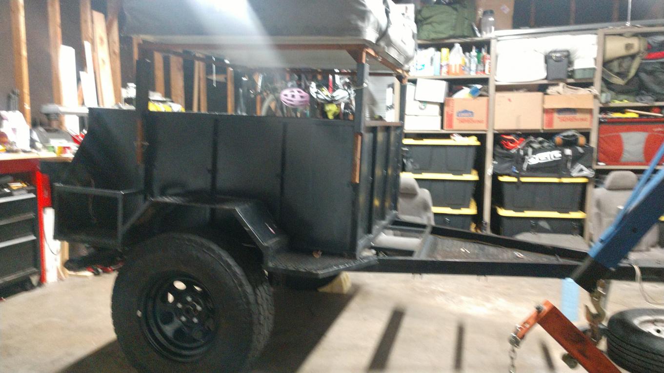

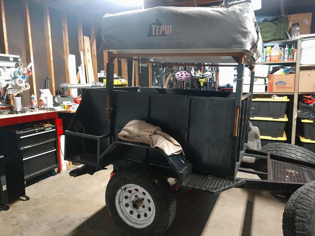

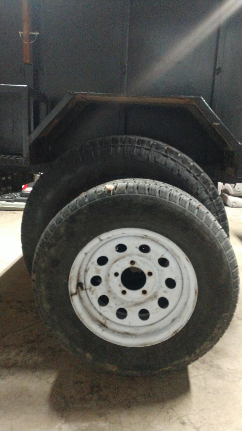

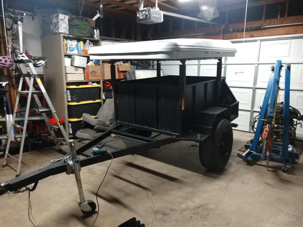

Did some work on the trailer...found some cheap 265/75/16s for 80 a pair with about 60 percent tread, and bought some steel wheels from summit for 90 each. Needed spacers because of the offset, but il extend the axle at a later date. The trailer looks like I wanted it to when I originally fabd it up. Throwing the new hardshell rtt on it and need to make a mount for the awning I bought on Black Friday. The 4runner will be paired with this for all my camping trips!
New hardshell CVT tent mounted up. Now that the trailer is almost done (need to mount the awning) il probably take a week or more off then resume work on the 4runner. I think I may temporarily mount the OEM front bumper on it.
