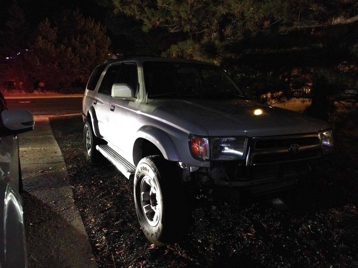

Installed the spindle/ hubs , left CV shaft, and tightened up the rest of the front end. Looks like this 4runner is officially 4wd! (As soon as I throw on the nuts to the axles).
GAH it looks like you forgot your dust shields!
well, i cut into them with my grinder anyways so i could reinstall and remove as needed...so when I when to press the bearings in I decided to leave em off! This isnt a DD anyways, but all it does is stop your brake dust from getting all over stuff...guess Il see how much I hate it later. Race cars dont mind!

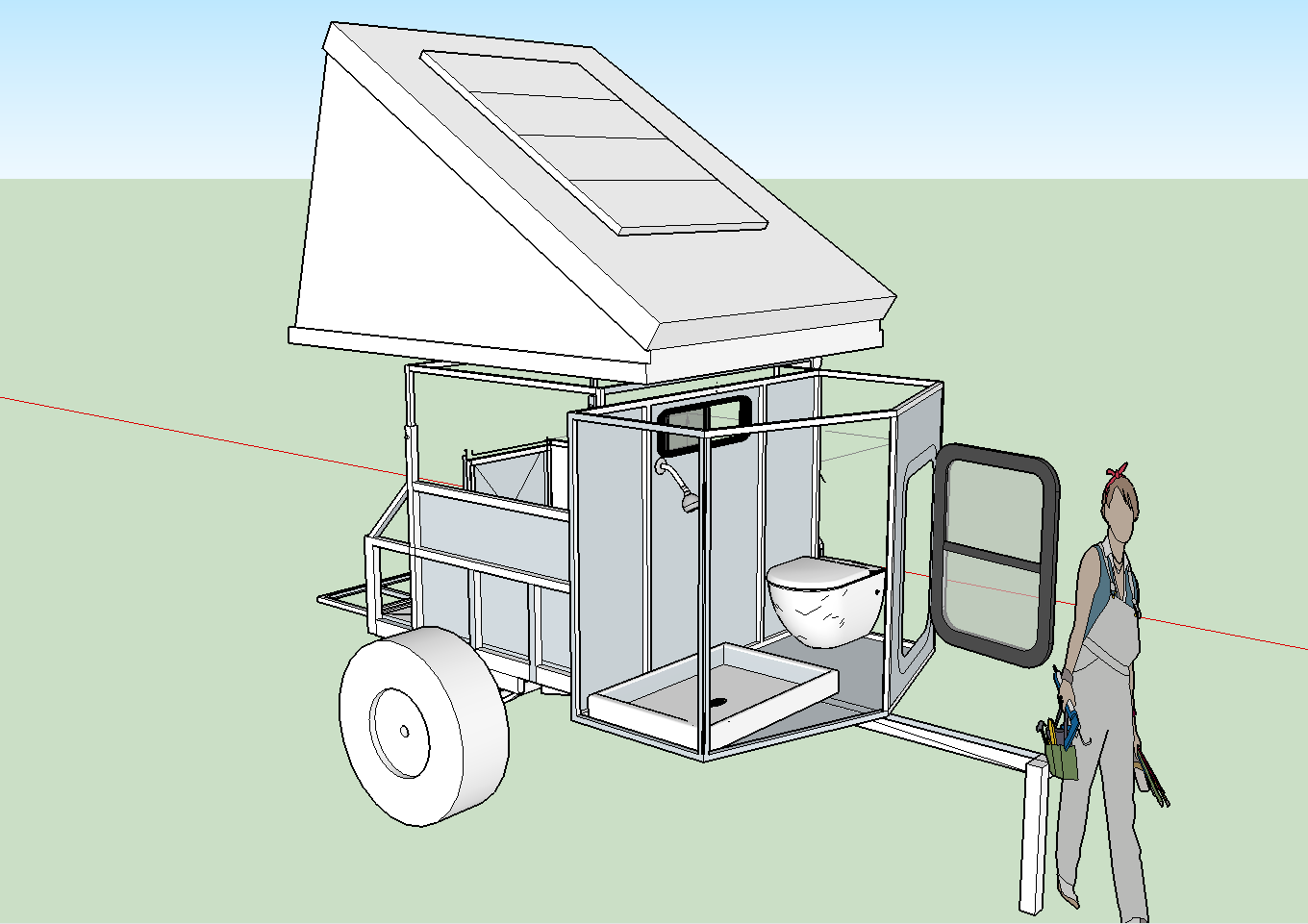

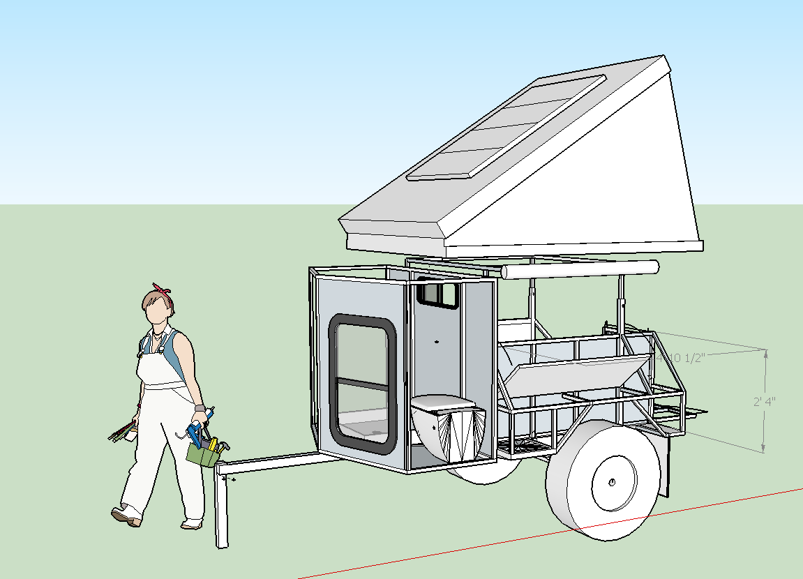

Been doing some designs on the current offroad trailer I built.
I purchased an awning and hardshell RTT for the trailer/4runner over black friday, so il most likely sell my softshell RTT. Its been great for the past 4 years or so, but time to move on!
This design is a bit unconventional. Most teardrops/small trailers have a small sleeping space with outdoor kitchen sink etc. I have a great sleeping space already with the rtt, but what would make a big difference camping is a hot shower every few days and a toilet with some privacy for guests that may be camping with us, and my significant other.
Ive designed this small shower/bathroom stall as a sort of module that I will either weld to or bolt to the existing frame. The bolt idea is nice because I have the flexibility to remove it, but I honestly dont expect to take it off once it is installed.
It will be 1x1 steel painted with the same epoxy style rust inhibiting black matte paint used on my current trailer.
I know this isnt specific to the 4runner, but those updates will come soon...Im waiting for the weather to get a little better before I finish up and get the 4wd and interior the way I want it.
here are some photos. The new addition is from the box forward. Interior space is 50 inches high, just enough to crouch inside and do your business. It will have heated water tanks to protect from freezing and an inline on demand heater for the water itself. The door is about 3ft, but Im looking into affordable options and trying to get a 4 ft door that will work for ease of entry.
the shower pan is 24x36 which allows for enough room to rinse off. Il purchase a small shower bench that is removable for ease of use. The toilet will be a chemical toilet with removable tank (most likely). Dealing with a black water tank and plumbing isnt my idea of a great time.

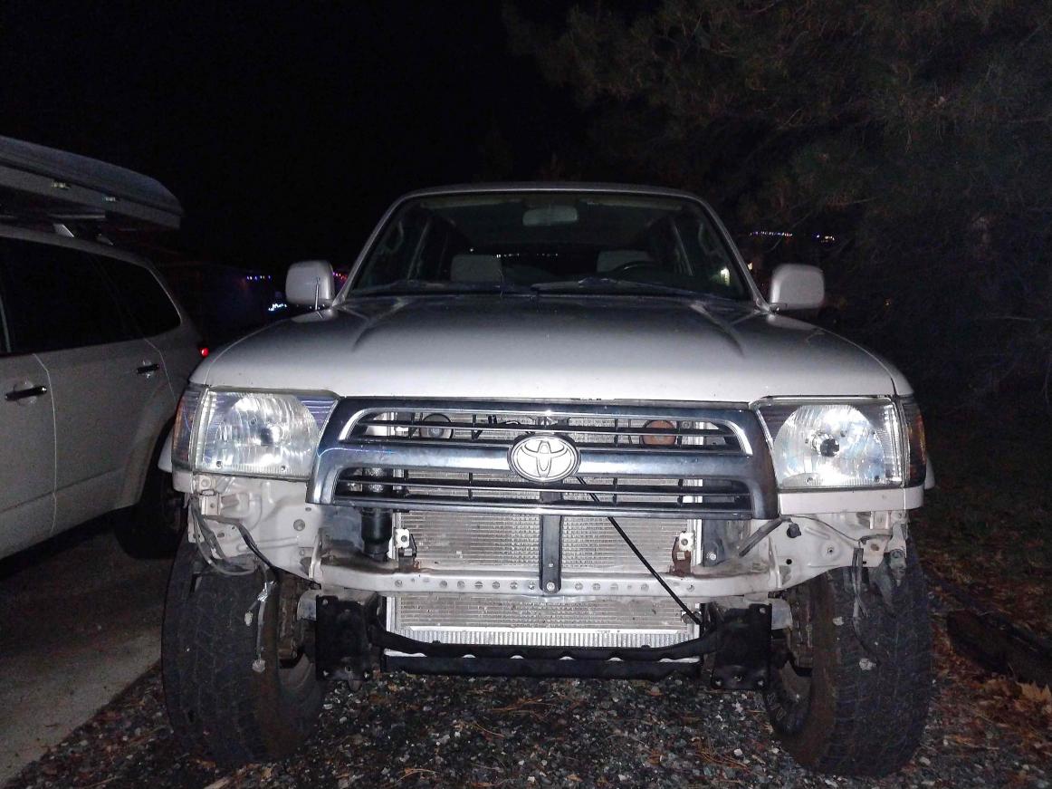

She needs a nice fabd bumper and the rest of her flares, but it's definitely getting close to being finished. Still have to wire up that ADD...mainly haven't because I know what to do and Ive been trying to knock other stuff out first.
Evening photos sitting in the driveway after a test drive with some new gas...
