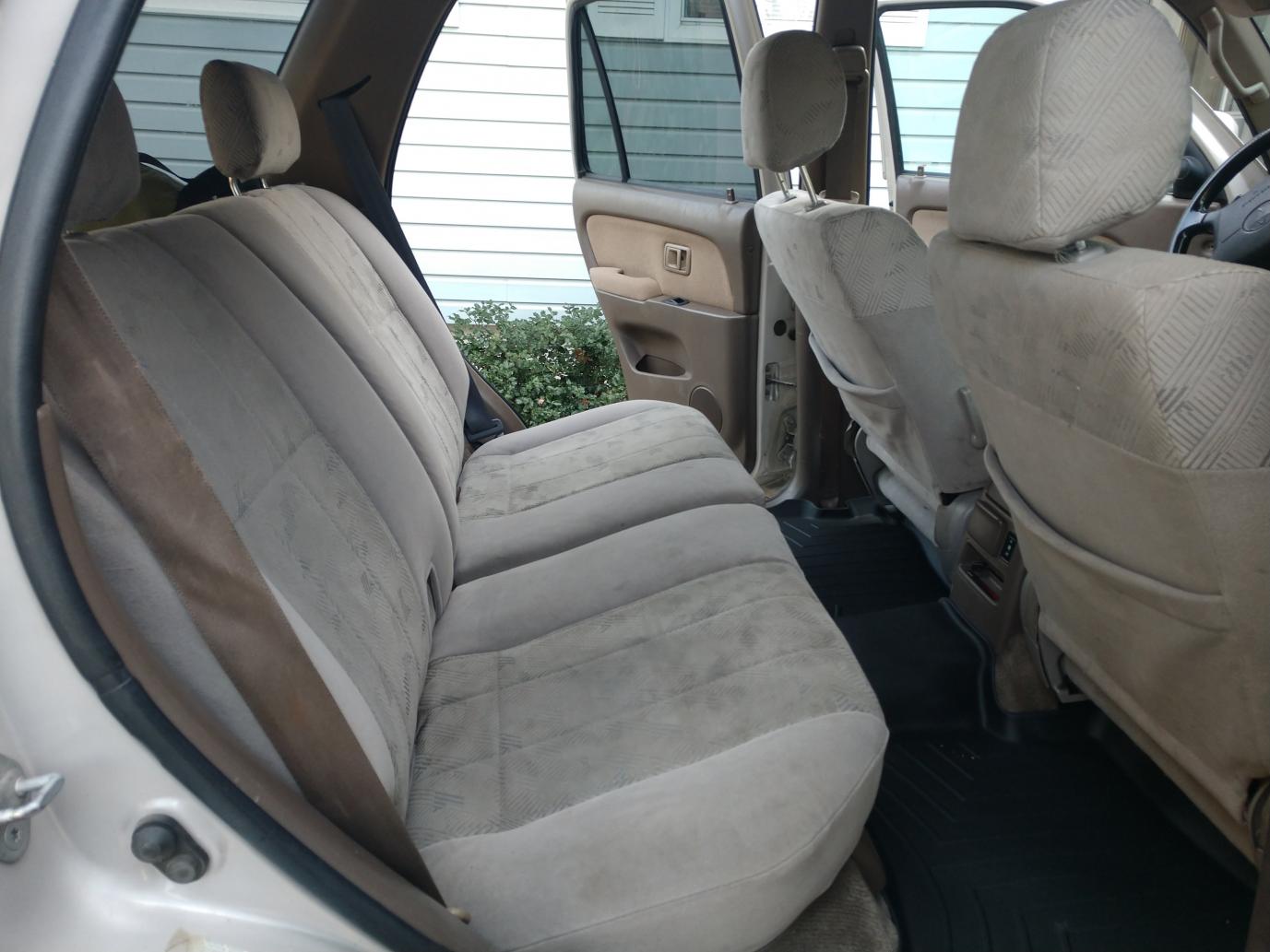

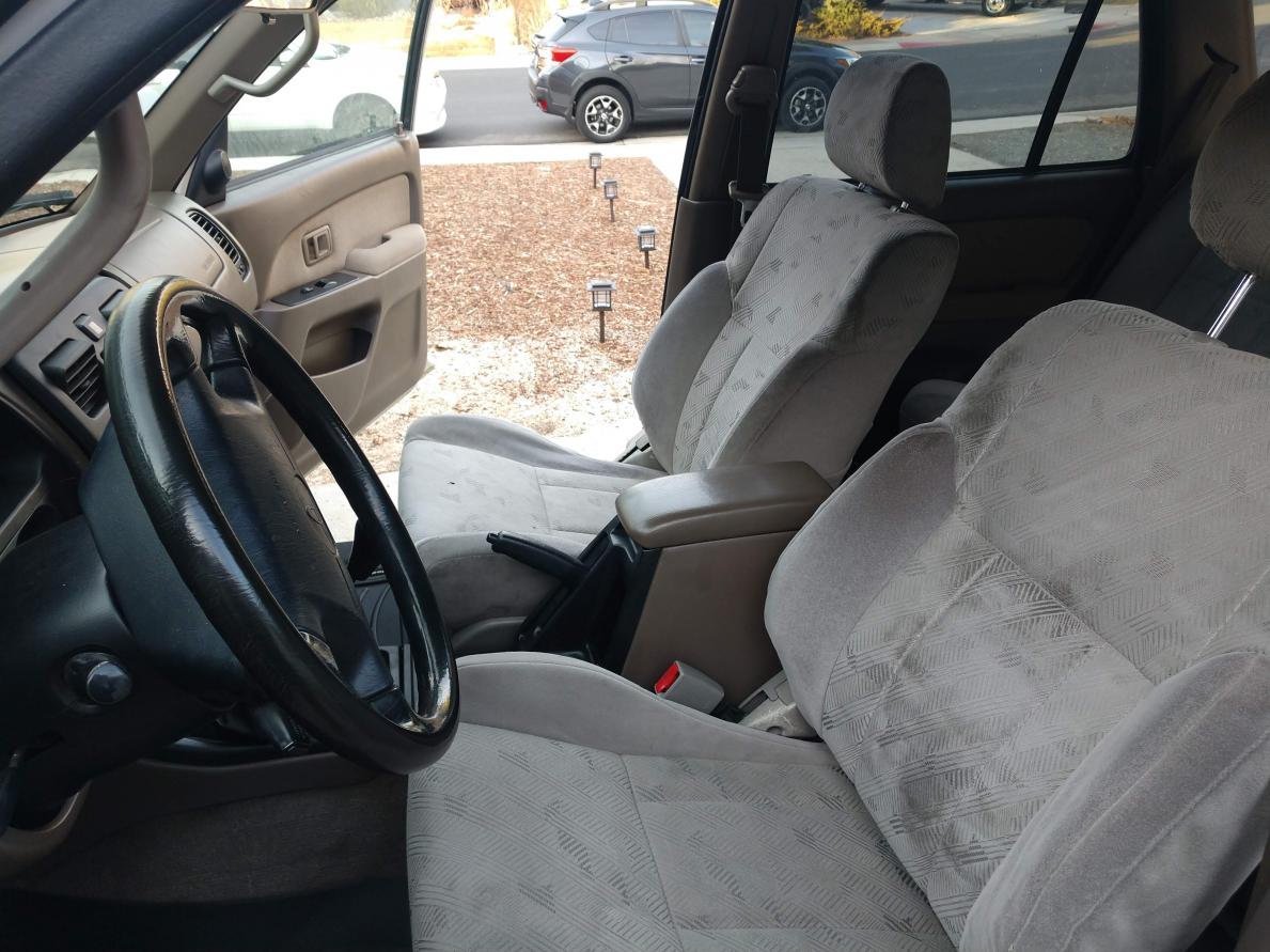

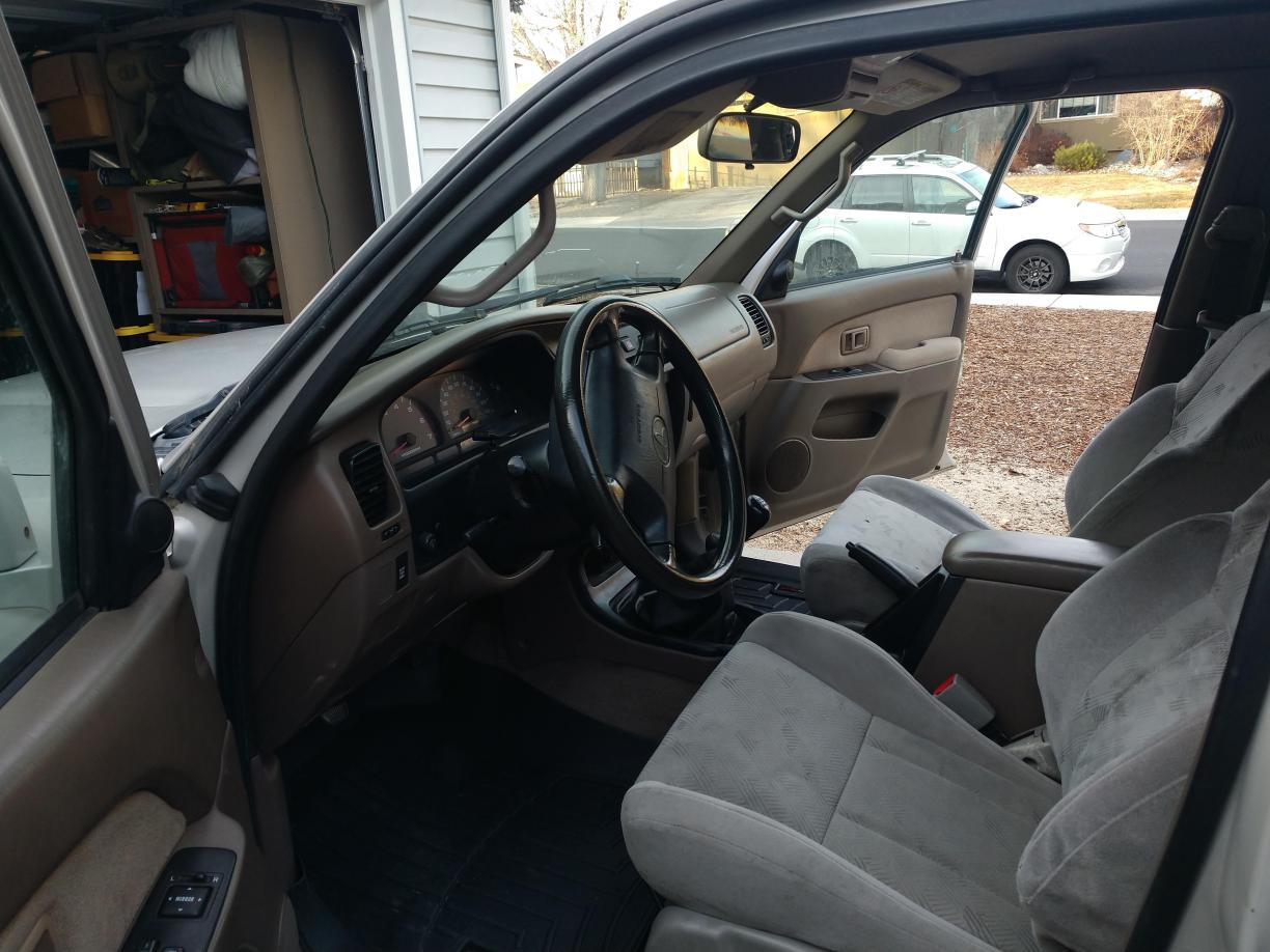

Today I got a passenger seat and rear seat from an 01 runner that are in great condition. They are a soft faux suede trim with cotton centerpiece in Gray. I'm swapping the good cushions from one of the passenger seats I have to the bad driver seat I already own to make an almost mint complete set of sport buckets!
Excited to throw them in, il stay happy for a while...not a fan of the non sporty half buckets that are in the 4runner currently. Doesnt help that they are a boring tan...

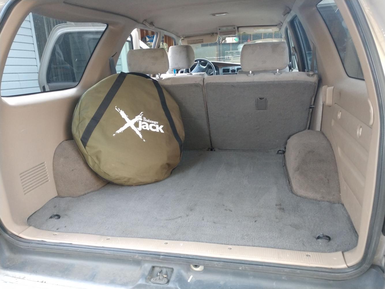

I also got the new to me sport seats cleaned and installed. Swapped the bottoms over from a passenger side to the worn driver side. Removed the seat cover uppers and washed em in the washer, and for the rear I scrubbed em with turtle wax carpet and floor mat cleaner and got pretty good results! Love these seats compared to the old ones.

Hi.. So you preferred the sport cloth seats with the lateral support BETTER than the standard cloth seats you show on your first page? More cushion or better support? Any idea on if one or the other affords more head room?
Thanks..
