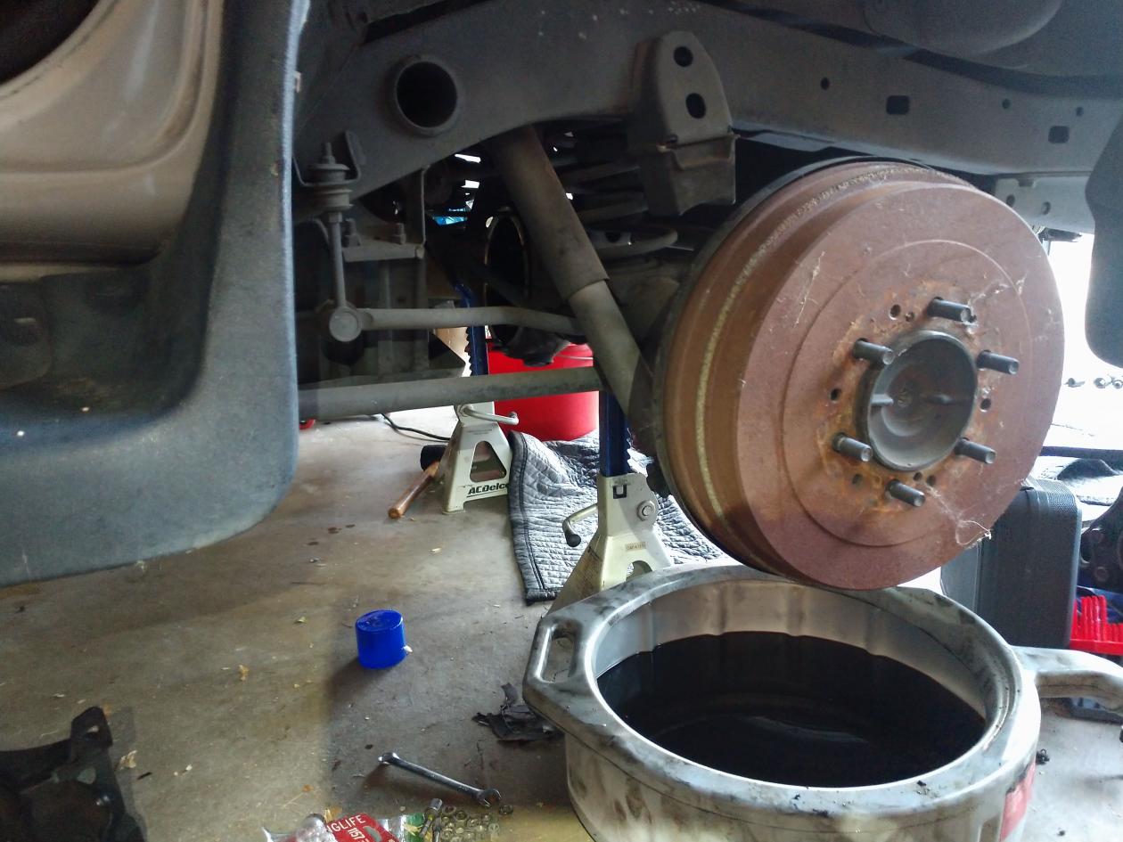

UPDATE:
Wow...what a day. Started at around 1 and finished at 8:30.
Started by removing the xfer case bolts , interior trim around the shifter, shifter and 4wd lever, and then the motor mounts.
I forgot about the clutch line until I started pulling it, but I did it slowly so I was able to address what I might have missed. It was rusted heavily , so I cut the line (will opt for stainless braided replacement).
I also missed the ADD vacuum hoses, but those were easy to pull off. Once I started jacking the engine out I was able to get easy access to what looked to be the heater core hoses-popped those off.
Once I removed it with the trans (mated) the real fight started. It took me about 3 hours to get the engine out of the body and into the garage-not because of the difficulty removing the engine, but because of my gravel side yard. In the struggle I ripped off a wheel from the engine hoist and used a furniture dolly to replace it (it works!)
Photos of of the chaos. Tomorrow or Friday il be removing the xfer case, hubs, front diff, CVs,driveshafts and the ADD system. Looks a little rusty, so I might replace that vacuum box if it's cheap.
Popped the covers off the hubs to find pristine hardware-really excited. Still have to check the manufacturer to see if they are cheap cvs and spindles .

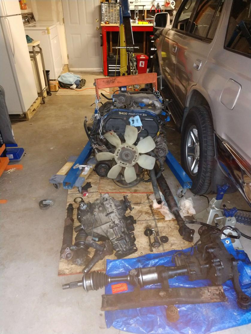

UPDATE:

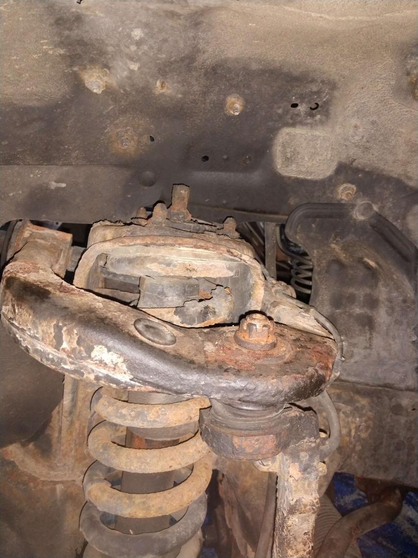

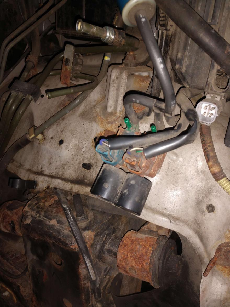

Got all of the mechanical parts I want out of the truck. The hubs look to be aftermarket, so rather than pull them and reinstall in the current truck I'm just going to buy some from Napa and install them into the new hub assembly.
Front diff looks good, but the ADD lines are definitely rusted at the ends. I think I'm going to shorten the metal where it's rusted and extend the end with longer rubber hose...this saves me from having to buy another part.
The driveshafts have surface rust, but nothing too bad. Il be replacing the bolts when I reinstall and running it as is.
The transfer case is in good condition, definitely leaking some though. Will be looking to replace the xfer case gaskets, trans gasket oil pan gasket, rear main seal, and a few other things that are hard to get to while the engine is out. If anyone has any suggestions let me know.

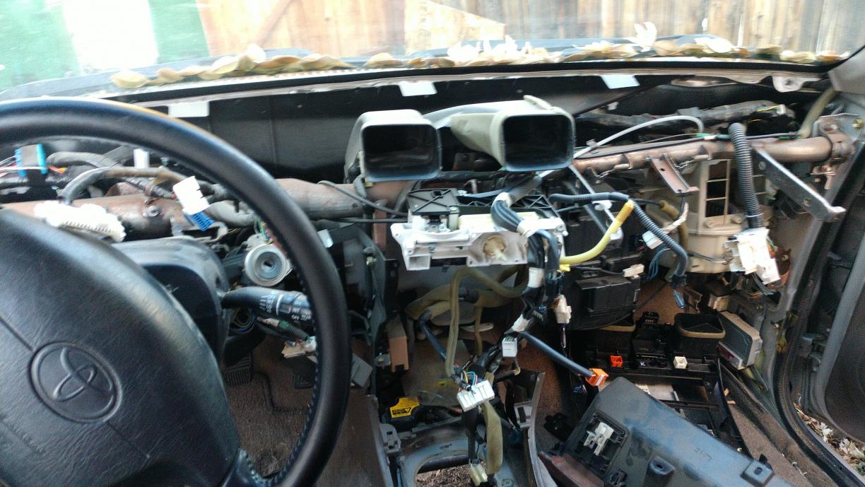

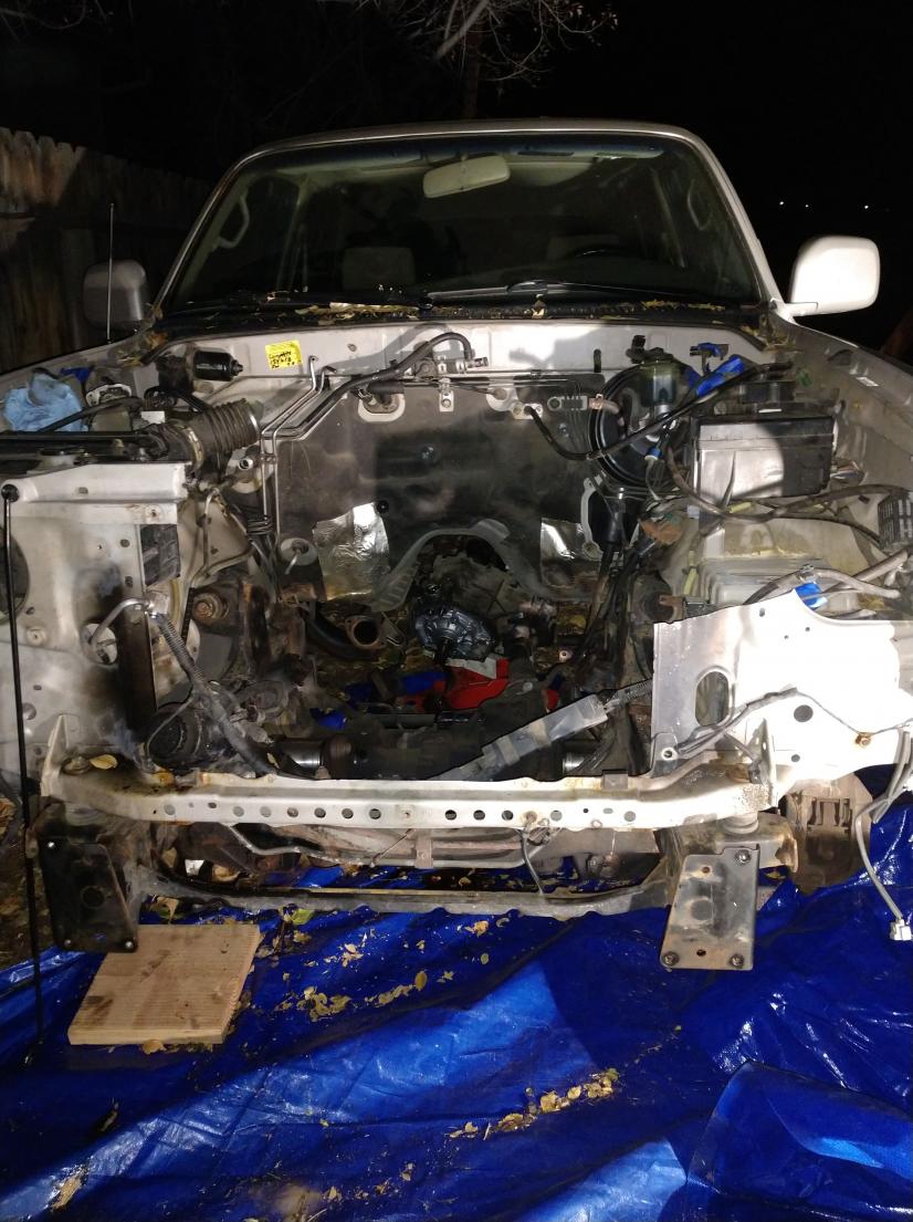

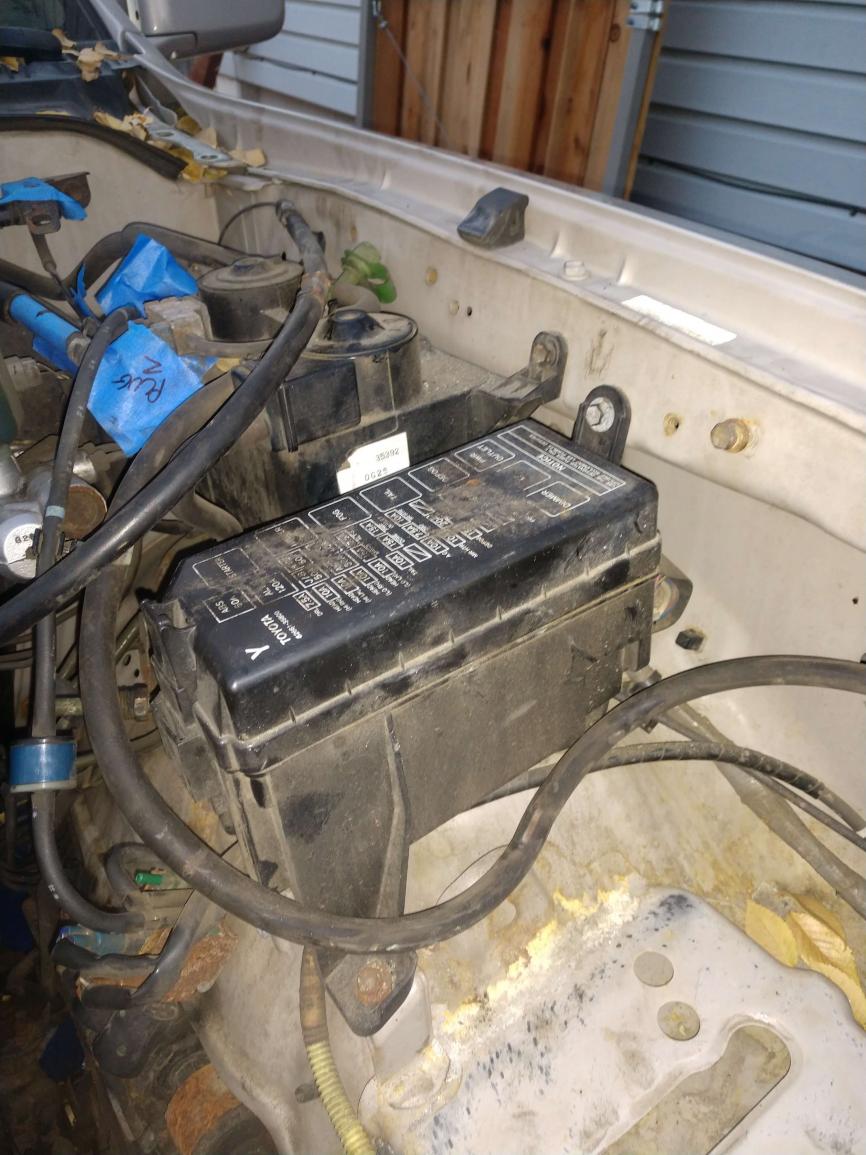

Took photos of what I still need to take. I think the whole drivers side fuse/relay box needs to be swapped out for the add wires, but I'm not 100%. Going to check on that. Obviously the master and slave cylinders , pedal box , and the cluster will be swapped as well.
The donor truck is a rolling chassis now, so itl be ready for towing when the time comes!
Everything I need that's bulky is now in the garage with the new 4runner. I'd really like to clean up the grime oil and dirt off the components before reinstalling....any recommendations of great degreaser?
To say I'm excited to be done working on that rust bucket is an understatement. I have no idea how I didn't break more bolts...pb blaster is your friend!
The hard work outside is now done....finally I can work in a clean garage with some heat!

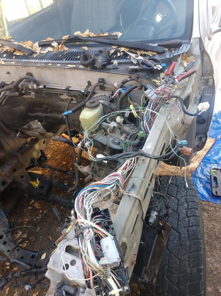

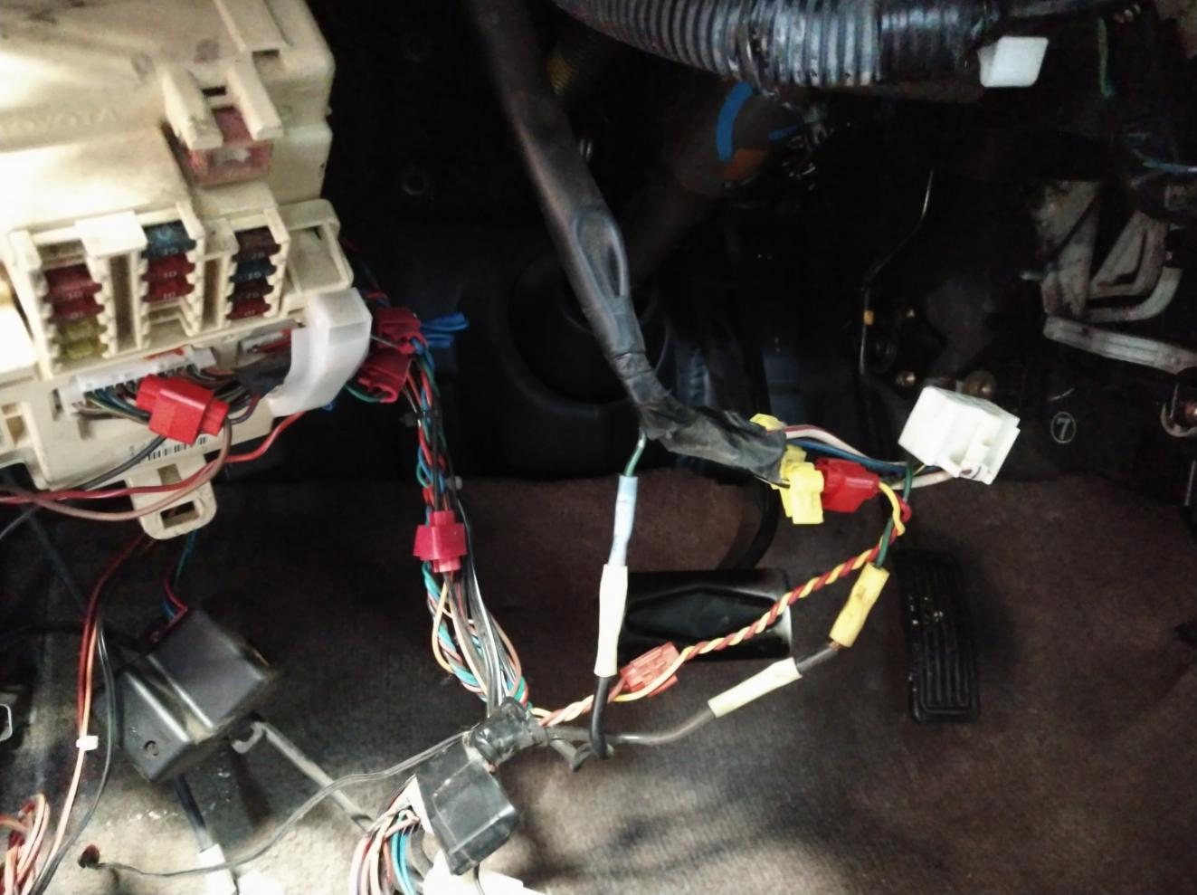

Those hubs look OEM. They just stay sparklingly clean under that dust cover. The uprights/knuckles do look pretty rusted, so I'd use your clean 2WD ones and swap over parts with new bearings/seals.
Don't replace engine seals unless they are leaking (probably just valve cover related parts). Trans pan should be sealed with RTV, not a gasket, and again, only if leaking. A little weaping out the top of the shifter holes on the TC and transmission isn't too unusual. I think Marlin has some parts/seals that may help there. You might need shifter seats for both TC and trans. Leaking on the output flanges is fairly easy to fix too.
The driver's side harness in the engine bay is different between 2WD and 4WD. It is only 3 wires and a few grounds, but it is different.
You may need to swap the dash harness to get the plugs for clutch cancel, etc in the harness. My '99 2WD dash harness had the ADD plug and 4WD signal wires, but nothing for the manual transmission that I could find (didn't bother me, I stayed auto).

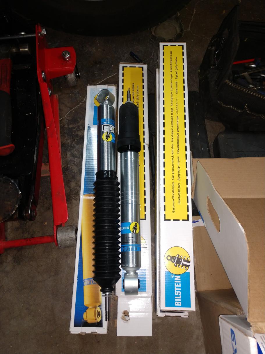

As a little note, picked up Bilstein 5100s for all four corners from....home Depot. I didn't believe they sold them, but with free ship to store and a pretty good price (384 with tax) I figured I'd give it a shot!
Also grabbed some replacement instrument cluster backfaces and 2.5 inch poly spacers from low range off road. The spacers should keep the rear from sagging and looking unbalanced with the 5100s set to 1.5-2 inches of lift in the front. I will probably replace the springs and spacers with other springs later, but this will suit the build for now.

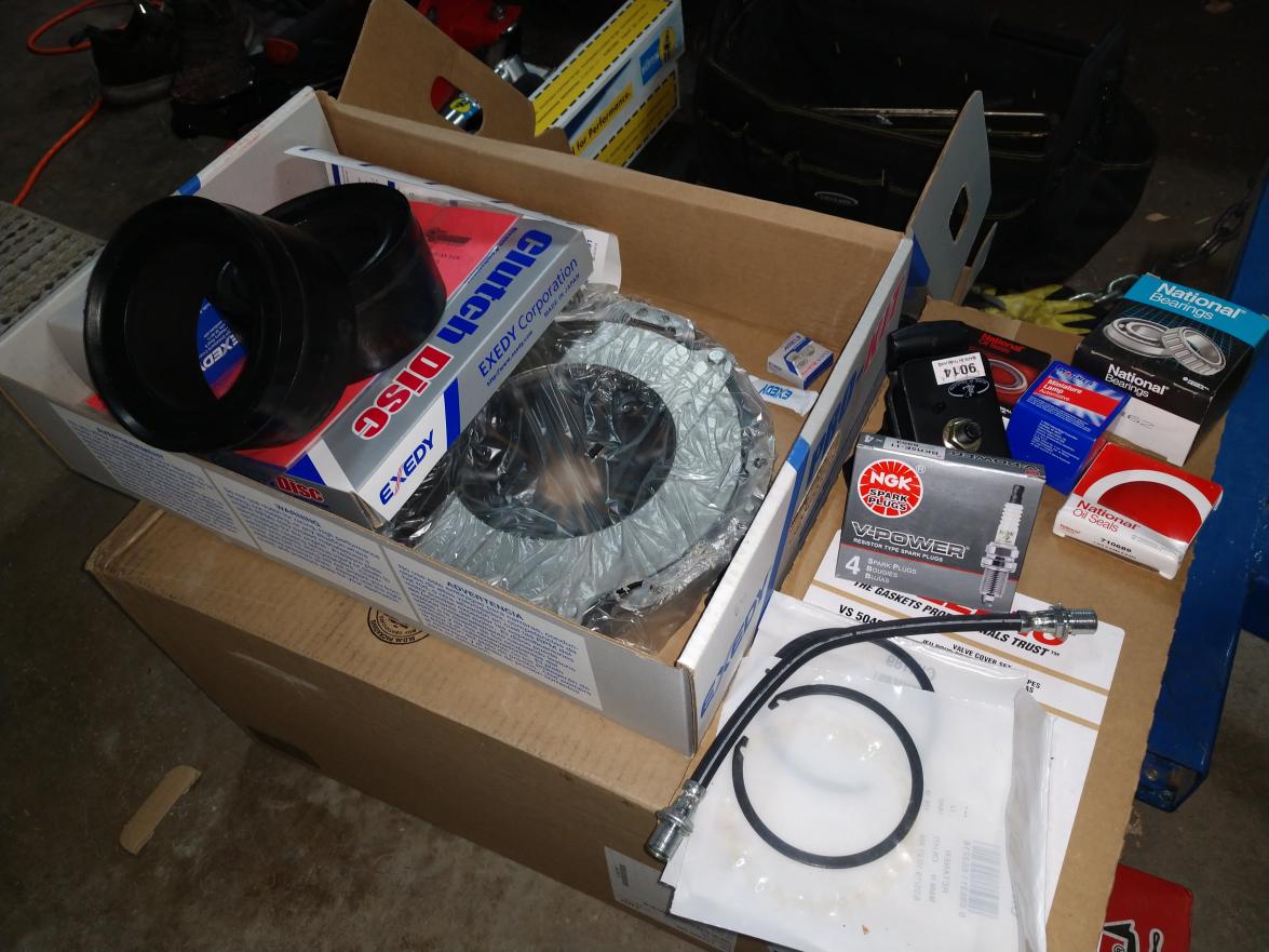

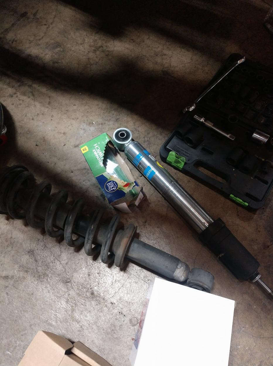

New parts day. Few more things like the trans mount and various bolts I ordered that have to come in, but it's almost all here.
Clutch kit , some gaskets, some bearings, new shocks, 2.5 inch spacers from low range off road, clutch line, spark plugs, new bulbs for the instrument cluster, and more!

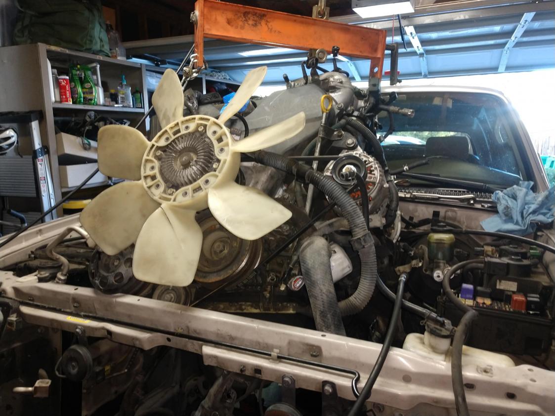

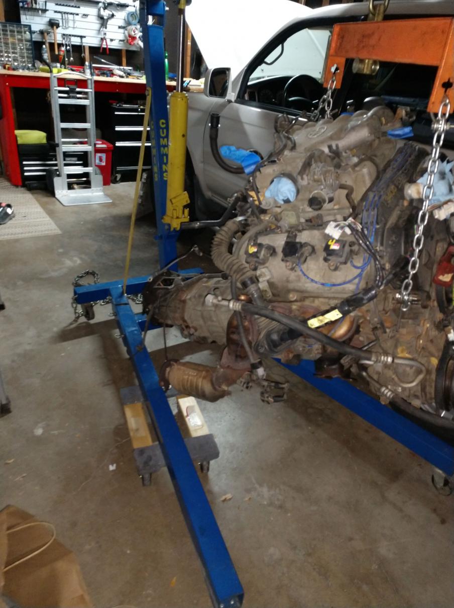

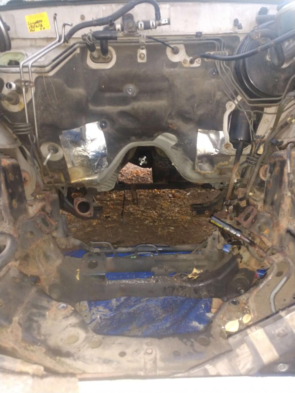

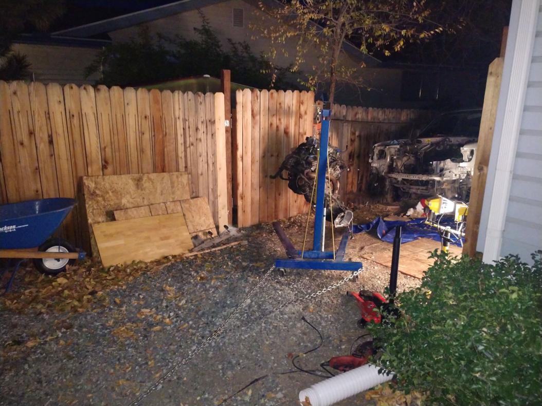

UPDATE:

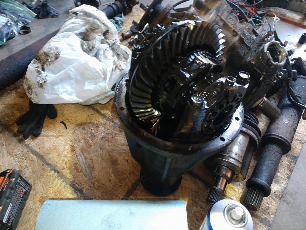

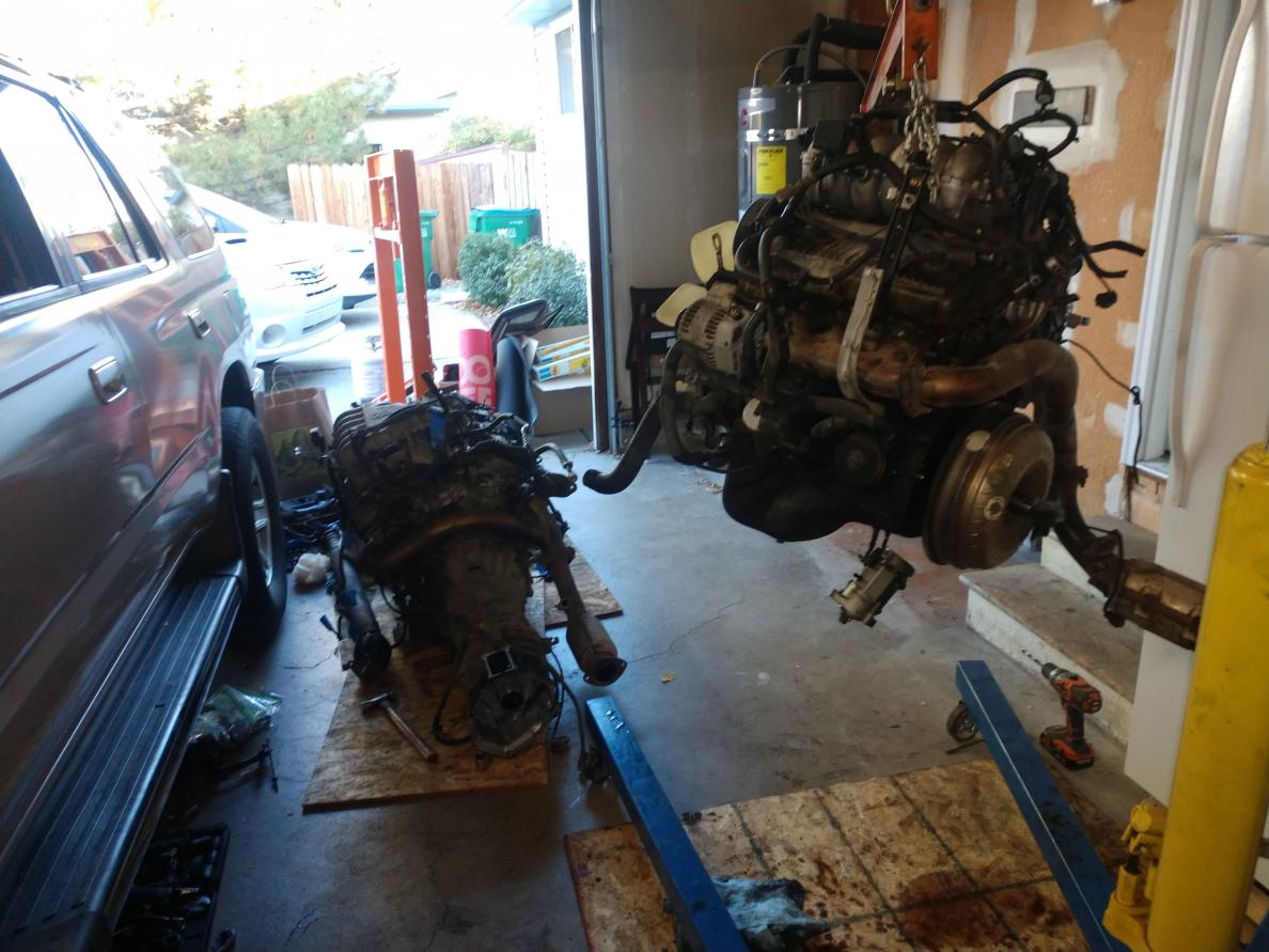

had two full days to do work on the 4runners, so I got a lot done. Removed the 3rd member of the donor truck, along with the ADD wiring from the driver side wiring harness.

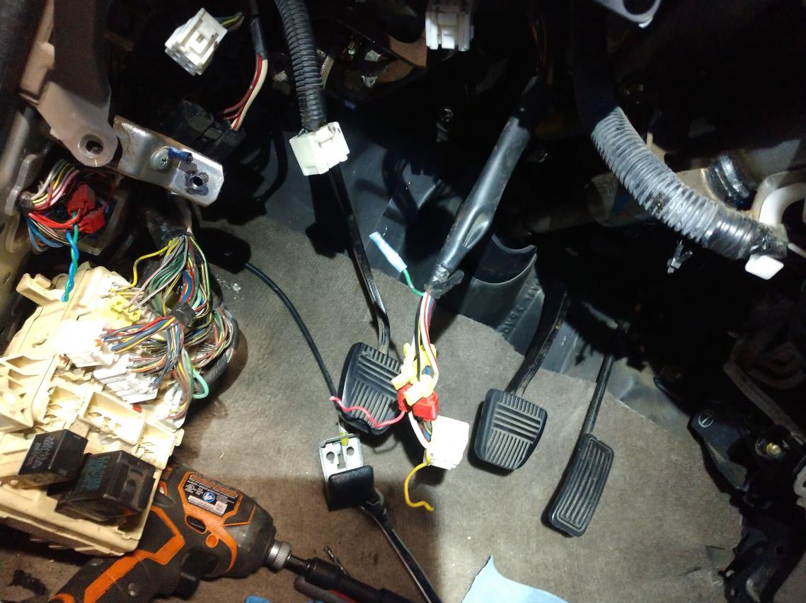

Ive still got some wire tracing to do for the clutch cancel and the clutch switches, but im thinking thats all I really need to mess with. Because im swapping the whole engine/trans combo into the other 4runner (including wiring harness and ecu) all of the wires to the transmission are there-just need to see if they actually work with the existing wiring.

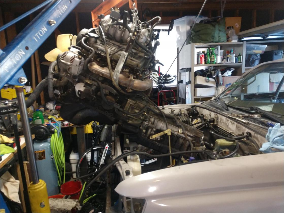

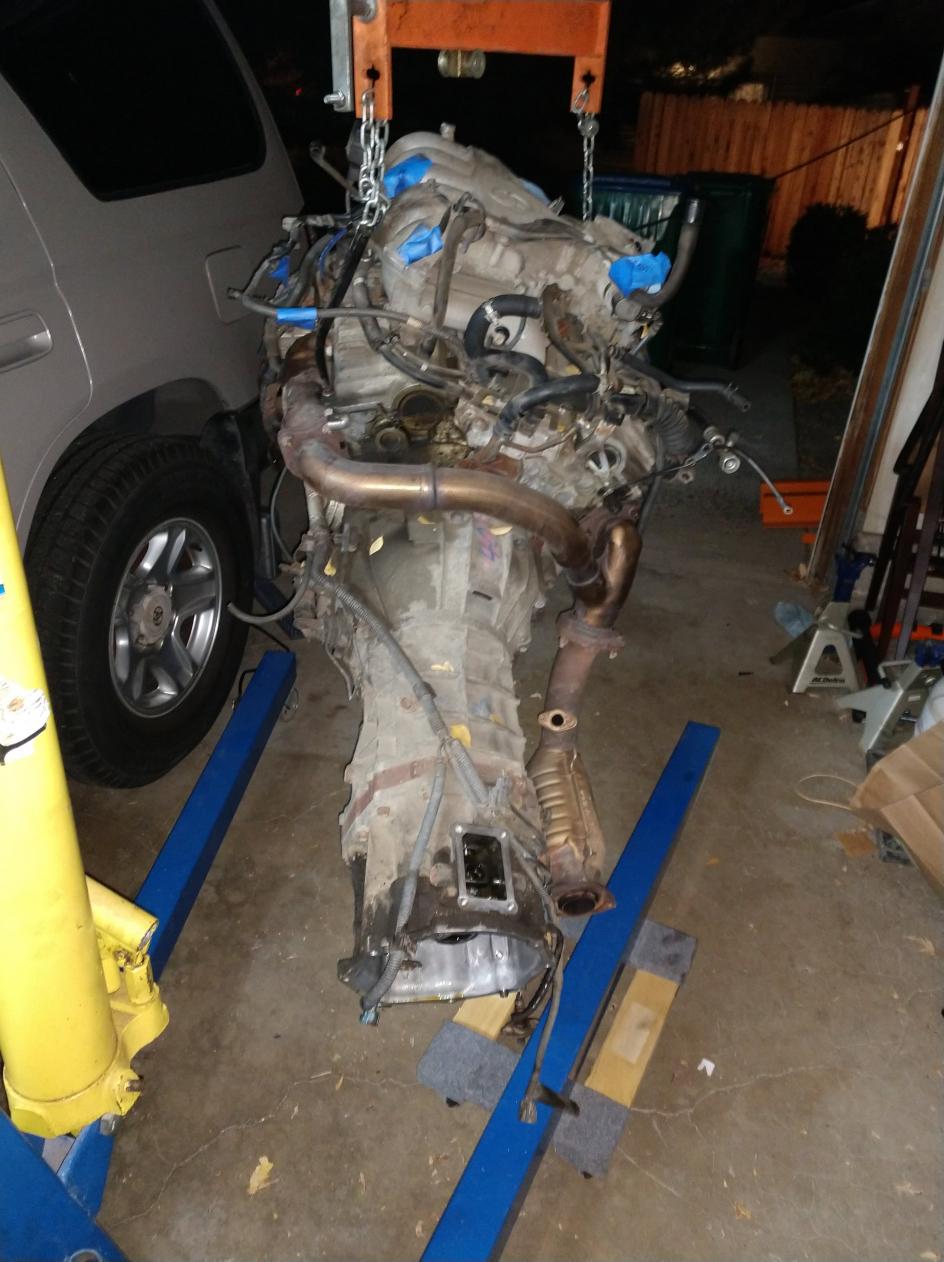

I remove the engine, trans, and started on the driveshaft as well. The engines are now both sitting next to the 4runner to be worked on. I sold the auto trans to someone so that is a nice few bucks to go towards wheel hubs and bearings.
I pulled the trans and engine as one as seen in the photos. tight fit, but with the engine tilt mechanism thing, it wasnt bad. I did all of it solo with no hands to help and it took me no more than a few hours to prep and a few hours to pull.

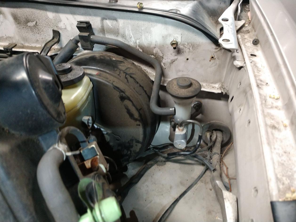

Installed the three pedal setup, and started removing the chaos that is an aftermarket security system. Only one wire seems to run through the unit, the rest are wire Taps. Gonna splice it back together and should be good.
Installed the master after cutting a hole in the firewall. Made a paper gasket after tearing the old one.

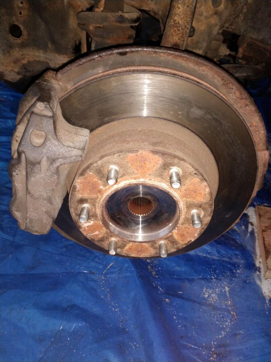

Bought Koyo bearings at Napa and new 4wd hubs...the spindles on one side are removed and I'm working on the right side today.
Changed out the 3rd member and sealed with gray rtv, hoping I did a good job on it. Cleaned with a razor and break clean before application.

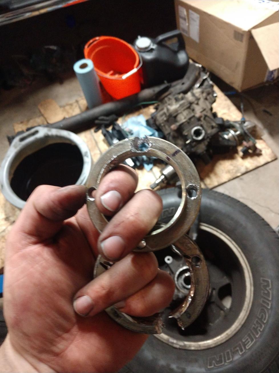

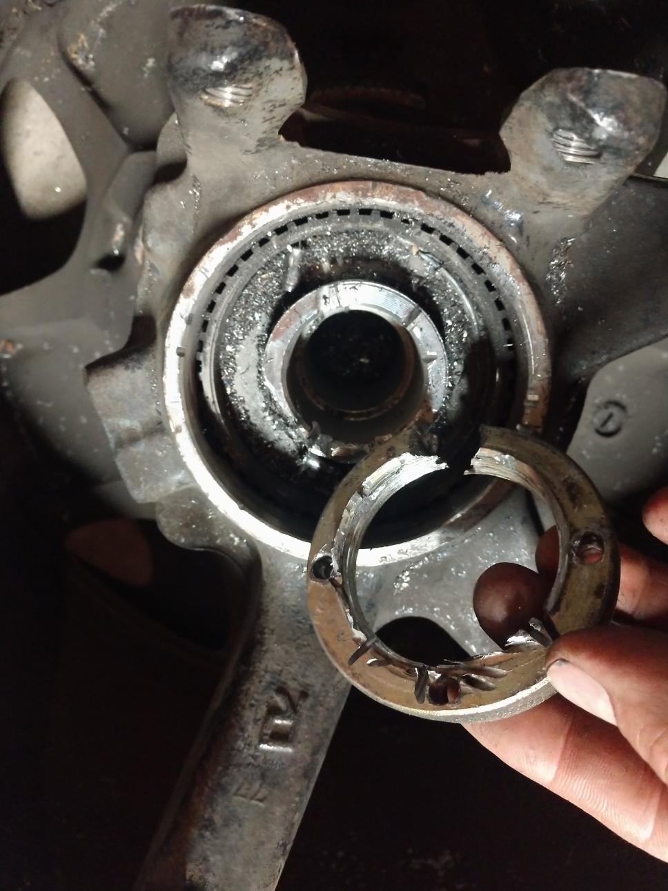

Well, I was until today. I am trying to press the wheel bearings out with my press and old rotors. Well the rotor shattered from the press (wheel bearing not budging.) So I'm thinking of what to do...
They can be a real pain is the a**. Were you able to get the tone ring off? If it's only the bearing, did you remove the snap ring?
This, and if using the 2WD knuckles, is the lock ring removed?
-Charlie
I'm a big idiot. I didn't realize that was a threaded lock but in the 2wd hub as I was using my 4wd diagrams.....well 100 dollars later and several hours later I've ordered the 4 pt socket and new rotors for the 4runner .
Now I've got a beat to hell lock nut that I tried to hammer out without the tool ( no luck) that il be hopefully removing Saturday when the socket arrives.
If it strips out of the OEM holes il drill some more.
Luckily only one side is so beat up.
Either way, today was a waste of time ...goes to show how using the right manuals saves you time and money.
Tomorrow I'd like to do the things I planned on doing today, as none of it was accomplished (with the exception of the hubs, have to wait for the tool now).
As referenced in post above, I'm an idiot. I did NOT remove the 2wd lock nut.
Sometimes I wonder if I should be allowed to work on anything.

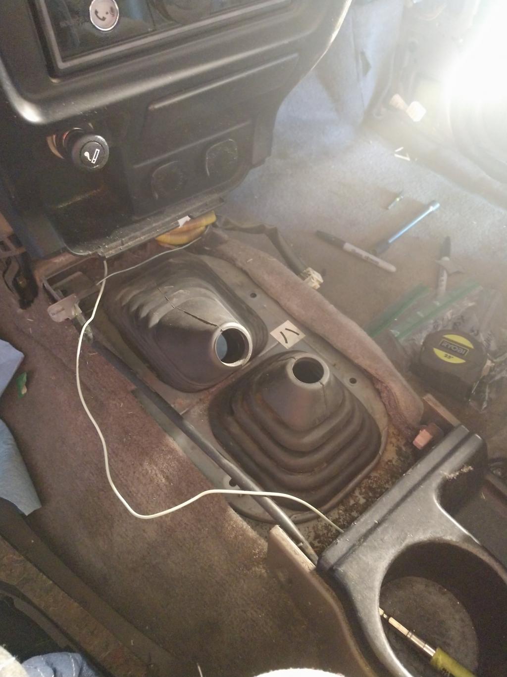

A good productive day.

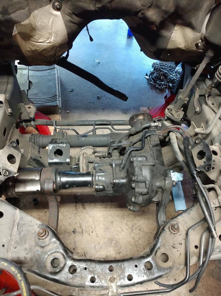

Cut off the Frame crossmember horns from the donor 4runner and cleaned em up nicely to get ready to weld.
Made a template for the shift boot cutout and cut out the hole in the 2wd 4runner
Trimmed the rusty add metal lines and ran new vacuum hose
Installed front differential and front driveshaft

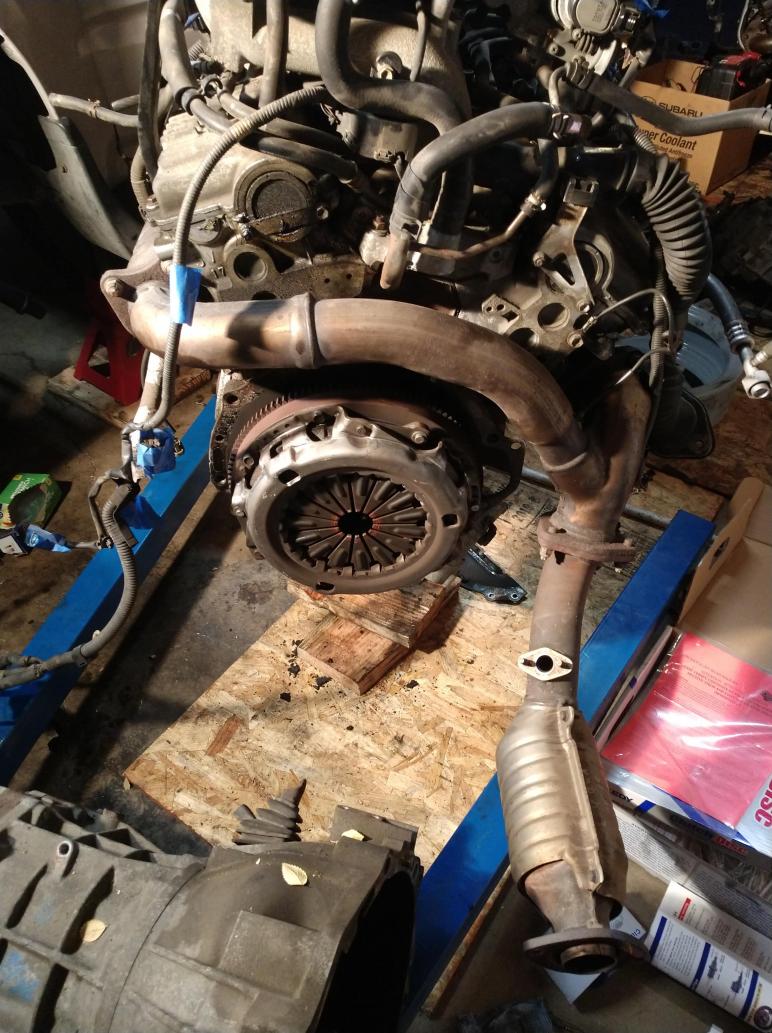

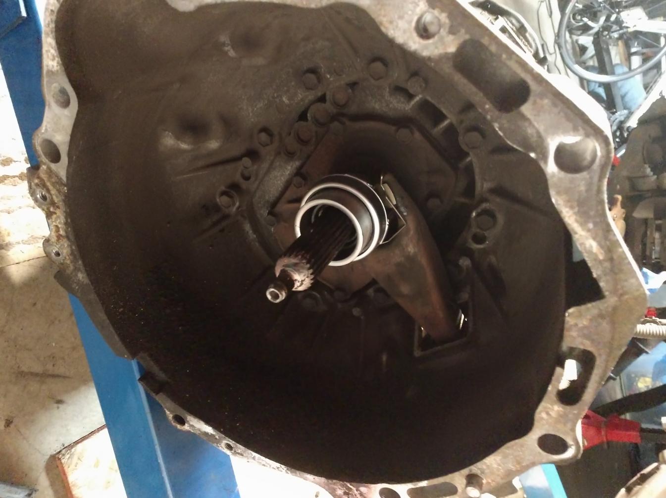

Removed clutch and reinstalled new exedy clutch, throwout bearing, pilot bearing.
Trickiest of all of these jobs was the grinding of the horns as the angle was difficult with the grinder.
I also had to use a mixture of a sawzall, Dremel, tin snips, and a hacksaw to make the cut for the shift hole.

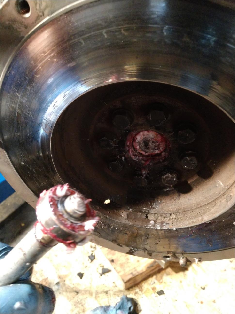

The second trickiest was getting the pilot bearing out. I used the toilet paper soaked in water trick and packed the hole full and hit it with a clutch alignment tool, repeatedly packing with more toilet paper until it was moving bit by bit. THEN... I added more! And repeated. Got it out in less than 10 min.
Sad thing is the clutch was also exedy, and looked fairly new. I saved it so il probably try and get a few bucks for it if anyone wants one on the cheap. I compared thicknesses and it was damn near the same. I figured I may as well change it anyways, but hopefully my loss is someone's gain.

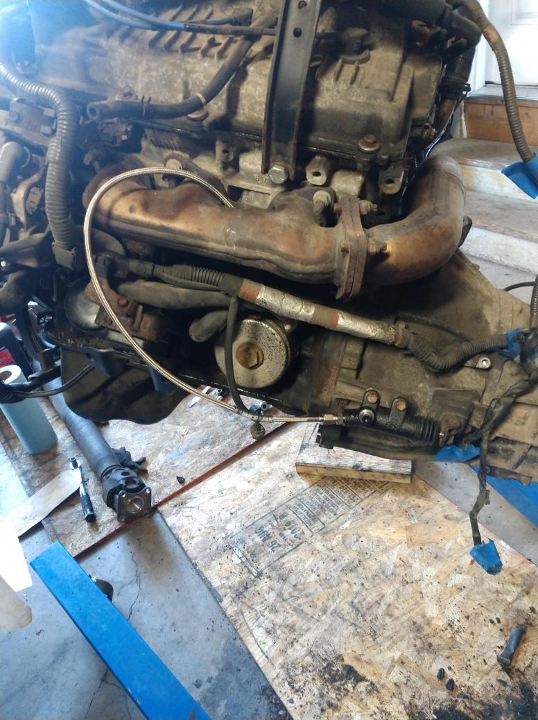

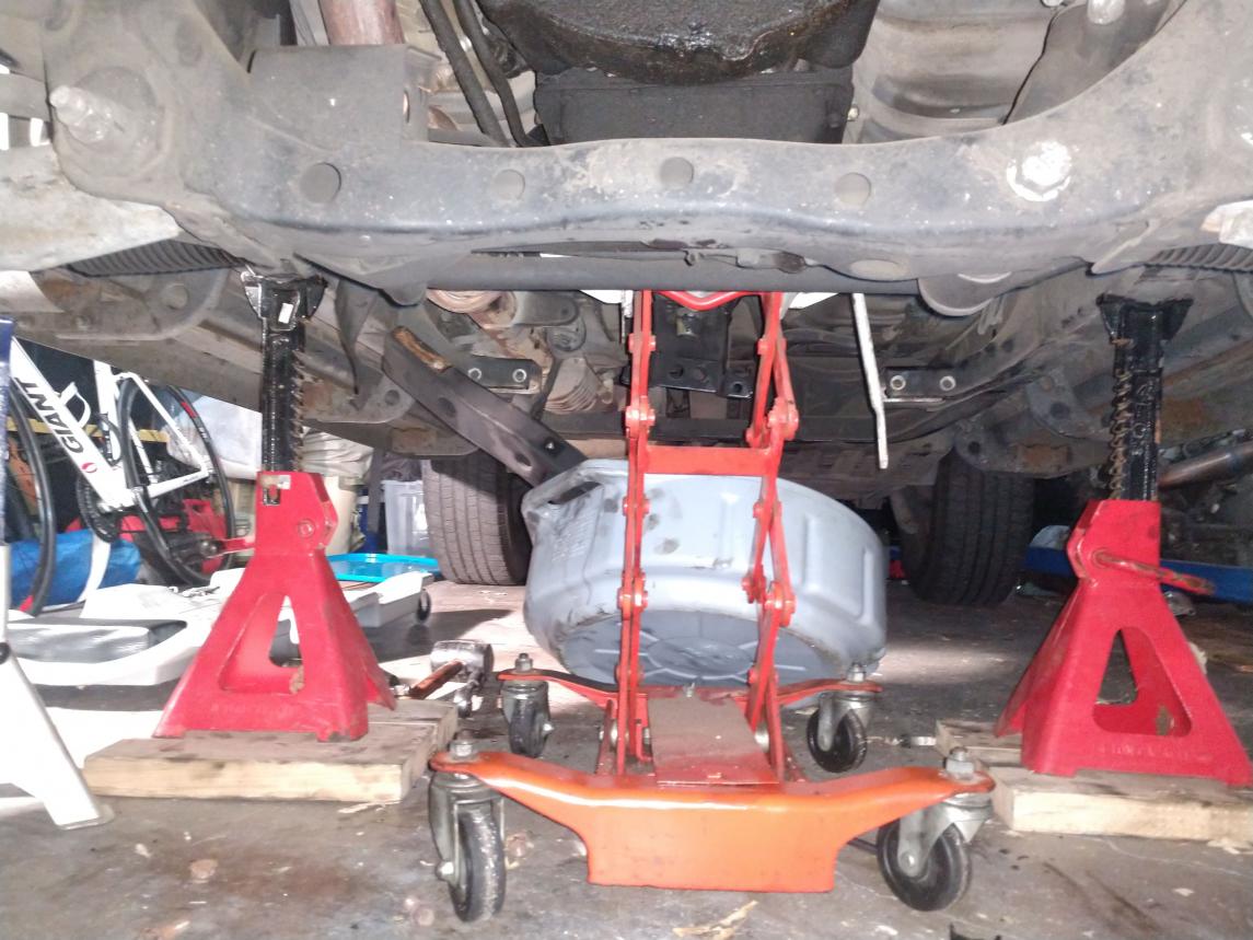

Busy day..got to work on the 4runner for about 7 hours on and off. Fit a quick two hour mountain bike ride and a beer mid day which slowed me down, but was well deserved.
Today I started by replacing the slave cylinder. Was going to reuse the hose until i found it was so rusted it wouldnt even rotate in the fitting-so a quick trip to summit racing and I was able to get the exact stainless hose I wanted in the length I wanted...for super cheap!
While I was there I picked up aisin antifreeze, a new oil filter, and some 8.8 bolts for the driveshaft.
also picked up two new upper strut mounts (front) a loaner spring compressor, and some oil.
I replaced the line with stainless line and will not be using any hard lines if I can. I do need to get one 90 degree fitting and some clamps to drill into the body to keep the line from flopping around, but napa had these for pretty cheap.

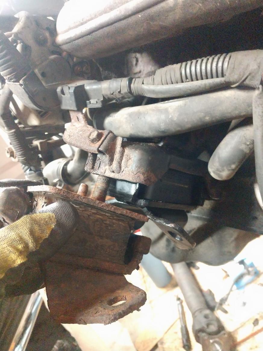

Once the slave cyl and lines were in place I moved on to the motor mounts...after several slow wrench turns due to the rusty mounts, I got them both free and replaced with new beck arnley rubbers.

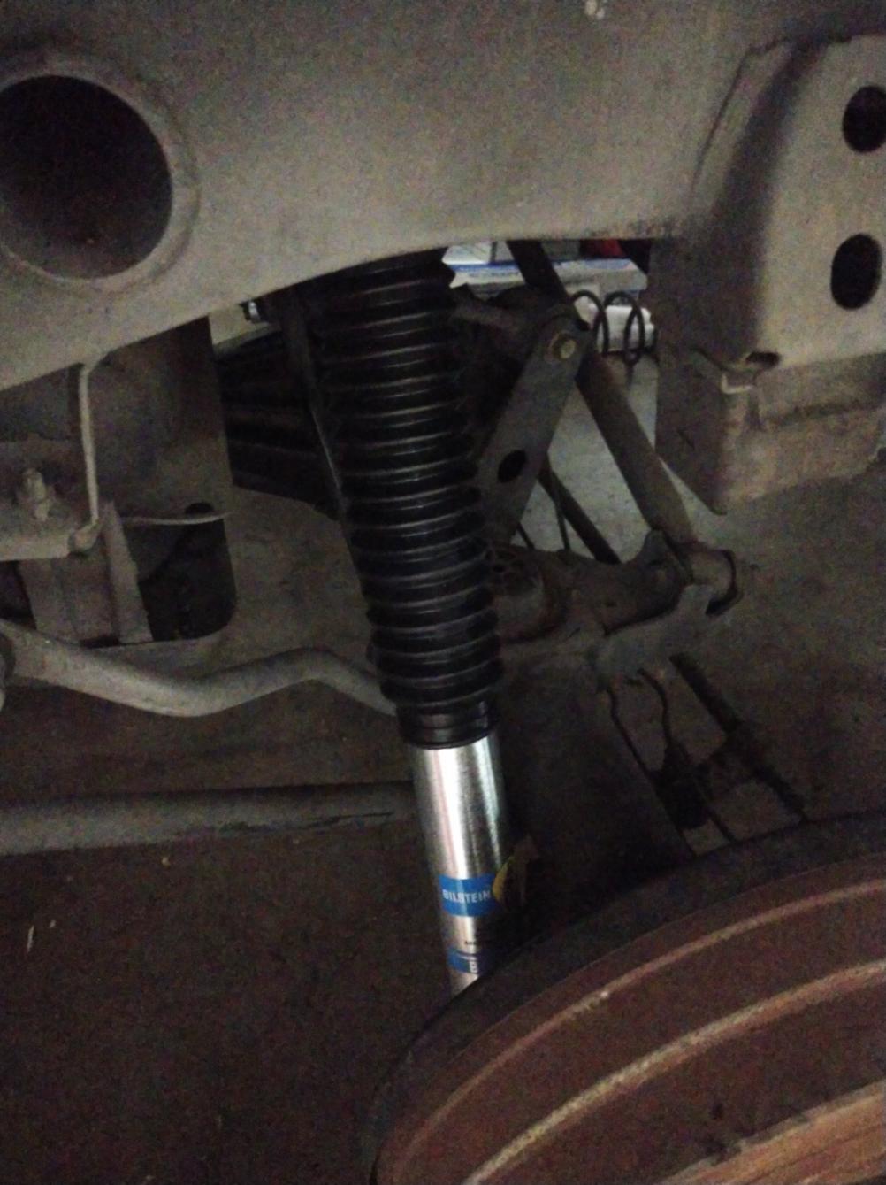

Started removing the suspension so I could change the shocks out and add the spacer. Removed all shocks/struts and installed rear shocks. Going to finish that tomorrow-with the spacer the spring compressors are definitely needed to make it a one man job.

I figured why not take it on before calling it a night-which I quickly regretted. It took me over 3 hours to get both threaded rings removed (EVEN WITH THE TOOL). they were so snug due to years and miles of use that i was using a 2 foot breaker bar and SLAMMING it with my rubber hammer which was giving me 1/2 an inch of rotation each hit. After 45 minutes I got the first one off which was a relief.
The second one however, this one took over two hours. Not only was I having to beat my breaker bar into submission, but the great force from my might hammer (or not so mighty) caused my hammer to split in half in the middle of the wood handle. Well this wasnt going to stop me, so i grabbed my hydraulic jack handle and began beating it into submission.
BUT WAIT...the pins now started to fall out of the socket requiring replacement with a hammer every 3-4 strikes with my almighty tube. "OKAY" I said. patience will lead to success. I kept hitting at it and was slowly making ground for at least 1.5 turns...and then nothing. It was frozen. nothing I could hit it with would move the ring. I accepted the fact that this would now be a surgical procedure. Grinder surgery.
I ground out angles that I thought would work well. I couldnt do exactly what I wanted because I didnt want to damage the outer housing too much, even though it isnt necessarily important (structurally, sure). After grinding away and hitting away, and grinding some more, I still couldnt do it.
So I decided to split the ring. I got my drill and bored out one of the holes until the ring broke in half. I then forced it open with a hammer and old screwdriver. Slowly but surely, and about 15 minutes later...IT WAS FREE.

Installing wheel bearings now....do you lightly Grease the outer surface of the wheel bearing? Or is it dry pressed in?? Is assume lubrication, but no mention in manual...
I used grease to lessen the amount of force for insertion.
