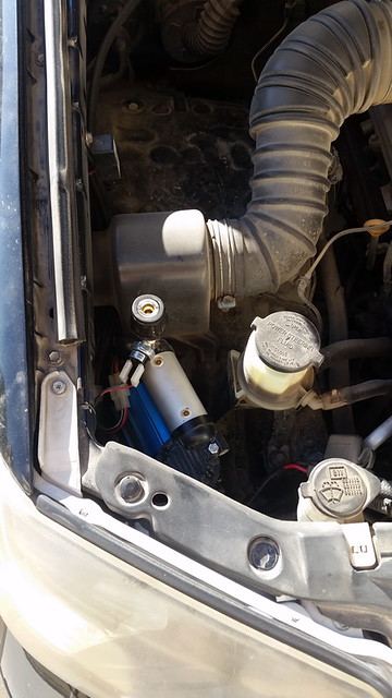

I have a ARB Air Compressor (CKMA12) that I plan to shove into my 08 V6 SR5. It is the medium size one. I have been poking around a bit in the engine bay looking for the best place to mount it. I am leaning to mounting it vertically in front of the passenger side headlight. It looks like it could also work by the anti-lock brake system. If you don't plan on doing a second battery ever, the area above the passenger wheel well has tones of room.

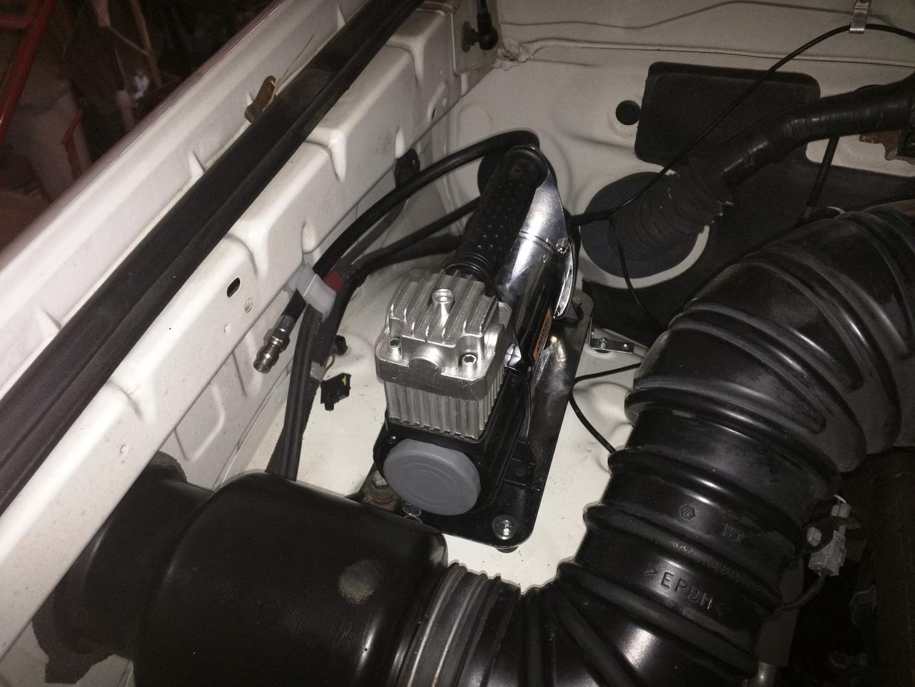

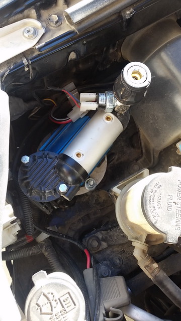

I mounted the same compressor in my 4Runner (V6). It's mounted horizontally behind the passenger headlight. No problems in that location.
I've been trying to sort out what I wanted for OBA but if the CKMA12 fits where you say it fits, then I might have to switch gears...
That's about the only place I have left for accessories right now.

My install looks just like [MENTION=127401]Krayziekid[/MENTION] (same unit as well). I've got a V8. I'll tell ya, it's tight. I had a mount made by a guy here on the forum. It's up sort of high. Level with the airbox. It makes getting to the dipstick just a little harder. I get my oil changed at valvoline (gasp[emoji50]) and they usually have trouble finding the stick. I had the mount made with a tank in mind but then decided against the tank but didn't consider mounting the compressor different. If you're not going to do a tank, I'd mount it vertical with the filters up. Provides easier access to items adjacent.
100% agree with all of the above. V8 is tightttttt. Got my mount from Bandi, who is active on here and the FJ Forums.

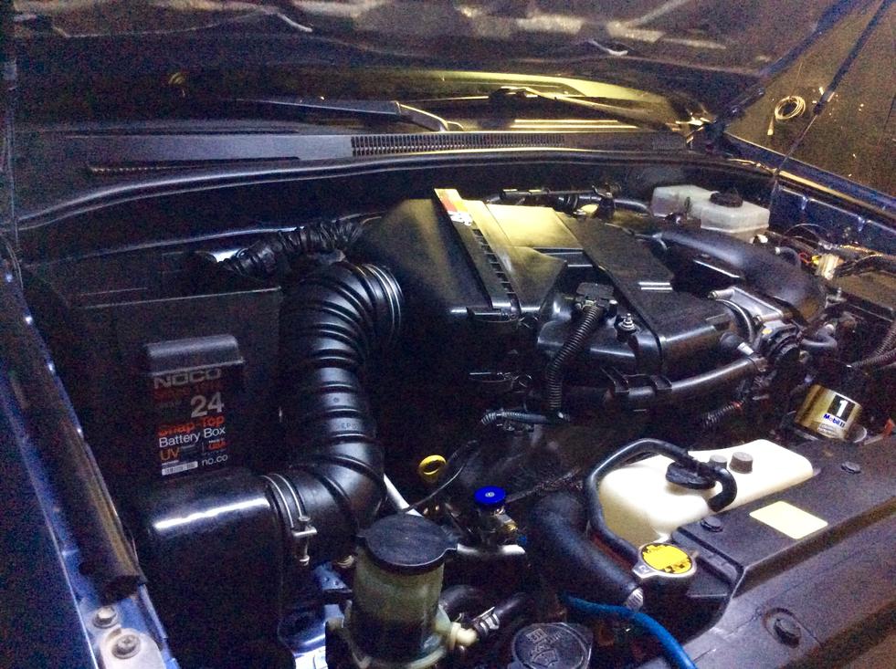

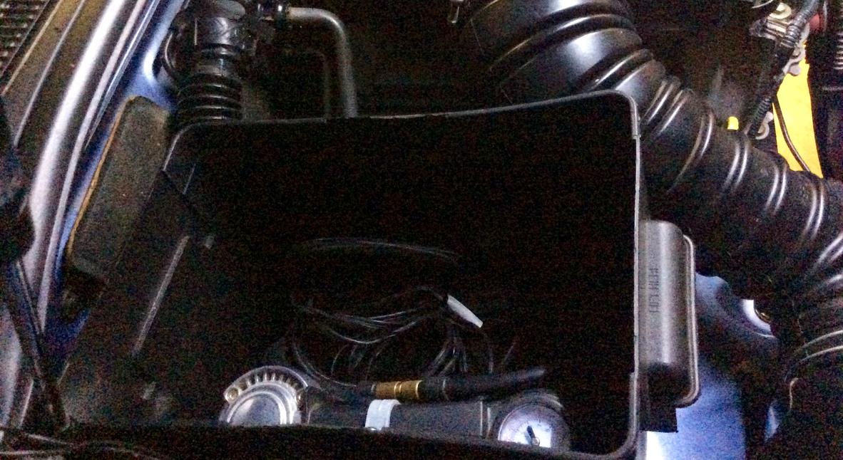

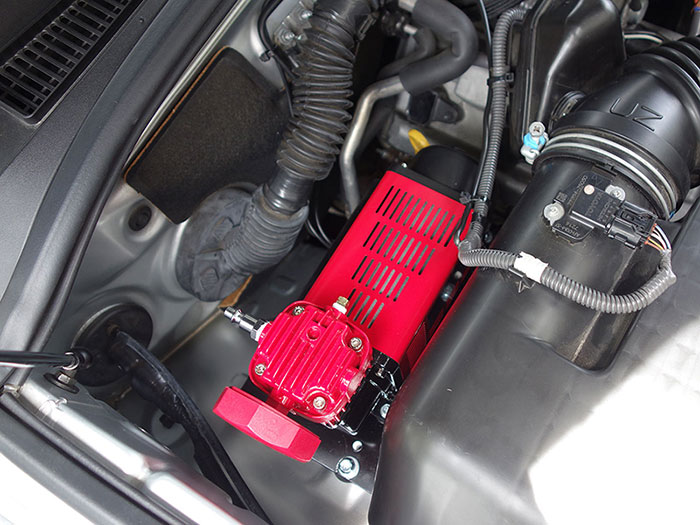

Mounted in the same spot but I bolted down a battery box then mounted compressor to battery box. This allows meet to throw hose line and power cables inside as well and it keeps it contained from all the elements

Same all around. [MENTION=125603]bandi[/MENTION] mount. Super tight. Wanted tank but based on how tight, skipped and don't think I can do one now based on the design change Bandi did to fit the unit. I don't know that anything smaller than a gallon is worth it and the gallon tank would be too tight. I figure you could remote locate the tank, but where? Maybe in front of the airbox? Else a long skinny tank on a frame rail.

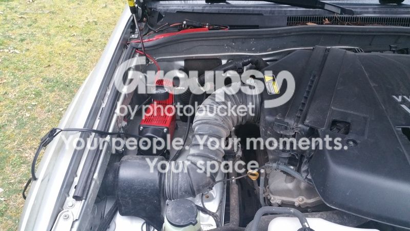

I finally had a chance to take some pictures...
You'll have to excuse the dirty engine bay. My 4Runner actually gets run on the trials unlike [MENTION=117408]Oneluv13T4R[/MENTION] 's pavement princess with a detailed engine bay!
Here's my cheap Harbor Freight compressor.

If you mount it vertically, you might be able to get a bigger unit in that space. I had to orient the unit diagonally to maintain a small amount of clearance in two spots. I was pleasantly surprised by the compact size of the compressor for the modest performance (and price) and the fact that it fit in that spot. I wanted it in the engine bay and I didn't want it behind the intake so I can add a second battery later if needed. I fabricated an isolated mount to reduce vibration and it gave me a little more clearance. Of course, that compressor isn't going to flow the amount of air the CKMTA12 compressor will, but for the size, price, and reasonable performance I've been happy.

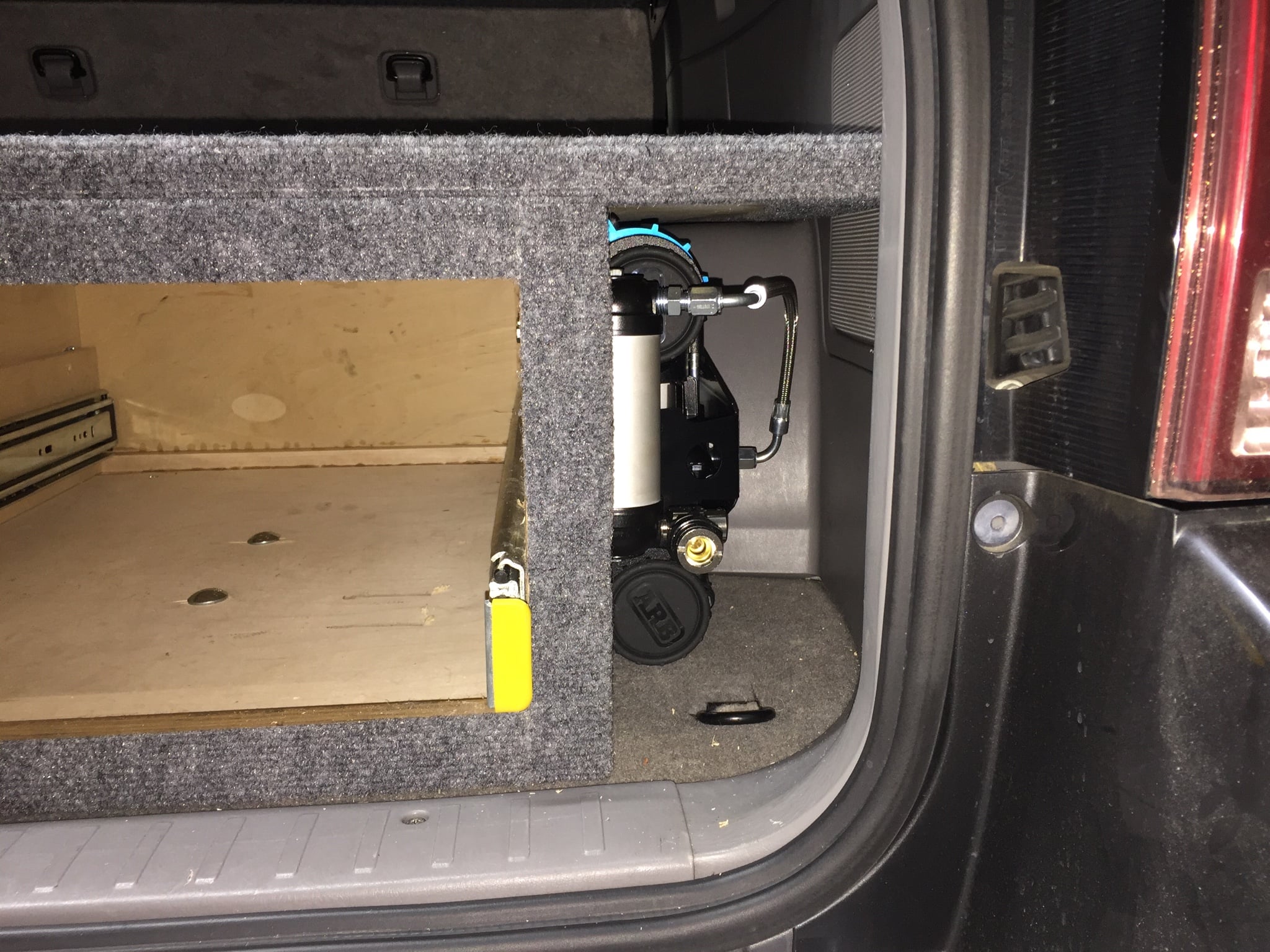

built a box for the rear and tucked the compressor with manifold for lockers in the right rear corner
