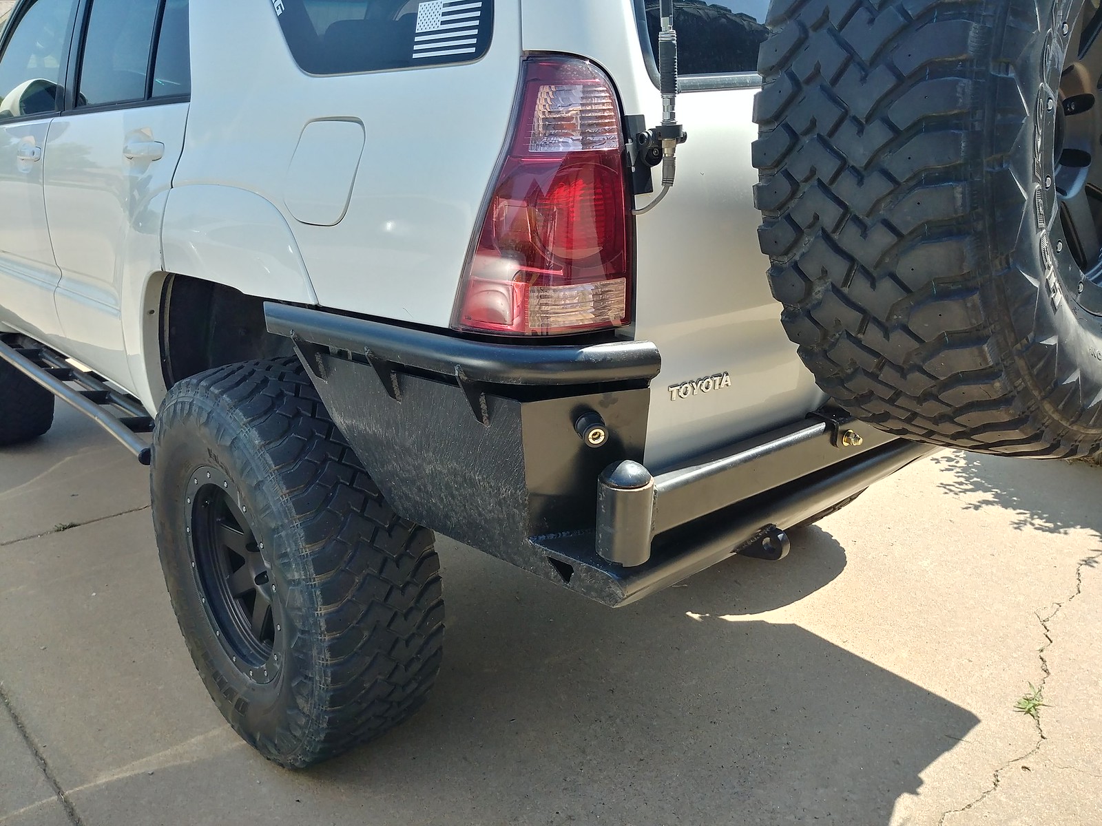

I used an ARB quick disconnect system for my truck mounted through my rear bumper. Has worked really well with a coiled hose I can reach all my tires.
I've since added the ARB cap to it after taking this picture.
