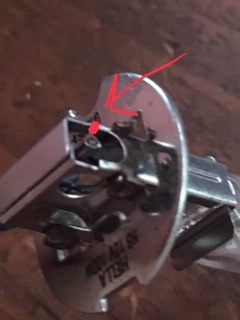

Looks like both bulbs were defective. Short found at base of bulb itself when removed from housing.
Pic shows where I bent it back into place.
