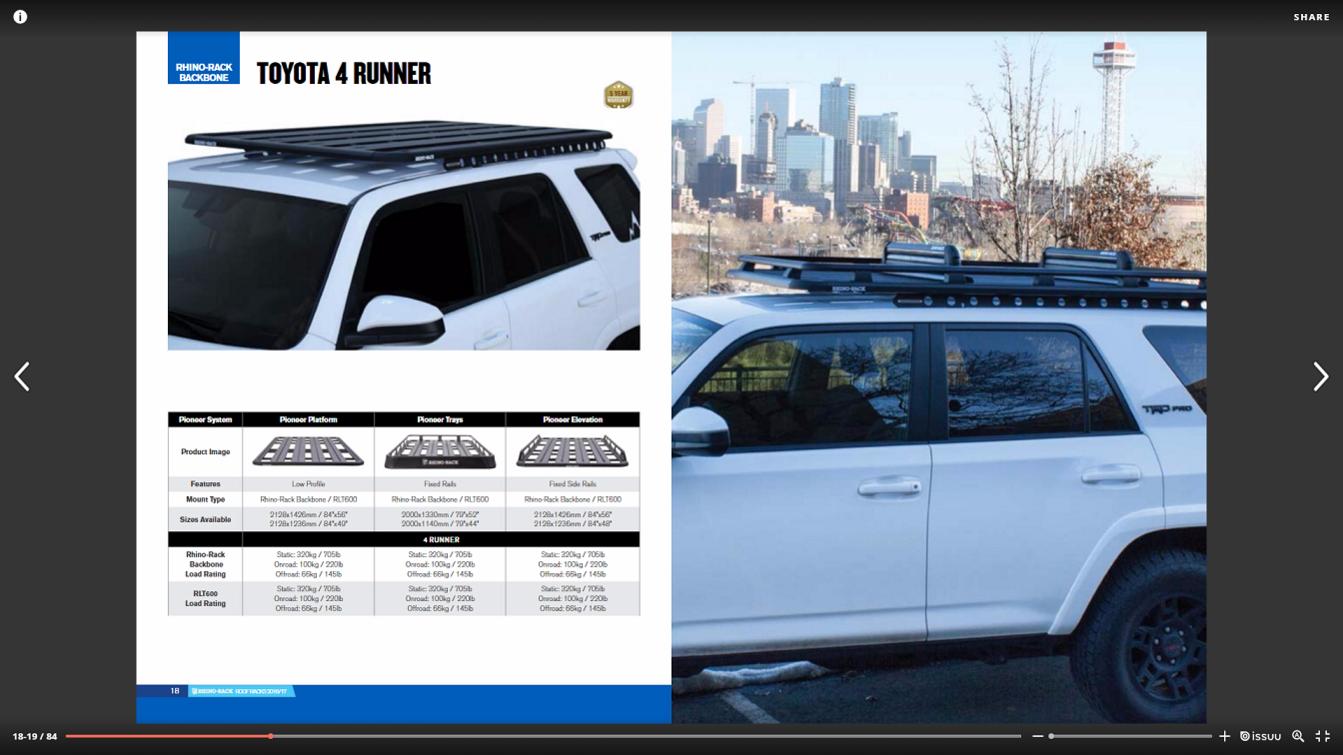

Rhino Rack info
Here is some info from the Rhino Rack online catalog with weights and mounting options.
