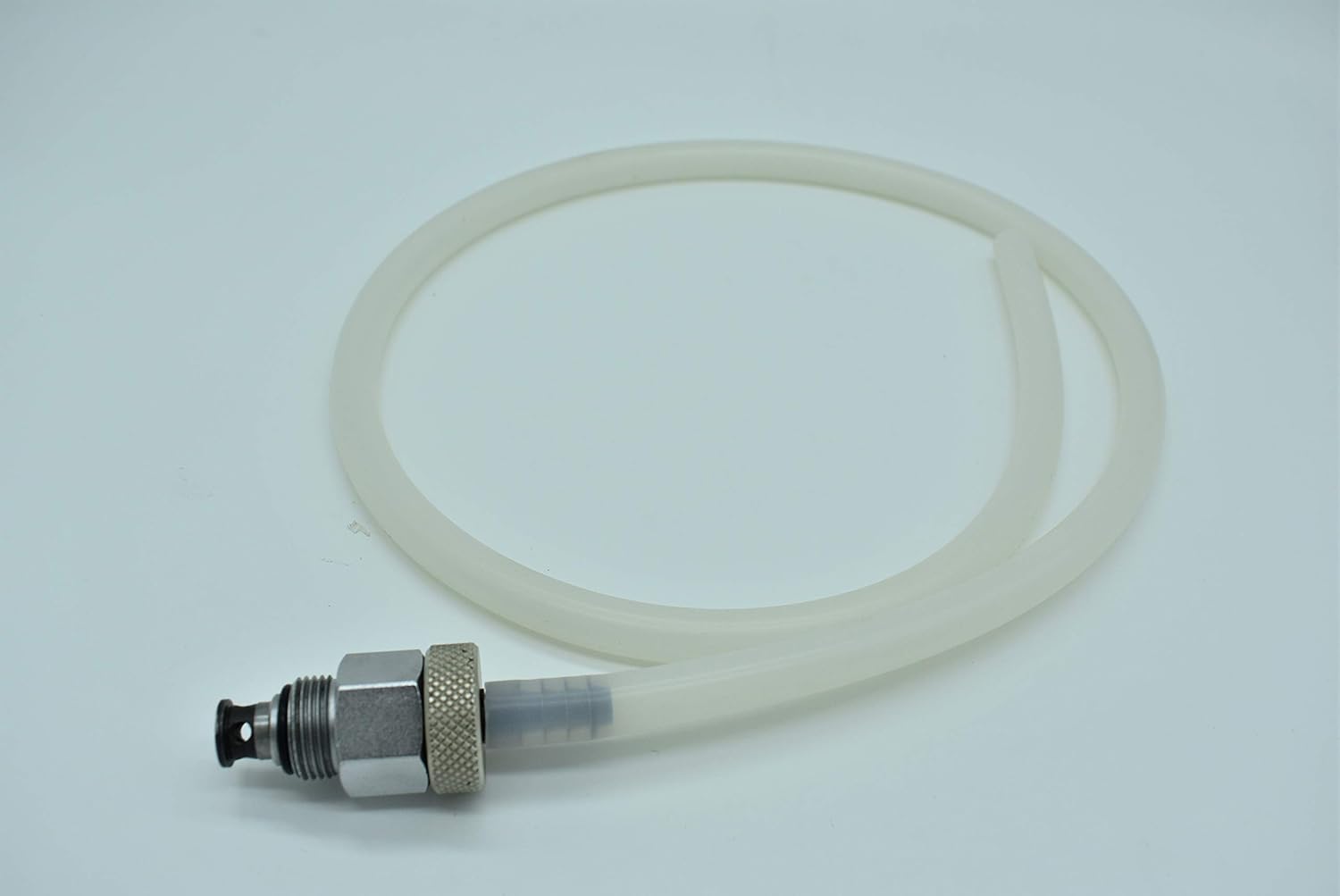

Use one of these nifty drain valves with a hose to cleanly empty the oil before unscrewing the cover. Far easier than wasting your time dropping the skid plate over and over when it has a nice access cover engineered into it. Simply screw this drain hose to the filter cover end fitting, open the valve and the oil drains right into your used oil container through the tube. :cheers:
With the cartridge housing empty of used oil you can unscrew it and replace the filter element.
https://www.amazon.com/JDT-TOYOTA-R...d=1564410753&s=gateway&sr=8-2#customerReviews
https://www.amazon.com/Motivx-Tools...rtridge+drain&qid=1564410753&s=gateway&sr=8-3

Copy that, actually bought one of those metal drain valve w/ hose, it is sitting next to the Toyota alloy replacement cap for the next change, will also swap in the Fumoto valve at the same time. Thanks.
