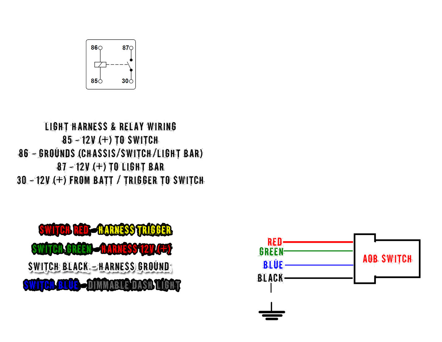

Ok so I just went through the same thing as TRD Tim. I installed my light bar with their harness and the AOB switch. I DIDNT tap into the cars harness for dimmable light (yet) because I don't like T-Taps and I want to figure a different way to illuminate. But, when hooking up the light like th AOB directions say to I was constantly illuminated no matter the status of the car. On off lights on or off didn't matter. I ended up switching the RED & GREEN wires to the switch and voila! It worked. The red went to the "trigger" to the LED bar and the green went to the 12V from the relay. The black went to the harness also which was grounded where the fuse block grounds out on the driver side fender. I will try to think of a way to illuminate the switch, maybe not dimmable and use an add a fuse. Best of luck. If you need anything let me know and I can take some pictures or draw one for you.

Interesting update. Diagram or pic would be great. It will help others with similar issues.

OK, so this isn't my best work, but Im doing this at the same time as getting ready to wire up times square for the new years TV Broadcast. So I'm a little tired and unfocused. Ill correct anything I messed up ASAP. But here is what I have as of now. Happy New Year everyone!

I swapped the wires like TRUSTYAXE suggested and works as it should !! Thanks guys !! I should probably draw it up as I have it and post.
