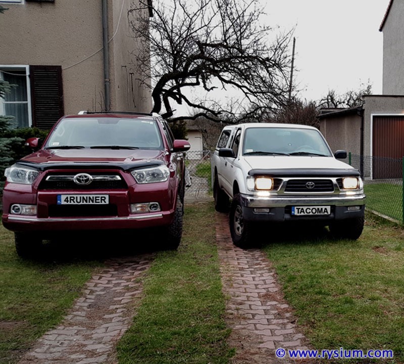

Here is the visual comparison of the actual color of different lights. It is in my Tacoma, but should give you the idea:
Sylvania SilverStar halogen headlights - 4000K
Osram LEDriving PX-5 DRL - 5200K
T10 LED Front marker - 6000K
You can see that 5200 DRL are quite close to Sylvania SilverStar. T10 LED at 6000K look ridiculous, but I can't find any T10 bulb with decent output at 5000K
