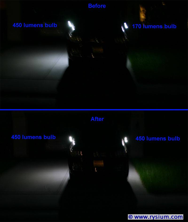

I found that all available LED bulbs are not up to the task for rear hatch and puddle lights, so I made my own bulbs. All described here: http://www.toyota-4runner.org/5th-gen-t4rs/206081-my-version-interior-led-lights.html
Installed cargo bulbs (480 lumens each, true 3W delivered to LED chips), that is total 960 lumens in rear hatch.
Installed puddle lights (450 lumens, true 3W delivered to LED chips) and comparison to biggest you can fit there: JDM ASTAR Extremely Bright 5730 SMD 194 168 2825 W5W T10 LED Bulbs,Xenon White (only 170 lumens).
And here is the comparison between original stock 5W incandescent bulb and my 450 lumens LED bulb.
