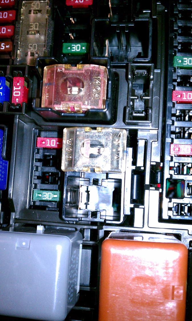

i'm trying to do the same thing. the original post is helpful but the setups are different for the 5th generation.
since i rock an SR5, there isn't a relay for the power outlets/inverter. the relays are in the engine compartment and, according to the diagram on the reverse of cover and manual, there is only a space for and 80A relay/fuse for the inverter.
this is where the jumper goes but i don't know how to do it: slide it over the contacts?
you can check out the picture.
any help would be appreciated.

I did a 12v constant on mod on my 5th gen, but because I didn't want to dig into the relay box which is fairly well up under the dash, I took the quick and easy way out. Cheap, fast, easy... Not /quite/ as nicely permanent as the relay mod, but I can dig into that some other time if I'm really bored :) This work fine for now...
http://www.toyota-4runner.org/5th-gen-t4rs/165542-warthog-build-adventure-thread-2.html
