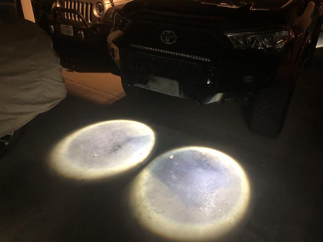

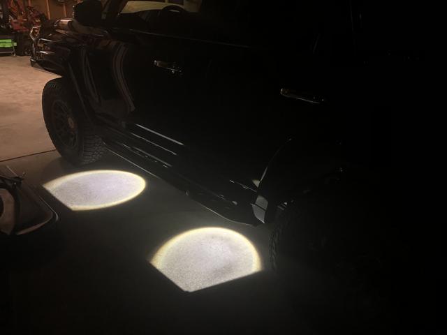

I have however replaced the 4 lights I got from Amazon with a Rough Country 4 LED rock light kit. Nice lights. Much brighter, but more focused light. More expensive, but still reasonable cost. I have the lights aimed more toward tires so there is a dead spot in the middle.

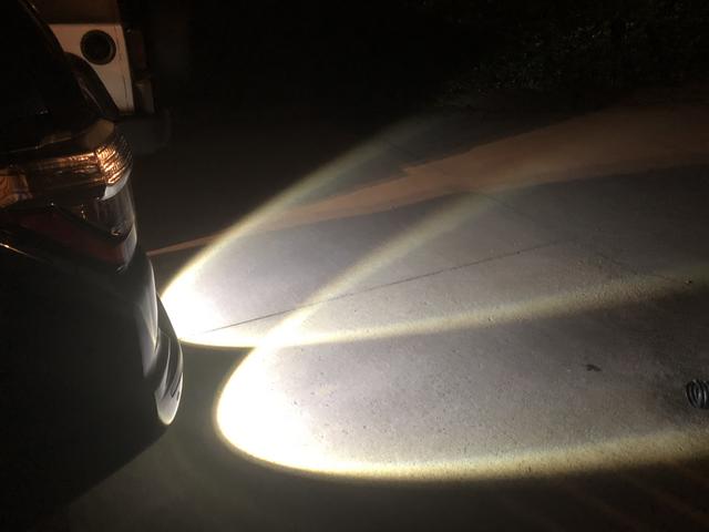

Also used another of the same 4 light kit for 2 backup lights in rear and 2 lights in front just for the heck of it. These are not on the puddle light circuit, but controlled by another circuit on my Switch Pro.
Puddle lights
Backup lights
Front lights
