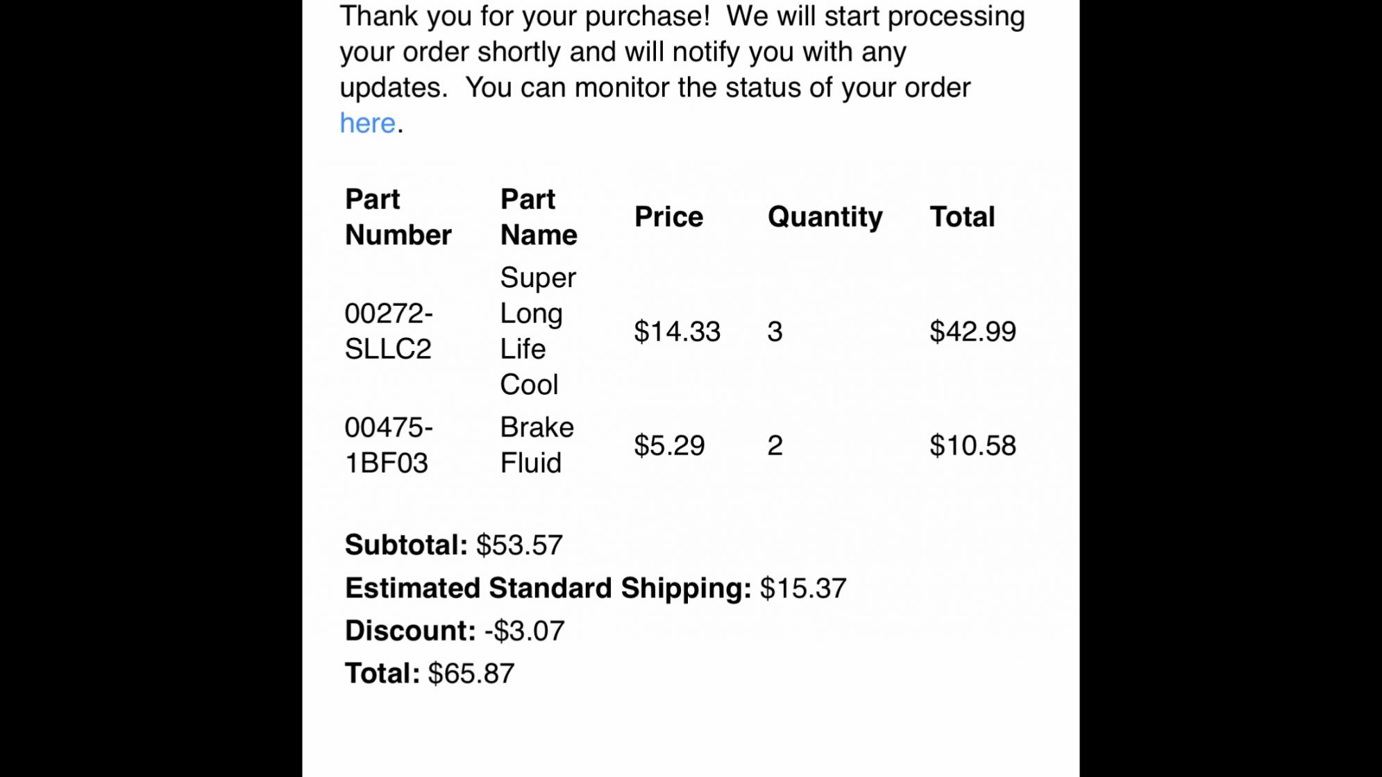

Good price at Walmart but it offers no store pick up for me. Over $50 just to ship 3 gallons. Got my 3 gallons from BAM Wholesale at $14 per gallon and shipping was also $12 with discount code for 3 gallons with 2 bottles of Toyota brake fluid that I also needed.

Well.
I overpaid....
We all have at some point or another lol.
