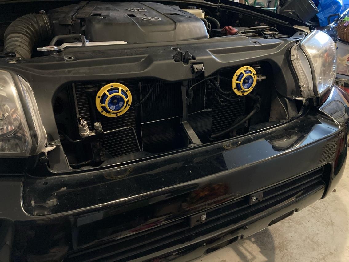

Now is the time to add a tranny cooler. The ATF flow is IN the top, OUT the bottom. Because its a vertical cooler. The fluid drains back to the transmission. Unless you are adding an external cooler, there is no need to top off the ATF.
BTW coolant is cheap compared to head gaskets. Buy two gallons and flush it now while you are in there. I go the extra step and disconnect the top heater core hose and blow compressed air to empty the core. Be careful to gently blow air in it, you dont want to blow out the core. When refilling, leave the top hose disconnected (engine off) until coolant comes out to purge air from the system. That is the highest point in the system.
I didn’t check the trans fluid level. I tried even tilting the radiator sideways and barely nothing came out from the two transmission lines. Maybe a drop or two if that. Your explanation makes a lot of sense.
With that said, does my base SR5 even have a trans cooler then? If the trans fluid doesn’t even pass through the center of the radiator it sounds like the transmission fluid is not being cooled at all.
I already put everything back together so unfortunately I didn’t drain any additional coolant or add the external cooler yet. My radiator only took about a gallon to bring the level back up. I drove it once after finishing the job yesterday so I’ll check the level again this morning.
Yes, the cooler circuit in your radiator is effective at maintaining trans fluid operating temp (and helping to warm it up to operating temp). The optional auxiliary cooler is fluid-to-air type and plumbs in after the radiator to spill off additional heat.
