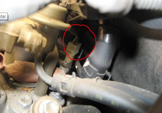

From what I read, the high idle comes from ect sensor sensing colder coolant in the morning. So, I am thinking I could heat up the coolant (with some external heat source) or maybe I should focus on locating the actual ect sensor and warm that up?
Appreciate any thoughts.
There's a pic of the temp sensor for the cluster gauge on post 11.
Thanks HiLife. I tried to attach that photo from Post 11 and red circle the sensor to verify I located.

I would like to add to this thread. I recently just picked up/bought a diamond in the rough. Mine is a 1999 4runner limited. Needs lots of little things. But did this rear sensor today and after pondering how to go about this all morning what I did was took the hood off set that aside then popped the heater hose out of the way and then if you get over top of the sensor you can see it and there is a relieve cut mad in the plastic for a socket to slide right down. Took my 12mm deep socket with a few extensions and took out the part went to the auto parts store got the new one and then wrapped electrical tape around the hex part (so once you put it in it won't side out/off) then put it on with an oversized socket tightened it down and started the truck up and sure enough it fixed my problem

We forgot about this and the temperature gauge wasn't working. We spent an afternoon tracing the front sensor wire and cleaned all the connectors and tested the voltages and resistance of those leads with no solution beyond confirming that the sensor was not at fault. Thank you so much for this tip and picture! We went back through our pictures and found one showing that connector dangling unconnected! Back in business!
Hey, sorry to bring a thread back from the dead but I'm dealing with this issue and I cannot for the life of me, find this sensor. This photo is helpful but without context its still hard to find. I'm looking on the driver side close to the firewall.

Ah ya thank you, that's the one in the front of the engine.
There's apparently a second one between the engine and firewall that is hidden away and hard to reach. It's the one that communicates the coolant temp to the dash gauge. Unfortunately, that's the one I'm having an issue finding.
The picture on the second page is pretty clear. Find the fuel lines, follow it back to the regulator (rear driver's side of the engine). The black mass at the right of the picture is the firewall. The bigger hose goes up to the heater valve high on the firewall... You will be looking in from the back corner of the bay near the driver's door.
I'm not sure which side is easier for physical access... hopefully you don't have to remove the intake manifold to work on it.
