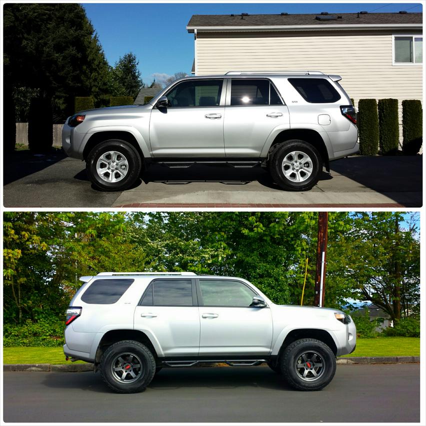

I have the ATP 285/70 on mine. Even at a 2.5" lift in the front it would rub at full lock on the mud flaps. After my alignment and getting as much positive caster it rubbed on the front bumper bottom corners. I had to push the fender lining forward and dremel off material from the bumper corners to reduce rubbing. Even after shaving off a good amount of the bumper I would occasionally get rub with load and going up/down steep angles. The + caster will do this as it increases your wheel base but it tracks straight at low and high speeds and under heavy breaking.

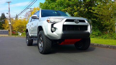

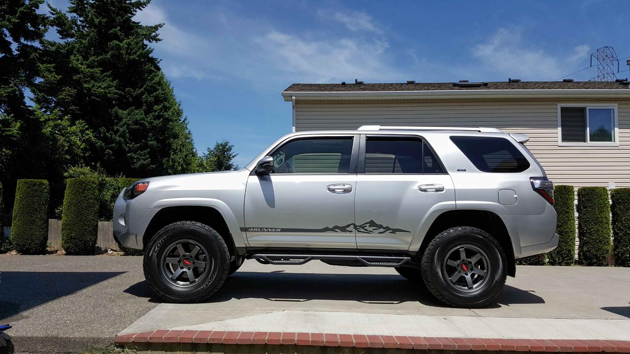

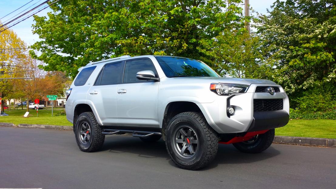

Nice looking rig. Mind posting a head-on photo, of the stance width? I'm likely getting this same tire/rim combo in October. Did you go with the -10 or 0 offset wheel?
Offset is 0. Don't have any head on pictures but these are close enough. Though I have never tried the AT3's I have nothing but praise for the ATPs. They are great in dirt, gravel, rain, and snow. I have not tried them in mud though. My buddies vouch for the ATPs as well.
