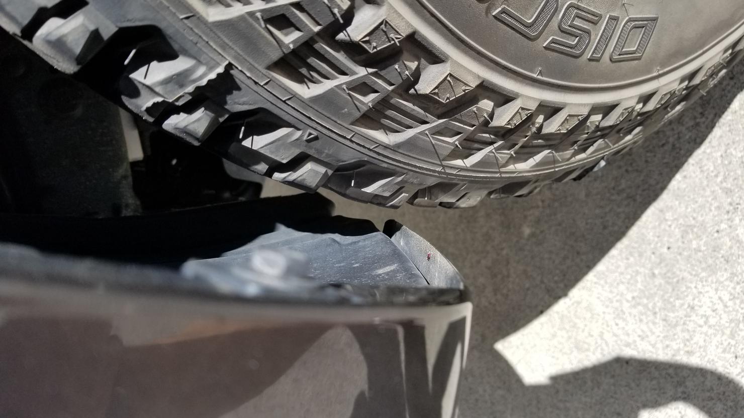

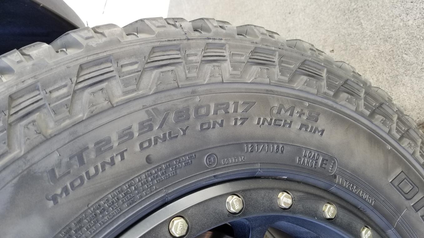

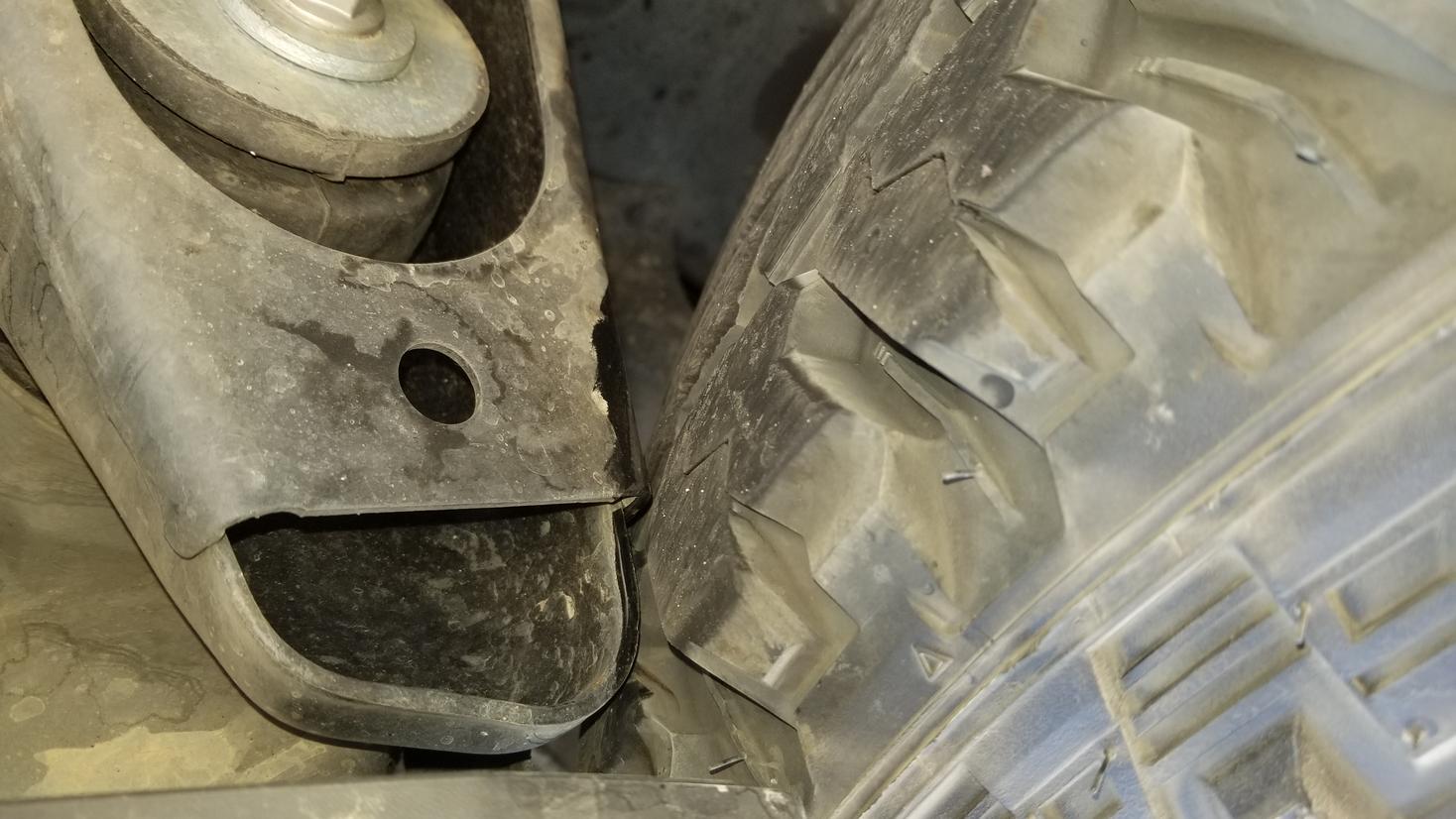

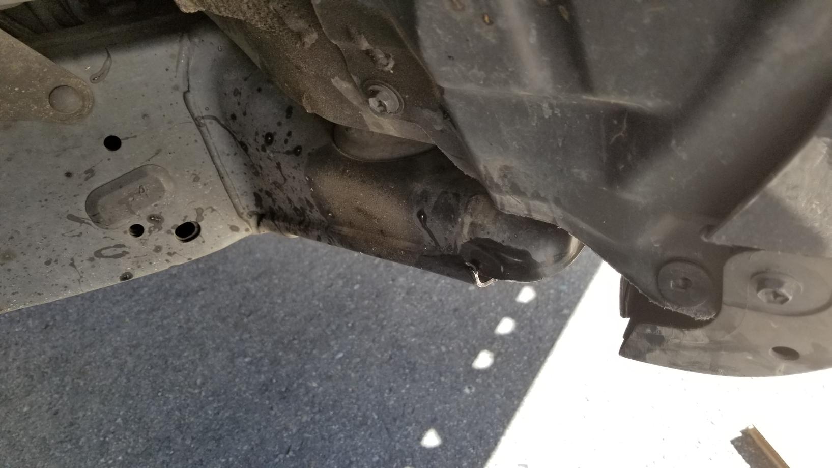

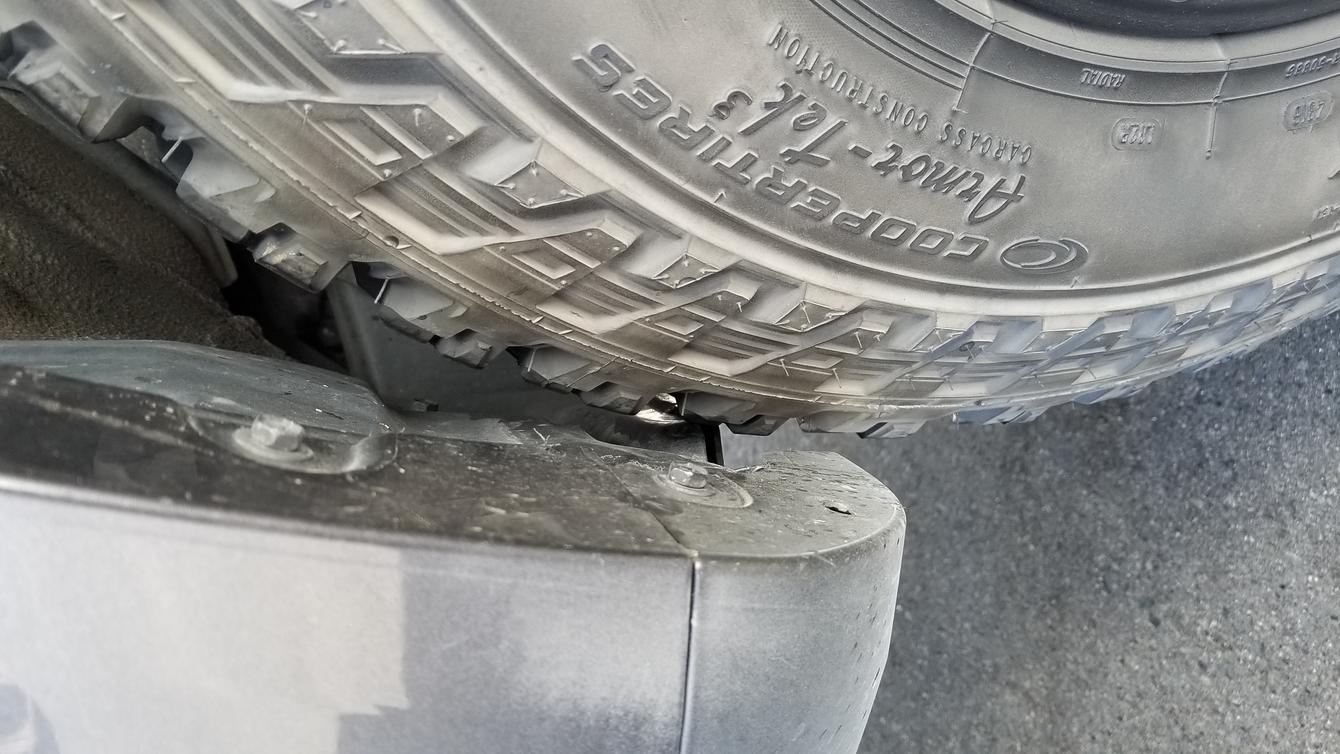

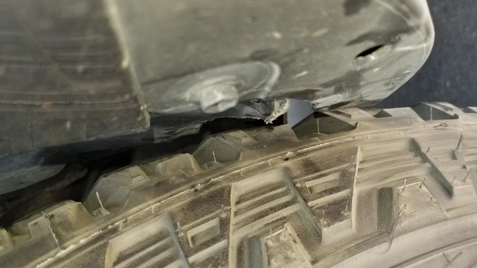

I purchased the Cooper Maxx 255/80 R17 based off of the good reviews and individuals saying they had no issues with fit. I have a Toytec Ultimate lift. I've added Light Racing UCA and spacers, I've also had it aligned twice to try and make them work. Unfortunately the rubbing is on the frame so there's no body trimming that can be done besides the frame which I'm not ready to do. I have a 2016 SR5. I can't imagine it has a different frame. Does anyone have any suggestions. Thanks for the help in advance.

Your issue is likely the spacers. Try running without them and you might see different results!

Thanks for the reply. The spacers were the last thing that I bought hoping it would help to clear the frame.
Spacers are usually only needed when you are running 285's and are needing to clear the upper control arms due to the wider tire. Spacers will add distance from the pivot point, and will in most cases make rubbing worse. Try removing them and see where that gets you.
