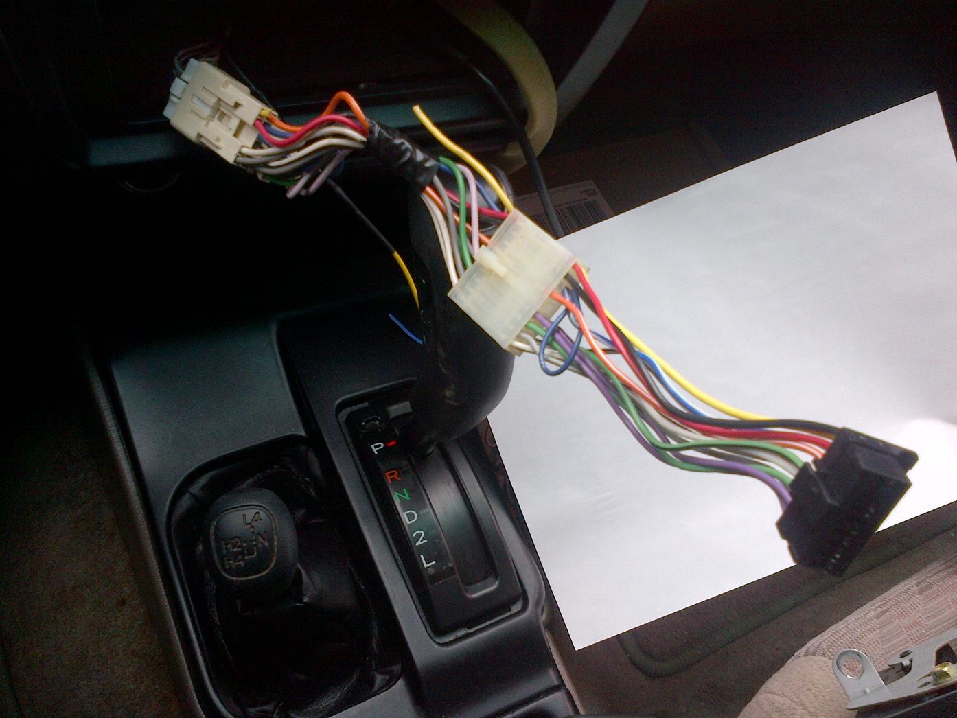

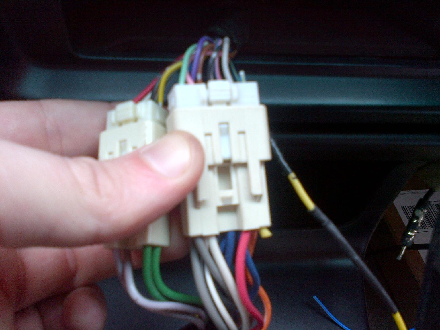

Nevertheless, I have encountered another problem. The PO had a Pioneer head unit installed, however when I opened up the cluster to swap the wiring harness I found that whoever installed it re-wired the 12v battery power (yellow wire). Looking at the first picture, you'll see where the wire is cut on both sides of the harness connectors.Seeing this, I cut the wire that was bypassing the harness and connected it to the new harness' 12v battery power.
The second picture is the entire harness for the previous Pioneer radio. You can see where I cut the yellow wire in order to solder it to my new harness' 12v battery power lead (also yellow).
After doing this, my alpine head unit still will not turn on and naturally, the pioneer wont either as I cut the power. I am close to throwing in the towel and having someone do it. I can't keep driving with no radio.
