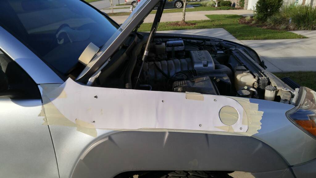

I had some spare time today finally, so I installed my snorkel. I've had it for about a week now. The last time I went wheeling, we hit some water crossings that were deep enough to scare me, so I ordered one as soon as I got back home. It's made for an 80 series Land Cruiser. I've seen some people mount it on a 4runner, so I figured I'd give it a shot.
Getting everything lined up.
Final product
It actually fits quite nice! I did have to trim a little of my cladding...maybe 1/4" or so. Other than that, and drilling into my fenders, it was easy!
Nice that looks really good! I was trying to stick it out for Safari to come out with one but i don't think that's going to happen,,,, at least not for a while, plus i'm sure it will be pricey! I really like the one made for the 1st gen Taco but it's around $450 :ohwell: So this is a great alternative. My other buddy used the one for the prado Safari ss135hf (i think) but had good success with it. I really like this one though i think the fit and finish looks much better. Is there a specific company you ordered it from? I see they have one on amazon for around $70.
Thanks!
I got the $70 one from eBay. I'm pretty sure it's the same company that seeks the one on Amazon. It's well made for the price in my opinion. The way I placed it, where the air exits the snorkel lines up perfectly with where the airbox comes out, so connecting it was easy! I may cut some of the top down some, so it doesn't sit so high, but other than that, I'm completely satisfied with it!
Thanks!
Awesome man thanks! I think i saw that one on eBay to, looks like the same pics. The only negative thing anybody had to say about the one on Amazon was about the Template being poorly made and to make sure you double and triple check before making your final hole. How was the template on yours?
The template was almost perfect. The 2 bolt holes closest to the door were off about 1/8", everything else was good, but I laid the template on the snorkel and made the holes match before I went drilling my fender!
That's good to know, that's what every one else was recommending to do with it also. I can only imagine that moment when you drill into the fender with that (there's no turning back now feeling haha) I'll probably end up going with this one. It's good when we each do mods on our trucks that we each don't have (if that makes sense:confused:) because our trucks are similar so it really makes the decision making that much easier haha :thumb3:
