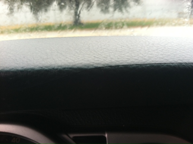

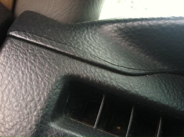

My 05 SR5 has the same issue. I bought it used 2 yrs ago and the crack was not there. Now it's like a hair line fracture starting from the right side of the stereo that goes all the way over and across to the vent next to the driver's side door.

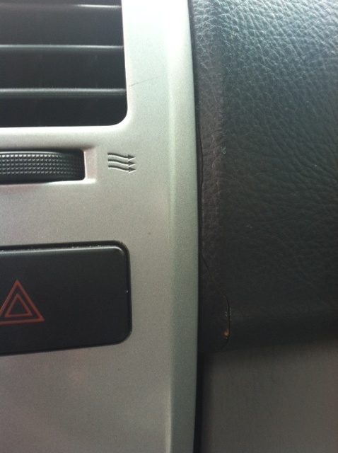

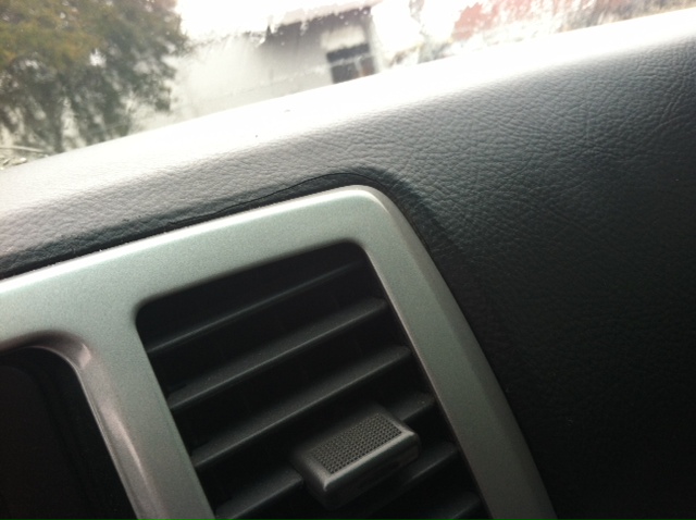

So after buying ours a month and a half ago with a really bad cracking dash, i couldnt stand looking at it so i decided to go and get a Coverlay from JC Whitney cuz it was the cheapest place i could find at 157 shipped. I was kinda iffy on buying one cuz i fear that it might not fit right or the color may be way off.. When i received it did a dry fit i was totally wrong, it was perfect even around the center speaker and the airbag cover was a tight fit. no gaps and the color is so close my wife couldnt tell..
Can you take a pic around where the dash meets the silver trim from the radio? It looks like a great fit!
That fits awesome!
What type of adhesive did you use to hold in place? Which color is that?
Its the Dark Gray one and it comes with a tube of clear silicone but I used alot of it and pretty much ran out for the airbag but good thing i had an extra one in my tool box.. what i suggest if you have a center speaker is to take out the speaker cover using a paint scraper to lift it then place book over it and something heavy on the book so that it seals tight then when its dry place back the cover. Doing this will eliminate you getting silicone on the speaker cover
