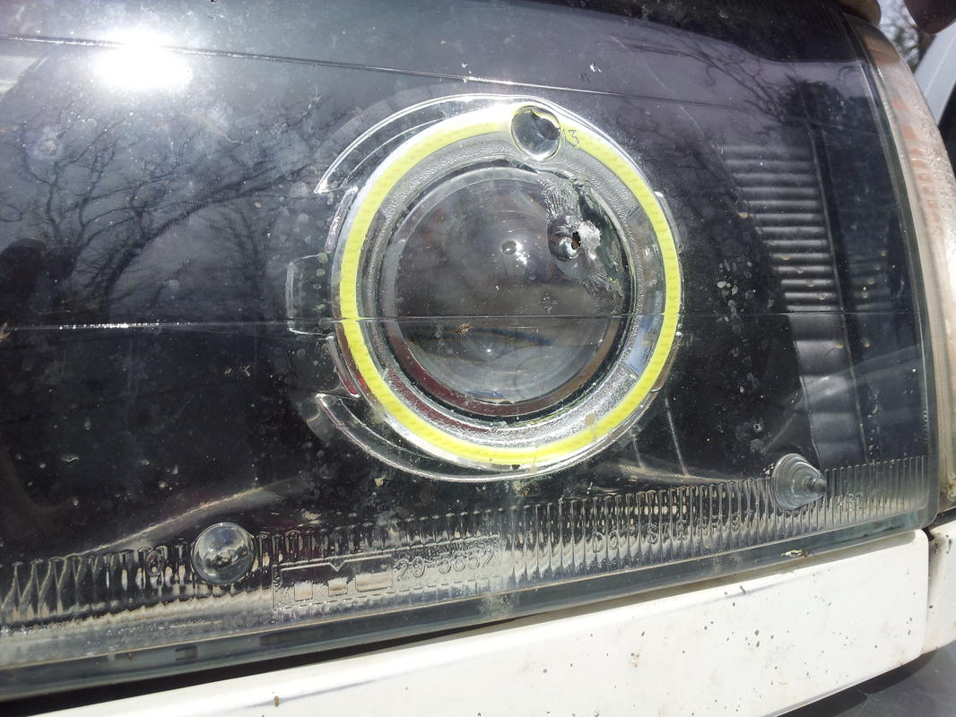

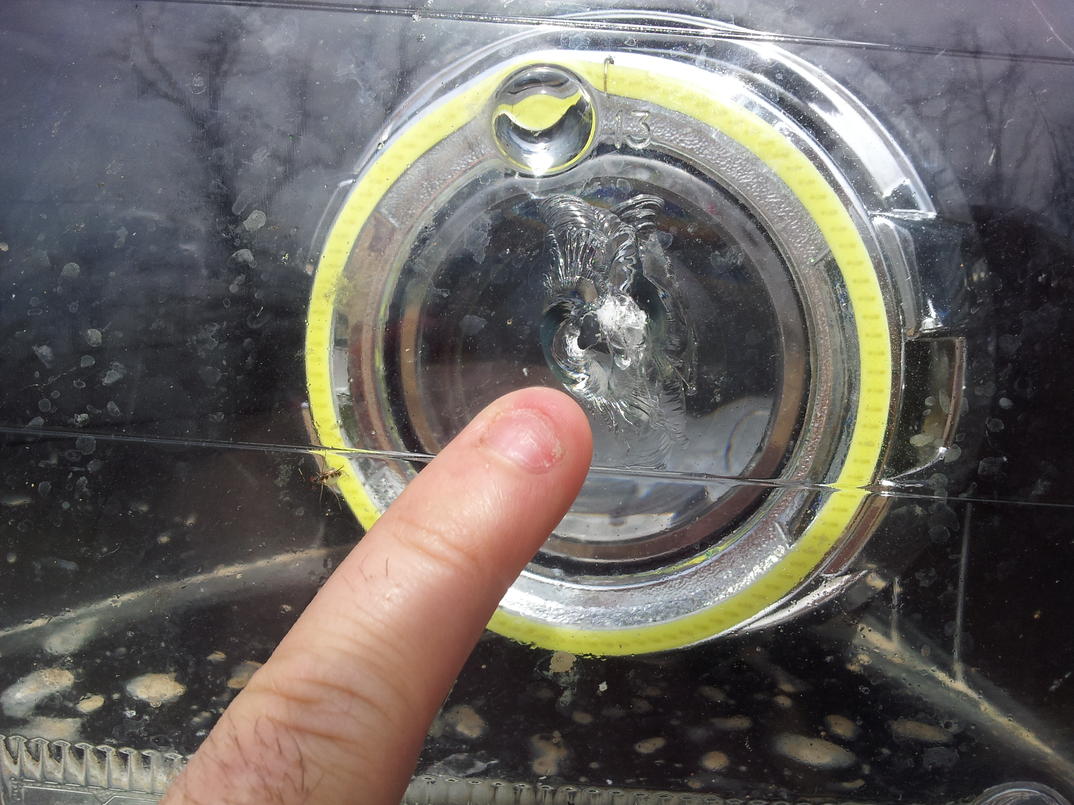

After upgrading to HID's and also it being glass I took a rock head on and now my glass has a hole in it. I'm worried that it will retain condensation and mess up the HID bulb. How do I seal that small hole in the glass. I want to get this fixed ASAP but not sure how to go about this one. My skills with glass are not that hot. Any ideas would be helpful. I was thinking about calling safelight even and seeing if that stuff they use will fix it up.

How big of a hole? I used to have one in mine, a little smaller than a dime, and nothing I used lasted real long. You might could use some marine epoxy that goes on clear. Anything you use is obviously temporary. You're going to need a new light housing eventually.

You will have to buy a new headlight assembly, but yes it is possible to replace just the glass, but then you are left with a reflector bowl you don't need. If I were you and the hole is less than a dime in diameter I would look into epoxying it.

Yes you can just take apart the glass and do the swap. You will need to buy a new L/R headlight for $40.
I don't think you will be taking apart the HID, just swap the glass. The HID component can stay assembled. Just remove the bulb and bake.

I personally would replace the glass after seeing it. There is no way to fix it without completely ruining your light output...
