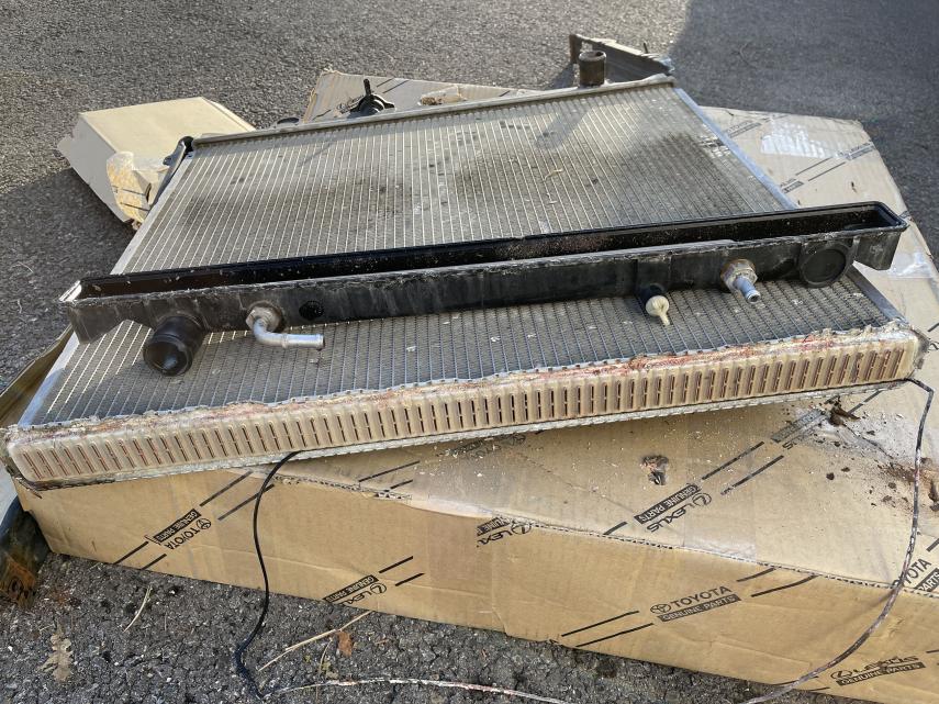

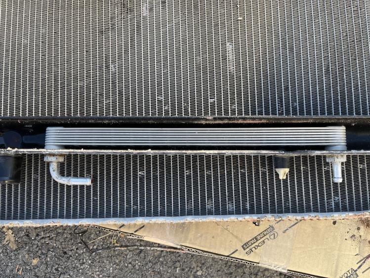

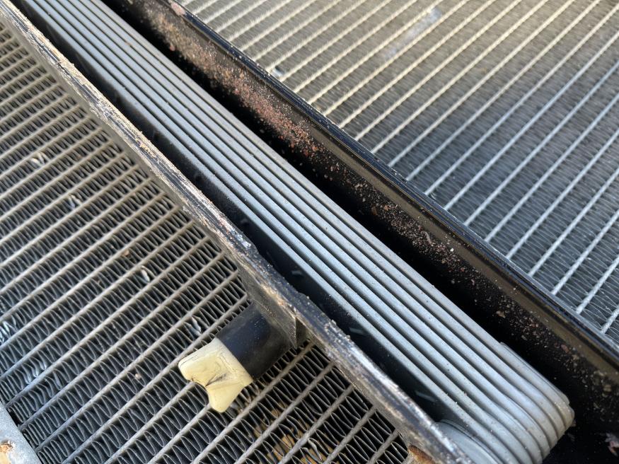

My original radiator was getting a little long in the tooth so I decided it was time for some preventative maintenance. My 02 has 159k on it, however, it did have regular coolant flushes so I wasn't that nervous about the possibility of a pink milkshake disaster. After changing out the radiator I took the bottom half off and I'll let the photos speak for themselves. The crusty stuff is from me prying back the tabs to pull the end cap off.

looks like factory fresh. to me radiators are cheap and easy to swap out. super low cost of piece of mind. I would agree I think that rad looks fine to keep going, but maybe not now?
I imagine my 200k rad looks about the same inside. The PO flushed every 36k. My concern is the browning of the tanks. That indicates plastic breaking down. I'm going to be replacing my 200k rad in the next few weeks. I need to take it out to run some wiring for my rock lights cleanly, so I might as well replace it....
Yeah the plastic eventually erodes and loses it’s integrity. Doesn’t matter if it’s PA66 or PPA. The plastics (on quality units) are usually designed with a 7 year lifespan in mind!!
My 2001 is factory original with 240k miles on it but regularly flushed it. My 2005 T4R had to be replaced at 140K(but I bought that one at 120K miles on it).
