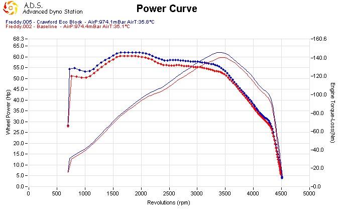

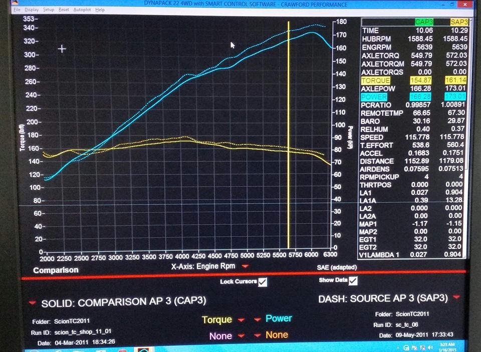

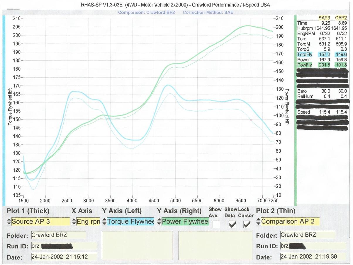

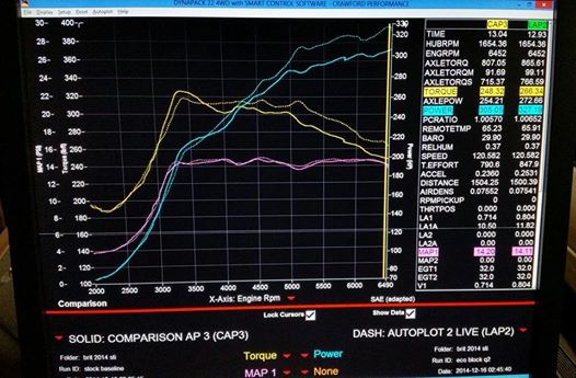

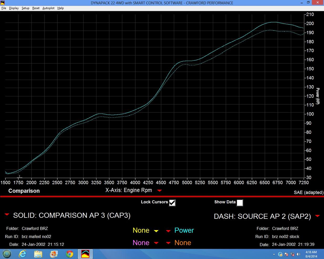

Here are some dyno graphs for you guys to ponder. I know that none of them are from one of your trucks, but the results will be the similar as they all use a MAF sensor for tuning.
These graphs are from gasoline and turbo Diesel engines as well as from different brands of vehicles. They also come from different parts of the world.
This Tuesday we are supposed to have three trucks here for us to dyno, as soon as I have the graphs they will be posted here for you to compare :)

In the above cases, did you allow time for the fuel trims to adjust once the MAF spacer was installed? The 2014 STI dyno shows a stock lambda of 0.714, and a MAF spacer lambda of 0.804 - which is 12.6% leaner. Depending on the ECU, once you've driven for a while, you may or may not get any WOT lambda change with the spacer.
Fuel trims in closed loop adjust as soon as the o2 sensor is hot, like a couple minuets. There is really no waiting time.
All the dyno runs were made at full throttle so the ECU is in the open loop fueling mode where there are no trims added.
So Open Loop does still reference the reported (adjusted/reduced) MAF input data, and that is what ultimately allows a lean condition @ WOT (apparently proper stoic, not actualy "Lean") - but the "learned/corrected" (trimmed) conditions as reported from the O2 sensor in Closed loop conditions are ignored in WOT/Open Loop.
I'm still wrapping my head around why the VVTi and Timing are affected - but I feel I'm closing in on more ECU comprehension :) I'm a Drummer/Audio Dude/Broadcast Guy :D
Open loop fueling pulls the math right off the open loop table which uses "load" and RPM for its two axis parameters. The Load axis is offset by our Eco Block which causes the ECU to do its math based off of a different load cell within the table. To be honest, the AFR is no where close to stoic at full throttle, it will actually be a few points richer.
The timing is affected exactly the same as the fuel, by offsetting the "load" point in the output table.
