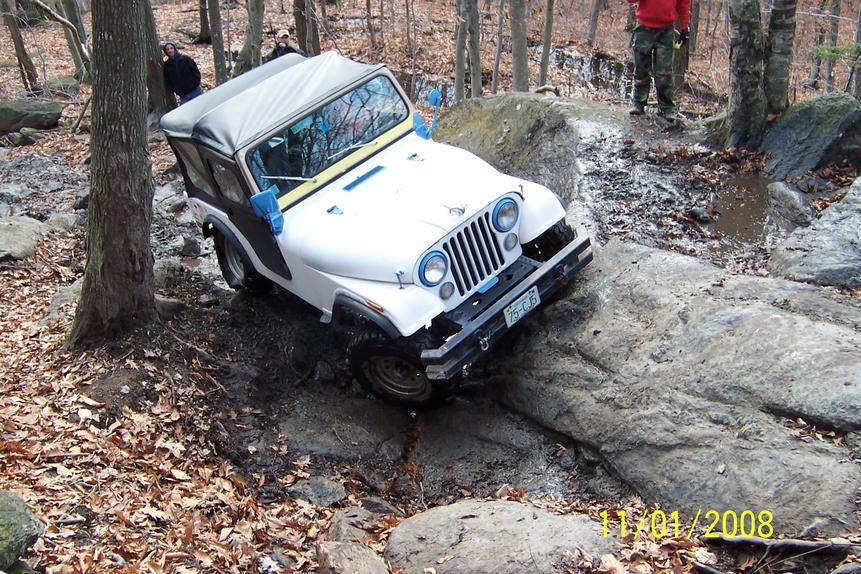

on my cj, with 34x10.5x15s, i typically air down to 4 to 6 psi. no beadlocks. bias ply tires (not radials). if that isn't enough, i'll drop to 3.

take a close look at the rear tire. it is folded over a pointed rock.
