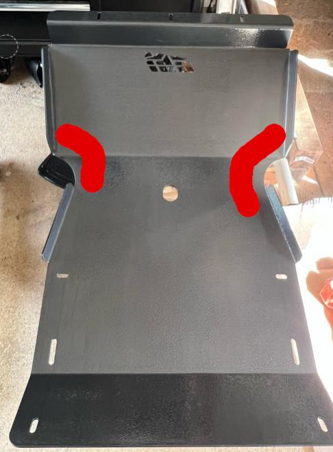

CBI skids finally came in. Ordered them in mid November.
I went with rustoleum Hammered paint. Should be easier to touch up.
I went with rustoleum Hammered paint. Should be easier to touch up. h/IMG]

So I had a very similar skidplate to this one. Very thick and heavy, but not as strong as you think. It bent right where the red marks are in this pic. I ended up getting scoring a set of Savage skids, but I was going to beef the one I had up so it doesn't bend. trust me, it will bend pretty easily if you land right on that bend..I wish I had taken pictures and video of all the work I had to do to get it to fit back on.
