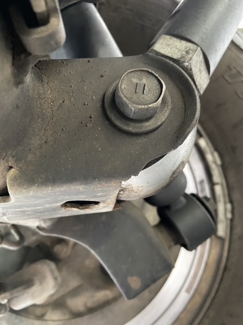

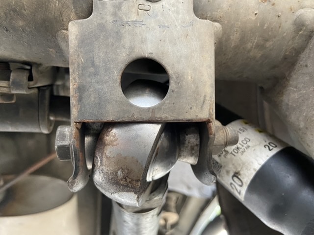

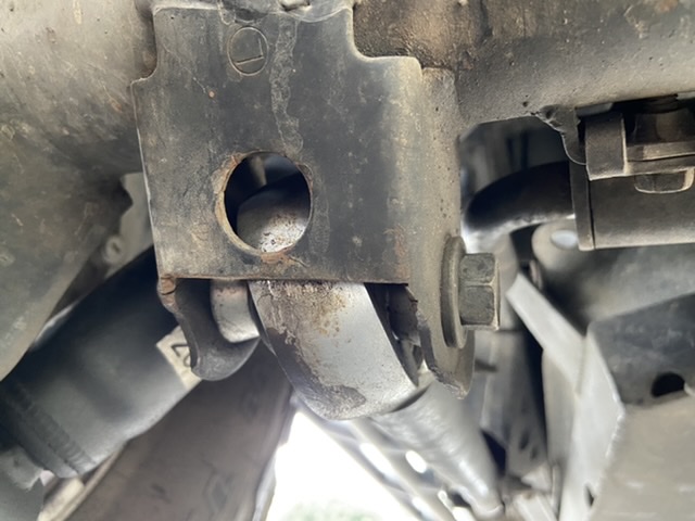

No photos, but maybe I can grab one later this afternoon. It rained early this morning for once here in Socal, so it’s too wet to slide under the rig at the moment. I took off 1/4” - 3/8” off the plated part on the backside of the mount.
Here’s a couple photos. First two are drivers side. There’s 1/4” from the factory hole in the bracket to the cut part. Still appearing to touch the bracket on the driver’s side judging from the scratch marks on the rod end. Make sure to use Cross Check or a paint pen on the large nuts once your rod ends are tightened down. Those little bastards like to come loose from time to time.
Thanks for the pictures and the pointer!
Do you thing that cutting off a part of the mount has weakened it any?
