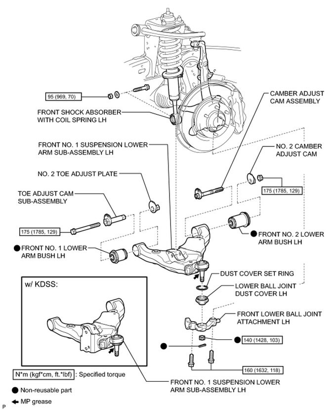

Yes, it was the loose LCA bolts. I may sure they are torques to 129ft/lbs every time i visit an alignment shop. I re-torque them when I get home.
Your symptoms are exactly like mine, so I am assuming I have the same issue. Did the creaking come back, or is it still gone?
Can I tighten the bolts under load, or does the vehicle need to be off the ground?
And to confirm, the LCA bolts are the ones in this diagram that are indicated by the 129 ft/lbs torque spec?
Thank you so much for the help.
