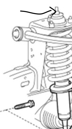

Can I tighten the bolts under load, or does the vehicle need to be off the ground?
And to confirm, the LCA bolts are the ones in this diagram that are indicated by the 129 ft/lbs torque spec?
Thank you so much for the help.
I have the same squeaking i have pass 2 set of bilstein and they alway comme back ,but i have notice when a friend is jumping on the driver side to make it move when i pry the top bolt the sound is less loud so i am wondering if the coil when it flex side to side maybe is rubbing on top plate ! Sorry for the bad english
