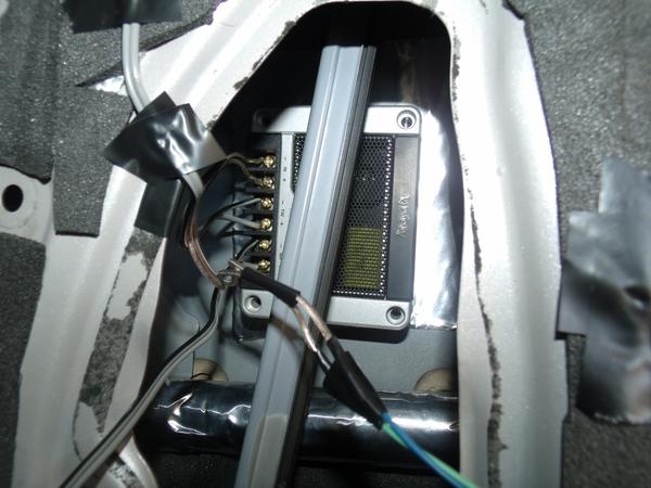

Some double sided tape would hold them in place honestly. Since it's a tight fight anyway, you don't need much to hold it in place. I have some kappa components in mine now and was able to fit everything nicely.
I mounted mine to the inside door panel (metal part) using 3m double sided foam tape, and it has held perfect for almost 4 years now. Ehy wouldn't you mount it in the door close to the speakers? That's the easiest for wiring

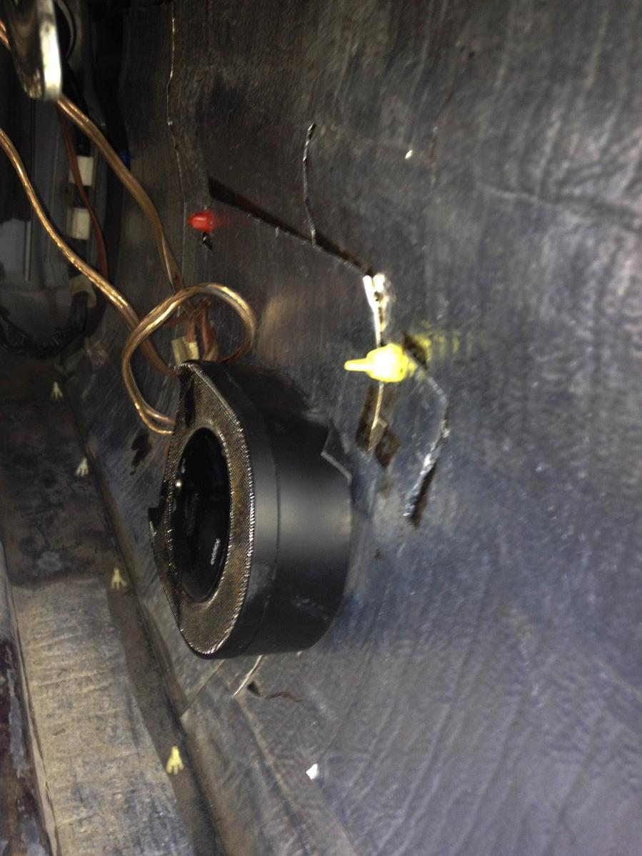

I second this, mine are in my door. Why have a mess of wiring? Just take out the speaker and mount and put it right behind there.
