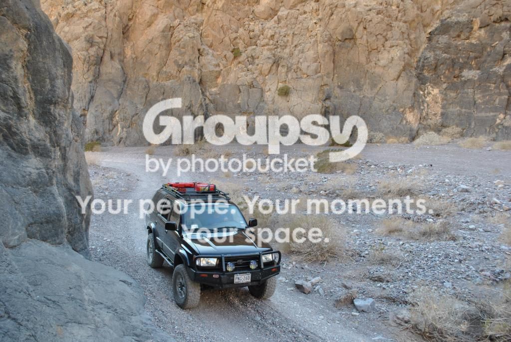

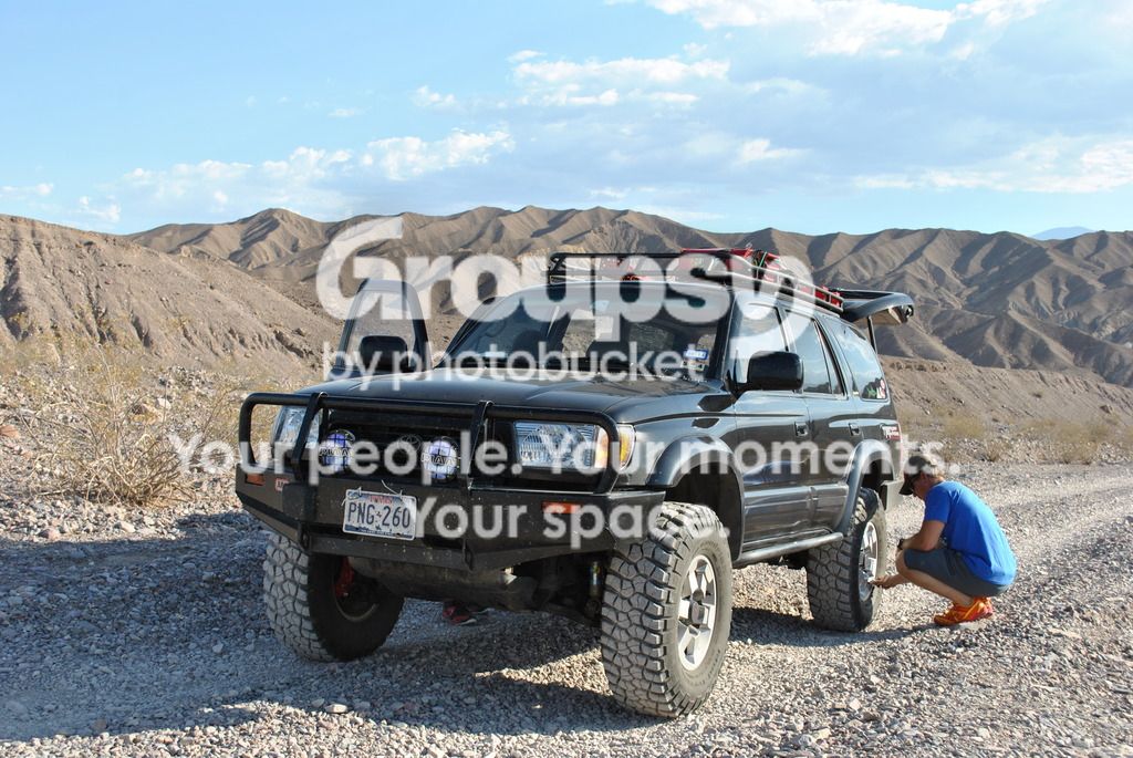

We arrived about ~3 in the the afternoon in the main road of the park and started looking for our first trail and camping spot. The first trails we were going to do were Hole in the Wall and Echo Canyon. Aired down and started on the trail.
Hole in the Wall
Once we made it to the top of this first trail it was starting to become the time where we would have set up camp. It was still hovering around 100 degrees though and none of us wanted to sleep in that hot of temperature. So we decided to hit up the low point in Badwater Basin and then head to the Whitney Portal on the mountain and try to find a spot there.

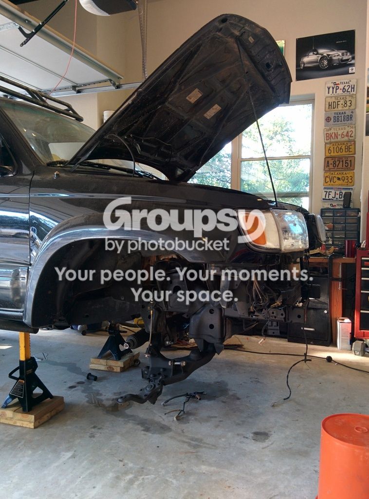

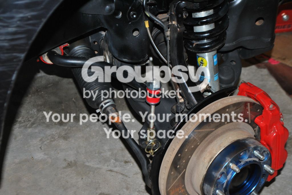

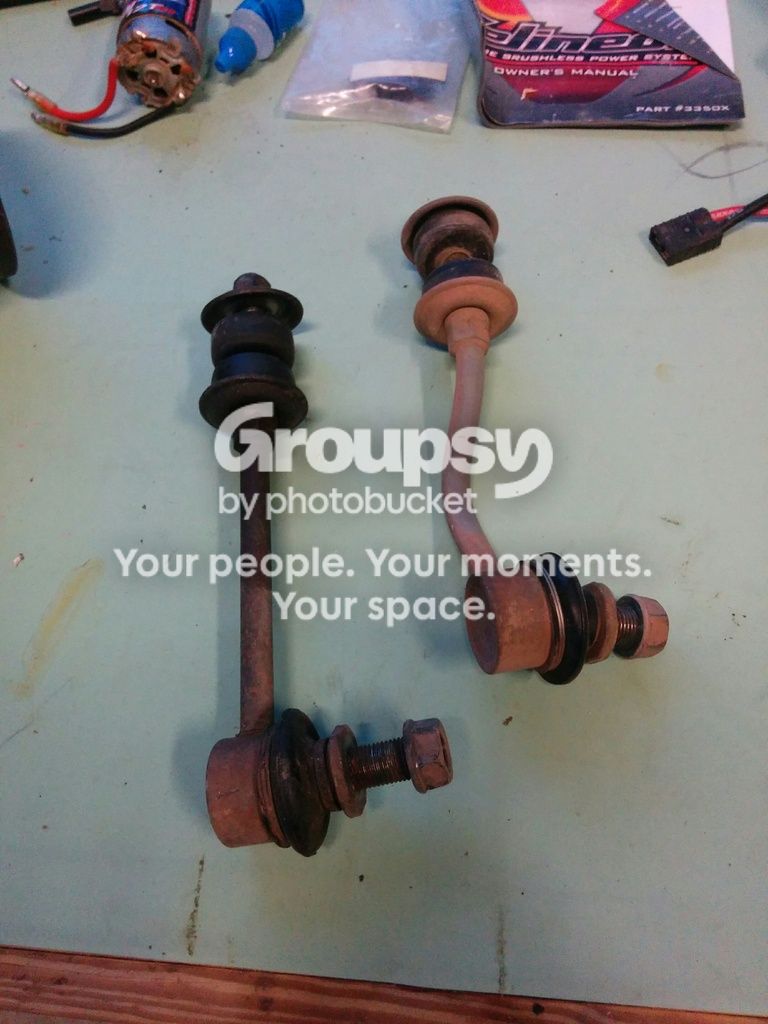

Well I open a huge can of worms. My front sway bar end links got bent!!!...
And someway, somehow, led to this?!-
So since my sway bar end links were bent I started down this whole "well if I'm down there I might as well replace this..." mentality. I know if it aint broke dont fix it but most of what I wanted to accomplish was actual upgrades.
After getting under and finding my sway bars bent I took the sway bar off and while doing that saw my CVs were leaking on my drivers side. I was not surprised in the least as the truck is now 220K miles (110K of lifted driving) and these are original! I also noticed that since grease was everywhere my steering rack was all greased over and had a slight bit of give to it. As the bushings had never been replaced on it I marked that down on the list too.

I had actually let the truck sit for about 3 weeks as we were on vacation and while gone, I got into this whole idea of a complete restoration on the front of my truck. Take everything off clean it, put new seals, joints, bushings, cvs, and replace every consumable and fluid. Luckily I have an M3 to drive in the meantime...
Lists now sits at-

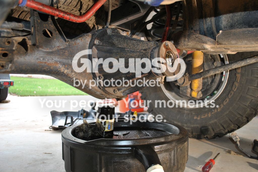

Trans drain/fill
CV Joints
End Links
Steering Rack bushings
UBJ/ both sides
Upper Control arm Bushings
ARB Bumper cut and adjustment
All new clips and fasteners
new differential seals
Timing Belt
Waterpump
belts
Crank seal
Degrease

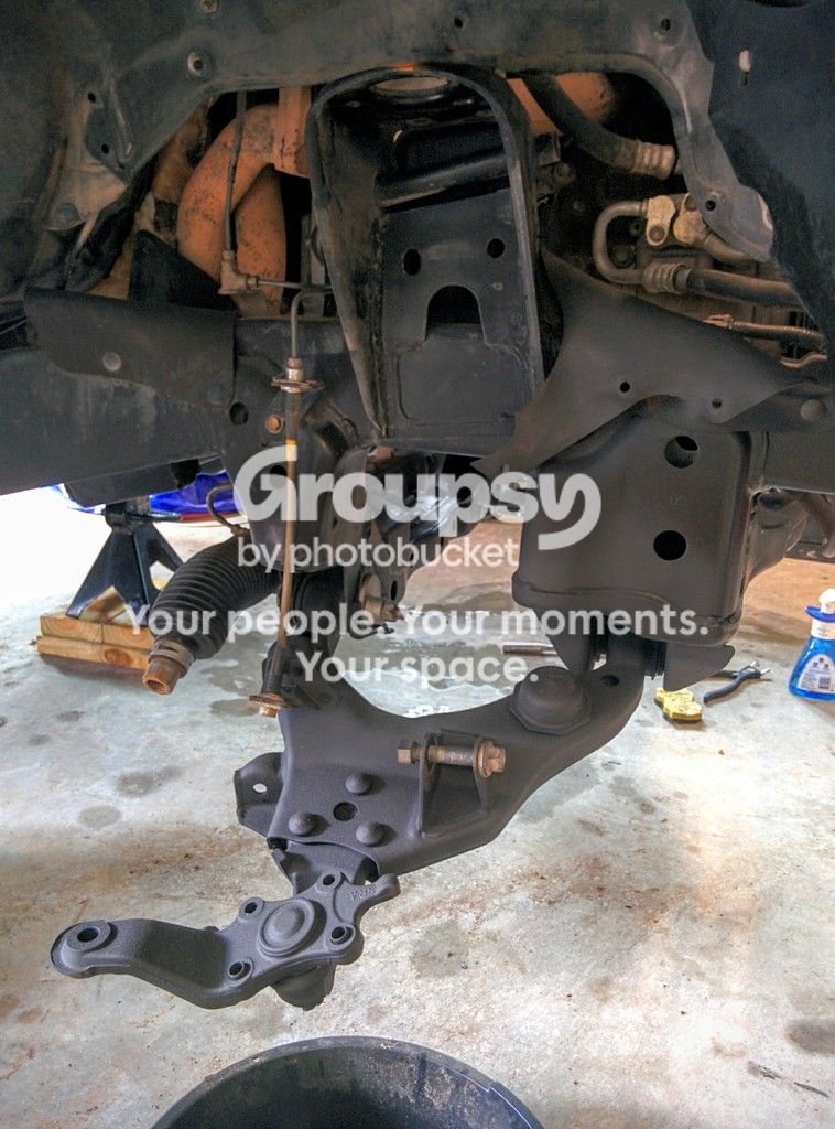

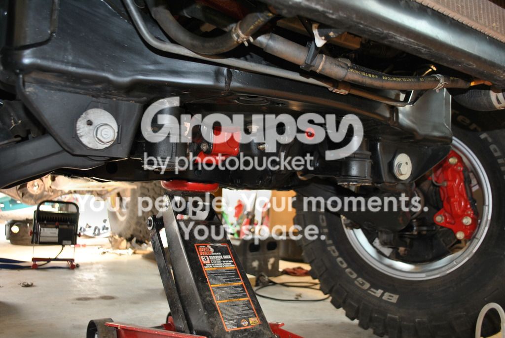

Here we go:
Suspension, axles, diff out, degreased and painted:
Front diff out and cleaned up!

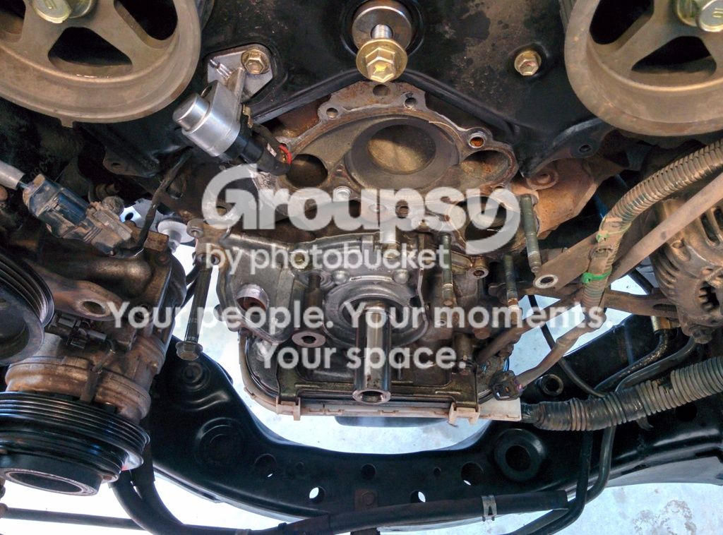

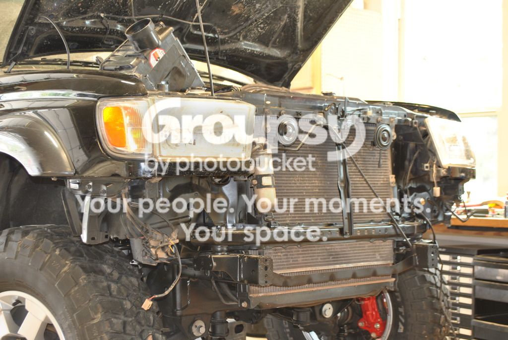

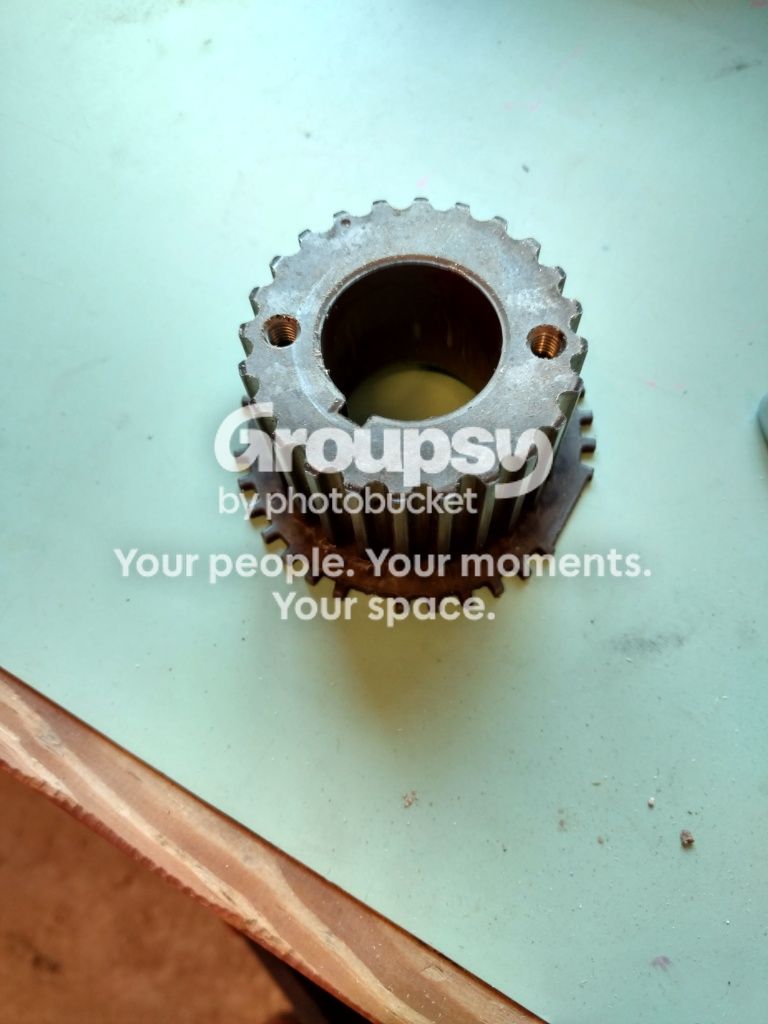

Engine under surgery. To get to the Crank seal you have to remove the timing sprocket. As I was prying it out I easily broke a couple of the teeth off the sprocket. It is extremely soft metal and it actually looked like some of the teeth were already compromised. :

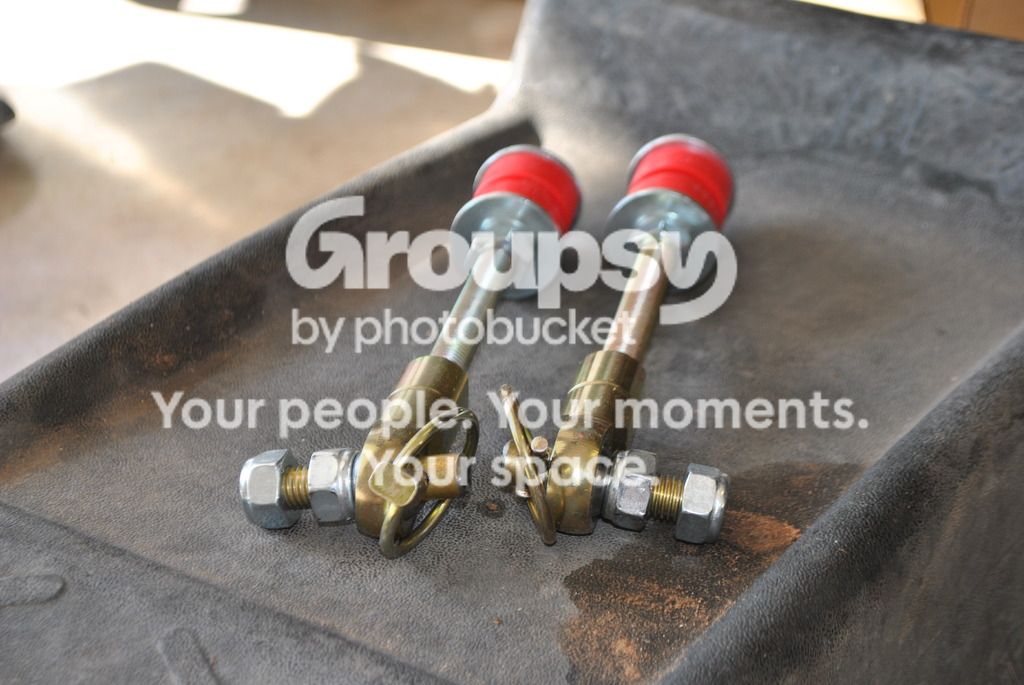

Pretty new Sway end links:

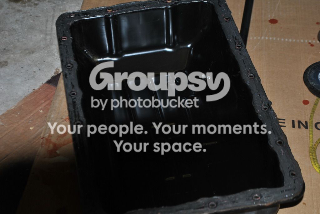

Love removing old rtv...

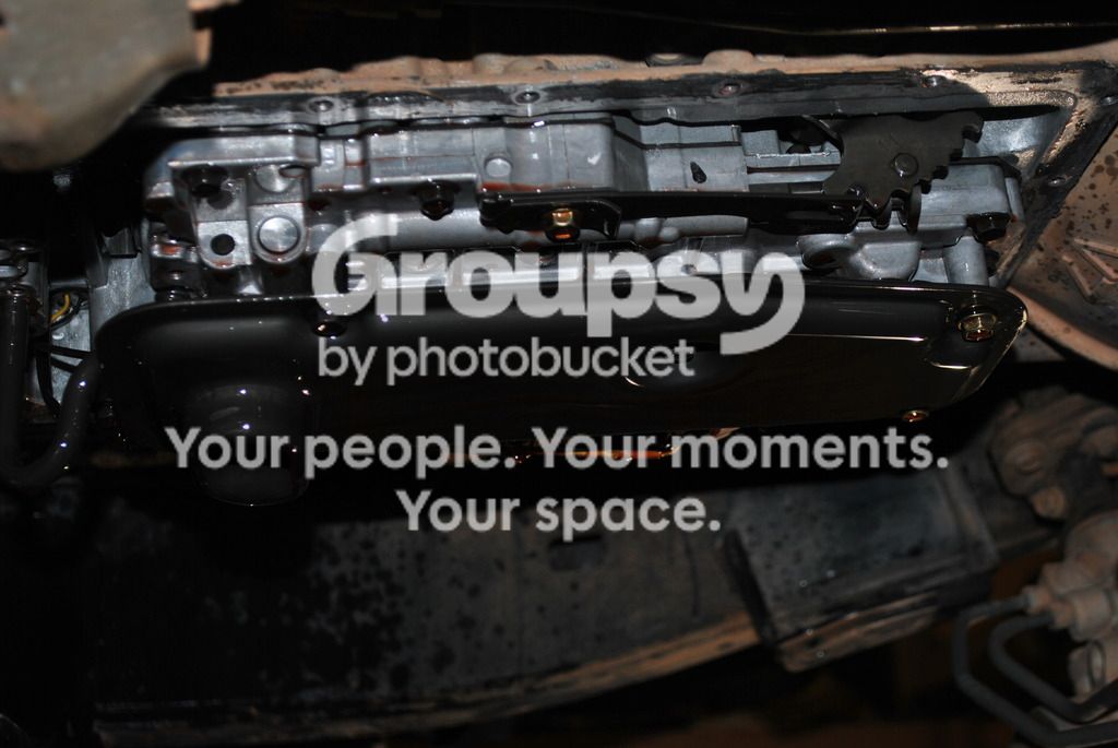

New trans Filter coming up:

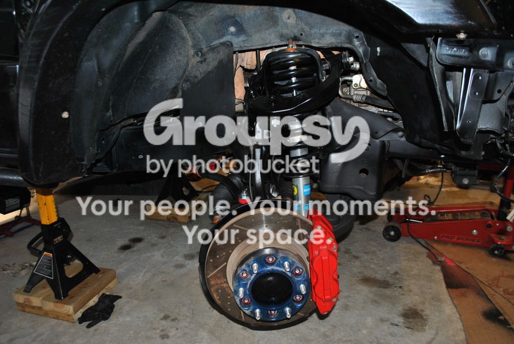

Front end refresh continued...

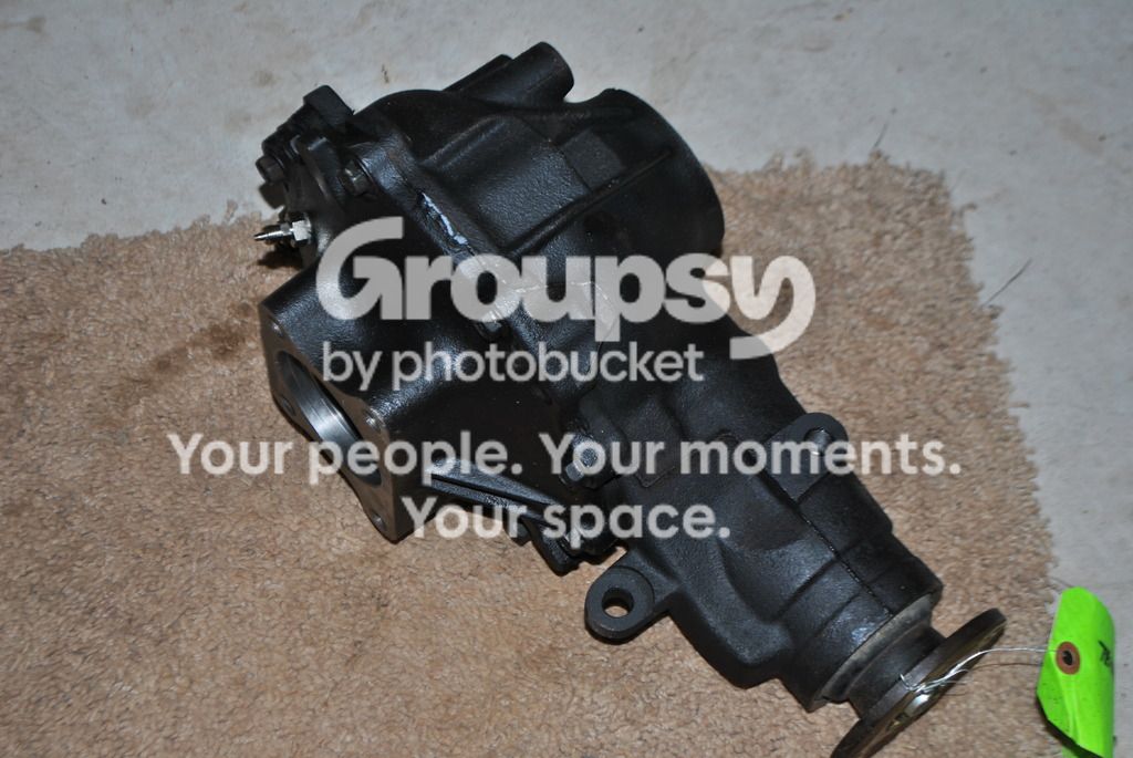

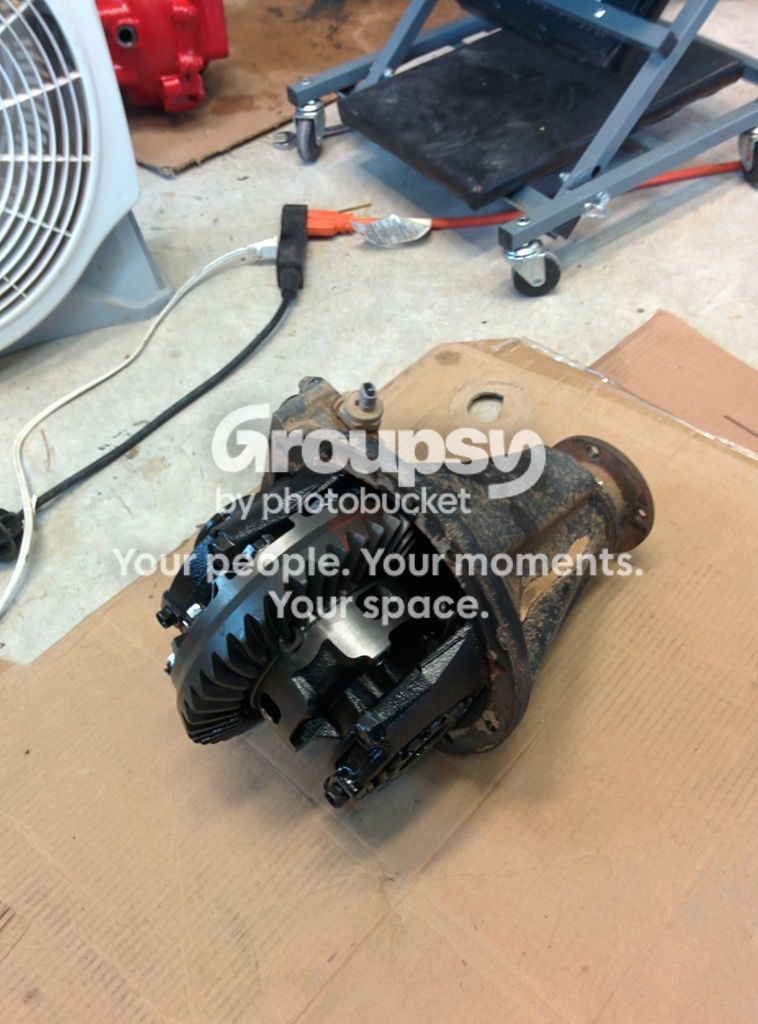

I had the front diff completely out and all clean and could not bring myself to put it back in there. The problem was, I had lurking in my mind, the idea of a re-gear and the addition of a front locker. This was a big decision because of the time investment and of course the cost. The decision was honestly pretty easy since I already had the front diff out and ready to be replaced. So in deciding to regear the front, of course I had to redo the back as well.
So I placed an order for my front differential at East Coast Gear Supply specing 4.88 gearing with an ARB locker. I knew I wanted a selectable locker as I didn't want any kind of hindrance while driving on the road and I wanted to be able to turn it on only when I may think a CV wouldn't be destroyed.

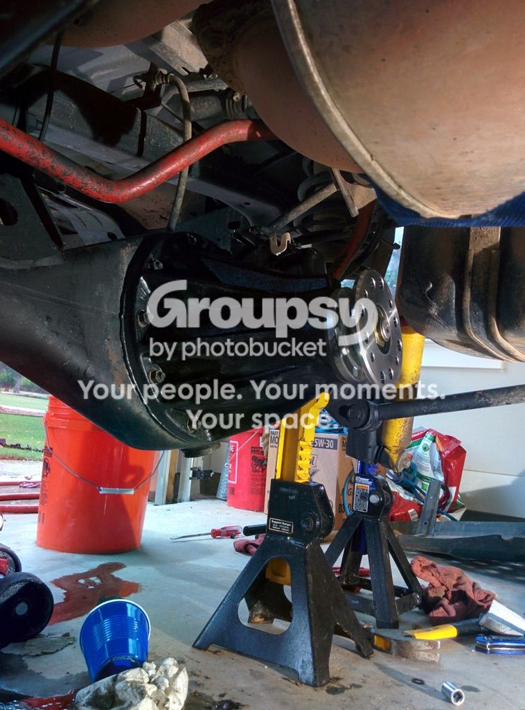

For the rear I decided to go through Marlin Offroad and bought a fully built rear 4.88 3rd member with the Toyota Elocker. I had been having problems recently engaging and disengaging the stock rear locker. At first I thought it was my rat problem and a wire issue but upon installation of the new locker, that has been cancelled out.

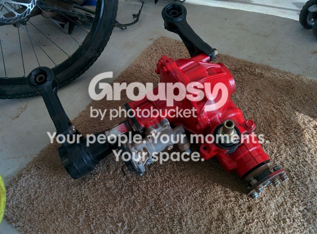

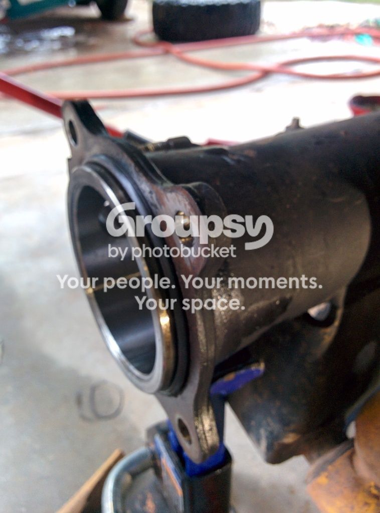

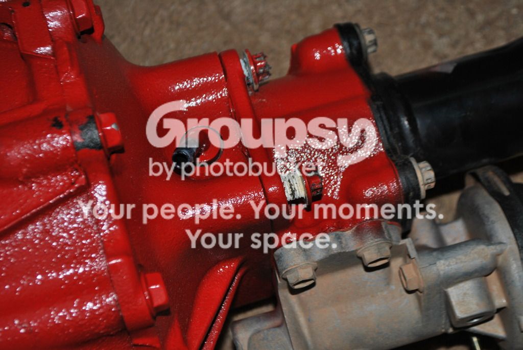

Removing the ADD and shaft
In!
Hello there!

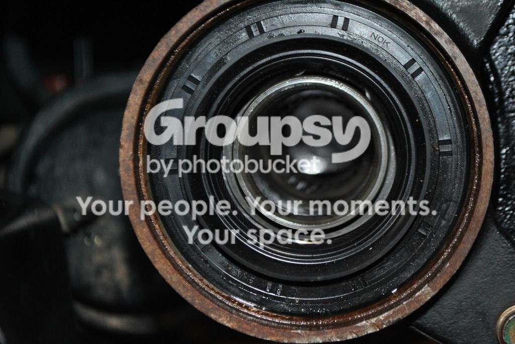

New shaft seals
Out with the old:
In with the new:
New End Links, Inner and out tie rods

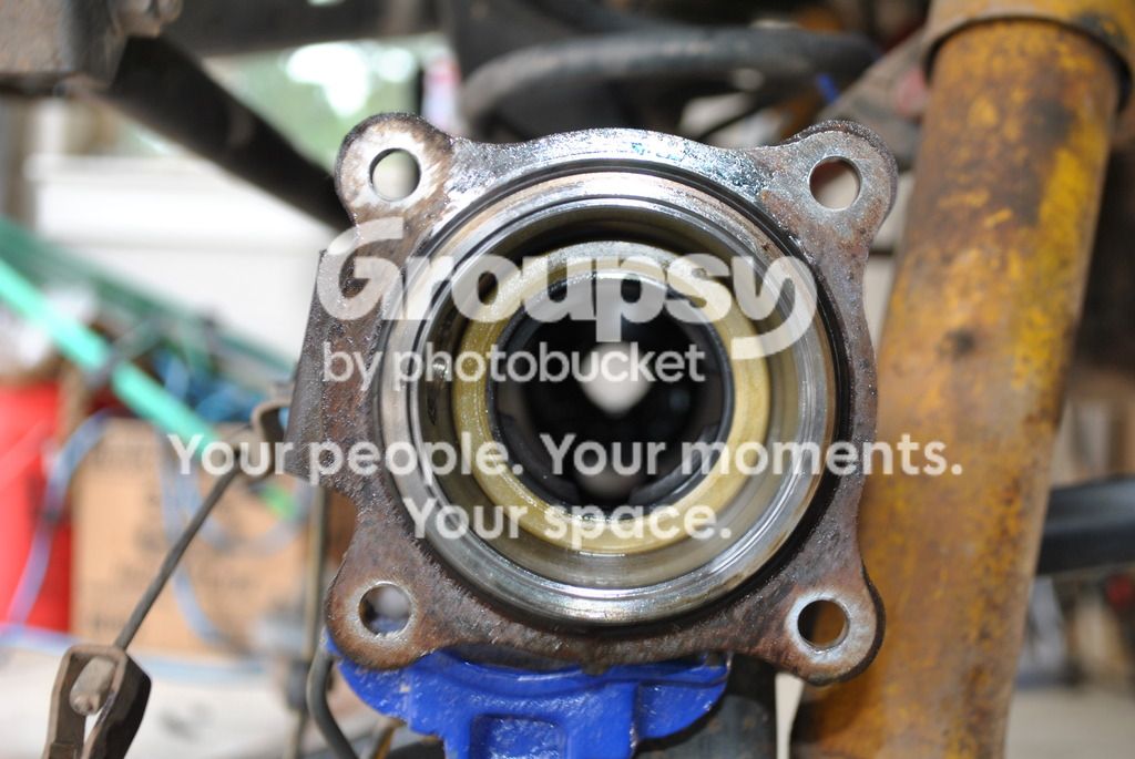

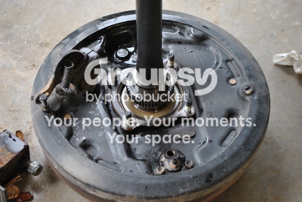

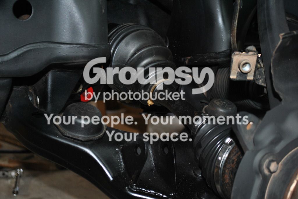

Rebuilt CVs with new Toyota Boot Kit

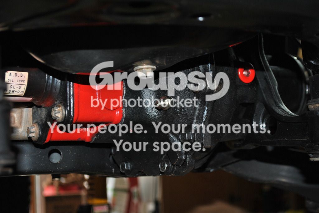

And while I had the diff out I might as well...

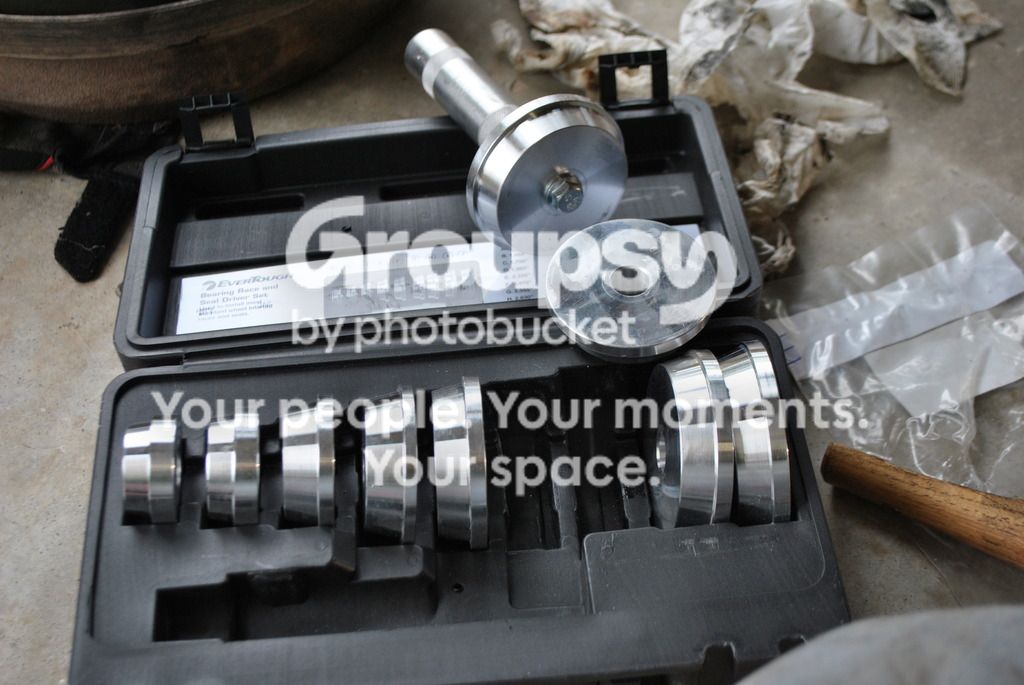

New seals in and what I used to hammer them in:
All Put back together and cleaned up!
