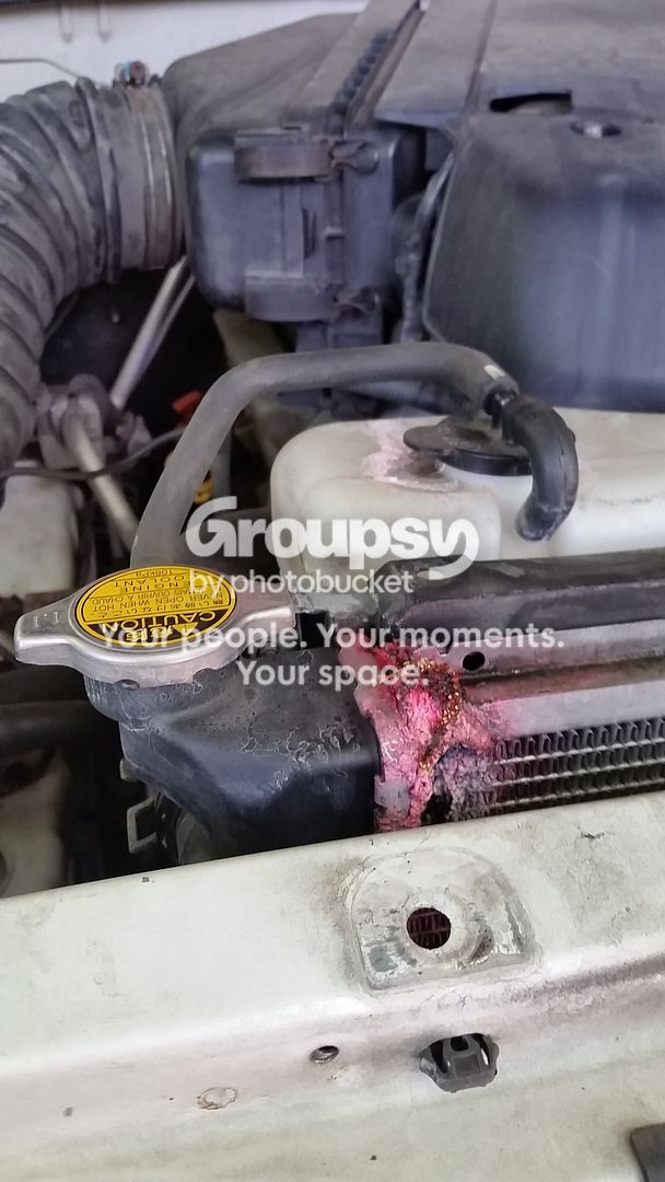

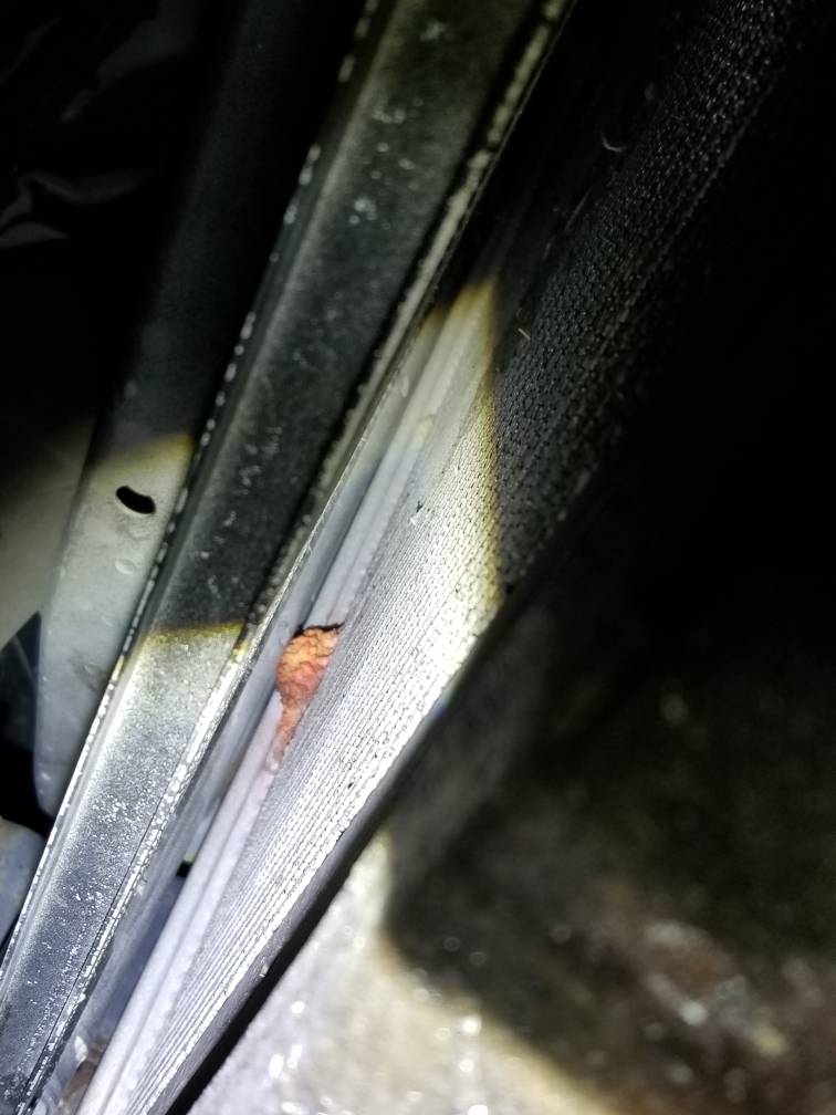

I am need engine a new radiator.
Check out what I found after removing the cover:

What do you all think?
Honestly, I reused the cap from the old radiator without issue. Wouldn't hurt to replace it with oem though. I also took the petcock out of the old radiator and used it in the new one. The new one seeped a bit.
Other than that, it's a really simple job if your 4Runner isn't rusty. Removing the rubber mounts can be a b#!%h if it is.
