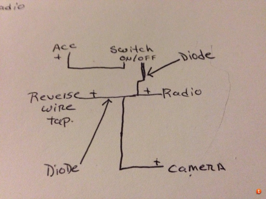

This is the way i am going to route mine
We shall see
Don't mind my bar napkin drawing
Instead of the diodes, have you considered just using a SPDT switch for complete isolation? Flip the switch one way and the reverse wire and headunit are connected; flip it the other way and the accessory wire and headunit are connected.
This is what I did on my OEM backup camera on my 5th gen, for anytime backup camera activation :)
Would that mean more wiring?
Depends on how you wire it, lol. You'd basically just be interrupting the wire that signals the camera to come on, and then selecting between the two signals (reverse or accessory).
stole this photo from the internet (sorry to whomever it belongs to :)), but basically this is what I did:

:thumb: thanks for the help
all this wiring im am doing is making my head go boom
sucks i just finished building my taco and totalled it now i have to start over
errrr
think i am sticking with my way....
i did it this way on my tacoma and it worked fine for years and very simple for the simple minded "me"
plus i already have everything here.....
i hope i can get some done this weekend.....
