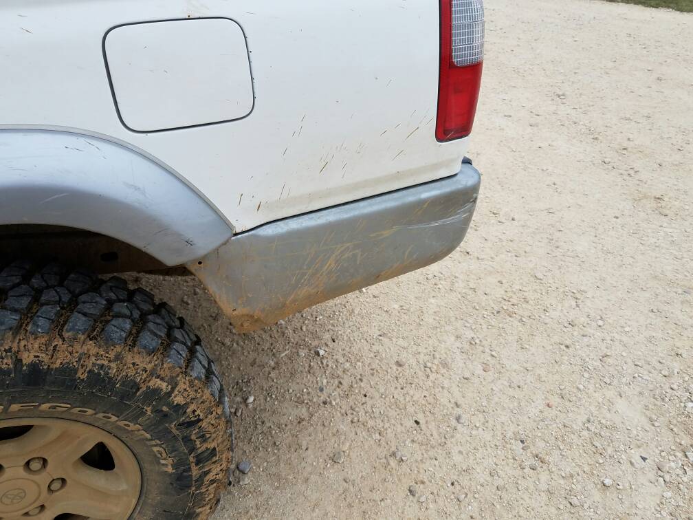

This is my first time to stroll through the 4th Gen part. Glad I did since you're decently local. I went to Bridgeport last weekend and that place gets pretty crazy I noticed. I wheel almost every weekend and I got my first trail damage there haha. I am in austin so normally go to hidden falls. Hope to see you at the jamboree man!
Here's my battle scar (and I still conquered)
Really tiny lol my rear mud flap and cladding took the blunt of it (hence why it's now removed)
