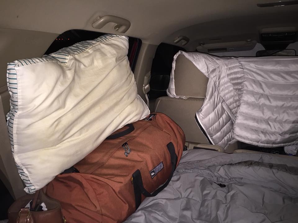

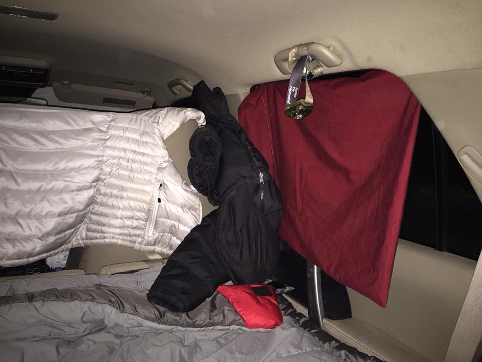

Curtains have been on my to-do list for many many months so I could have some privacy when camping in public areas. Last November I ended up sleeping at a rest stop for lack of a better spot, and I had to resort to this:

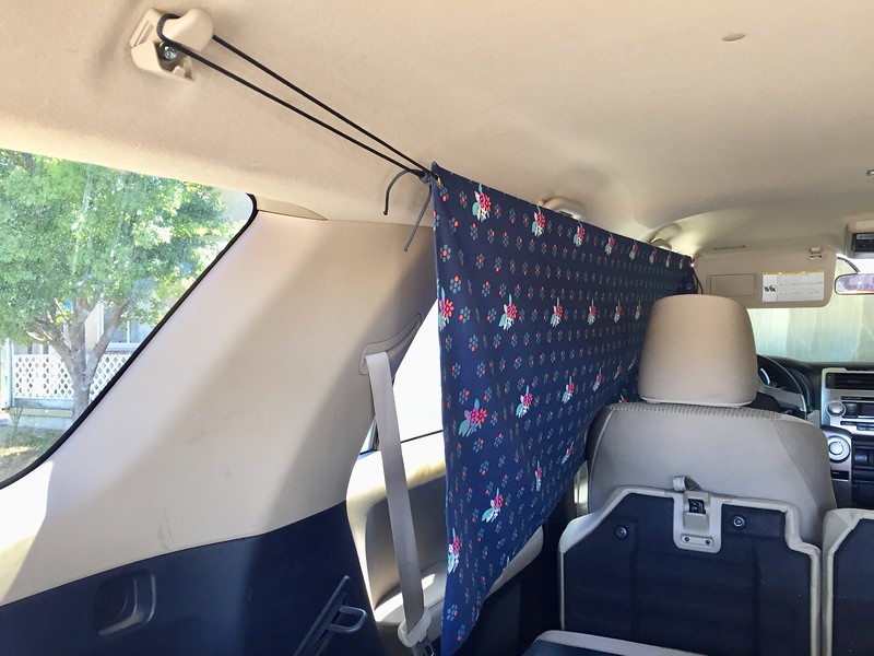

Once I had a basic panel cut, I tested it out and realized that my best bet for attachments would be two attachment points for each curtain panel: The cargo coat hook aft and the sun visor arm forward. With the right tension, the curtain panel would stay taut and not sag.

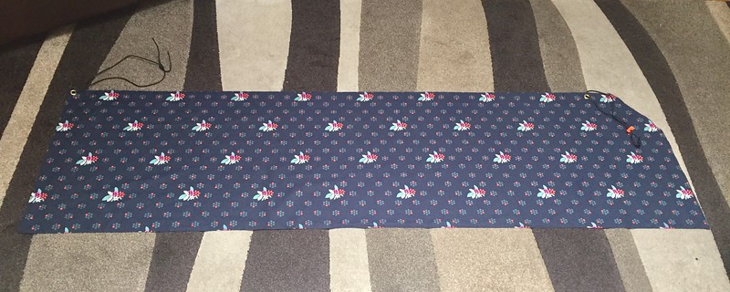

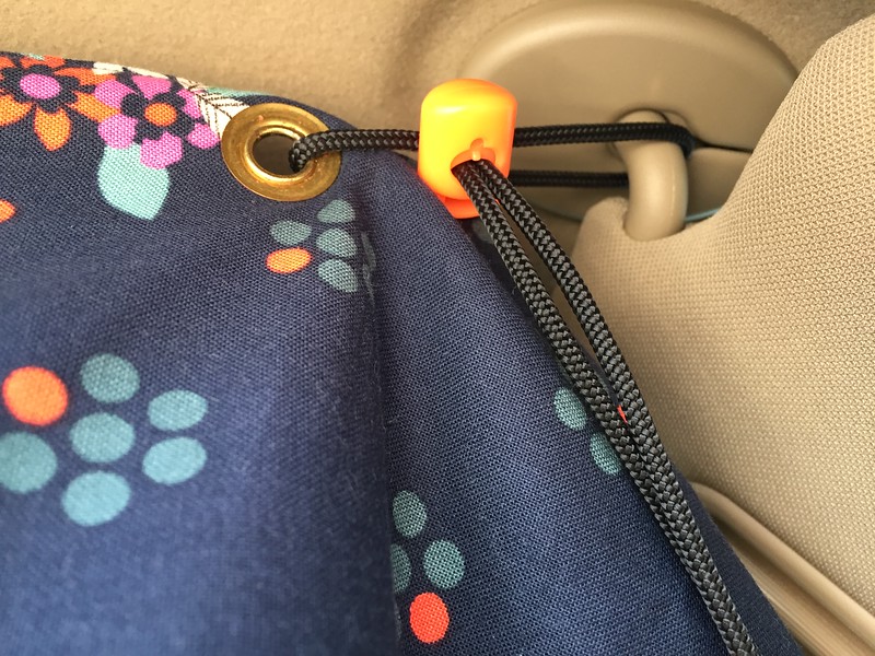

I bought some 3mm utility cord and a set of two toggles (link is for "up to 4mm"--make sure to get the "up to 3mm" size for better tension) and borrowed my friend's grommet kit. I added two grommets to each curtain panel: One in the upper aft corner and one near the upper forward corner. I added a loop of cord to the aft grommet and a smaller loop of cord to the forward grommet with the toggle. The forward loop needs to be just big enough to go around the sun visor; the toggle is for cinching this loop down to tension the curtain panel.
Here are some pics:
Panel with cord loops (right is forward, left is aft). The panels are the same, just mirror images of each other and so are interchangeable on either side of the truck.

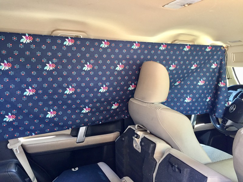

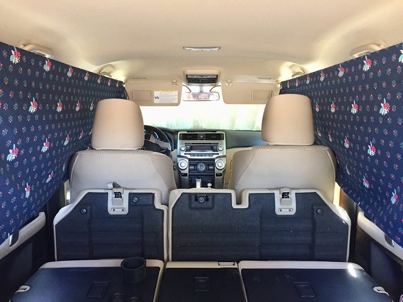

Curtains are in!
It's important to cinch down the toggle to get the curtain taut, which means it's also important to get this grommet in the right place.

This didn't take too long and they turned out pretty well. I'm hoping the print will grow on me... If not, I'll give these away and start over in black!
