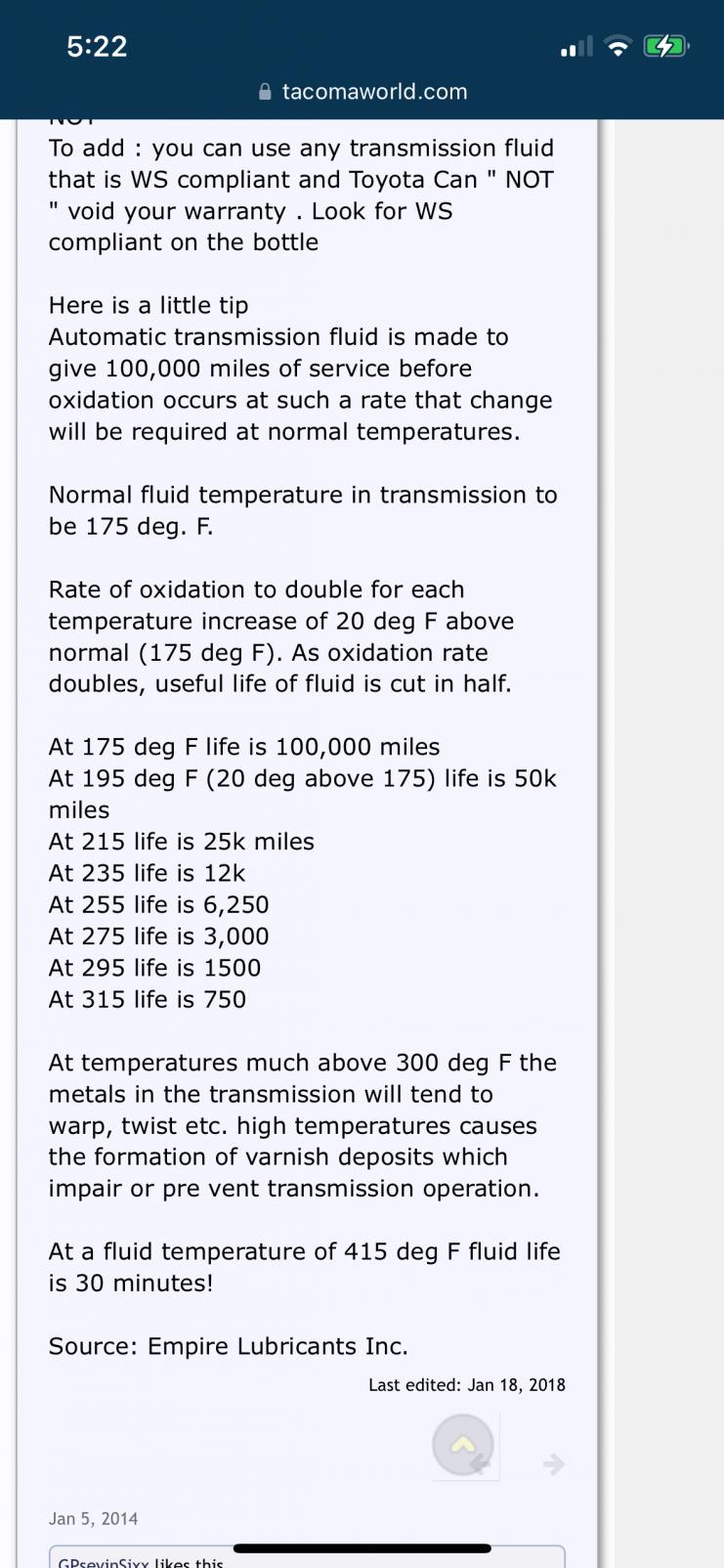

I do have a Scanguage 2 that allows monitoring tranny temp. I do not tow, but I do fast drive CA mountains in summer with air temps over 100 F.
I shift into S4 when I hit a up grade and the tranny temp drops fast from 200 to 180 or lower. But Most all my driving is town and freeway.
